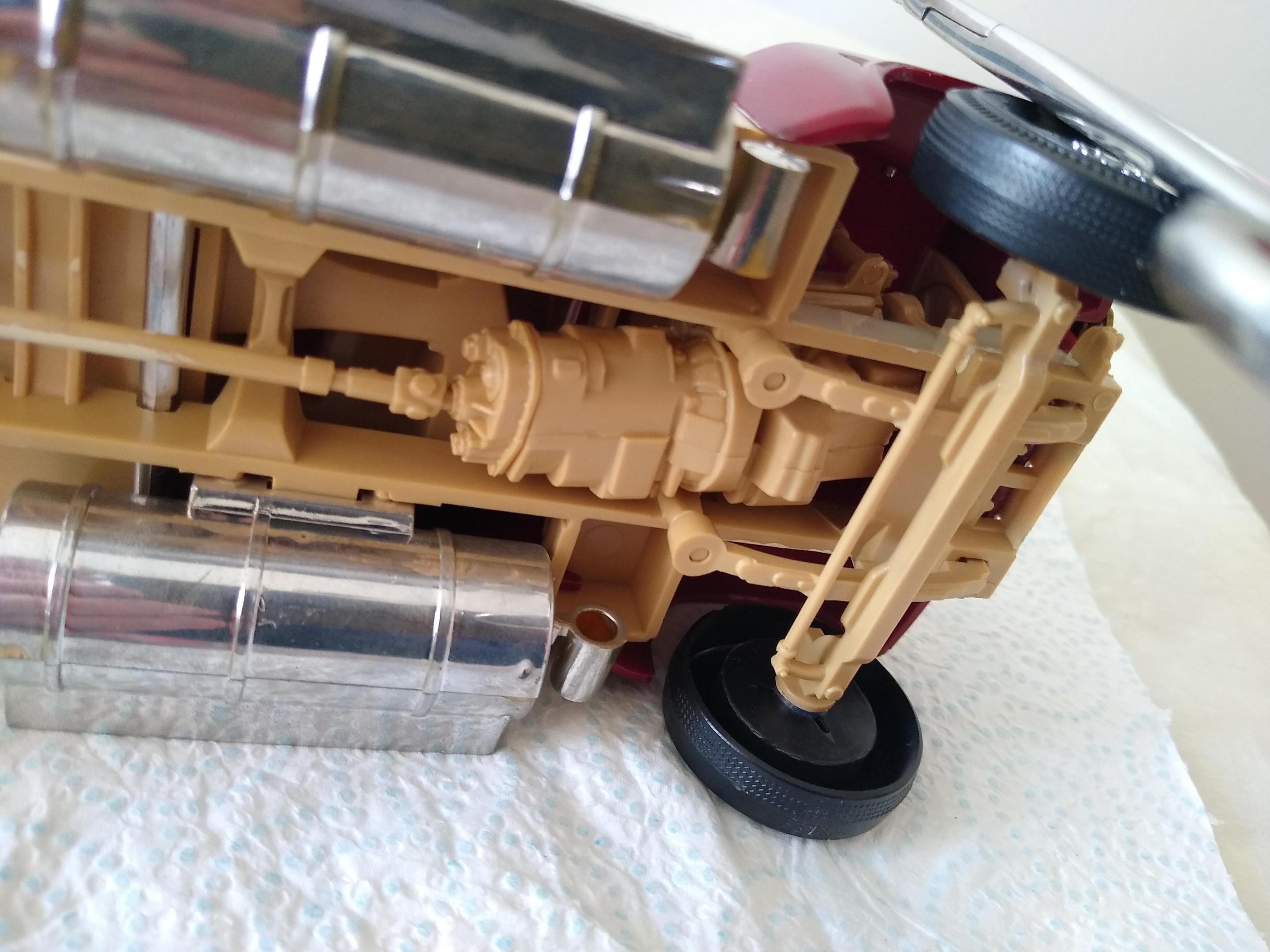

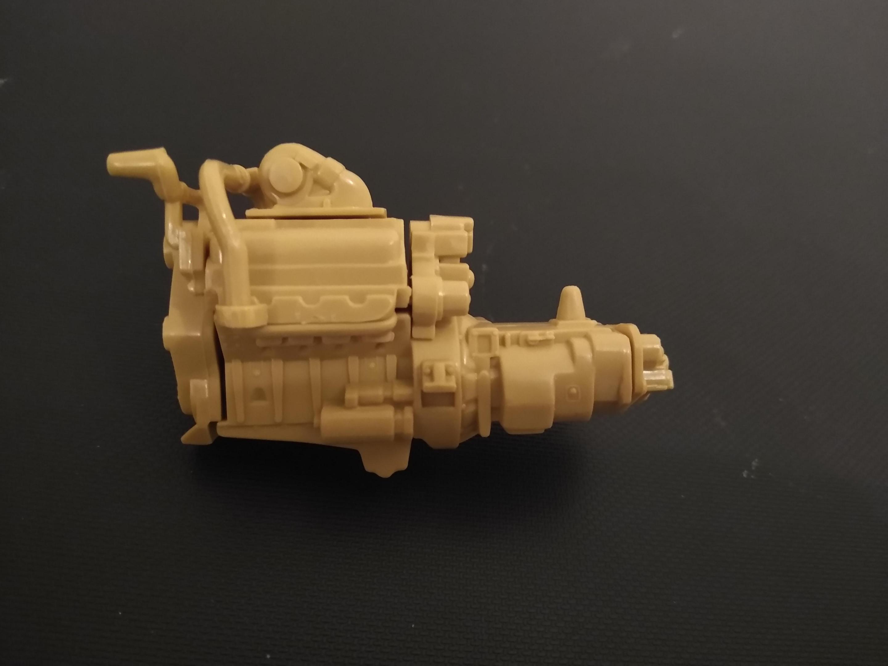

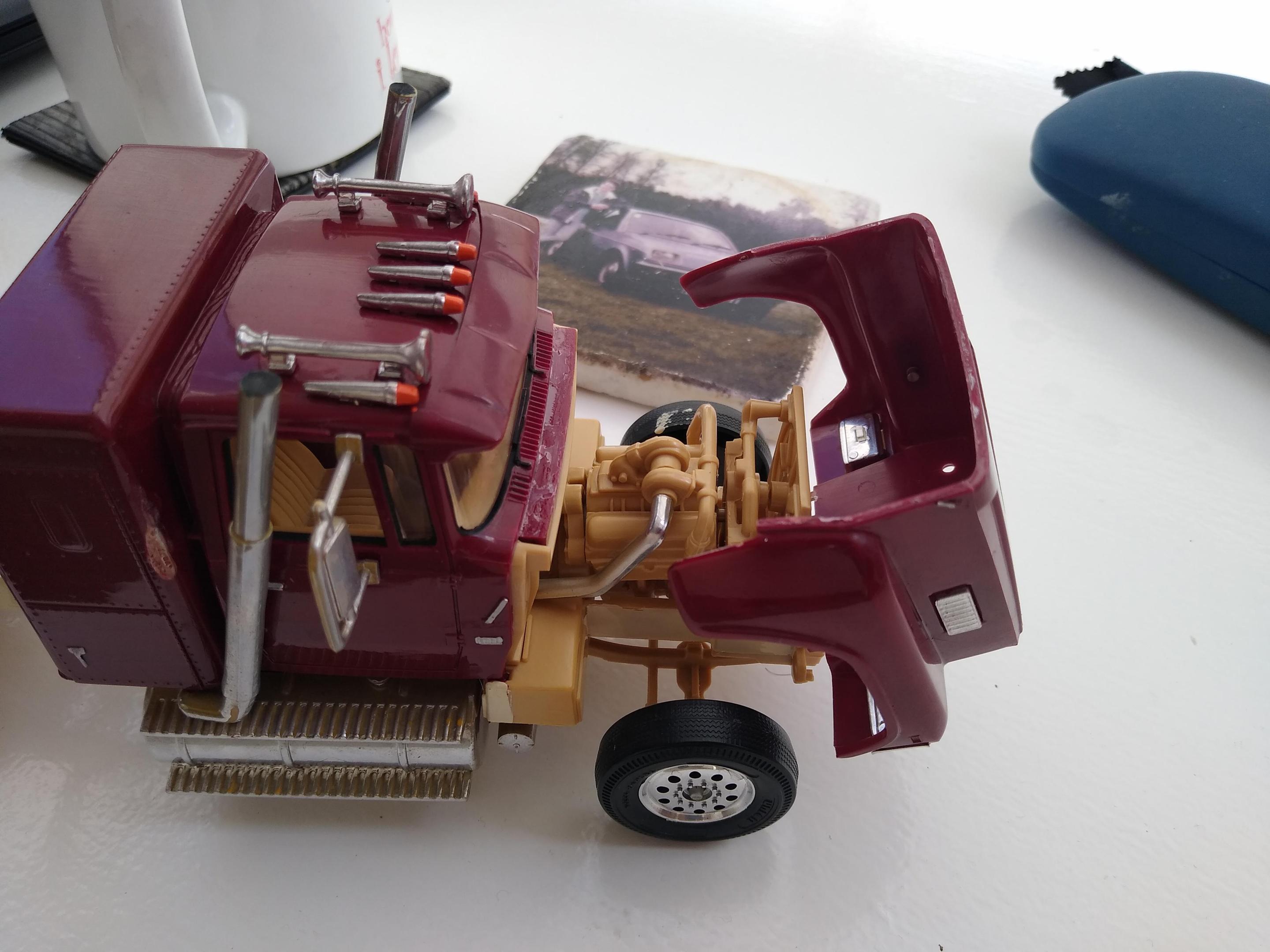

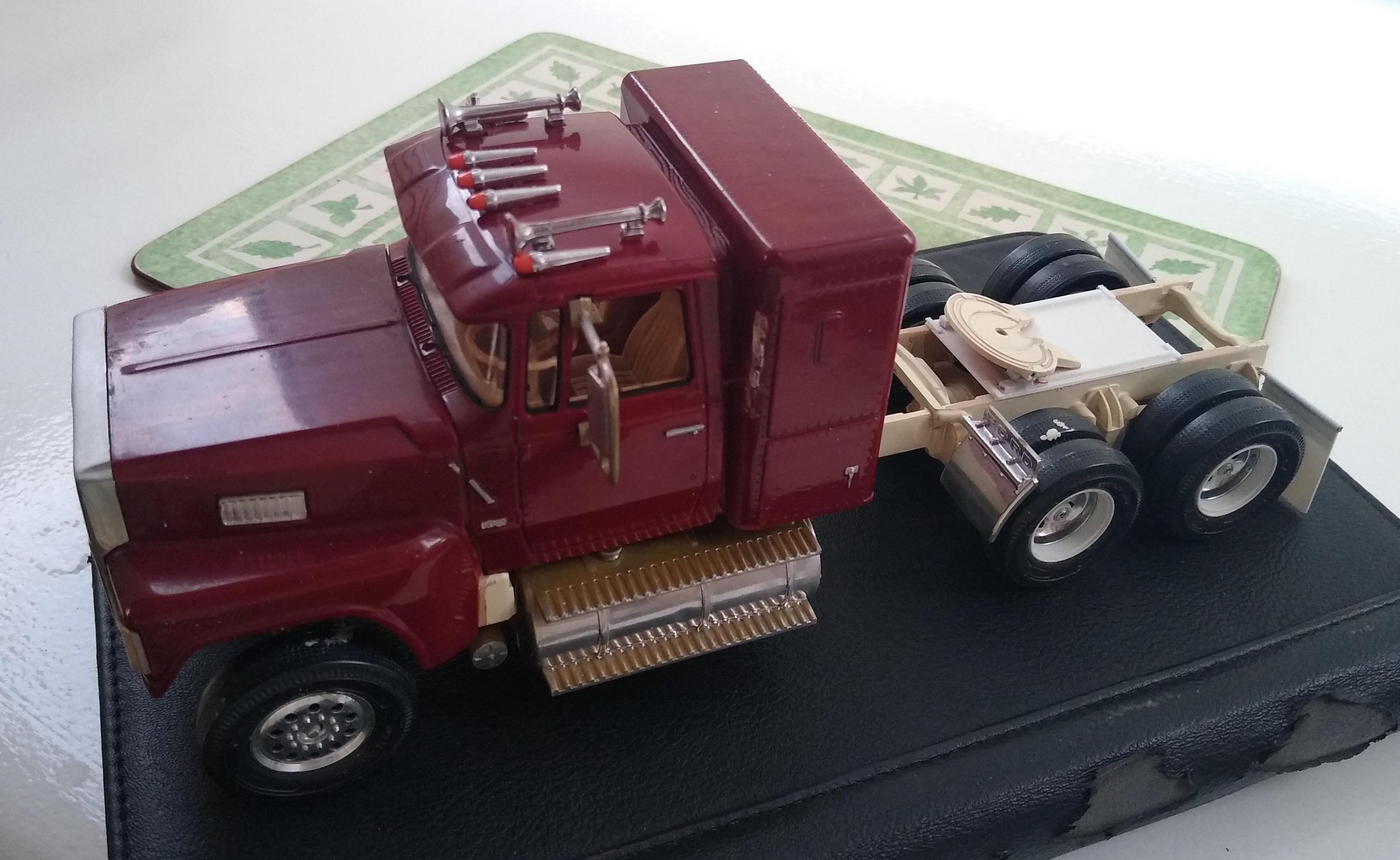

Just got this off eBay for £20. It was really grotty, mould growing on the dusty chassis. Realised that it should have a tilting hood because there's a fantastic little Detroit V8 and Fuller transmission underneath. At last, a 1/32 kit with an engine! I separated the hood using nail varnish remover to soften the super glue. Gave it a good bath too. Snapped the front axle twice in the process. Someone has already replaced the undersize AMT wheels and tyres.
First thing is to lose the ducktail on the chassis. Then research the underhood arrangements. Correct the 5th wheel and make it a functional slider. Reinforce the front axle. The list is endless.

I can't get over this little Detroit, it's fantastic for the scale and the fact that it's a snapper! If only ERTL had been involved with these kits longer we might have had some great 1/32 stuff and I could have a life!
  • Like 3
That's a nice looking engine in 1/32.  The Revell kits are nice, but they are really designed for kids & beginners, in my opinion.  These Ertl 1/32 kits are really another level, although, as you mentioned, the wheels & tires are a little small.  I'm really hoping that Round2 will reissue these 1/32 kits.  They're released everything else multiple times, so why not!

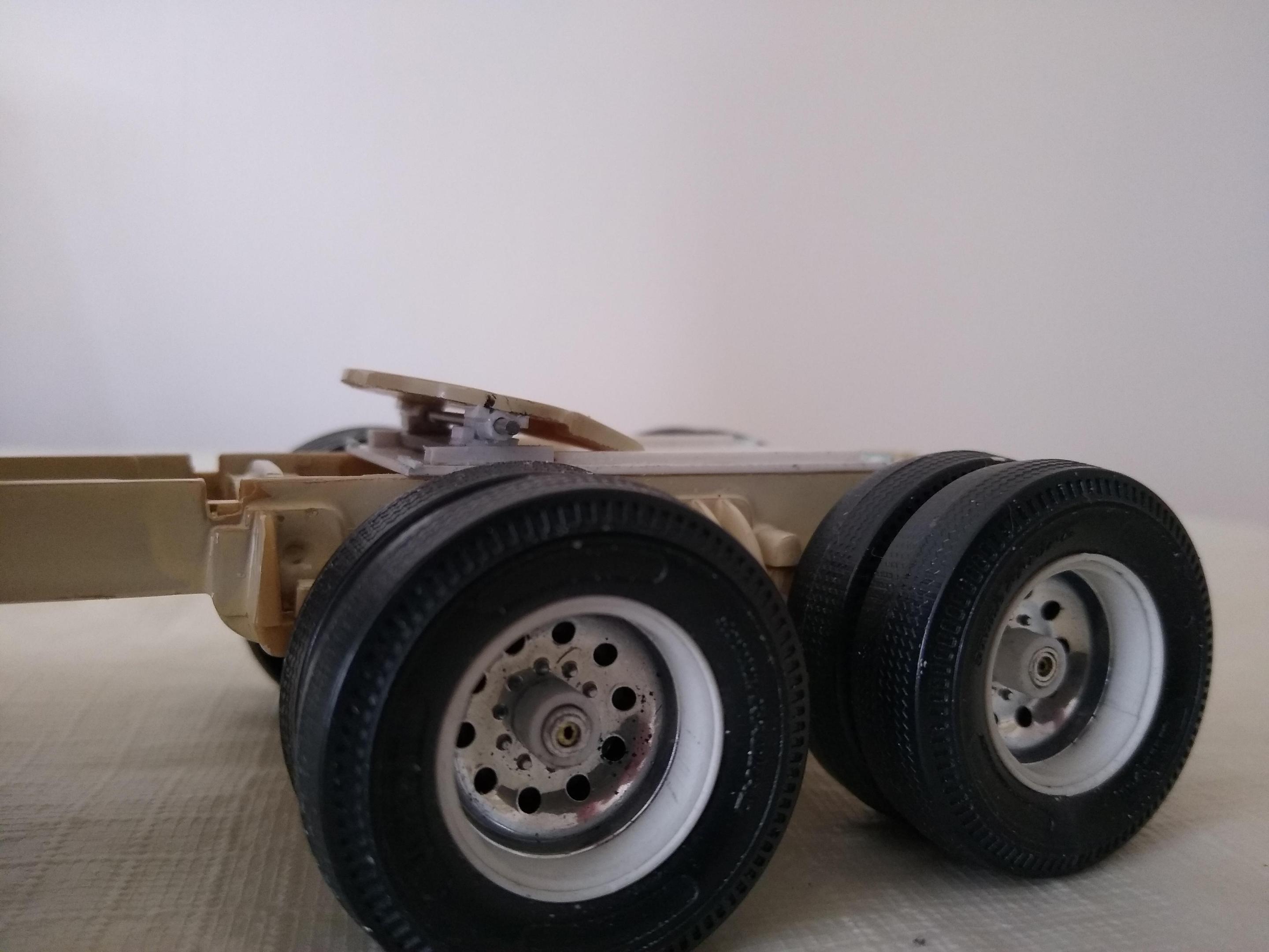

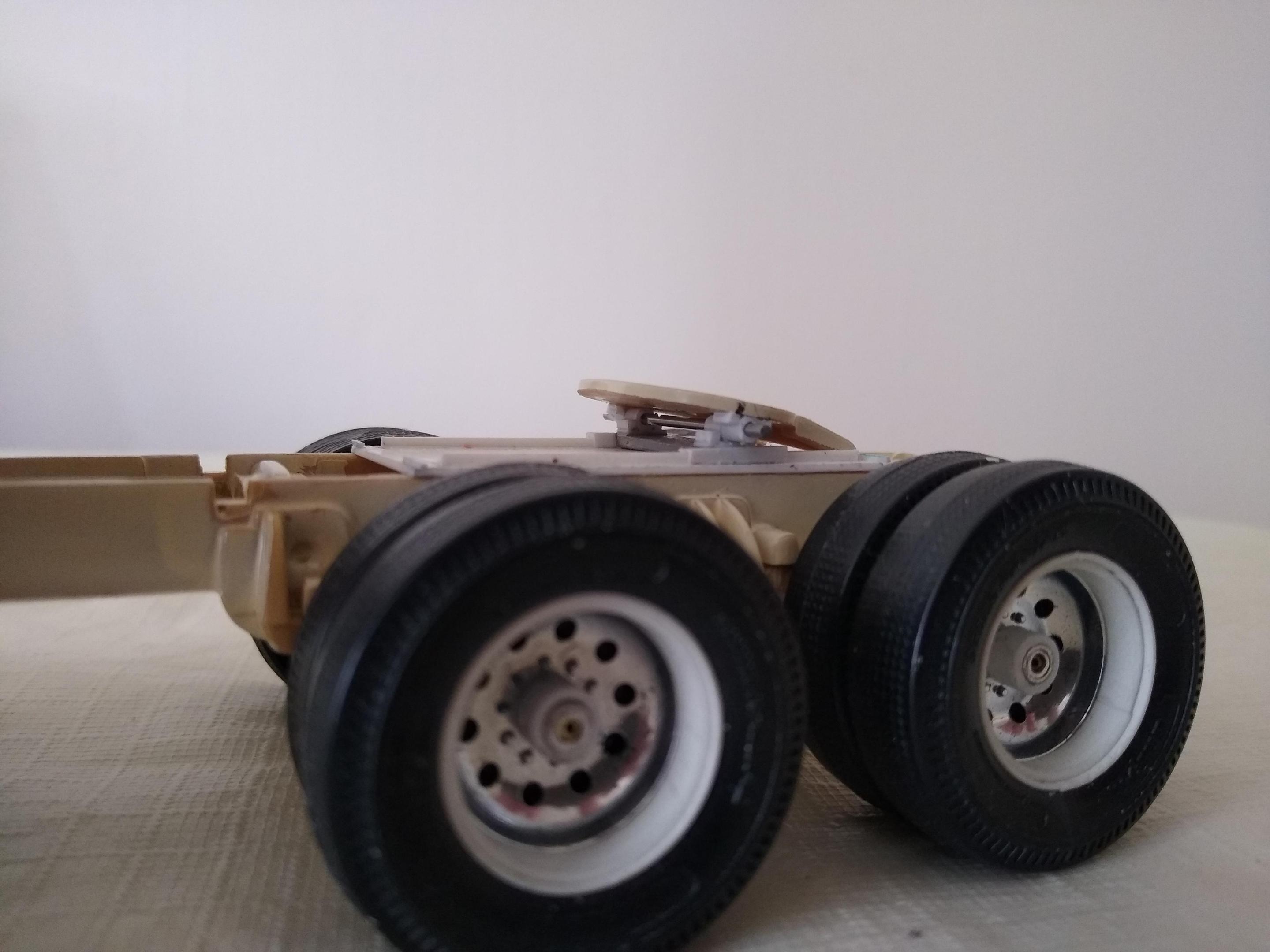

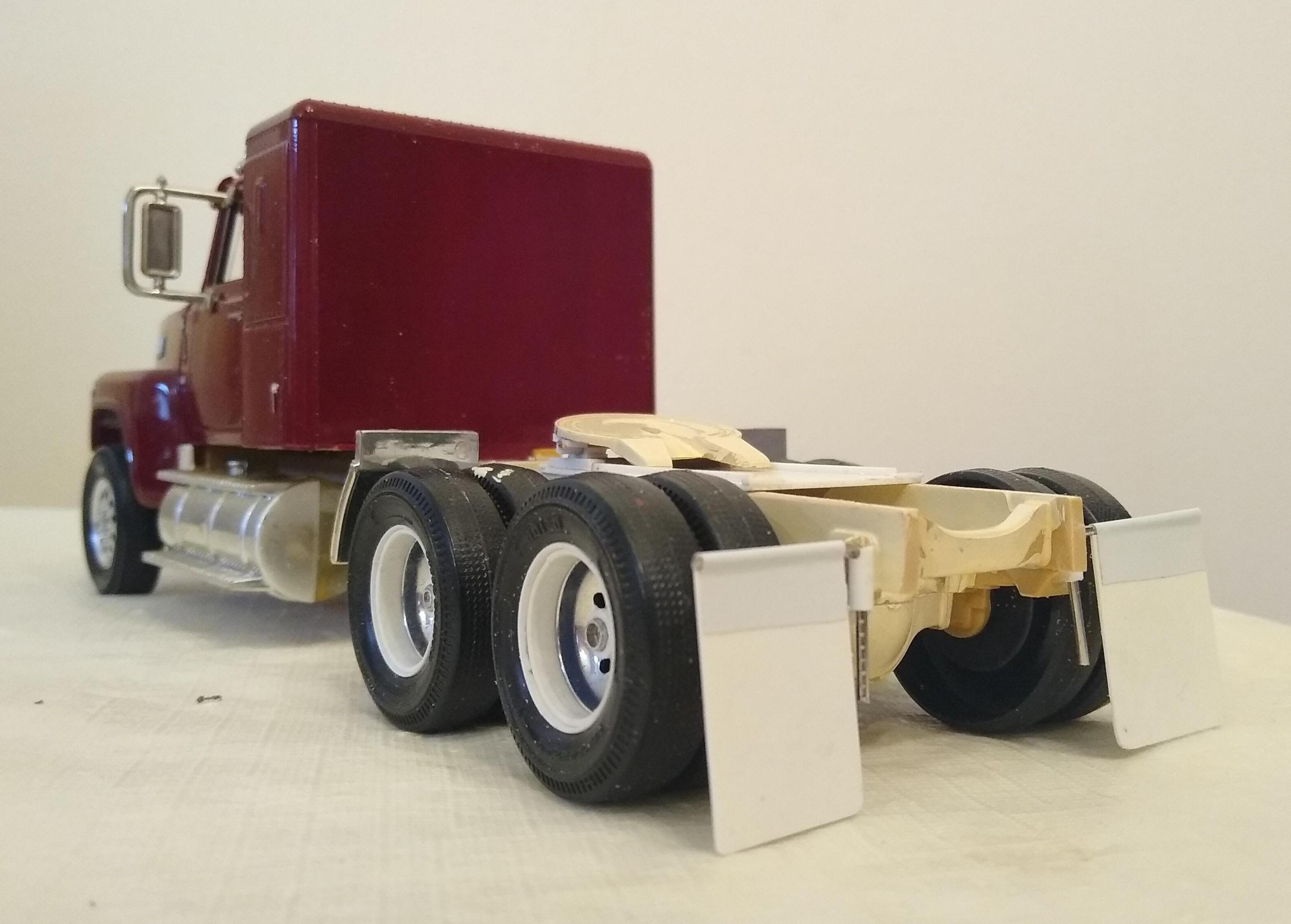

I wanted to do some painting today but the weather was freezing cold and I didn't want to risk a whole trailer "blooming" so I resorted to making the first steps on the Ford.

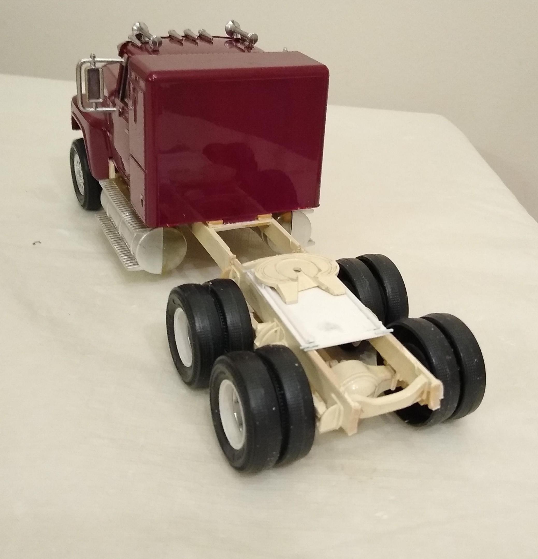

Cut the fifth wheel mount off and built a new slide plate. I'll finish the fifth wheel tomorrow.

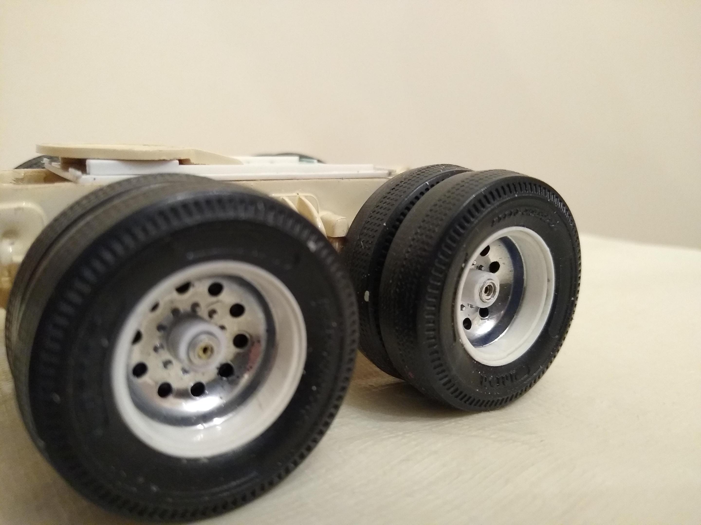

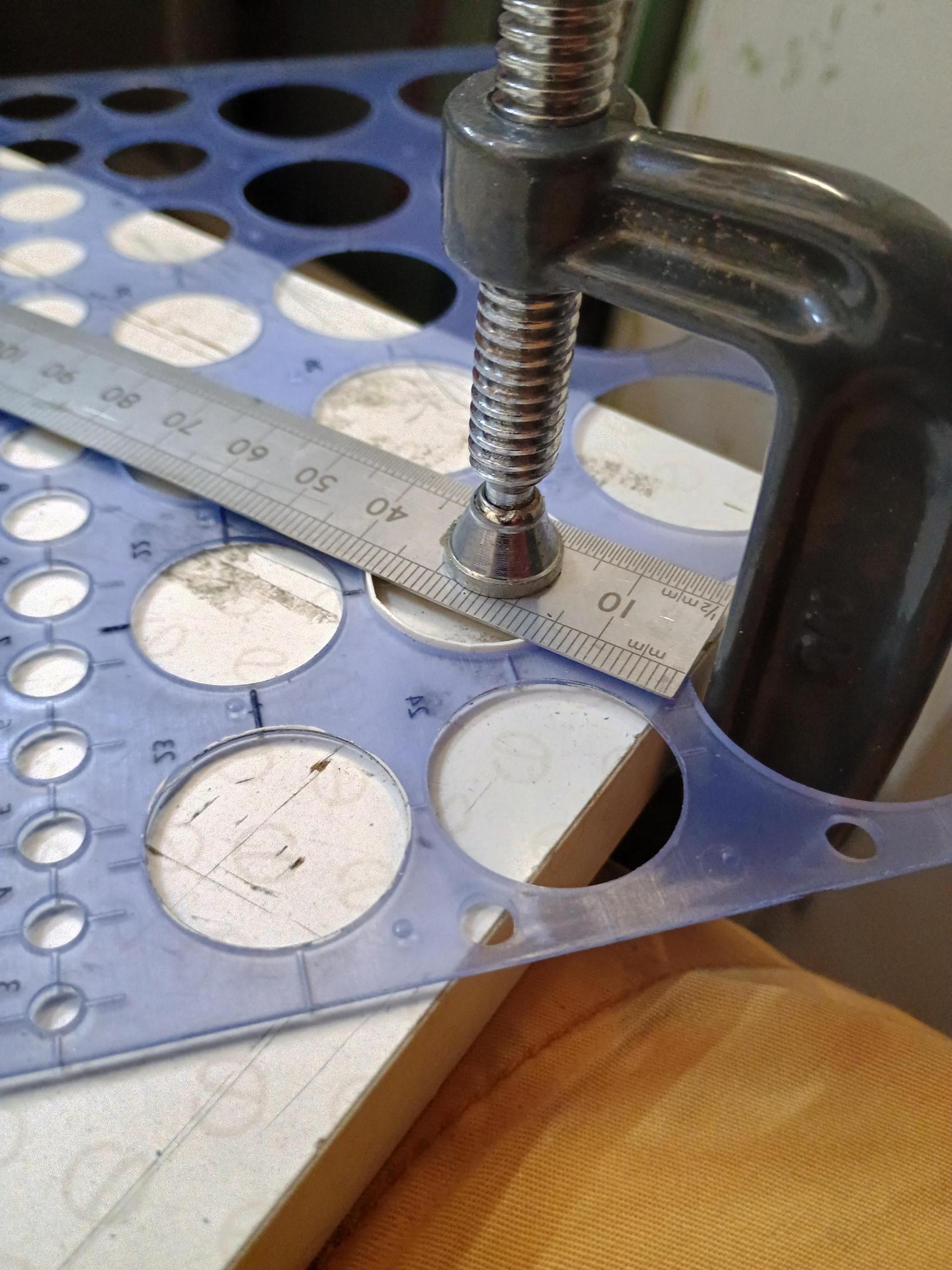

I had to create two new axles from brass and aluminium rods. I cut the back out of the outer tyres which means the rim can sink into the right depth within the tyre. Then, using two 3mm strips of plastic I formed a new wheel rim. They look good. Also trimmed the ducktail off the chassis. Transforms the stance.
  • Like 3
Got my fifth wheel gudgeons fitted and got it mounted on the slider bridge. Might do some detailing to the underside later. The truck is gradually getting it's dignity.

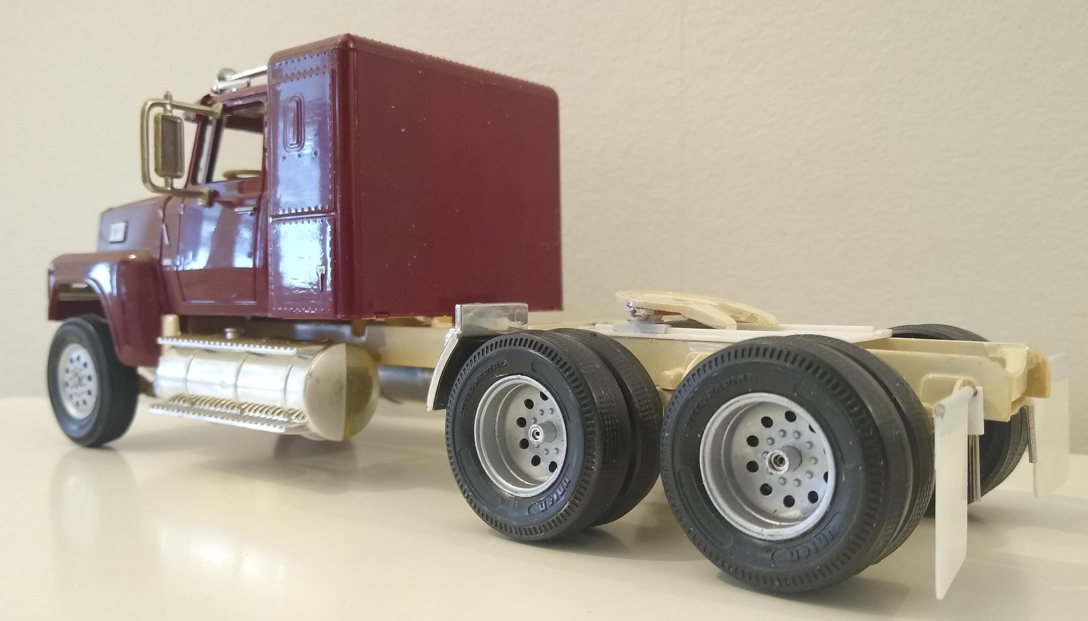

For instance, I didn't want to do my usual crossbar mounting for the mudflaps because the rear crossmember is just too good. I therefore fitted 2mm tube to the rear spring brackets to act as sockets then cut & bent a big paperclip to carry the flaps. For the moment the flaps are 0.5mm sheet hung with a loop of electricians tape. The quarter fenders are good as they are so they can stay. I'm very happy with the look, so much better.

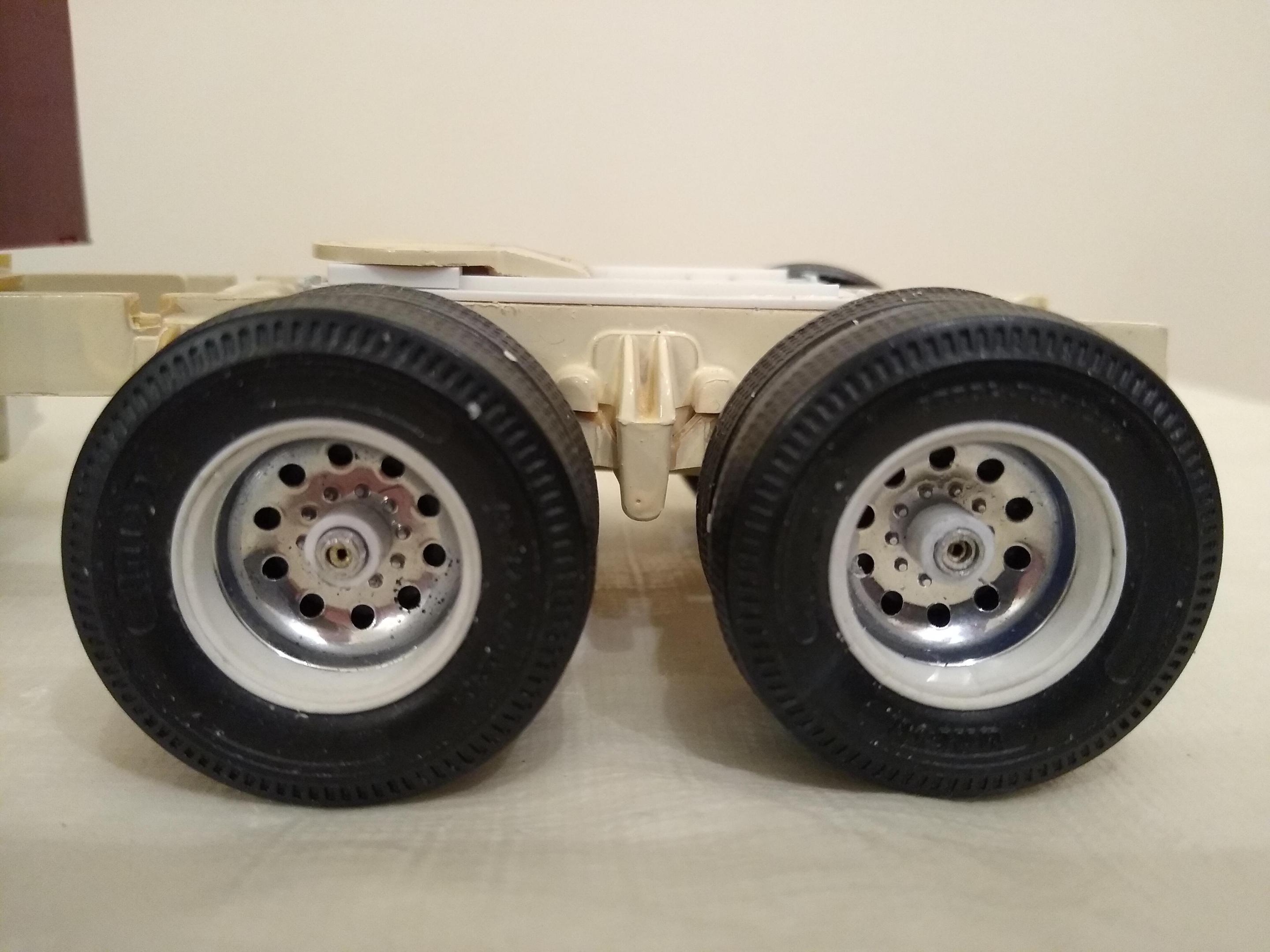

Painted my modified wheels a nice weathered aluminium. I think they look fine, make the rear tandems look beefier.

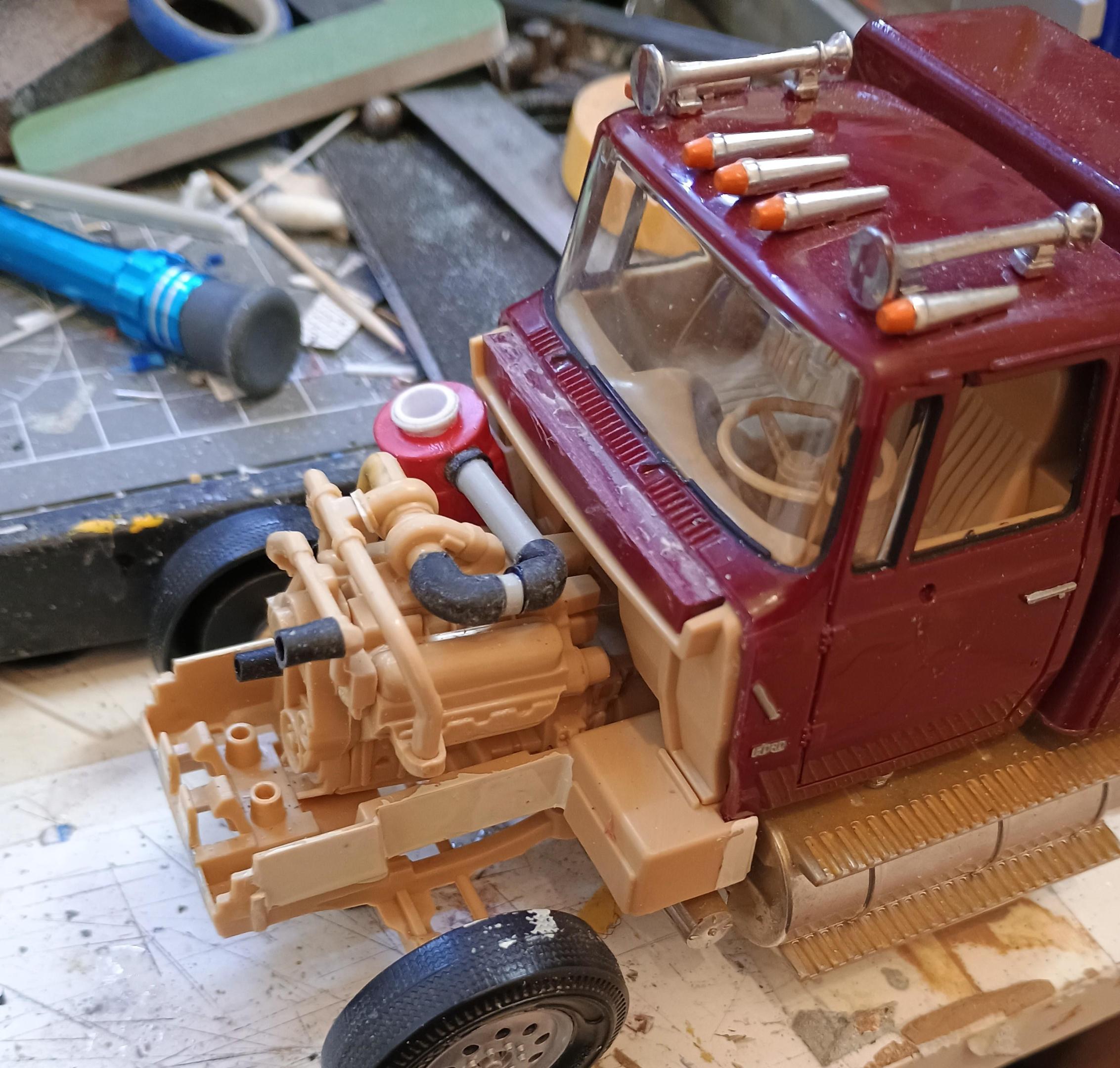

So I trawled through my WIPs and found that next in line was the Ford LTL9000, so I gave that some attention.

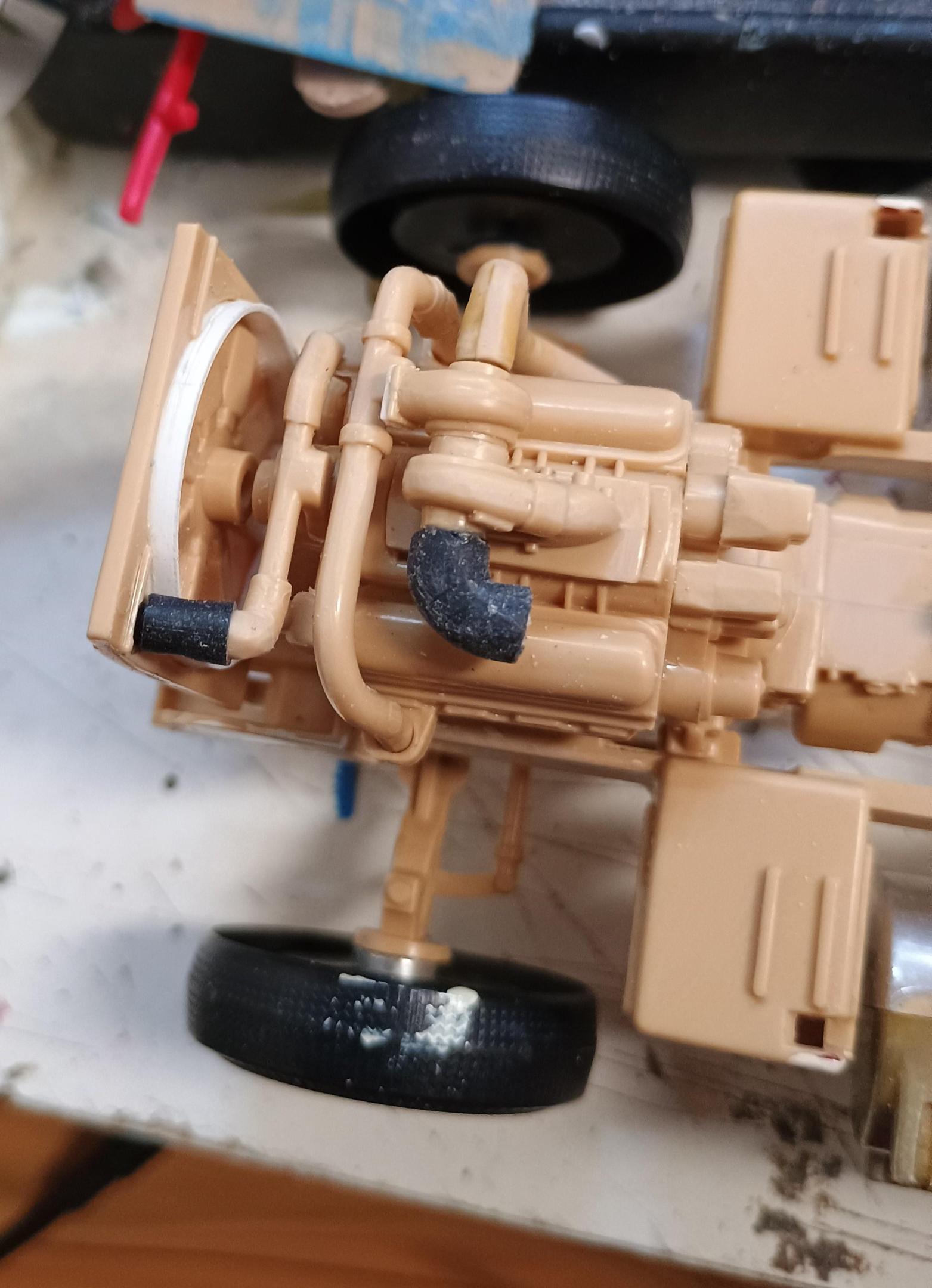

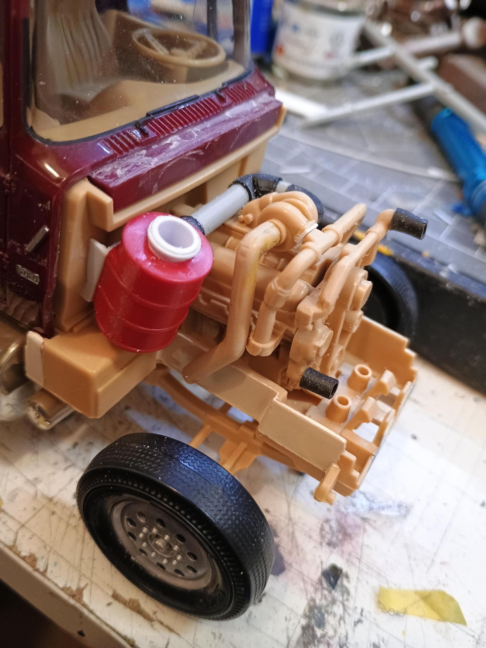

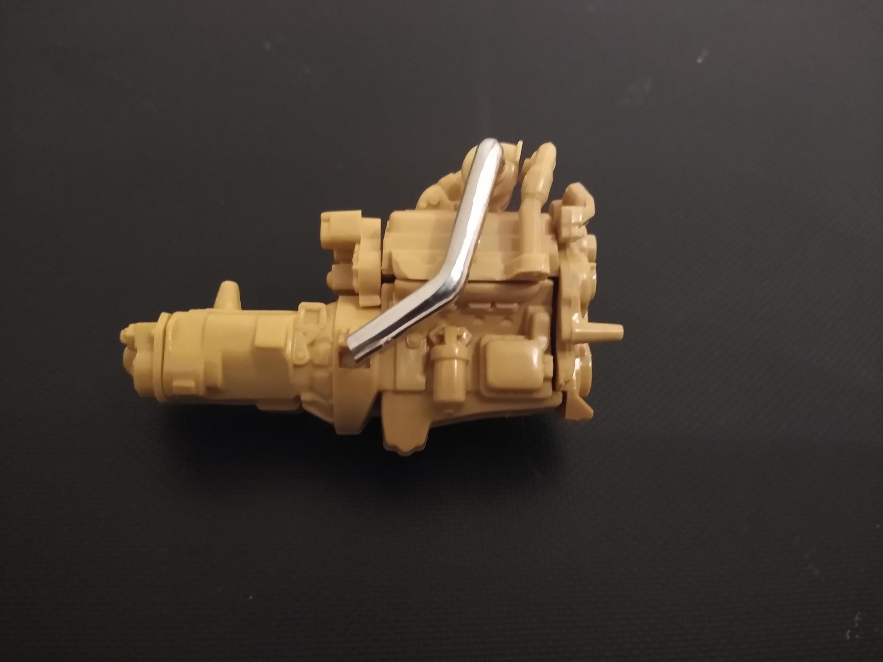

First, I stripped the engine and tidied the joints up so that it looks more whole. Added radiator hoses and used an old air cleaner assembly and chubby sprue to build an inlet system to the turbo. Had to make the rubber gasket on the top of the filter that mates to an air box on the hood. Looks ok.

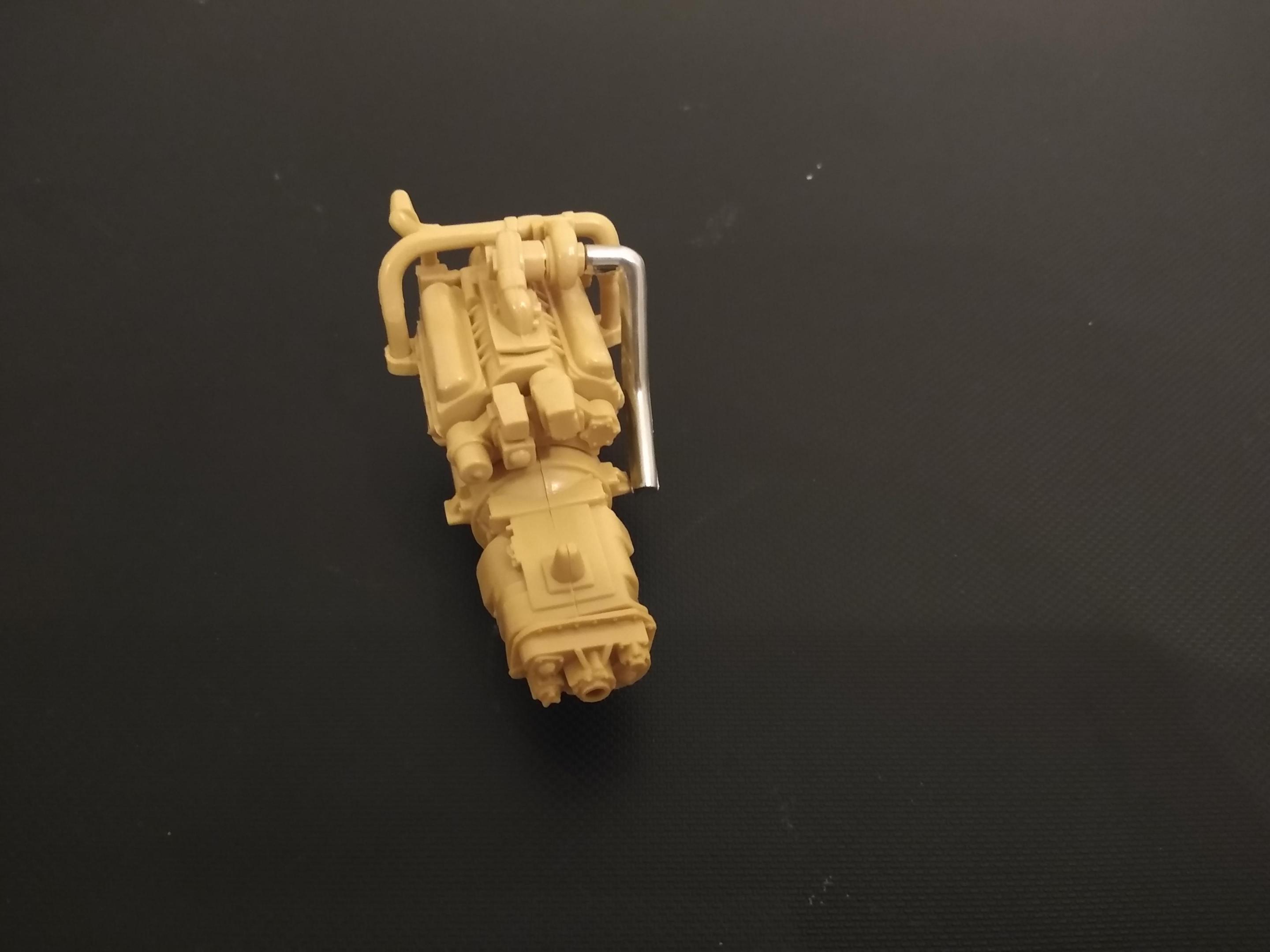

Made a fan shroud and a steering box this morning. IMG_20241020_095227999_HDR.thumb.jpg.2a1eab429bdd6f74639735cdbc221757.jpg
