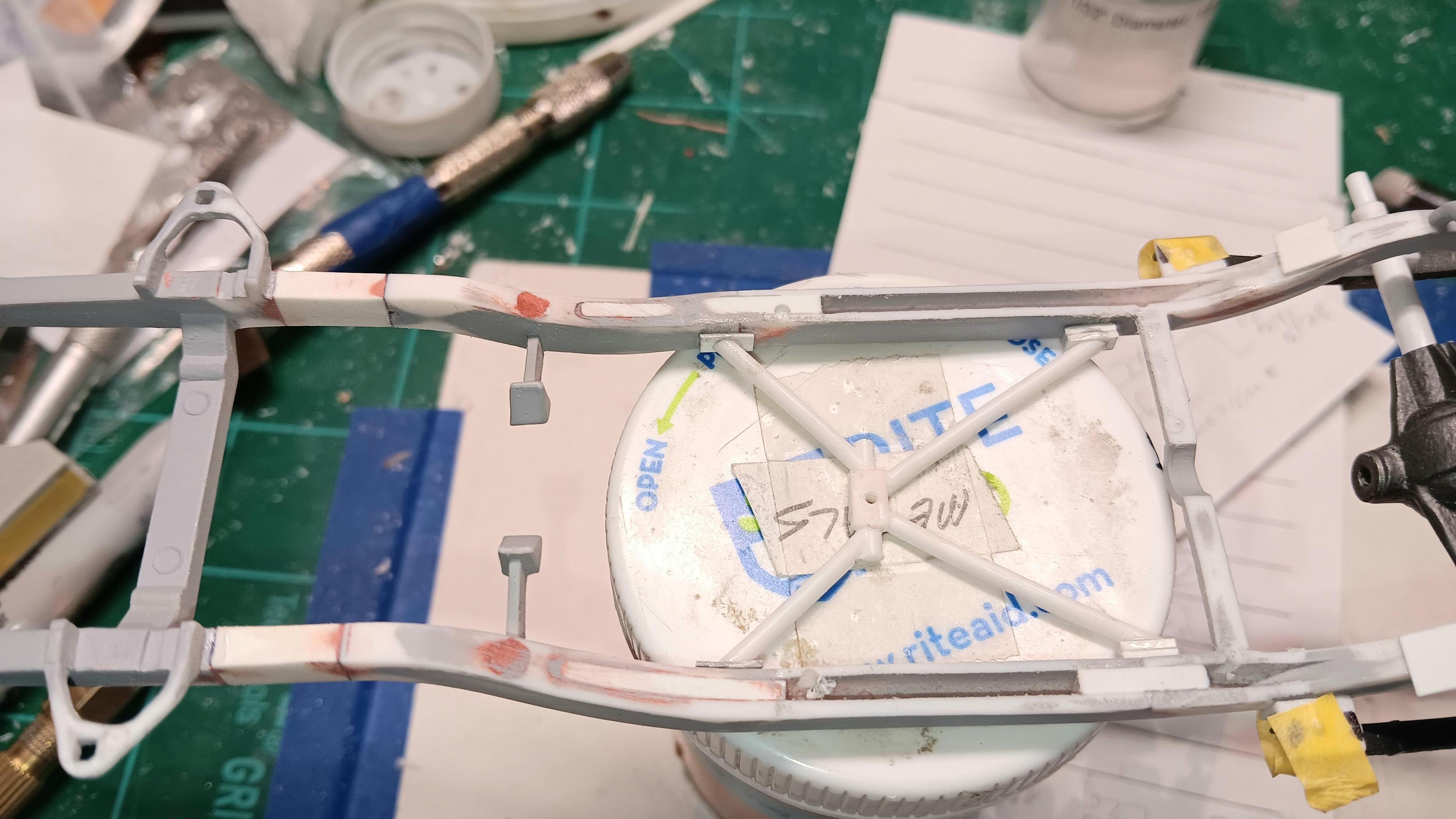

This has been kicking around for a few months. I had wanted to do a build with all the MPC kit issues resolved.

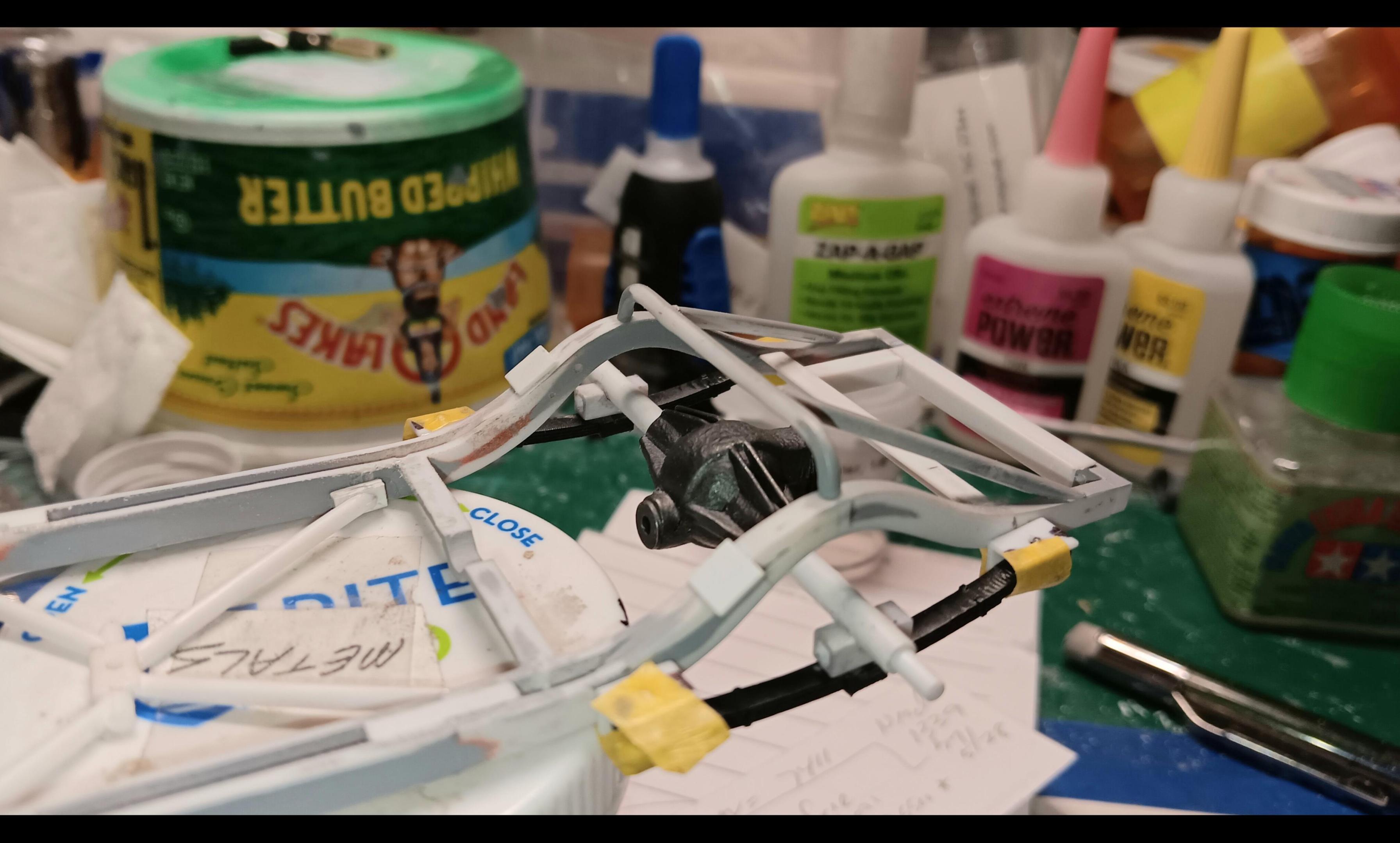

1. The engine needs to be set back around 5/16". What I realized on this one was, a similar amount had to be added in front of the motor mounts, or the tires are too close to the headers

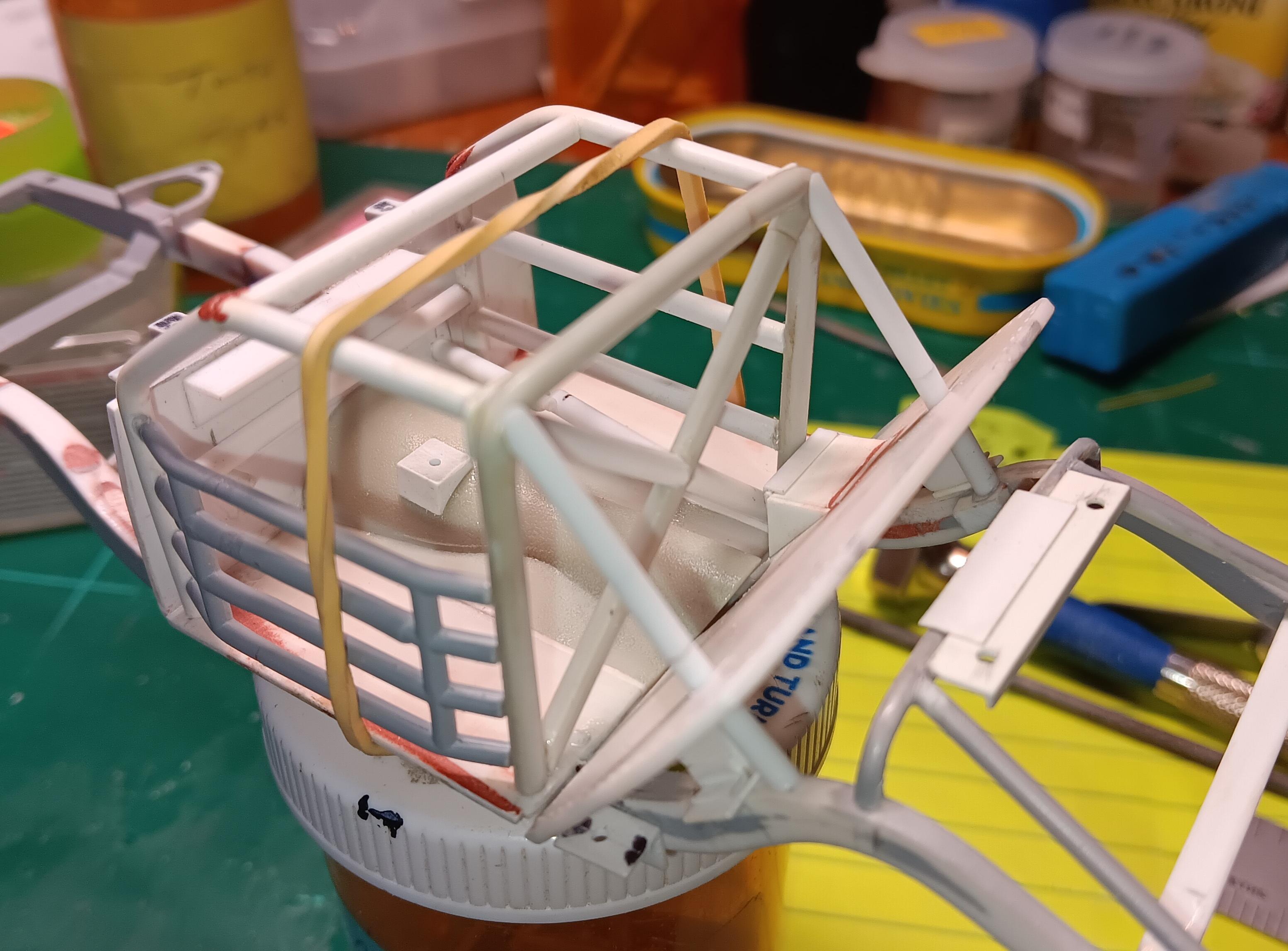

2. The kit cage is junk. So I kit bashed this one. I will move it to the left so the seat fits better.

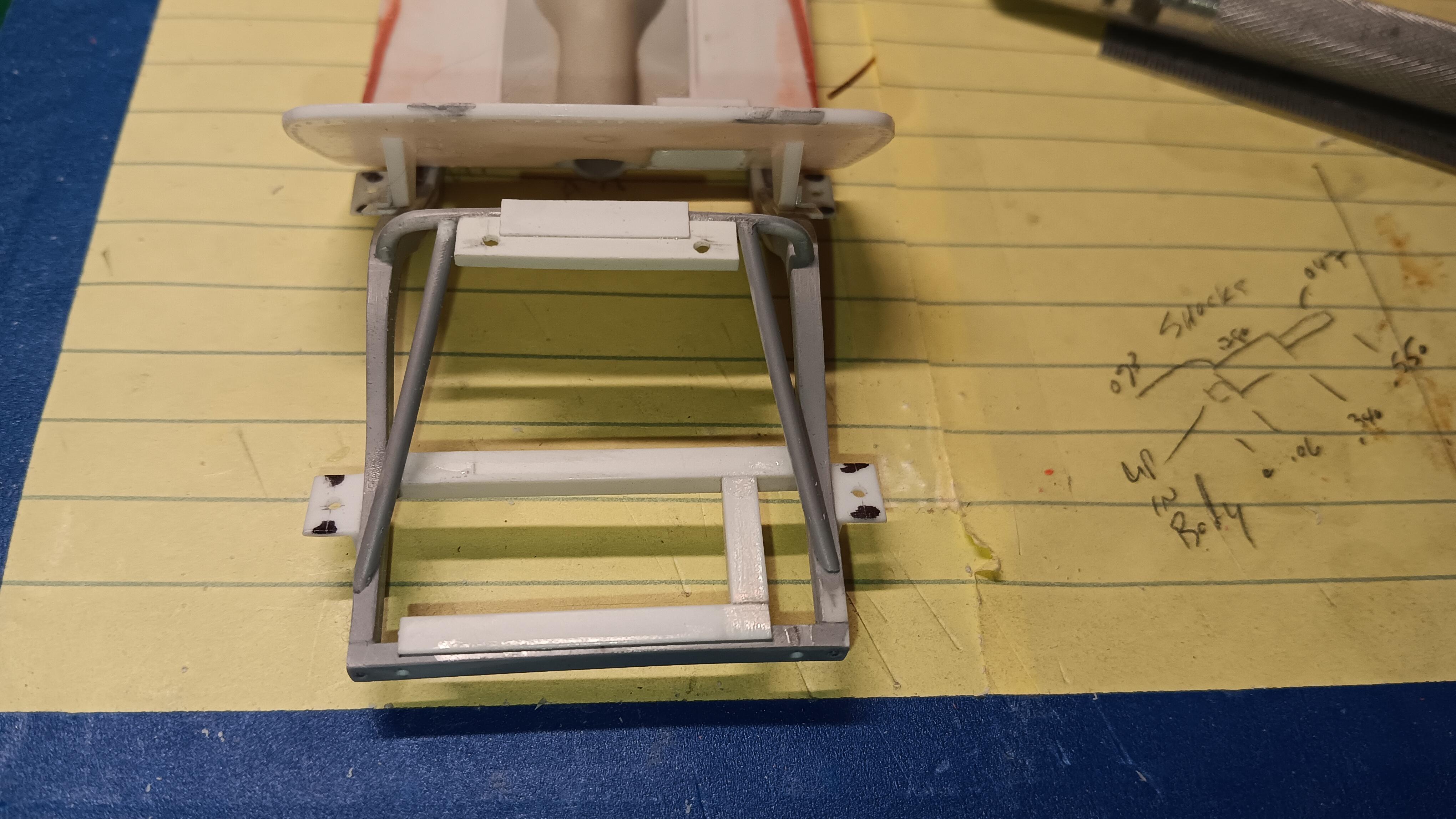

3. The rear springs need a lot of work too. I used some from Ron Coon Resins and made perches from 1/8" square tube. The too-big axle tube was replaced with 1/8" tubing. Now the springs mount from the bottom.

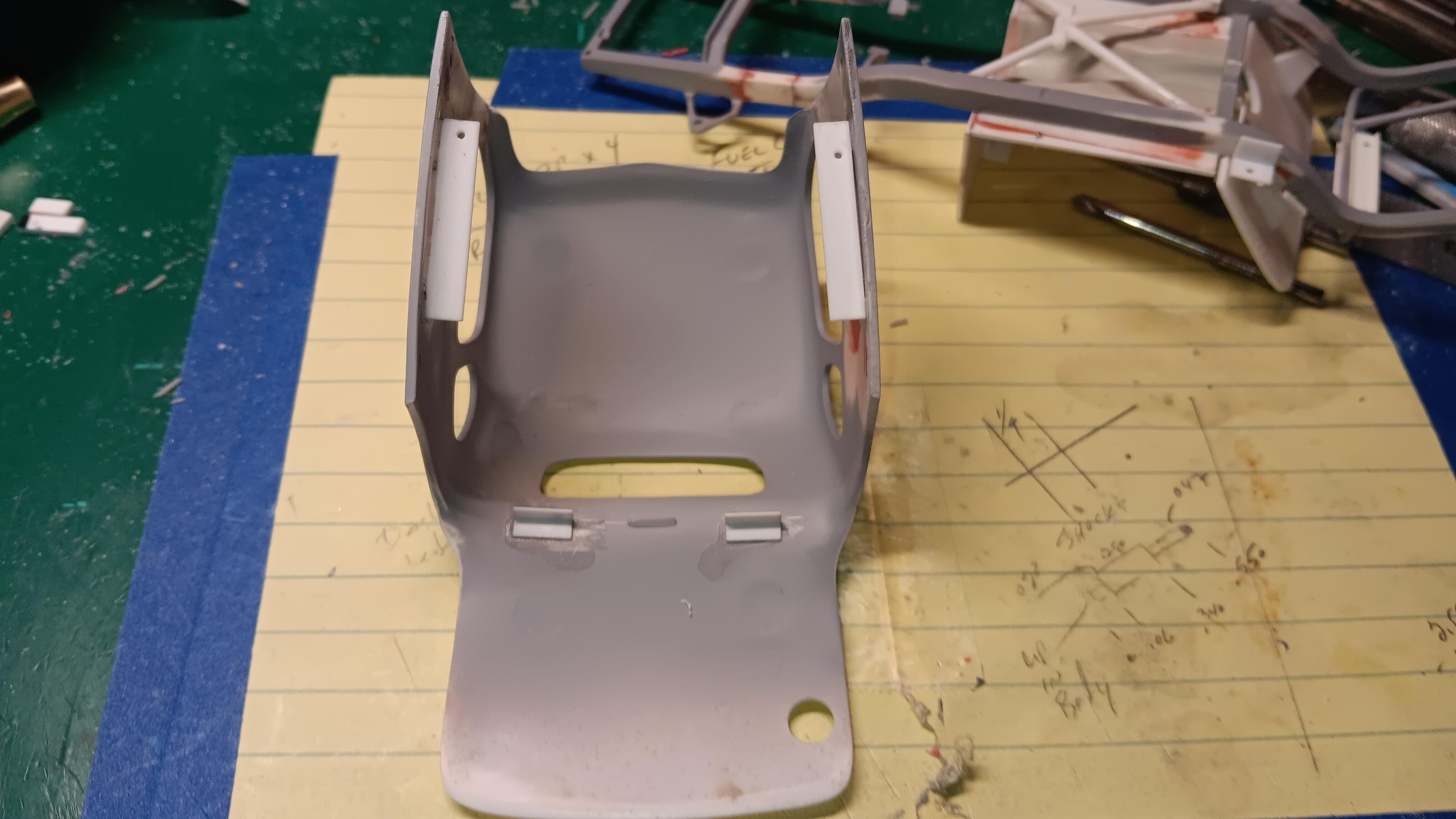

4. The kit floor pan is very tight for the engine set back. I grafted in a partial pan from my junkyard. I squared off the floor pan to fit the coupe body
5. The headers are almost not worth messing with. I added about .100" to the tube lengths, something that needs to get done with the Vega and Pinto as the bodies are wider. I have a couple here to look at, also Ron Coon and VCG Resins have something worth a look.
Other things, the transmission cradle also has to move. The kit coil overs are crude, I make my own from .120" diameter springs. I still have to do the back ones.
I'm working on this a little at a time. Next will be the rear coil overs and mounts. That bar over the rear end makes the installation difficult. I may use a stud at the top
The side rails always fight with the headers. I may have to make those too.

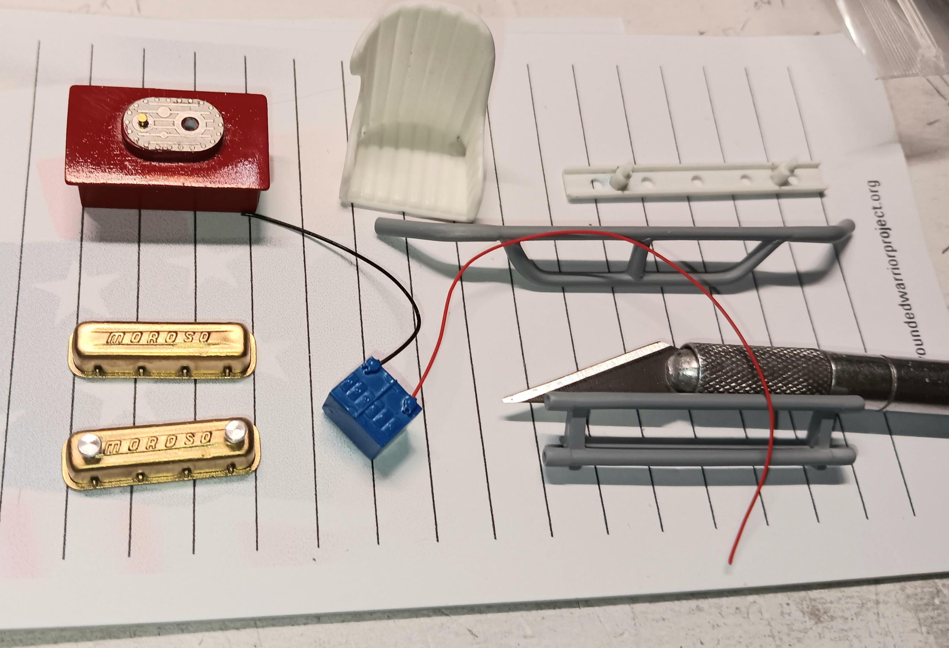

I went through my 3D printed header stash and have a couple that may be workable on this build. I'll have to extend the header tubes and see how well it plays with the side rub rails. It may be time to start making my own rails from brass tubing, the kit ones are another struggle. Ron Coon also has 2 sets of big block headers I would like to pick up. Another option is solder, but all I have is .062" and anything else is too fat. The solder also droops in long lengths.
I have also been eyeballing a 427 Ford engine I built for another build. The generic engine that comes with the kit (could be built as a Chevy or Ford) is fairly ambiguous. I had a set of injectors made up for a previous build, but had problems plumbing them up to look realistic. I picked up some other injectors, one nicer one from 3D Scale Parts that may be workable.

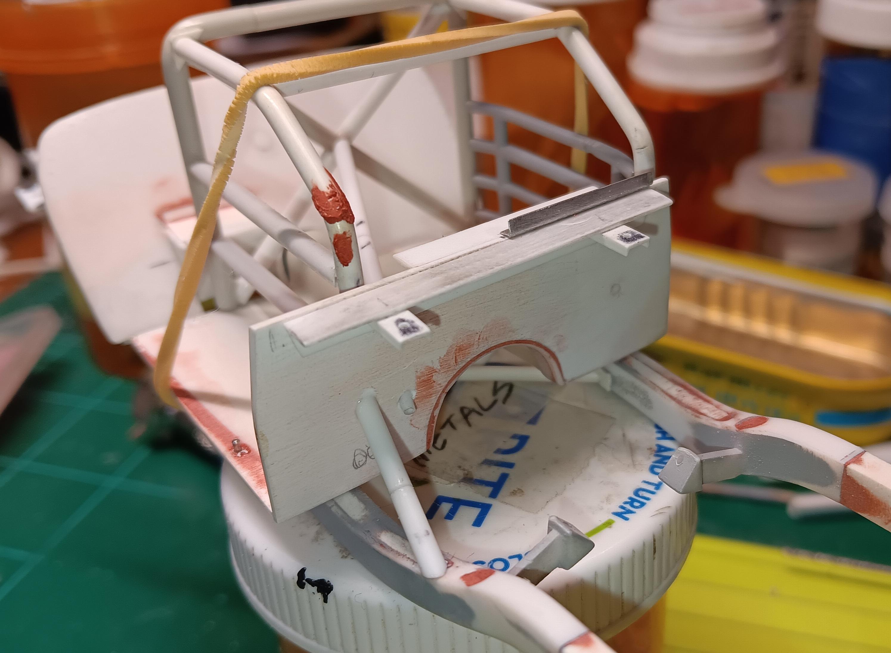

I have to get back on this. I ran into am issue with the rear partition or firewall location.

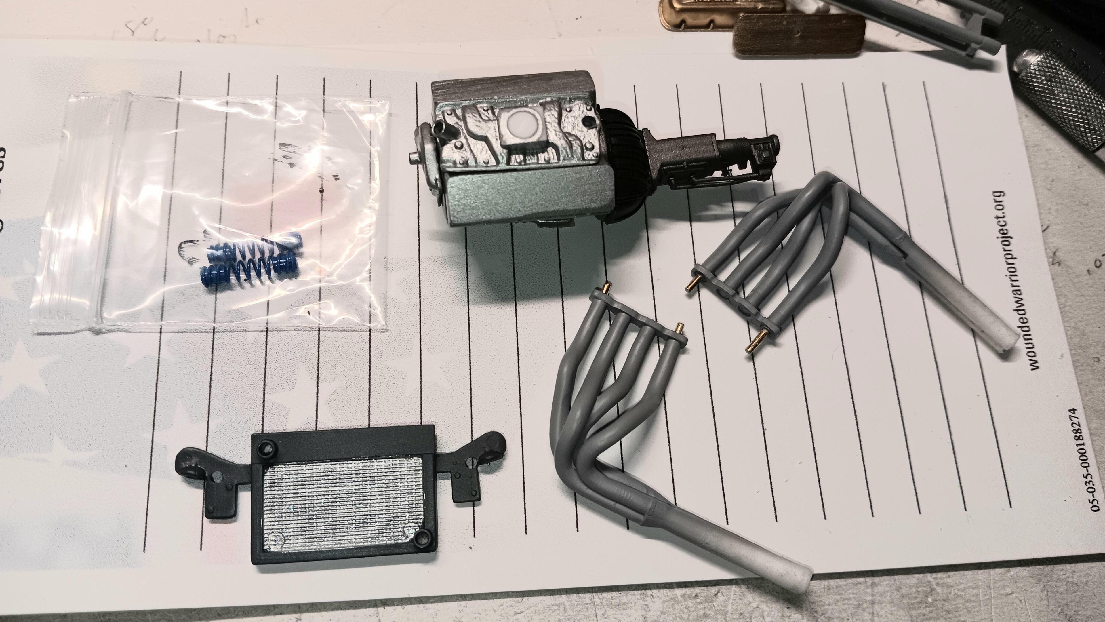

The kit headers are a horror show. I have a few sets on order from Ron Coon Resins.

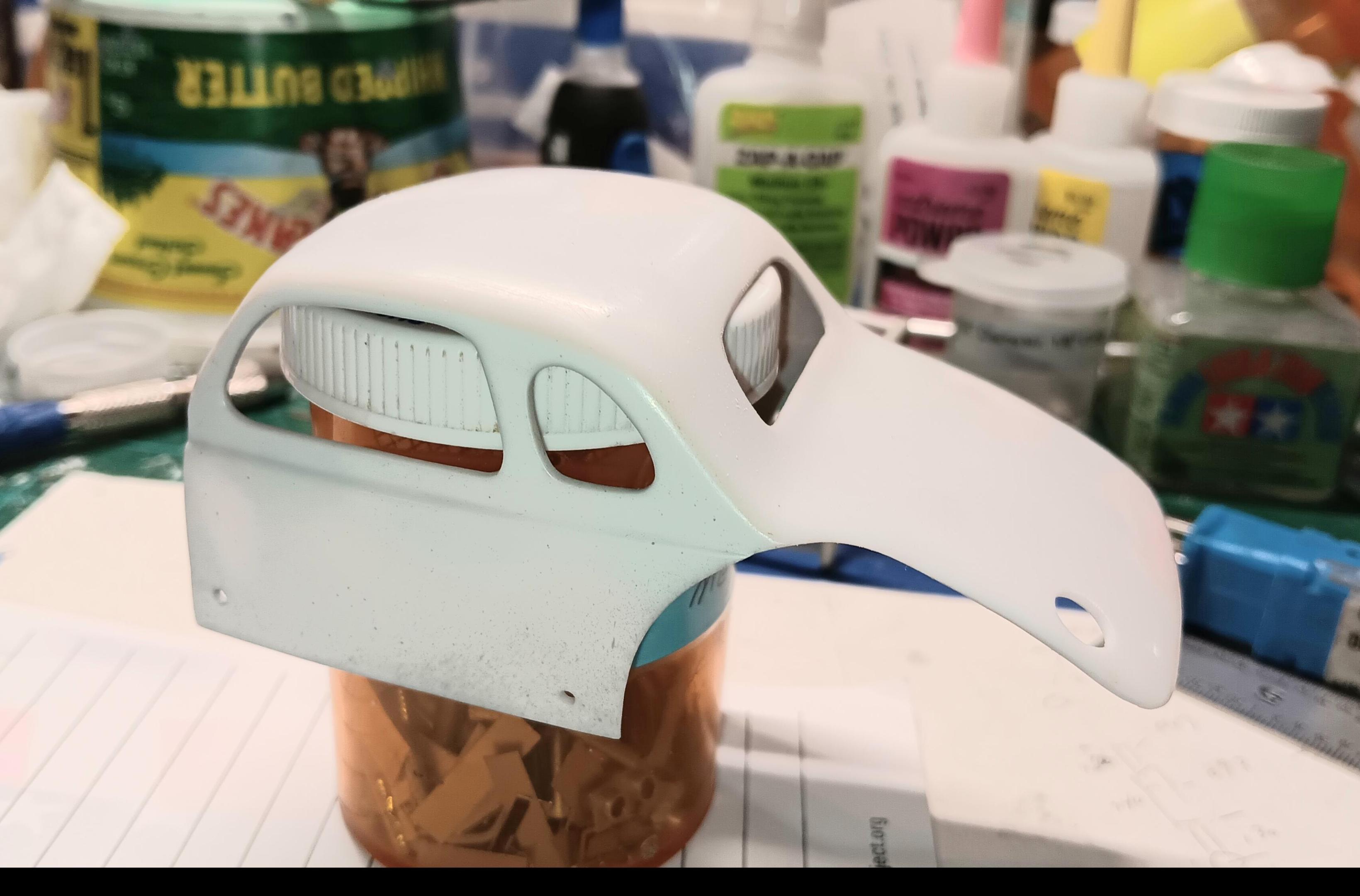

Ok... the Future Mod is back. I got disgusted with botching up the body to chassis fit.. BACK IN THE BOX!
I decided to try some new Ron Coon Resins parts on it. Last night I was able to get the body in a good location. I used some styrene angle and pinned it 2 places along the rockers.
This is one of my major dislikes with the kit.

Next up is to add a ledge to the firewall to make fitting the "glass" easier. I have to fix the battery box, or make it modular to install the battery/box as a single unit.

I have a few headers to choose from.

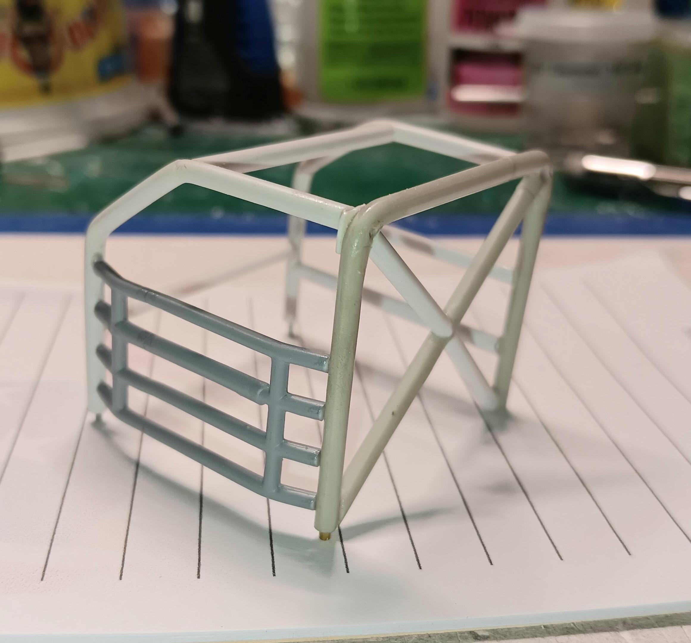

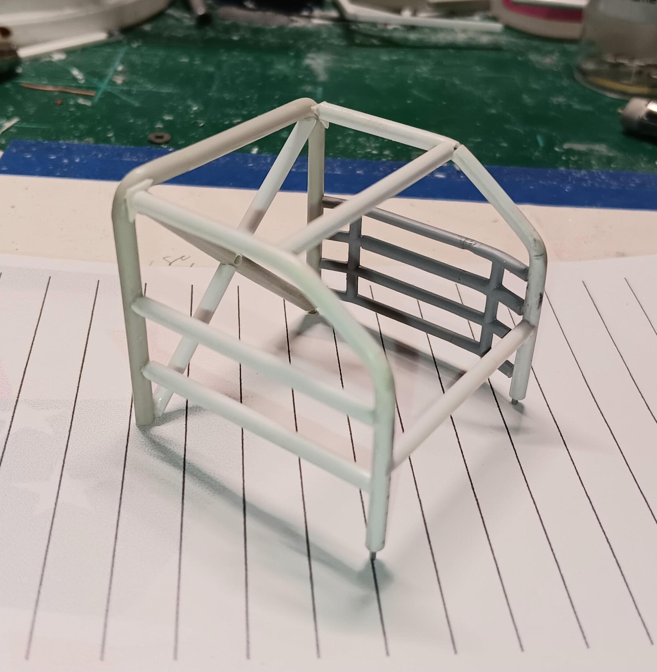

I'm doing some bars and having 2 ends with a compound angle makes it harder. I now make the bars in 2 pieces. Get the angled ends right. Cut the other ends that meet square. Now you can index the ends, glue the middle.

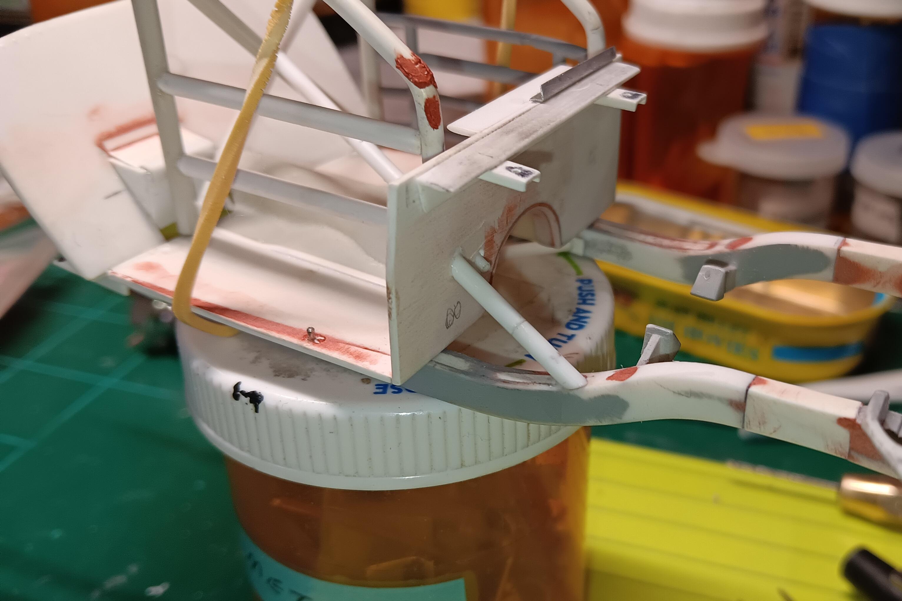

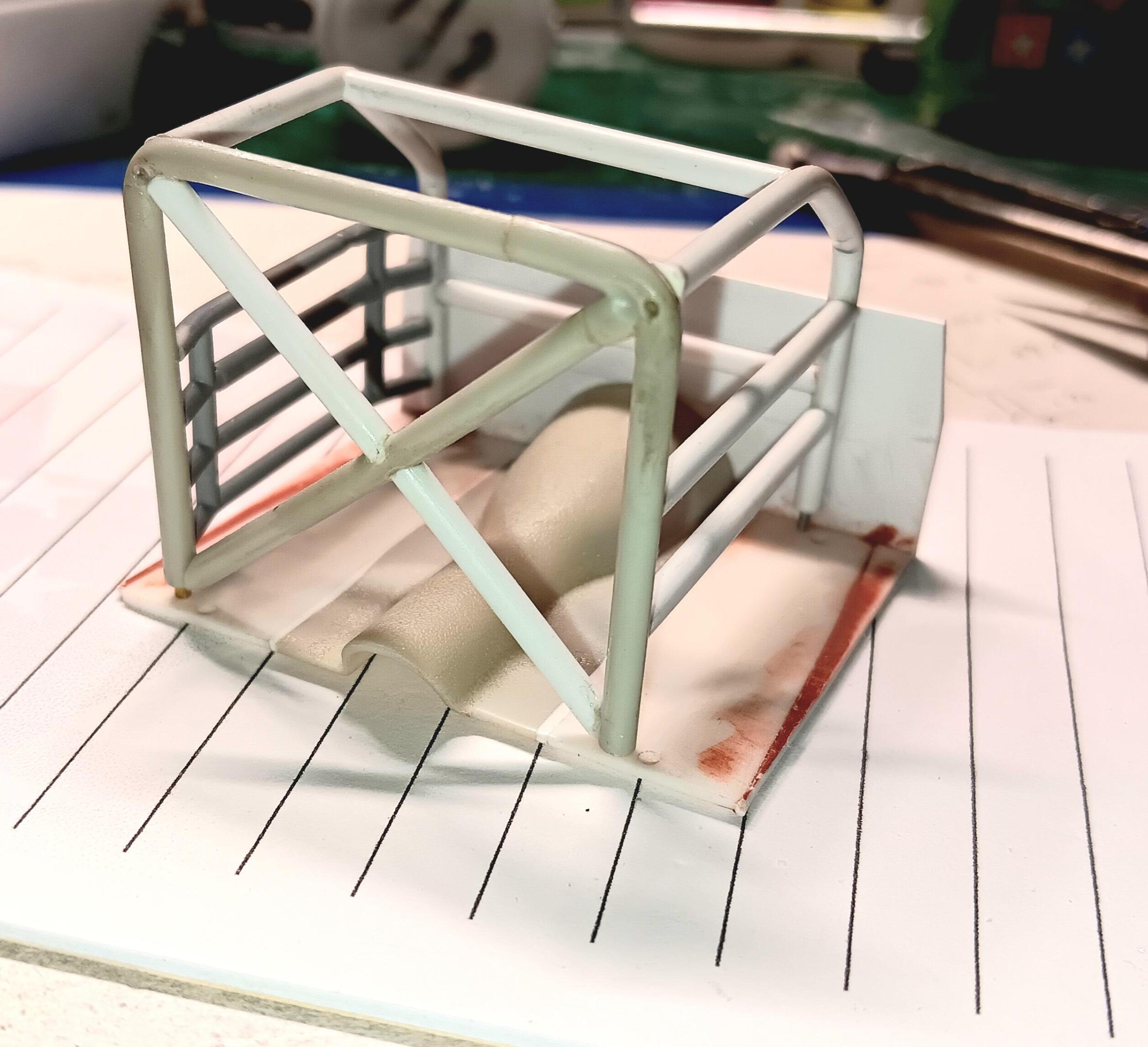

Rear kicker bars are up next. More fun since the cage is offset to the left. Which was common on modifieds. The kit does not give a ton of room as it is, even worse with the floor pan left stock.
Calling the cage DONE. The rear kickers are 2 pieces, the upper pieces are pinned to the lower, to be installed at assembly.

Patched the gaps on the floor pan, reattached the battery box.
The body needed material added to the driver side wheel well. The body was out of symmetry by .090".
I made a longer oil filter, much better. 4 speed again is from VCG Resins. That will be pinned in place.
The kit headers are about as good as they are gonna be. I have a set of Ron Coon headers I extended the tubed on. I have flanges made up.

I did this cage with .093" plastic tubing, since it is easier to splice with a center hole. I have some .080" tube, but it is thin-walled. I have to mess around with it some more. It does take .062" rod and aluminum tubing. I just think that the .080" tube looks more realistic.
