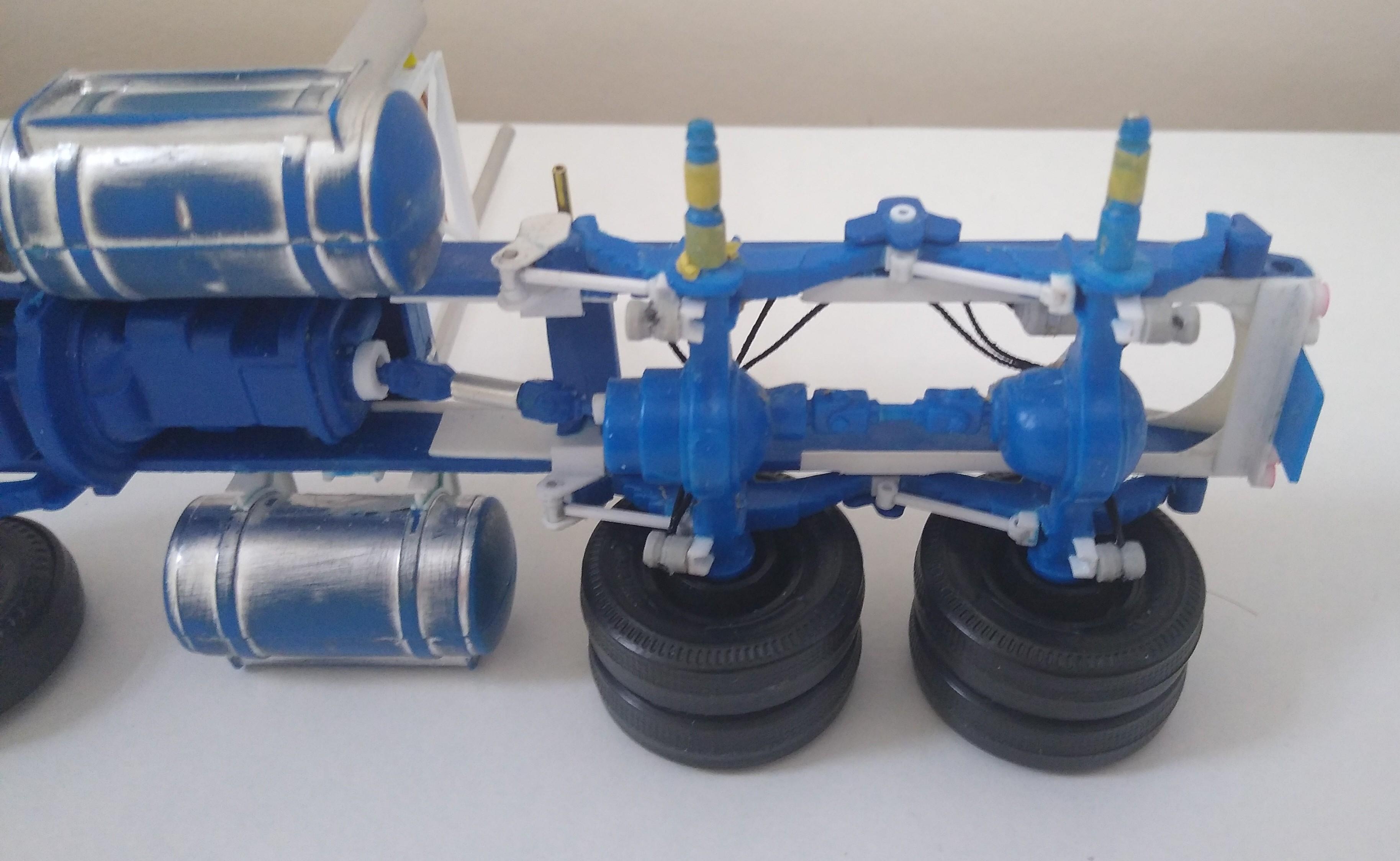

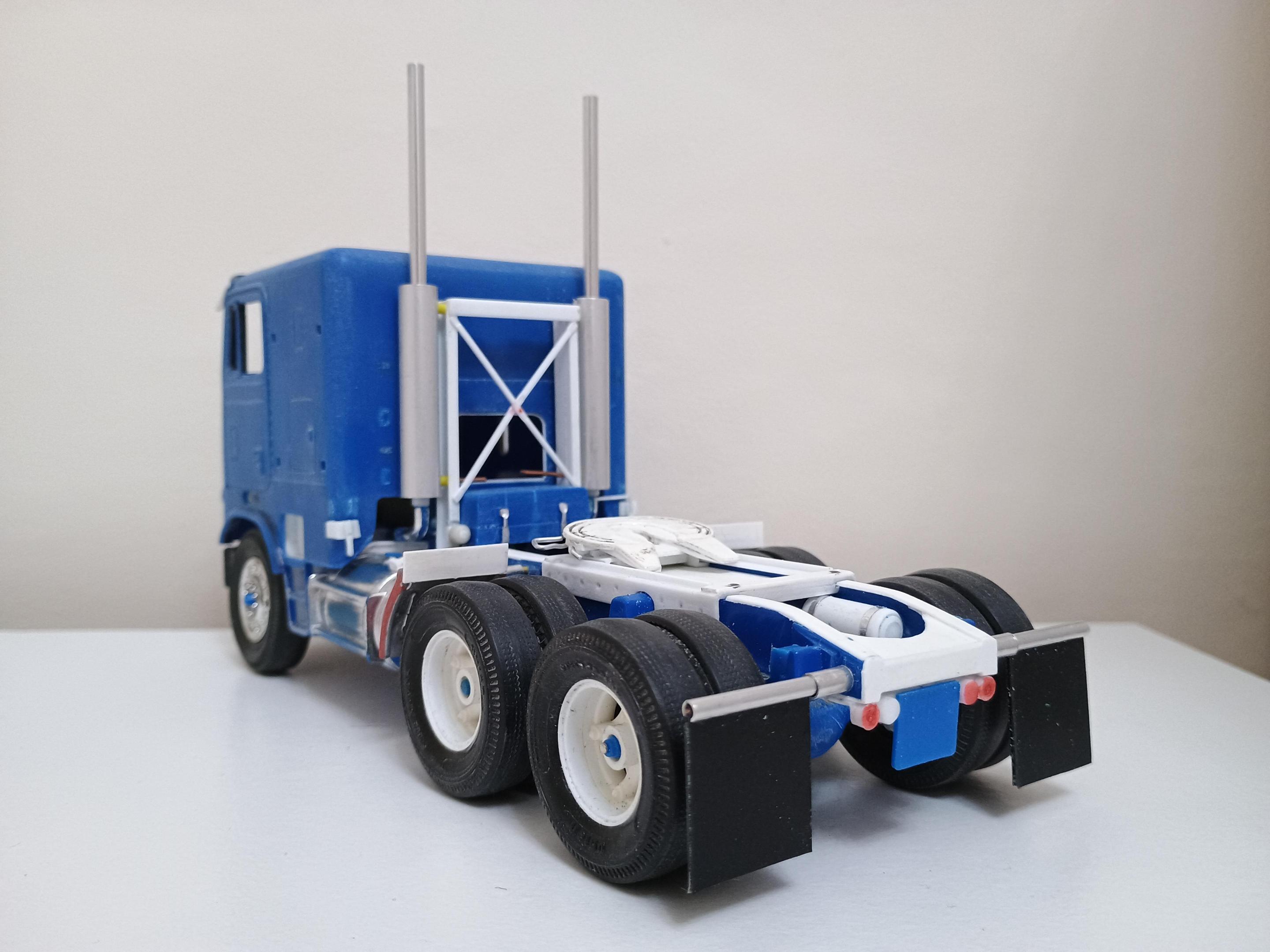

Rockford Posted August 27, 2024 Author Posted August 27, 2024 Turned some brake chambers from sprue. Piped them up. Made a cab tilt pump out of sprue, square rod and a piece of aluminium wire (arrowed). Added securing straps to the lid of the battery box. Realised that I'd made a mess of the radius arms on the Reyco suspension. The front brackets have a dog leg in them to bring the front arm bushing out and down. I knew that and still made the original brackets wrong, modelling them on the centre bracket. Looks righterererer. 3

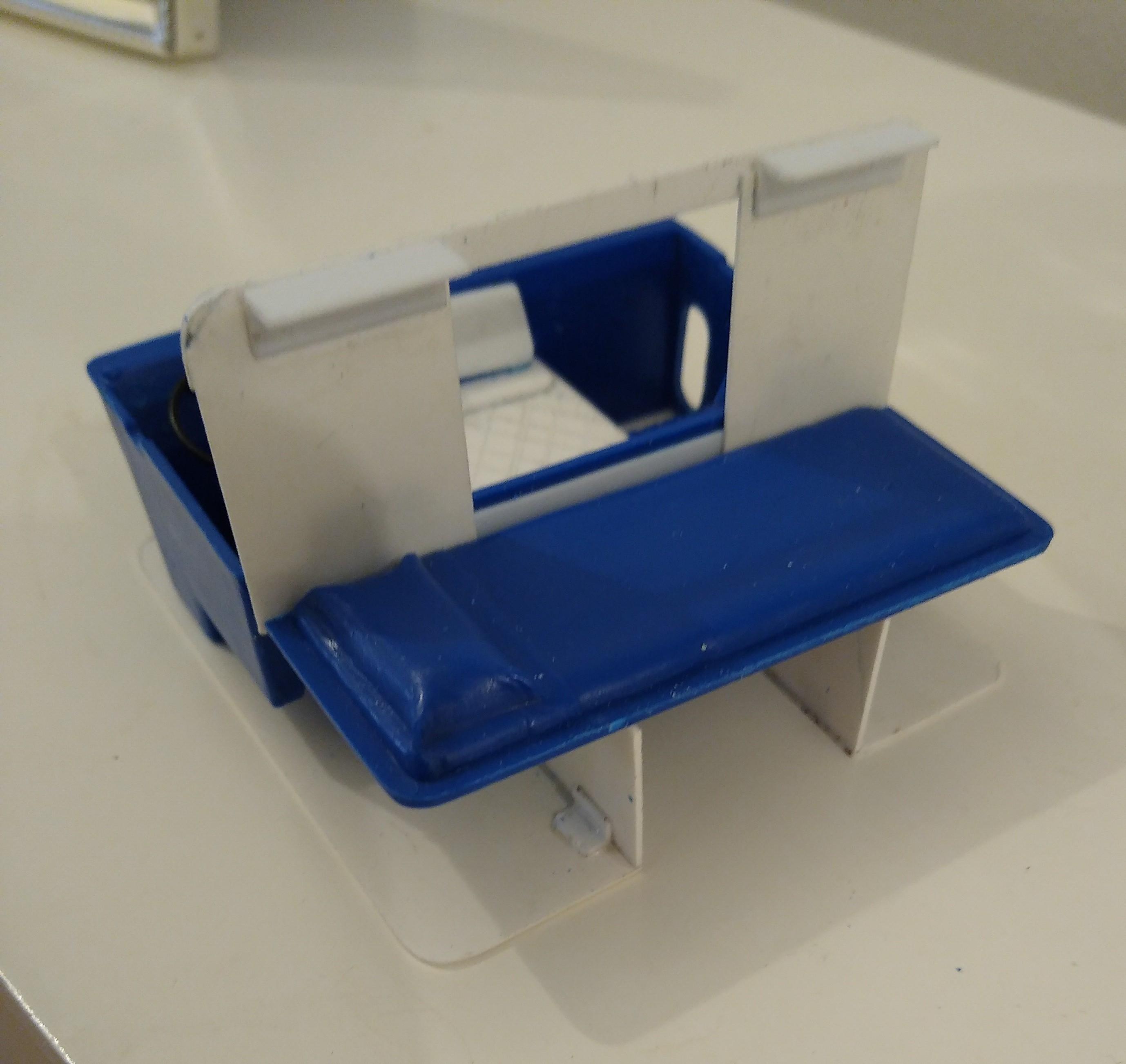

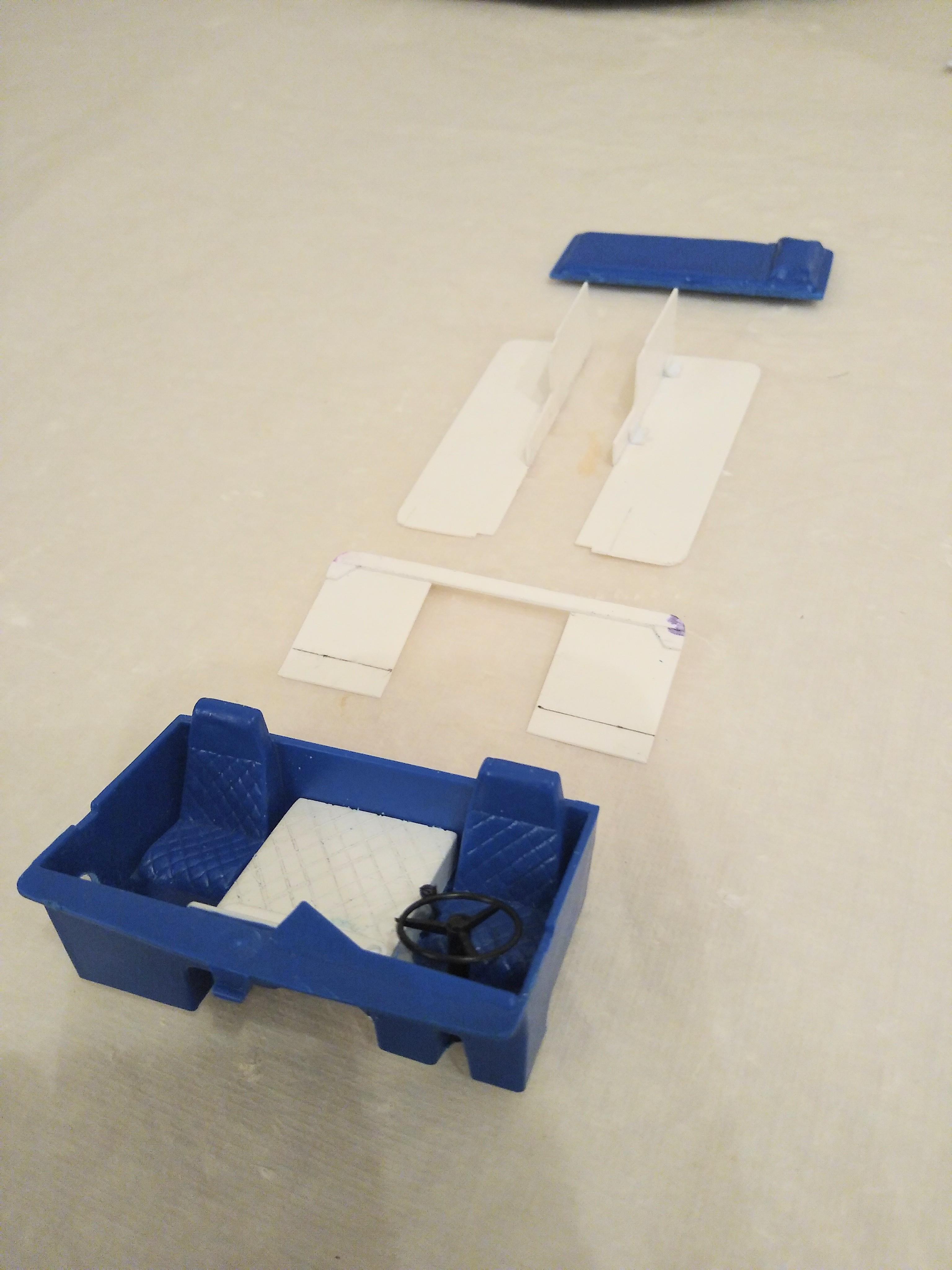

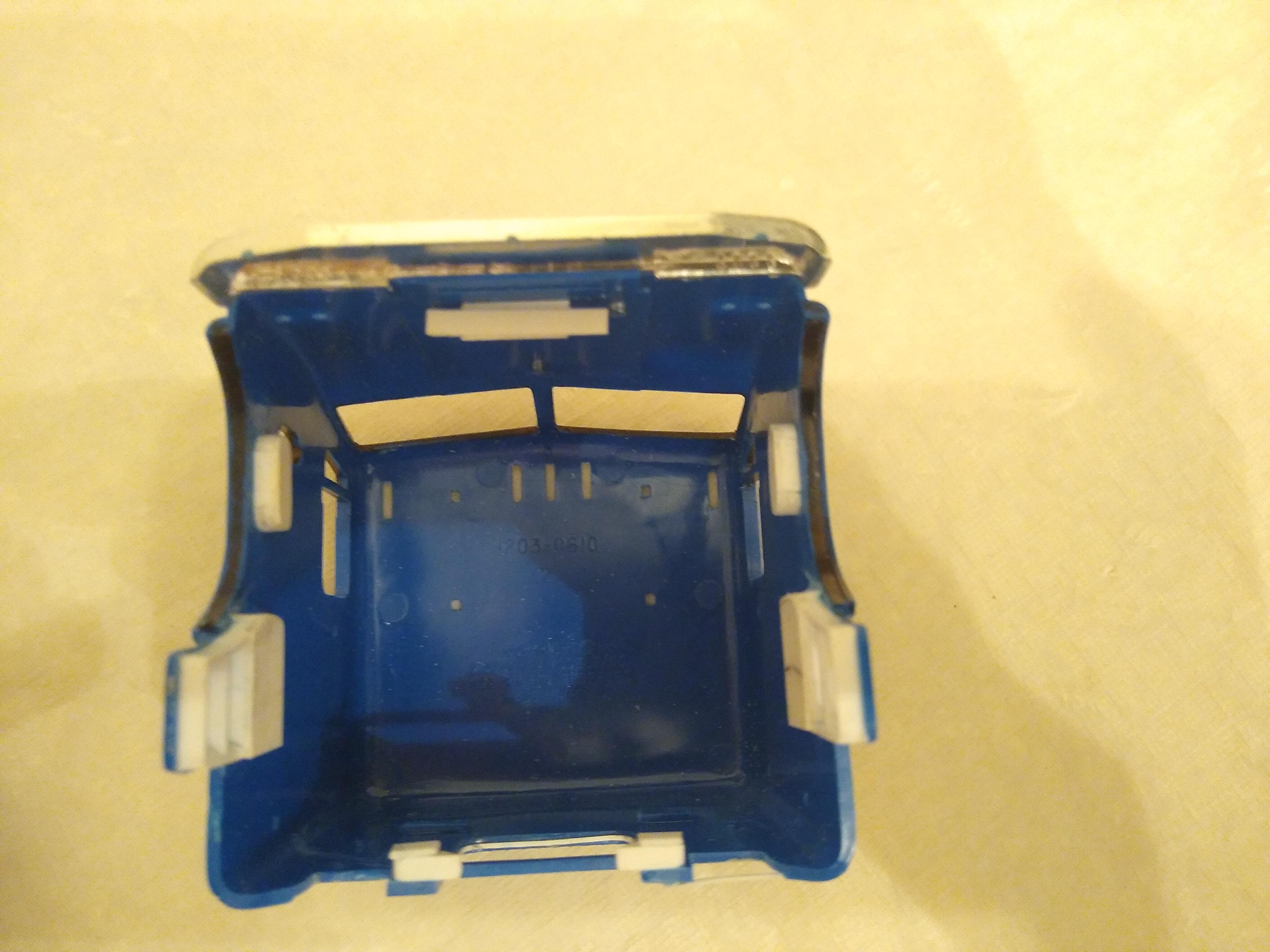

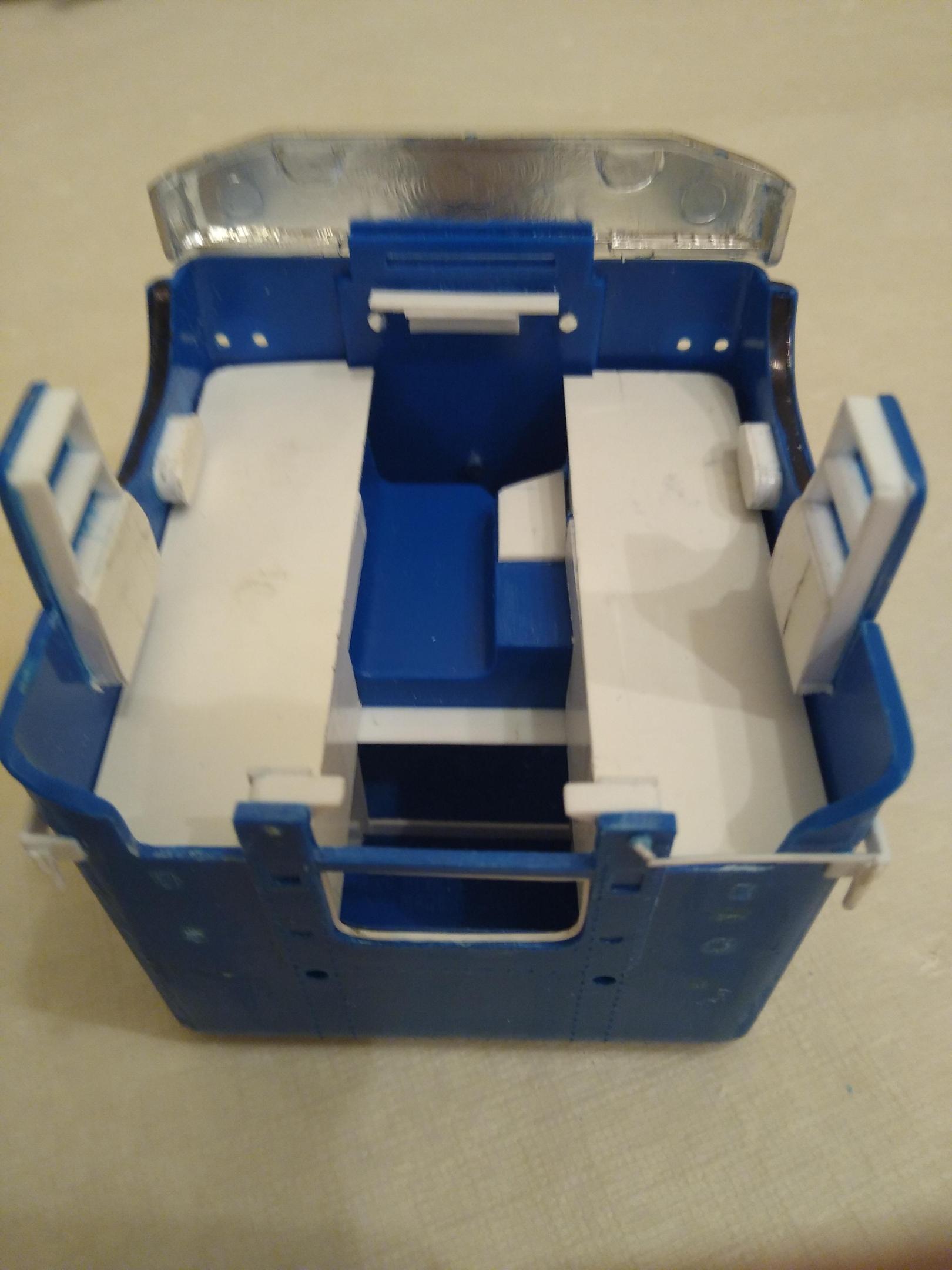

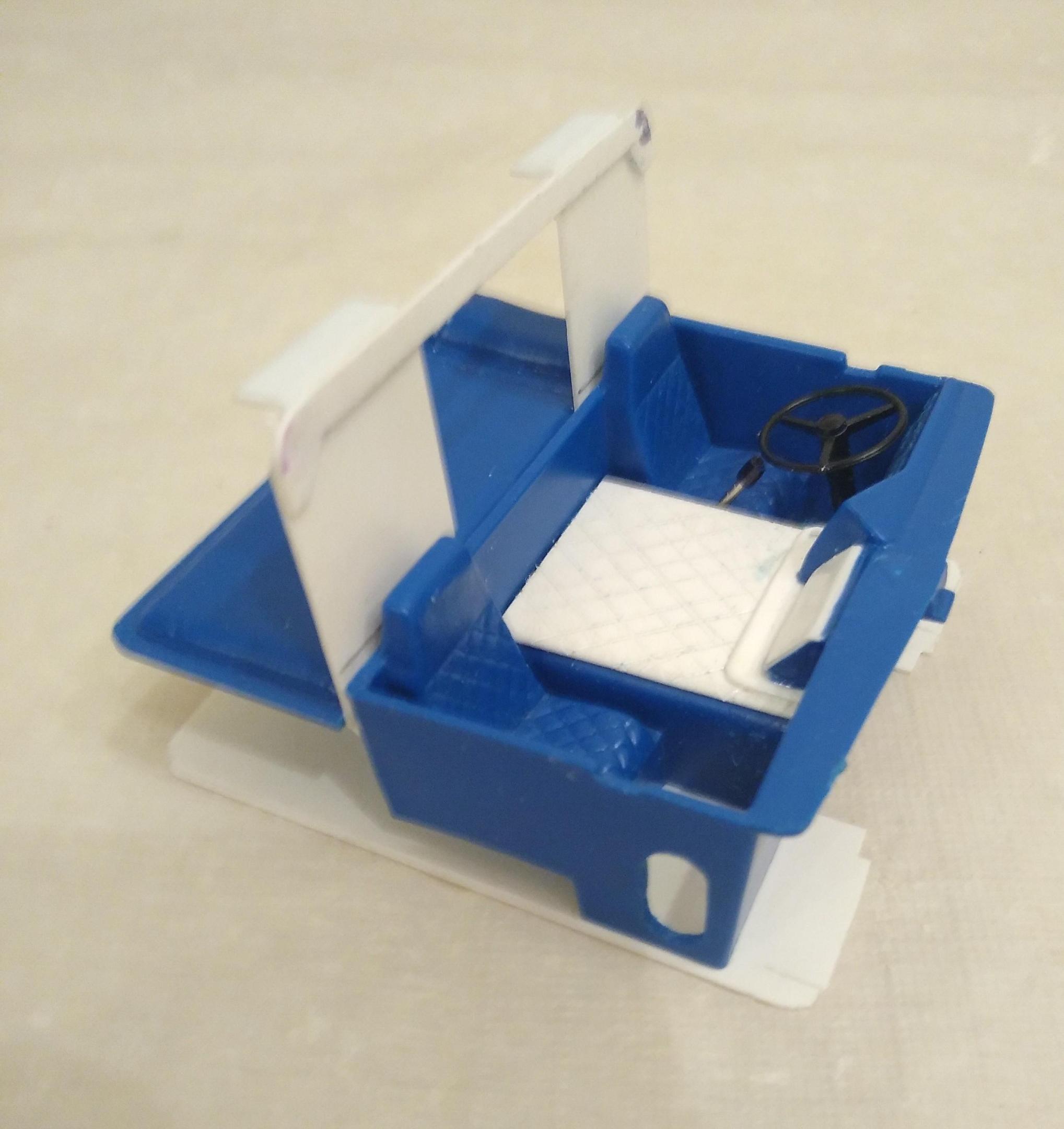

Rockford Posted August 31, 2024 Author Posted August 31, 2024 Turned my attention to the interior. Because I added the steps in full depth I can't get the interior back in as one piece, so I cut the bed off which allows me to get the seats and the doghouse in. Then I built a pair of curtains and a roof crossmember, also a rudimentary cab floor. Hopefully I can fit the interior tub, secure it with the curtain assembly, then add the bed before fitting the floor pieces. Usually these kit interiors are simple but dimensionally ok but this is utter garbage! Doghouse is half the size it needs to be, half of the dashboard is missing. I fitted a new doghouse (for a bigger dog), scored a quick diamond pattern on it. Added a glovebox on the dashboard. Made a shift lever from a big paperclip. Used insulation from copper wire for a gearknob. Cut out the sight window in the passenger door. 2

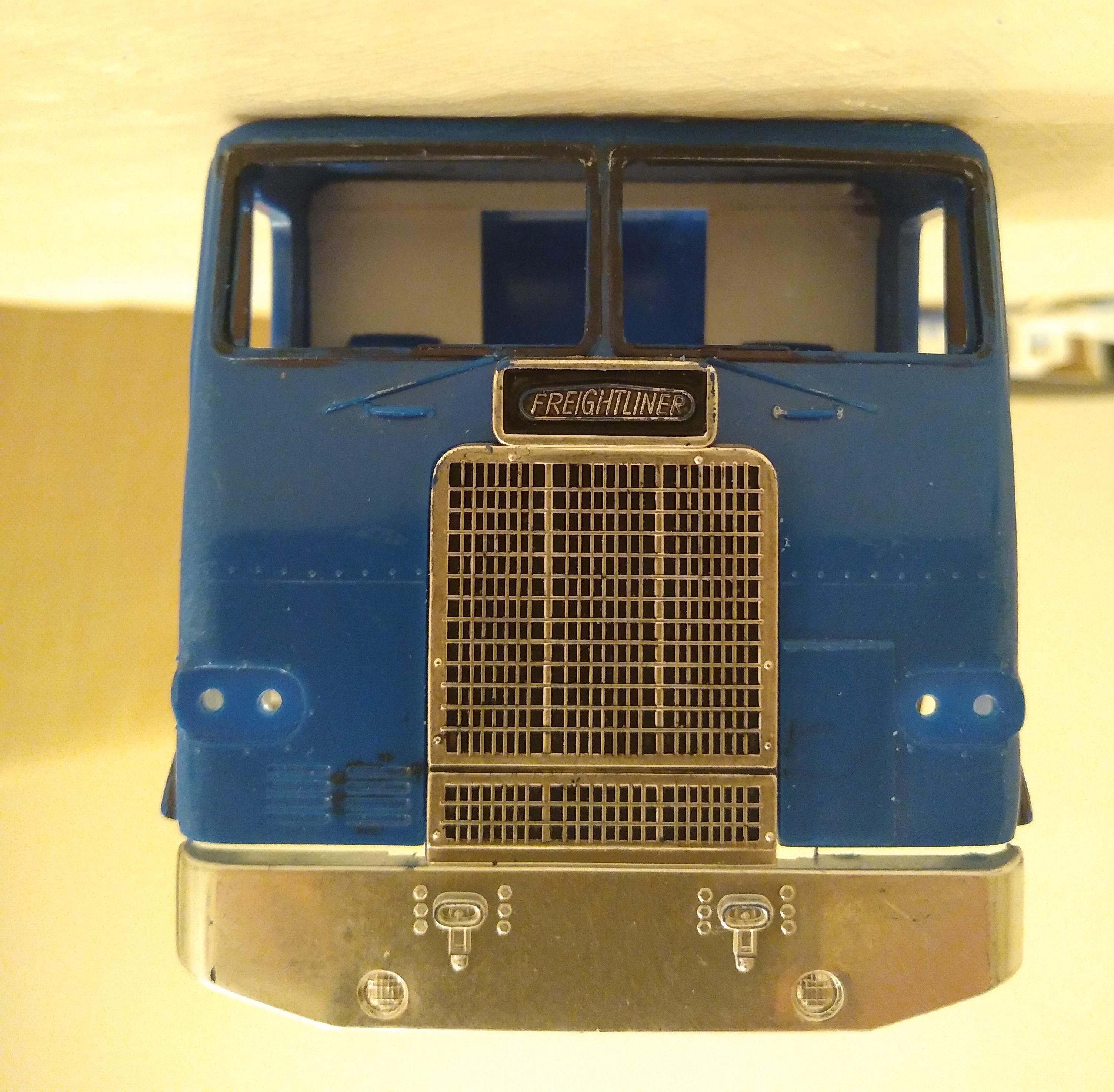

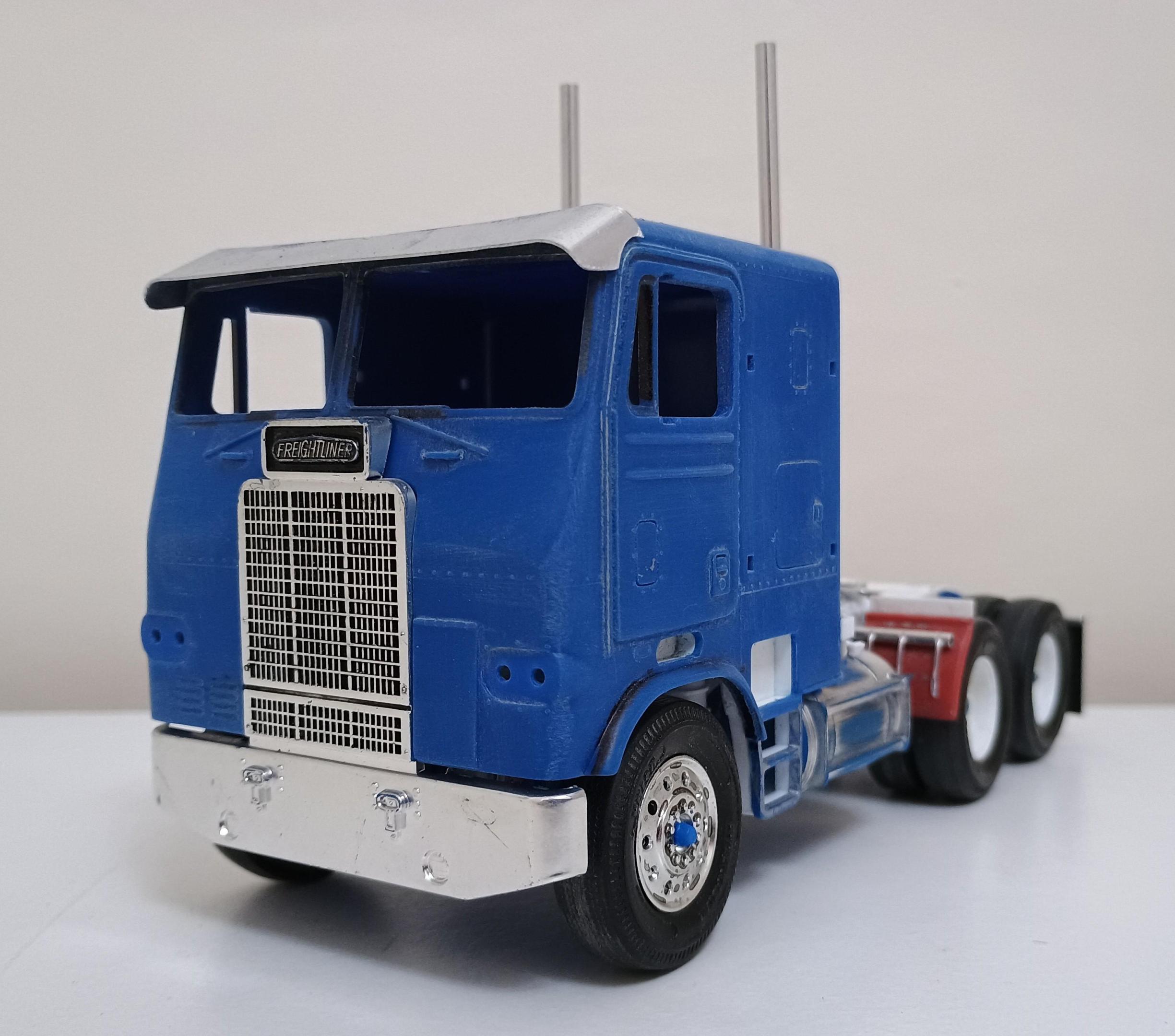

Rockford Posted October 12, 2024 Author Posted October 12, 2024 Right, I've got this to the point of paint, so I'll have to firstly, work out what colour I'm going to paint it and then wait for suitable conditions. At the moment it's very damp and cold here in Blighty. This kit is quite poor in rendering the Freightliner cab, but with the mods I've done it is much better, still not right but definitely looking more like a Freightliner. I reversed the cab lock handles because every truck I've seen has them pointing down when locked and I'm beginning to think that the only one that has them pointing up is the AMT kit and that's where I must have seen it. The linkages are very fragile so I'll attach them immediately before I paint. Also made a visor out of ali sheet. Roughed up the tyres removed the mould separation line in the tread. Started painting the interior with a Humbrol Matt colour and it is awful stuff. Stirred it for ages and it's still watery and refusing to dry. I'll just have to be patient and recoat a few times. If the weather stays garbage I'll have to think of something else to start. ? 3

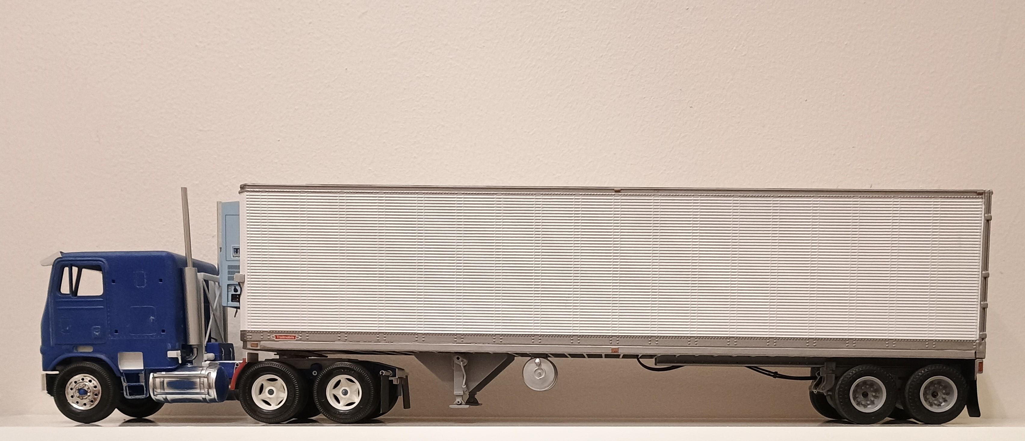

Rockford Posted October 12, 2024 Author Posted October 12, 2024 I think it looks the business with the AMT Trailmobile reefer behind it. 2
Biggu Posted October 12, 2024 Posted October 12, 2024 9 minutes ago, Rockford said: I think it looks the business with the AMT Trailmobile reefer behind it. I do too … 1

Biggu Posted October 16, 2024 Posted October 16, 2024 Something I notice here is the mix of rims. Chrome Budds on the steering axle and Daytons on the drivers, back in the day (locally) that showed a real work truck and a LOT of highway tractors had that exact set up. Weight reducing and looked cool. The Daytons were a good strong rim although one had to be careful on installing the rims to the hub. Make sure they were clean and straight when the rim was slid onto the hub so that when the wedges were installed the rim ran true. There was a trick to have that happen. Used to put a small piece of wood parallel to the tire and spin the wheel as one tightened each wedge gently in an ‘X’ pattern so that you cud see if the tire and rim was tracking true and straight. Sorry for the deviation , Steve. I love this project and am eagerly waiting for the next update. You are doing a great job transforming this into a great looking truck . Jeff

Rockford Posted October 17, 2024 Author Posted October 17, 2024 (edited) 16 hours ago, Biggu said: Something I notice here is the mix of rims. Chrome Budds on the steering axle and Daytons on the drivers, back in the day (locally) that showed a real work truck and a LOT of highway tractors had that exact set up. Weight reducing and looked cool. The Daytons were a good strong rim although one had to be careful on installing the rims to the hub. Make sure they were clean and straight when the rim was slid onto the hub so that when the wedges were installed the rim ran true. There was a trick to have that happen. Used to put a small piece of wood parallel to the tire and spin the wheel as one tightened each wedge gently in an ‘X’ pattern so that you cud see if the tire and rim was tracking true and straight. Sorry for the deviation , Steve. I love this project and am eagerly waiting for the next update. You are doing a great job transforming this into a great looking truck . Jeff Thanks Jeff. Thanks for the memories of the Daytons. I don't think we had actual Daytons but there were some spoked wheel setups over here in UK but only for really heavy work, they were more common on the continent though. I can well imagine them being tricky to work with. When I started in the workshop we still had an awful lot of cast iron split-ring rims around and LH and RH taper seat wheel nuts. Air guns were rare and we would often find ourselves with an 'L' bar supported by an axle stand with a 6ft tube slid over it. We'd then have to climb onto the tube and walk up it to the end where our weight would be most effective and start gently bouncing on it until the nut cracked off. I still feel the shockwaves going through my frame as it broke free, ankles right up to skull. One thing I'll never understand is the Budd system for tandem wheels where you have one wheelstud sleeved inside another, absolutely nonsensical. Edited October 17, 2024 by Rockford Text editing 1

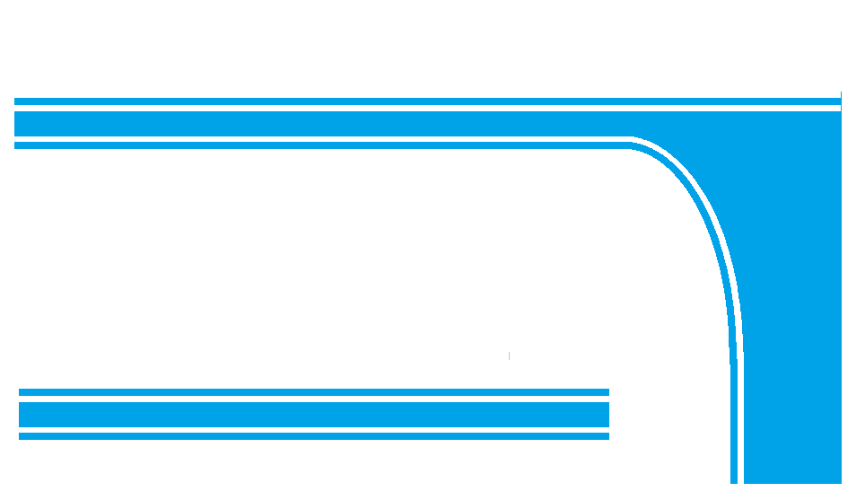

Rockford Posted October 17, 2024 Author Posted October 17, 2024 (edited) As the weather was just so awful yesterday I found myself confined to barracks, so I busied myself drawing a few stripe layouts in the hope of gaining some inspiration for colours. Though I've used blue in all cases I can change that with one click. They're all drawn on the original Microsoft Paint. The simple straight runs are for the rear wall of the cab so that left meets right (hopefully). The angles and corners look a little ropey at this scale but when reduced to 1/32 sizes your eye can't see the pixelation of the curves and angles. Edited October 17, 2024 by Rockford Text corrected 2

Chariots of Fire Posted October 17, 2024 Posted October 17, 2024 Nice building on a 1/32 scale kit! I see you changed the differentials a bit. Any reason for that? Perhaps I missed it. 1
Rockford Posted October 17, 2024 Author Posted October 17, 2024 3 hours ago, Chariots of Fire said: Nice building on a 1/32 scale kit! I see you changed the differentials a bit. Any reason for that? Perhaps I missed it. I think I'm just incapable of doing the same thing in the same way twice! 2
