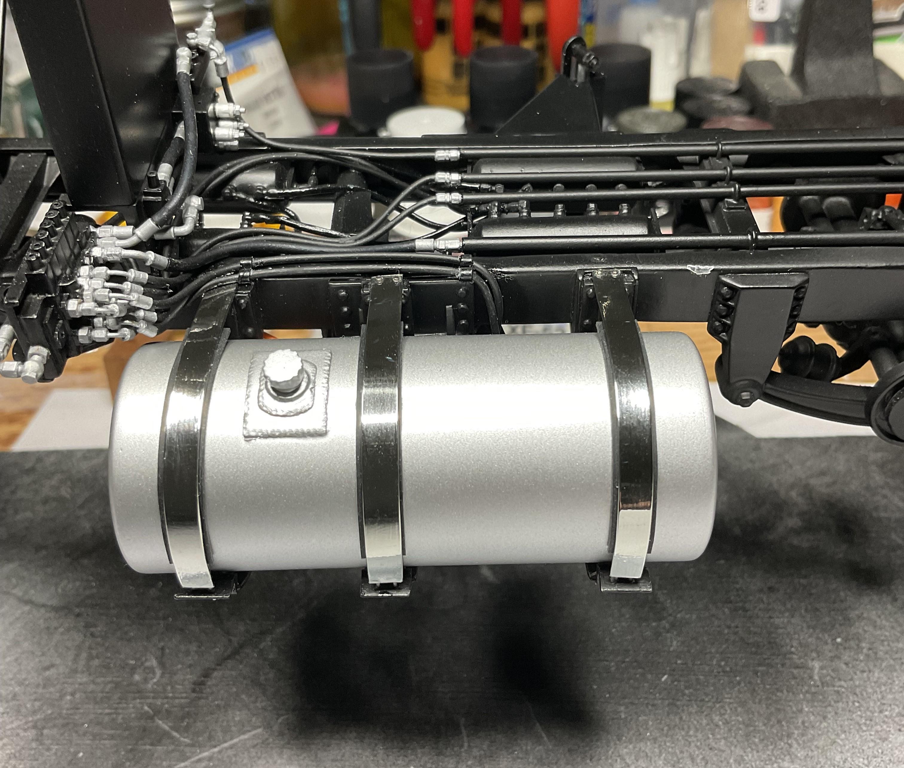

Bren Posted December 7, 2024 Posted December 7, 2024 On 12/5/2024 at 3:20 PM, BK9300 said: Thanks Guys - appreciate it! Good day today - and a big step towards finishing the fuel tank. Just need to make a semblance of a sending unit and it will be done. Pic of the real truck - this was the goal Very happy with results. . .quite anxious process using slow setting CA glue and not have it leak out the sides of the straps Placed a little blob of epoxy on the bolts, on inside of angle iron to add to some strength to strap. Painted them aluminum to represent the nuts A few hours left today - might get a start on the sending unit! Always appreciate your comments - take care! Wow! I (and everyone else it seems) am running out of superlatives to describe this build Brian. Those tanks/straps are AMAZING! It is an overused cliche - but you could scale this thing up and drive it off the lot. I’ve never seen such a stunning replica. All I can say is keep it up! We’re watching in amazement. 1

BK9300 Posted December 11, 2024 Author Posted December 11, 2024 More detail work on the truck accomplished today - fabricated the components for the fuel tank sending unit and vent line. Also got a start on the work needed to help finish the hydraulic lines at the front of the truck. Made hose fittings for the hydraulic pump that mounts on the plow lift group's cross member. Also heading out to the shed to give the pump some paint. Slow progress, but some progress is always a good thing! Parts and pieces for the sending unit and vent line Wiring and 'split' sheath for the sending unit Sending unit tank fitting Vent line - will need to shorten it a bit as it is supposed to end part way down the middle tank hanger Hydraulic pump I made in Sketchup and printed by Bren; drilled and pinned resin fittings from Top Studio Will need to drill cross member for bolts and for mini drive shaft to crankshaft pulley I need to make something like this before I can mount the pump and plow lift group onto the truck frame (this isn't specifically for attaching to a DD 60 series crankshaft pulley, but I somehow deleted the picture I did have of one from a mixer) As often happens, by the time the shed warms up, weather changes and painting not a good idea. Maybe tomorrow - take care! 4

BK9300 Posted December 13, 2024 Author Posted December 13, 2024 (edited) Big one off my list - sending unit and vent line are in - fuel tank is finished, finally! Few quick pics and out to the paint shed momentarily, to brighten up that hydraulic pump! That 'blue' vent line is actually clear tubing- maybe the fluorescent light from the desk lamp doing that. 'Split wire' loom from sending unit heading down into frame rail Split wire loom routed into frame rail (not going to pretend - the loom just ends 'out of sight') and vent line terminates by underbody plow lift cylinder. Put a wear protector sleeve on fuel lines - thanks for the reminder, Jeff!. Driveshaft paint took a bit of 'damage' during loom routing (the mechanic did his best to avoid any damage!) - will probably leave the aluminum tubing peeking through, as is. . . Painted the two hydraulic fittings at the trans cooler but I've decided to leave hooking up the cooler lines until I get the front plow lift group mounted - don't want to make a mistake on not having the hoses clear the lift group. Off to the shed - thanks for having a look! Edited December 13, 2024 by BK9300 1
