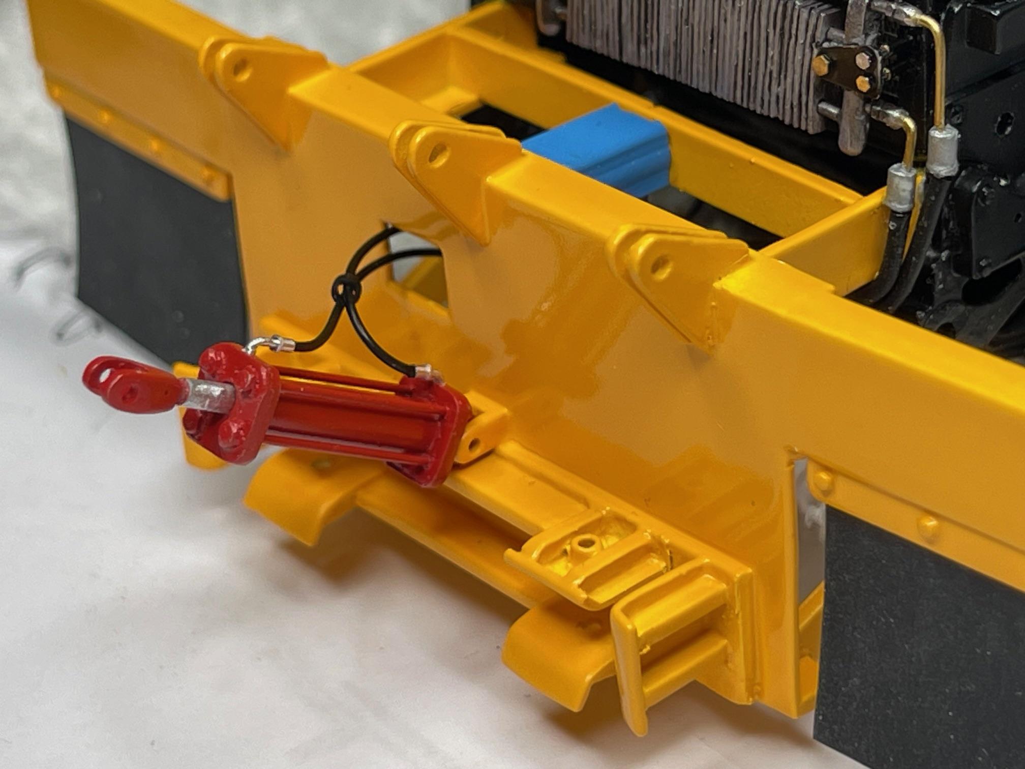

Still one more thing to do before the truck gets up on its tires and that is to hook up the front plow lift cylinder.  Managed to get the fittings and lines attached, and had to make a change there, too.  Didn't mount the cylinder in place yet, but did get a couple pics of it in place for time being.
Had made the lift cylinder some time ago, but needed to add fittings for hydraulic hoses - fittings are from R & B Motion
Hoses attached -
A couple mock up pics of lift cylinder in place, temporarily (need to change the oversize band holding hoses together)
Should be more tomorrow - take care!
That cylinder looks perfect Brian. Well done.

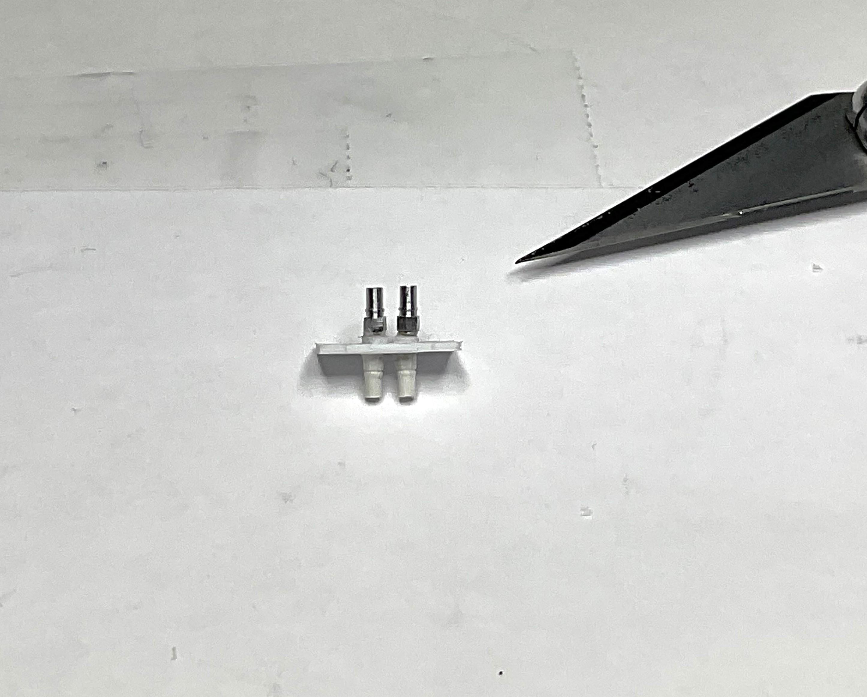

I mentioned a few posts back that I had/needed to make a change with the hydraulic lines to the front plow lift cylinder.  I messed up a when originally laying out and running all the lines from the valve manifold - the lines running to the front plow were too big for scale and just didn't look ok coming through the front bumper.  The lines I have attached to the cylinder now are a better look for scale, but now I have two different size lines to match up.  I learned from Craig, a Mechanical Supervisor at YRB, that the company now uses bulkhead fittings to get through the bumper assembly, and Jeff was able to find a confirming picture of this as well.  My 'story' is that a new practice was incorporated into an older front bumper assembly that was already in inventory when the truck was built!
Last couple pics of 2024! -  Sample bulkhead fitting I need to fashion:
started on the bulkhead fitting  - the scribed lines indicate the size of part of the existing bumper opening and the rest of the material will be a flange to CA glue the fitting plate to the back of the bumper

Bit more done today - finished up the bulkhead fitting and, while waiting for some ordered fasteners to assemble the front plow lift, I worked on the front plow itself.  I needed to add a length of rubber to the top, front edge of the plow - this rubber strip helps direct the snow back down.
Just need to paint the fitting, glue it in place, attach the hoses behind the bumper plate and wait for some fasteners before hooking up the lift cylinder hoses to the front of the fitting
