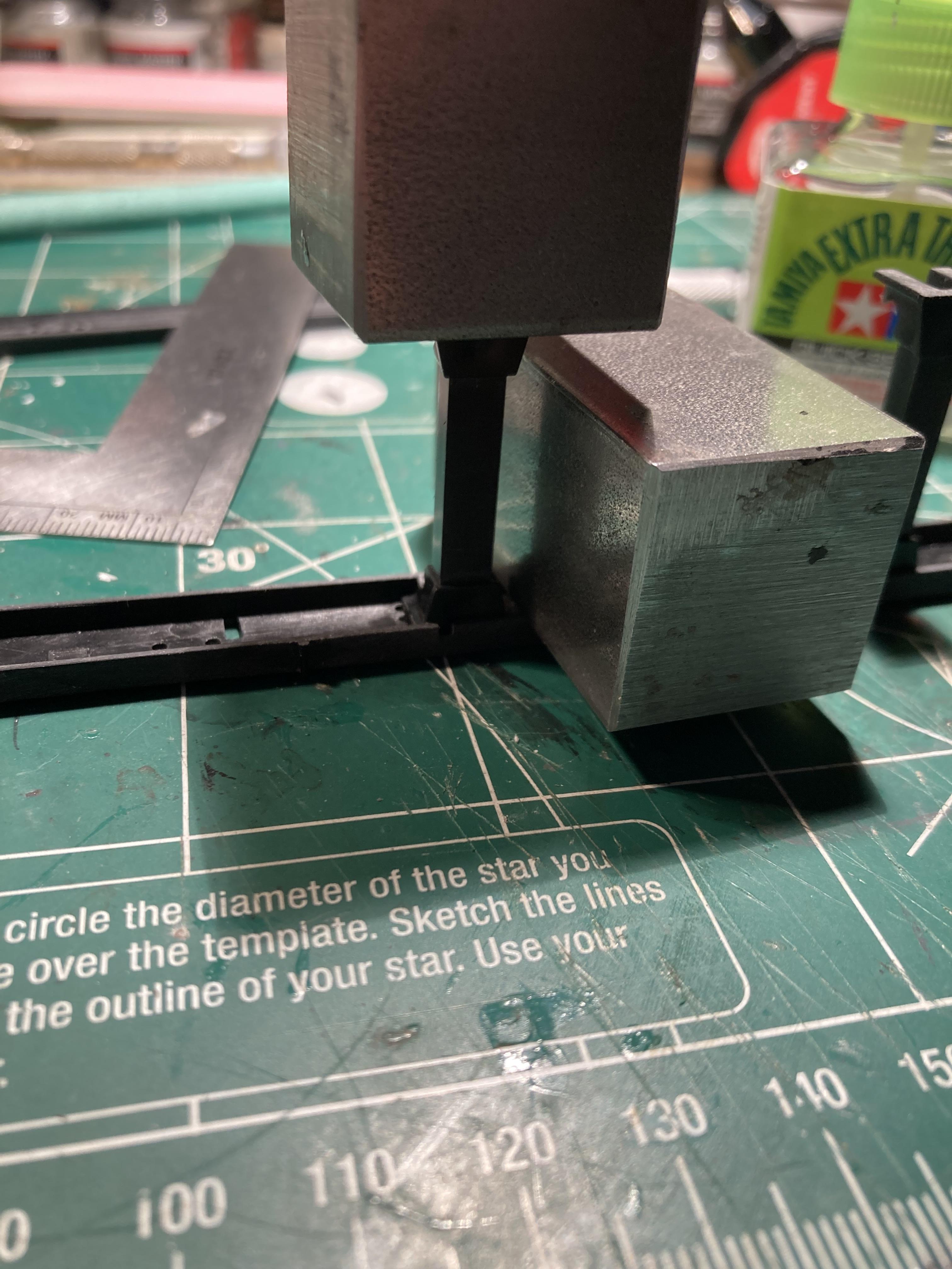

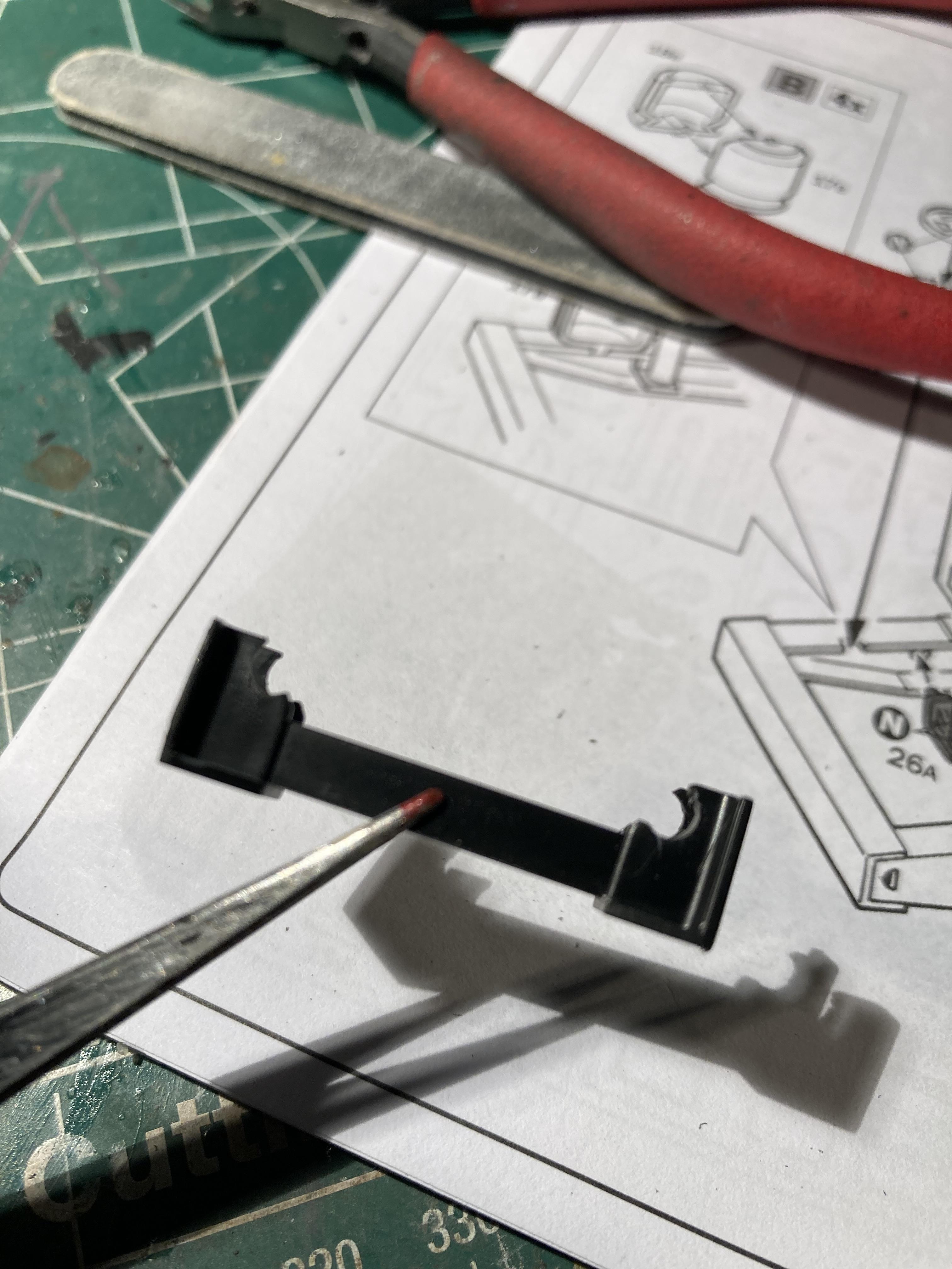

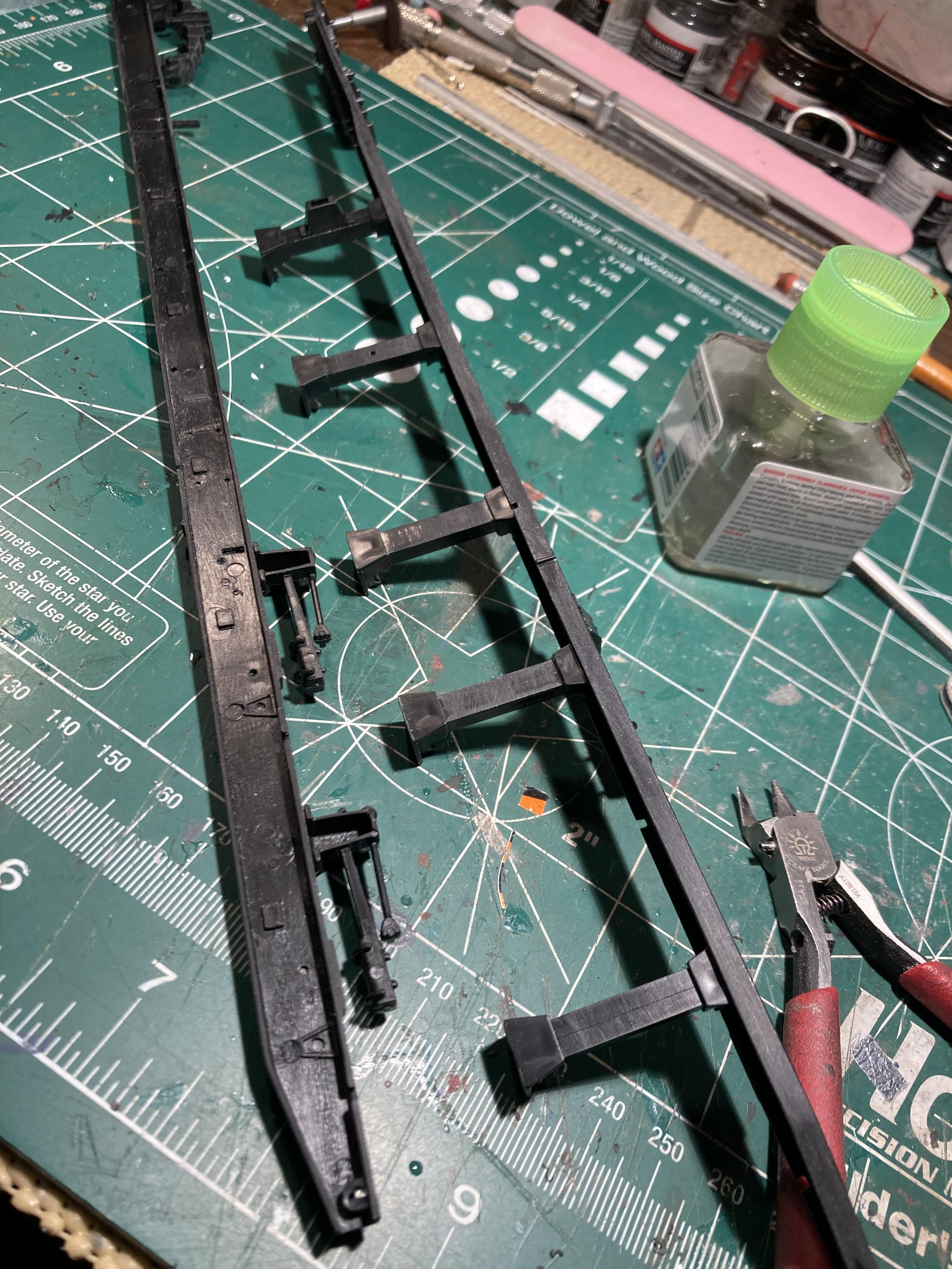

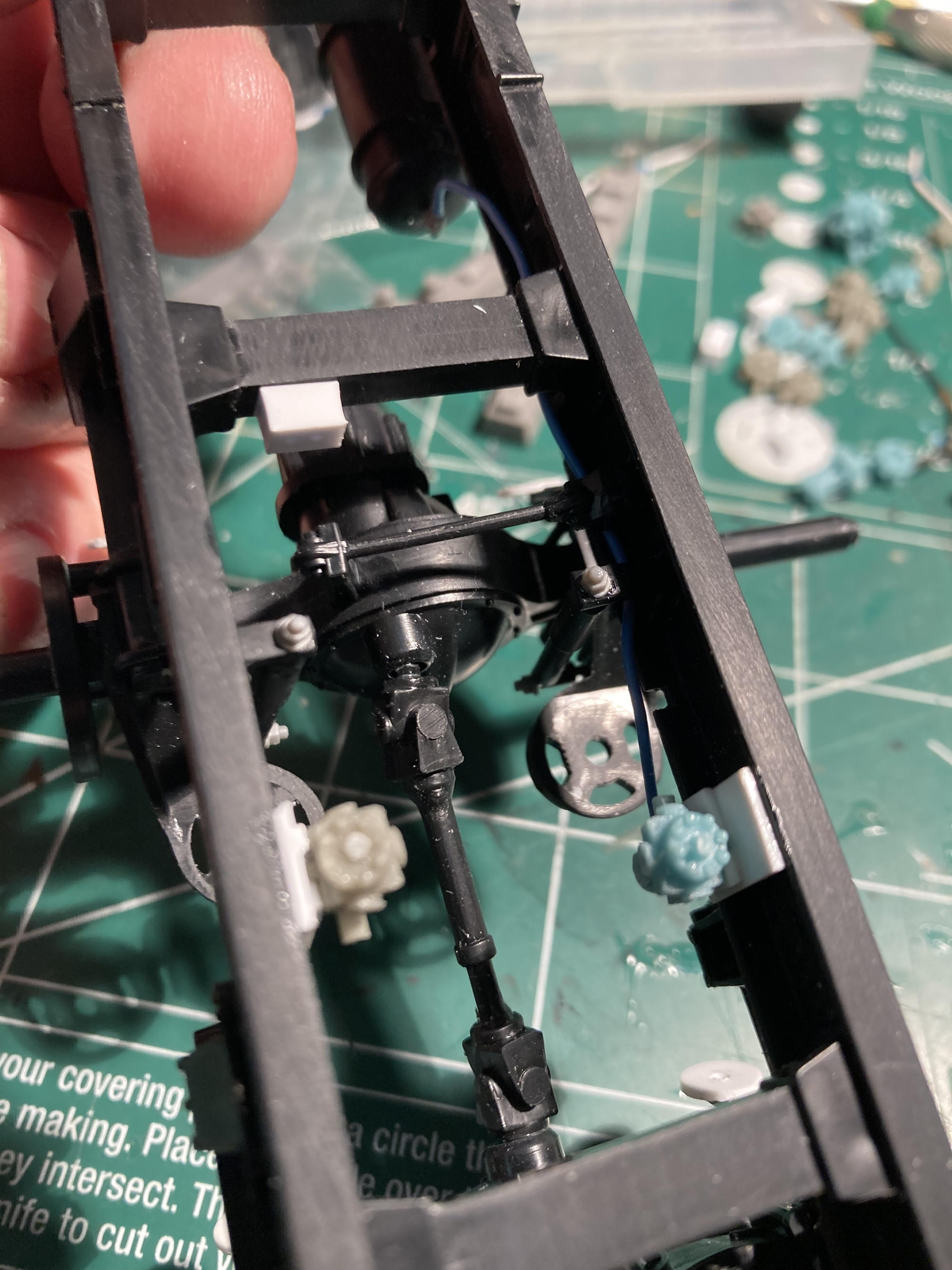

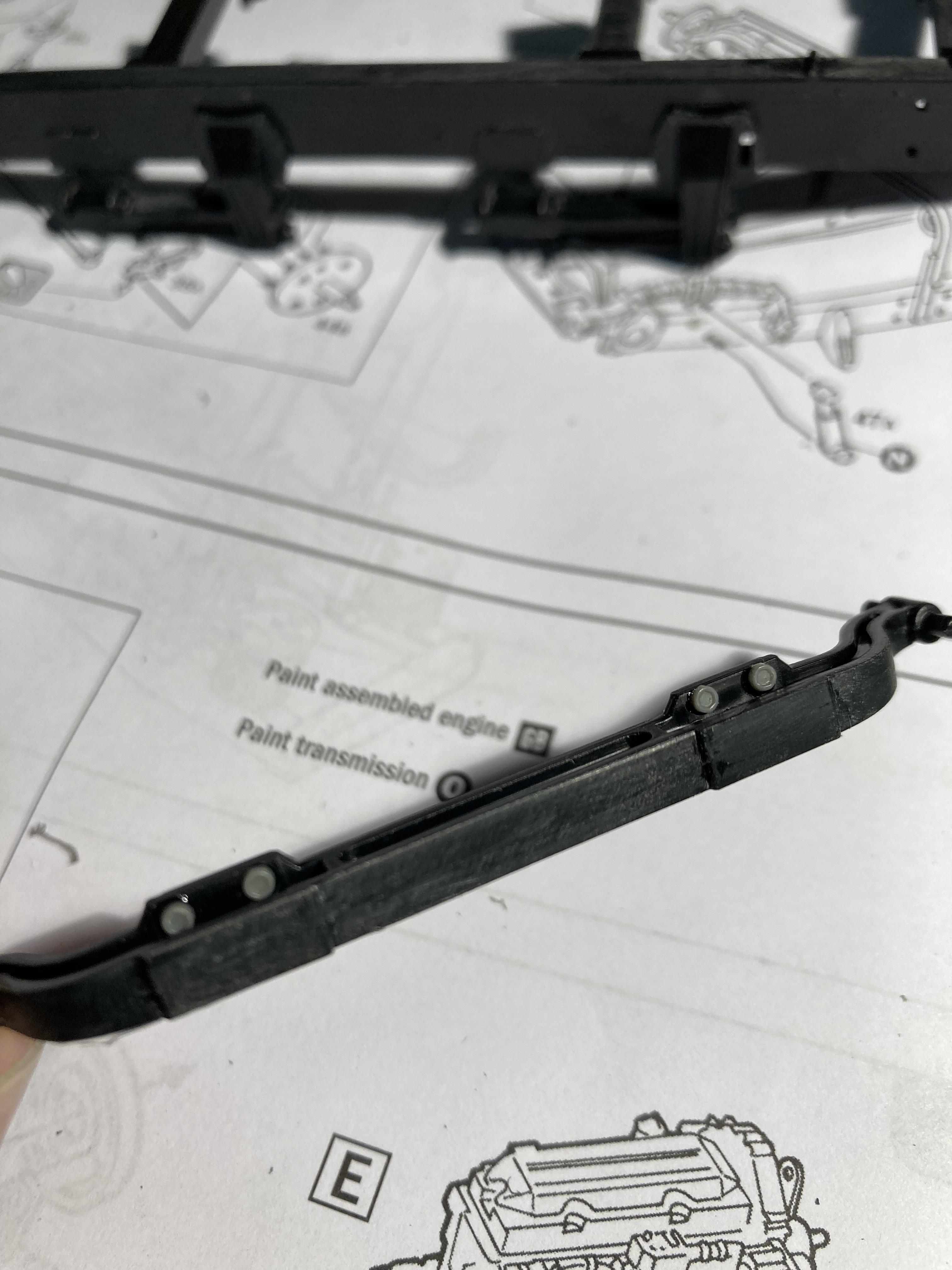

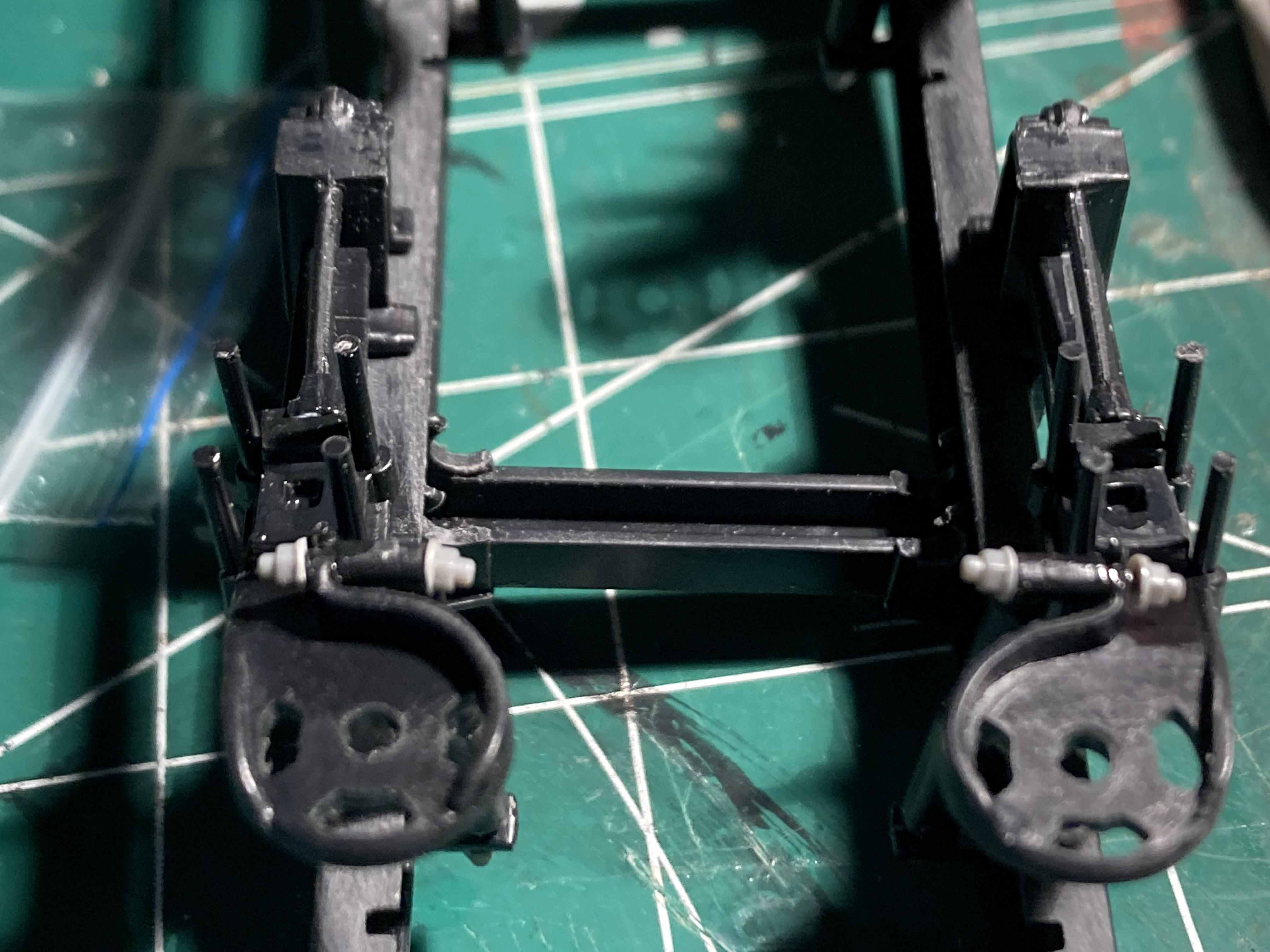

Biggu Posted August 12, 2024 Author Posted August 12, 2024 So with a start I modified the crossmembers a bit to accept air plumbing. Not Peterbilt certified but a little artistic license and nothing earth shattering here really .. 1

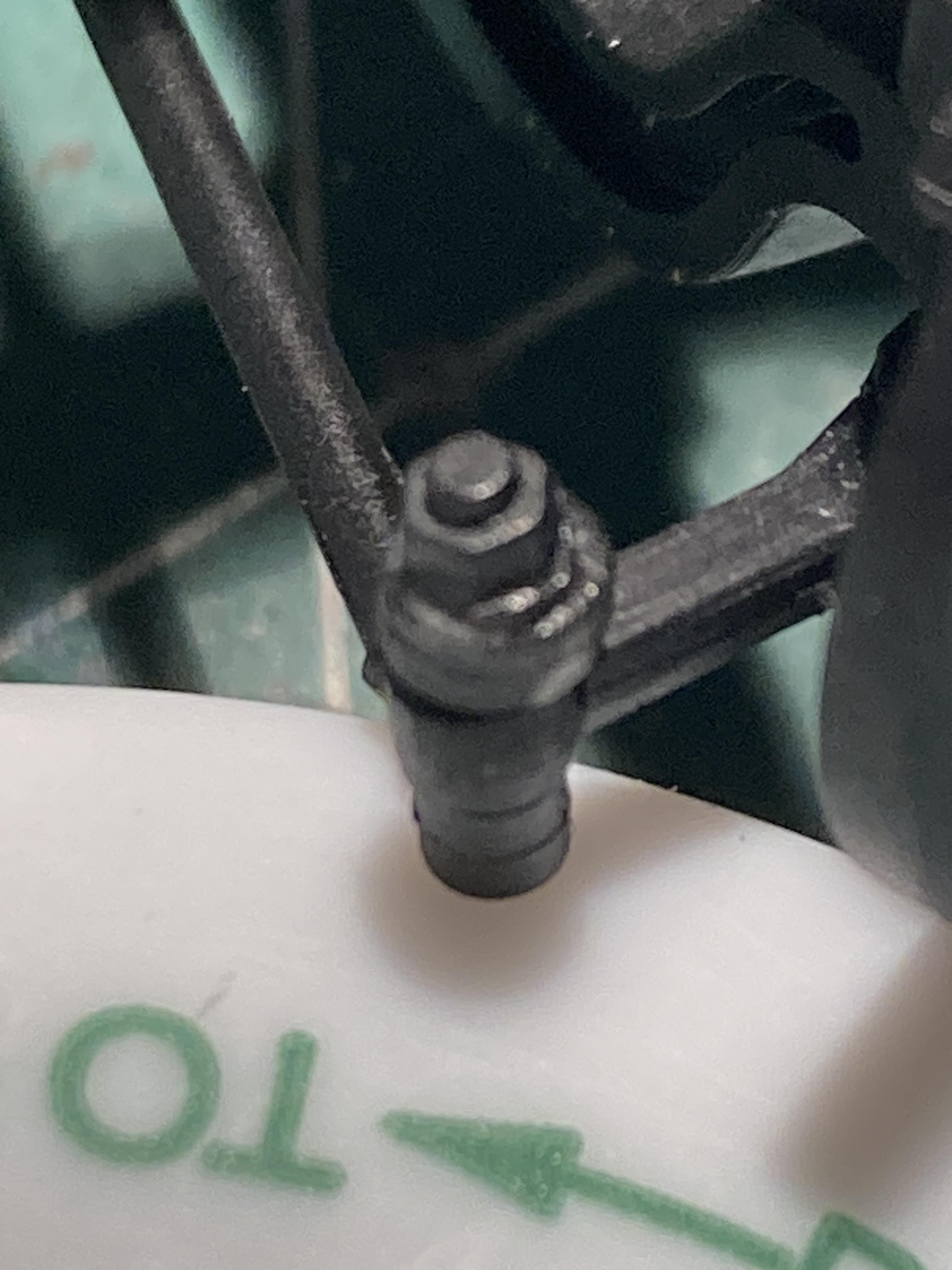

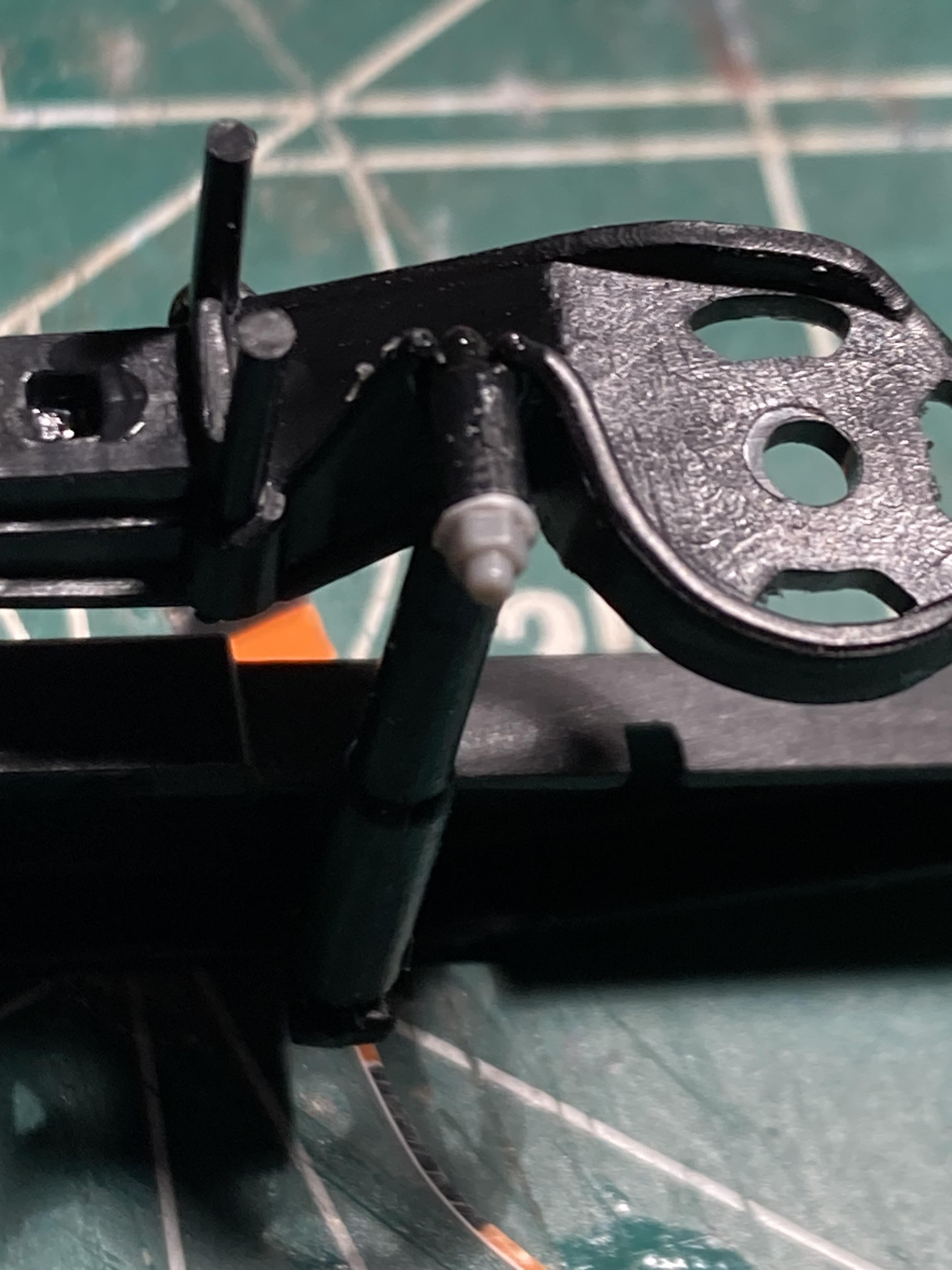

Biggu Posted August 12, 2024 Author Posted August 12, 2024 (edited) The next part I thought could use a little help was to add a little ‘fluff’ to the front axle by adding some bolts for some visual candy and should look ok under a splash of paint Edited August 12, 2024 by Biggu 1
Rockford Posted August 12, 2024 Posted August 12, 2024 Looking forward to seeing what you do with this. Air plumbing will look good and keep you occupied for a bit. Are you doing the full U-bolts on the front axle? 1
Biggu Posted August 12, 2024 Author Posted August 12, 2024 2 minutes ago, Rockford said: Looking forward to seeing what you do with this. Air plumbing will look good and keep you occupied for a bit. Are you doing the full U-bolts on the front axle? No I don’t think I will. As I ‘thought’ the molded kit ones looked ‘ok’ considering where they are located. As a second thought looking at it now that may have been a very good idea. It’s a little late at the moment as I have it all installed. So I would say it may have been an oversight.

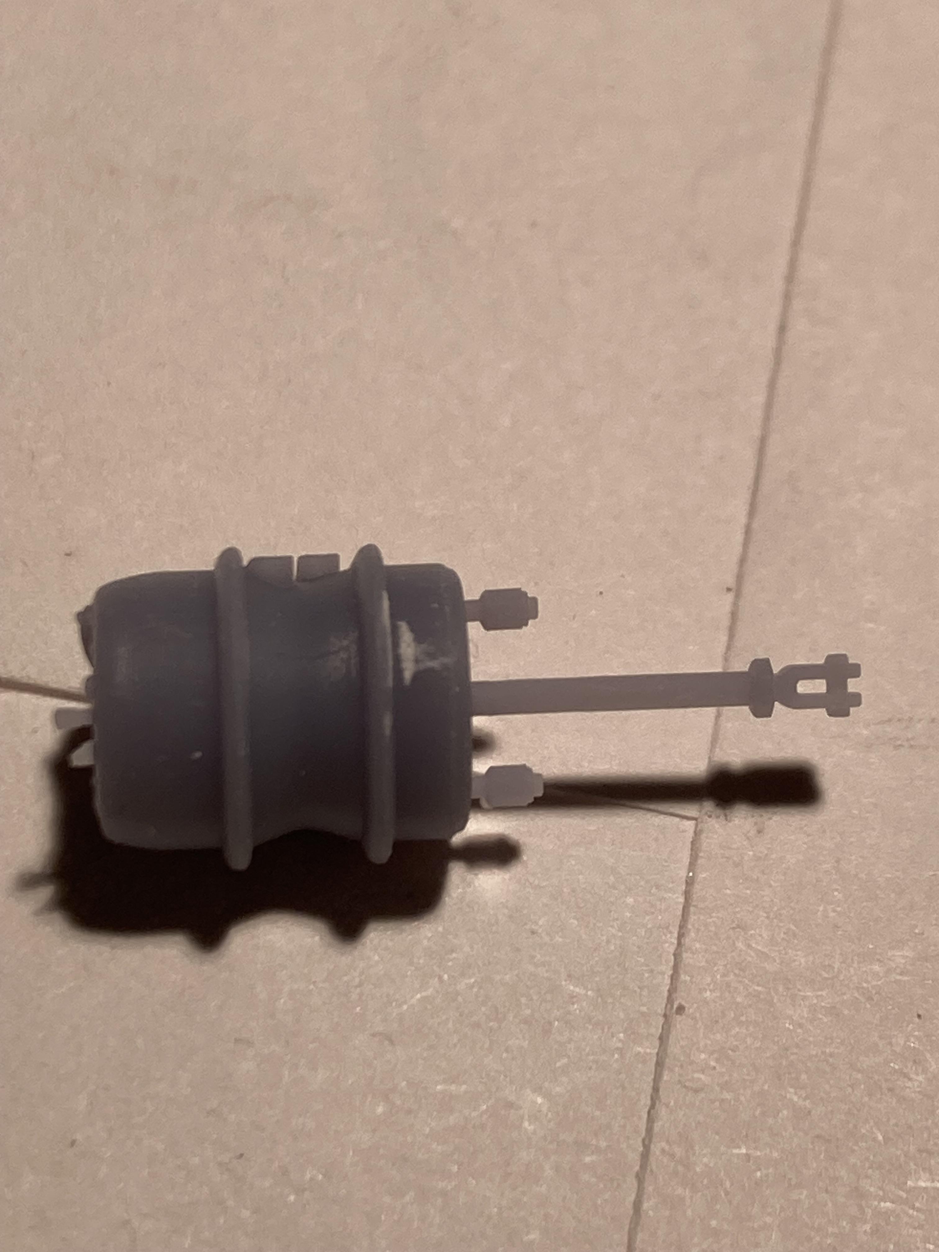

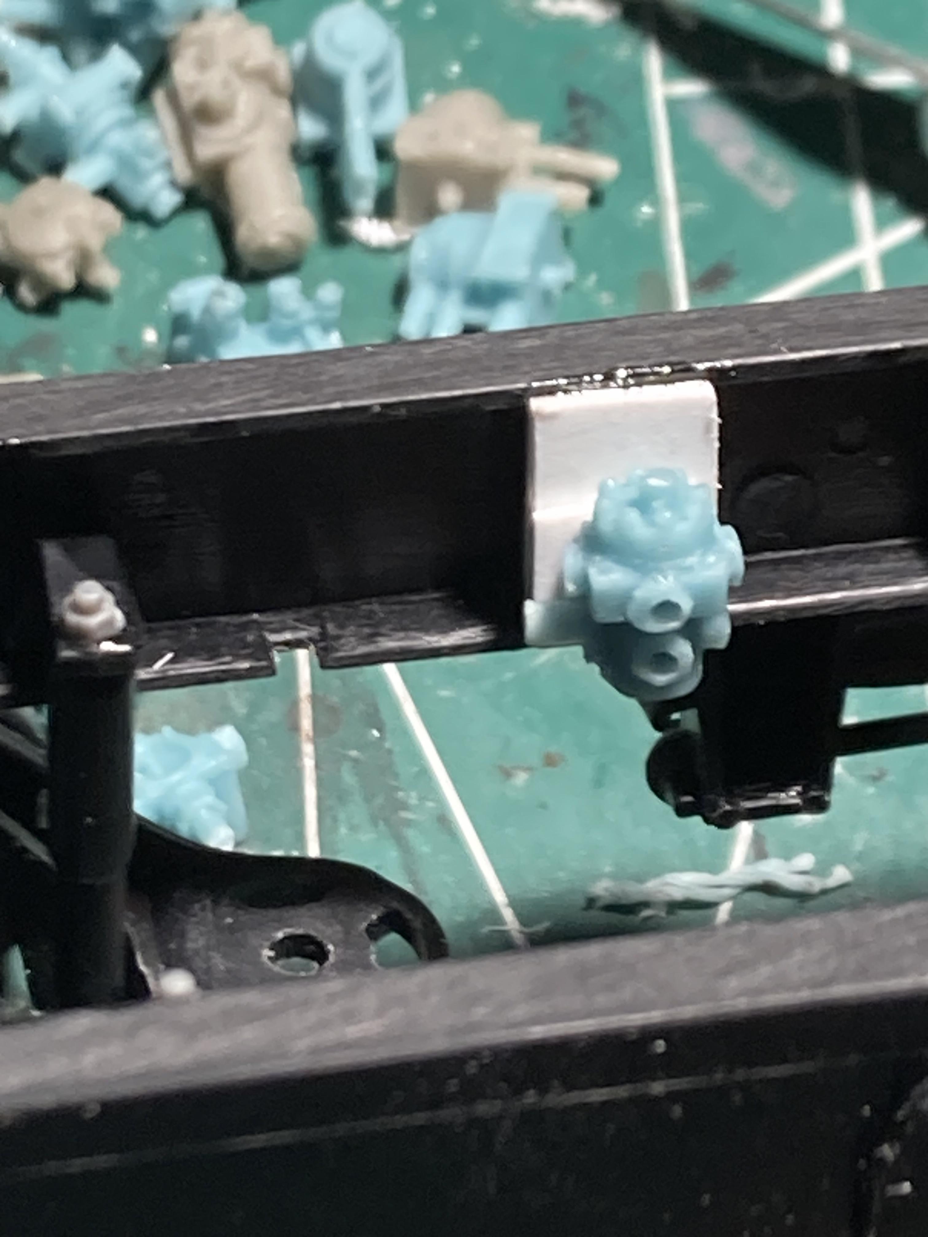

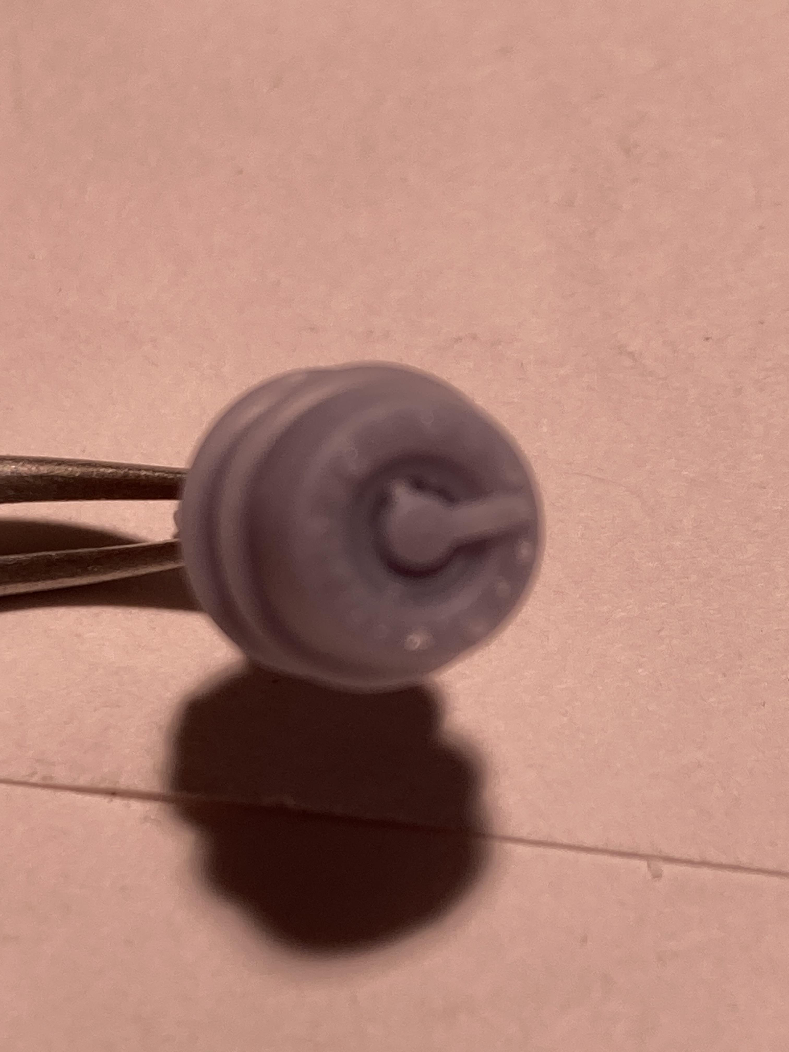

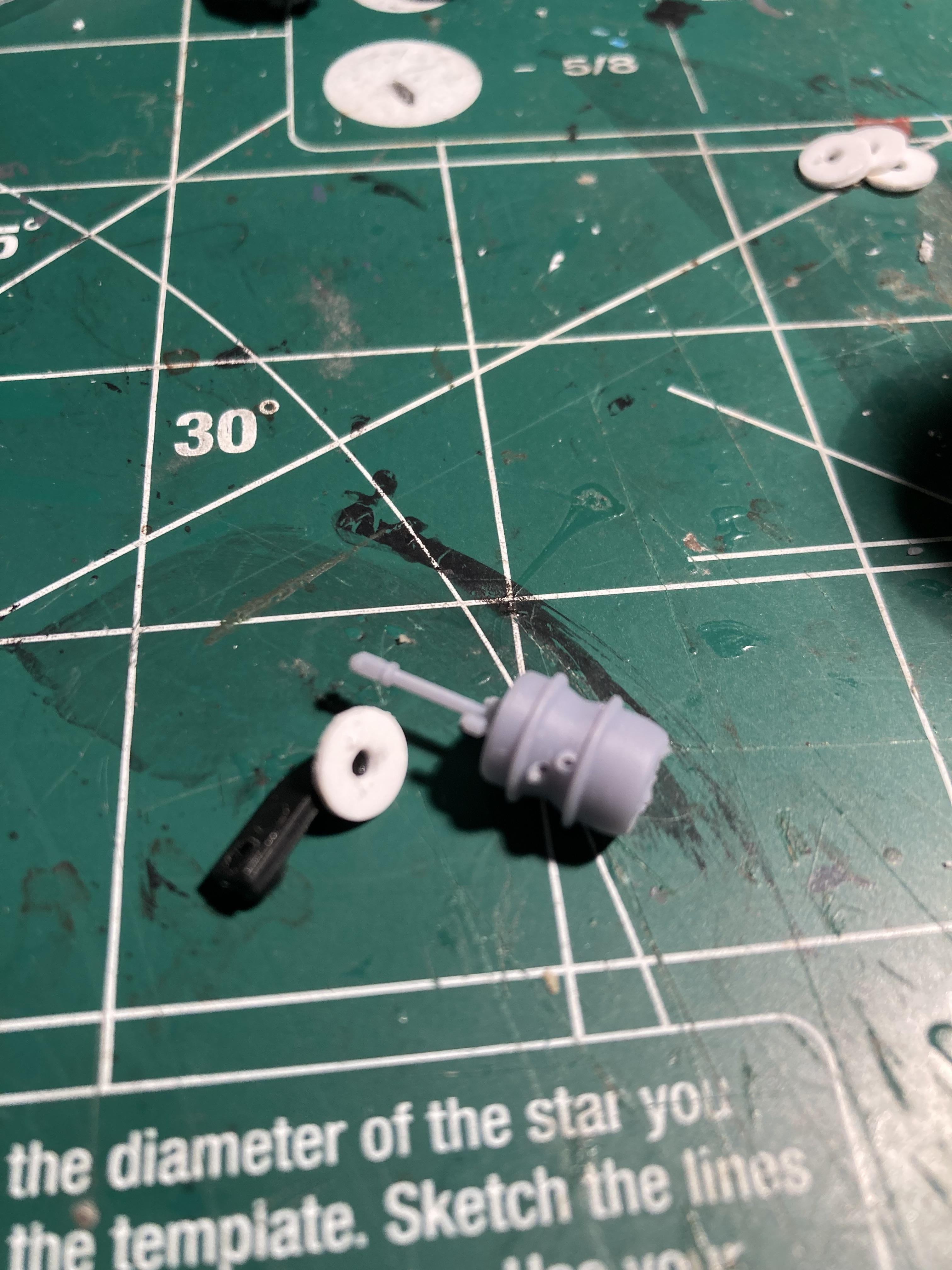

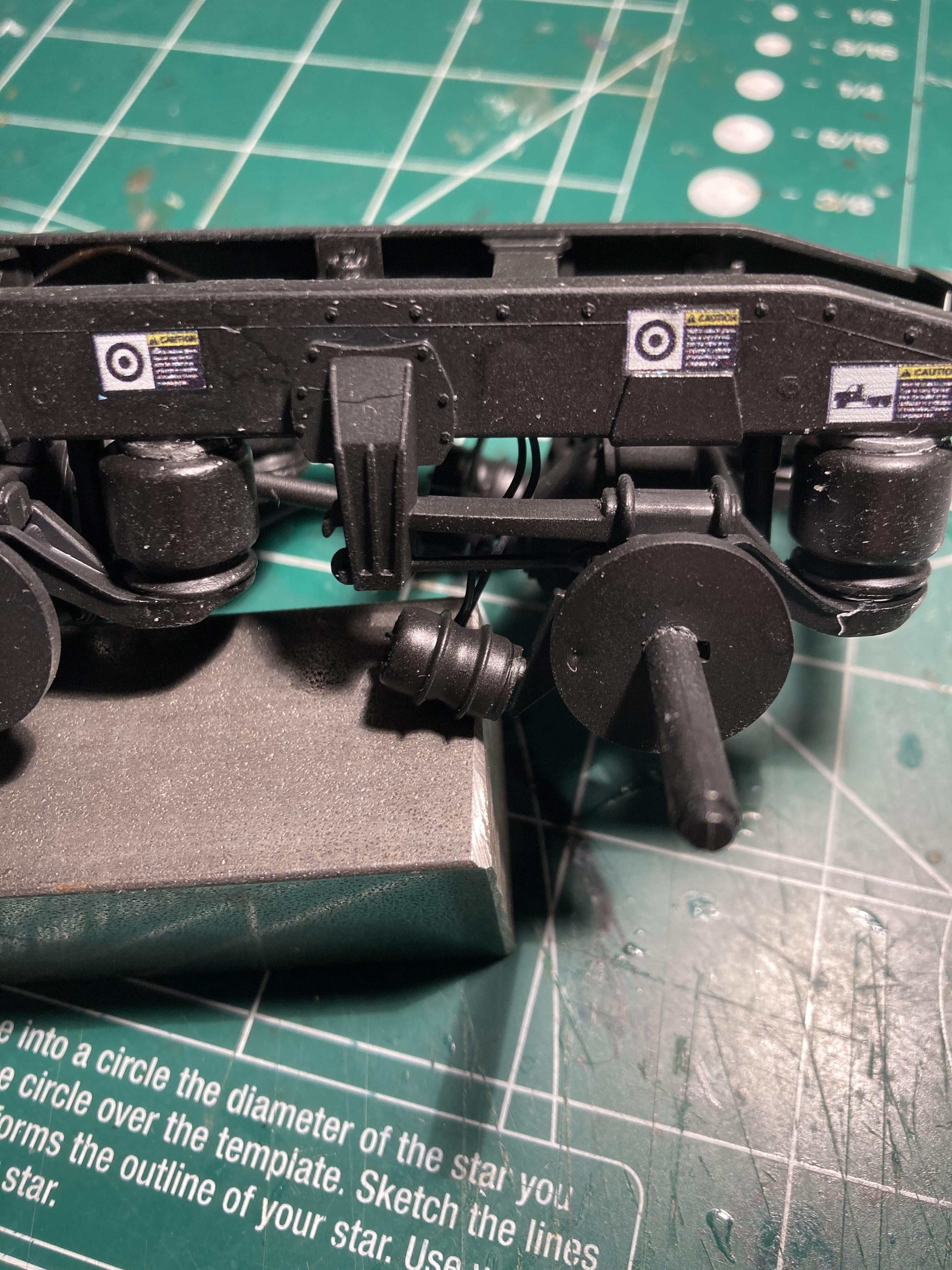

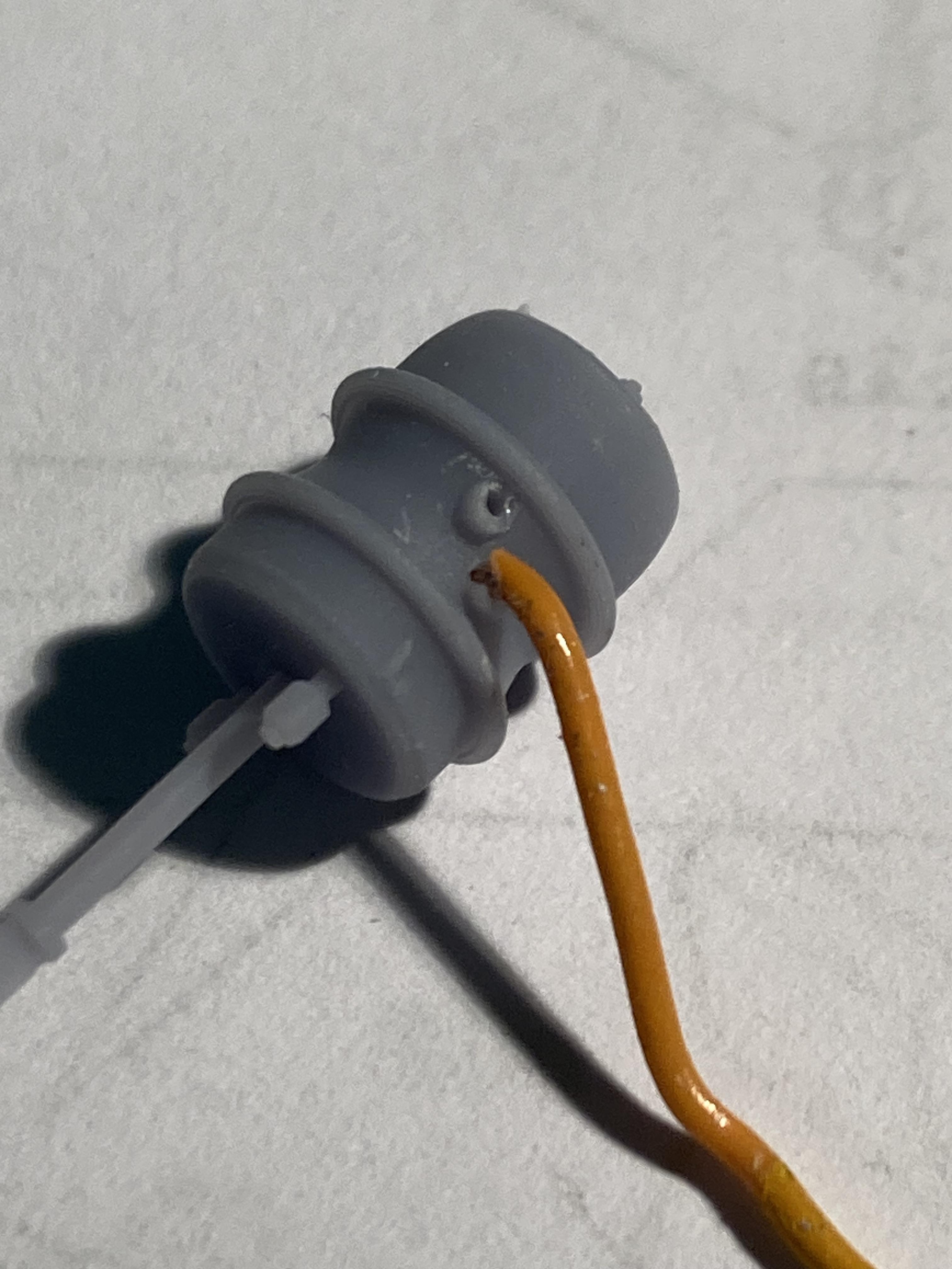

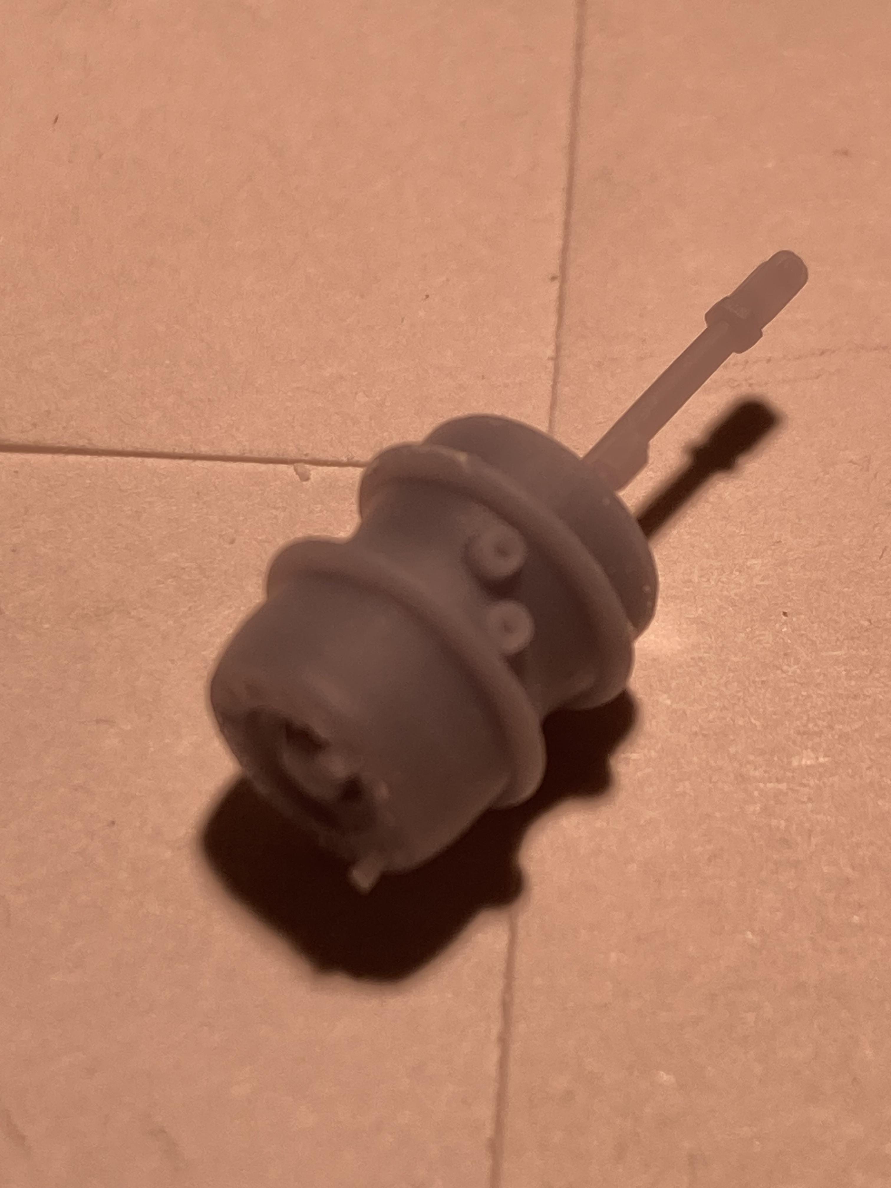

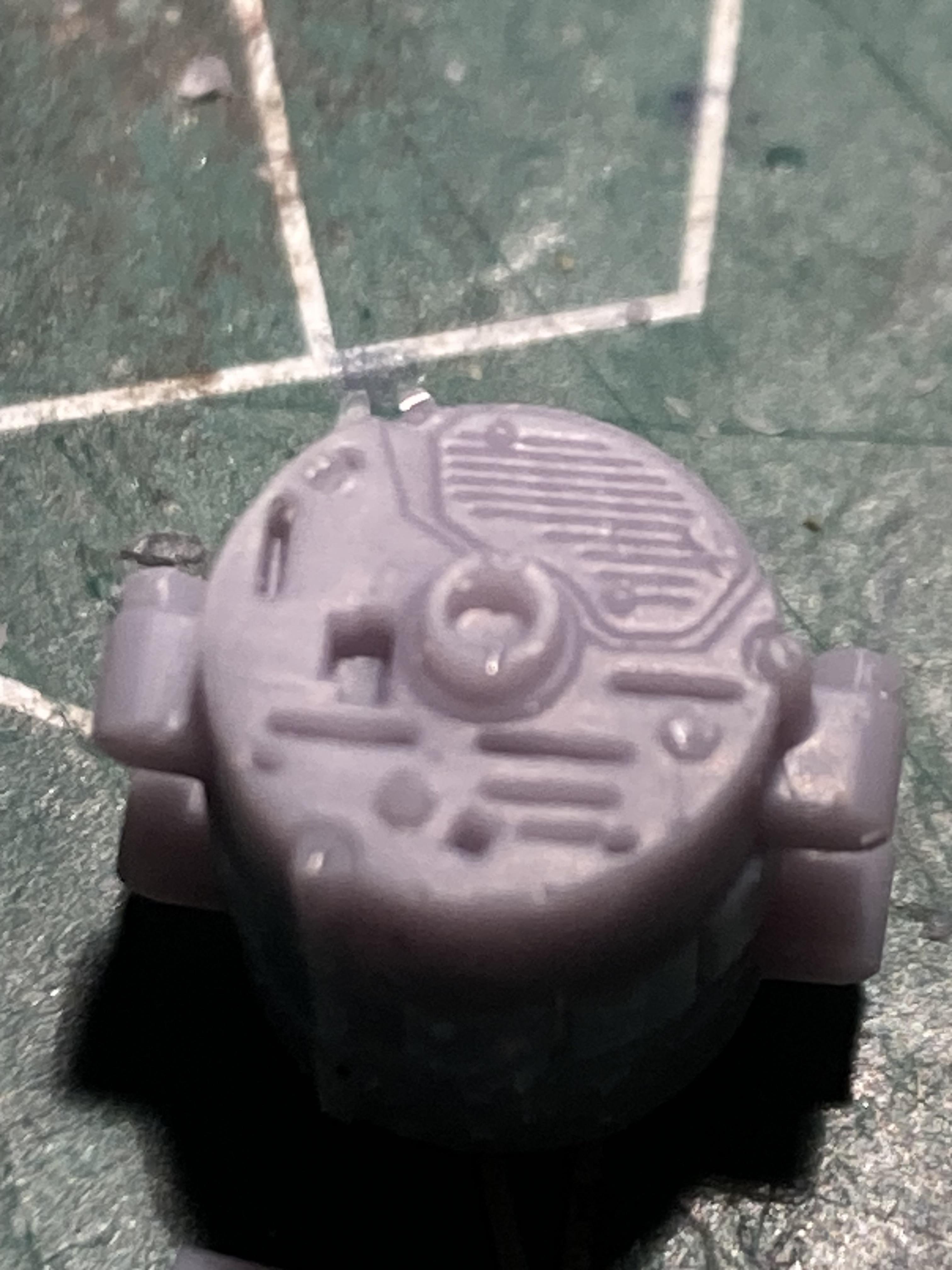

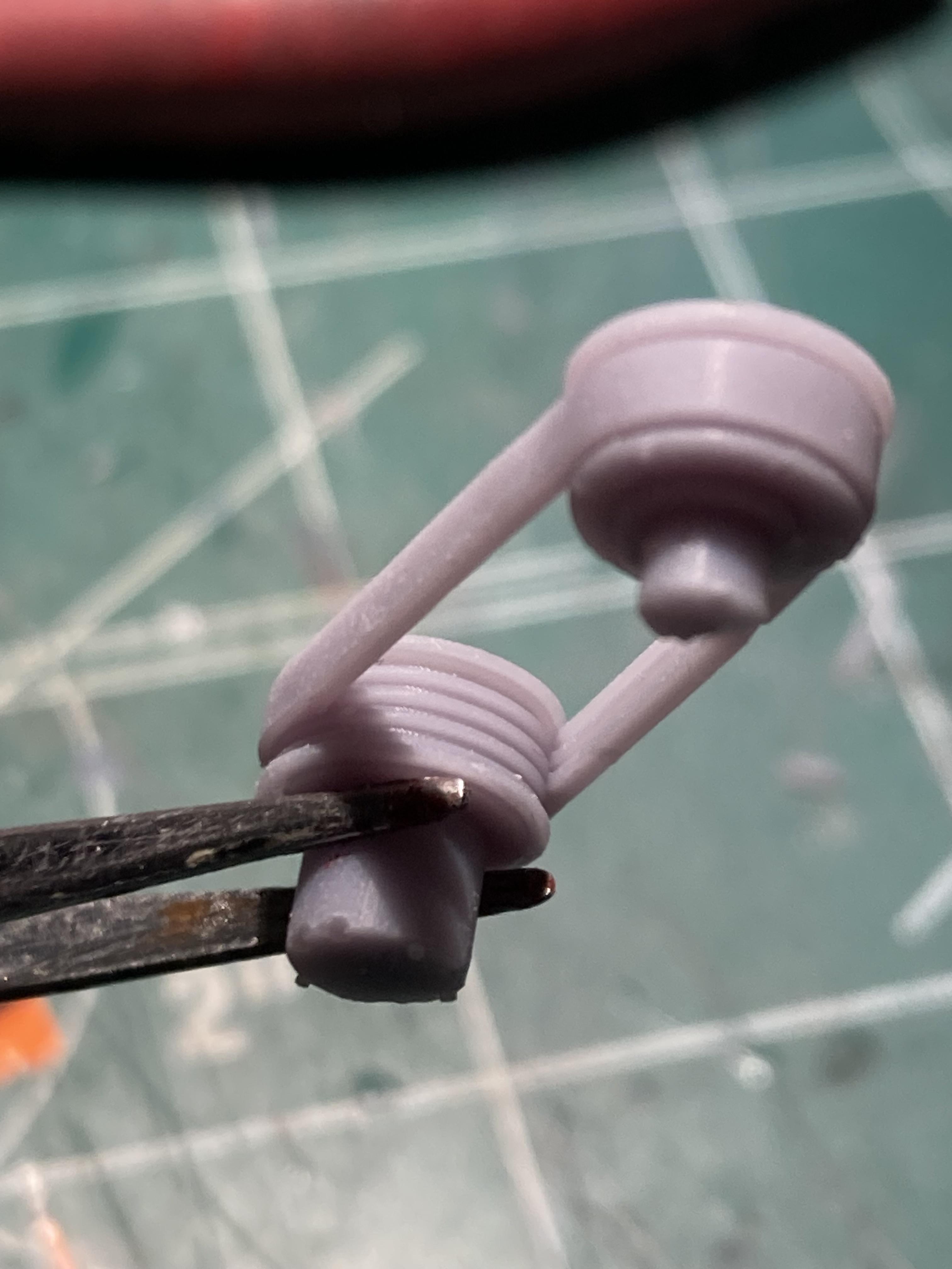

Biggu Posted August 12, 2024 Author Posted August 12, 2024 So the rear brake chambers are just not good for me and in my eyes totally unacceptable as earlier mentioned. So I found Kootenay 3d , a local fellow who does some printing of truck parts. When I saw his brake chambers I was sold. So I purchased a few sets and after seeing them for real will be getting many more sets . They are wonderful. And very well detailed. Altho a little care is needed when working with them the results are light years ahead of what comes in the box. I used the stock mounting brackets and it turned out well and at least they look the part 2

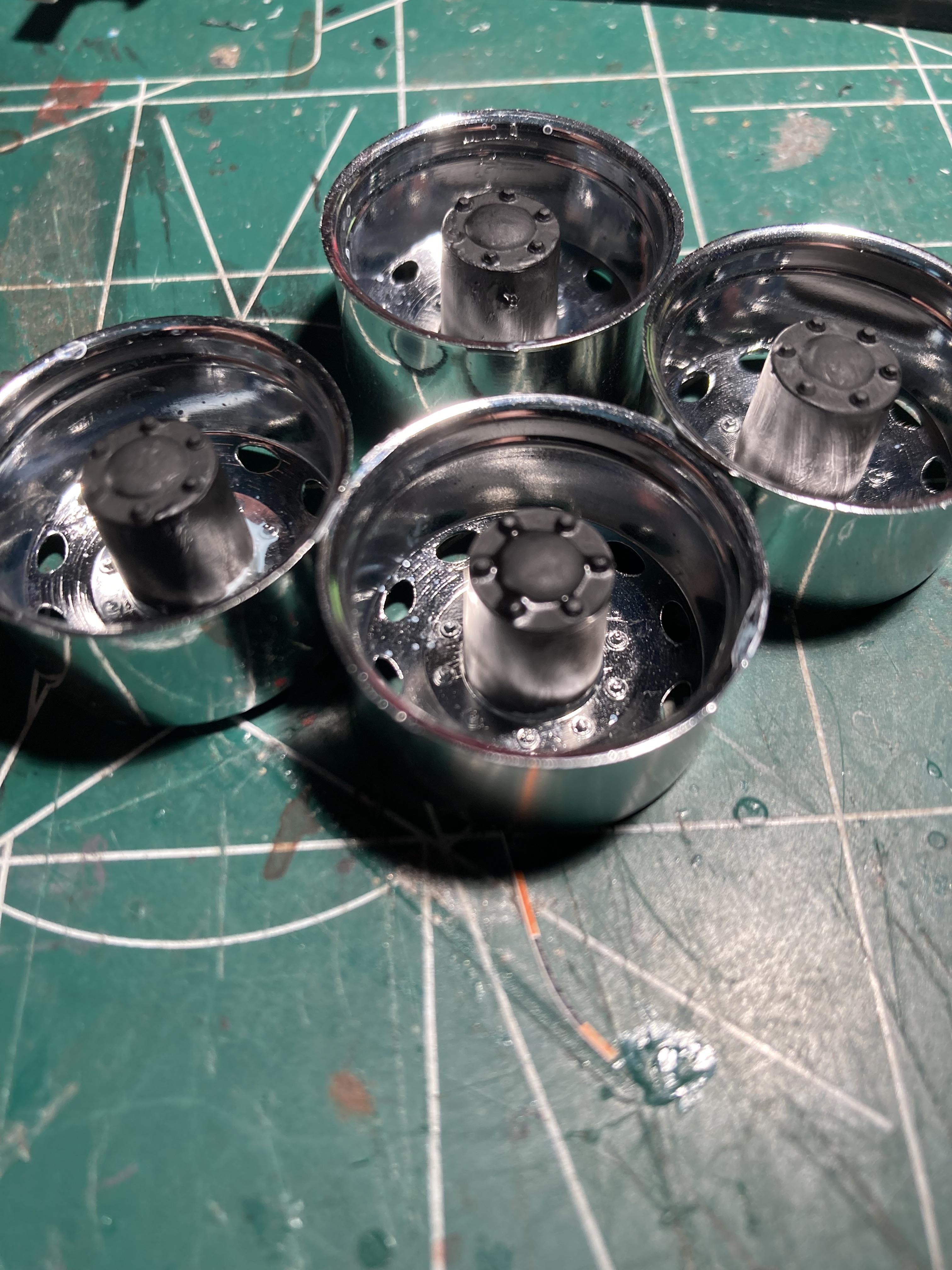

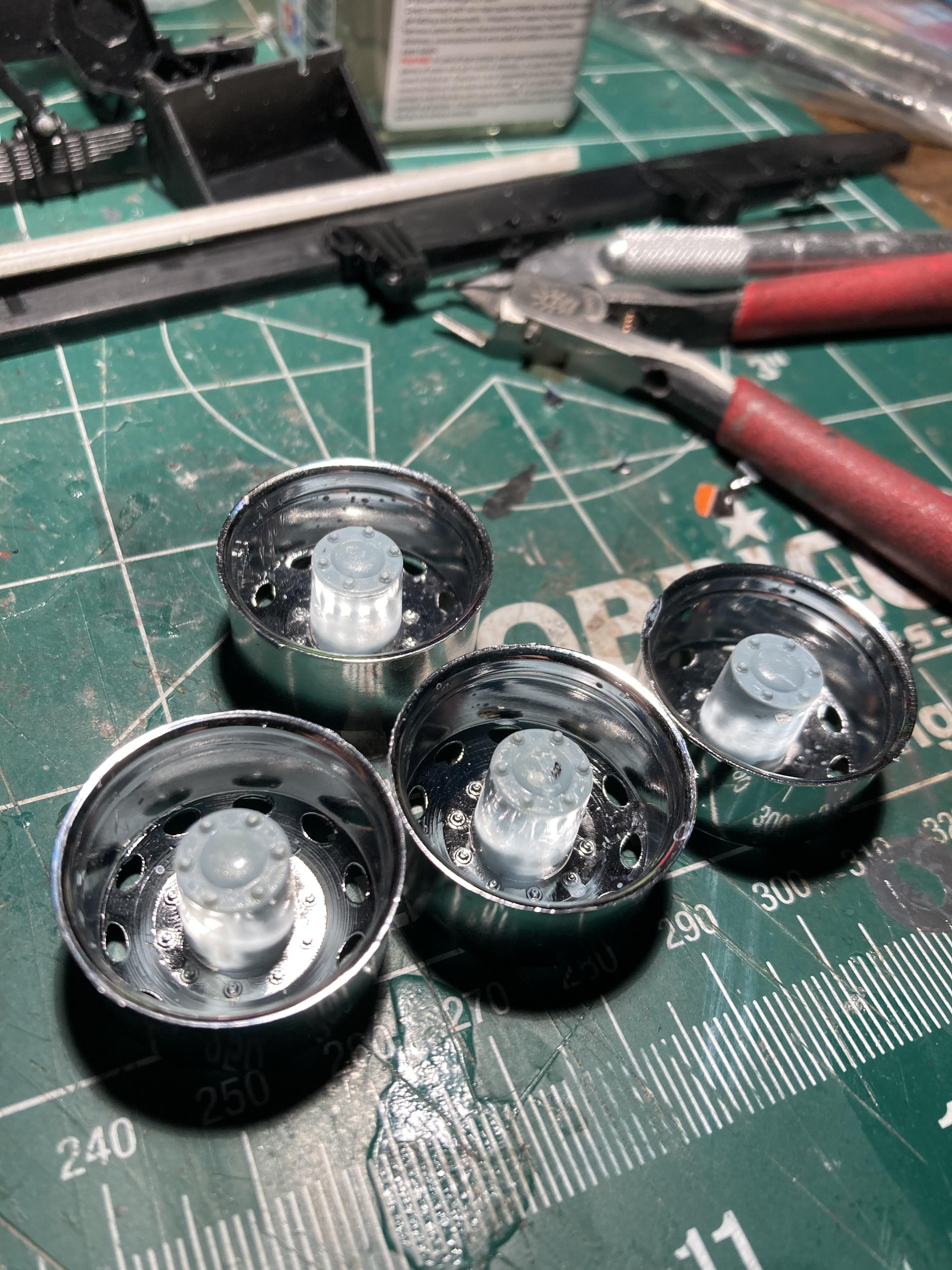

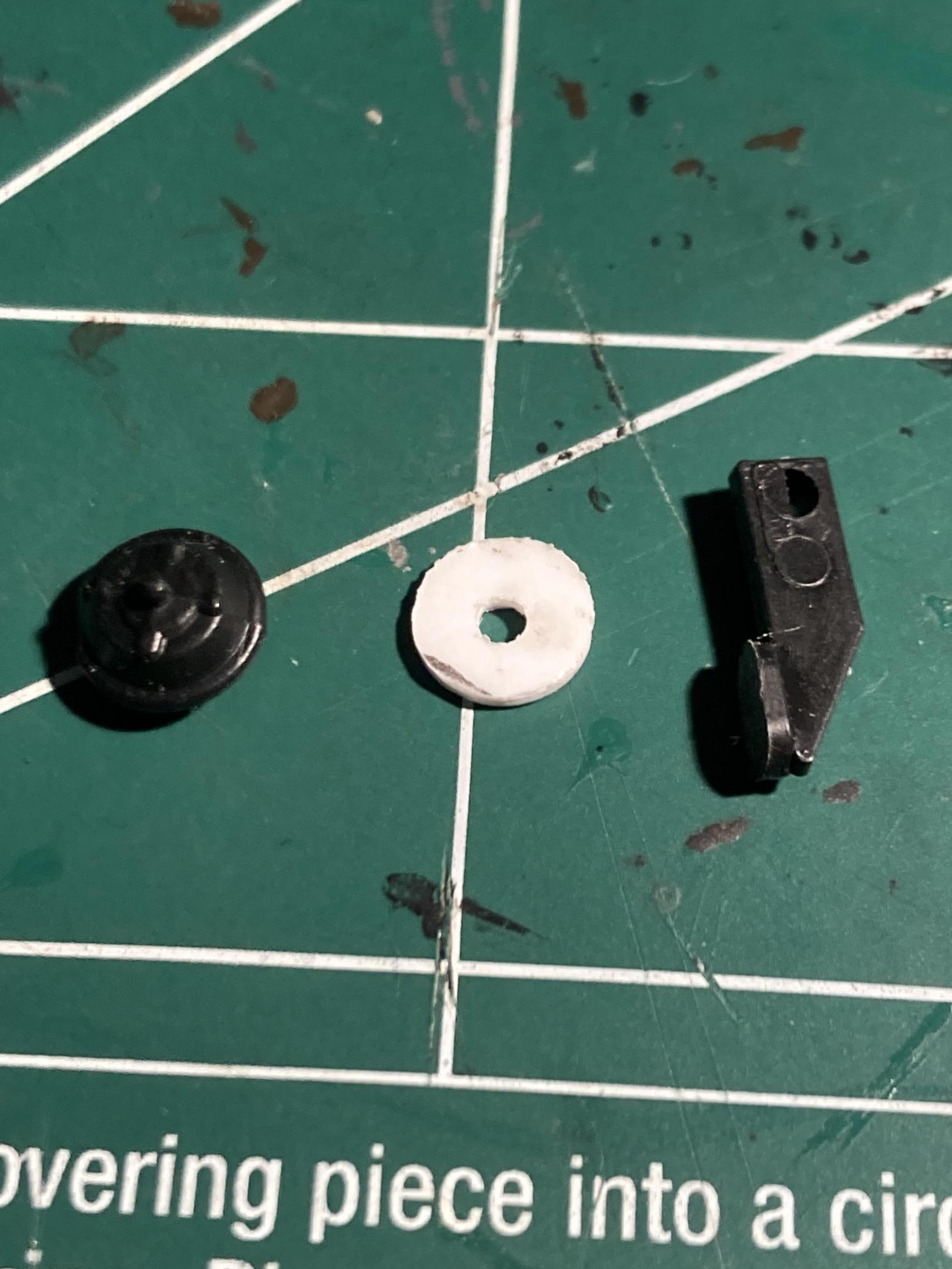

Biggu Posted August 12, 2024 Author Posted August 12, 2024 I find that some times the chrome is a bit bright and some parts chromed shouldn’t be. Case in point is the hubs on the rear wheels. Its obvious they can’t not be chromed as the hub in this case is part of the rim. So careful de-chroming needs to take place. So I carefully de-chromed the hubs and ten painted them satin black. I also decided to de-chrome the air cleaners and will paint them cab color with chrome hold down strips and some CTM photo etc screen on the air intake. 2

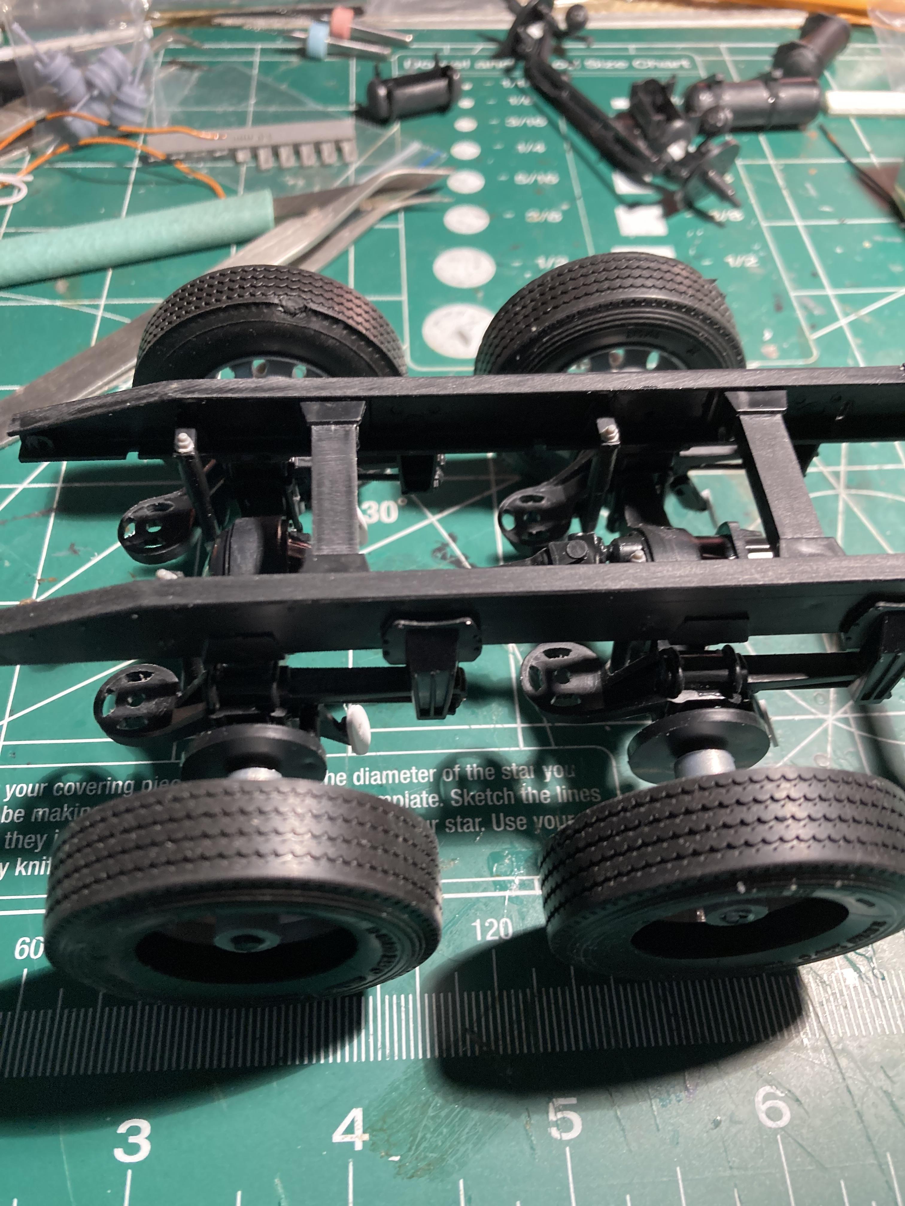

Biggu Posted August 13, 2024 Author Posted August 13, 2024 Added a few ‘bolts’ here and there and installed the rear ends and made sure all four rear feet touched the ground 2

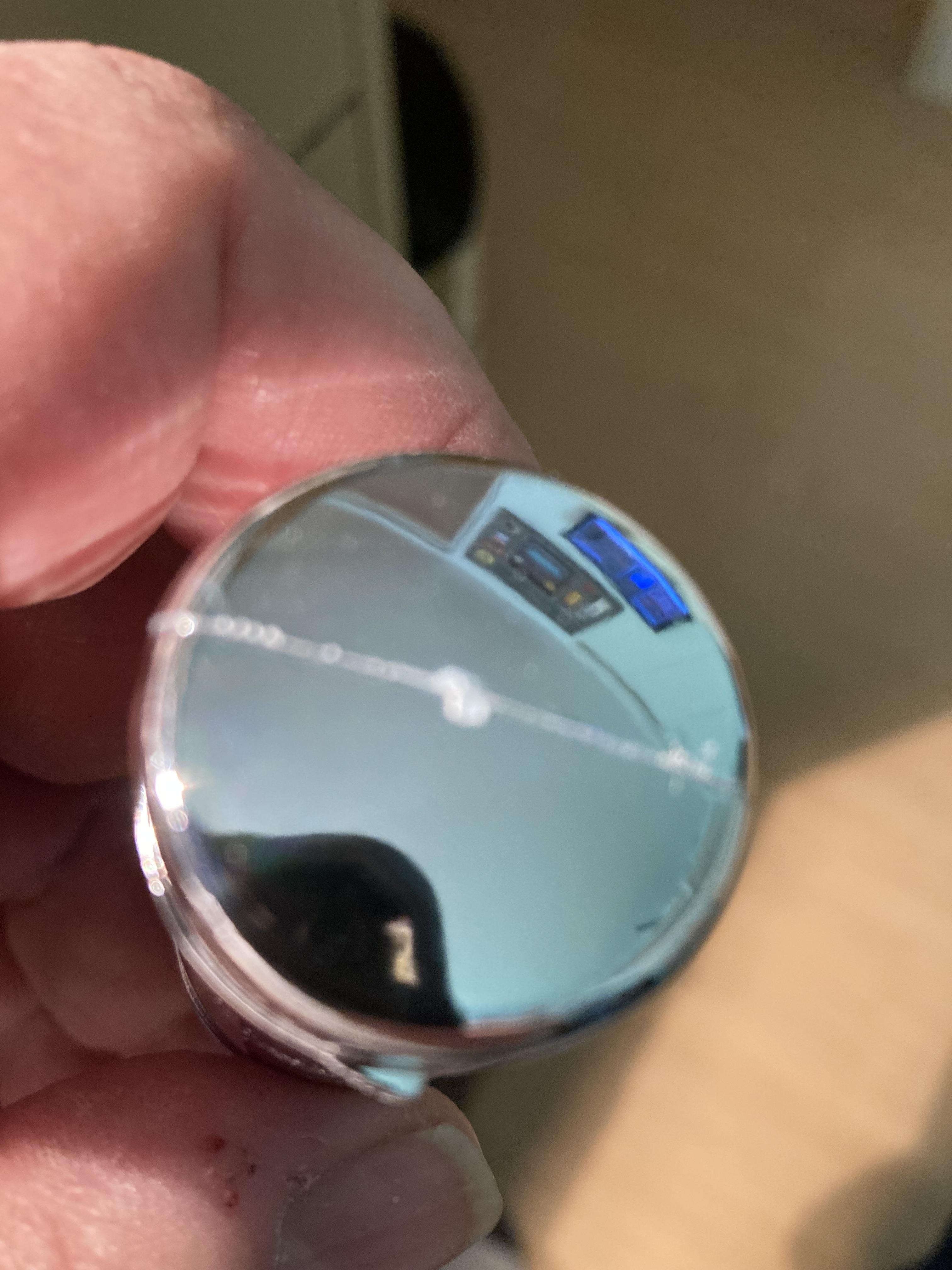

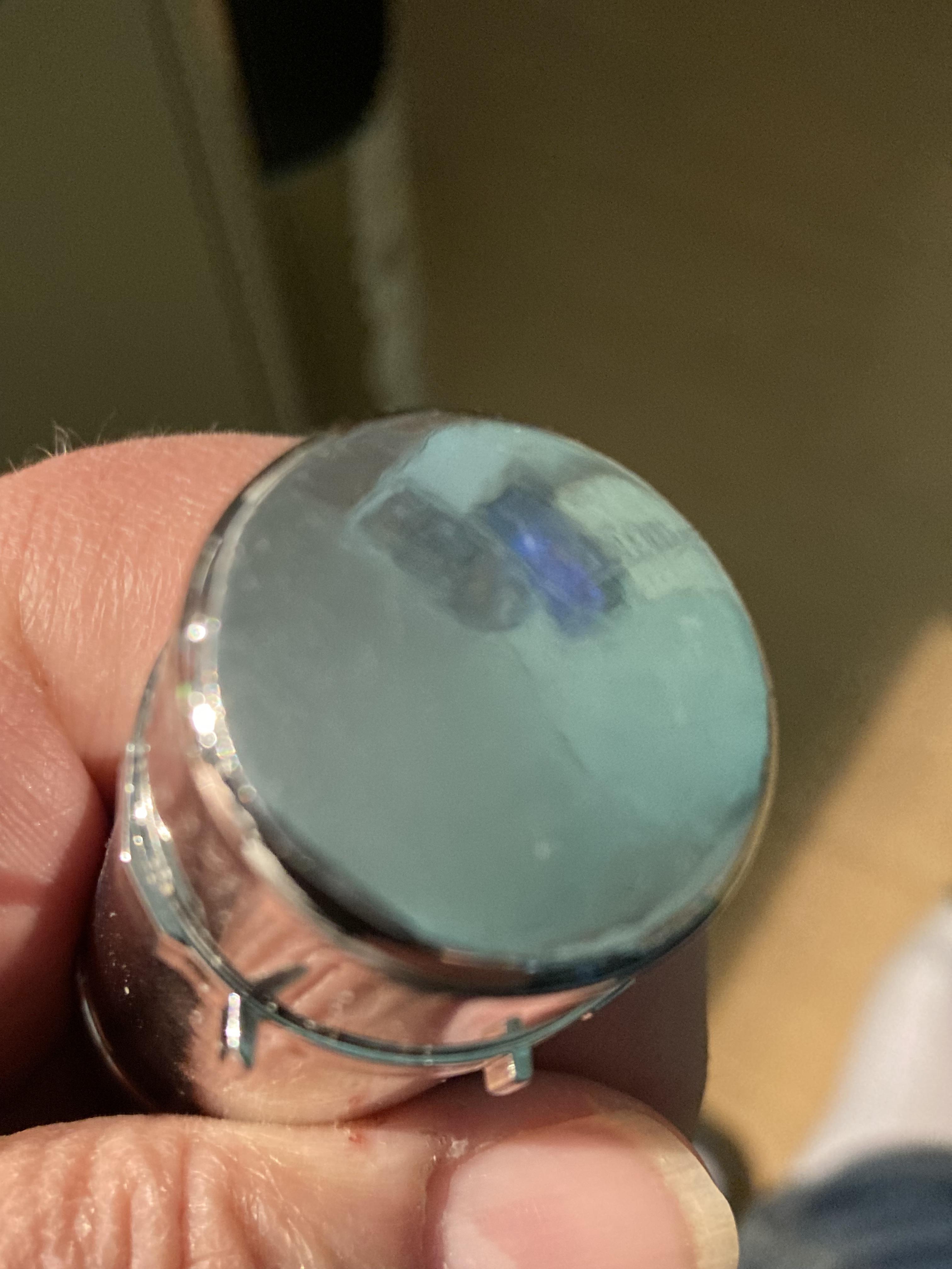

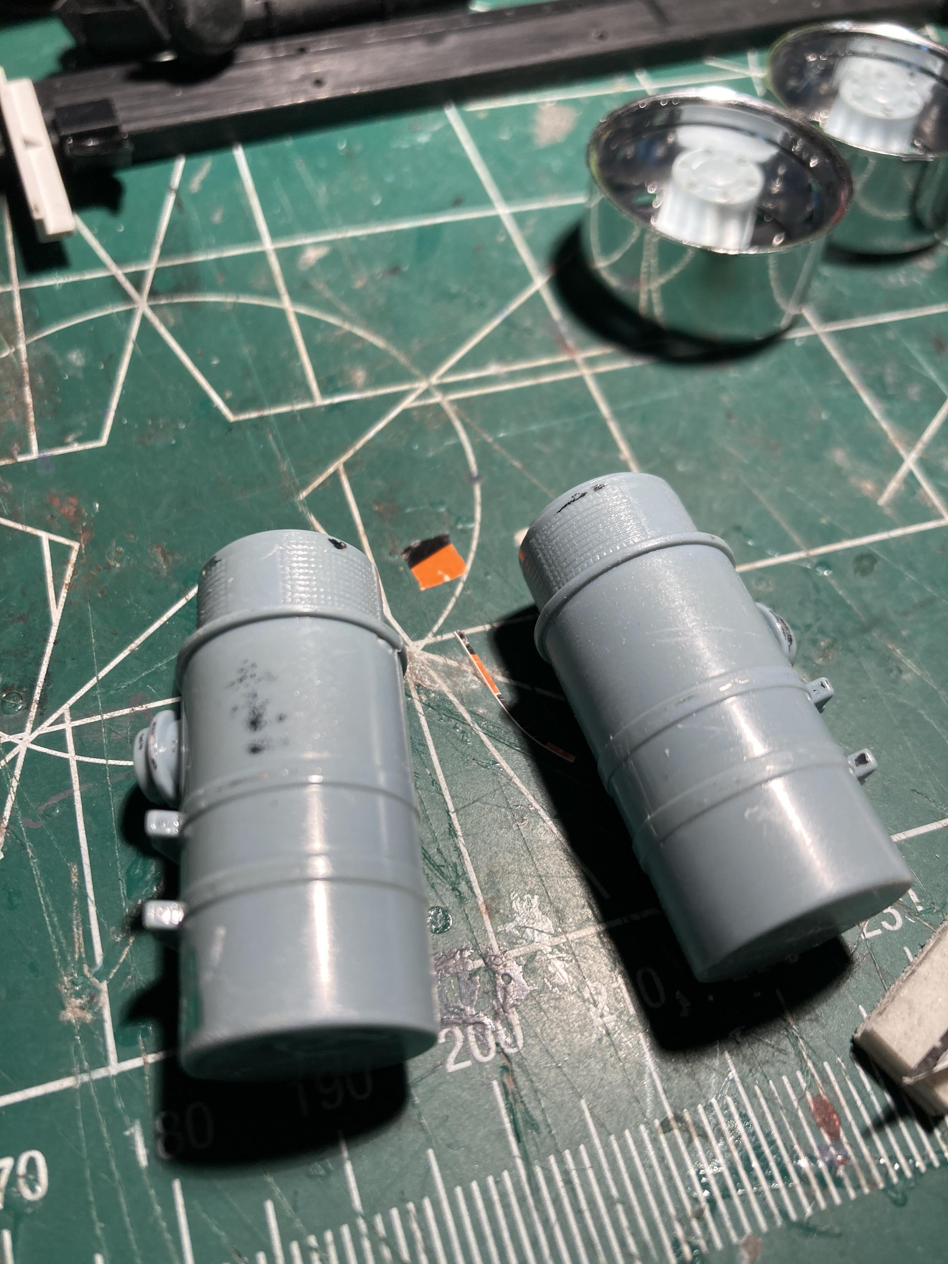

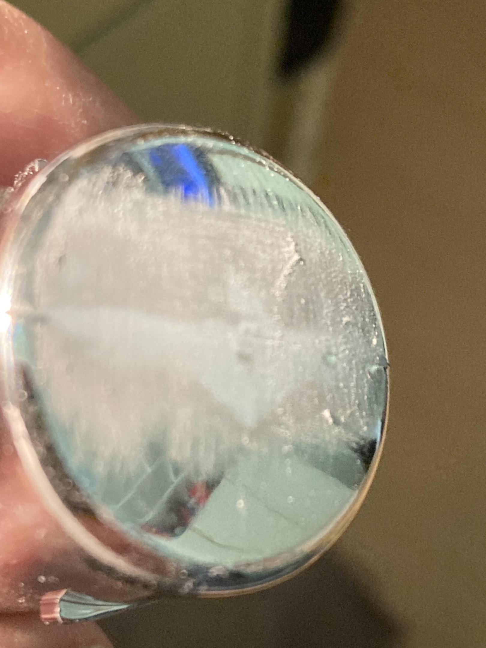

Biggu Posted August 13, 2024 Author Posted August 13, 2024 So for me I find sometimes the nice chrome on these kits is too bright and as I had 38 years driving trucks, mostly gravel trucks pulling a pup or our low bed truck and trailer. Neither of which had chrome tanks. Our newer units had nice clean aluminum tanks that didn’t stay nice, clean and shiny ….. but I do see some highway units with beautiful tanks. So with that said I did decide to leave these tanks chrome. But I was less than impressed with the seam on the tanks. No matter how hard I tried I couldn’t hide the seam. So I sanded the seam and of course took the chrome off. So to cover that , I found some ‘chrome’ automotive tape and cut the appropriate size of the tank ends and put it on the end to make it ‘chrome ‘ again. Now it isn’t perfectly chromed BUT if you look at a real chrome tank, after a long trip the ends do take a bit of a beating from road grime rocks, sand etc. so for my application and my old eyes this seems to work for me and for the most prt hid the seam …. 2

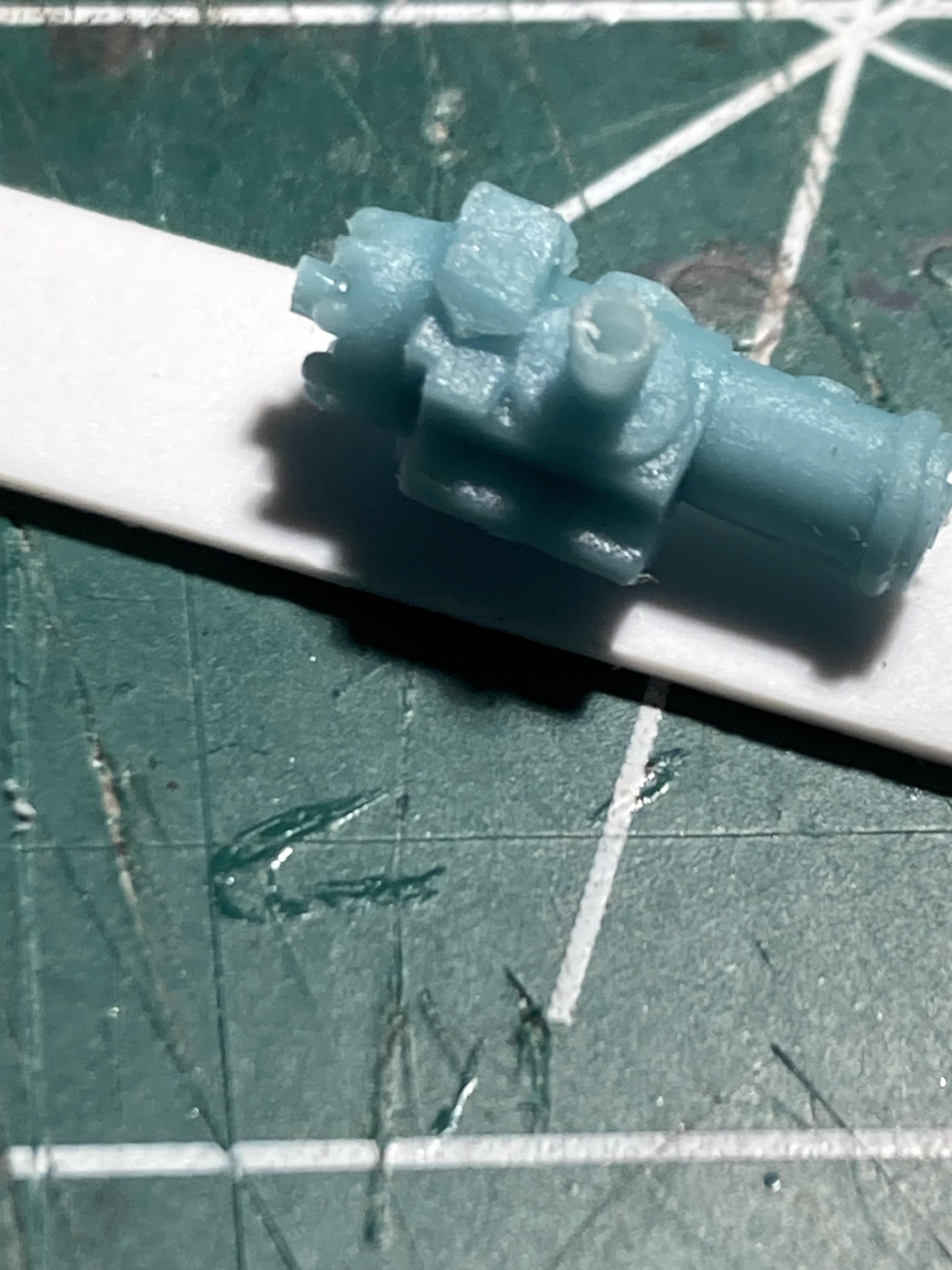

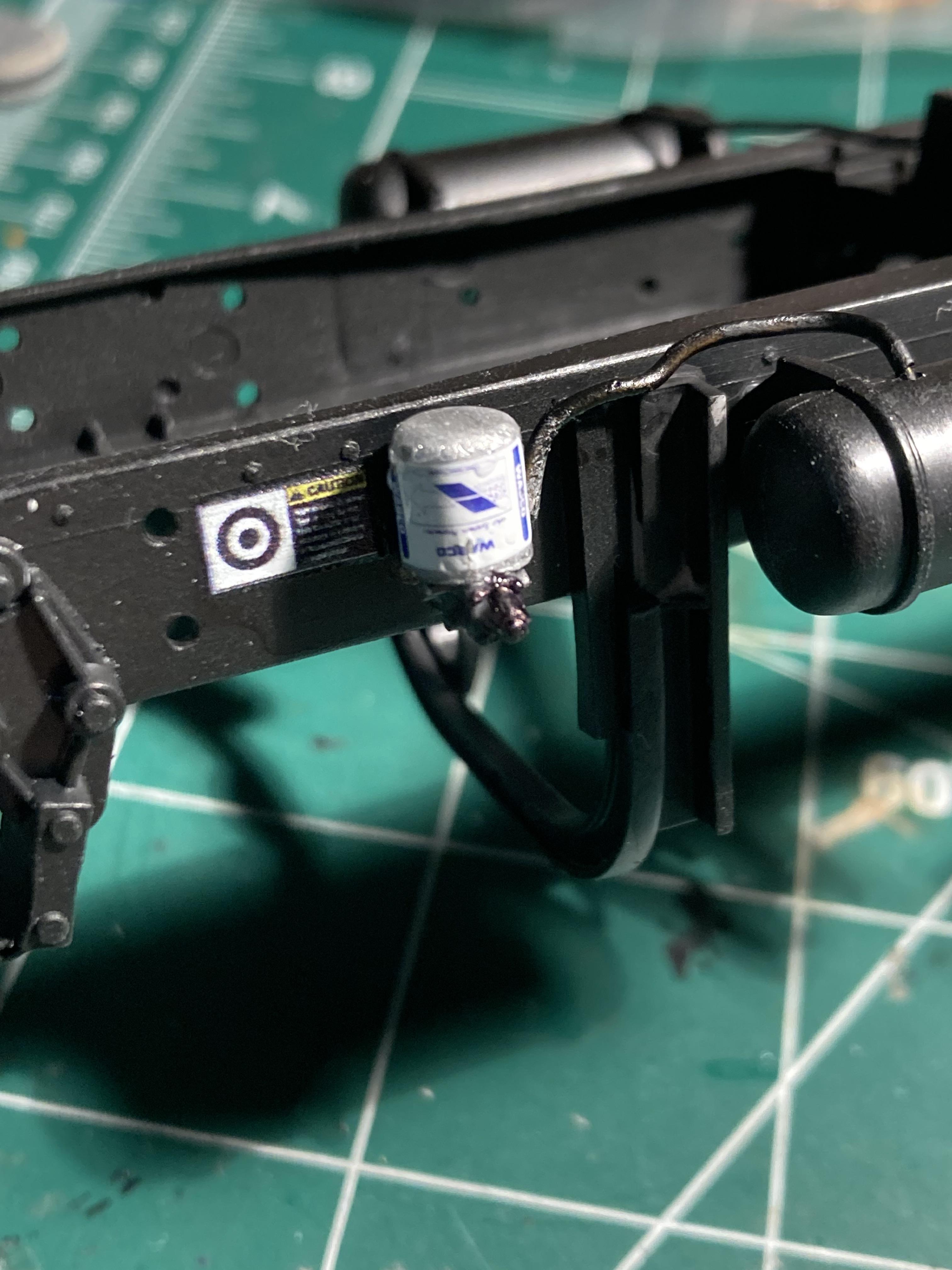

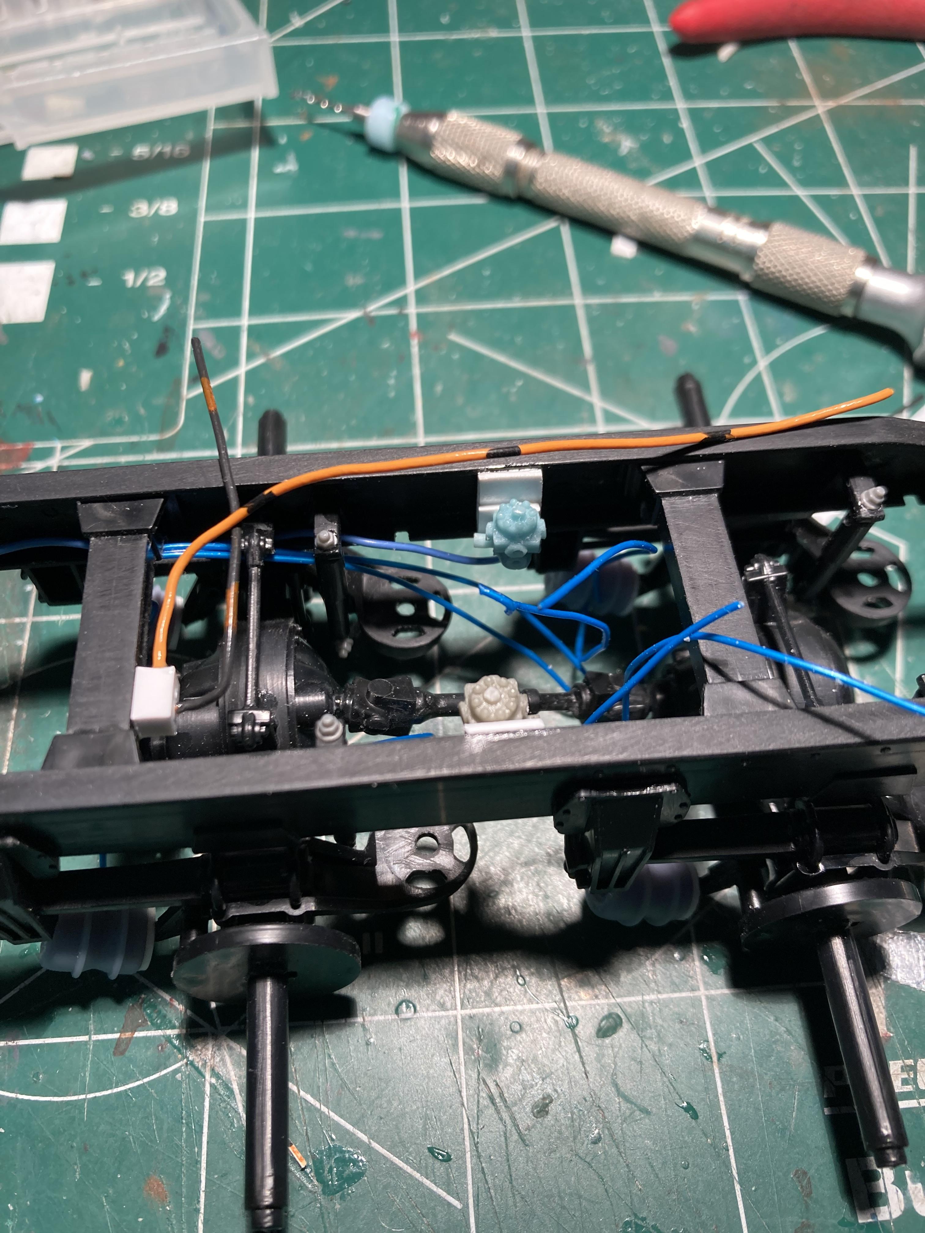

Biggu Posted August 13, 2024 Author Posted August 13, 2024 So now it seems to be air plumbing time. I buy my air valves and my aftermarket from STSupply as Paul is in Canada and it saves me the massive bank exchange fees to US Dollar. So all a/m including rims and tires comes from Paul . That is my main source for A/M. So valves installed and the plumbing started 3
Biggu Posted August 13, 2024 Author Posted August 13, 2024 So under a splash of paint and a few decals added to the frame and the Wabco Air drier installed and a few detail bolts the frame is slowly coming together 3

Rockford Posted August 13, 2024 Posted August 13, 2024 I'm struggling to keep up with this build! Those brake chambers are exquisite! Loving the detailing you're doing. The fuel tanks look great, good idea on the chrome tape, stops the seam spoiling them, I might look for some myself. I know I've found aluminium duct tape very useful recently, like a much cheaper Bare Metal Foil. 1
Biggu Posted August 13, 2024 Author Posted August 13, 2024 17 minutes ago, Rockford said: I'm struggling to keep up with this build! Those brake chambers are exquisite! Loving the detailing you're doing. The fuel tanks look great, good idea on the chrome tape, stops the seam spoiling them, I might look for some myself. I know I've found aluminium duct tape very useful recently, like a much cheaper Bare Metal Foil. Thanks , Steve...................I totally agree with the tape , the duct tape should work as well, I have found that if I take a wooden dowel or something like that and really burnish the edges of the tape it seems to help somewhat and doesn't leave a sharp line and I use a circle template to cut the tape, nothing fancy......the brake chambers are from Kootenay 3D Model Parts.... Brandon does really nice work.... his site is down for a little bit by the looks of it, but well worth checking out....

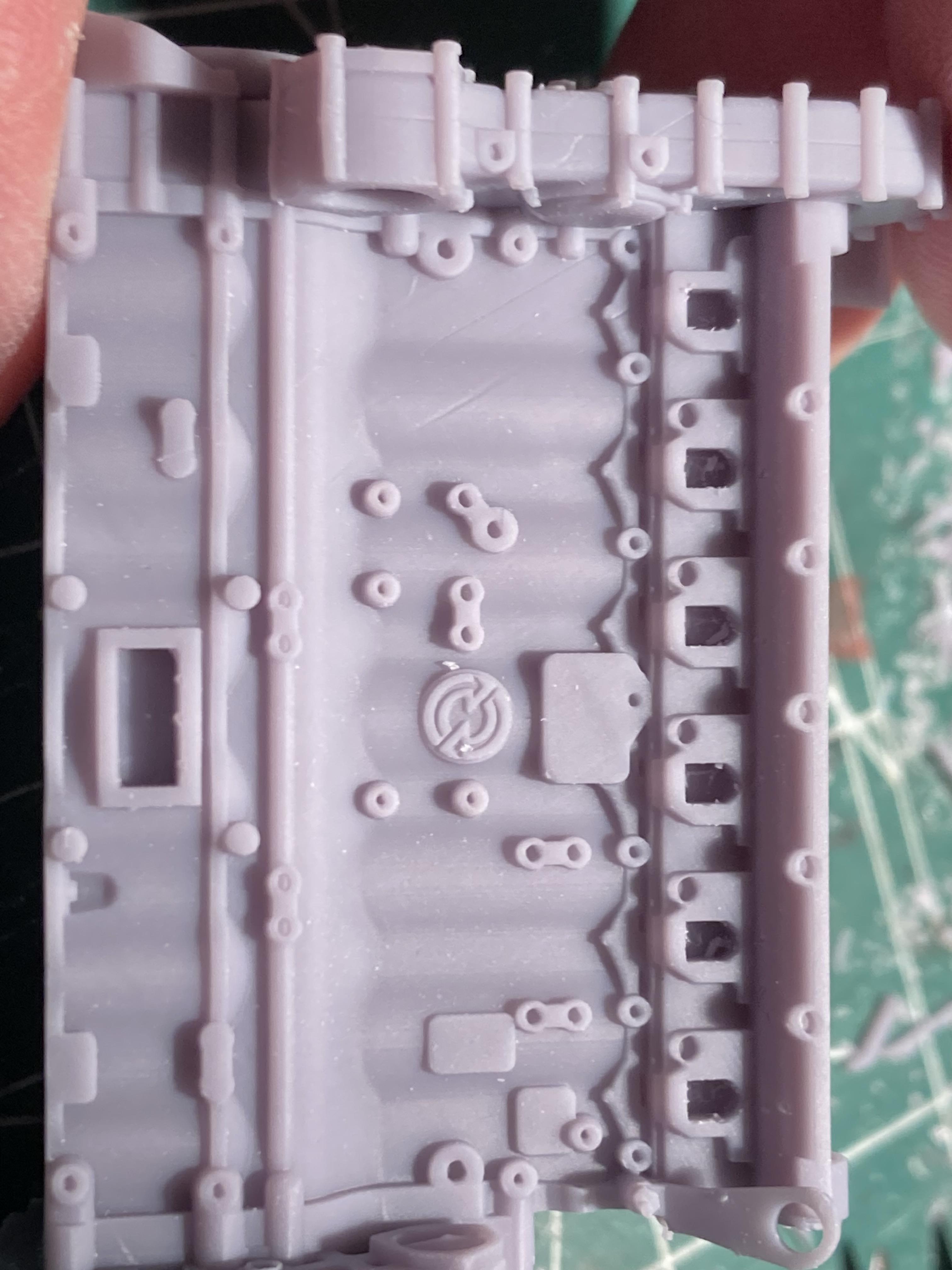

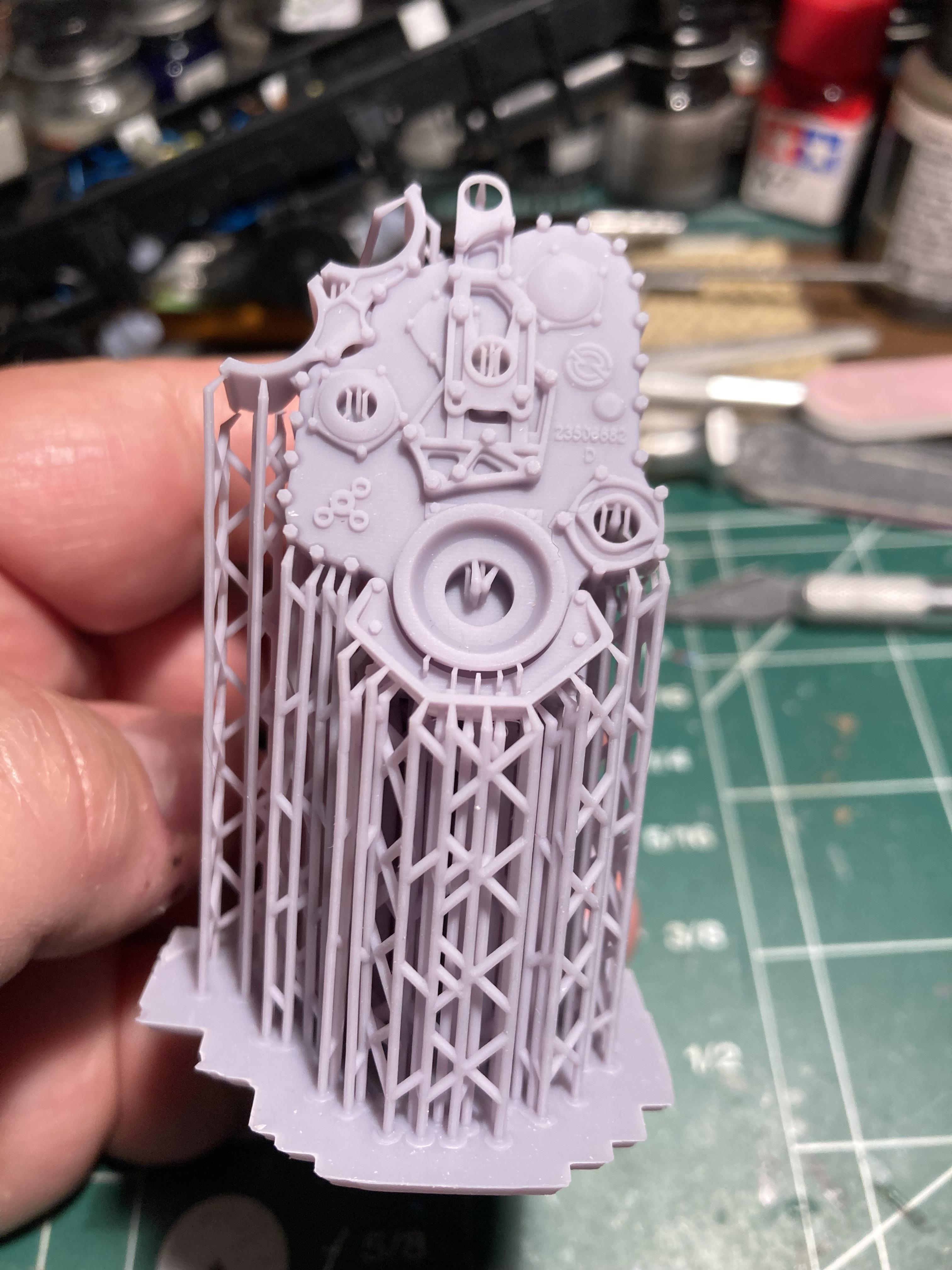

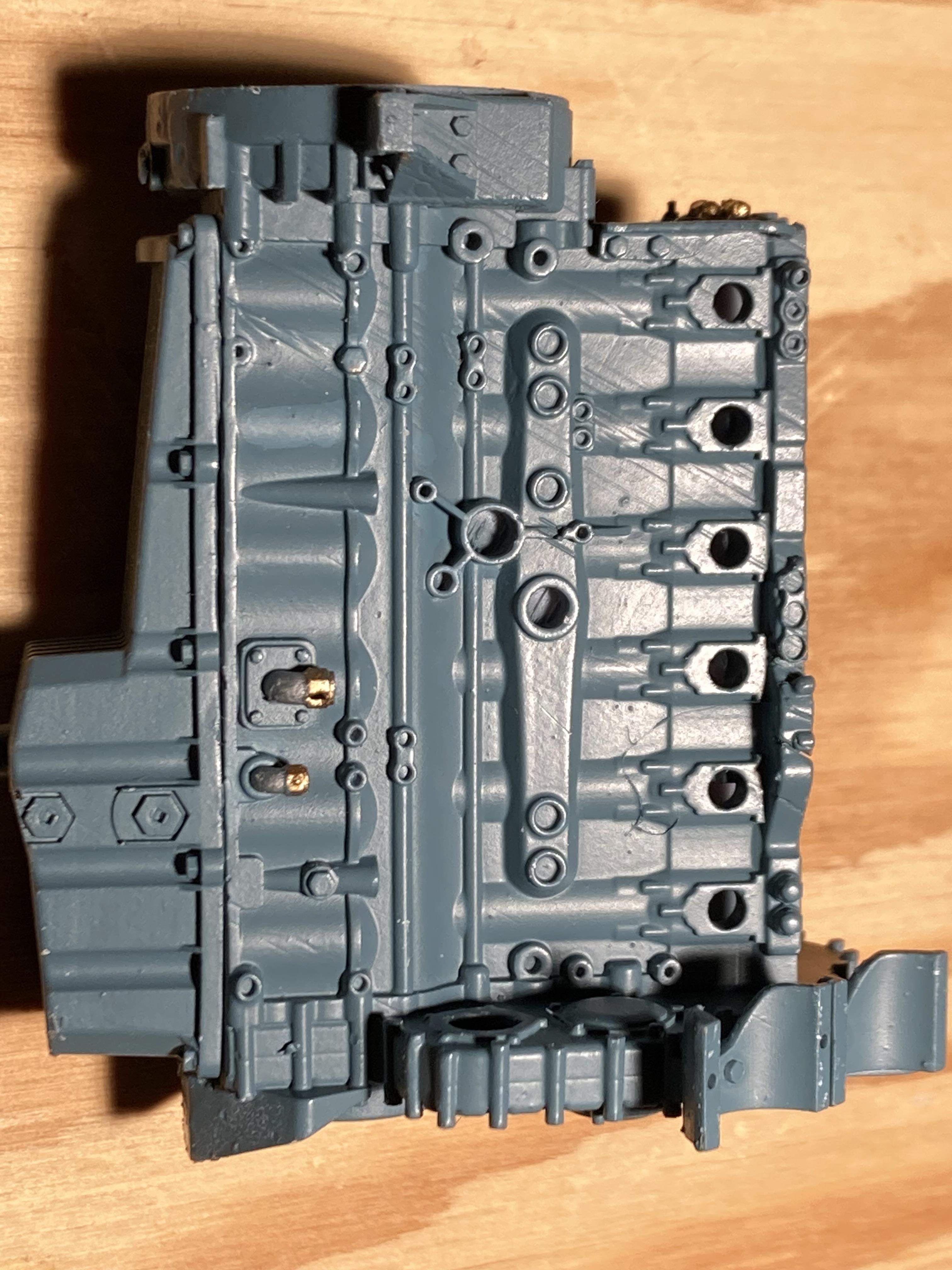

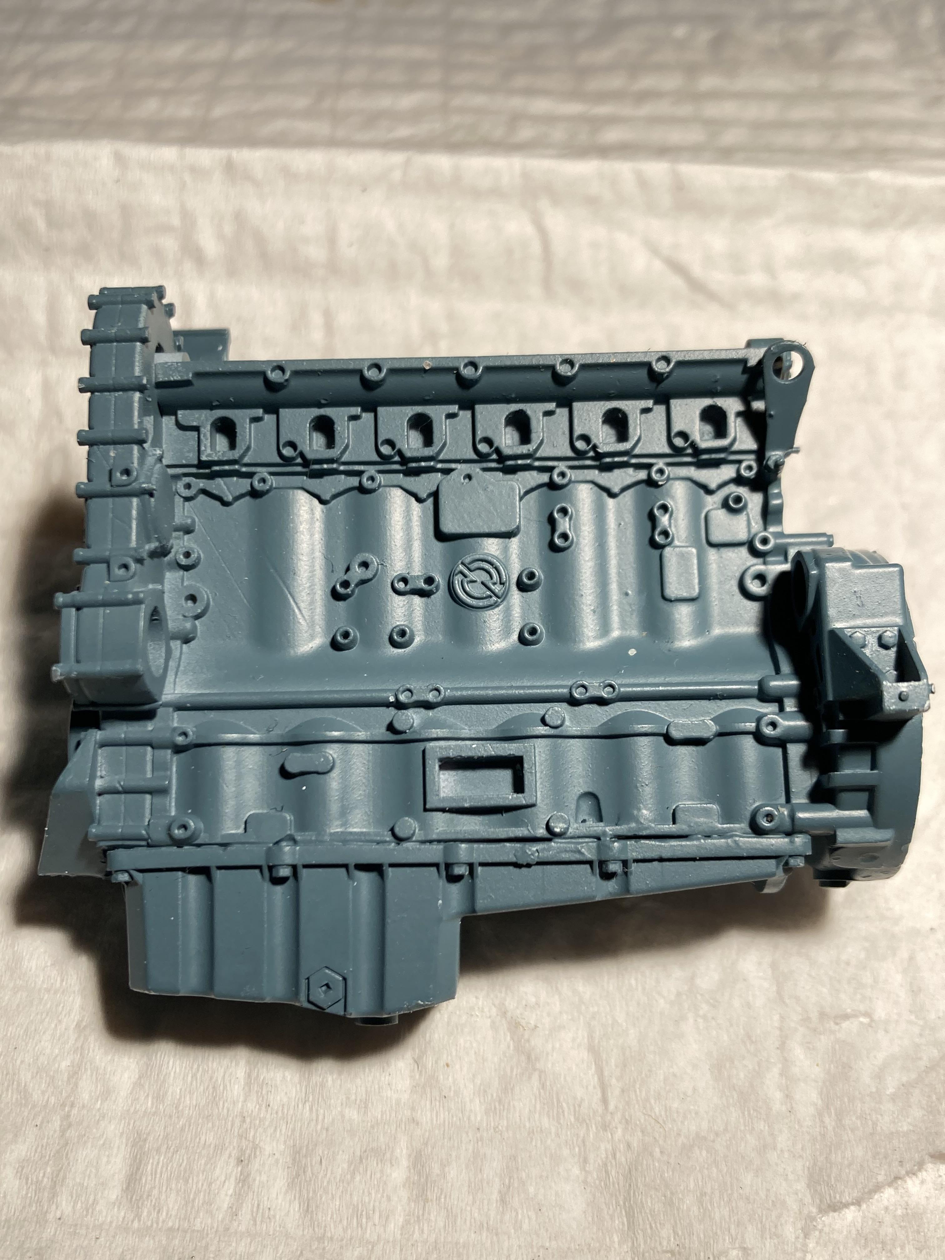

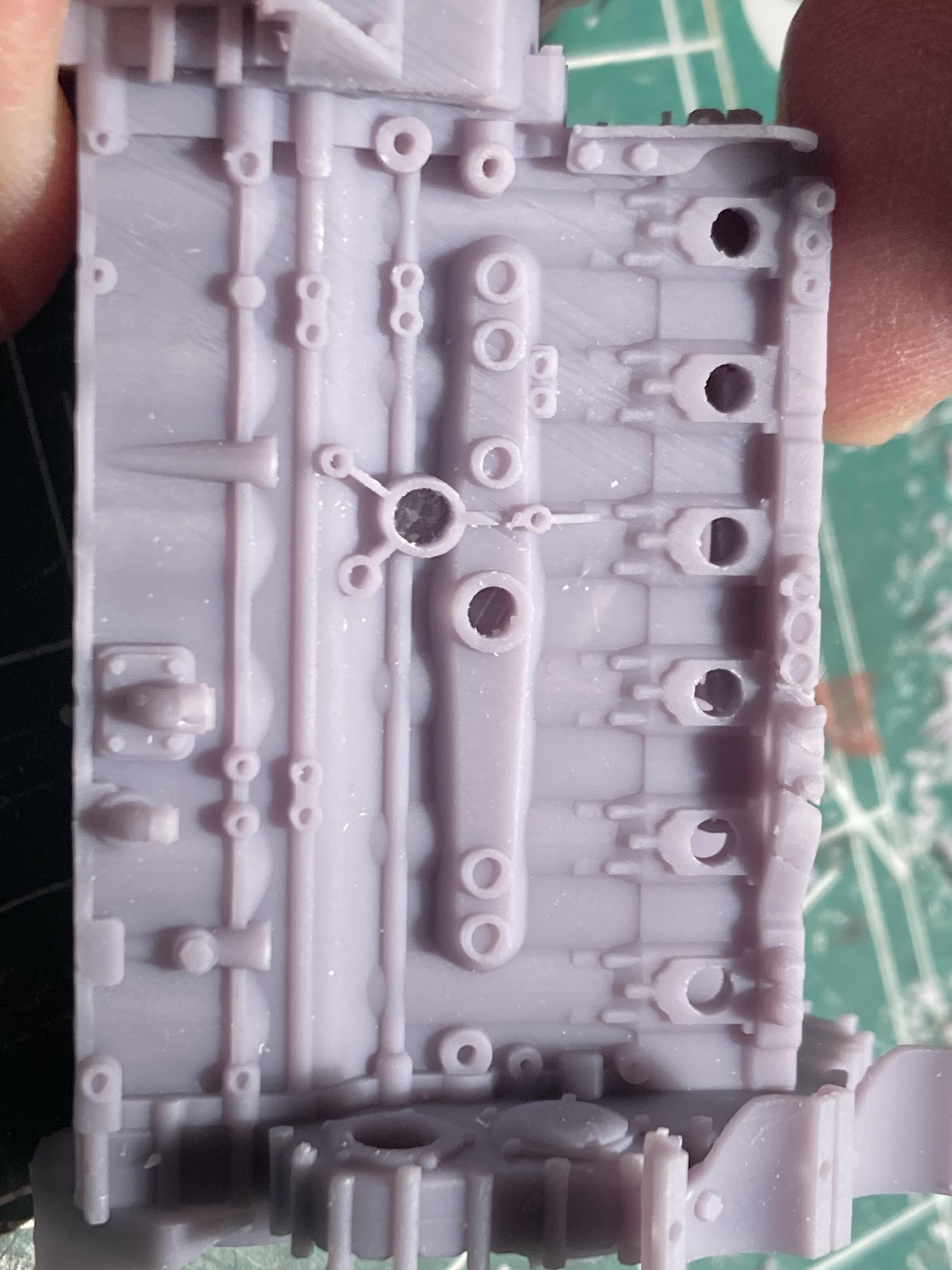

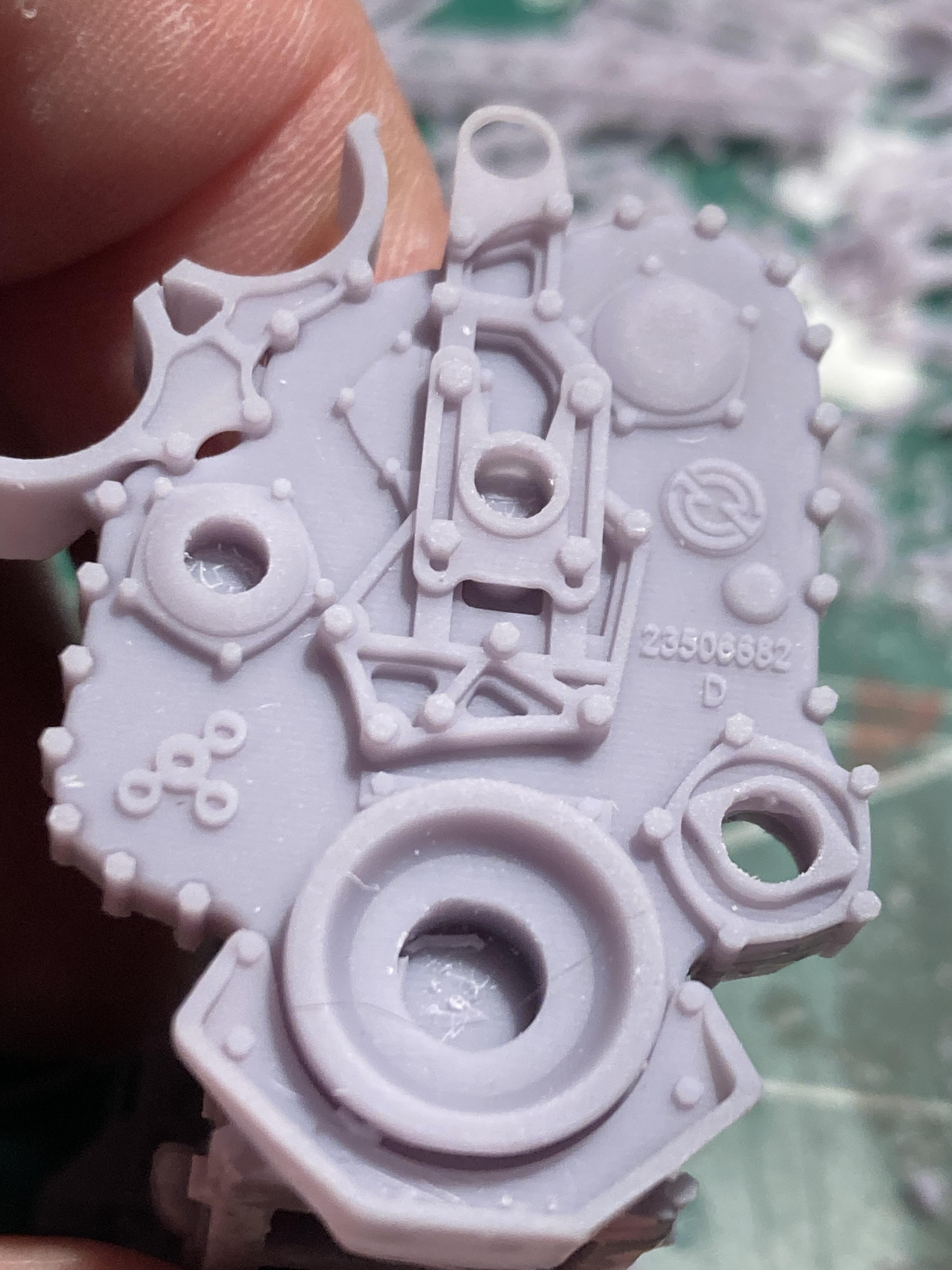

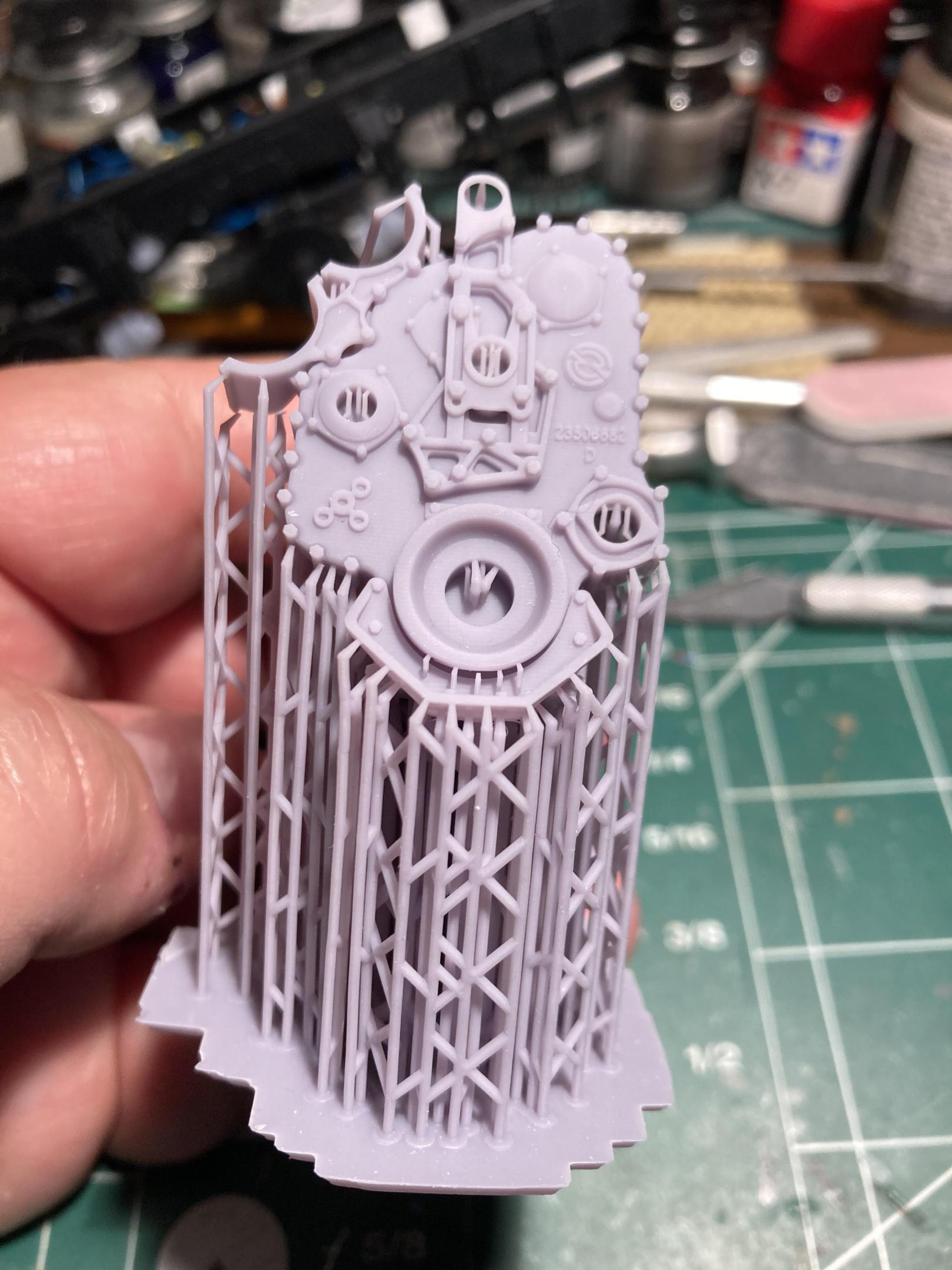

Biggu Posted August 13, 2024 Author Posted August 13, 2024 So a while ago a fellow on another site mentioned that GP Modeling was in the process of designing a 1/24 scale 3d 60 Series Detroit engine. I aww what was being offered and ordered one, from Spot Model who were excellent to deal with and I had to wait for about a month for it to be in production and shipped to me here in British Columbia. The detail is incredible. And screams for extra detail. ( see Randy’s build in the Floater Truck thread, his is off the clock) so I thought I would give it a go …. Here are some pics as it comes 1

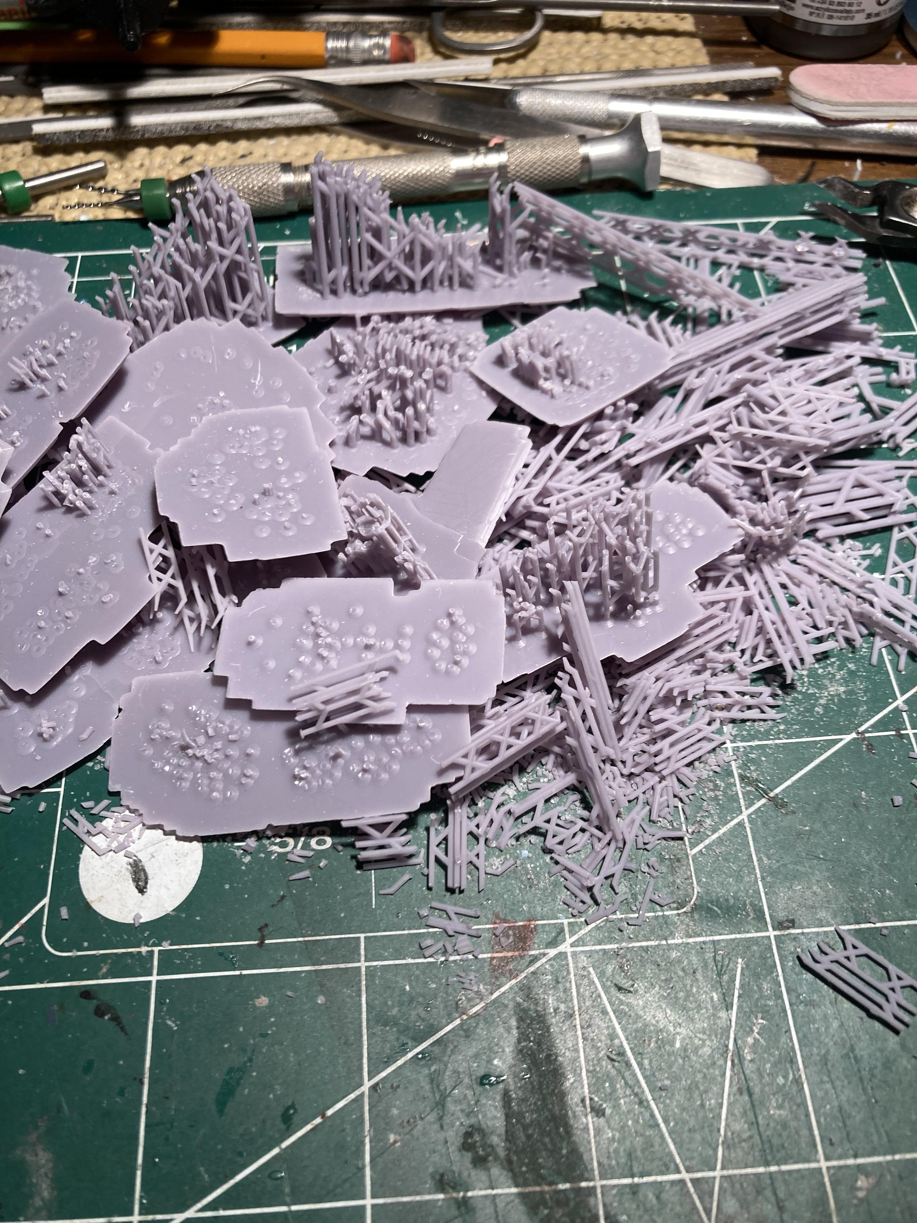

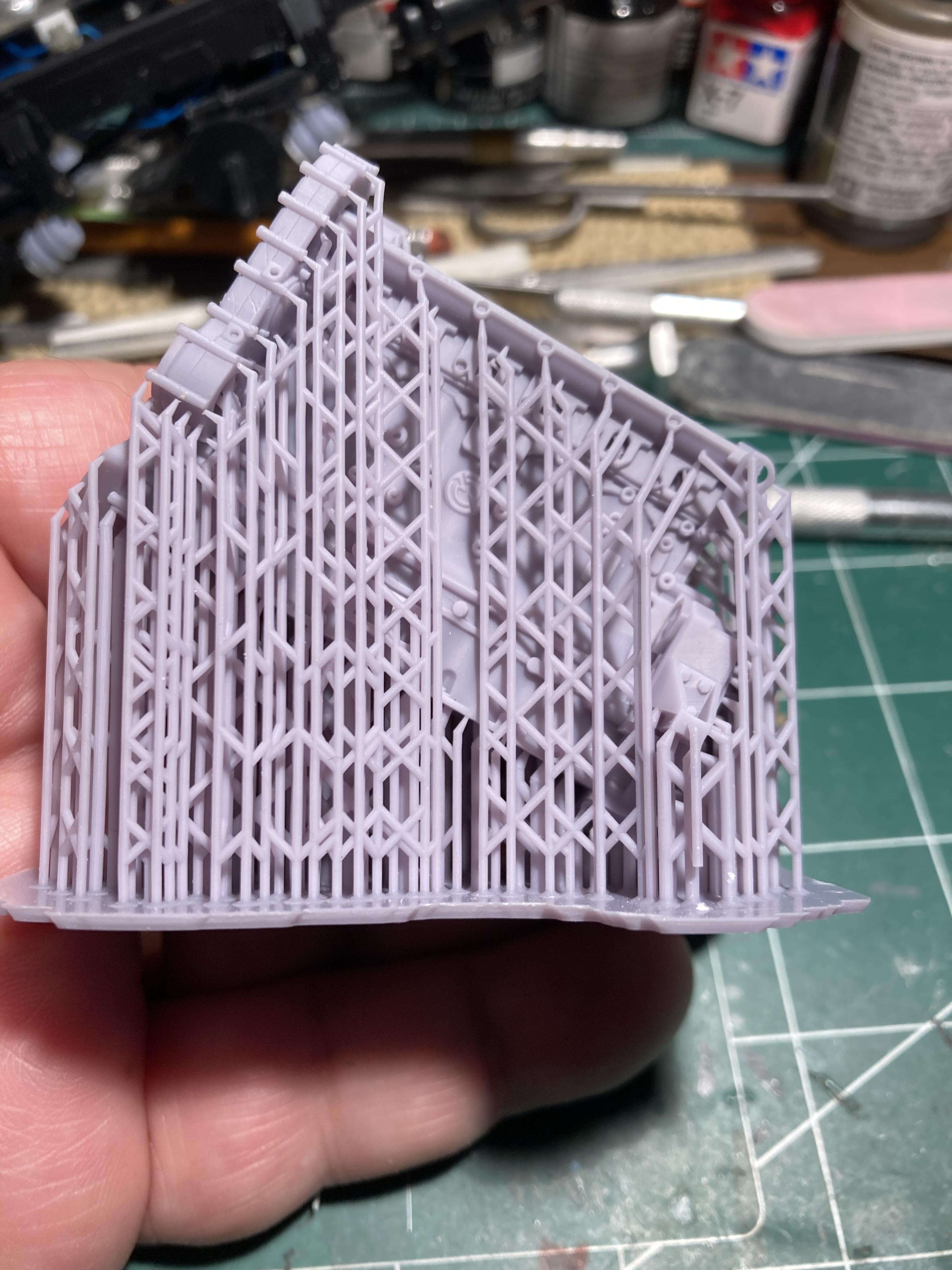

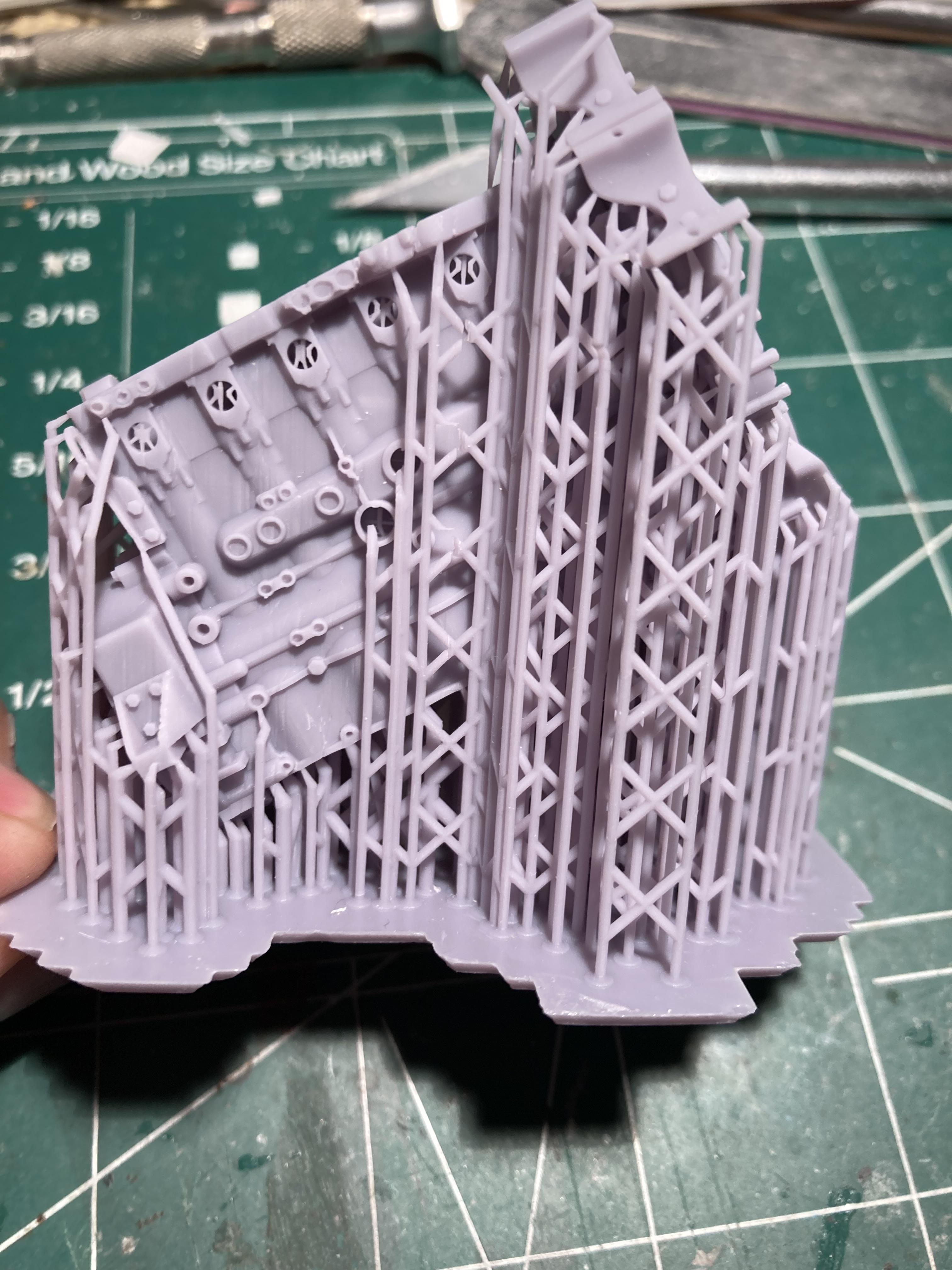

Biggu Posted August 13, 2024 Author Posted August 13, 2024 (edited) On the block there are 6 1/2 million contact points that need to be nipped off and it takes some time and patience but the little gem inside is more than worth the time and effort to clean it up. There is a fair bit of waste but that is the cost of doing business as they say . The pic is of all the waste bits for the whole engine and there is a bit Edited August 13, 2024 by Biggu 1
Biggu Posted August 13, 2024 Author Posted August 13, 2024 So in deciding what color I have that may be close to the Detroit color, I discovered that the early 60 Series were the old Detroit green and the newer units were the Detroit ‘blue’. I had a new bottle of Vallejo M-485 Blue Grey an acceptable color choice and with that gave the block a shot. This is my very first foray into acrylic paint as I am a die hard Model Master Enamel guy but someone decided that was to end so now I have to learn new tricks. I have to say so far the paint is good and went thru my airbrush smoothly … 2

gotnitro? Posted August 14, 2024 Posted August 14, 2024 Excellent work Jeff ! I can't get over the details on the Detroit engine, compared to kit offerings this is a huge improvement. I order from Paul quite a bit, very pleased w his selection 1
