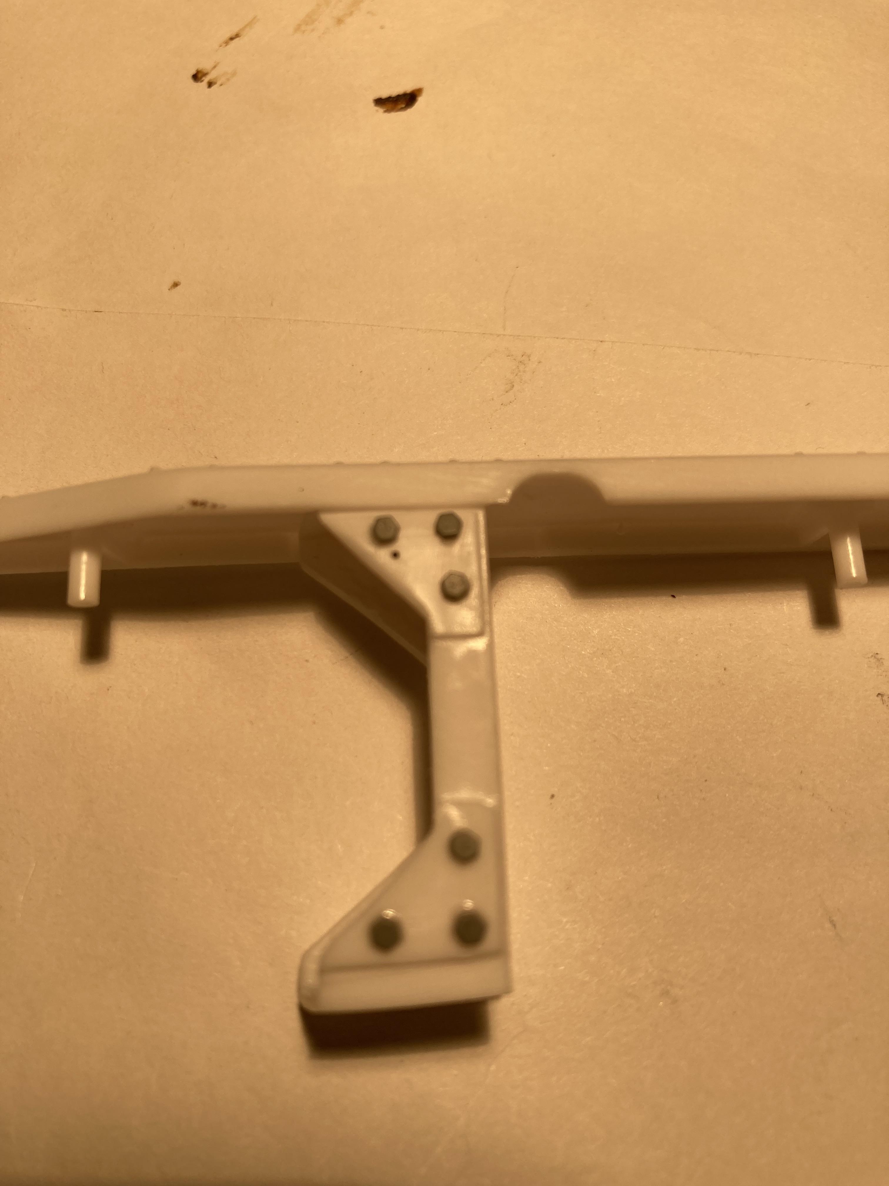

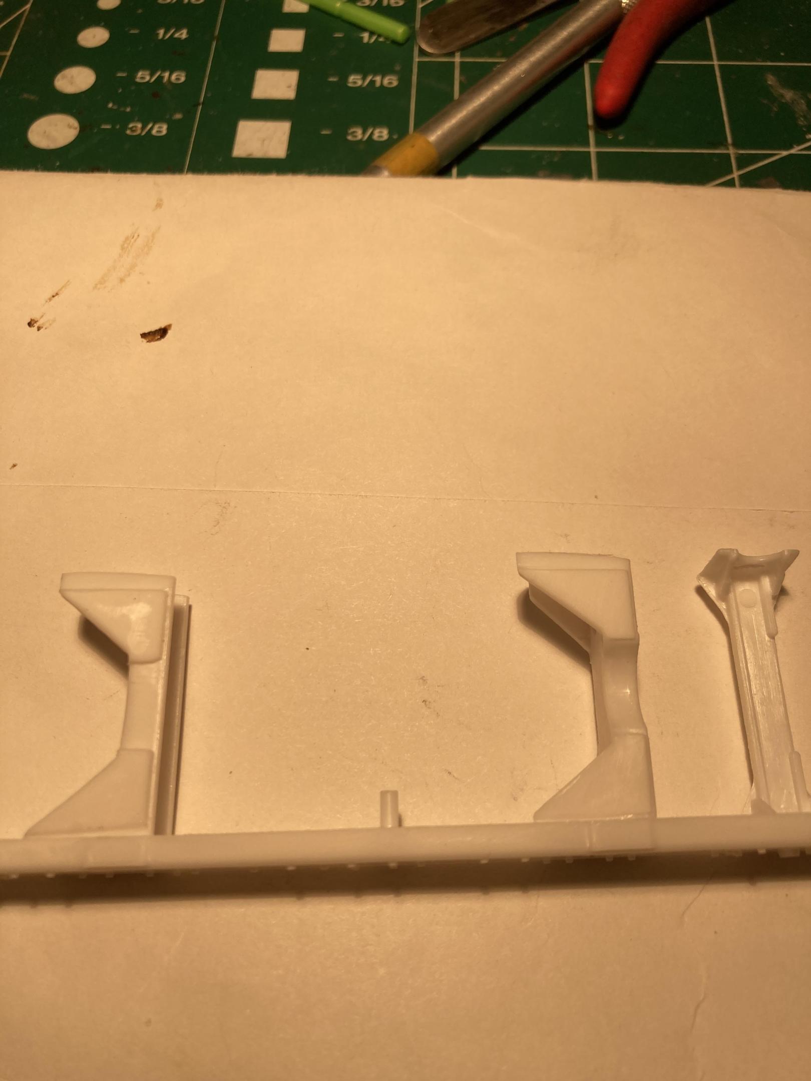

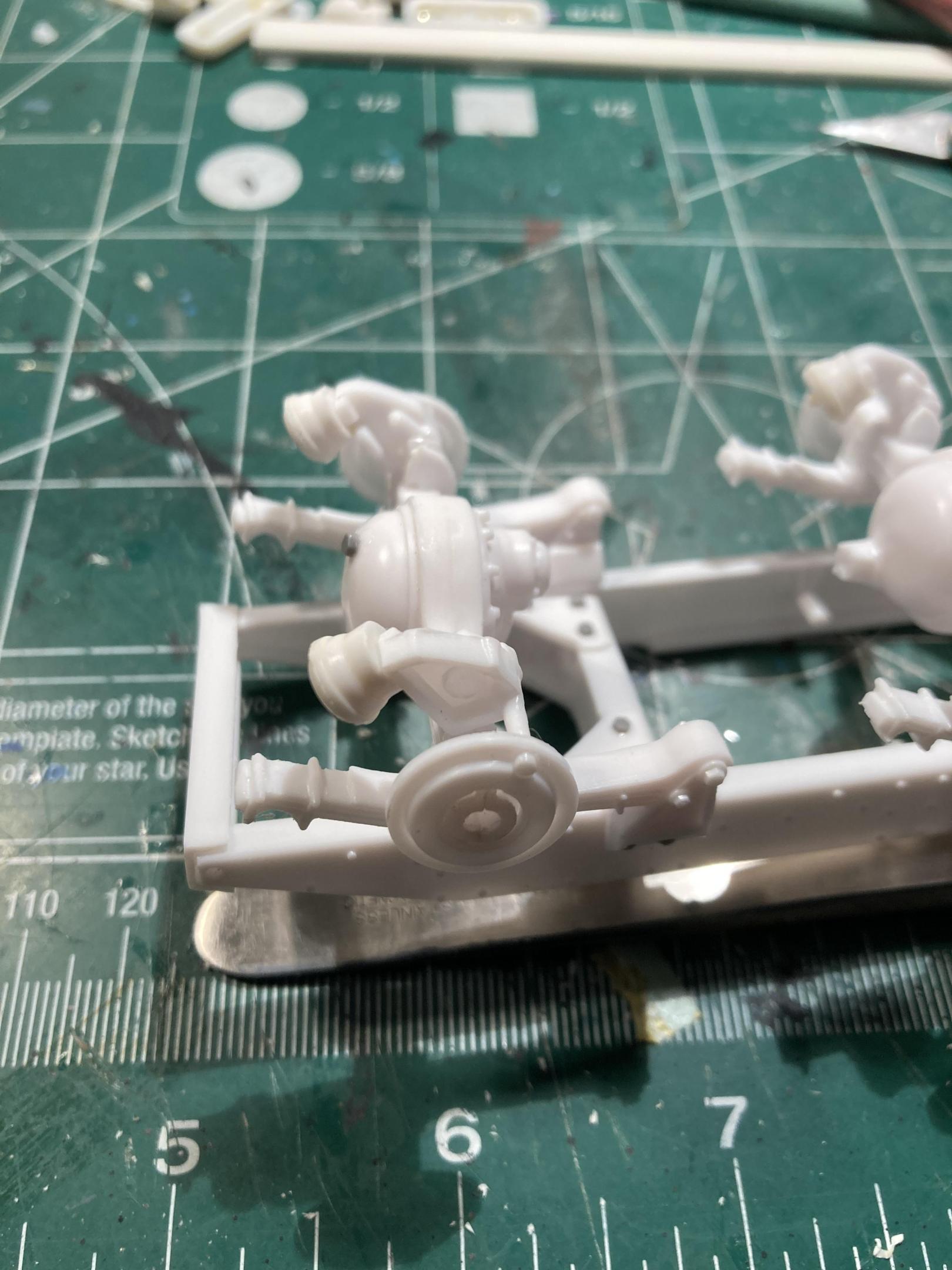

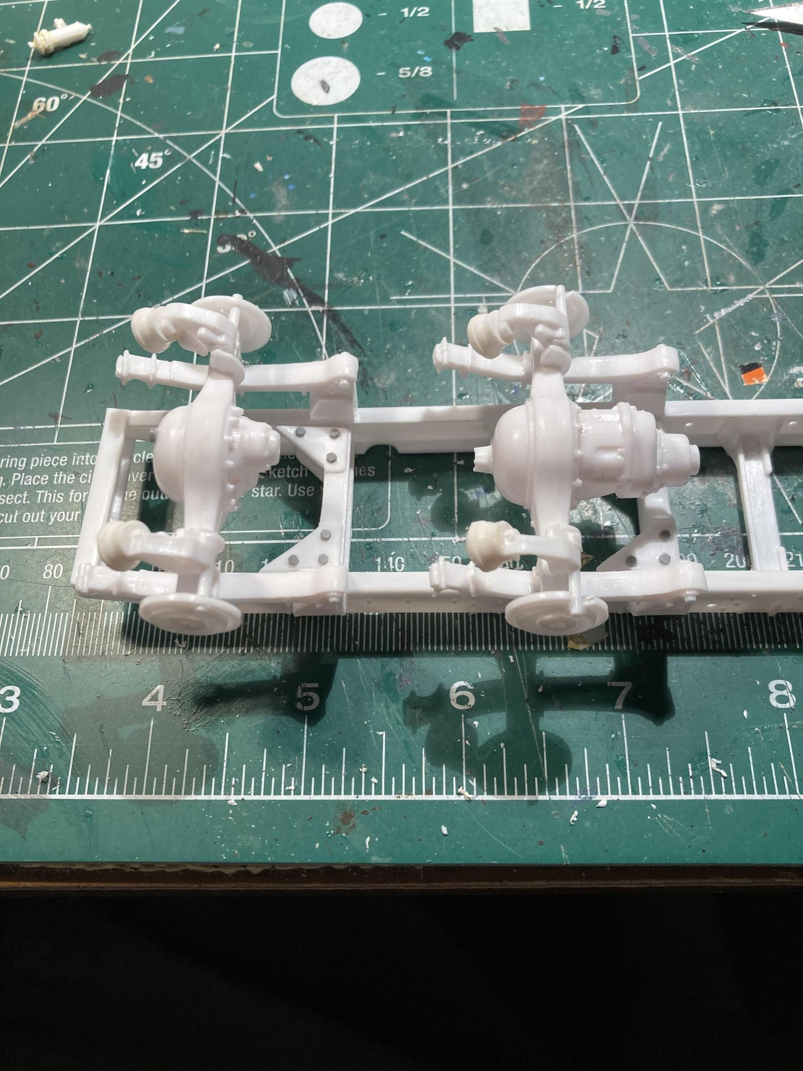

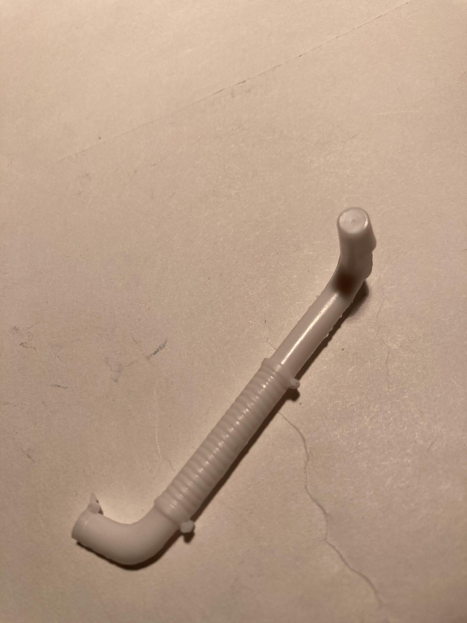

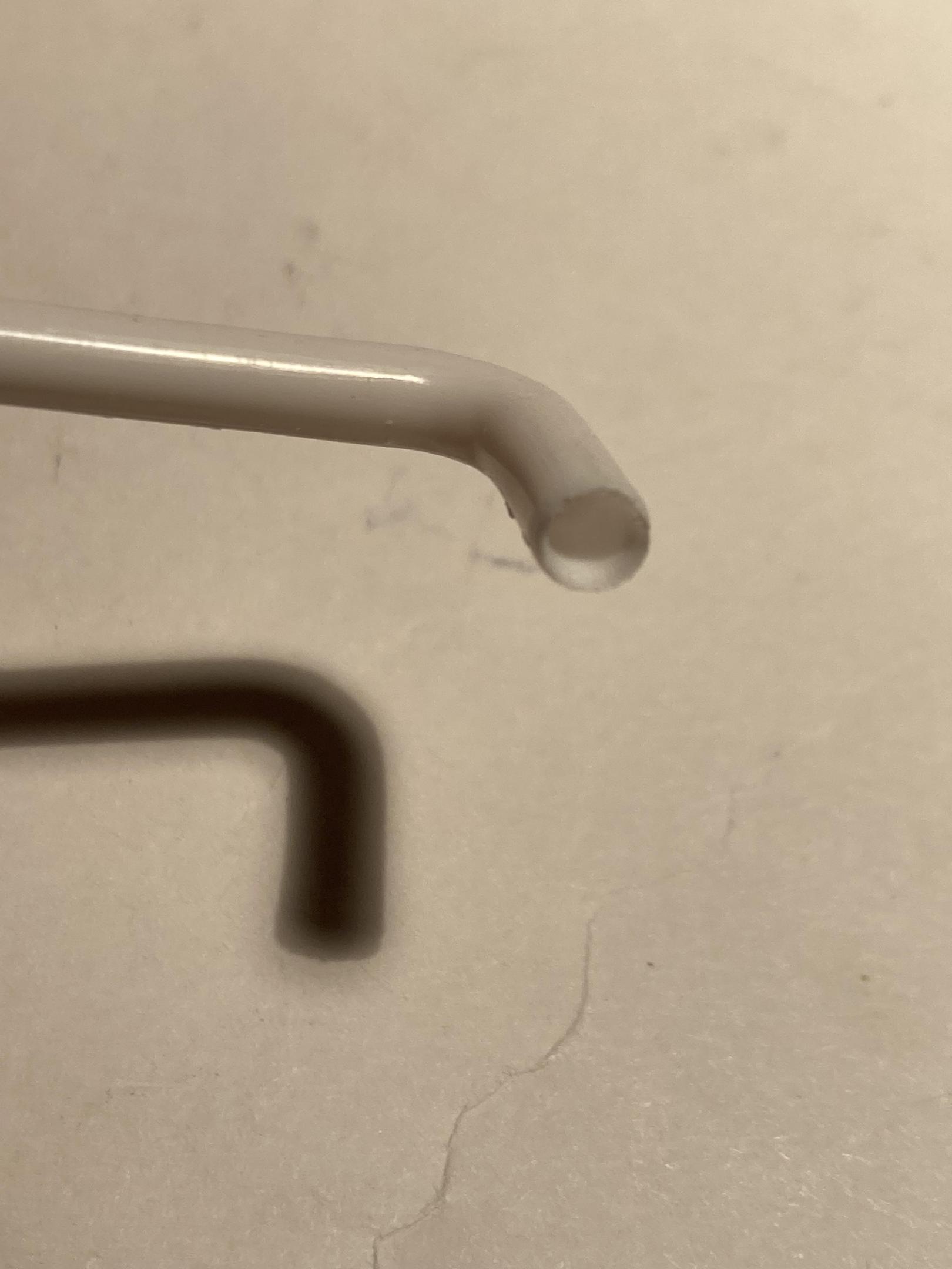

Biggu Posted October 13, 2024 Author Posted October 13, 2024 A little bit of a start. As with most of the old AMT kits there is a fair bit of clean up and filing and lots of fit , file , fit , sand , fit ….. well you get the idea ….. a lot of guys don’t like that part but to me that’s modelling. It would be boring if they all just dropped together, shake and bake style. Anyway got the frame done and added a few bolts to the crossmembers for some visual appeal. I also hollowed out the exhaust as when the cab is lifted, I think it will lend a little appeal rather than not having it hollowed out. 2

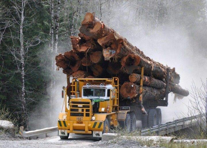

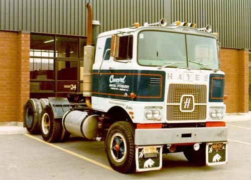

Biggu Posted October 13, 2024 Author Posted October 13, 2024 So, Hayes trucks started business in 1922 and the original name was Hayes-Anderson Motor Company LTD, and then is 1928 they decided to change the company name to the Hayes Manufacturing Company , Ltd. And in 1969 Mack Trucks bought a controlling 60 % interest in the Hayes Manufacturing Co. which was based in Vancouver British Columbia, and at that particular time Hayes was the Largest Canadian builder of heavy trucks in Canada. So, again , in 1971 the Company name was changed once more.... ( hard to keep up with this stuff sometimes ) to Hayes Trucks, Ltd, and that is the year the Clipper 100 Cabover was introduced. Prior to all this, Hayes were famous for manufacturing fire trucks, highway trucks, and their awesome off highway trucks mostly used for heavy logging on Vancouver Island and they were the HDX and W-HDX..... these trucks were and still are HUGE units, and can pack a massive load....see the pic A fellow by the name of Jack Curcio was hired by Mack Trucks in 1967 and later on was appointed President and managing director of Hayes and with Jack's leadership and foresight, production at Hayes rose from 50 to 500 units in the FIRST YEAR ! So with that more people had to be hired and the production crews went from 80 to almost 500 by 1973. Jack was given a lot of freedom as Pres and Manager and in 1971 the Hayes Clipper 100 Cab Over was introduced and was able to request the use of the F model cabs for the Clipper 100. So, that is why most of the Hayes Clipper cabs were looking like Macks, because Hayes was actually using the Mack F-model cabs........... so when does a Mack not look like a Mack??... when it's a Hayes..... Mack was Gracious enough to give Jack a lot of leeway, and he had expanded sales across Canada and was able to establish Hayes dealerships in the western U.S.A. including Hawaii and Alaska, and also other world markets.... read overseas... So the first Hayes Clipper 100 Cab over rolled off the assembly line in January 1971 , and a new Hayes production line was operational as of February 16, 1971. Jack Curico was doing his best to expand Hayes trucks and wanted to be a leader in the production of custom built heavy duty logging trucks, with the possibility of branching off into the oil field operations and of course the over seas markets as well as develop more highway heavy trucks. as a tid bit, Hayes received an order in 1971 for 26 identical 100 ton logging trucks and along with that 50 -100 ton pups to work off road on the Kemano project in north west British Columbia, and they were going to haul 200 tons of logs PER TRIP !! Now THAT'S heavy haul. but as a normal production this, Hayes regulatory built trucks and logging trailers from 20 tons to 60 tons.... just tell them what you want and bring your check book.... money talks ! Jack Curico, had aspirations to make Vancouver B.C. the Truck Capital of Canada, and he sure did a good job trying, but as things go changes once again were in line for Hayes.... in 1974 Mack sold Hayes to a company called Gearmatic , which was actually a subsidiary of 'Paccar" which is Peterbilt and Kenworth, as we all now know.... so............. for 1975 the Hayes Clipper 100 Cab Over now used the Peterbilt 352 Pacemaker Cab instead of the Mack F-model cab,............. BUT sadly that didn't last long as Paccar, closed the doors for the final time on Hayes trucks on September 30 1975. It was most likely a 'Board" decision as Hayes Cab Overs and the other units, were a direct competitor of Peterbilt and Kenworth ( Kenworth also had a factory near Vancouver B.C. ) So for now, my project is to convert the Pete to a Hayes.... and there are a few differences, so more research is needed.... I hope this is of interest and something a little different......... history is always fun... Jeff 2
Jürgen M. Posted October 14, 2024 Posted October 14, 2024 (edited) Wow, Jeff, that's a great curriculum of Hayes! Amazing knowledge! Thanks for sharing that! I like the one with the the Mack cab! Could be an interesting build! I didn't want to build another Mack since I've got five already but that would be a nice way of going around it and still having an F700 cab! Edited October 14, 2024 by Jürgen M. 1
Biggu Posted October 14, 2024 Author Posted October 14, 2024 On 10/14/2024 at 6:37 AM, Jürgen M. said: Wow, Jeff, that's a great curriculum of Hayes! Amazing knowledge! Thanks for sharing that! I like the one with the the Mack cab! Could be an interesting build! I didn't want to build another Mack since I've got five already but that would be a nice way of going around it and still having an F700 cab! Expand Thanks JM. Yeah I think the same thing and I was wondering if it could be done , the only thing that would slow me is the name plate letters that are above the front grille. I suppose a guy could use sliver letters …..????

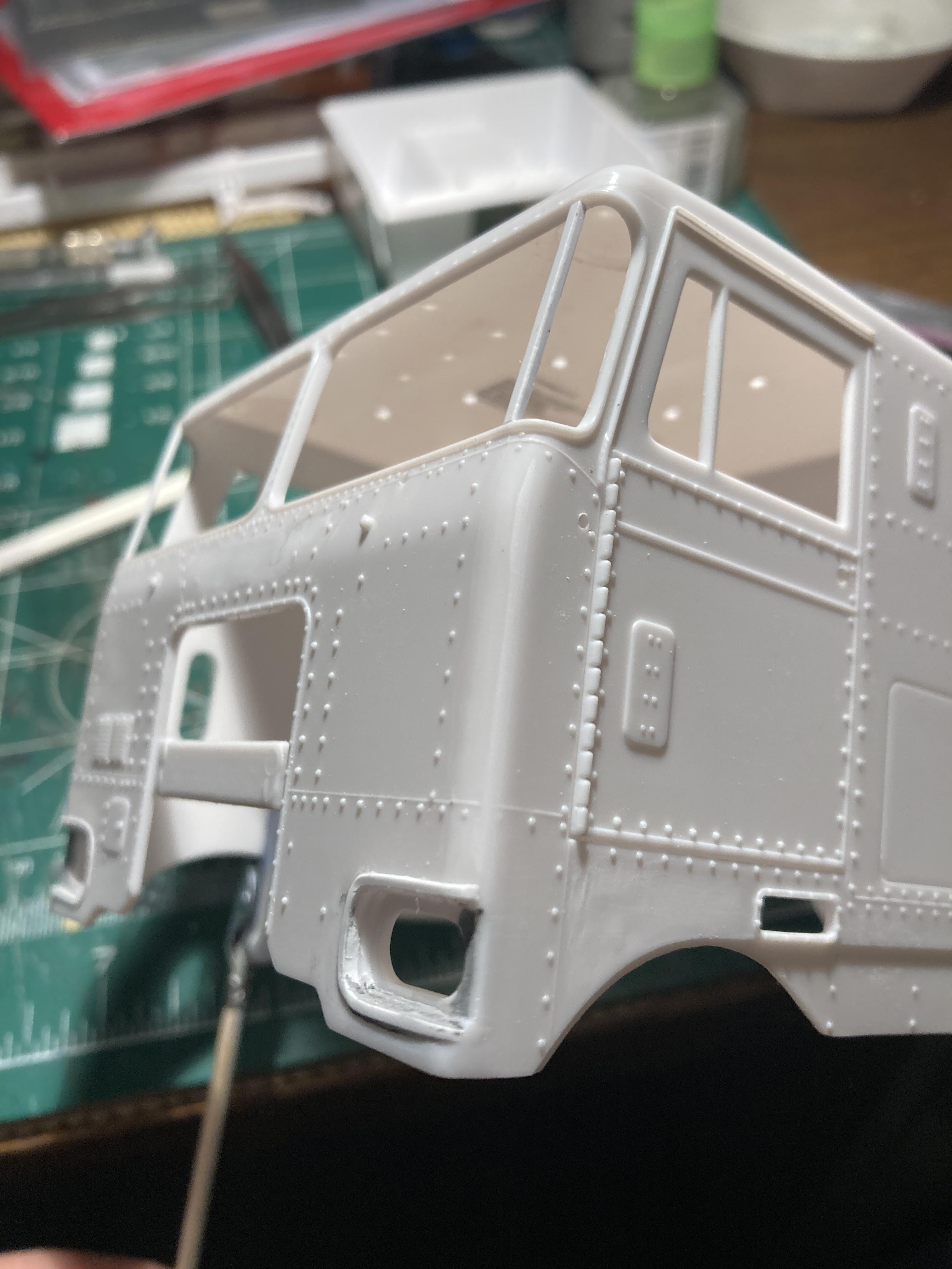

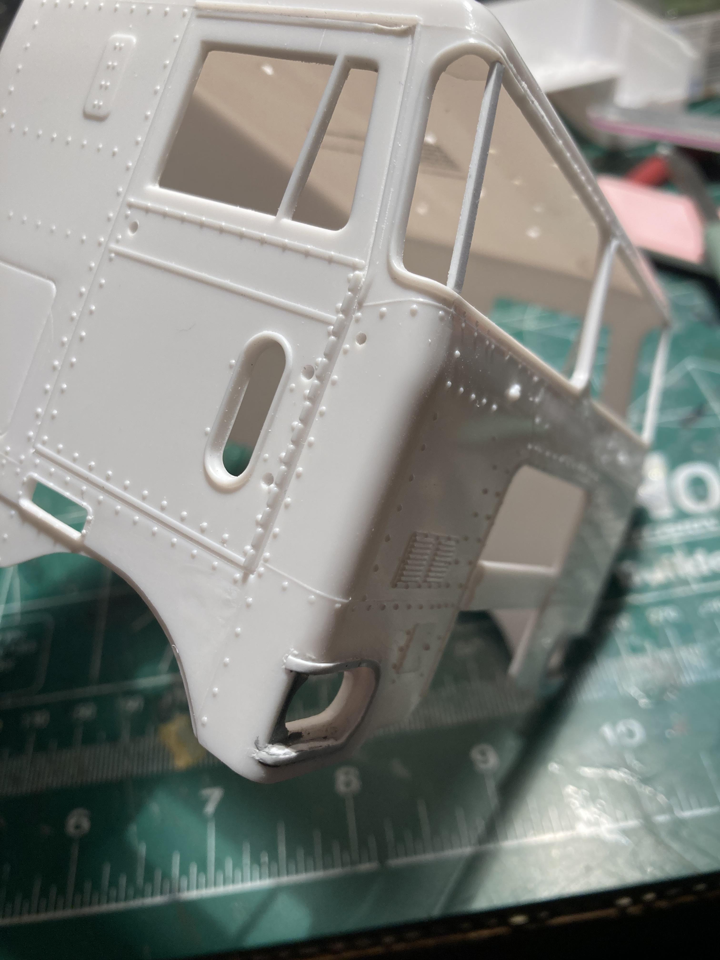

Biggu Posted October 14, 2024 Author Posted October 14, 2024 On 10/14/2024 at 4:09 PM, BK9300 said: Will you you have to do any body work during your conversion? Expand Nothing really massive, mostly removing the Peterbilt emblems and the grille surround details so that the new pe Hayes grille surround fits correctly. I had to add windshield corner supports. The fuel tanks had different options , some were exactly like the Pete 352 and others had large fuel tanks , so that may take some brain work. But nothing drastic. I’m trying to rework the head light buckets and still need a lot of work yet but another small detail. Also rounding the front corners of the cab just a touch as to my old four Mark 1 eyeballs look a little bit ‘sharp’ so just a little massage to maybe make it a bit different and maybe a little better appeal. Hopefully……..It will be subtle tho …. 2
Biggu Posted October 14, 2024 Author Posted October 14, 2024 Headlight buckets need a LOT more work...

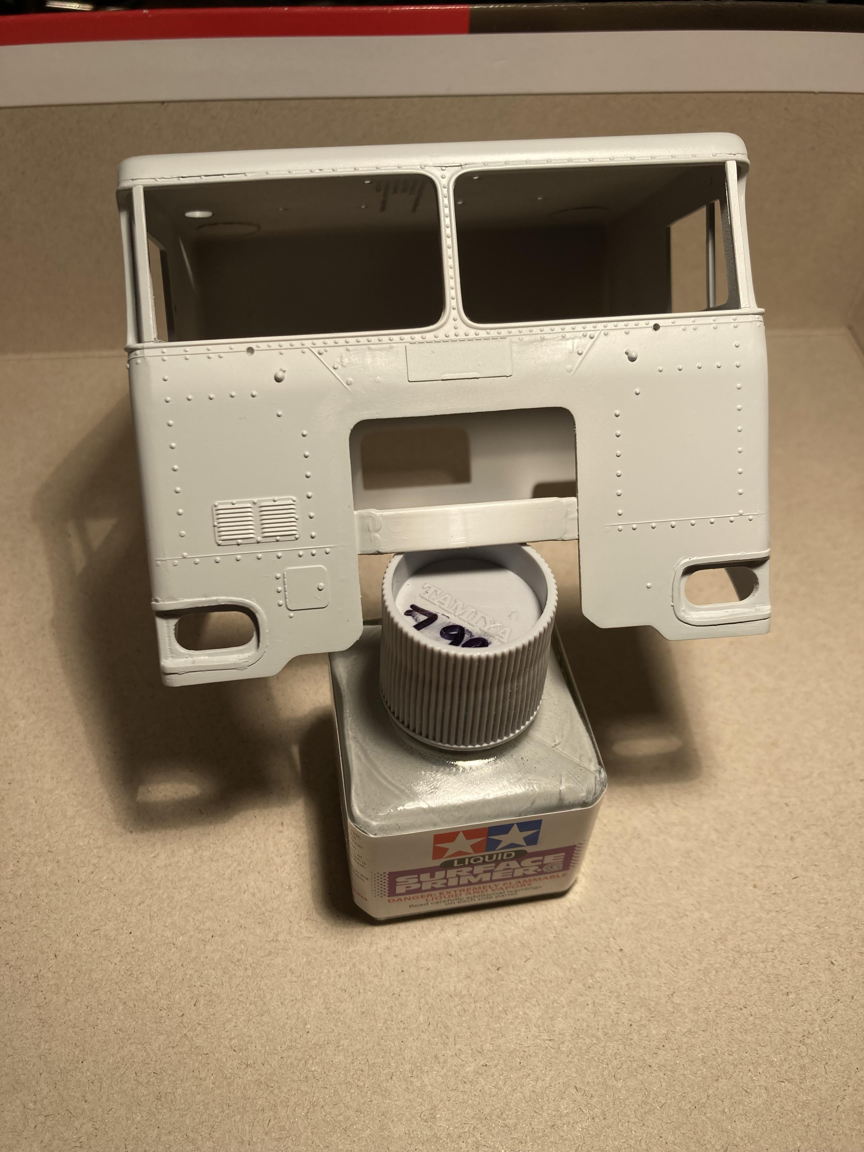

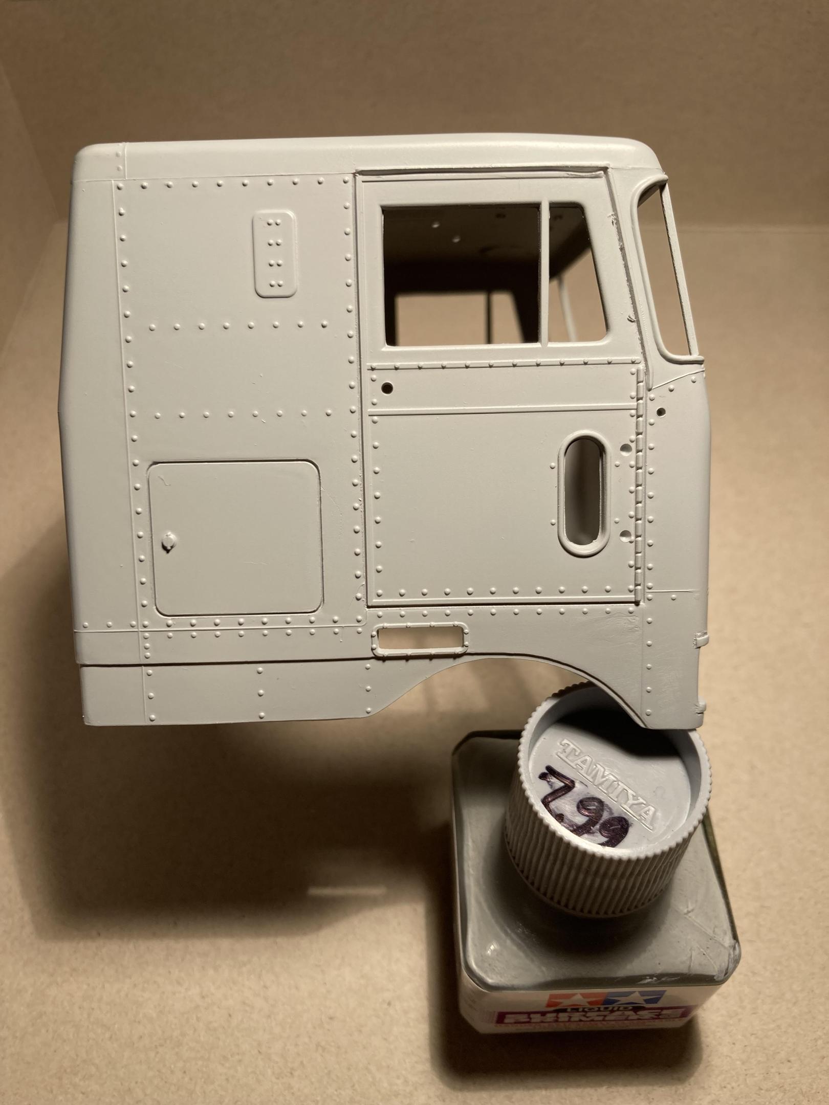

Biggu Posted October 14, 2024 Author Posted October 14, 2024 Ok ……. Take me out back behind the out house and slap me ……….. I see what goes on here with the paint thing….. most if not all of you guys do the primer deal on your builds and find all sorts of little details that need attention after a splash of primer and then also can show a pretty good job. I have a confession …… I have never used primer ….. ever….. and I have had some success with paint jobs although NOTHING like the caliber I see here on a regular basis. On a recent trip to Vancouver Island I stopped at a couple really good hobby shops and picked up some Tamiya grey and white primer….. so I thought I would give it a go, did some cleanup on “Pete Hayes” and gave him a shot. That primer is really nice to work with. And after this long winded explanation , the cab doesn’t look too bad under a splash …..still one or two little details to be addressed but over all for a first effort I’m fairly pleased. 1
Gary Chastain Posted October 14, 2024 Posted October 14, 2024 Looking good, sometimes I have to primer several times, each time working out an issue then do it again. 1
Biggu Posted October 14, 2024 Author Posted October 14, 2024 On 10/14/2024 at 8:30 PM, Gary Chastain said: Looking good, sometimes I have to primer several times, each time working out an issue then do it again. Expand Thanks Gary. That may very well be the case here but so far I’m pleasantly surprised how well this looks………so far. I will leave it for a bit and then I’m sure I will see all sorts of flaws but this is not going ro be a show truck bit a working truck, so a blemish or two would be authentic. Thanks for the tip.
Biggu Posted October 14, 2024 Author Posted October 14, 2024 On 10/14/2024 at 8:30 PM, Gary Chastain said: Looking good, sometimes I have to primer several times, each time working out an issue then do it again. Expand You were right... I found that I had to plug some pre-drilled holes for the air horns, so that they can be moved forward when install time comes... so plugged the holes and then had to do a little filling, then sand smooth.......... one issue dealt with... I'm sure I will find more... 1
