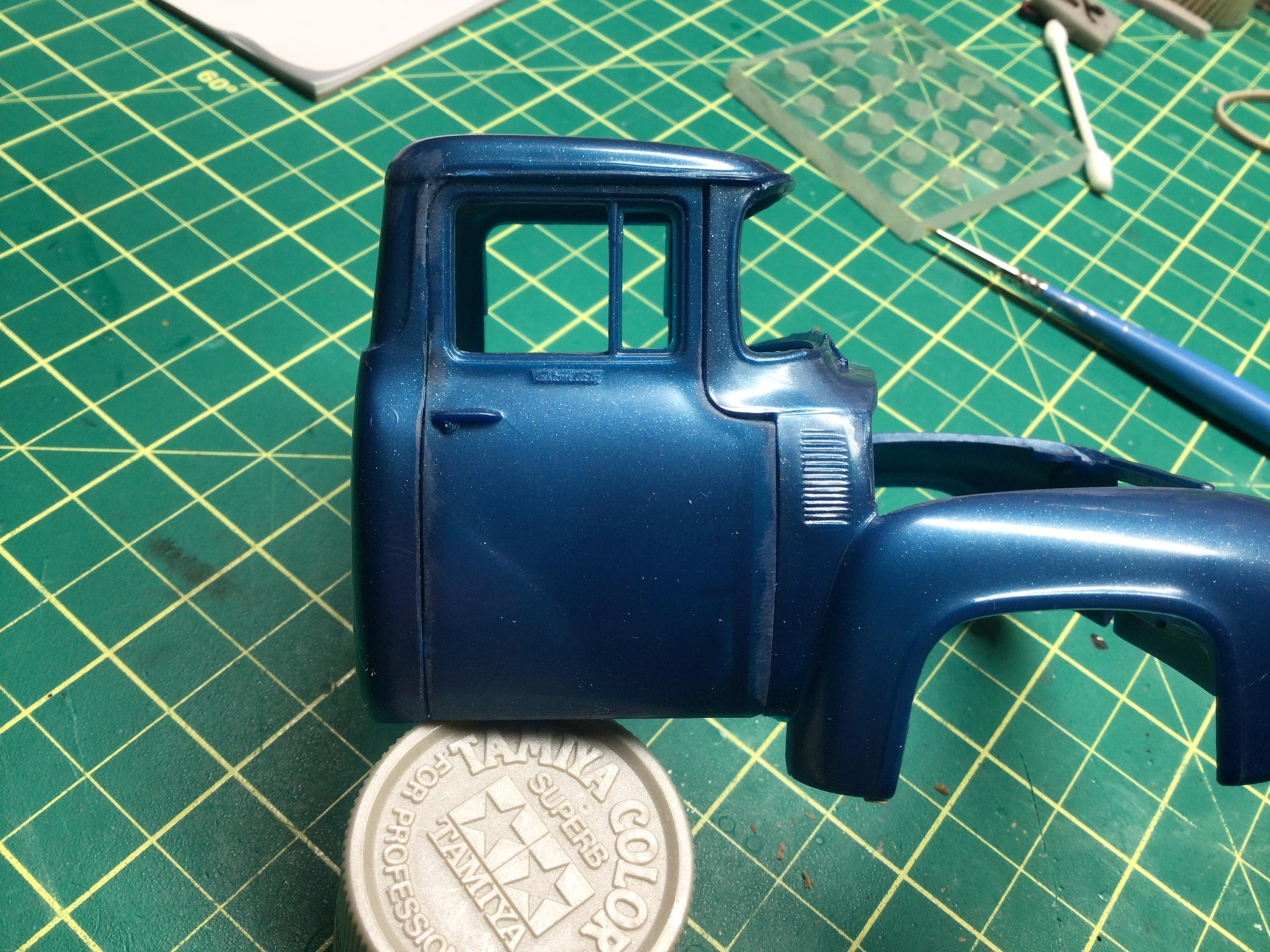

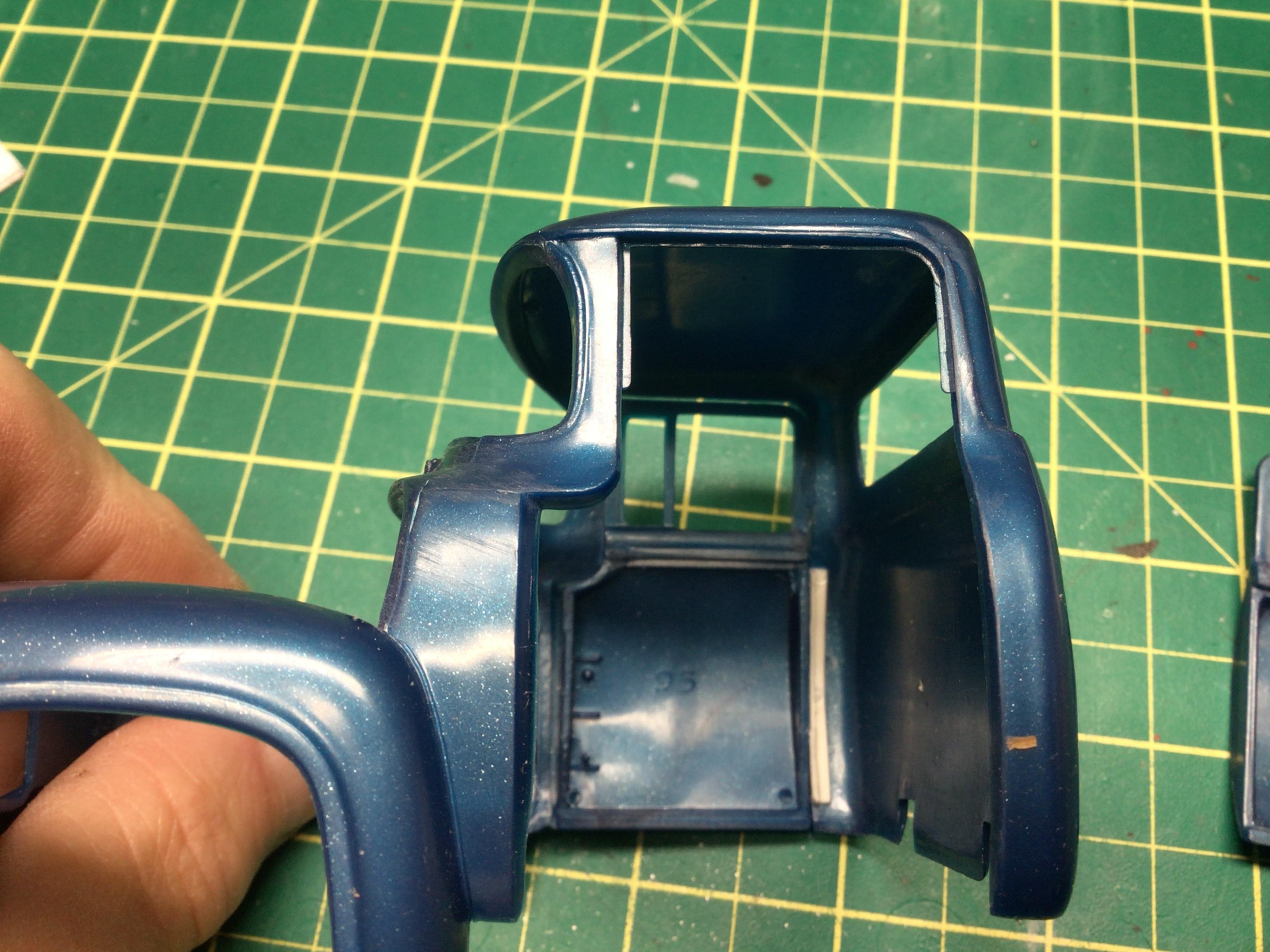

I thought the same when I got this kit and started to glue the doors shut. The door gaps are not too bad so with a few reinforcements on the inside, they should look OK. I gave up on it because I’m not a huge fan of these trucks.
Hey, thanks for sharing those pics. Is that as far as you got with it? Id love to see even more pics, even if not finished. I wonder if I could glue a thin strip of styrene to the front edge of the door and sand and fill it. and make the doors a much tighter fit. not sure if they sell strips that thin though. any thoughts? thanks again for sharing !

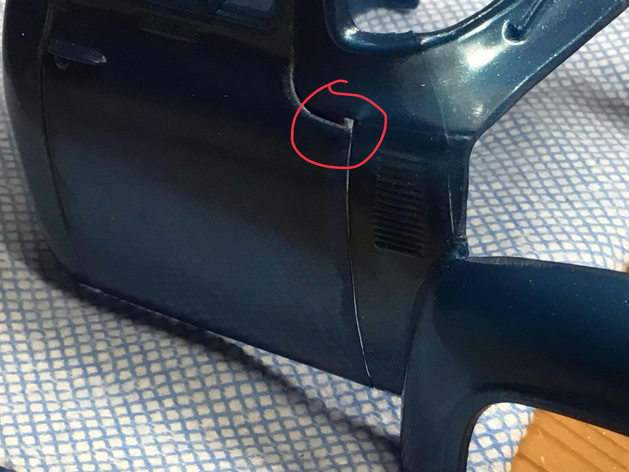

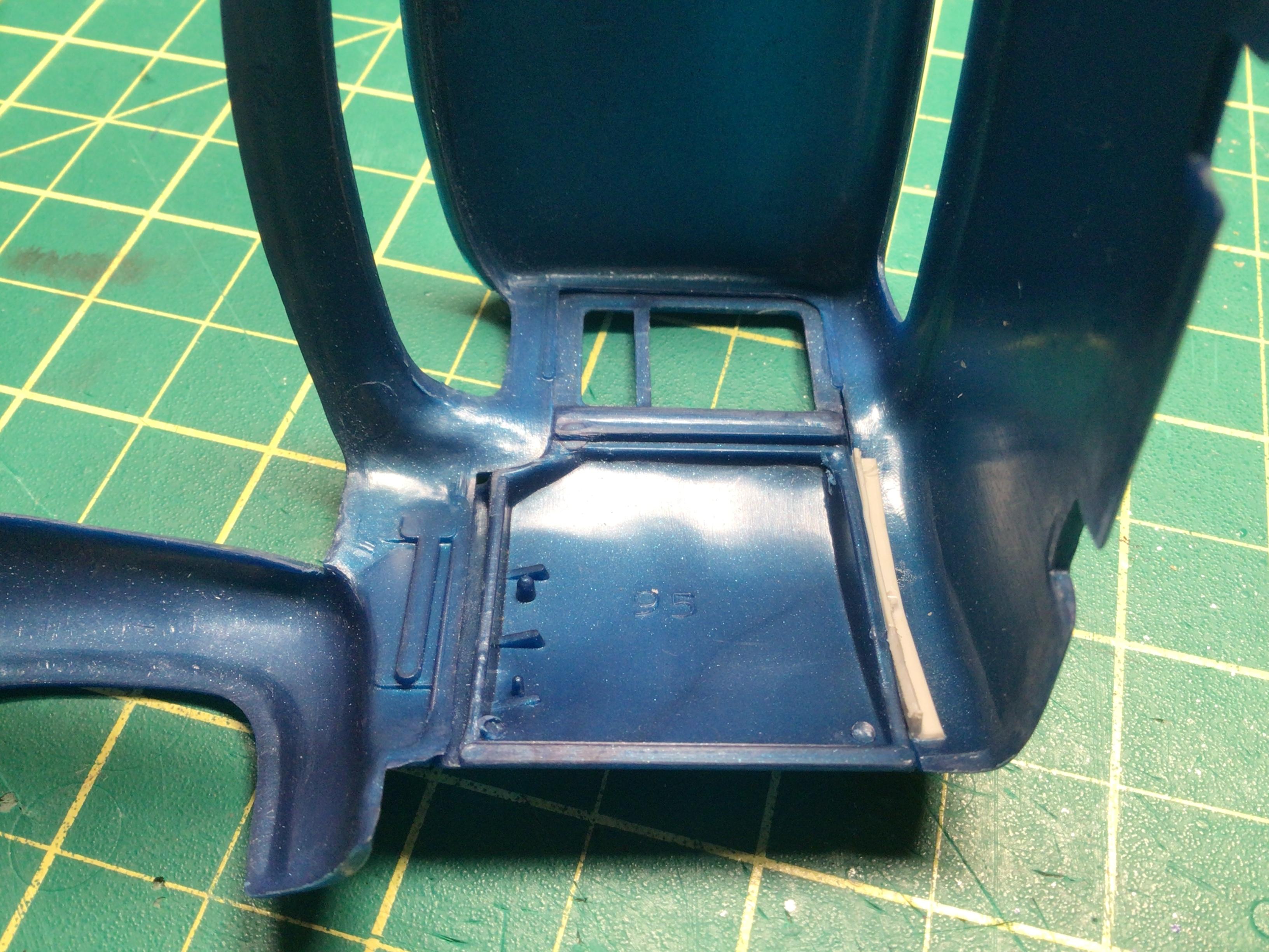

Yes that is as far as I got. I think the door fits pretty good and the gap looks OK as is. There is already a lip on the top half for the door to sit against and it  just needs to be extended down the latch side. The front edge might need a thin piece added inside the body for the door to be glued to. The only bad spot is the corner at the cowl which may need some backing or filler?
