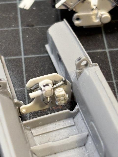

Pg265 Posted September 9 Posted September 9 Hi, Great job! Nice machined parts which bring a beautiful realistic mechanical touch. Hope to see more of this enjoyable WIP. Pascal

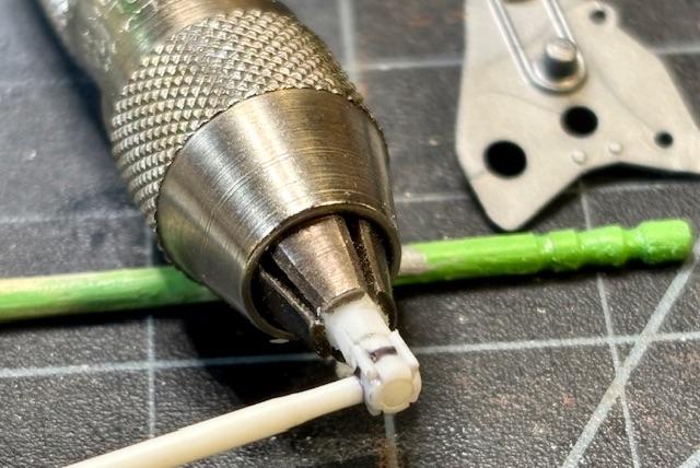

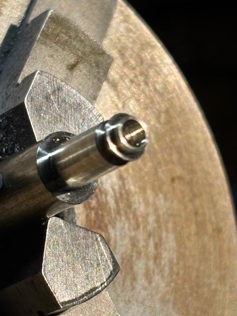

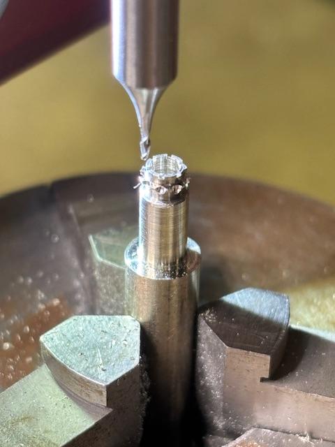

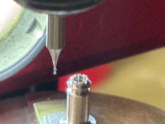

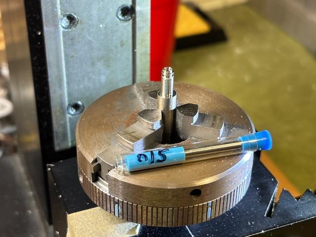

absmiami Posted September 17 Author Posted September 17 Thanks PG and Charlie - the fuel pick up was turned fr Nickel silver rod …. The teeth on the rim of the pickup were cut on the mill using an .015 mill - thats the smallest one that i’ve got - that i haven’t broken - looks like its about the right size … 2

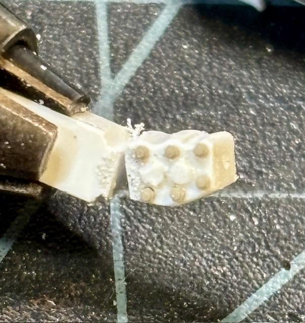

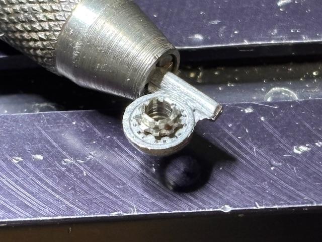

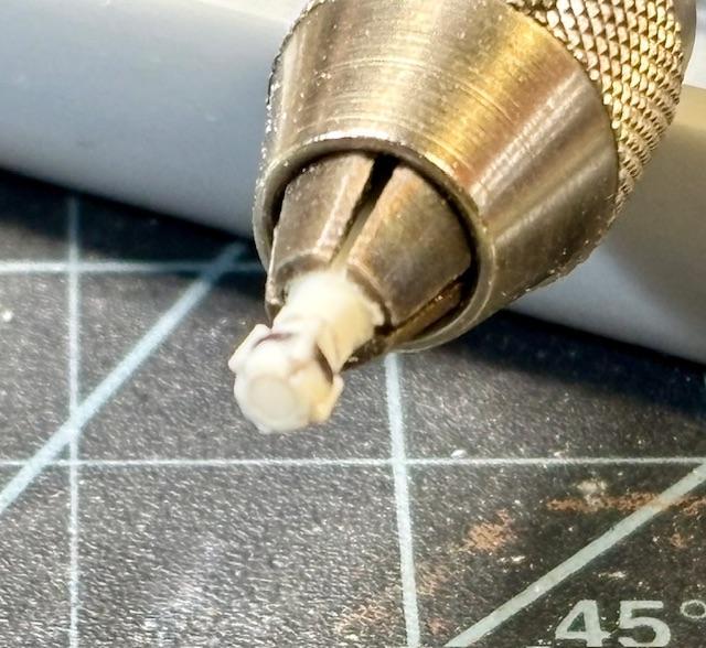

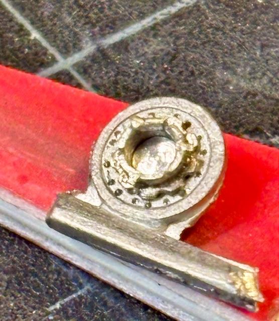

absmiami Posted September 17 Author Posted September 17 (edited) Next trying to solder pegs into three of the six teeth - thats why I used nickel silver rod- Edited September 17 by absmiami 2
absmiami Posted September 17 Author Posted September 17 The above mite be confusing - the teeth on the rim are cut w an .015 mill - the scallop shapes on the rim are cut with an .031 mill - clear as Mud ?

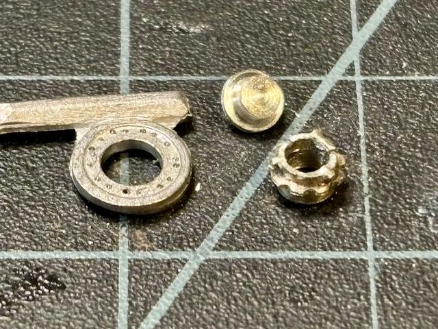

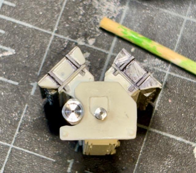

absmiami Posted September 17 Author Posted September 17 So i’ve ended up w these three parts for the moment - but i mite ditch the wh metal ring and make one w 12 bolts - which is …. err … nuts - therapy pl … 1

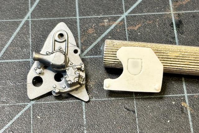

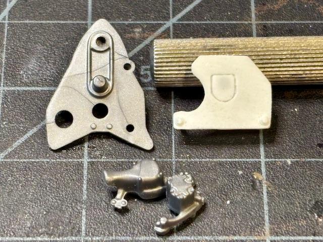

absmiami Posted September 17 Author Posted September 17 Needing a fuel pickup break - these are the front engine plates - the left hand is the 20th sc plate for the fuel injected Climax engine in the Tamiya kit - with the water and oil pumps - good stuff - the right hand plate is the simpler on that i made for the ‘62 Climax engines - which sported Webers … 1
absmiami Posted September 17 Author Posted September 17 So i’ll make some pumps for my plate - slightly smaller than the corresponding Tamiya parts … 1

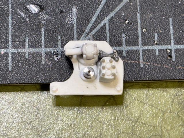

absmiami Posted September 17 Author Posted September 17 Bits and peices of Evergreen with some .06 bolts fr Master Club … 1
absmiami Posted September 17 Author Posted September 17 And i “borrowed” the portions of the Tamiya pump parts for the water pump lines to both Cyl heads … 1
absmiami Posted September 17 Author Posted September 17 Once this plate is done I’ll make The seperate plate for the fuel injected engine - like the tamiya part - it has to include the pulleys that drove the mechanical fuel pump in the V of the Climax engine … 1

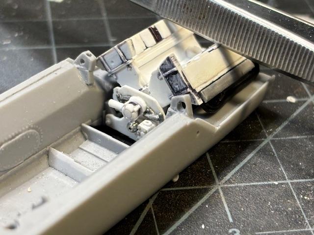

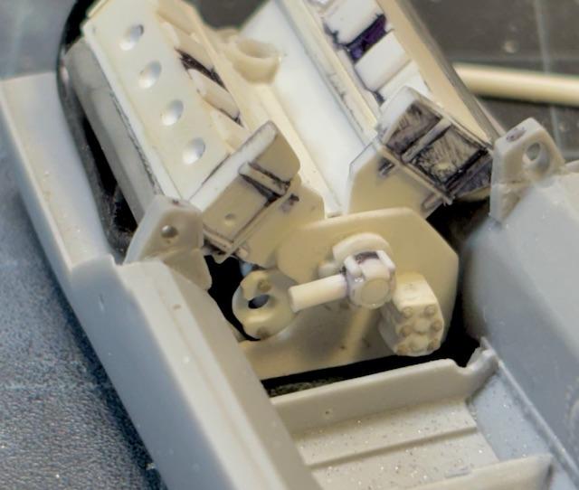

absmiami Posted November 26 Author Posted November 26 Some eng parts mockup - you can really see the quality of the castings on these shots 2

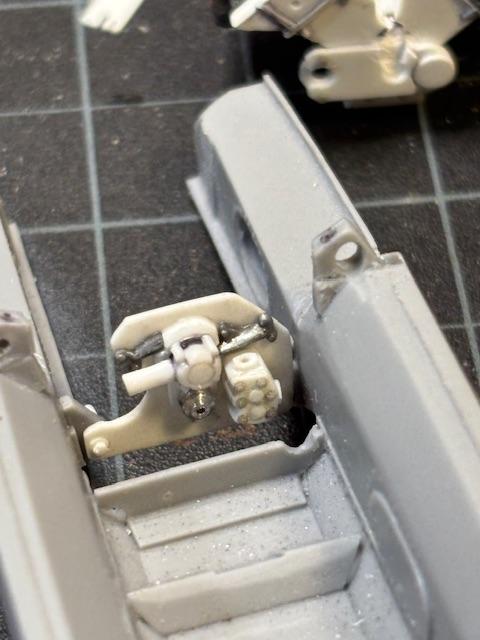

absmiami Posted November 26 Author Posted November 26 (edited) Bulkheads behind the seat … There’s an opening in one of these for a fuel bag photo on page 2 of this thread shows an opening for a fuel bag - thats an early chassis - so i think i’ll add this feature … Edited November 26 by absmiami 2
