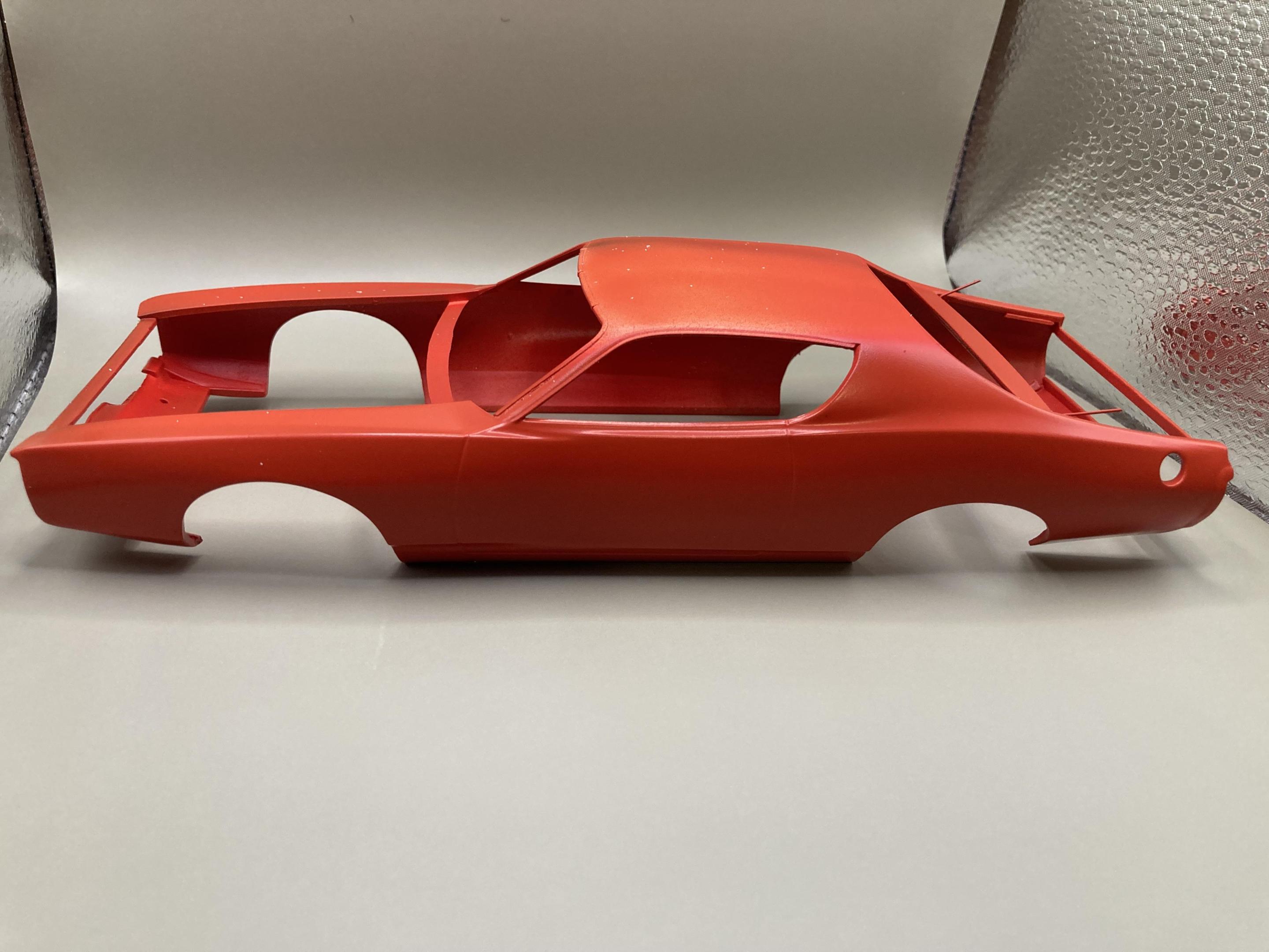

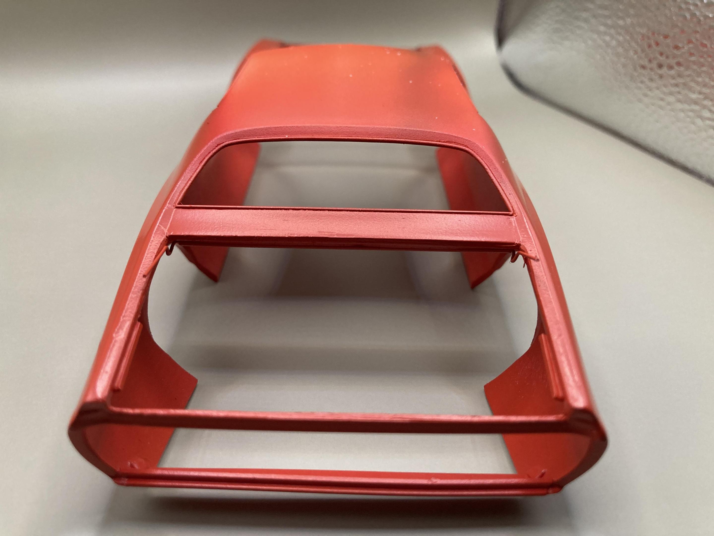

I need to mask this to be able to spray the top sections of the body gold. Has anyone been through this exercise in the past and have any tips that they could offer as to the best approach?
29 minutes ago, Horrorshow said:
Normally, I would spray the whole body gold, then mask for the red.
Less to cover that way..

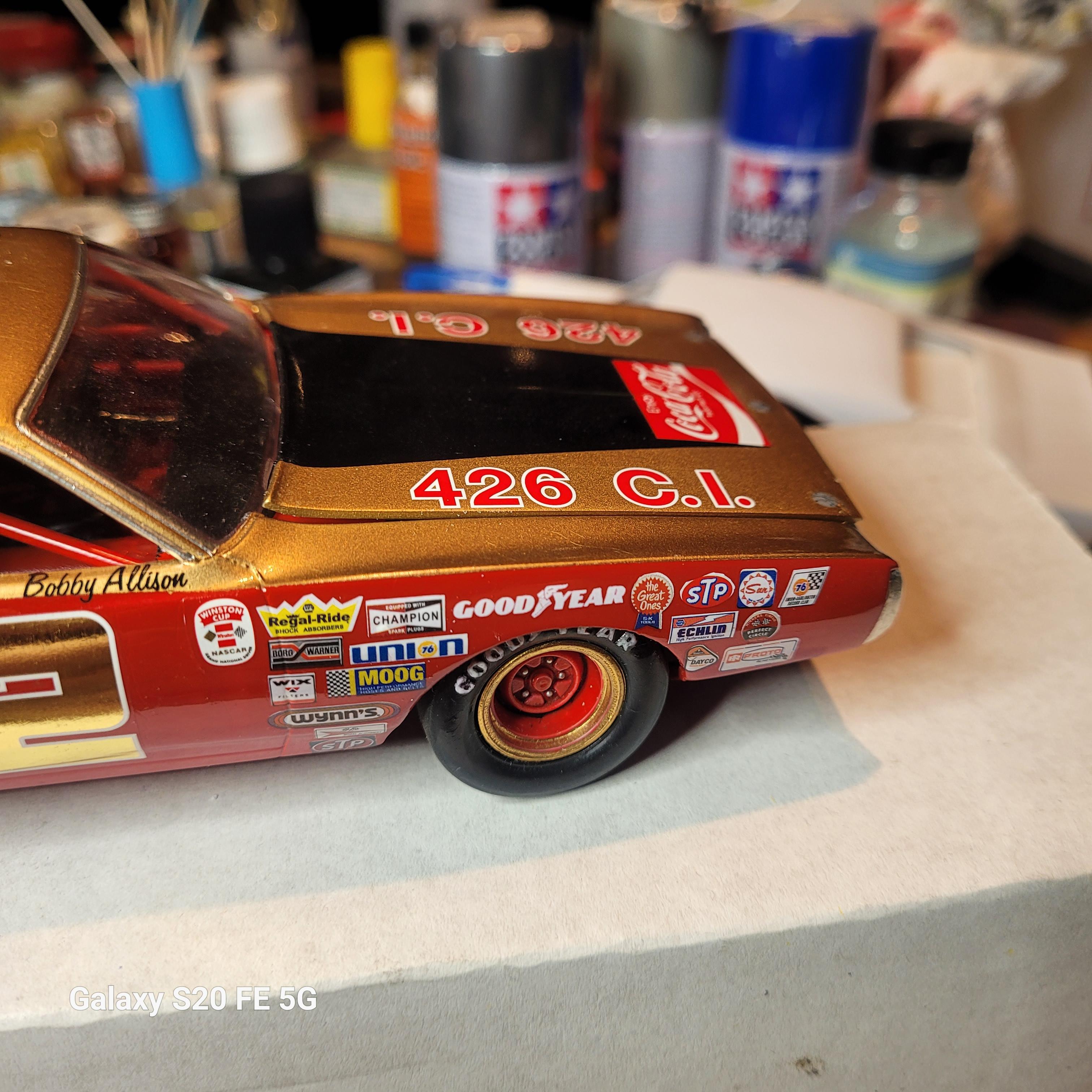

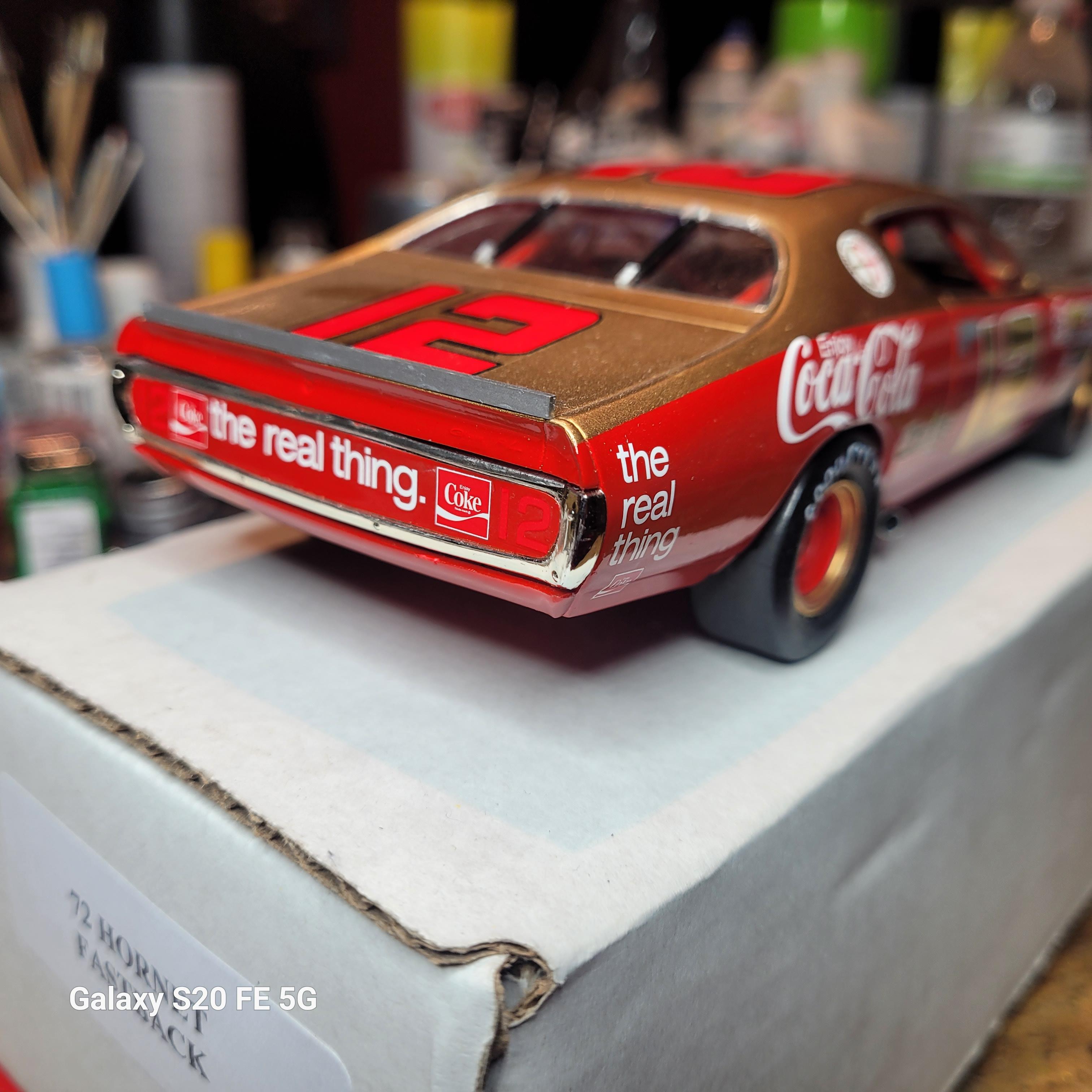

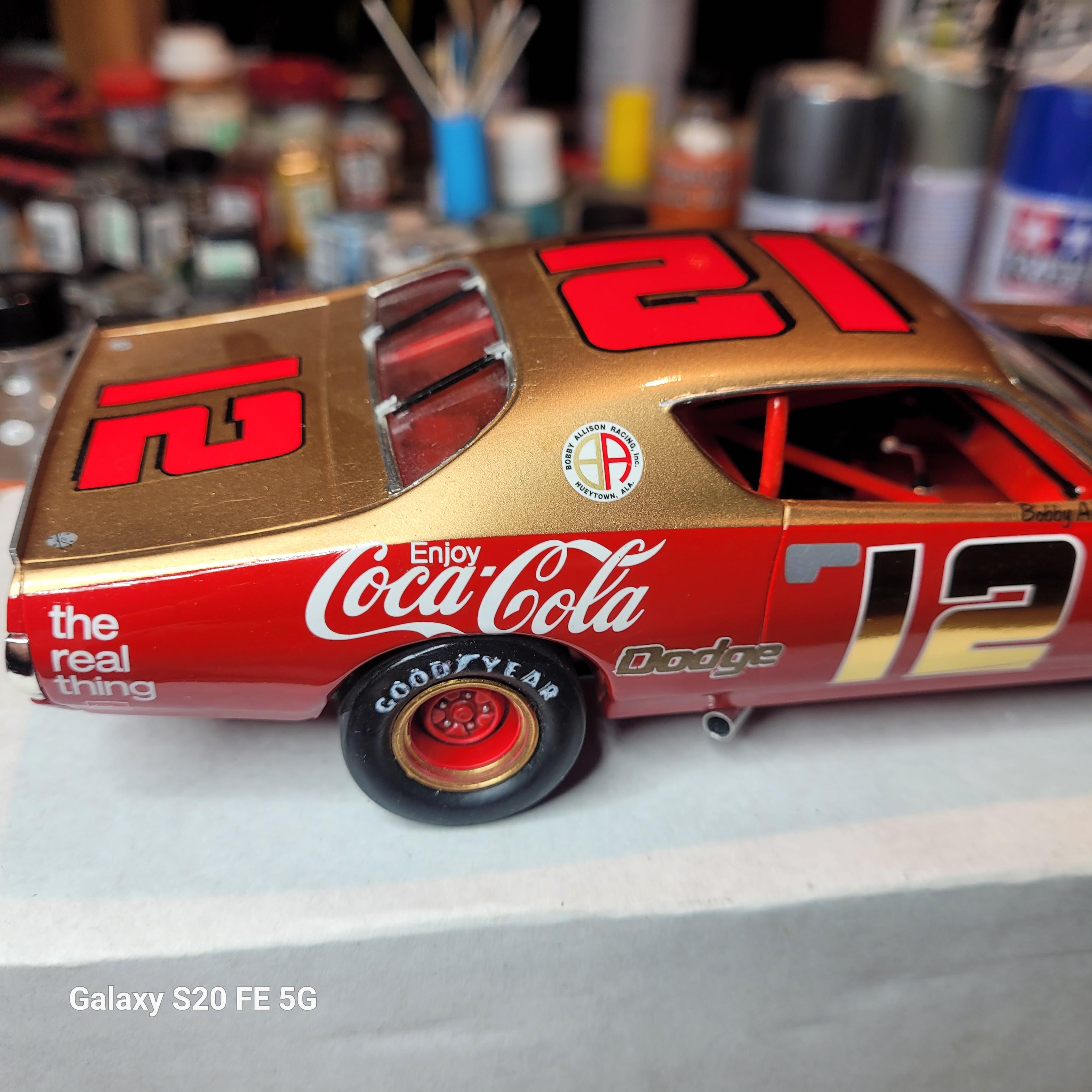

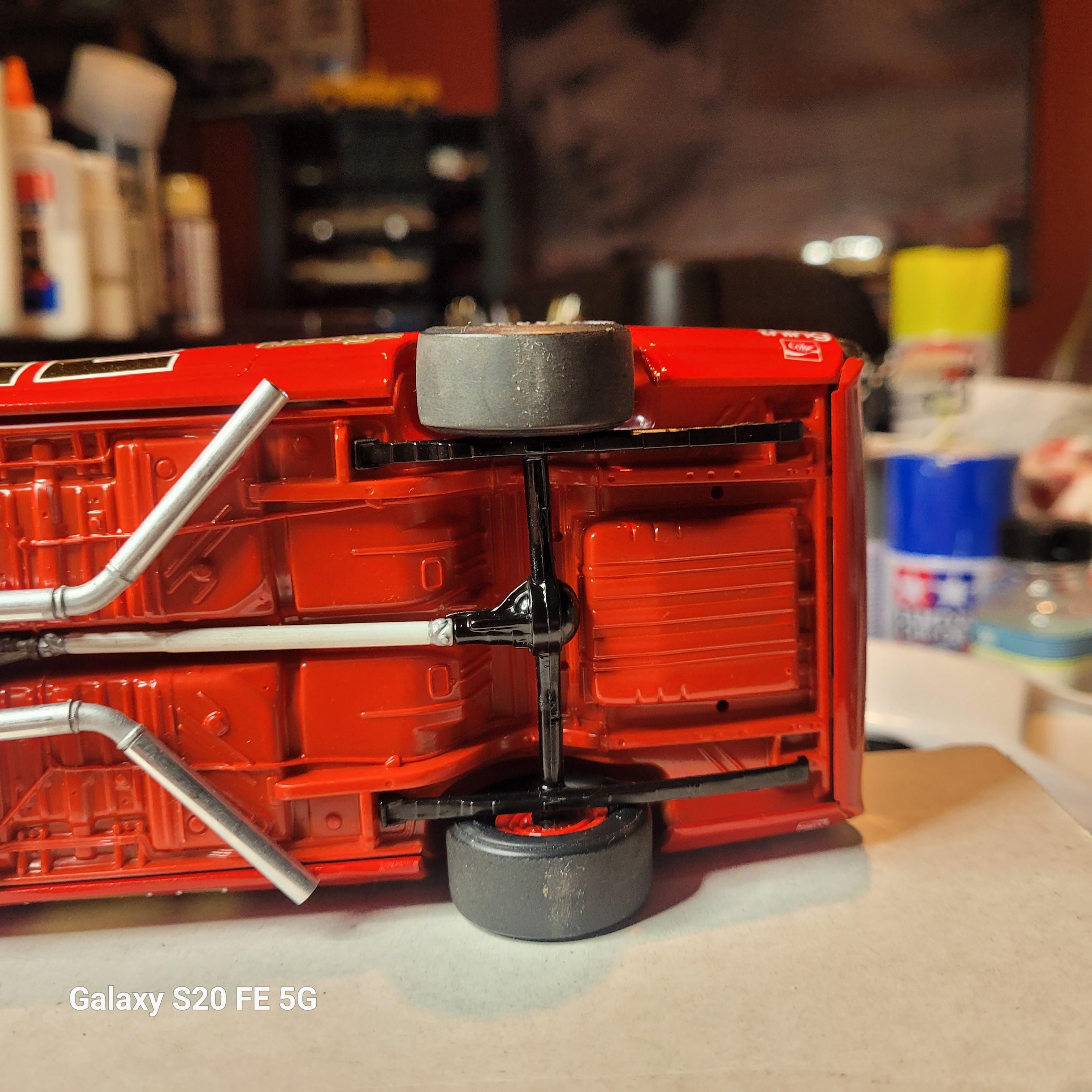

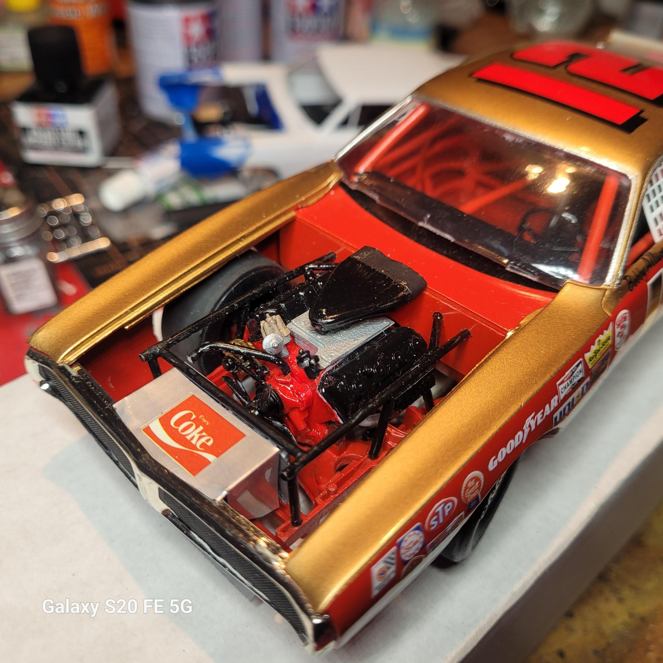

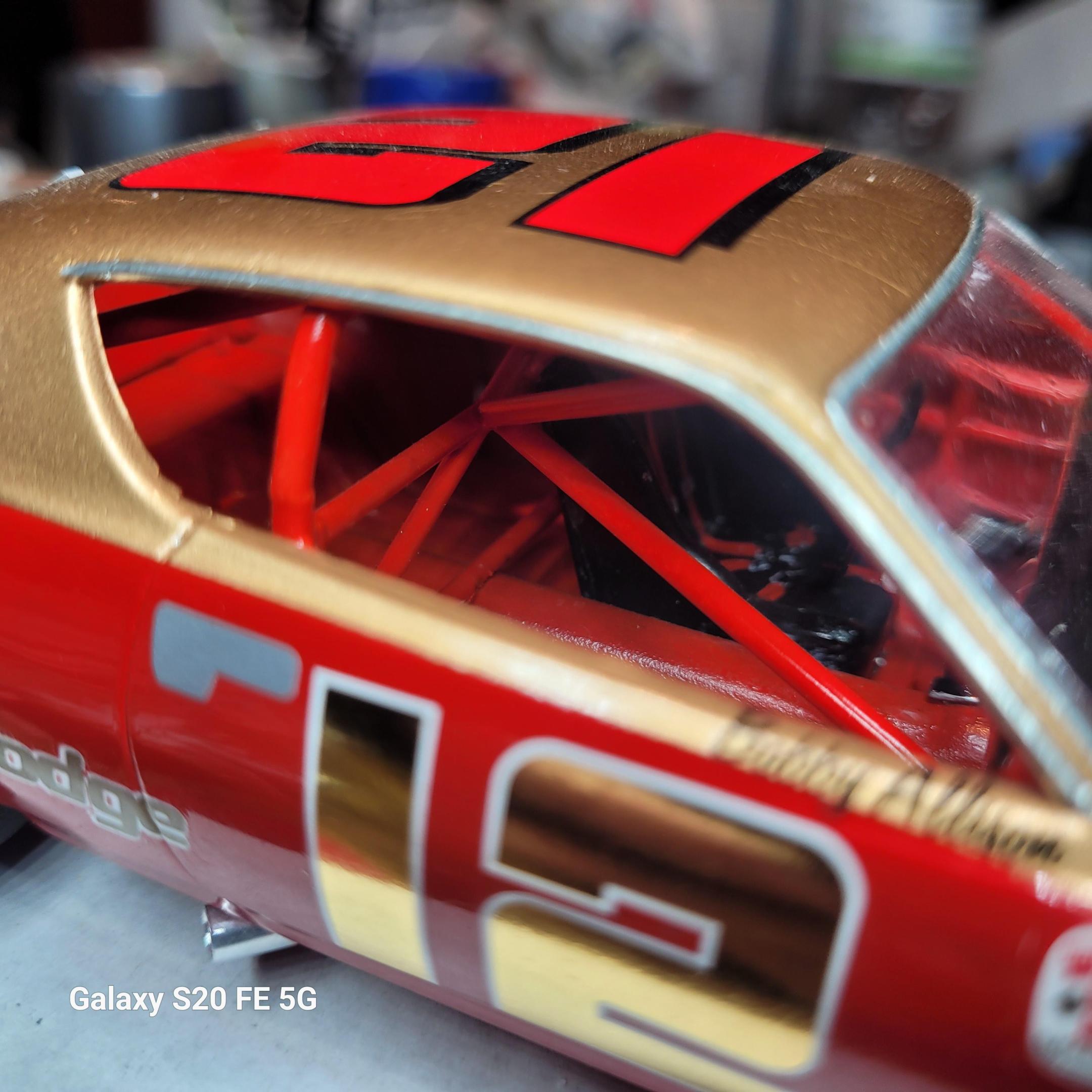

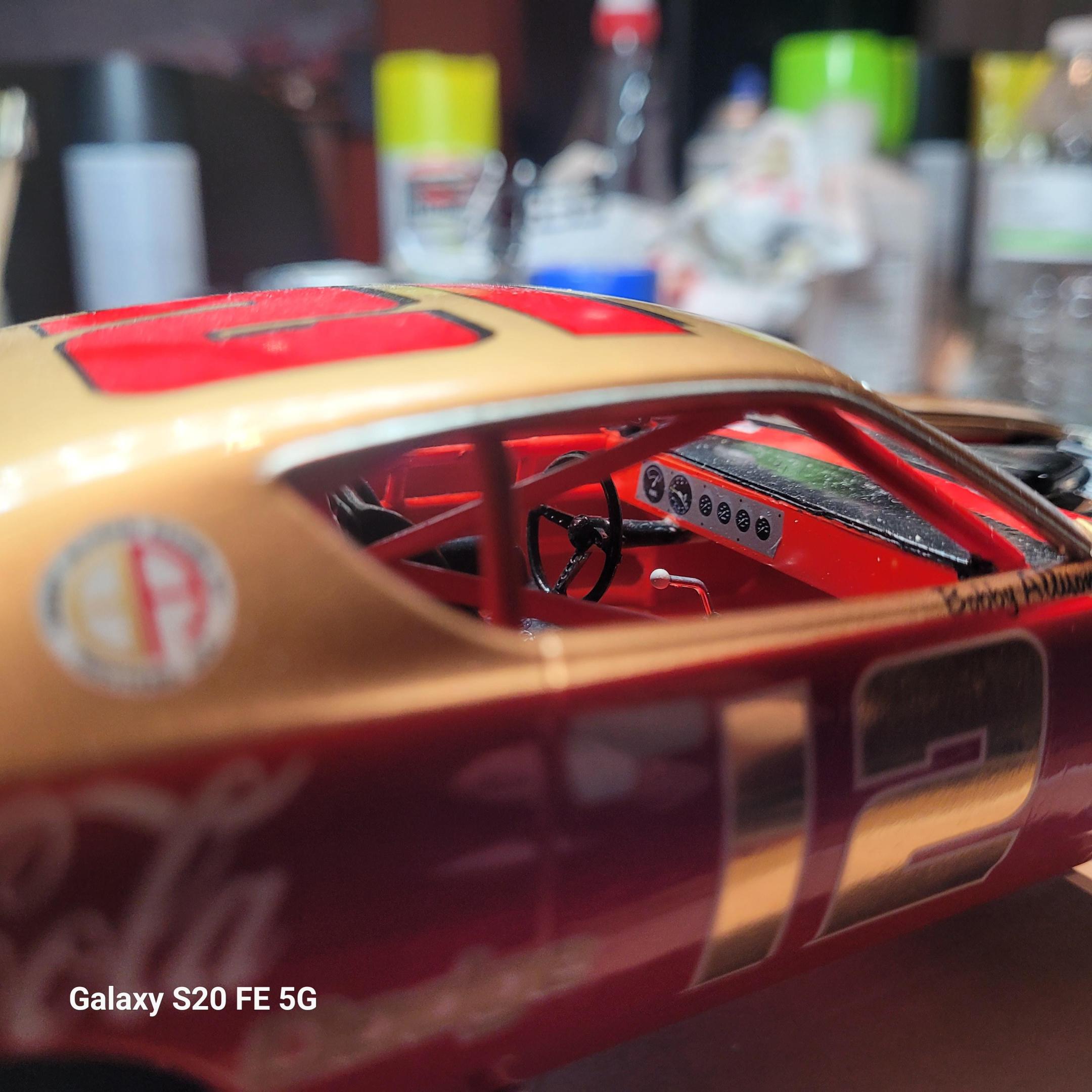

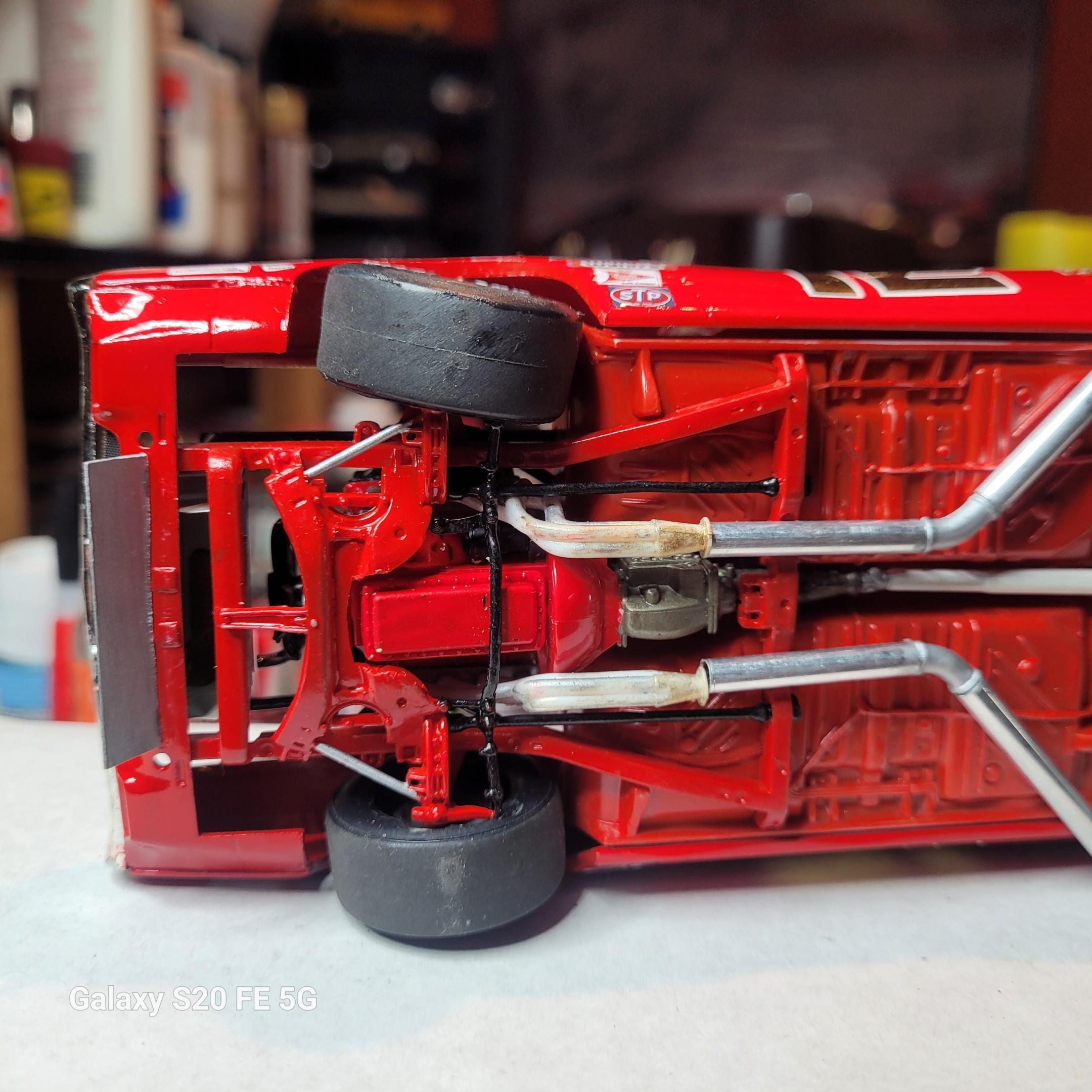

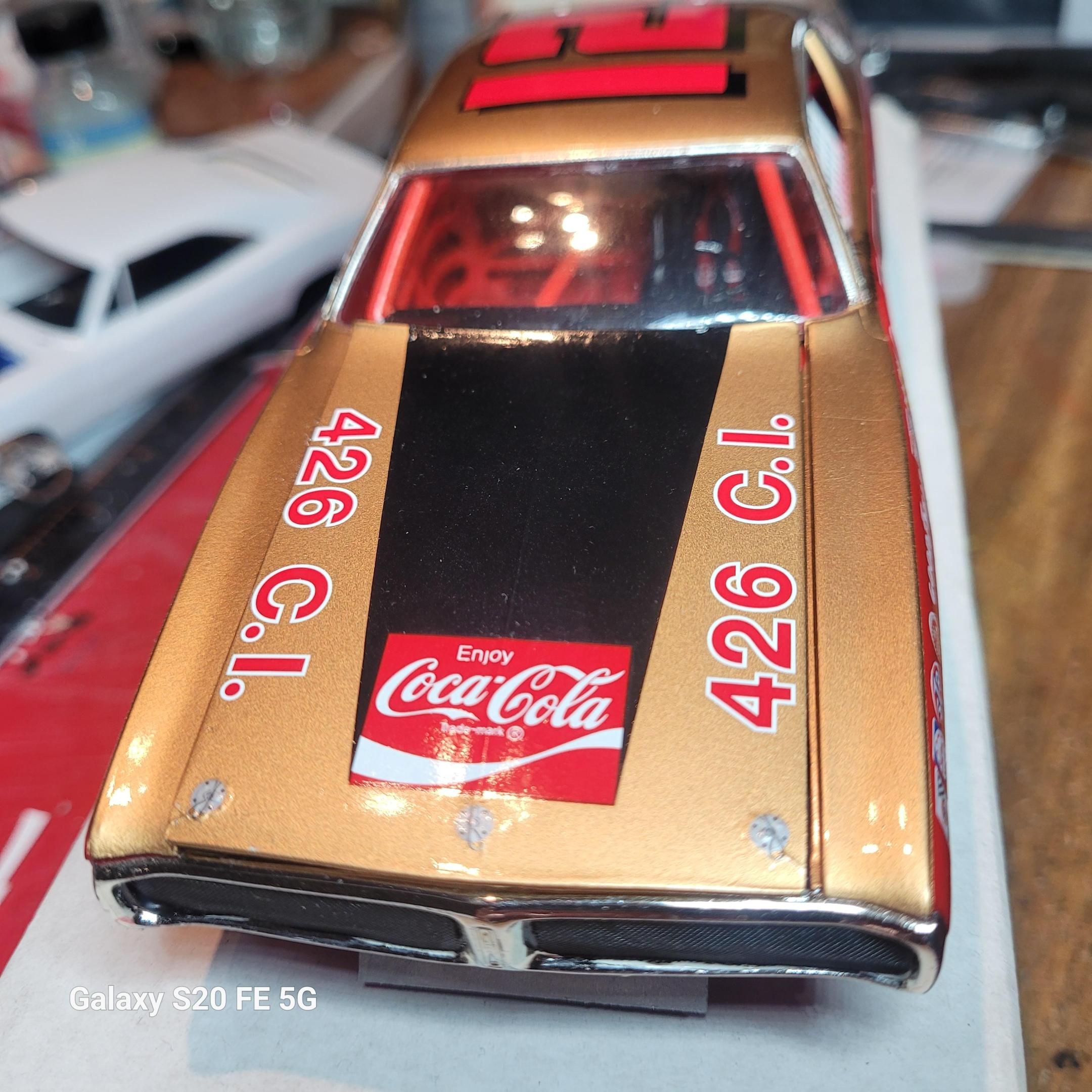

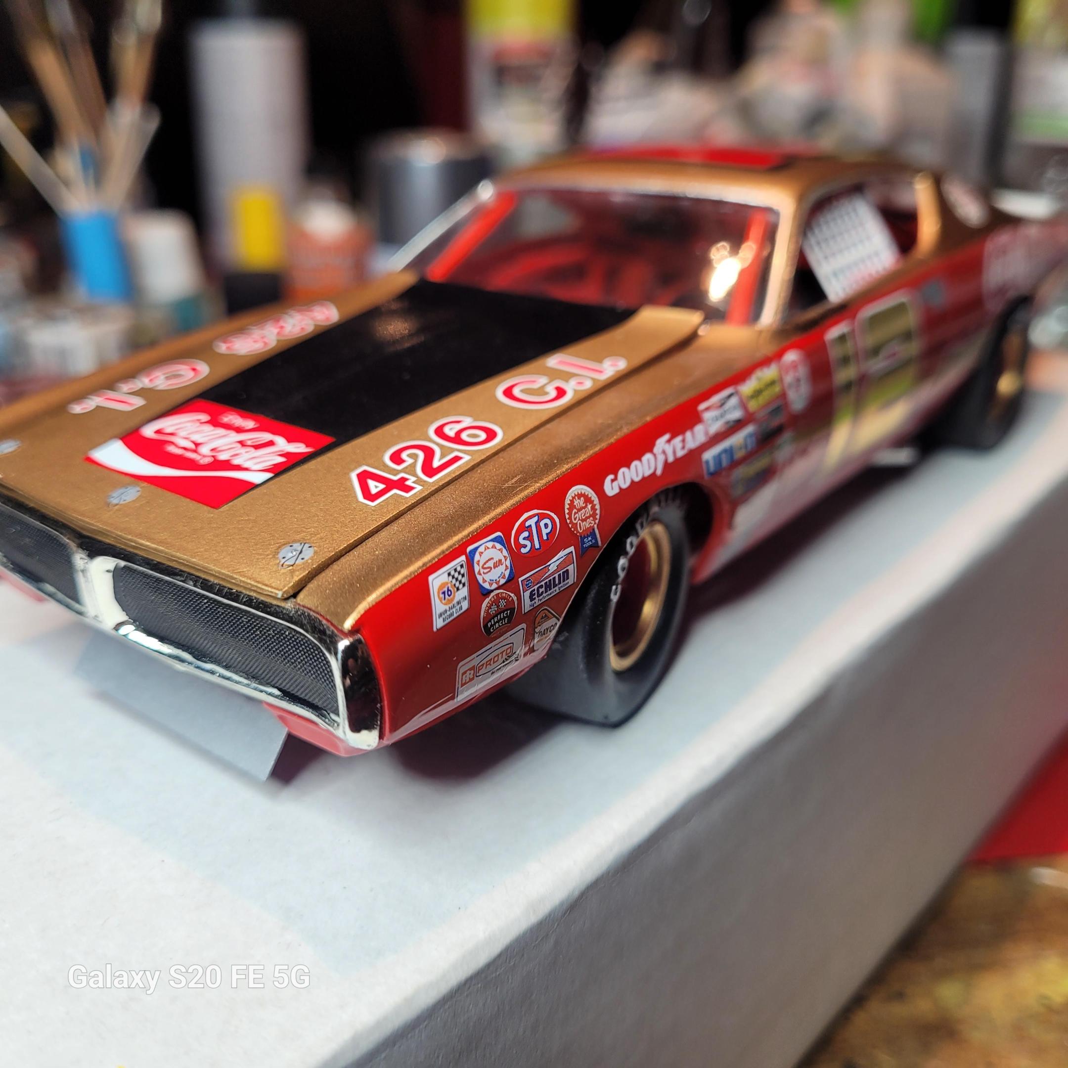

Use Tamiya masking tape to start at the top of the fender and follow the Chargers fender and character line to the rear.
It's been a while when I built the #12 but if memory serves correct  it was Testors Enamel  Met. Gold.  Once painted and decaled,  I used Pledge acrylic floor wax to brush on.  Self leveling, drys fairy quick (15 minutes) and if needed you can apply 2-3 coats. Easy to work with.
Sent some pics to visually help out and feel free to reach out anytime... Chuck

Thank you, these photos are great reference material. I appreciate the time you've taken to post them and share your techniques with me.
