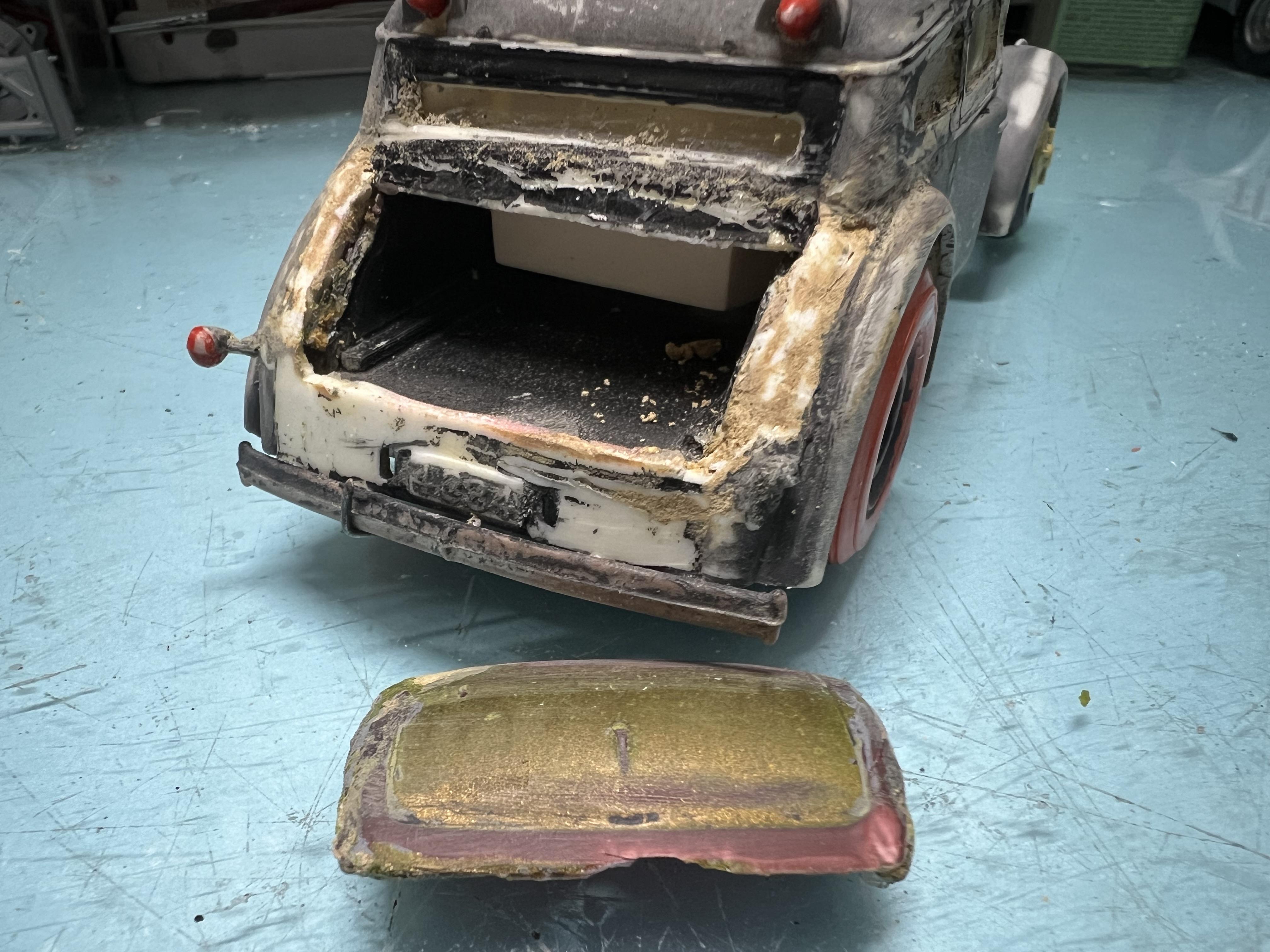

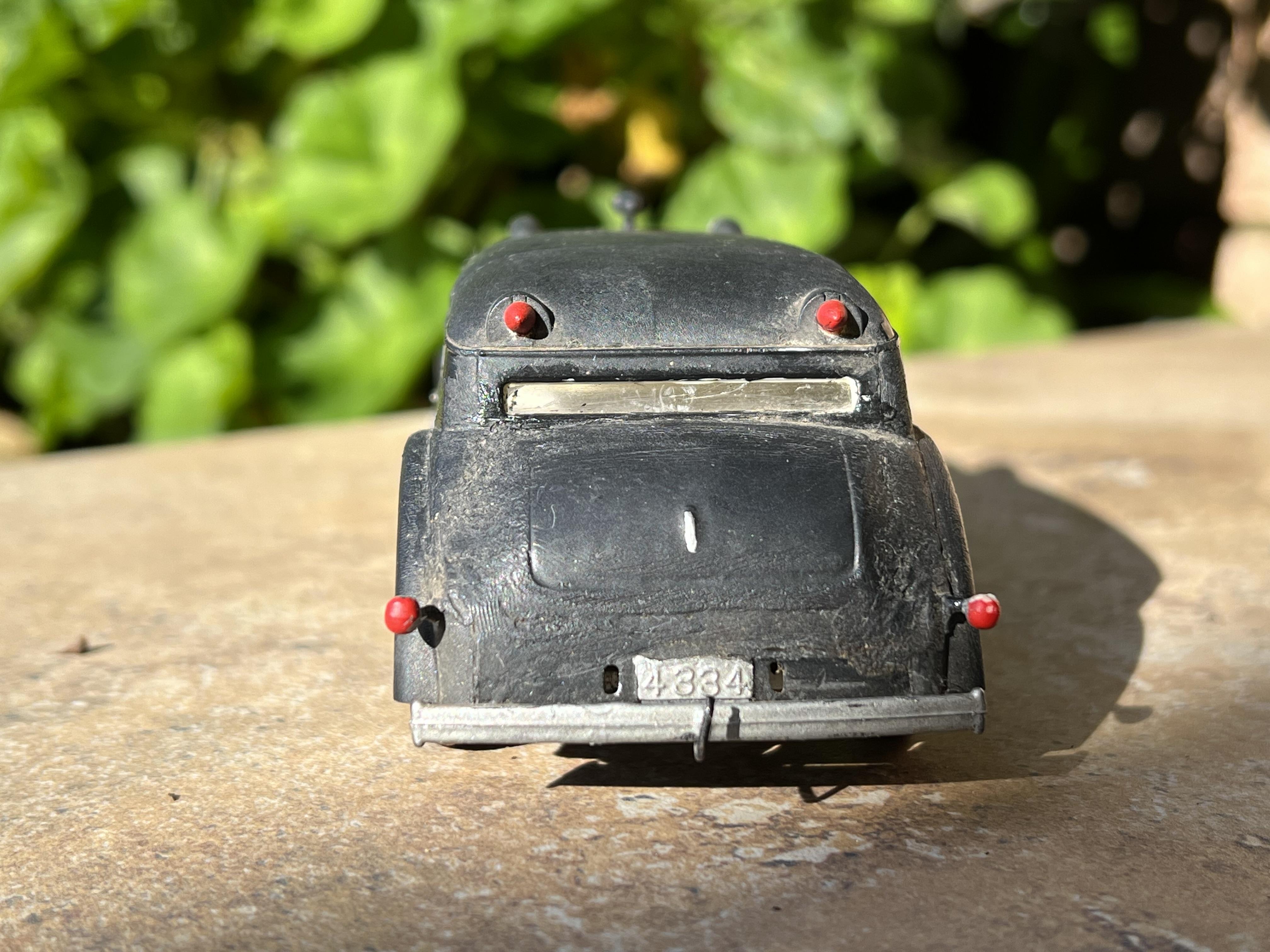

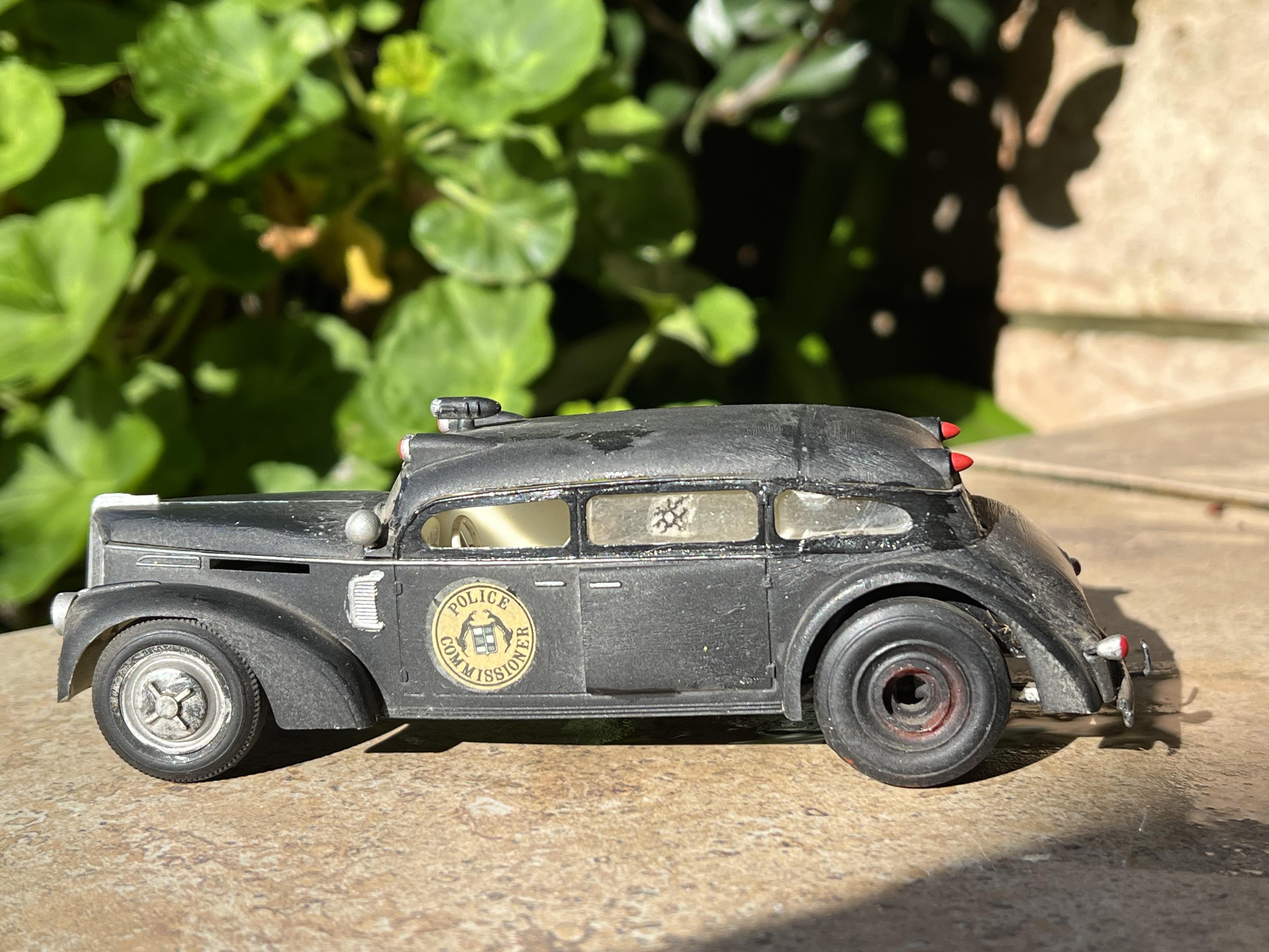

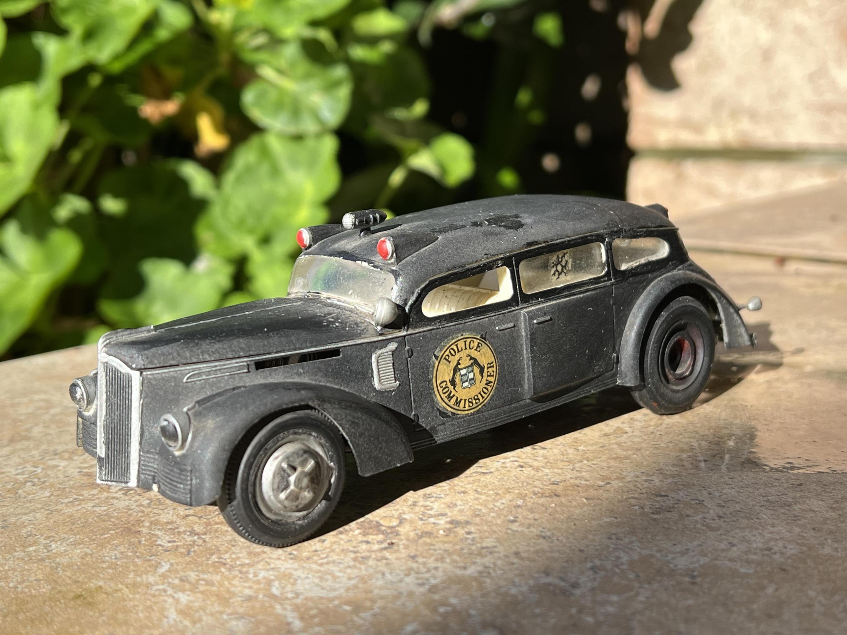

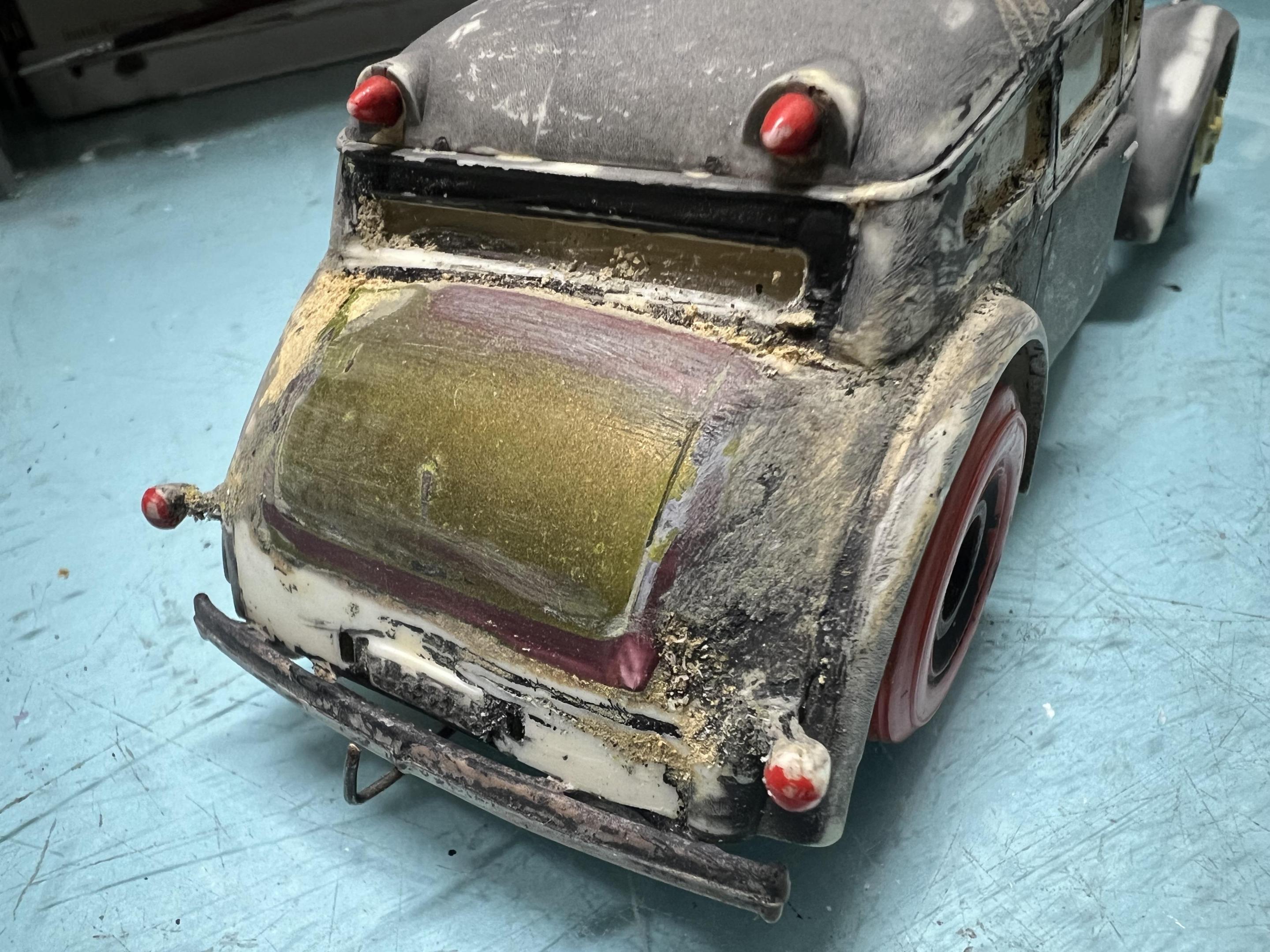

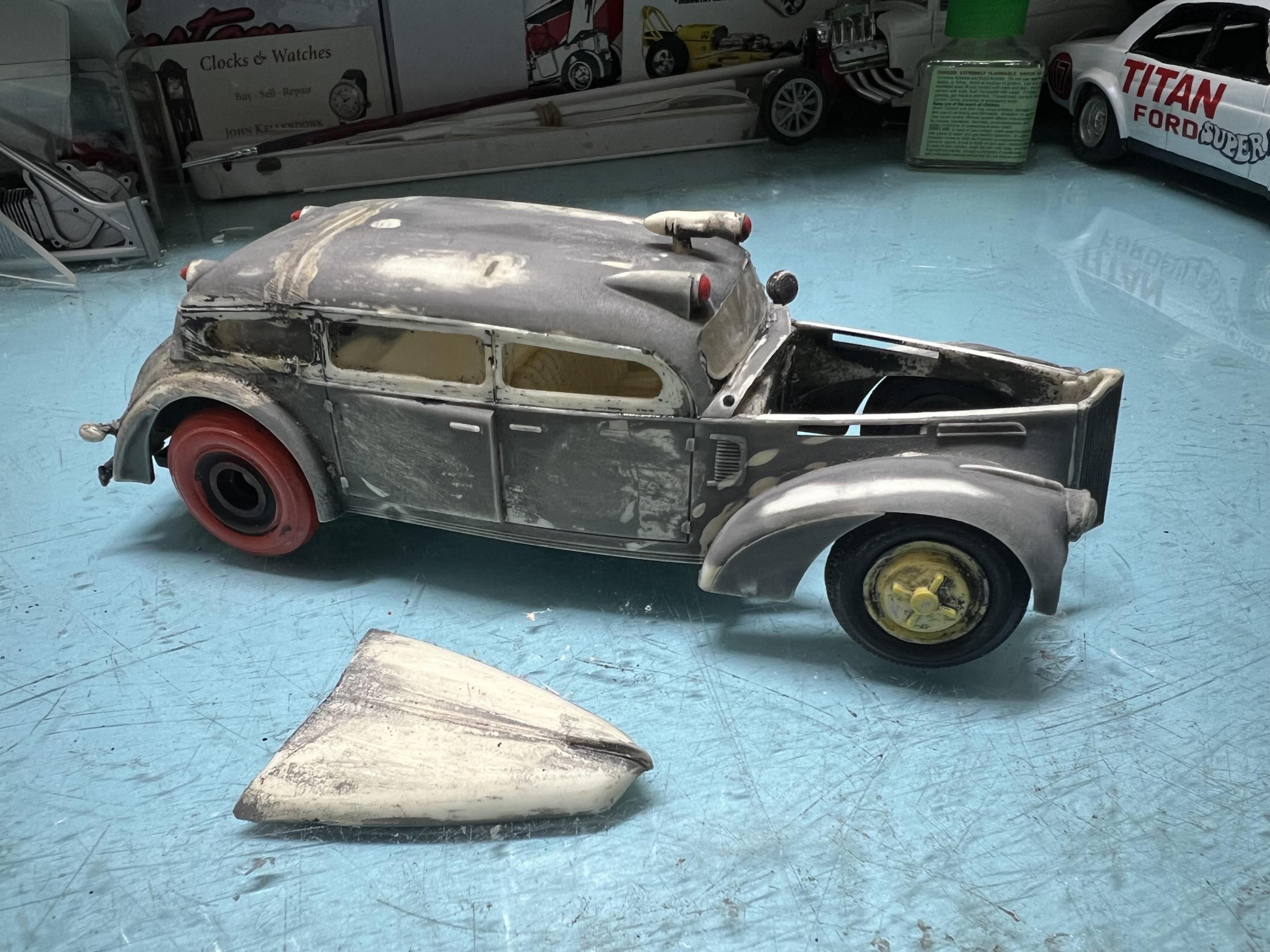

The model that Craig spotted was certainly interesting in its own right.  It appears that the original builder attempted to make a police chief's car from the ambulance. He did a pretty good job for the time but the build quality and materials used  (paint and putty) suggest to me that this conversion was done a very long time ago.

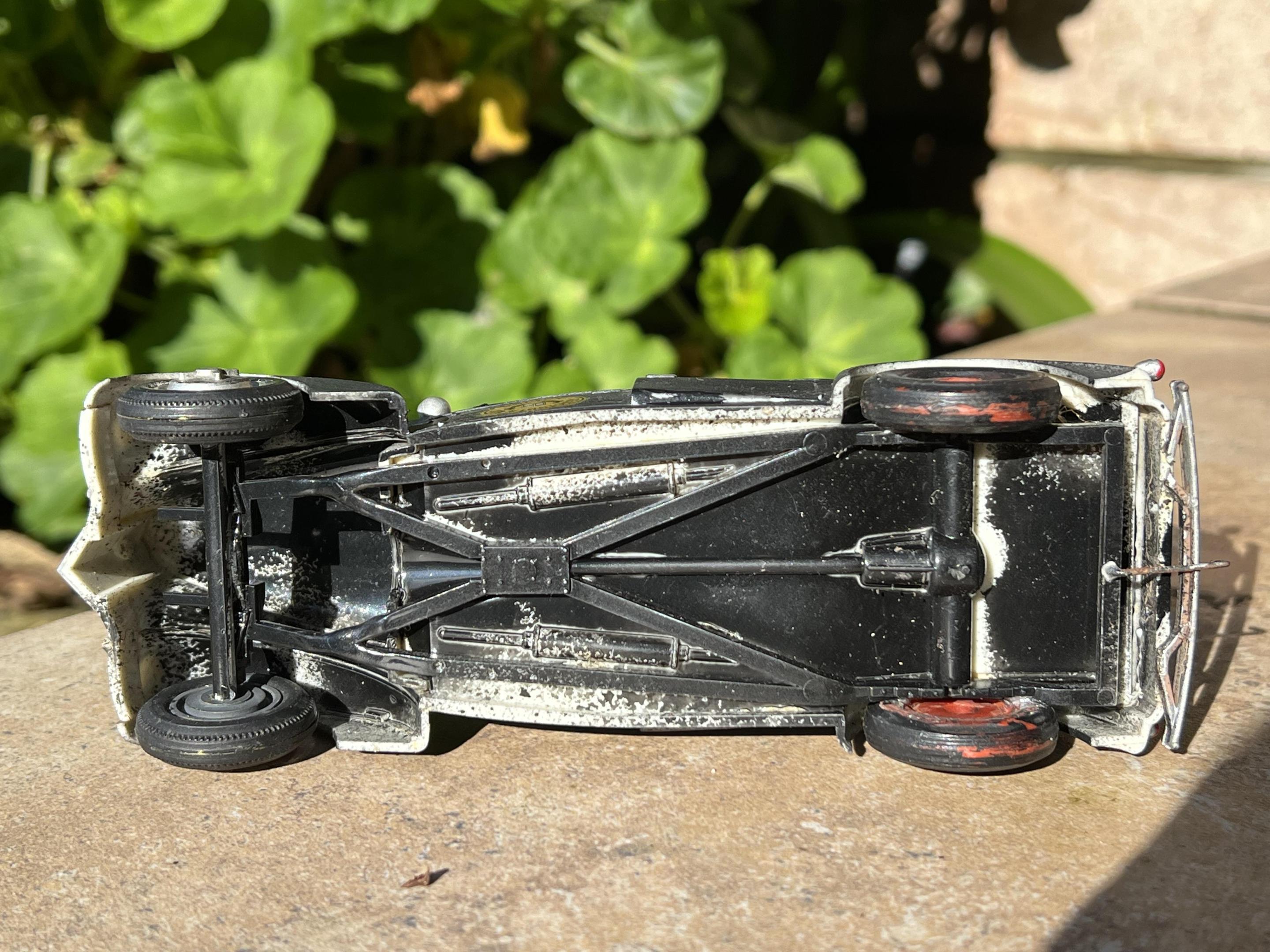

Missing were the original bumpers and four spotlights, the engine, radiator and exhaust pipes top and bottom and the rolled up stretchers from the roof.  The front wheels were from a Monogram T bucket and I don't recognise the rears at all.The box and instructions and decals were probably missing since the sixties! The back of the body had been replaced with the rumble seat of an unknown model and the louvres on the hood were filed off - judging by the scratches, he may have used a chainsaw to remove them!
Landed in Oz it owed me just over $120 Aus!
Here's what I got for the money

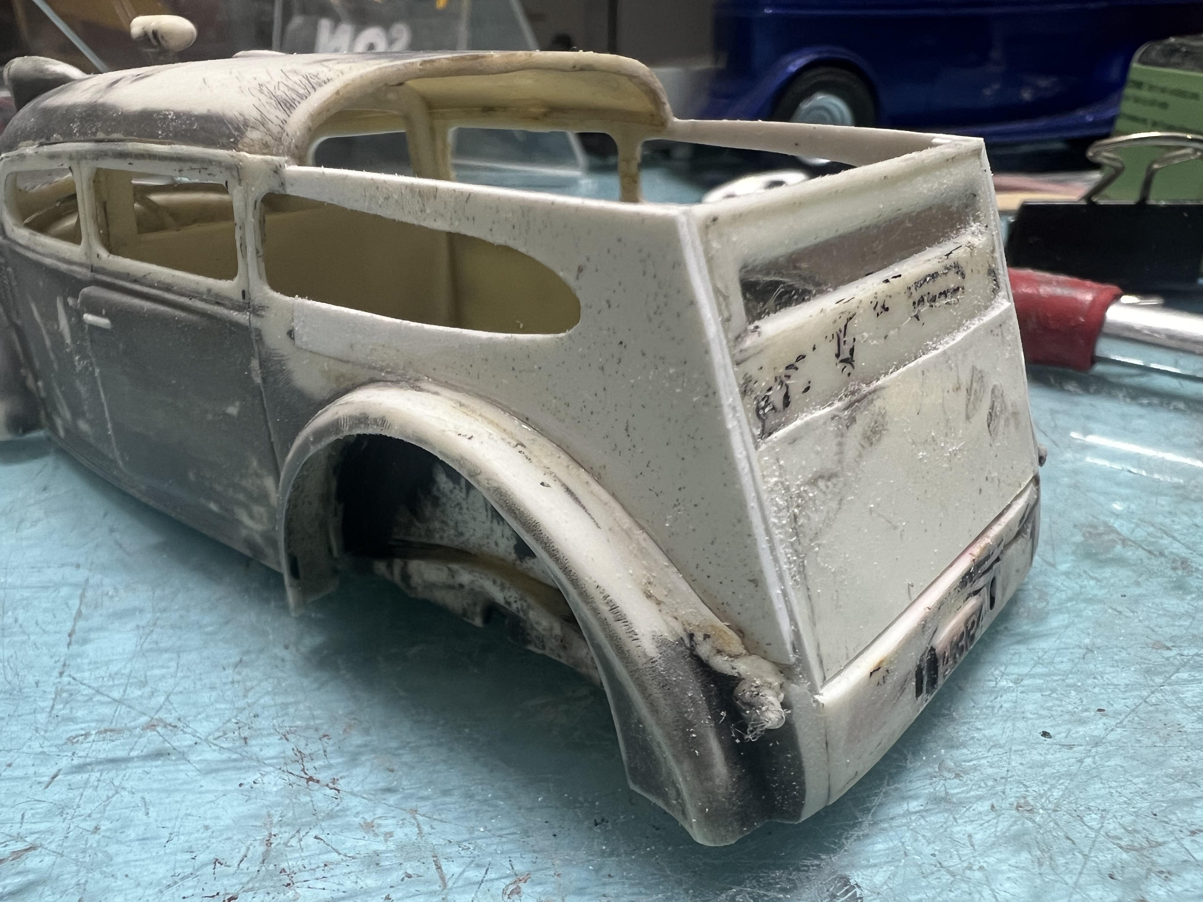

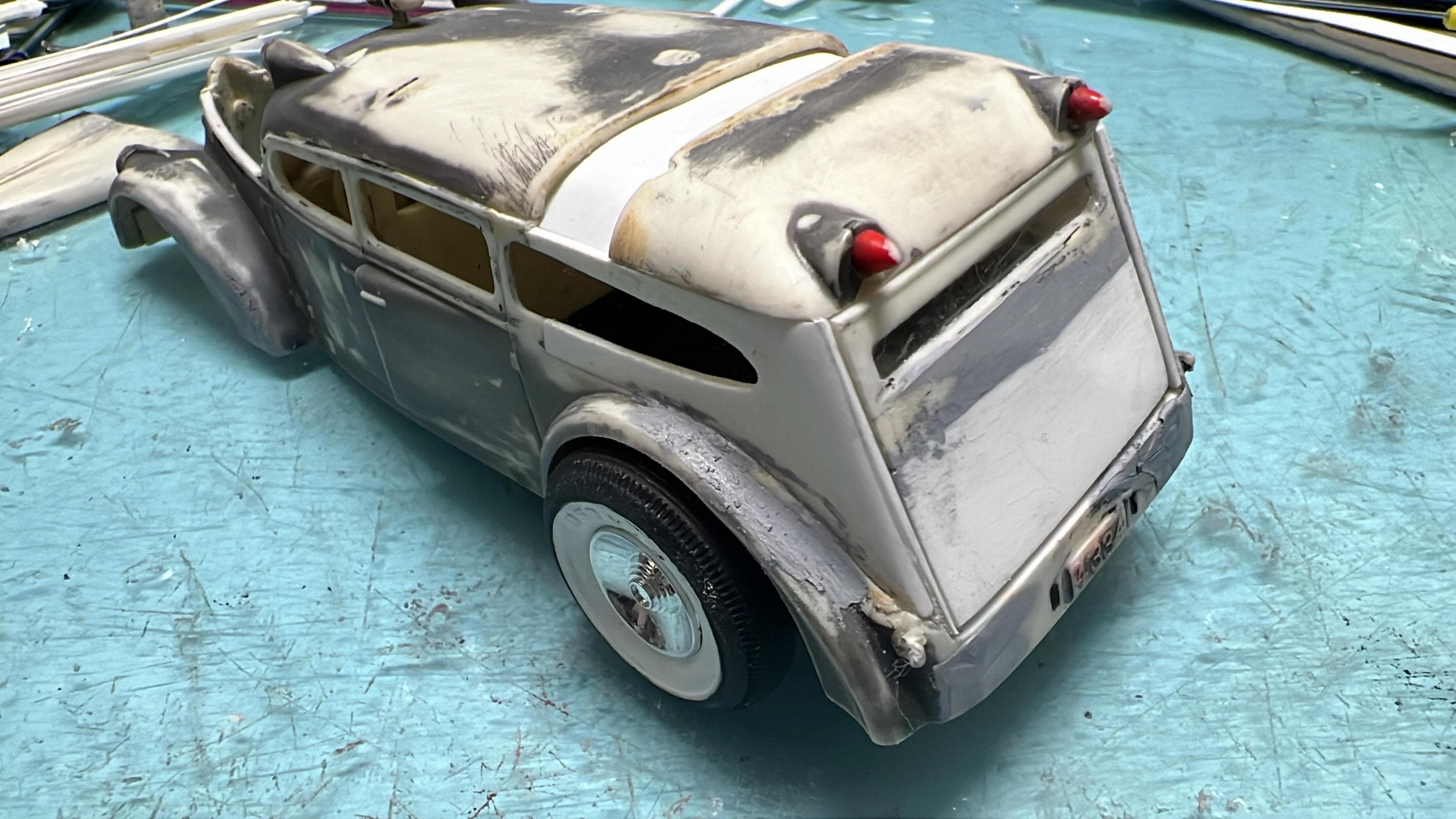

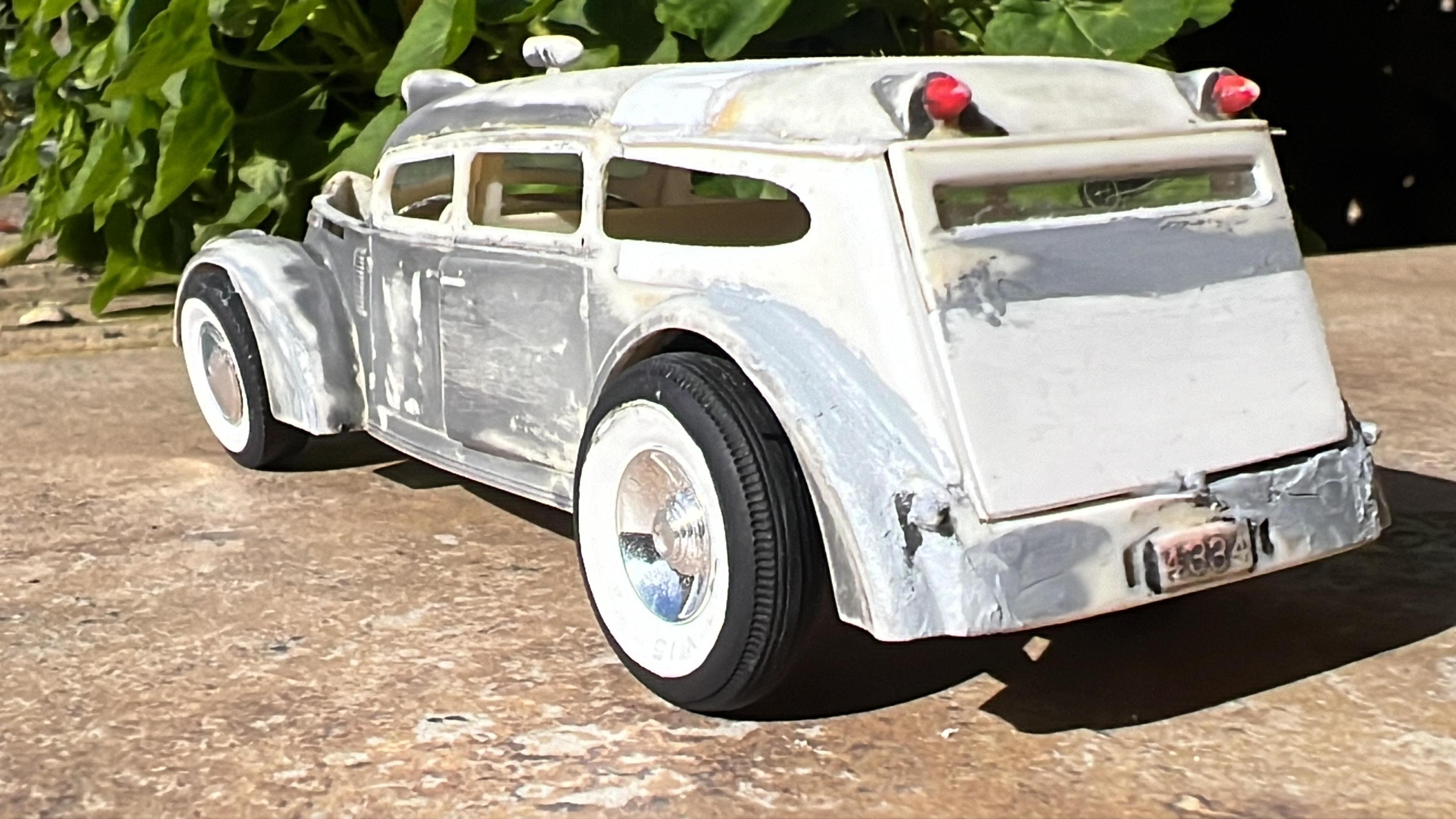

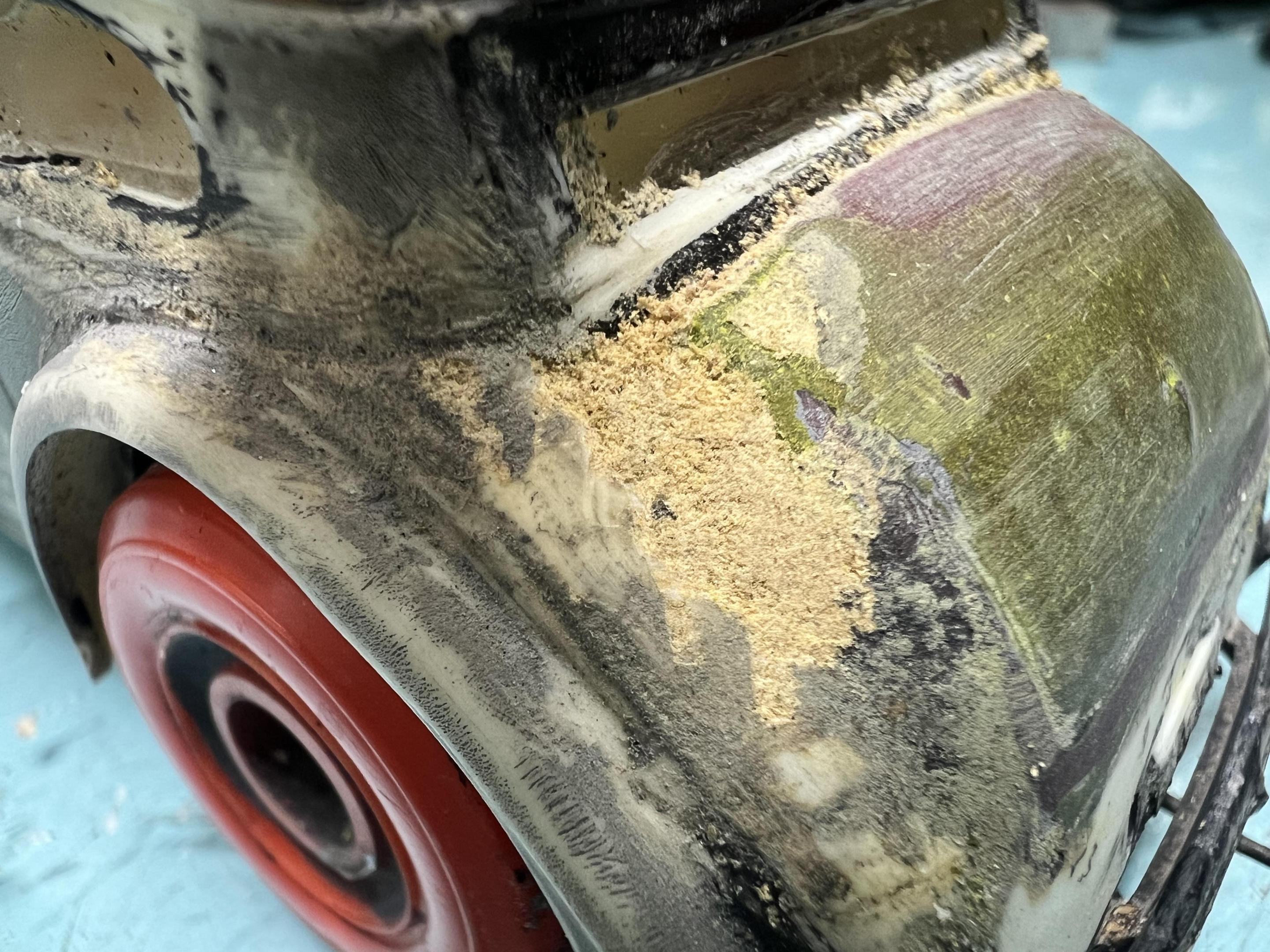

After a day in caustic soda this is what was revealed!  That grey primer could have been used on the nose of the space shuttle - it is indestructible and was rather character building throughout the exercise!   The rear conversion was completed with what looked like dried up Tootsie Roll but I am told it was most likely a wood putty from the hardware store. Fortunately  there were some critical parts remaining of the roof and back door to assist in the restoration.
Edited by alan barton
  • Like 2

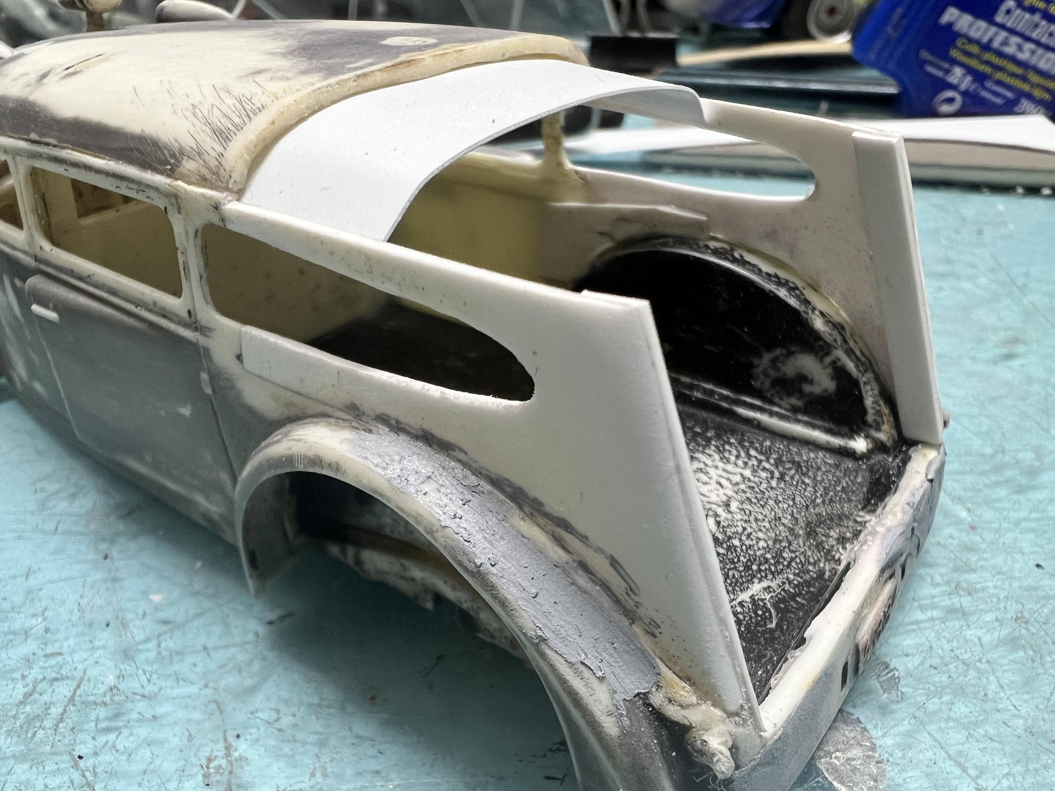

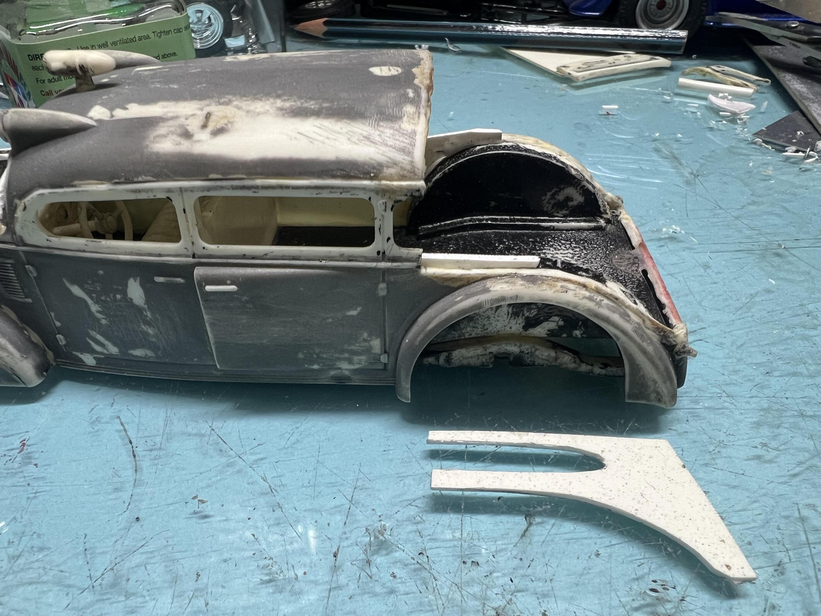

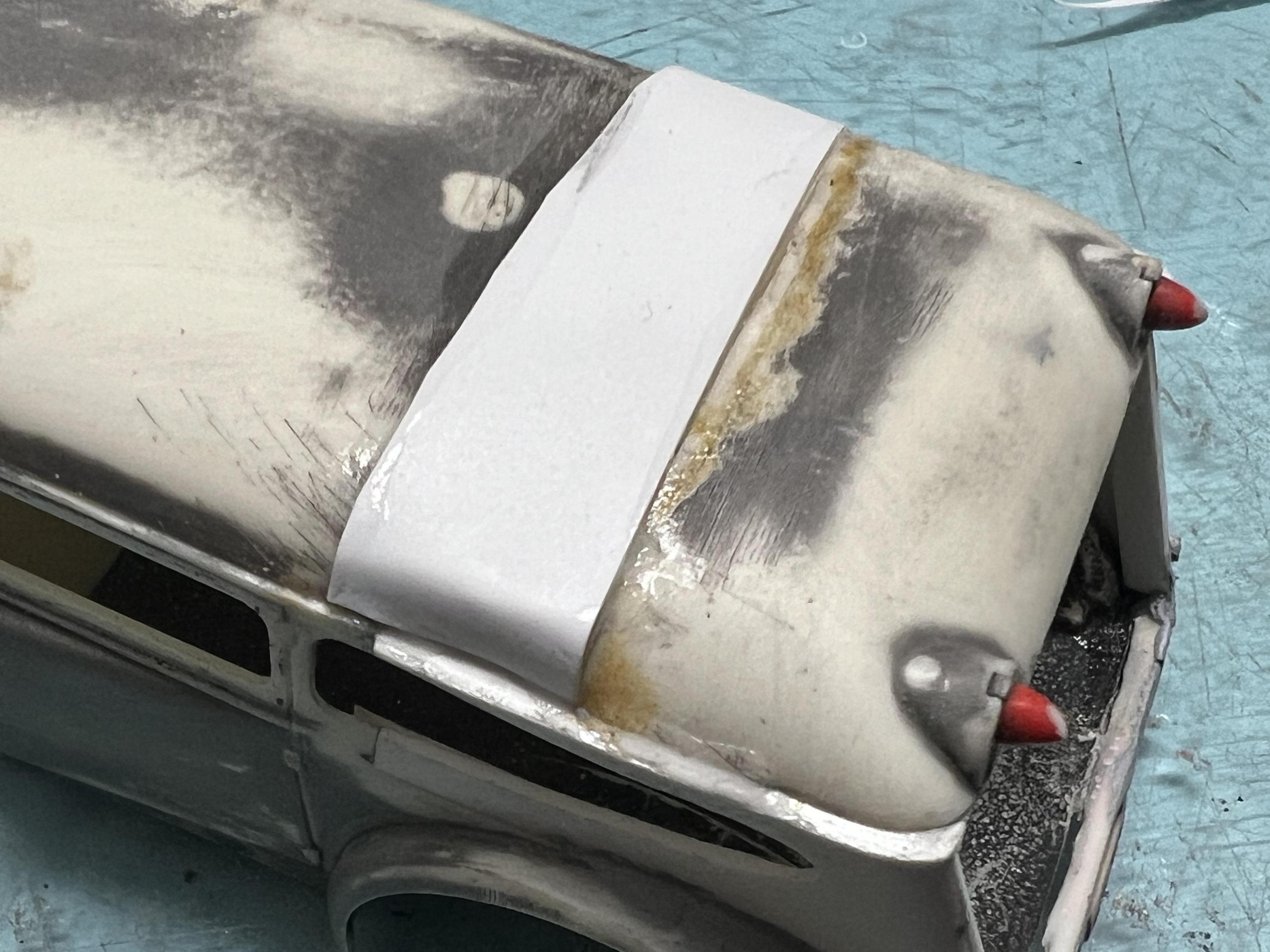

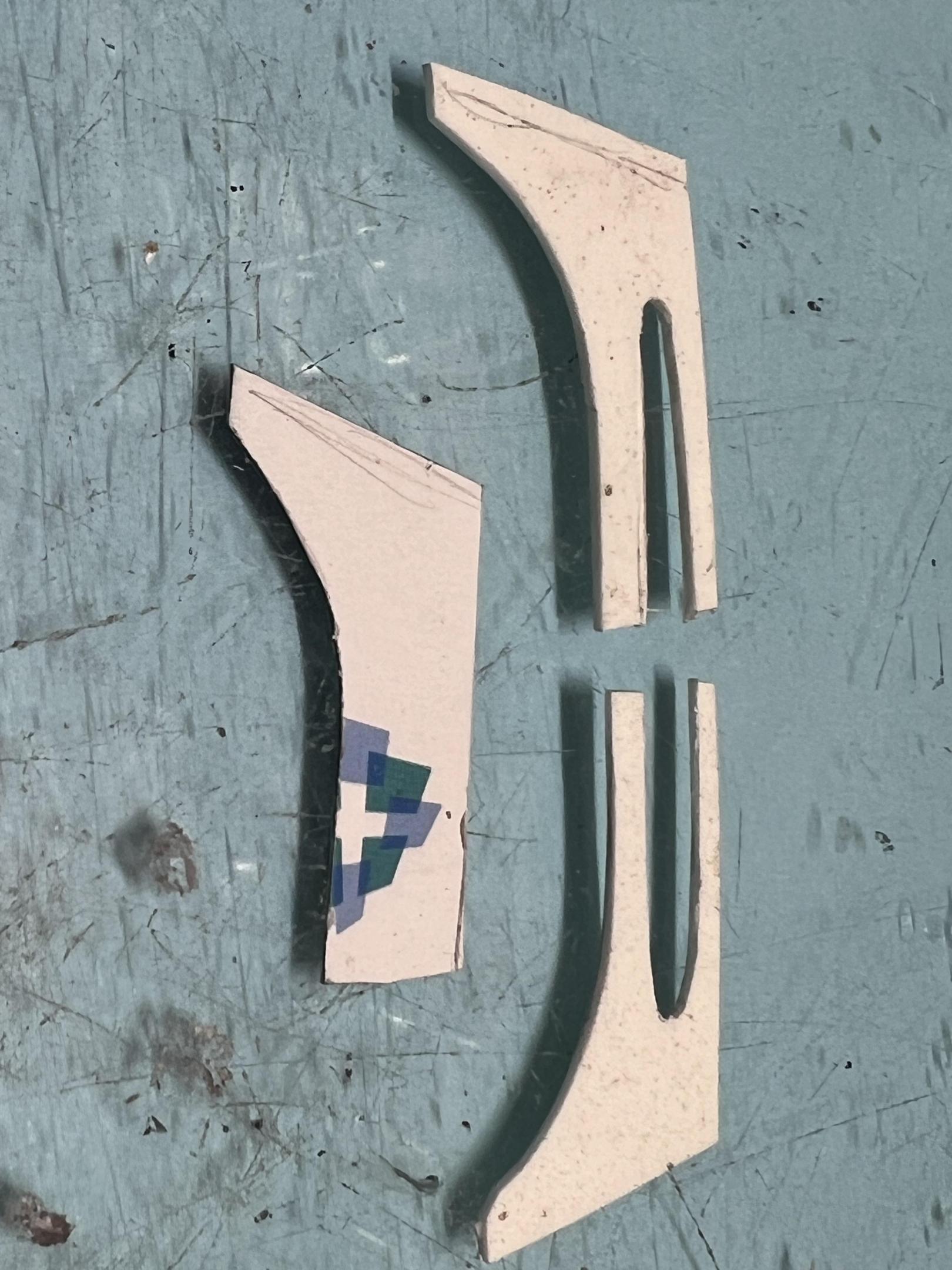

Restoration consisted of prepping all the undamaged body panels and making templates to recreate the missing sections of the rear of the ambulance body.  I ended up removing most of the heavily damaged gutters and remaking them with thin Evergreen. Evergreen was also used to recreate the waistline moulding.
In case you are wondering, well-assembled Aurora models are very brittle and prone to exploding if any sort of force is applied.  As a result, dismantling this model for repair was not practicable.
  • Like 3

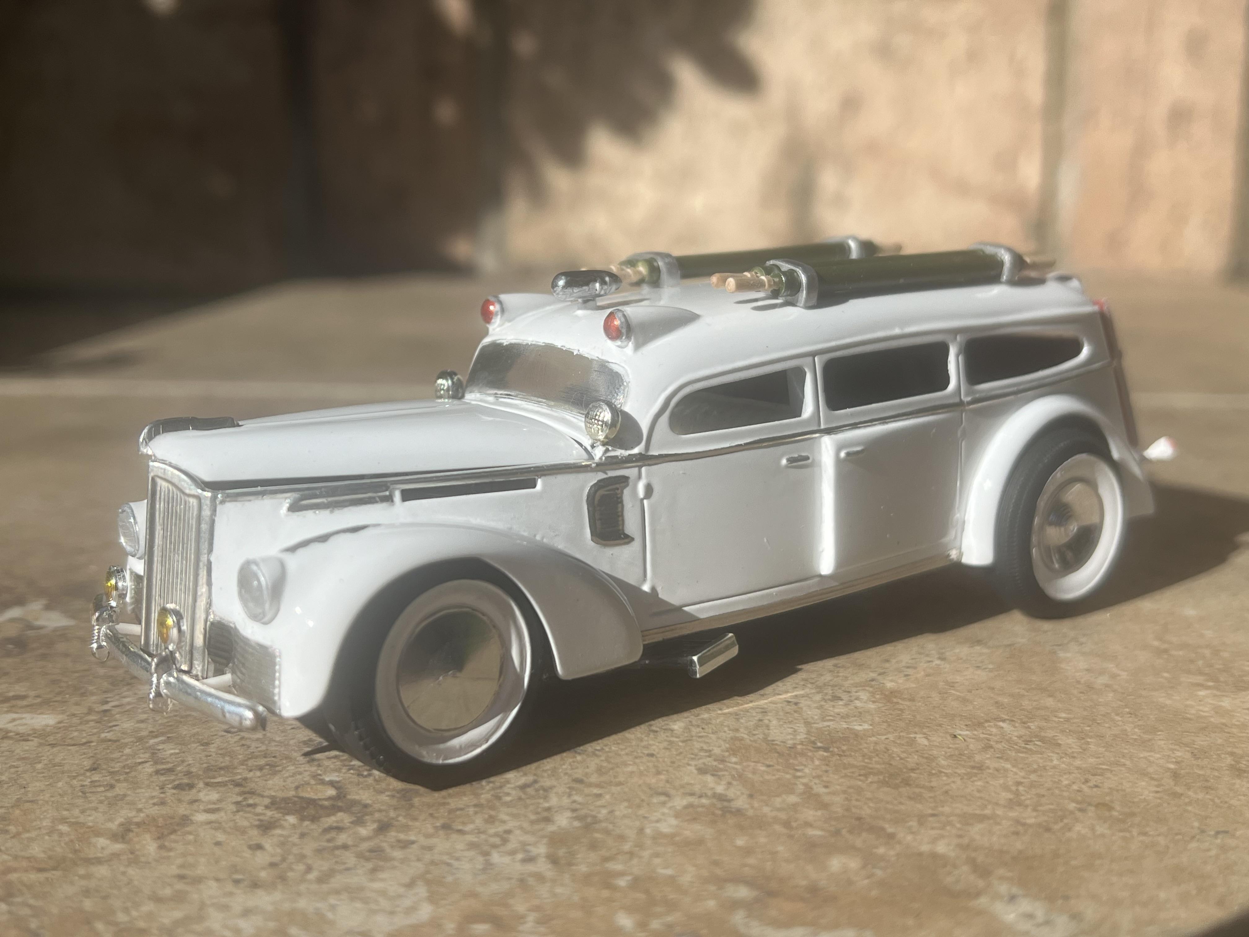

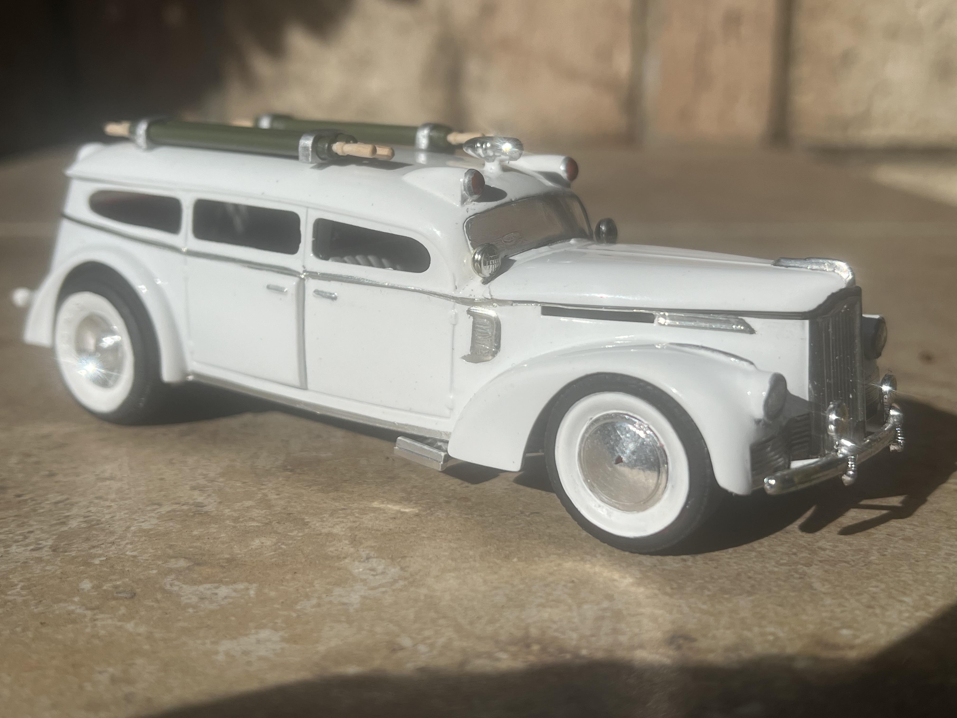

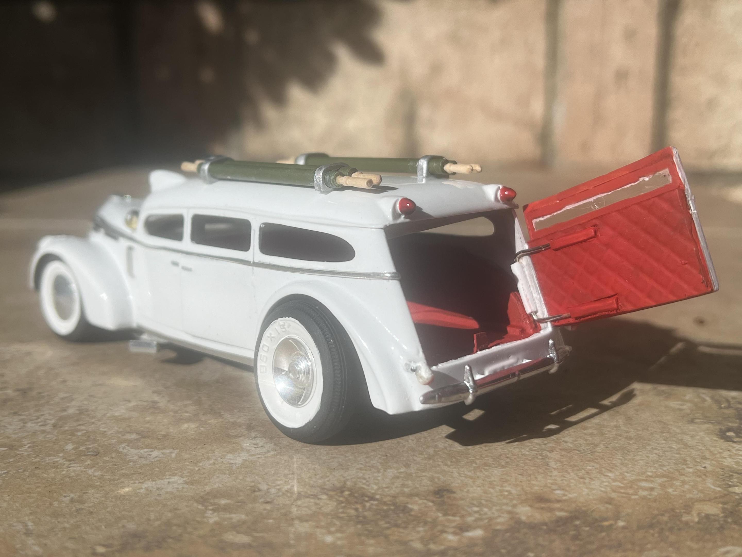

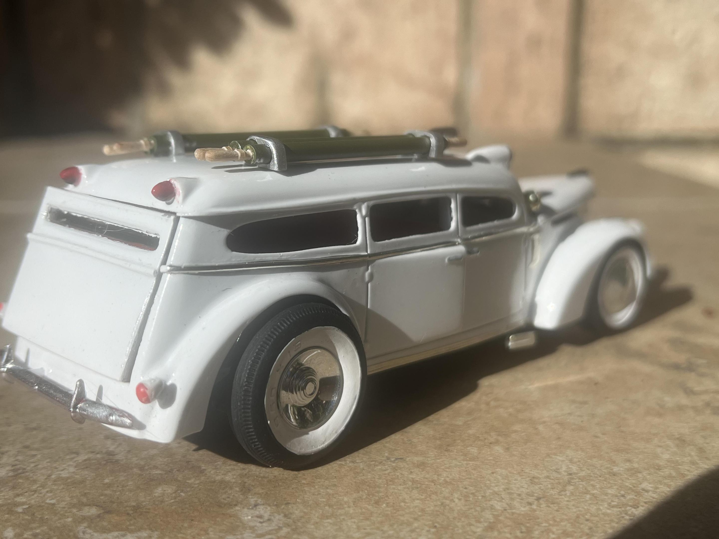

After several months of putty-sand-primer-repeat routines, here she is!  Some details are not exactly to the box art but I am very happy to finally have an example of this model on my shelf.  Paint is Tamiya flat white with three coats of Tamiya Clear.  The stretchers are lengths of Evergreen tubing with the ends of toothpicks for handles. A big shout out to Craig for enabling me to capture this elusive model!
Cheers
Alan
