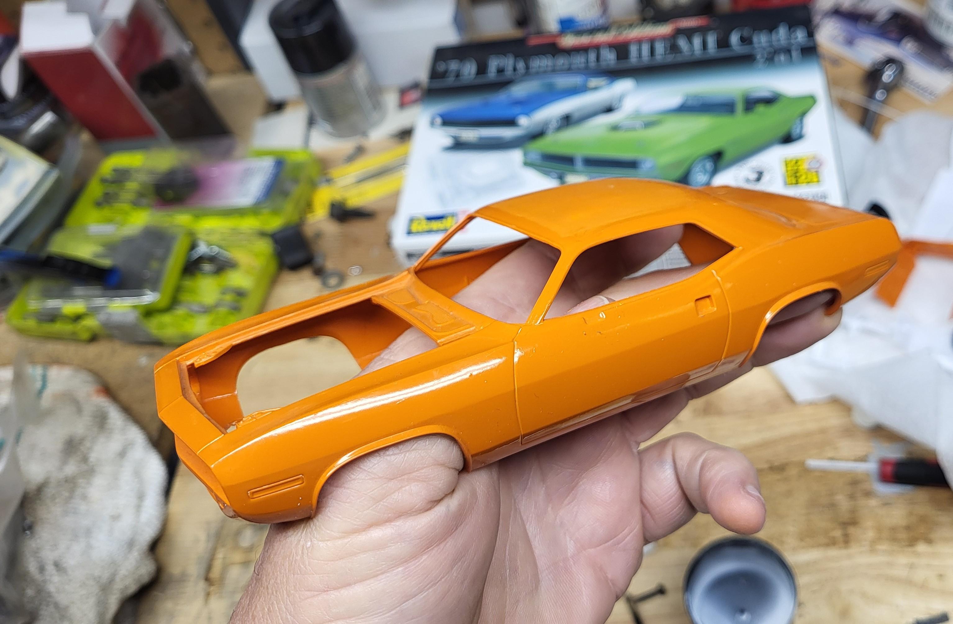

Painted K2 Testors GoMango / Vitamin C   with black interior to match the 1/1
It has some scuffs in the paint , luckily I still have the Testors can and hopefully It sprays out well enough to repaint the body and hood. Fingers crossed on that.
If not maybe I can decant it and break in my new to me airbrush I got for Christmas. If not, I will have to look at other avenues for paint.

Body was already painted. I didnt catch the wide flares in time

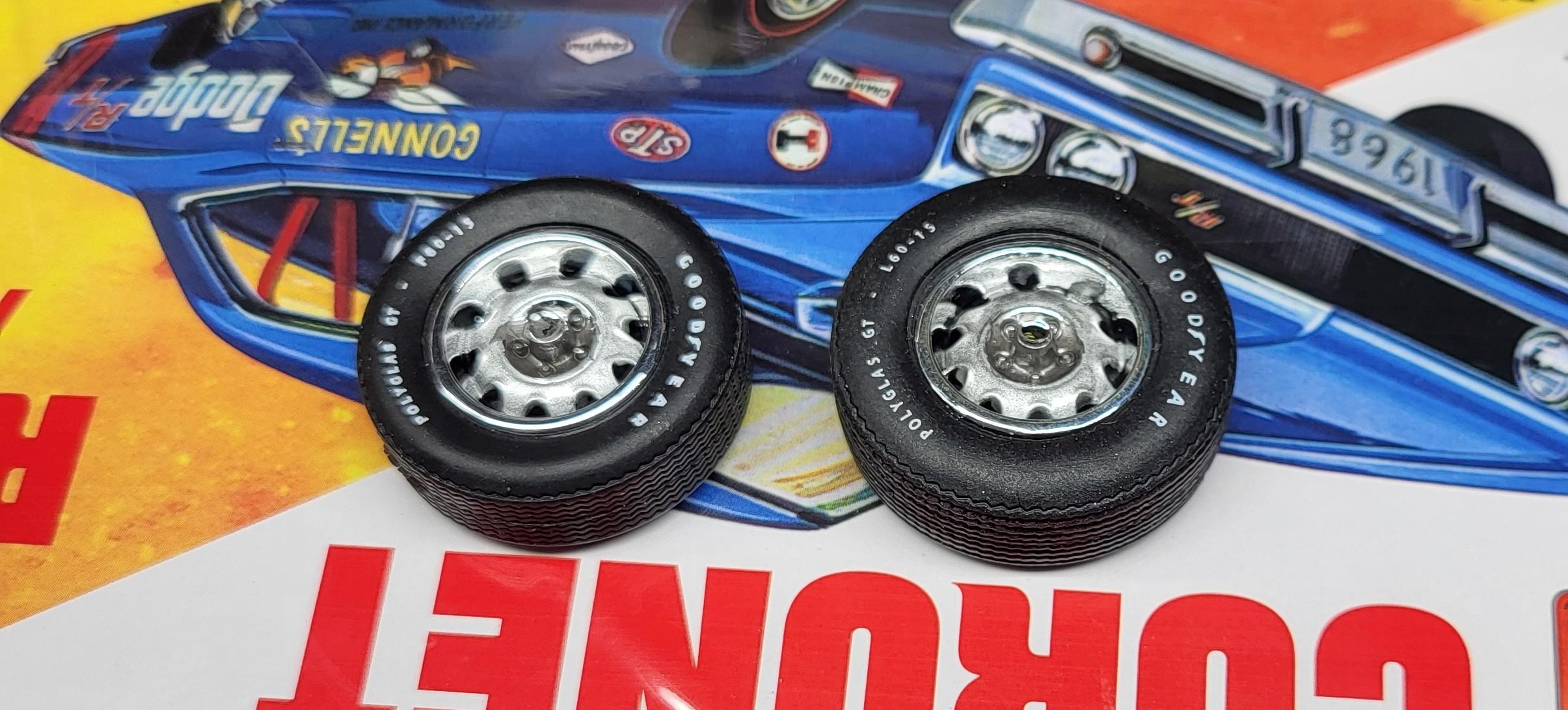

Wheels and tires done.
Tamiya flat aluminum rims with a light coat of testors burnt metal for the centers

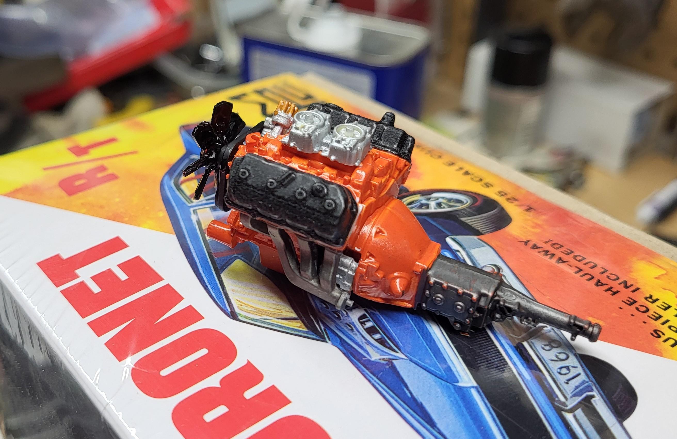

Engine done.  Painted with  duplicolor hemi orange Engine enamel..built box stock.
Chrome Valve covers stripped and sprayed with duplicolor black wrinkle paint.
Overall just detailed with various shades of paint
Edited by gtx6970
