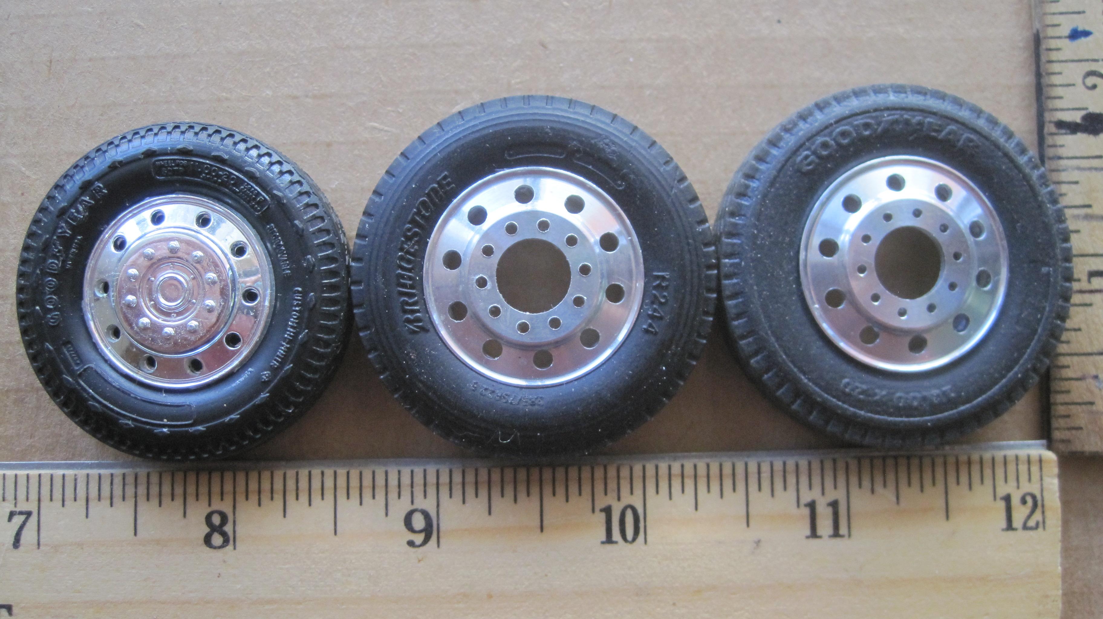

Tommy, I really appreciate your knowledge/info on various topics including the wheels/tires.
I think this is where I was short sighted. ;)  Håkan was trying to point this out this before also, I just didn't think about the rim size, tubeless vs tube, locking ring type, and such.
I don't have the Freightliner kit yet, but I plan to build it someday so I will definitely check it out and compare the size in future.  Now I know what to look for if I want a larger set.
I must confess though, I envy some of the quality truck builders here, they have extensive spare part bin where they can find pretty much anything they like to replace. :)
All seem to have various sets of different wheels/tires, exhaust stacks, different engines (does that means some trucks were built without the engines so they can have spare?), etc.  I am hoping I could build like that someday~
Your welcome. I have to take back the possibility of using the solid Alcoa's used on the front axle of present day Ertl IH cabovers and conventionals, they too were molded too small to fit your larger tires. Maybe someone will chime in on the size of Alcoa's used on the front axle of newer Revell or Italieri (now AMT) kits that might work for you. Another possibility are  3d printed front Alcoa wheels in the right size from aftermarket people. These appear to be the right size,  22 inch 10 hole truck wheels . Photo shows  Ertl solid  type Alcoa(left) and Keystone solid type Alcoa(right).  Ertl must be technically 22.5", the industry never made solid wheels in 20", even though it fits 20" kit tires. The Keystone must be 24.5", the industry never made solid wheels in 22", they fit aftermarket rubber tires once sold from Double Take and tires now sold by ST Supply.  I would ignore the tire size stamped into these larger aftermarket rubber tires, think of them as smaller size or larger size tires.

On 2/11/2025 at 8:07 AM, Force said:
The tubeless tires for 22.5 inch rims and the old tube tires for 20 inch rims are close in outside diameter for standard profile and the same goes for the 22 inch and the 24.5 inch.
I agree. I have discovered the truck hobby has settled on making 2 different size tires and wheels, not 4 different size tires and wheels. The 22.5" (solid wheels) will fit into the same size tire the 20" wheels fits into. Likewise the 24.5" (solid wheel) will fit into the same size tire the 22" wheel fits into. They are not marketed as 22.5" or 24.5" solid wheels, they are marketed as 20" and 22". In 1:1, the trucking industry pretty much made the 11.00-20 tire the same diameter as the 11-22.5, the 11.00-22 tire the same diameter as the 11-24.5 tire. The trick in the matchup is, one has more tire, less rim ( the case of the 20" and 22") and the other has more rim, less tire( the case of the 22.5" and 24.5"). There is a compromise in the truck hobby and have to accept what is readily available (unless your a 3d printer person) to try to make our models as realistic as possible.

First of all, I must say that the aftermarket aluminum wheels look super sweet.
Yeah, those do look quite bigger in size, and they look good!
At the end, as you said, some compromising effort is needed based on what we can get.
I try not to get "too" involved with accurate as it can really make you to suffer through the building process (and nothing wrong with that, I know many of you enjoy that kind of effort). ;)
again, did I mention those tires/wheels do look nice?
When it comes to AMT I'm intrigued that they used 20 inch wheels and tires on most of their truck kits when lots and lots of real trucks used the larger 22 inch wheels wich were very popular back in the day, it's just a few kits like the White Freightliner, the White Road Boss, the Diamond-REO and the Autocar kits that have the larger 22 inch wheels and I believe it's only the White Freightliner kits that have 10-hole drive wheels.
The AMT Kenworth K100 Aerodyne kits use the same 22 inch tires as the kits I listed above but the rims are one piece tubeless style although the rears doesn't look right as they have no "ditch" in the middle of the rim.
Understood, Håkan!  I hope to acquire some of these kits mentioned someday and also check them out per your info.
In general, I do prefer bigger tires/wheels on any vehicle just because they simply look better.  But that is just my taste.
BTW, you and Tommy need to draft a sheet or chart on this type of info and post up in info section so we all can bookmark it.
After 3 months from now, I don't think I would remember any of these (unless I remember to come back revisit).
