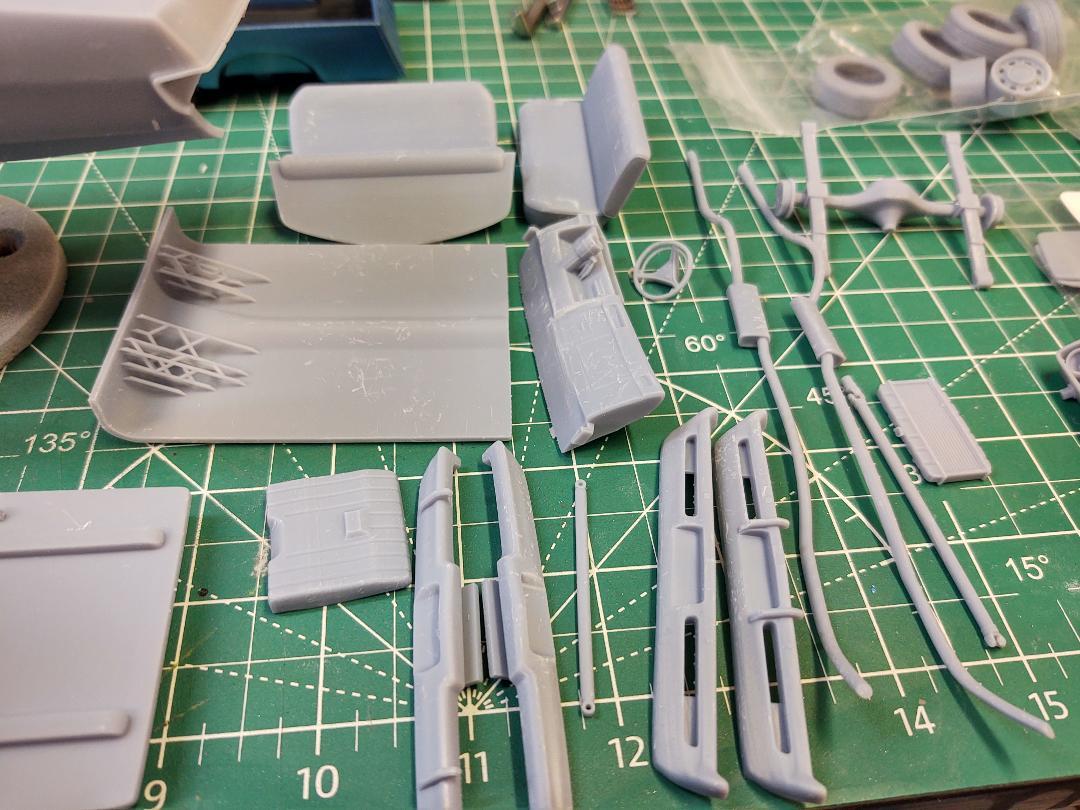

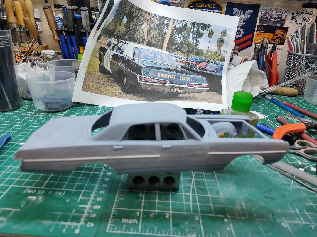

Scott Eriksen Posted March 12 Posted March 12 (edited) I got the kit from Madman today,,,,positives> the body is beautiful ,came with 2 grille options (one with the "Superlight" and 2 bumper options ,with and without bumperettes ,interior looks good ,engine and wheels ok,,,the bad>>> the chassis pan is a cross between a pro touring or something GM'ish with coil over shocks and full upper and lower control arms,,,no torsion bars or struts or something that would resemble the "C" body front stub frame with a "K" member ,,,so I'll have to deal with that ,,being 1/24th maybe I can pirate some stuff from a Monogram Mopar kit .Other than that it will be my future California Highway Patrol build with steelies and dogdish caps,,I already have some CHP decals. Any other ideas on the front suspension I'm open for comments .The kits rear leaf springs are ok and something that sorta try's to look like an 8-3/4 ,,,lol Edited March 12 by Scott Eriksen 11

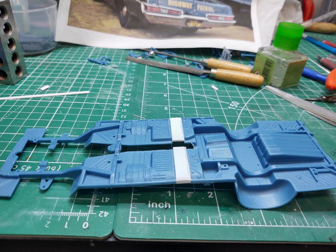

lordairgtar Posted March 13 Posted March 13 Superbee chassis will work in a pinch. You may have to lengthen it a bit to fit the wheelbase. That will get you all you need including the rear end. 1

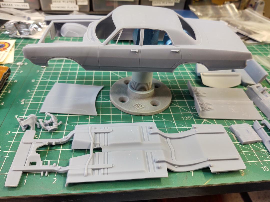

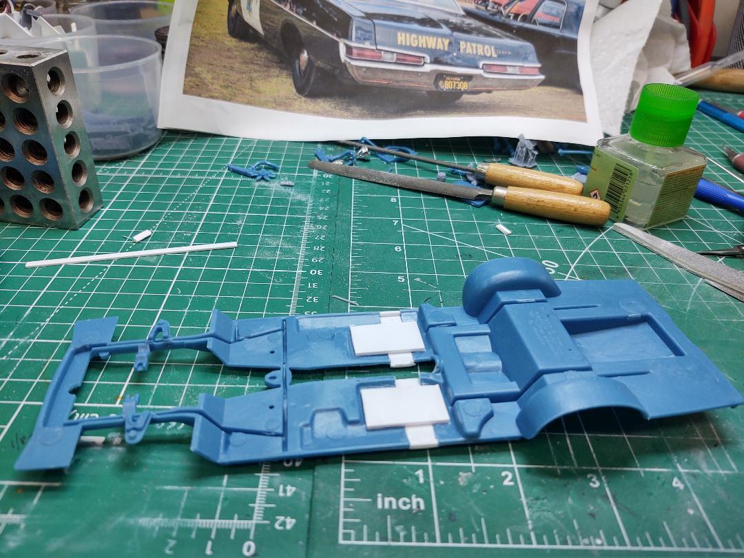

Scott Eriksen Posted March 13 Author Posted March 13 (edited) I just pulled out and checked the Superbee chassis pan ,,,,it will fly. I think the easiest way to gain the little bit in the wheelbase will be to lengthen the front frame rails rather than section the floor pan ,,I'll take some pics tomorrow.Oh and the 3D print engine is bad,,actually undersize,and the Torqueflite looks like a Powerglide,lol,so I'll use a Monogram 1/24th 440 or look for a better 3D job on the innerweb.I've done a bit more on the Travelall today ,,I ordered some better tires and steelies from Joe at Fireball,they should be here soon Edited March 14 by Scott Eriksen 1

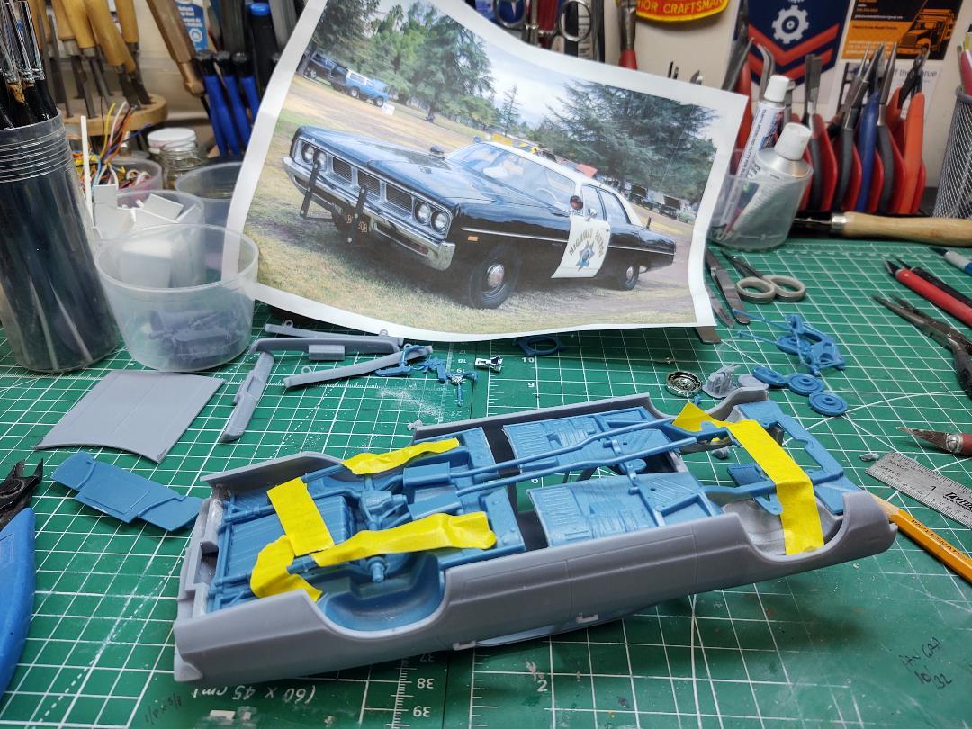

Scott Eriksen Posted March 14 Author Posted March 14 (edited) Monogram SuperBee chassis pan in the Polara,,pretty close ,,,might have to add some strips to fill the rocker "frame" rails to body too. I think I'll just add to the front frame rails a tad for that little difference,,,what do ya think ? I would just make some longer torsion bars . The trans mount would be shy a bit too,,Or section the pan in front of the rear frame rails and add a bit there? OR section it right behind the torsion bar sockets ?? I think moving it forward to where the control arm/spindle would be centered in the wheel well add the difference in the pan and move the rear section so the axle is centered Edited March 14 by Scott Eriksen 4

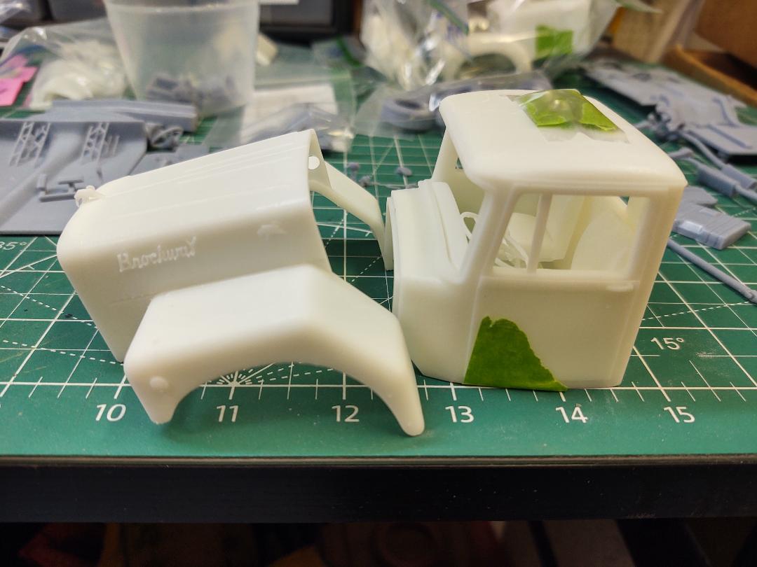

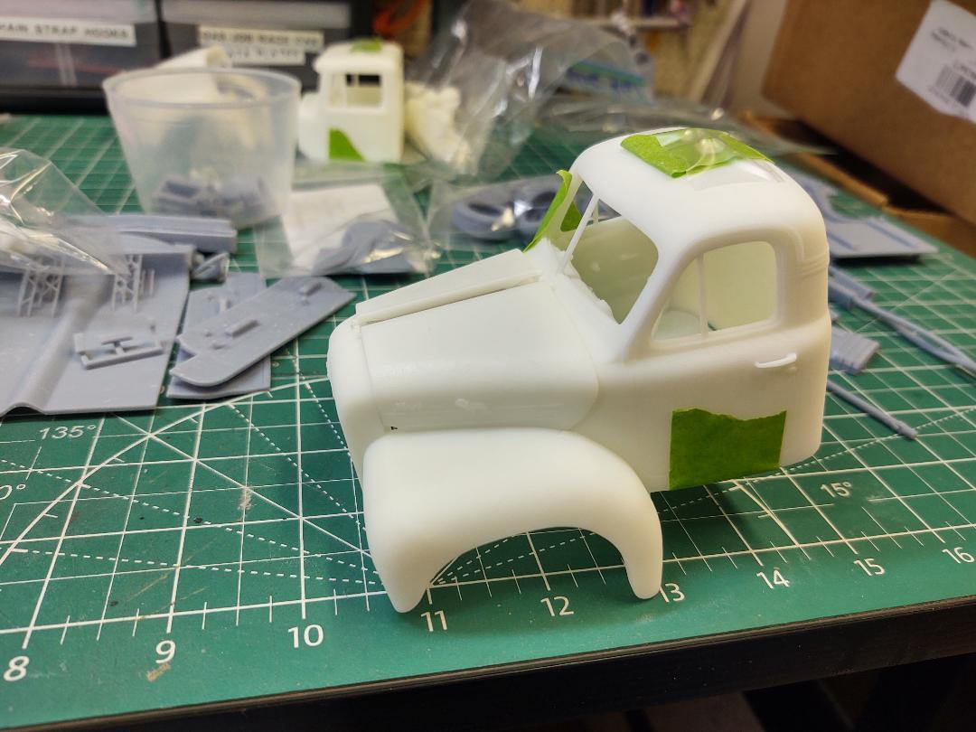

Scott Eriksen Posted March 27 Author Posted March 27 ...................started getting serious on this one today,and the 361 Brockway and the B-61 Mack came from Karl 4

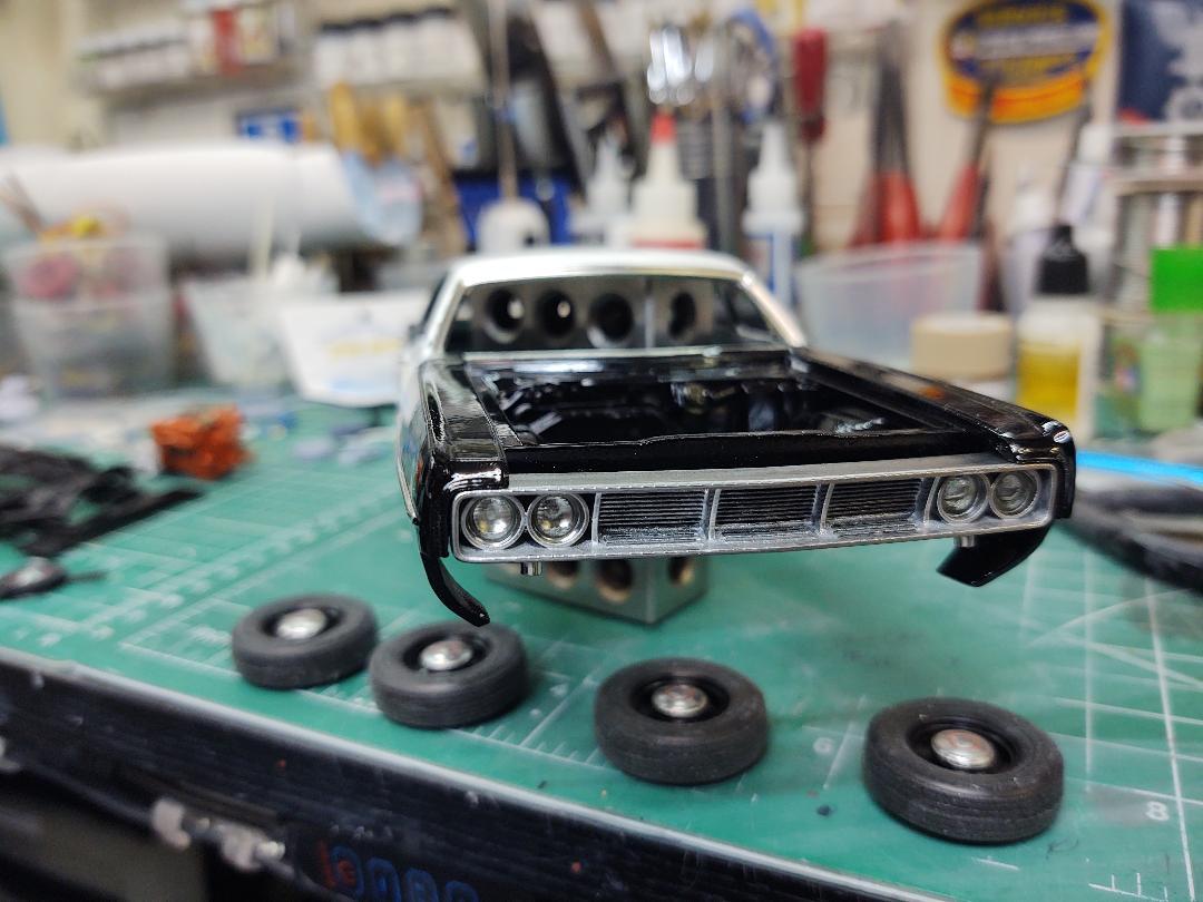

Scott Eriksen Posted March 30 Author Posted March 30 Super nice day today in the 80's ! Cleaned up the yard a bit.........some more progress on the cruiser ,body prep-added side spear moldings ,shoot some primer tomorrow,,,chassis is now the proper wheelbase 6

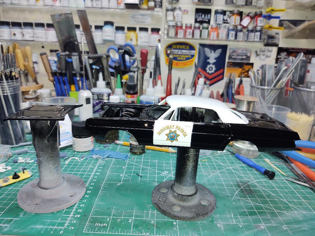

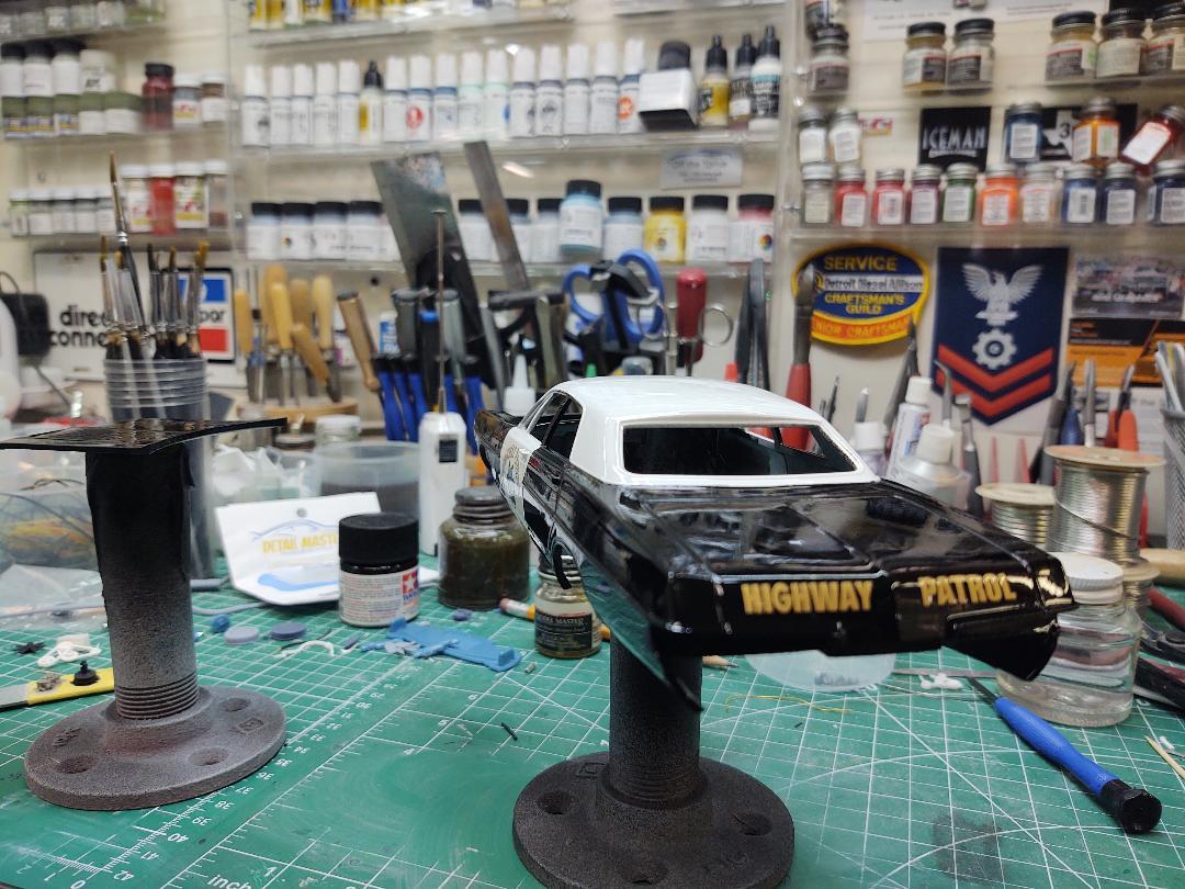

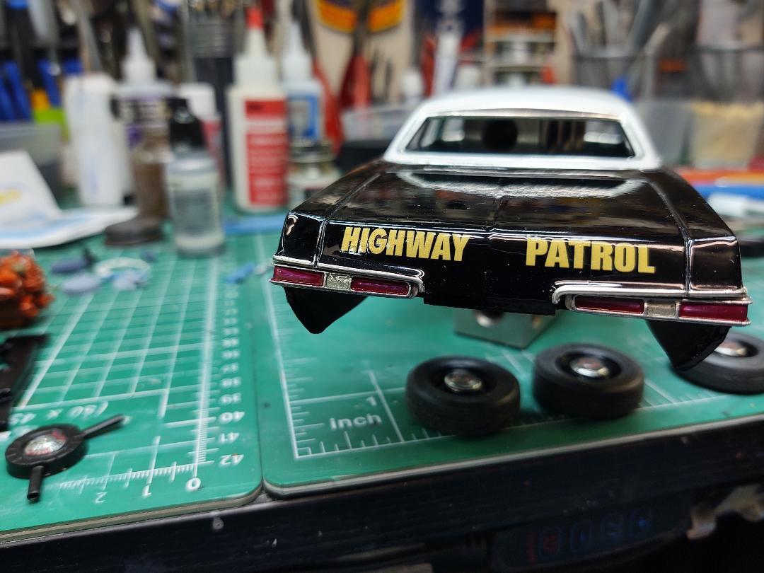

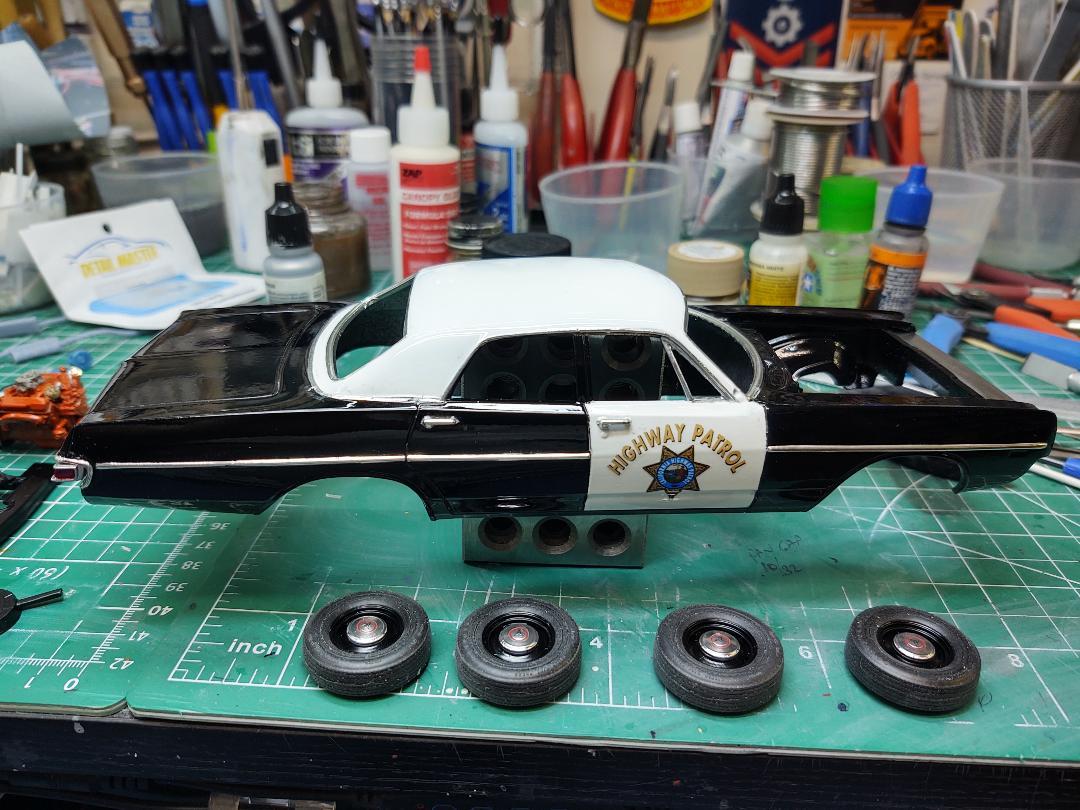

Scott Eriksen Posted April 5 Author Posted April 5 Shot the color,,,(ok black and white) ,decaled and hit with clear ,,some faint 3D print lines are visible which I didn't see with primer but showed with the black mostly on the hood. Next will be some BMF and make the glass with the bucks 8

Scott Eriksen Posted April 6 Author Posted April 6 7 hours ago, AmericanMuscleFan said: Excellent work Scott, the paint looks great and it's a good choice for the floor pan despite the small modifications you have to make to make it fit perfectly. 👍 I especially like the grille and taillights of the '69 Polara, it's a very recognizable design of the Dodge brand, I can't wait to see the photos when you have them installed in their place. 😁 Thanks Francis ! Hit the grille and bumpers today with Revell Chrome,, in the dehydrator now then detail the grille with Argent Silver

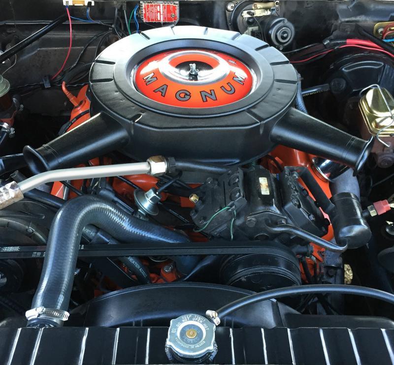

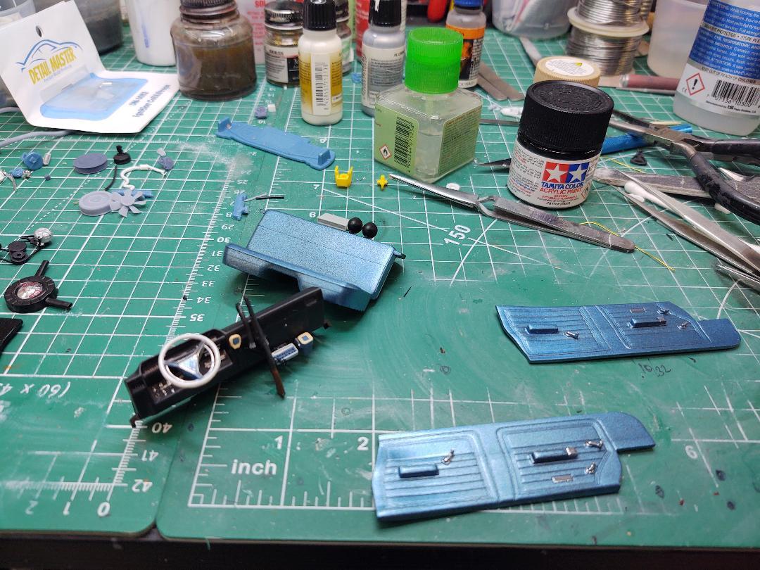

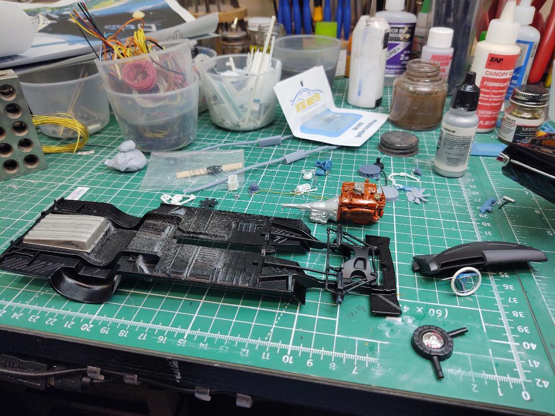

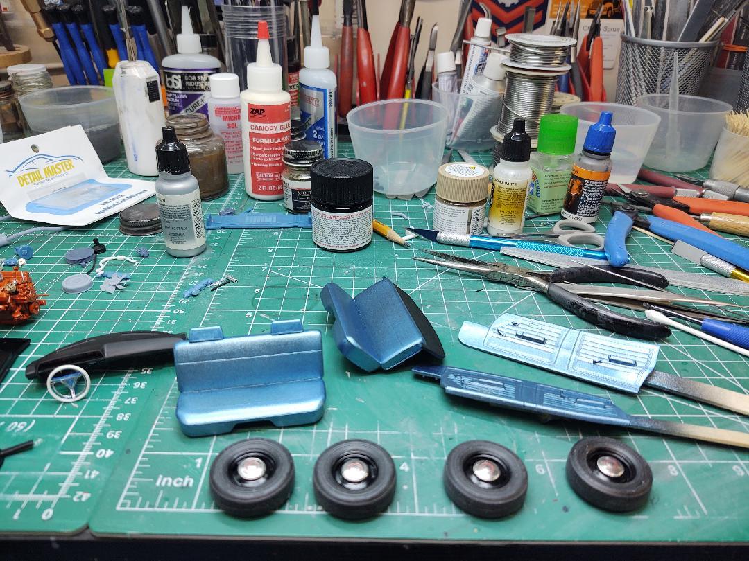

Scott Eriksen Posted April 9 Author Posted April 9 (edited) A little more progress....BMF done....... grille and taillights painted and installed , started assembly of the 440 and cobbled up a dual snorkel air cleaner thought I had a Fred Cady air cleaner decal but I must have used them all,,had to improvise on that. Made headrests for the bench seat ,started on the dash,,from what pics I've found online most are black dash with blue seats but a lot of other combos out there correct or not thats what I'm going with .Fireball wheels/tires and hub caps done .Might start on the windows tomorrow. I also remembered that the 71 Duster kit had the Airtemp A/C compressor so I have that to fit on the 440 Edited April 9 by Scott Eriksen 7

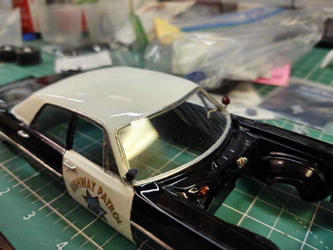

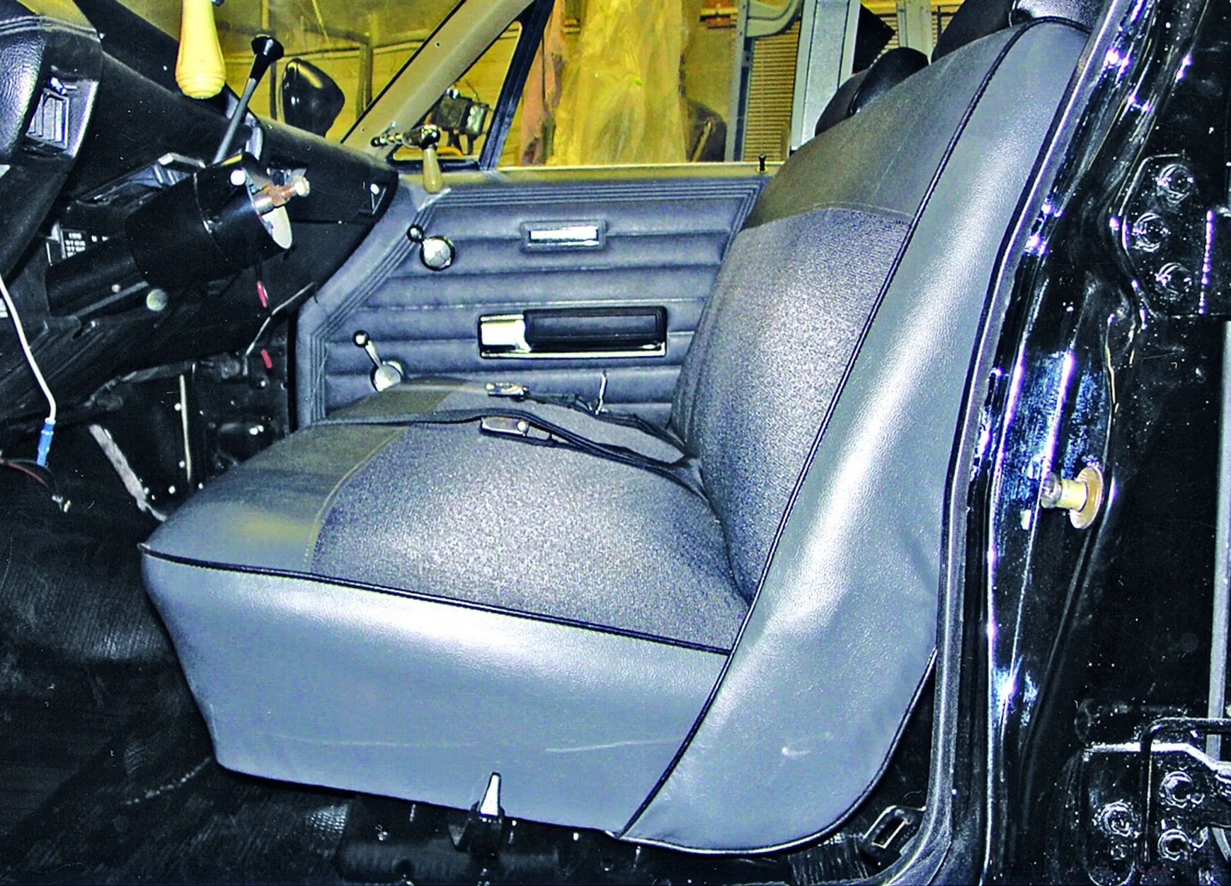

Scott Eriksen Posted April 13 Author Posted April 13 ...........got all the glass cut from Evergreen sheet and installed , I made some A-pillar spot lights from parts bin stuff and brass and aluminum and made the package shelf mounted red flashers ,dash is done , made sorta an old school Motorola radio with the parts DJ sent me and mounted the shotgun ,made a report light and nailed it on top of the dash . 4
BK9300 Posted April 14 Posted April 14 Great job with the foil work, Scott. Your interior is going look like the real deal when your done, too! 1
