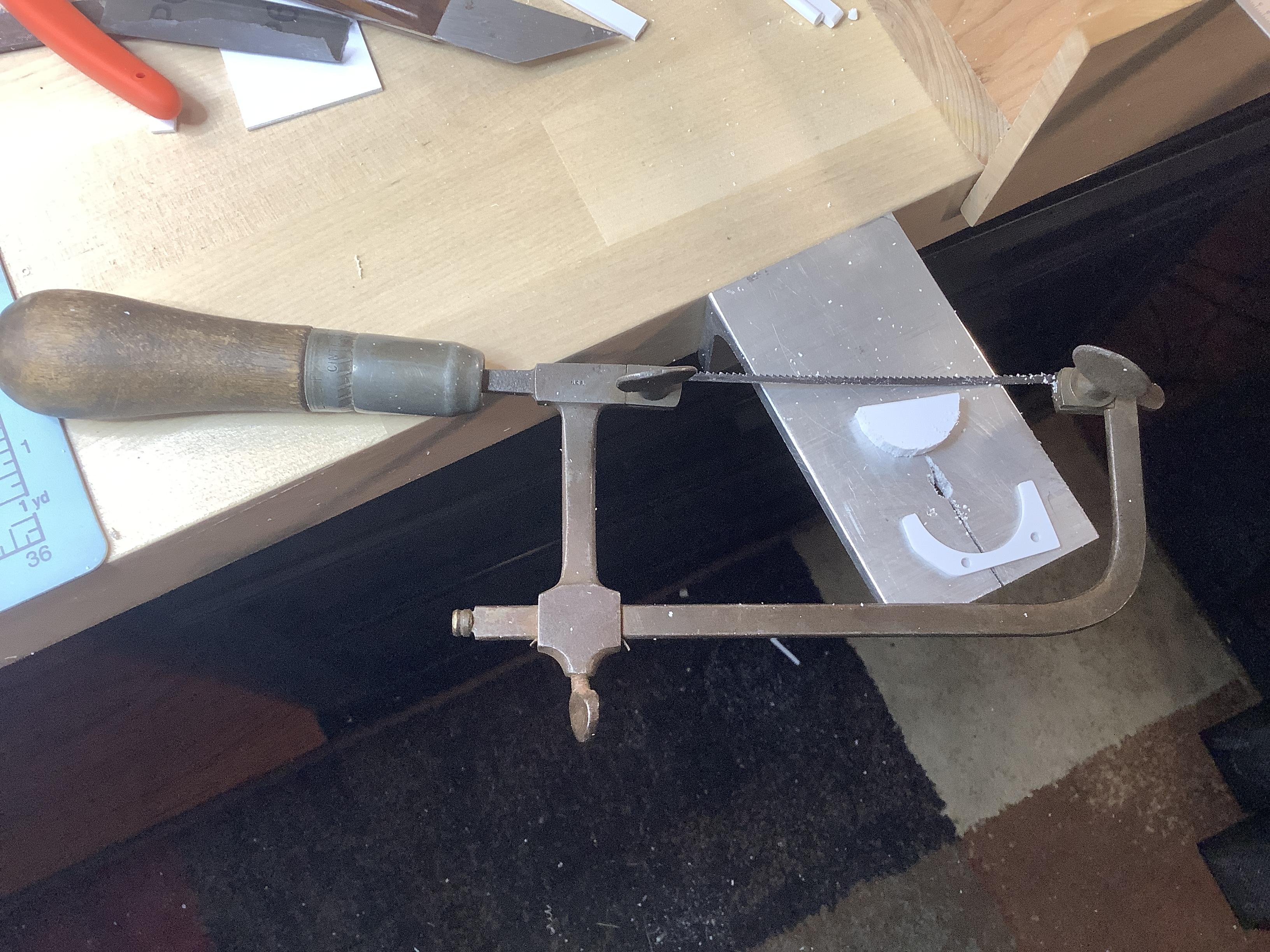

One of the silliest tool I have ever made has become so indescribably handy, is this jewelry’s saw and a thick aluminum angle (jewelers anvil) bolted to my bench. I use this tool more than I could imagine for cutting shapes from flat stock. Takes a bit of practice to cut vertical, but works.
  • Like 6
Looks like it works well - able to rotate your work and keep cutting same spot seems like it would make the cutting easier.
  • Like 1
Brian, it does, but I need to invest in finer toothed blades. In this case I cut four blanks, put glue on places I knew I would cut off, then drilled/pinned the four pieces together, then square the four blanks, layout, then cut. I need different blades for. Very thin material as the teeth catch too much.
  • Like 1
Might be harder to control, but jeweler's round, or wire, saw blades might catch less - good for keeping up the eye-hand coordination!
  • Like 3
