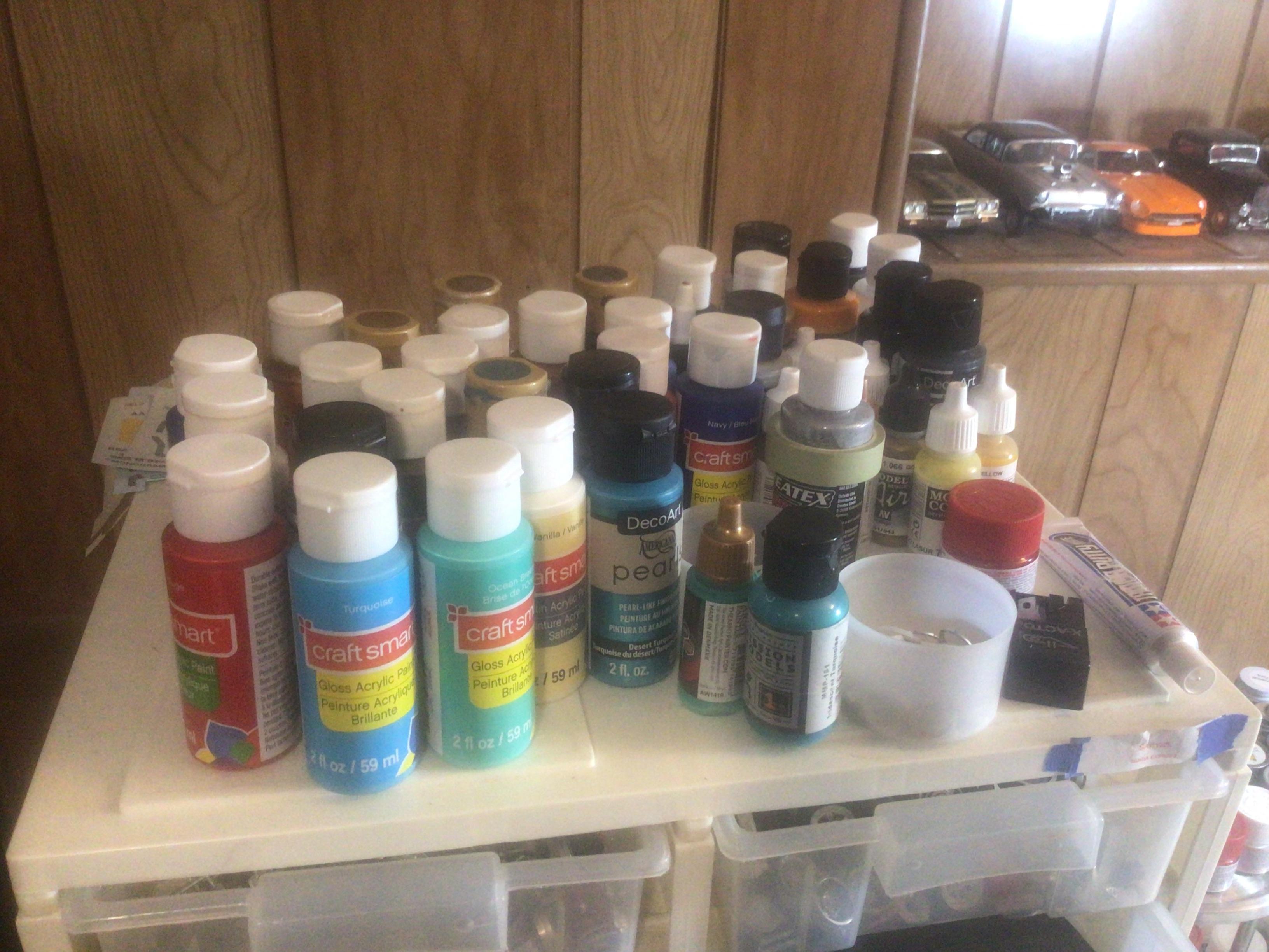

Radretireddad Posted April 3 Posted April 3 (edited) On 4/2/2025 at 8:16 PM, Belugawrx said: Yep..to each his own ..I used spray cans exclusively up until about 10 years ago..now I'm getting into craft paints thru the airbrush. The control is much better..the layers of paint are thinner...not to say you can't get a great finish with spray bombs, just that I found I was covering up alot of details. Have fun Cheers No question about it. I’ve found airbrushing acrylics to be far more economical, forgiving and clean up is a snap. The only downside is that the available colors are somewhat limited but that just means getting good at custom blending different colors. Cheers right back. Edited April 5 by Radretireddad
Valvefloat Posted April 3 Author Posted April 3 20 minutes ago, Radretireddad said: No question about it. I’ve found airbrushing acrylics to be far more economical, forgiving and clean up is a snap. The only downside side is that the available colors are somewhat limited but that just means getting good at custom blending different colors. Cheers right back. Micheals has great colors in craft paint like the colorshift and pearls.
Radretireddad Posted April 3 Posted April 3 Just now, Valvefloat said: Micheals has great colors in craft paint like the colorshift and pearls. Michael’s has an amazing assortment of craft paints and the prices can’t be beat.

Radretireddad Posted April 3 Posted April 3 Duplicating specific manufacturers colors or getting the shade of a particular color still requires custom mixing. Enamel and lacquer users have a couple of online vendors like Scale Finishes and Model Car World that offer exact matching colors but no Acrylic paint lines.

bauercrew Posted April 20 Posted April 20 90% OF my bodies are painted with craft paint i use windsheild washer fluid for thinning and i dont prime just sand the body very well and i shoot the paint ,,,,dry it with hairdryer than i shoot the clear,
