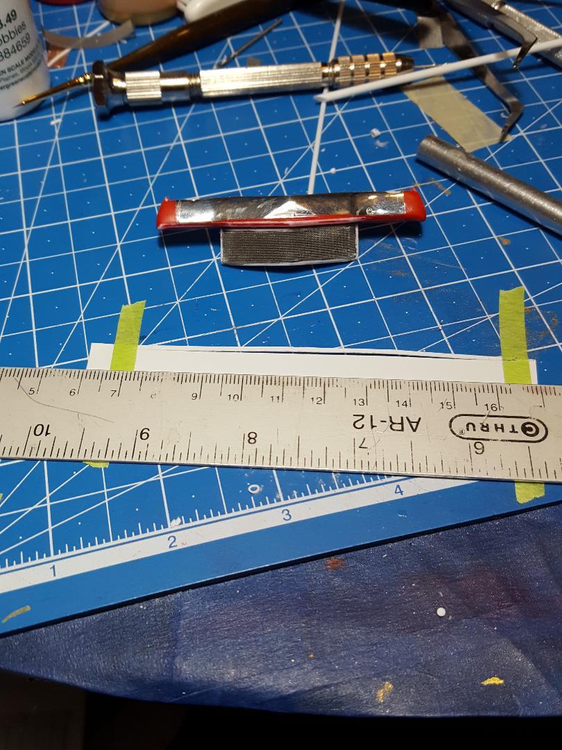

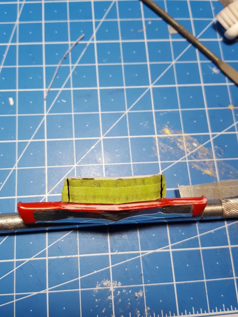

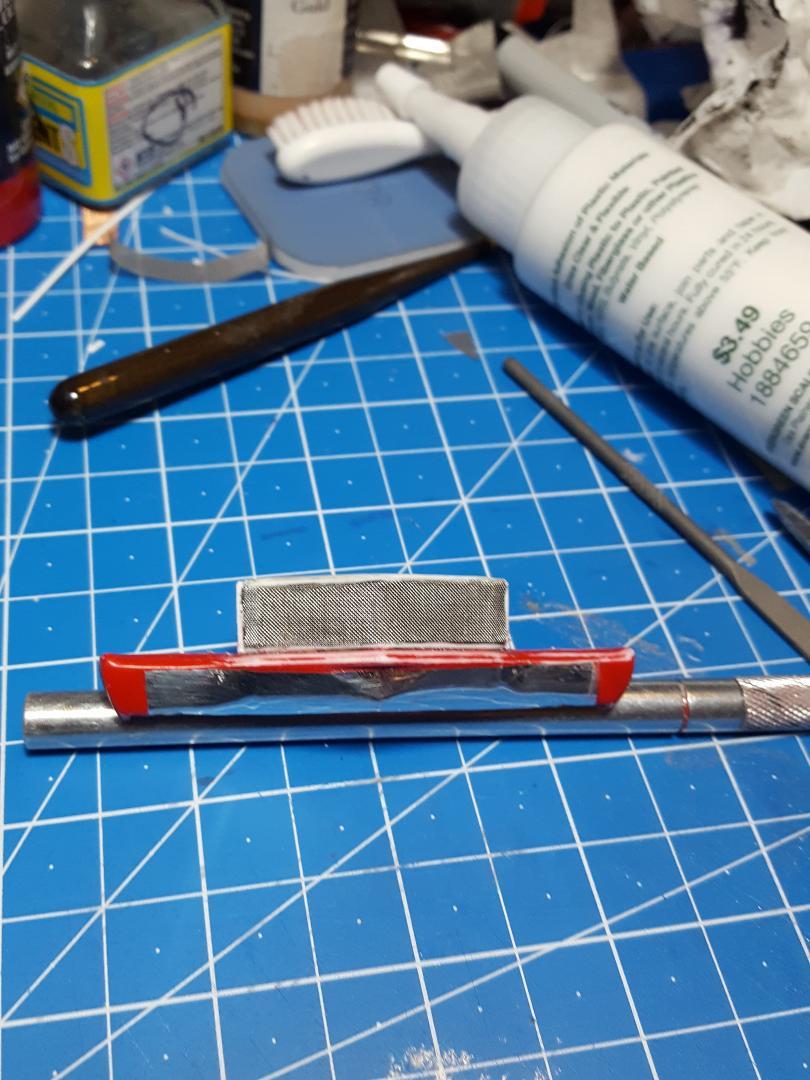

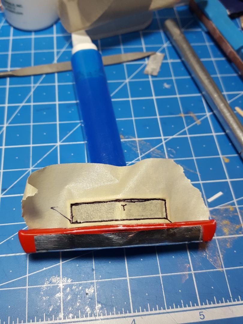

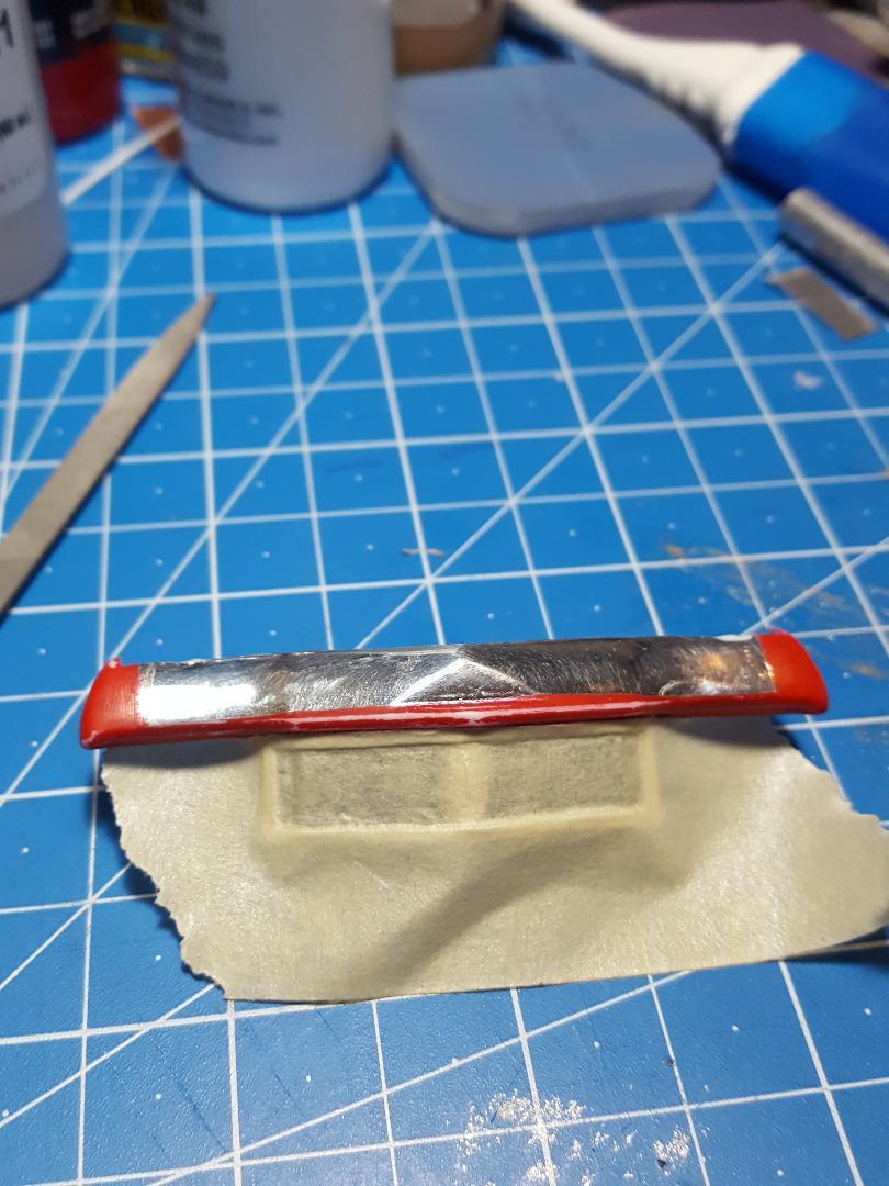

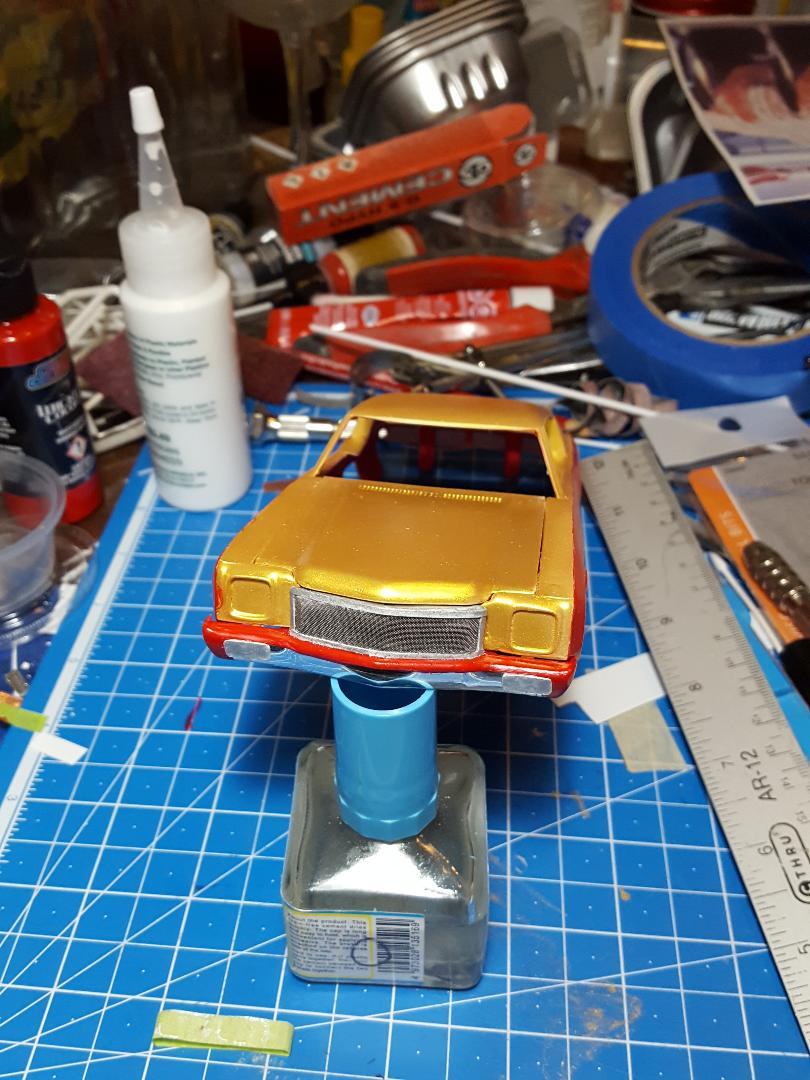

Just need to add the park lamp covers to the bumper and I will be ready to paint the grille/bumper assembly. Then I can start on the engine.
  • Like 3
I'm going to say I'm finished with the grille /bumper assembly. The fit is not perfect by any means but a lot better than you get making the model oob. If you do it that way you get a huge gap between the hood and the grille when the hood is completely shut on the sides. Really bad engineered kit but I don't think they wanted you to build a real Nascar cup car from 1972. More like a local track Saturday night special. For that purpose, it is just fine. On to the engine and eventual completion of this build.
  • Like 1
I missed a touch up spot on the right side next to the right headlight cover. Will fix it before I clear the model.

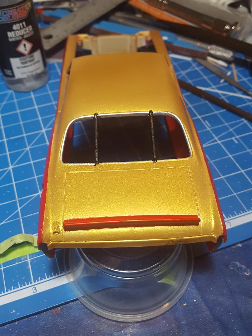

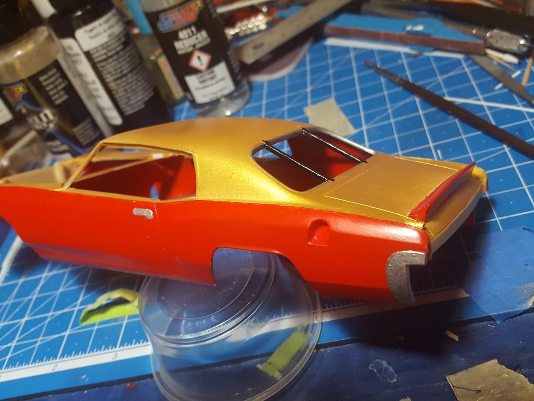

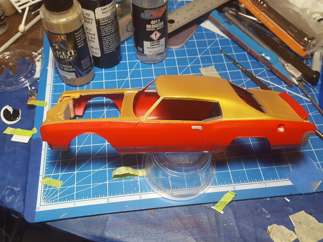

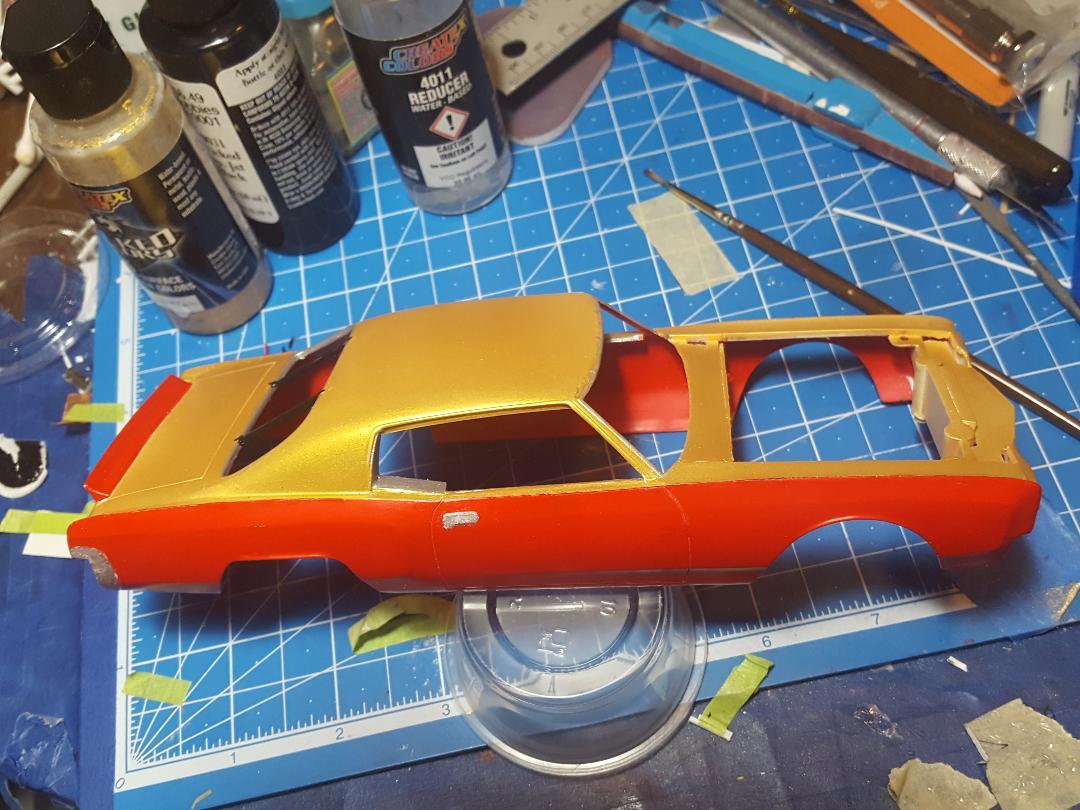

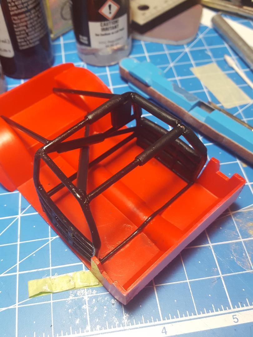

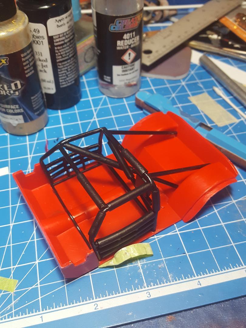

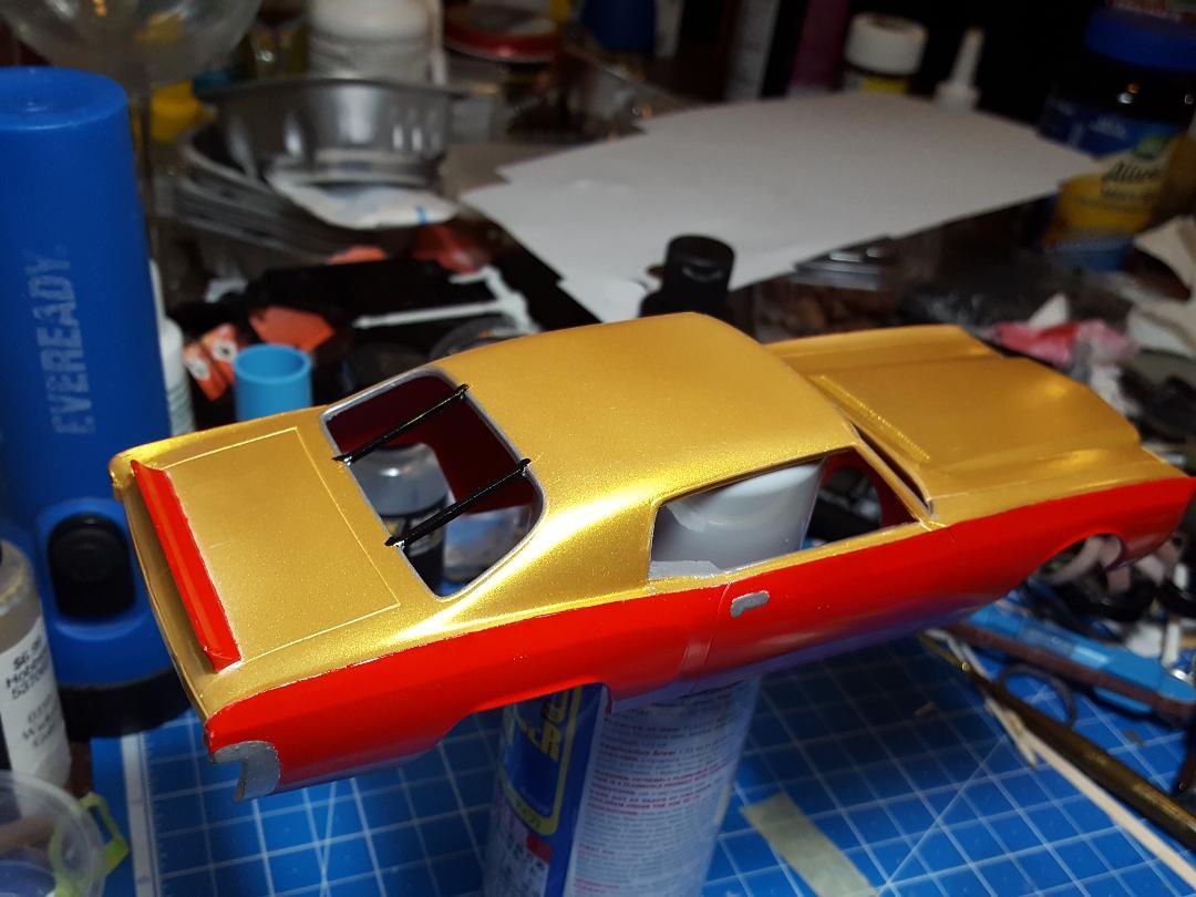

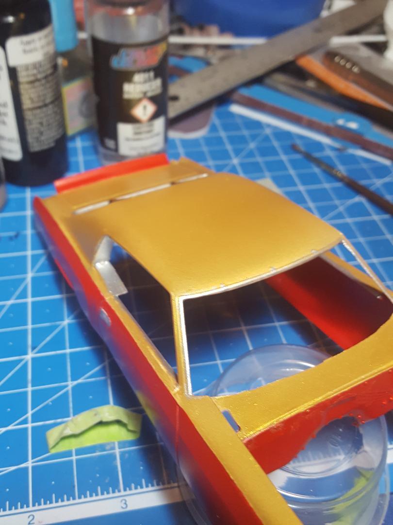

Did some brush painting of various parts that can't be airbrushed. The 1/4 glass fairings , the rear bumper fairings and the door handle depression covers. Also, the windshield and back glass moldings and the rear glass blow out straps. Also had to paint a bar on the interior floor where the cage attaches to the floor. Painted the pads and headrest on the cage flat black to differentiate them from the cage. Need to finally get around to the engine and also need to do the seat and shoulder belt harnesses and hardware. I probably should just glue the hood shut, clear the body and put this baby together and move on to the next build.

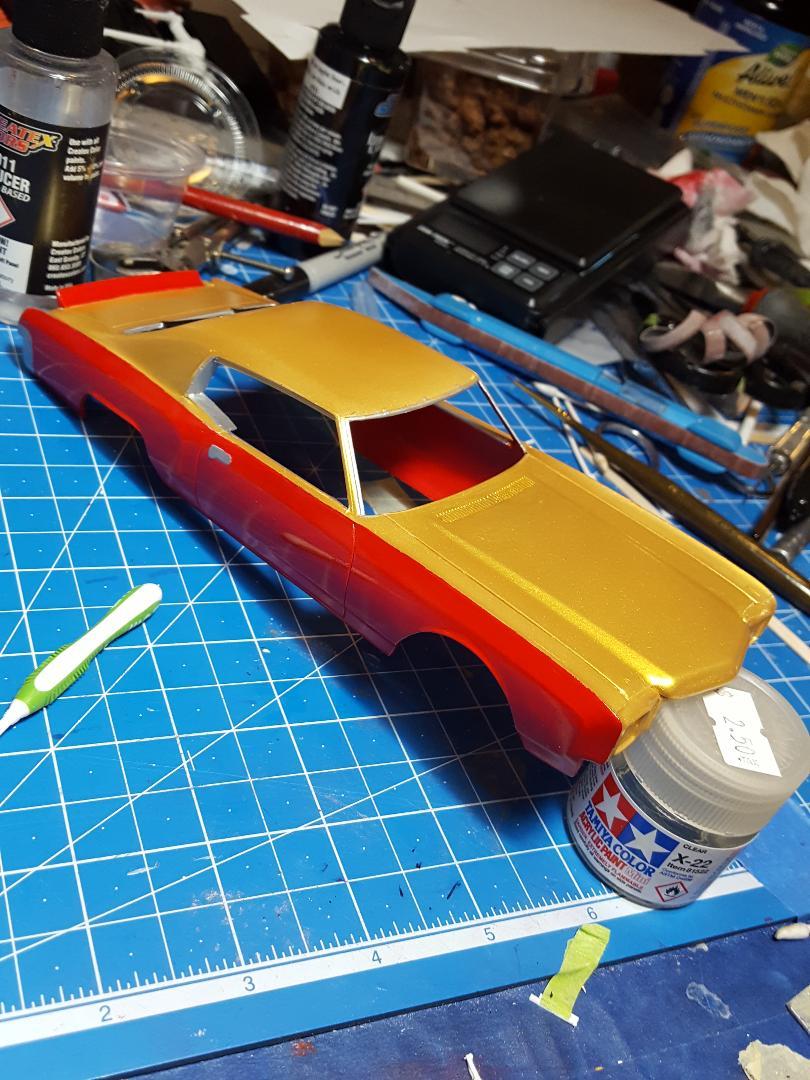

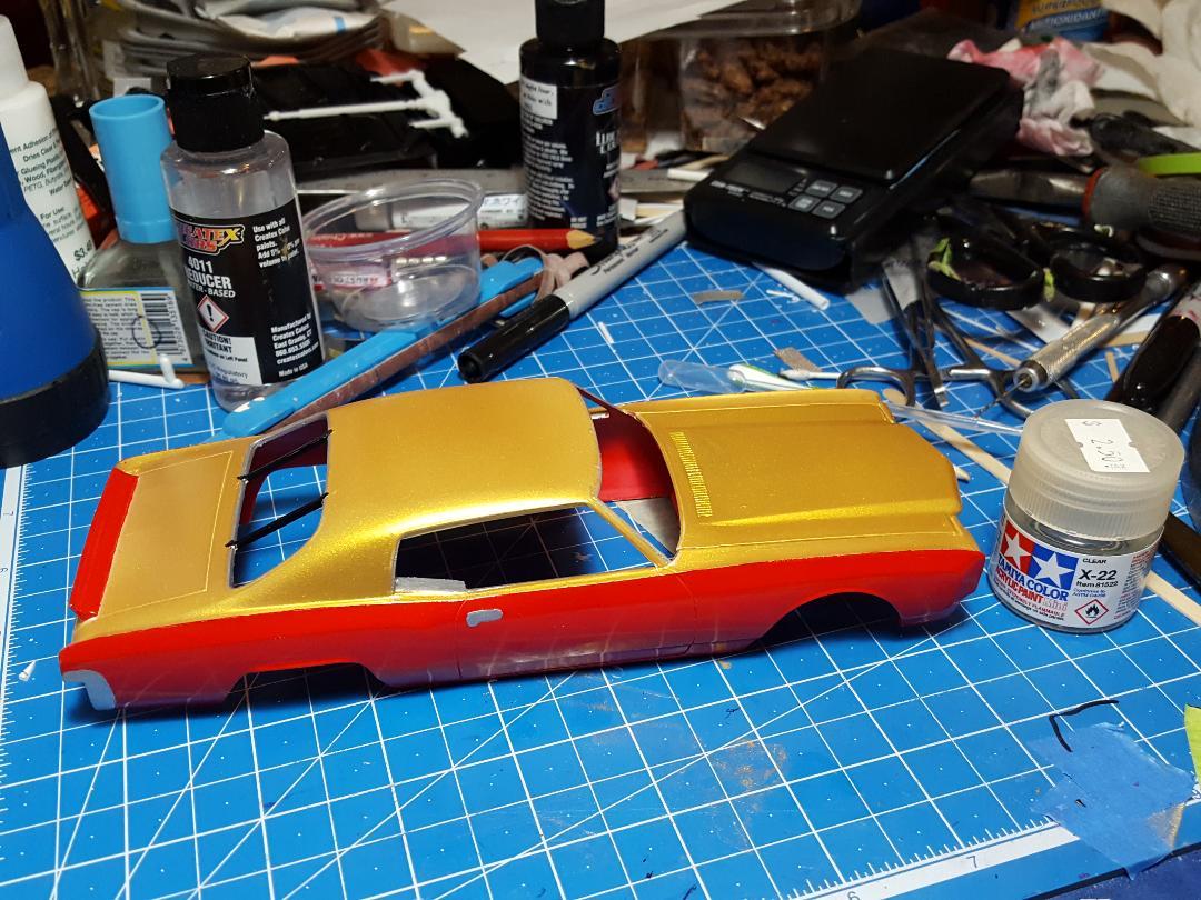

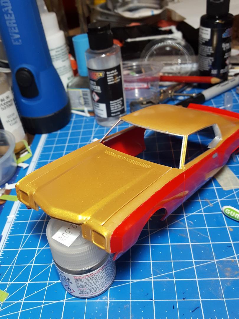

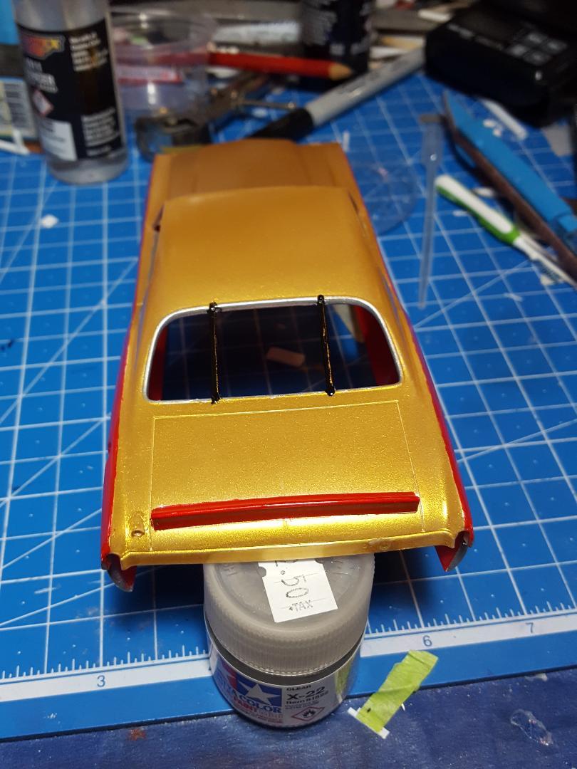

I glued the hood shut and heard that the African dust cloud is coming for most of next week so I real quick got the body ready for the tamiya x-22 clear and shot it this afternoon. Came out glossy enough that I won't have to polish it. if you look closely, you can see the reflection of the gum cleaner brush in the sides of the model. I can't get over how good the acrylic gold paint turned out. Really happy with it. The tamiya clear works really well too. You can get really close and shoot it wet but not enough to let it run and it dries glossy with the home-made flow improver I added to the mix. a little dawn dish detergent and a little acrylic retarder. just 10 drops added to the 10-gram mix of clear.
