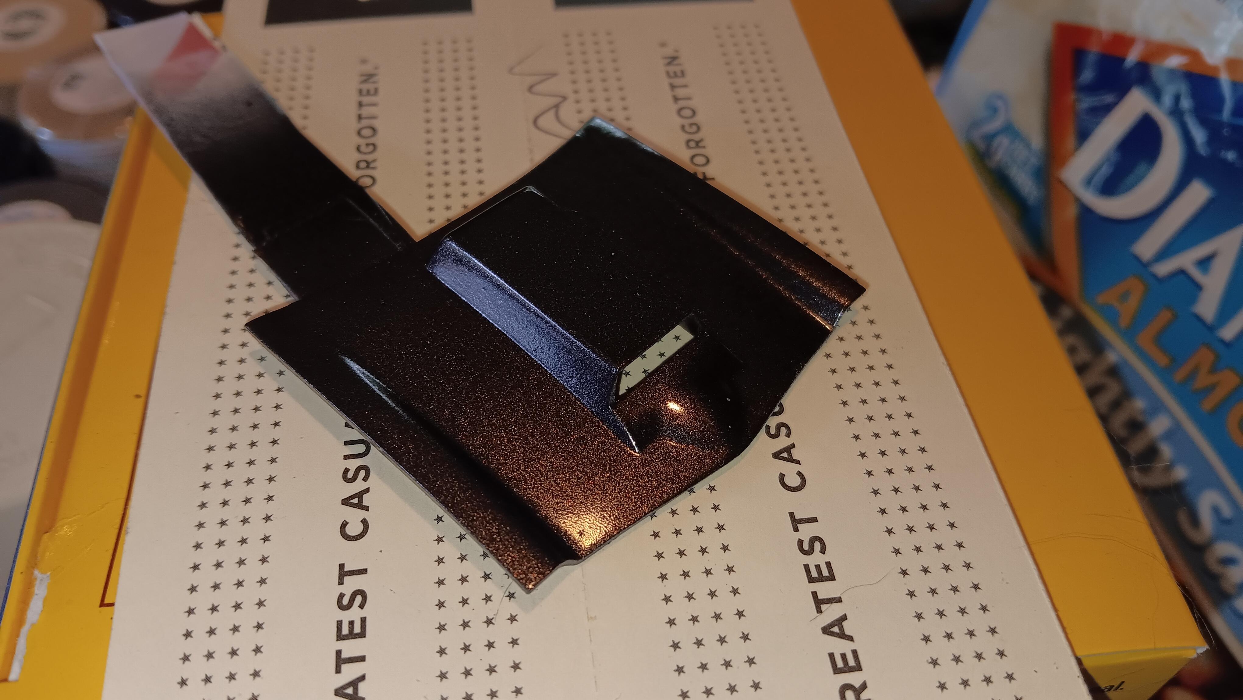

I saw a post on here from 2023 of someone using dupli-color 1k clear coat (which is what i’m planning to use), one of the comments said that it didn’t like being wet-sanded but i’ve tested it and i don’t find anything wrong with it does anyone know if there’s a problem with this ?? and also, should i apply decals and metal transfers before or after the clear coat? if after, do i apply them before or after wet-sanding ?

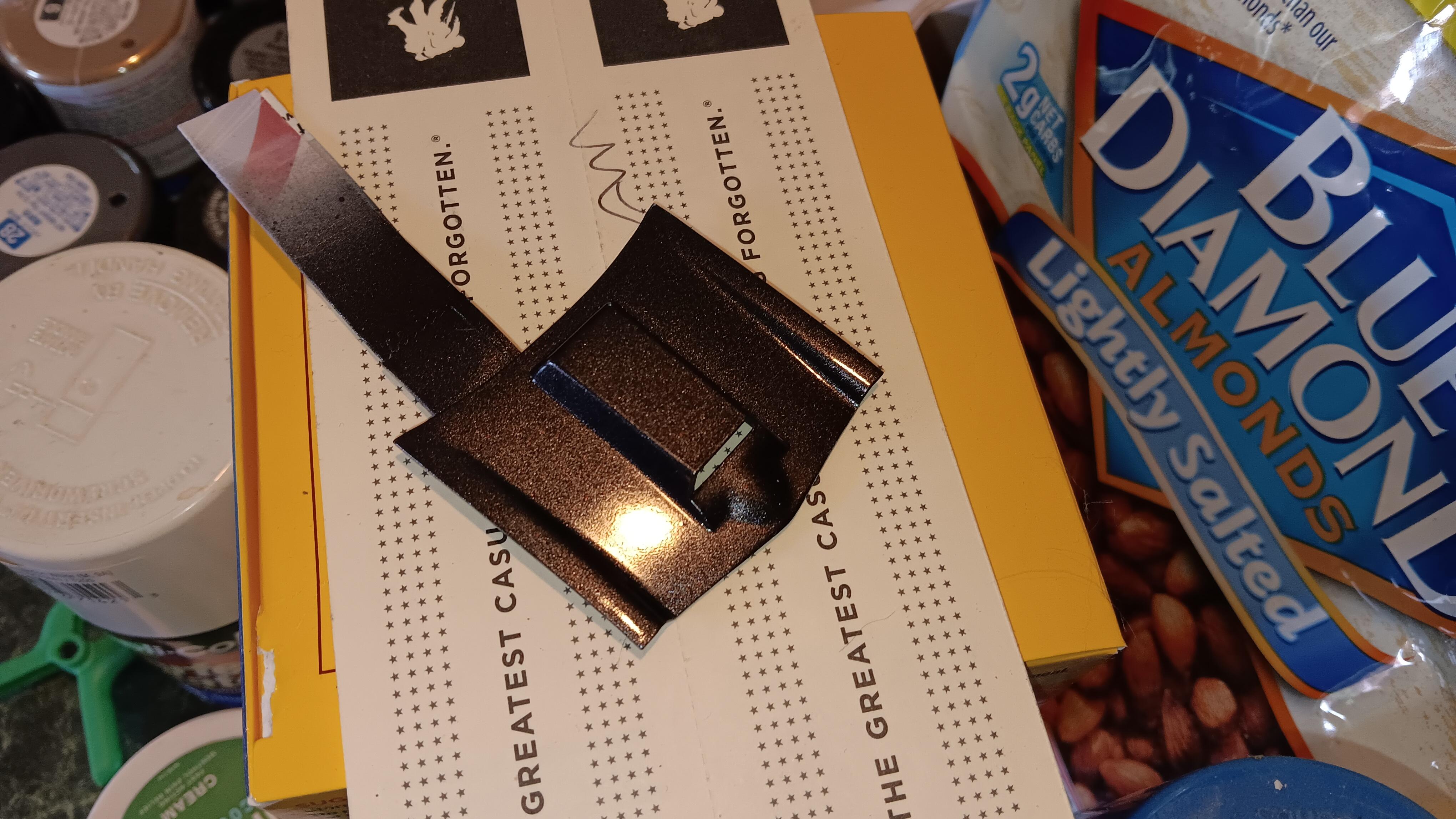

ur right, it holds its shine as it dries but my “problem” is orange peel as u can see in my pic
From your photo, it looks like your attempt to cut and polish has been successful. I don't see a problem with it. If it was mine, I would carry on.

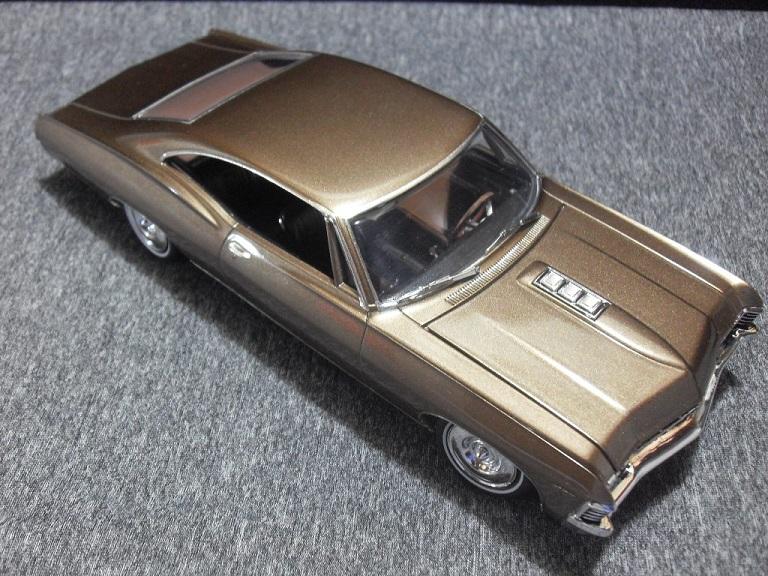

I used it for the 1st time on these 2
the Sox-Martin car is wet sanded and polished
And I have ZERO complaints with it .
Maybe one of the best paint jobs Ive ever done with a rattle can 20250328_134201.jpg.ceb1137b6e38d4b80954f501e58b0d07.jpg20250329_144952.jpg.a37cca60aa1e771e419262cdefd3f980.jpg20250408_084131.jpg.70b9ad162f5c7c591232a9dc1ac7376b.jpg20250414_170801.jpg.af0c5343a9d3f0971d70ccaddb277662.jpg20250414_170752.jpg.43158c2c4aaf5e4d16f5a585eaa58a81.jpg20250415_170530.jpg.90b7567619376646a2828a4fb33193ad.jpg20250415_170519.jpg.32480b1de9c7235bd08b596ace016e6c.jpg
