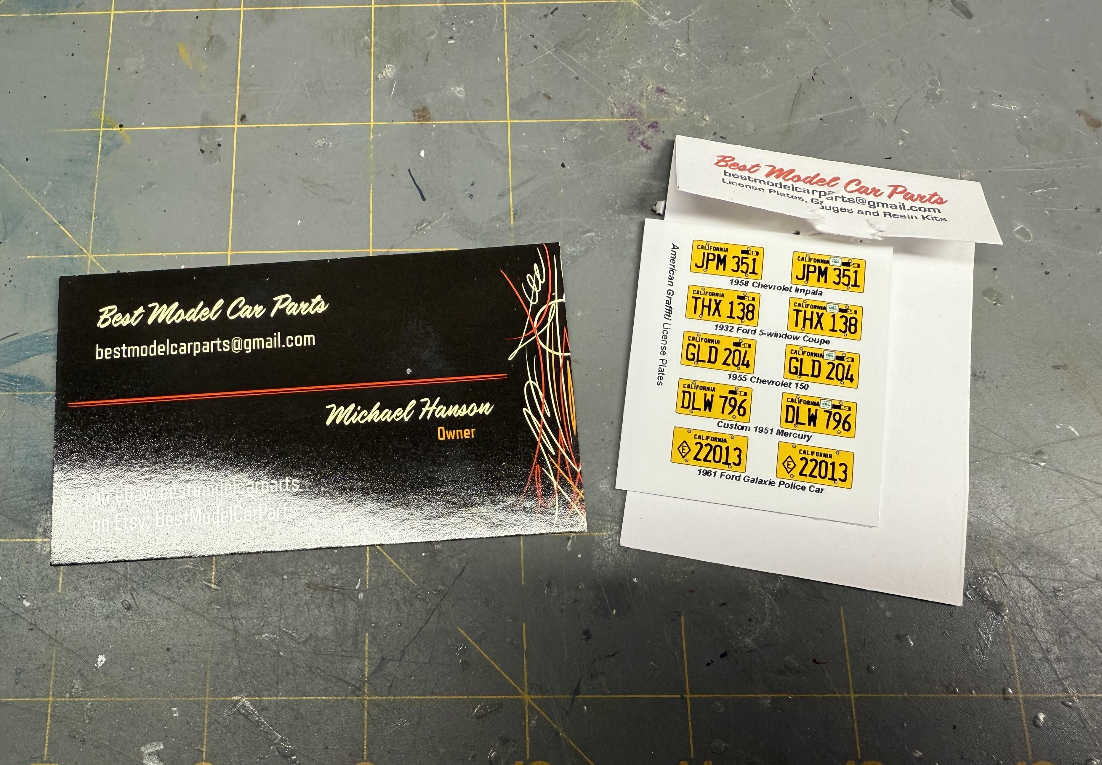

Twokidsnosleep Posted August 22 Author Posted August 22 Starting on the license plate print This is version 2.0…there will be more
