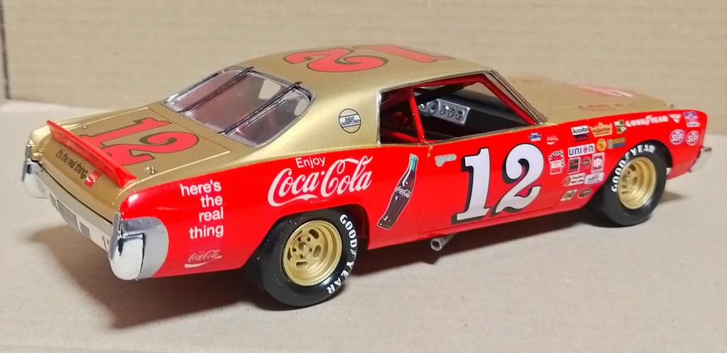

This car is Bobby Allison's Chevrolet Monte Carlo, which won 10 of the 31 races in the 1972 NASCAR Winston Cup Series.
This was the beginning of the “modern era” of NASCAR, when the number of races was reduced from the previous year's 48 to 31, all dirt tracks were eliminated, and the minimum race distance for oval tracks was set at 250 miles.
The base kit is AMT's “BOBBY ALLISON MONTE CARLO STOCK CAR,” which was re-released by ROUND2 LLC in 2017. The packaging design follows that of the original 1972 release, with all-new decals added.
This kit is not a 3-in-1 kit, but a kit that can be assembled only as a full display NASCAR race car. The body style is a good reproduction of the real car design, but the chassis and cockpit had to be modified in various ways.
1. Body
Looking at the photos of the actual cars that Bobby drove during the 1972 season, most of them looked like the 1971 model with the narrow radiator grille and the turn signal lamps in the bumper.

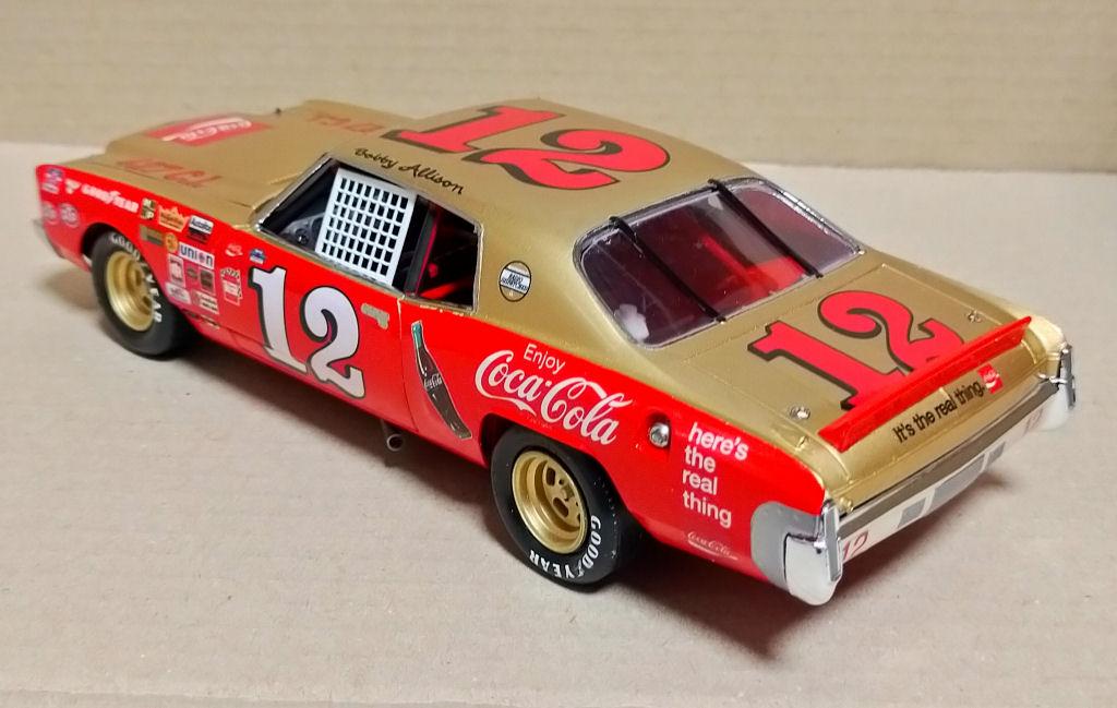

Therefore, I cut both ends of the radiator grille and filled the gap inside the headlamps with plastic plates.
The rear window was cut to fit the window opening of the body and fixed.
In addition, a vent hose and an overflow hose outlet were added on the left side of the rear of the body.

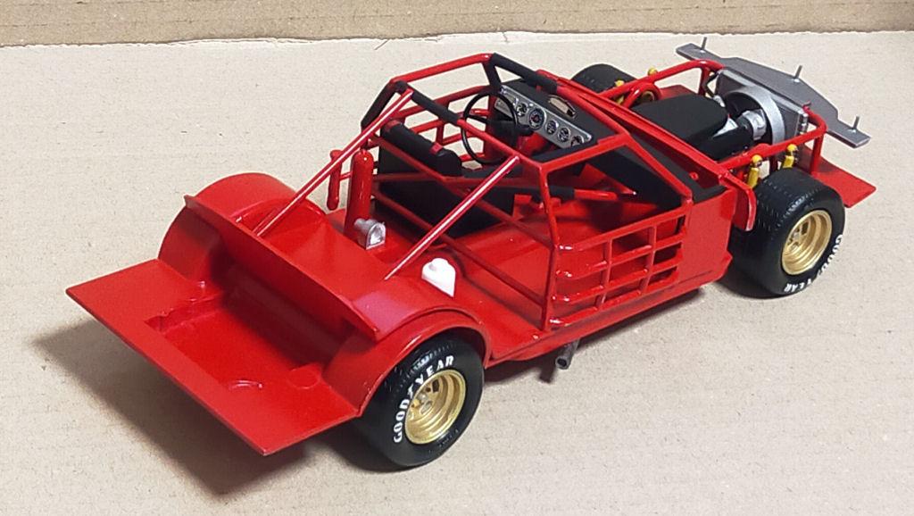

2. Chassis
This kit does not reproduce the engine compartment pipe frame or front suspension.
Therefore, I created a front hoop with Evergreen rods and incorporated upper A-arms, twin shocks, and a radiator diverted from AMT's GEN4 nascar kit.
The engine is unmodified, but the exhaust pipes were replaced with plastic pipes.
The chin spoiler was made by myself with thin plastic plates, and the ride height was lowered a little.
3. Cockpit
The roll cage of the kit was not very realistic, so I made a roll cage combining parts of AMT's GEN4 nascar kit and Evergreen rods.
The dashboard was similar, so I replaced it with a combination of plastic sheets and monogram meter panels.
The gauges are made from Powerslide decals.
The shifter was modified and installed from parts of an old JO-HAN kit.
4. Wheels and Tires
The wheels are 5-hole type wheels found in a junk parts box, and the tires are PPP 1965-1969 Goodyear Tires.

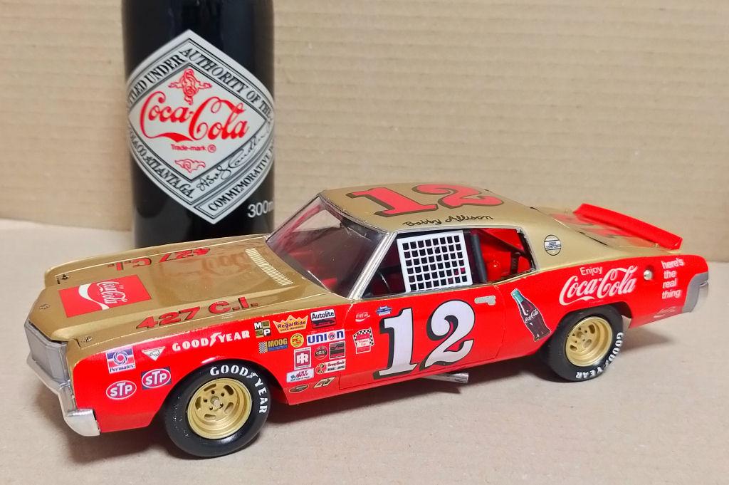

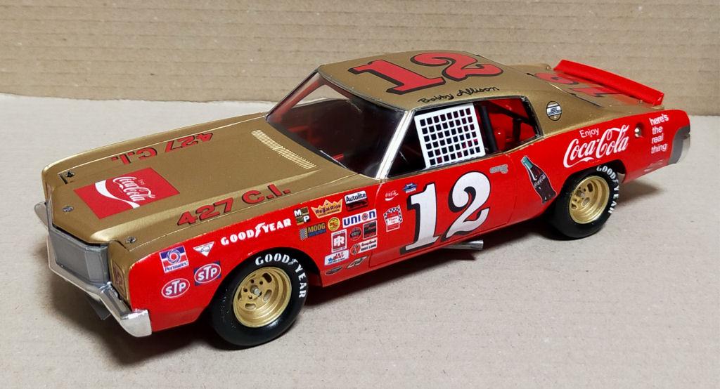

5. Painting and Marking
The body was painted with Tamiya Super Surfacer (gray), Fine Surfacer (white), and TS-13 Clear, then sprayed with TS-49 Bright Red, TS-21 Gold, and overcoated with TS-13 Clear, then applied the kit decals.
Finally, after the decals were sufficiently dry, I sprayed a final coat of GSI Creos water-based topcoat premium.
As mentioned above, I made various modifications, but since I could find few images of the engine and cockpit of Bobby Allison's actual car, the images reproduced are only based on the specifications as a NASCAR race car in 1972.
Note that the Coca-Cola glass bottle in the image was sold in 1981 by the former Tokyo Coca-Cola Bottling Company, established in 1956, to commemorate the 25th anniversary of the company's founding.
