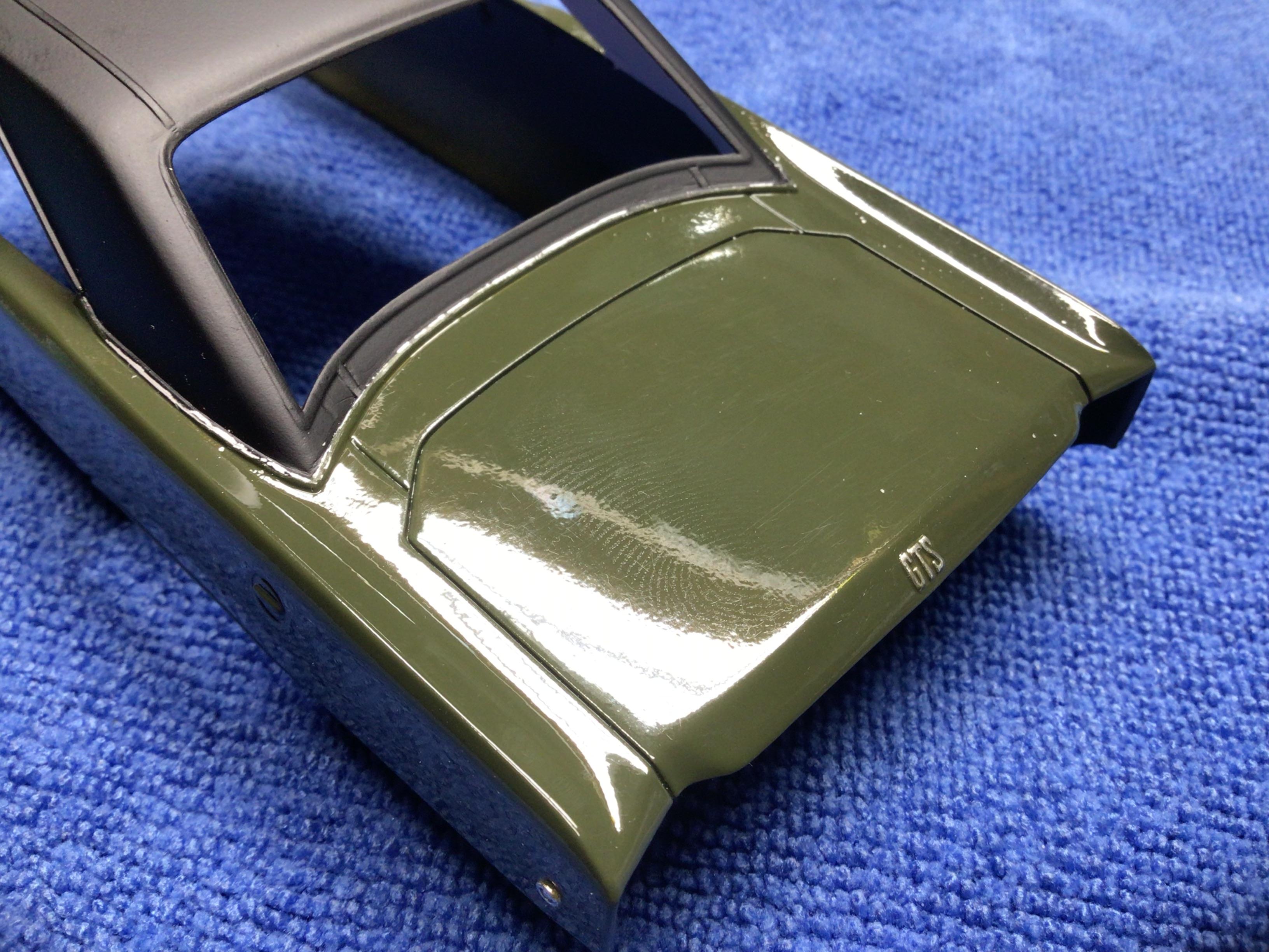

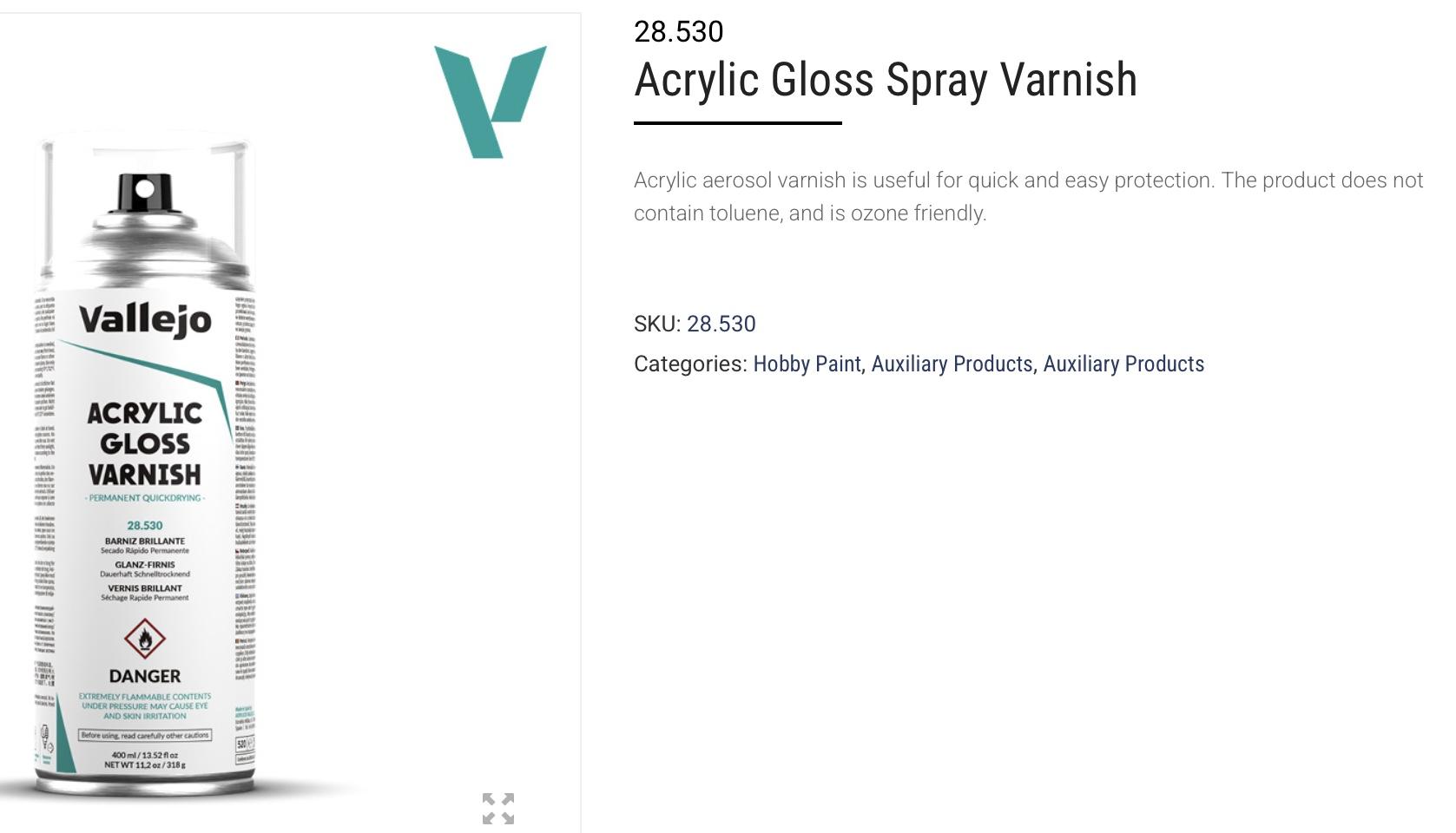

NOBLNG Posted May 27 Posted May 27 Has anyone used this stuff? I bought a can on the recommendation of a local hobby shop. It seems to have a nice gloss, but it comes out like a firehose. Just wondering if anyone knows if it can be polished using conventional methods? The only info I can find on Vallejos site is what you see in the pic.

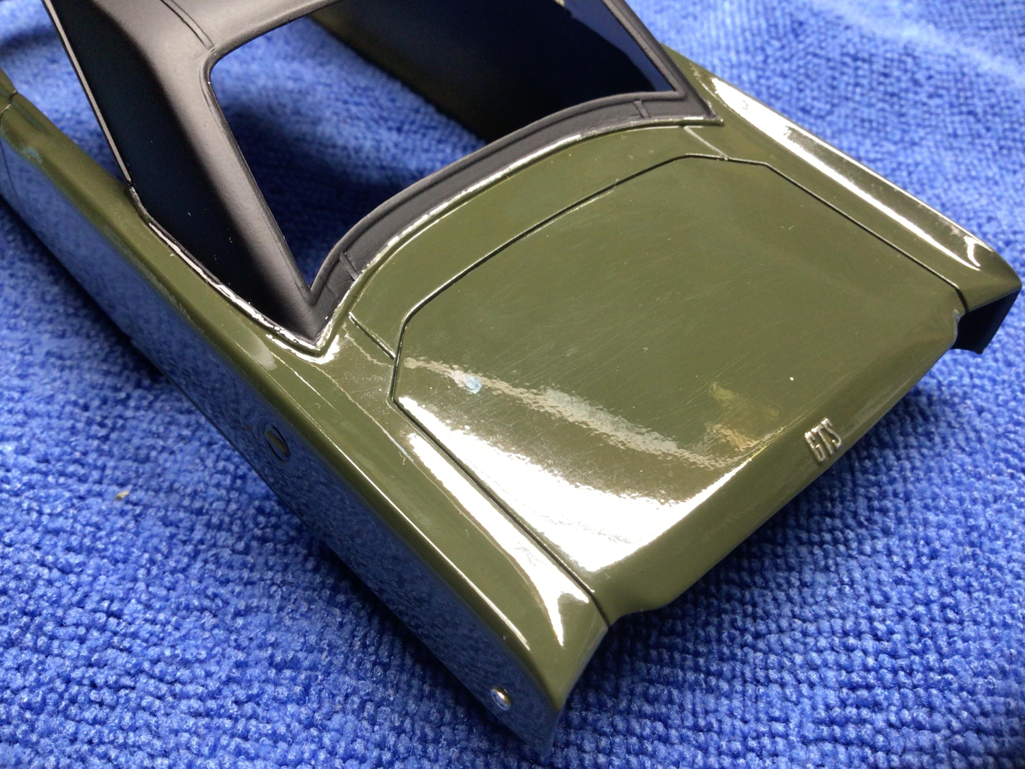

NOBLNG Posted June 2 Author Posted June 2 (edited) Well I am sure not impressed with this stuff.😕 After a week in the dehydrator it collects finger prints like crazy. They will wipe off with a very hard rubbing with a micro-fiber cloth. They can be polished off with Tamiya fine polishing compound, but more handling results in more fingerprints that again won’t wipe off easily.🤬 I guess this will wind up back in the pond…again.😕 I really like Mr. Hobby clear but the LHS I got this from is always sold out of stuff. Edited June 2 by NOBLNG Rubbed it harder.🥵
Dave G. Posted June 2 Posted June 2 It looks like, from your photos anyway, that it goes on way too heavy.
NOBLNG Posted June 2 Author Posted June 2 5 minutes ago, Dave G. said: It looks like, from your photos anyway, that it goes on way too heavy. As I said, it comes out like a firehose…however that should have no effect on the finish durability. A week in the dehydrator should be plenty of time to have dried it completely.
