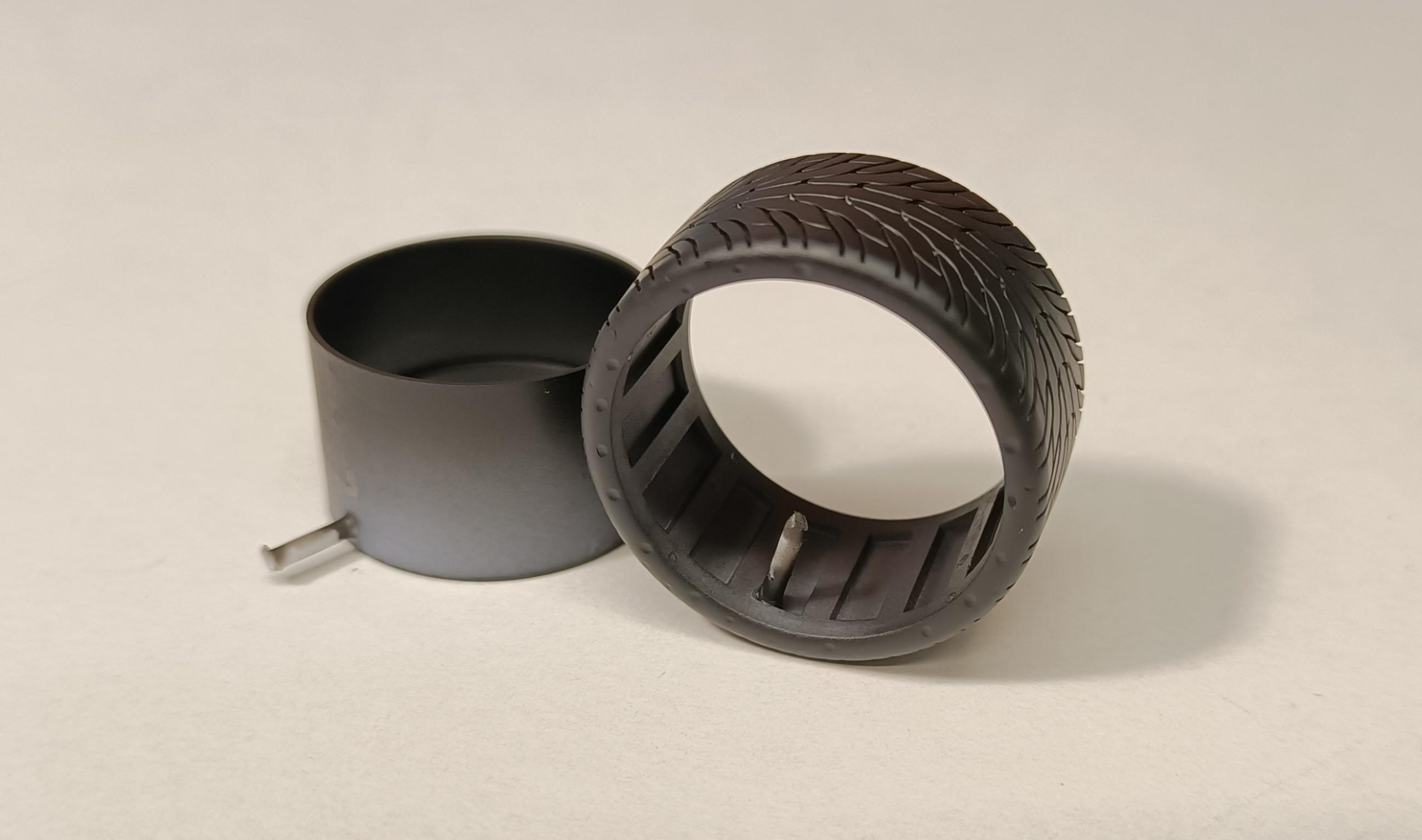

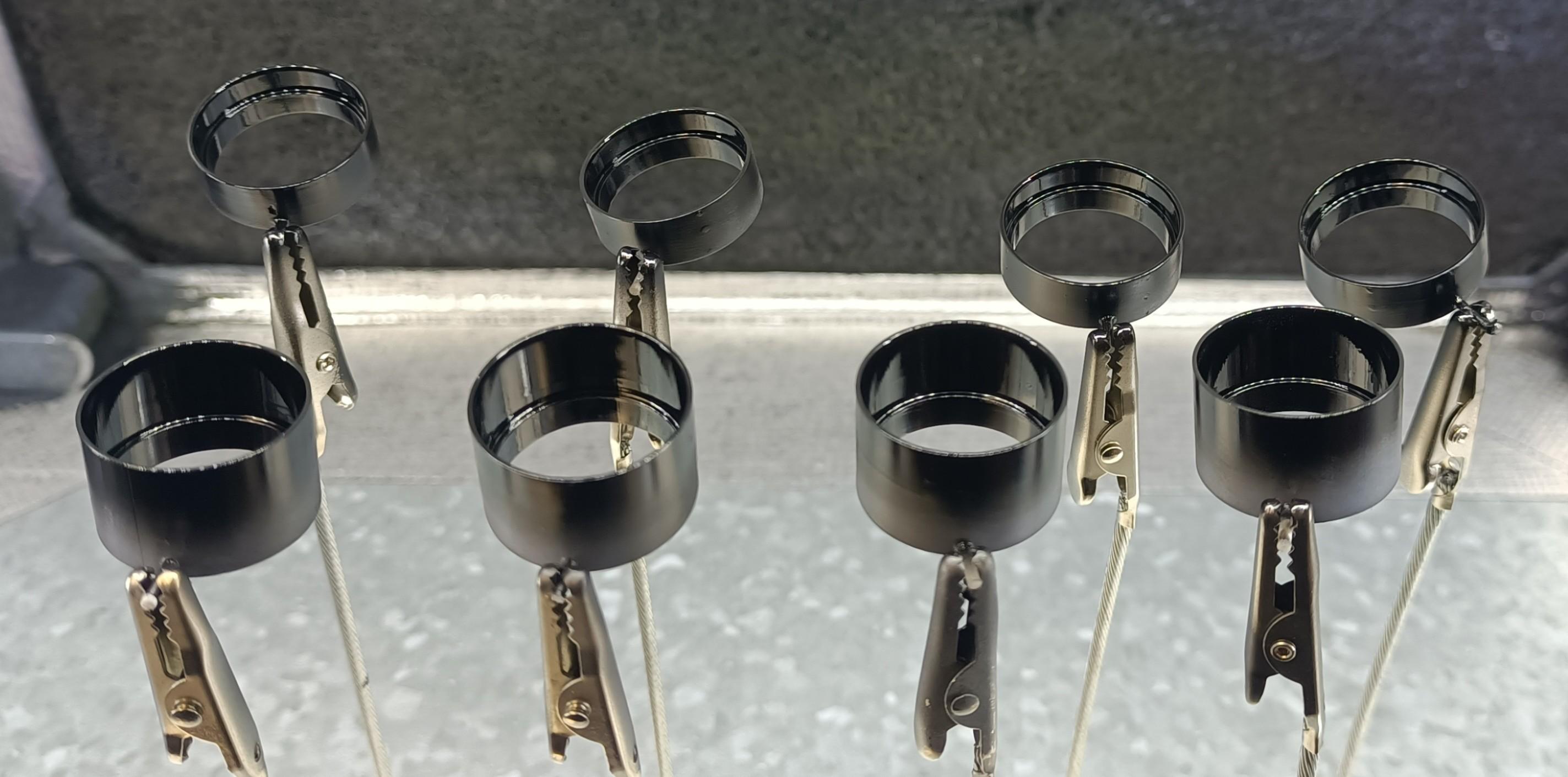

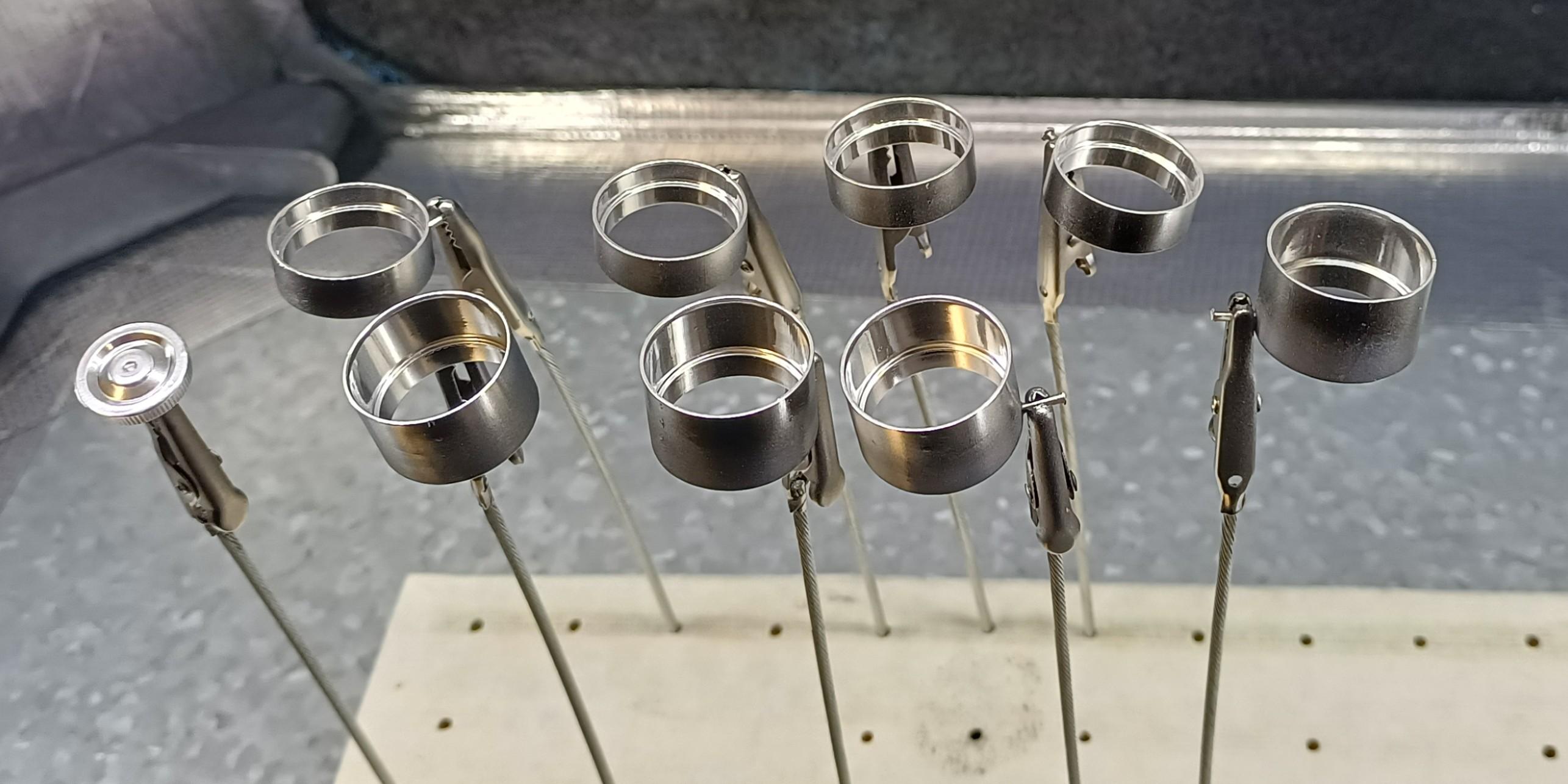

Glue on some small handles that can be held with a clippy stick. Use CA glue and it can easily be snapped off and excess glue removed with a blade.
Also do the same for tyres.

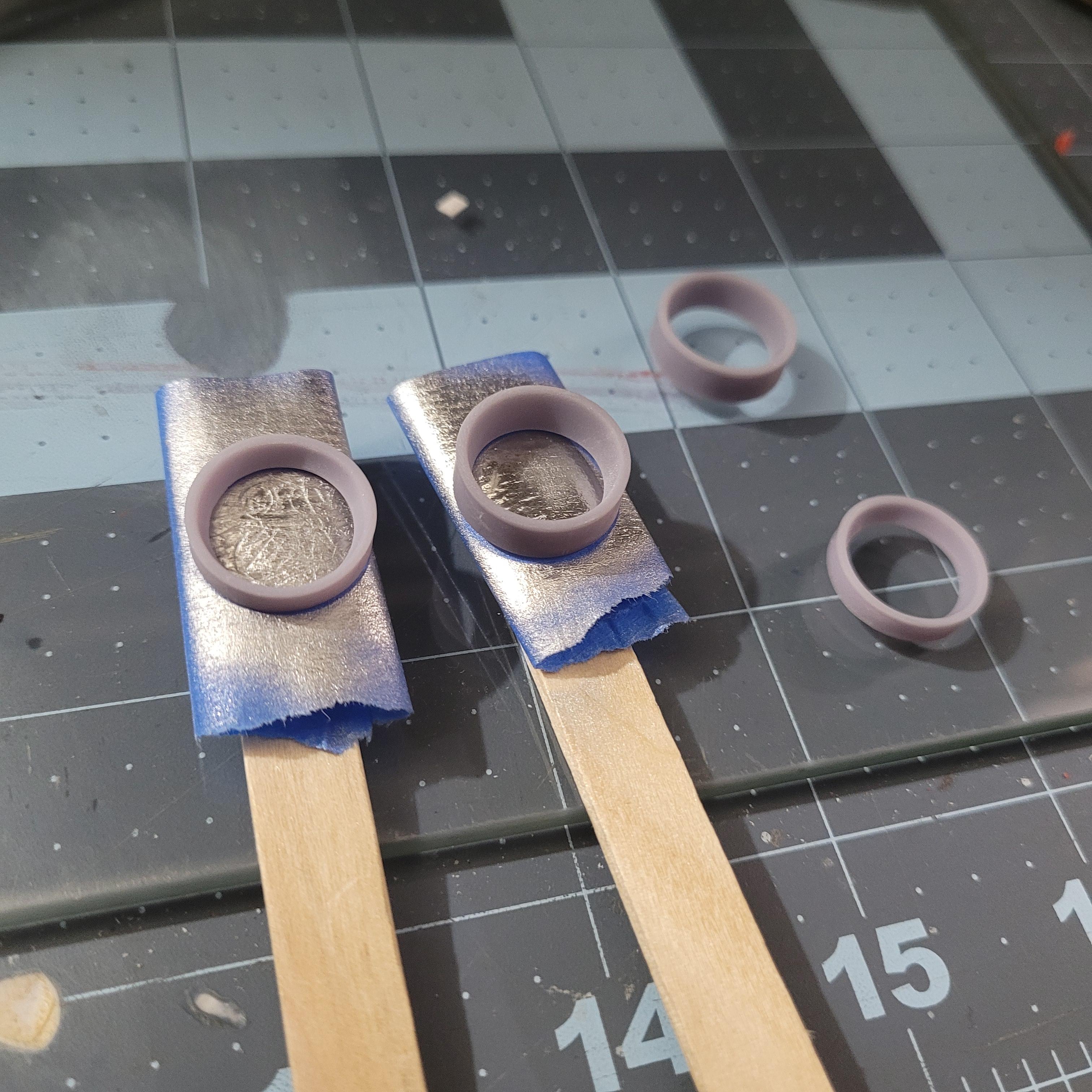

You could also cut a disc from cardboard about the size of your rings. Glue a long piece of sprue (or any round rod) to the center with CA, and then use double face tape or a tape loop to attach the rings. Then you can spin it as you spray. A bottle cap might work instead of the cardboard disc?

I find it works well as you just rotate the stick and the paint hits the surface and circulates through.
Having the hoops on the tape the Molotow hits the surface and the tape which circulates the spray back onto itself which is like having over spray going into the wet paint. And being that Molotow needs to go on heavy and wet the overspray would be dulling the chrome effect.
I found Molotow is way to finnicky and takes forever to fully harden/cure and even then the surface is not very durable.

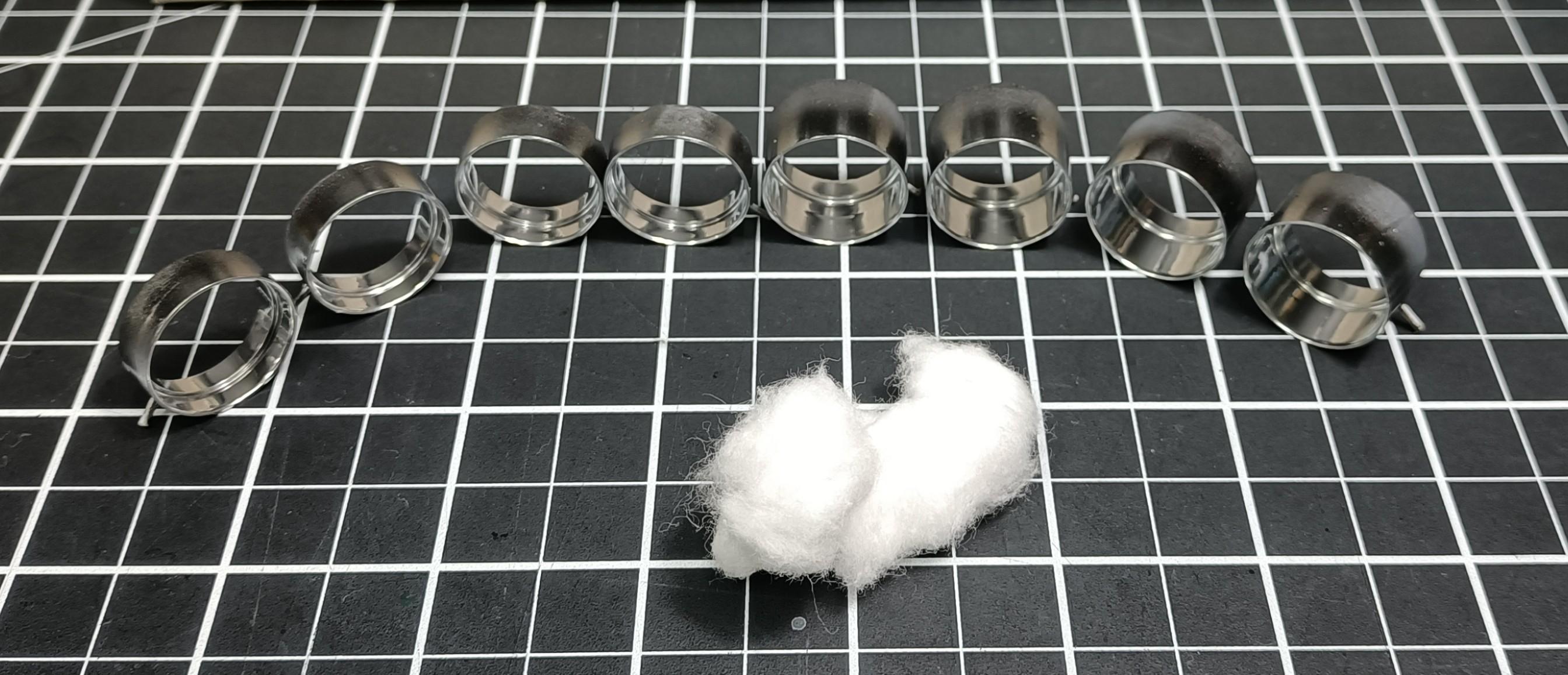

I recently started using SMS paints Hyper Chrome, the results are excellent and in my opinion its the best hobby grade chrome paint thats available, I have used it over Tamiya TS-14 black and Alclad gloss black base.
And shown below it was applied over SMS Jet black which was clear coated with SMS Super clear.
I use the Cold Tone for wheels
And like with Alclad its very durable, just lightly buff with a cotton ball to remove the dust that forms on the surface.
Ive pretty much tried all the chrome paints, and to me SMS Hyper Chrome is the best option for a great finish, its quick to dry/cure and very durable.
