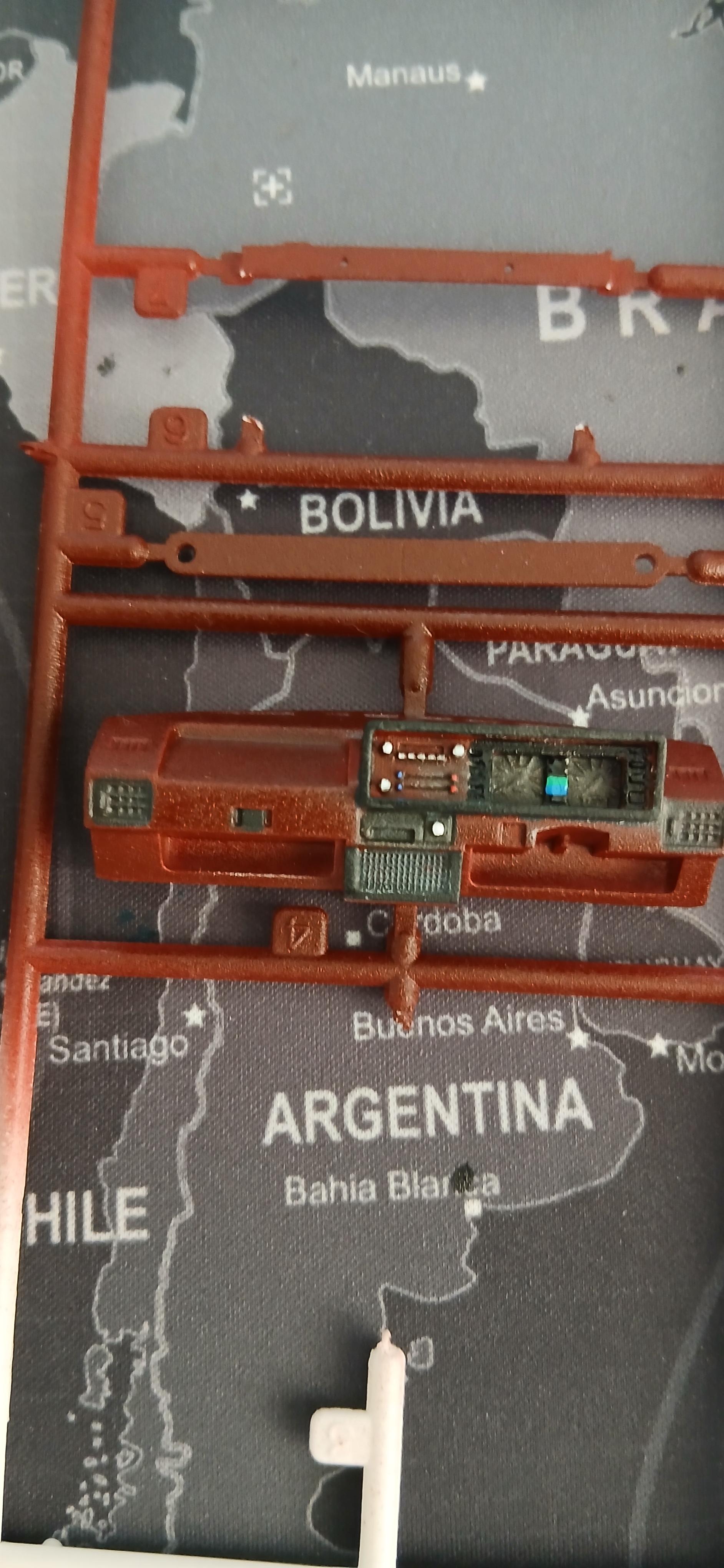

Jamese30 Posted July 29 Posted July 29 Hi All Im trying to detail up the dash on my Fujimi VW Golf. The detail in the moulding isnt great and jm going for a custom finish. Does any one have any tips to dress this up a bit more?(there are no decals for the gauges). I've tried dry brushing them but it's a pocketed area so fiddly.... Any help is appreciated Thanks James
stitchdup Posted July 29 Posted July 29 is the plastic white? if it is i'd paint the guage face whatever black you like then i'd glue a small disc of 400 grit to the to of a pencil, and use that to remove the black from the numbers and needle. then just a red pen on the needle and your finished. it might only take a couple of rotations of the pencil to remove the paint, anything courser than 400 will remove detail fast.
Beans Posted July 29 Posted July 29 I have on occasion, drilled out the gauge face, printed an image of the gauge, affixed it to a thin piece of plastic and glued it to the back of the dash. The image has to be good enough quality that it can be sized properly without getting all blurry. I usually use photo paper as it stands up better if I want to put some kind of clear to replicate the "glass" over the gauge. I haven't ever done this with square gauges but with the right drill bit and a small file should be doable. 1

Jamese30 Posted July 30 Author Posted July 30 Thanks all for the tips. I'd never thought of cutting the dials out or the small file option. Russell, it is actually the Mk1 I'm building from Fujimi. A pretty basic kit as it was originally a battery car option but relatively good none the less. Nice to hear you are daily driving a mk1 too! 1

Aaronw Posted August 1 Posted August 1 Paint the gauge clusters white, and then use a black wash. That will leave you with white highlights and dark base similar to Russel's photo of the dash.
Jamese30 Posted August 5 Author Posted August 5 (edited) Thanks guys - I did end up with a slightly overpainted white so applied a black wash. Actually a warhammer wash! It worked well and now with everything in position it doesn't look too bad. Edited August 7 by Jamese30
