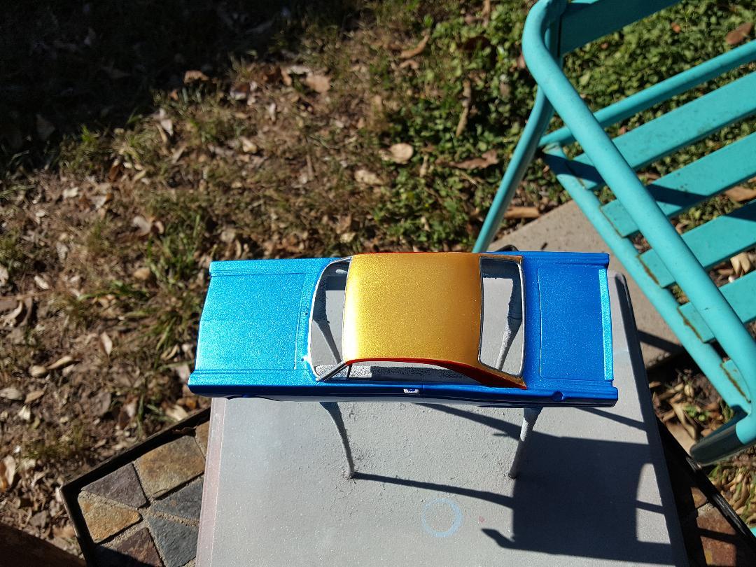

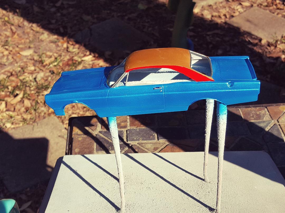

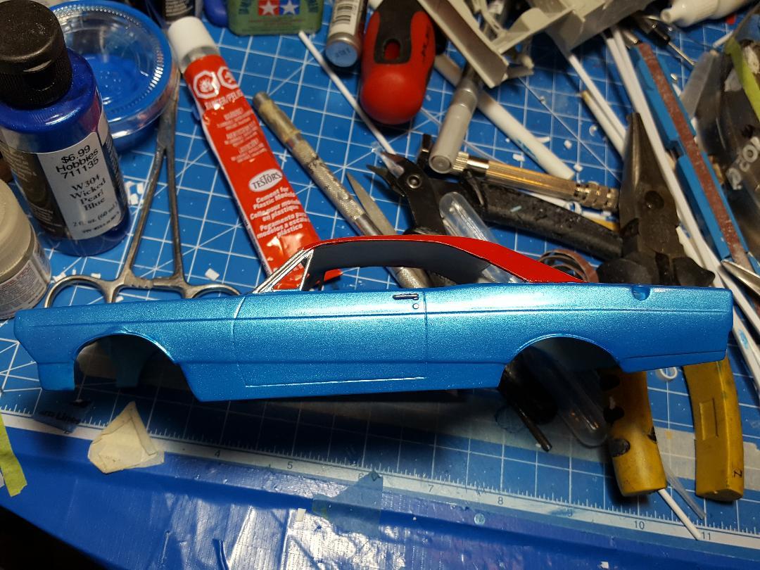

MarkJ Posted October 15 Author Posted October 15 Got the body cleared and I will have to sand the blue and maybe reclear it if I go through to paint. The blue did not go on as smoothly as the gold. I don't know if it was because it was a mixed paint and the gold was not. Maybe with mixed paint the ratio of paint to thinner needs to be tweaked a little. maybe a greater percentage of thinner to paint. I'll wait a few days before I try polishing with sanding pads. probably start at 3600 and go up to 12000 being very careful not to go through. the clear. Got the head support done and the seat except for harnesses that go on after painting. 4
Anglia105E Posted October 16 Posted October 16 15 hours ago, MarkJ said: Got the body cleared and I will have to sand the blue and maybe reclear it if I go through to paint. The blue did not go on as smoothly as the gold. I don't know if it was because it was a mixed paint and the gold was not. Maybe with mixed paint the ratio of paint to thinner needs to be tweaked a little. maybe a greater percentage of thinner to paint. I'll wait a few days before I try polishing with sanding pads. probably start at 3600 and go up to 12000 being very careful not to go through. the clear. Got the head support done and the seat except for harnesses that go on after painting. The blue and gold colour combination looks good outdoors in natural daylight, and the seating position for the driver is well protected. David

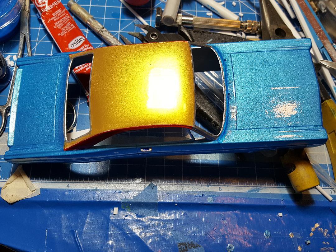

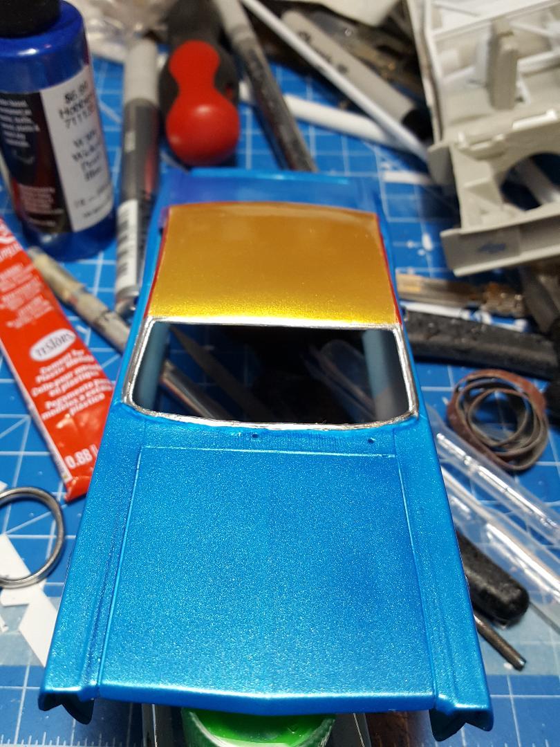

MarkJ Posted October 16 Author Posted October 16 5 hours ago, Anglia105E said: The blue and gold colour combination looks good outdoors in natural daylight, and the seating position for the driver is well protected. David Thanks, David. The finish is now glossy but grainy at the same time especially on the hood. I will post a photo later showing this. My aim is to get the graininess gone and have a smooth glossy finish. That will take a lot of polishing and probably another coat of clear. I will wait a couple of more days before I start the polishing process. In the meantime, I will try to prime all the interior pieces and get them painted and then assemble the interior. I also need to decal the tires with firestone decals and a gold stripe. This is very painstaking work to get the gold stripe evenly all around the tire using a toothpick to nudge it into place and hope that the decals are not too old and brittle. A tiny drop of dish detergent in the decal water will help in making the stripe move easier into place. Then I can start thinking about final assembly. Mark

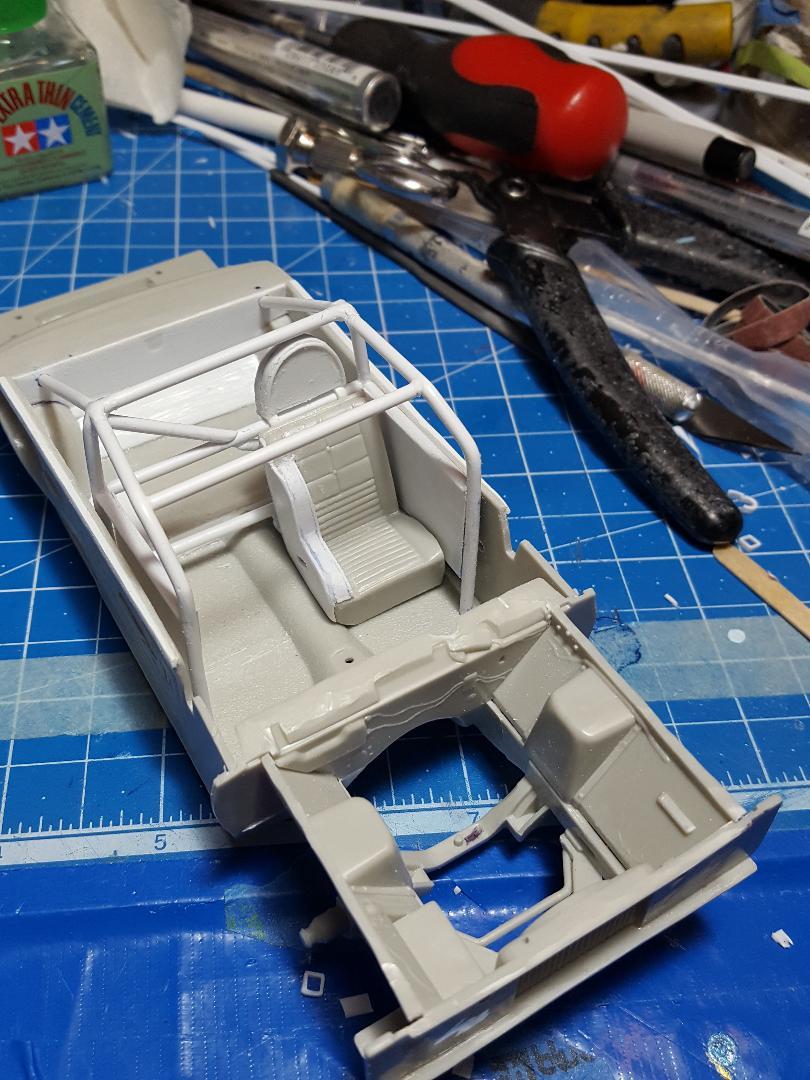

Anglia105E Posted October 16 Posted October 16 52 minutes ago, MarkJ said: Thanks, David. The finish is now glossy but grainy at the same time especially on the hood. I will post a photo later showing this. My aim is to get the graininess gone and have a smooth glossy finish. That will take a lot of polishing and probably another coat of clear. I will wait a couple of more days before I start the polishing process. In the meantime, I will try to prime all the interior pieces and get them painted and then assemble the interior. I also need to decal the tires with firestone decals and a gold stripe. This is very painstaking work to get the gold stripe evenly all around the tire using a toothpick to nudge it into place and hope that the decals are not too old and brittle. A tiny drop of dish detergent in the decal water will help in making the stripe move easier into place. Then I can start thinking about final assembly. Mark I remember putting the gold stripes and gold lettering on the Firestone tyres for my build of the 1:12 scale Tamiya Lotus 49B, which was the 1968 Graham Hill car. This was done with the fine tip of a cocktail stick (toothpick) and gold paint if I remember correctly . . . Here are three photos of the Firestone's . . . Good luck with those decals. 1:24 scale is way more difficult than 1:12 scale of course . . . David 1

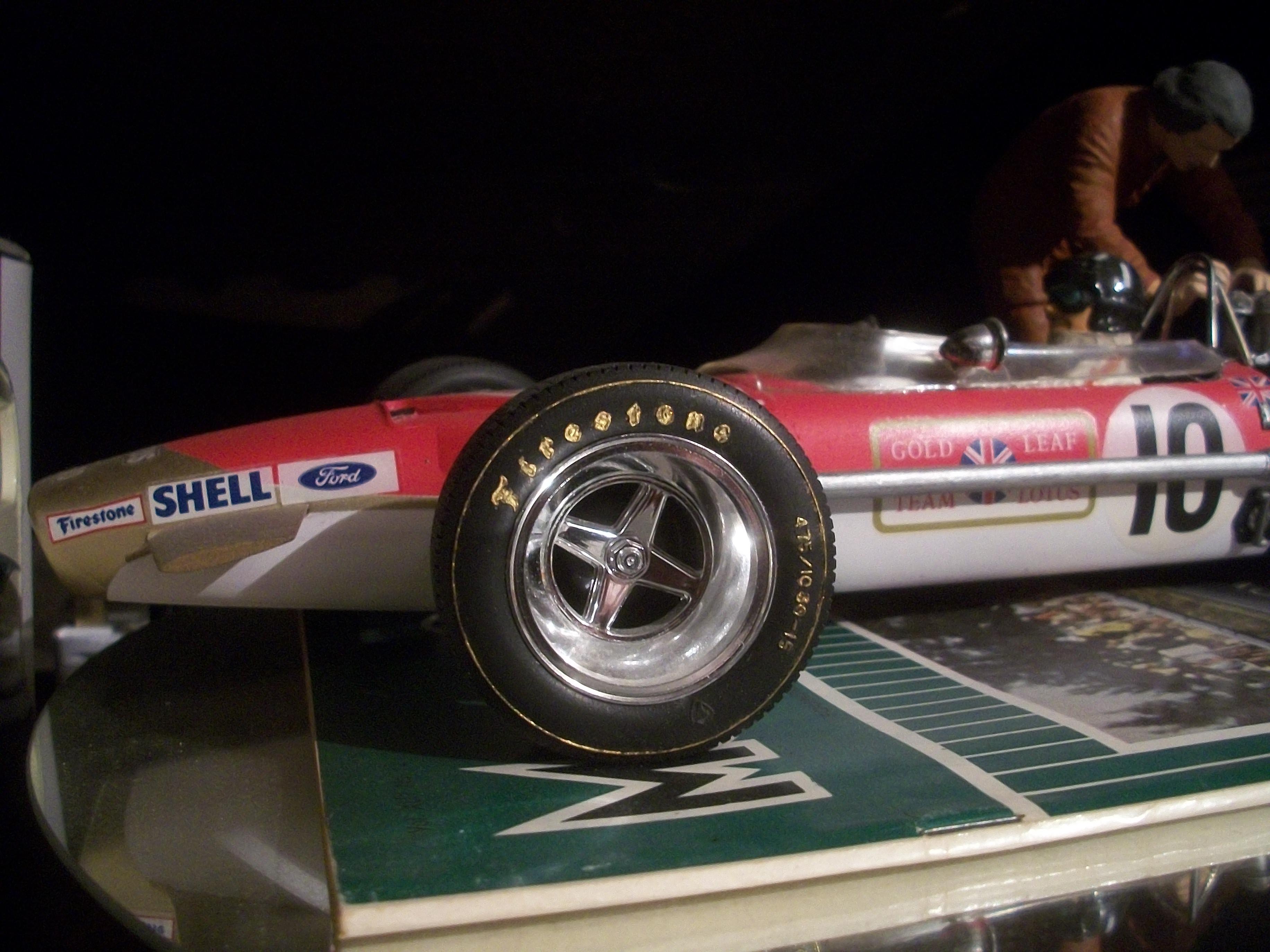

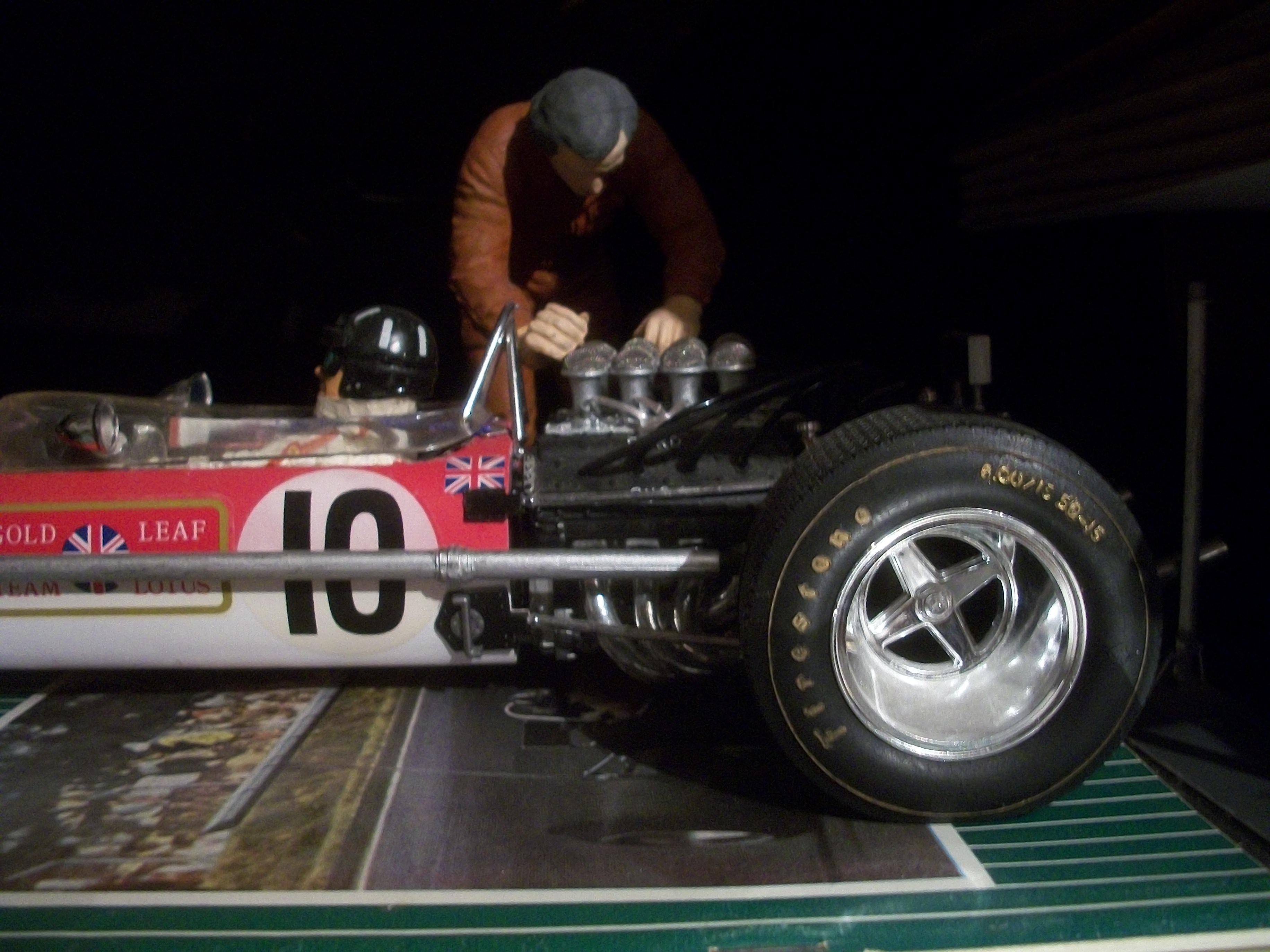

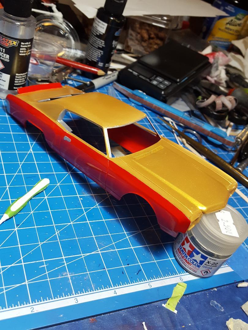

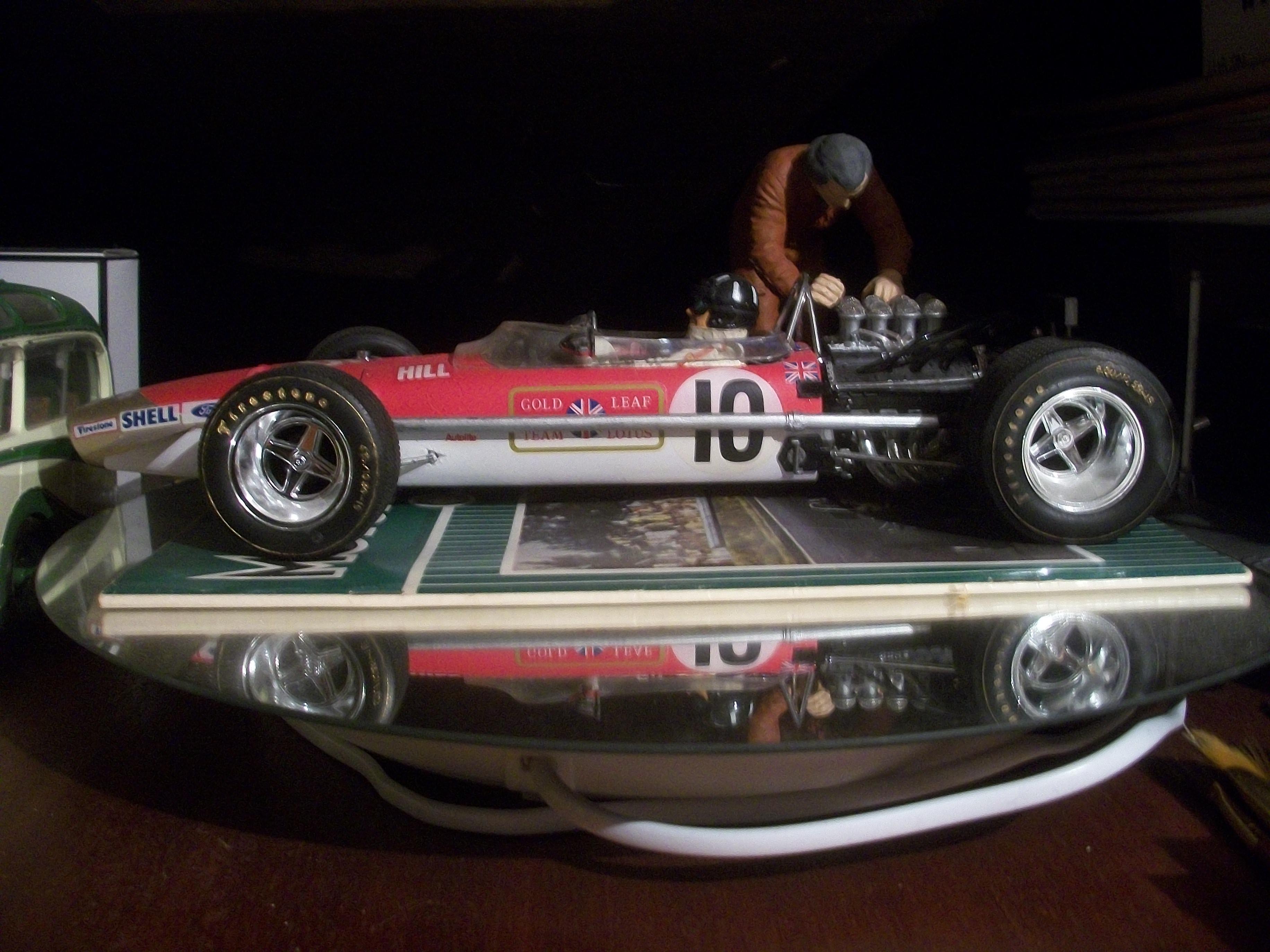

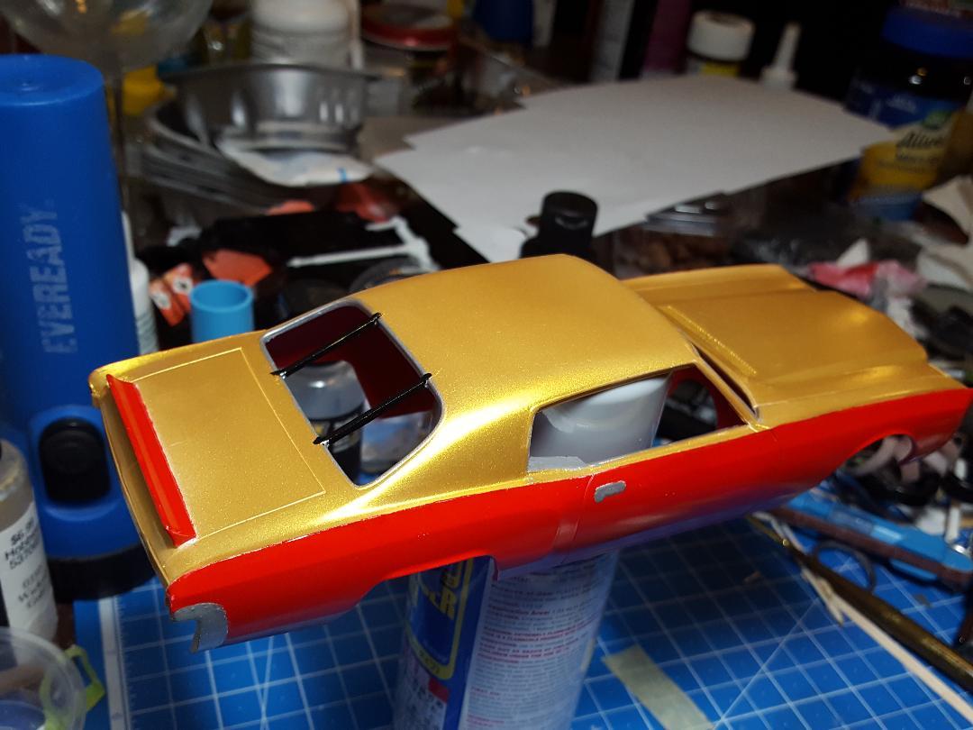

MarkJ Posted October 16 Author Posted October 16 Great job on those stripes, David. So that's what a 1/12 scale model looks like. You did a great job on the whole model too. Below are the pictures I mentioned, glossy but grainy at the same time. I have my work cut out for me. Mark
Anglia105E Posted October 16 Posted October 16 I see what you are up against Mark, and that is something that would worry me . . . When you have the glossy clear finish, which is what you do want, but the grainy finish underneath is what you don't want, what on earth do you do to fix it ? Somebody might suggest sanding it all down and starting again, but I could not face that option, and I would guess you don't wish to go down that route. You did mention using fine grades of wet & dry paper . . . maybe that could work ? David
MarkJ Posted October 17 Author Posted October 17 12 hours ago, Anglia105E said: I see what you are up against Mark, and that is something that would worry me . . . When you have the glossy clear finish, which is what you do want, but the grainy finish underneath is what you don't want, what on earth do you do to fix it ? Somebody might suggest sanding it all down and starting again, but I could not face that option, and I would guess you don't wish to go down that route. You did mention using fine grades of wet & dry paper . . . maybe that could work ? David David, yes it should work because I have had to do it before when I use to bristle brush everything. It would come out glossy but have brush strokes in it so I would clear it with a brush and use very fine grits of sanding pads from 3400 to 12000 to get it smooth and glossy but it was always a lot of work which I don't usually have with the air brush. As you will notice the gold is already glossy and smooth, so I won't have to sand or polish it. I didn't have to sand or polish the Monte Carlo I finished before I started on this build. Mark 1

MarkJ Posted October 25 Author Posted October 25 Got the upper surfaces polished. Pretty happy with it. You can see the reflection of the desk lamp in the hood and the trunk. The gold is a hint better looking too and the decals should adhere better as well. I painted a bunch of black stuff with a spray can I found in the garage. I believe it got the job done. I still need to polish the sides of the model. I'm using polishing pads dry because they tend to come apart when you wet them. I start with 3200 grit and work my way up to 12000. 1
