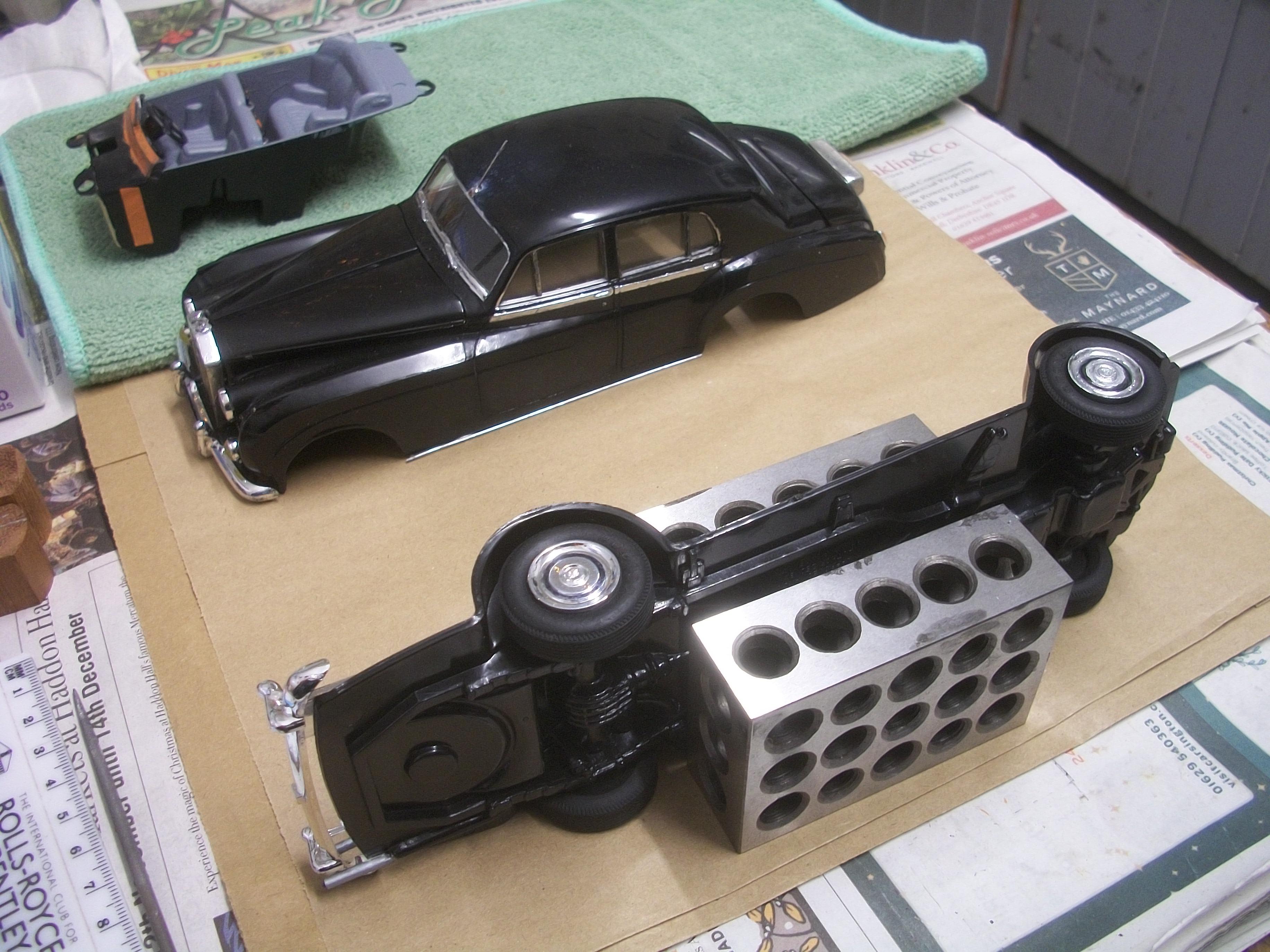

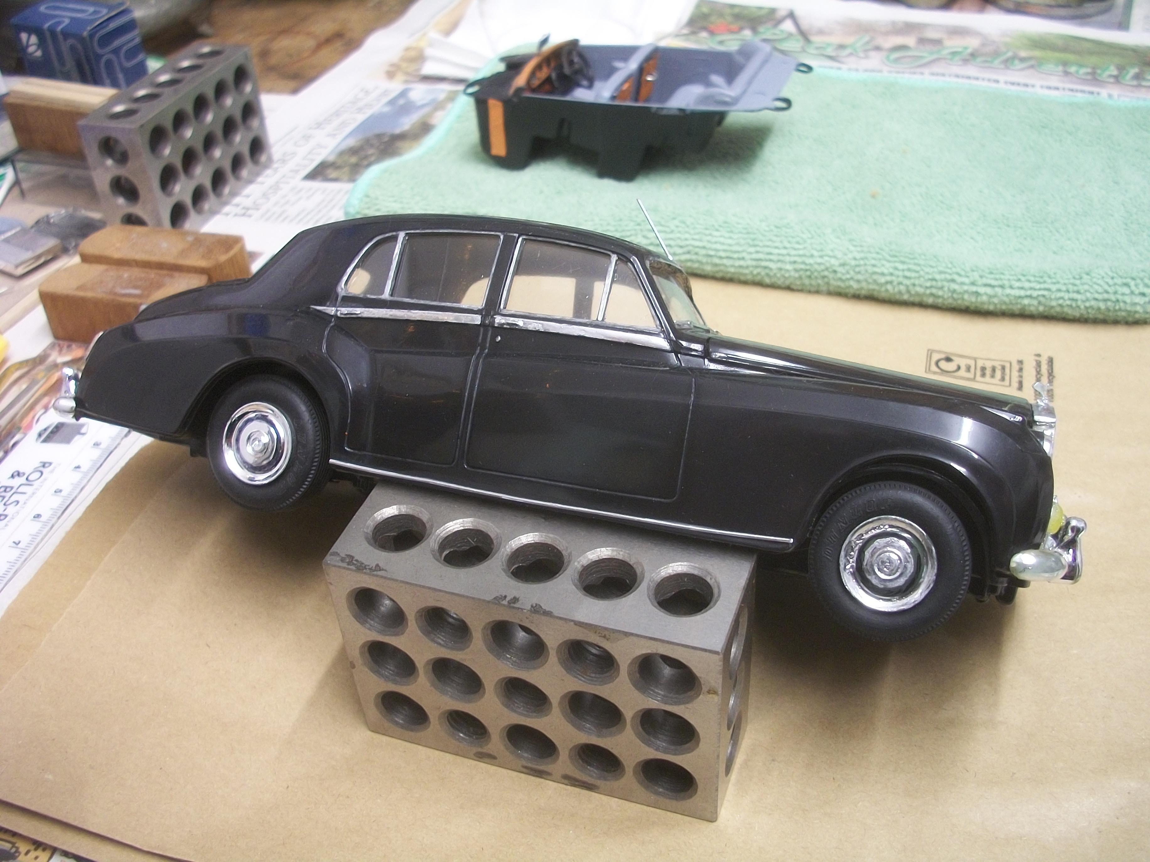

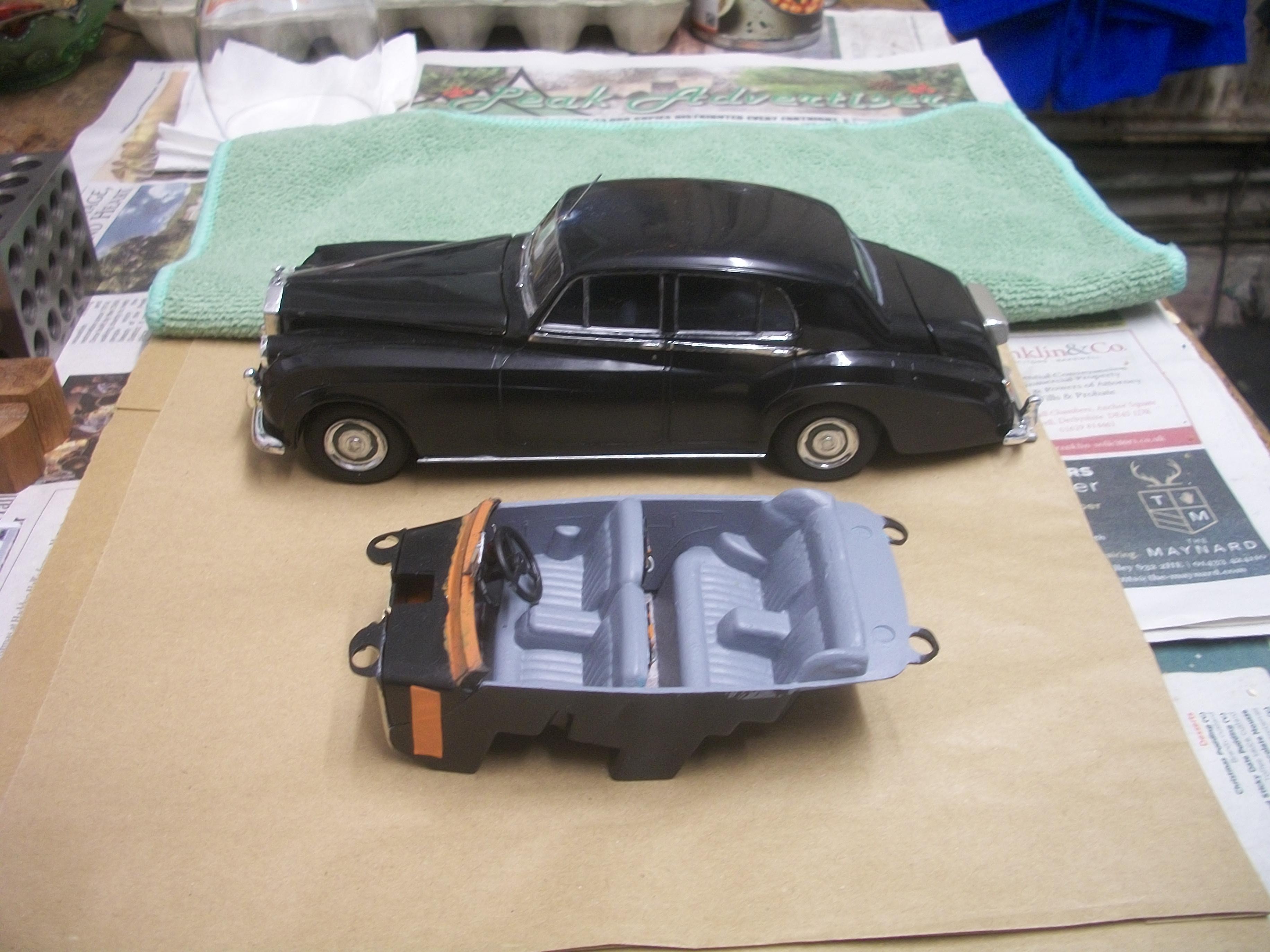

Anglia105E Posted November 13 Author Posted November 13 Last night I test fitted the body, interior seating tub, rolling chassis with engine, and bonnet / hood panels to see how things were looking. In the process of assembling the two bonnet panels with the radiator grille shell, the roof aerial became detached. This was bound to happen, and so I shall drill a small hole in the roof during today and super glue the roof antenna into the hole . . . David 3
MarkJ Posted November 13 Posted November 13 I believe you predicted the antenna doing exactly what it did. No problem. Your fix sounds like a good one. Mark J.
Anglia105E Posted November 13 Author Posted November 13 3 hours ago, MarkJ said: I believe you predicted the antenna doing exactly what it did. No problem. Your fix sounds like a good one. Mark J. I seem to remember your good self suggesting that if the radio antenna did fall off later, then it might be a good idea to drill a hole for it . . . I might be mistaken ? David
MarkJ Posted November 13 Posted November 13 3 hours ago, Anglia105E said: I seem to remember your good self suggesting that if the radio antenna did fall off later, then it might be a good idea to drill a hole for it . . . I might be mistaken ? David You might be right about that, David. But I'm so old I've already forgotten if I did. Mark J.
Anglia105E Posted November 14 Author Posted November 14 This evening a hole was carefully and precisely drilled in the centre of the roof at the top edge of the windshield. The steel radio antenna was then inserted into this hole and super glued in place. Liquid Chrome was then applied around the base of the radio antenna mounting point, and also along the top edge of the windshield surround molding . . . There was some liquid chrome remaining on my piece of scrap card, so I touched up the door strips which were in need of some tidying up. I am pleased with the result of this work and the liquid chrome can be allowed 24 hours to dry fully . . . As we go into Friday 14th November, the UK is about to be hit by Storm Claudia . . . This will bring us strong gusty winds and very heavy rain from 12:00 midday through to 12:00 midnight, so basically 12 hours of continuous extreme weather . . . The outside temperature will drop from 14°C to only 6°C for the duration of the storm. David

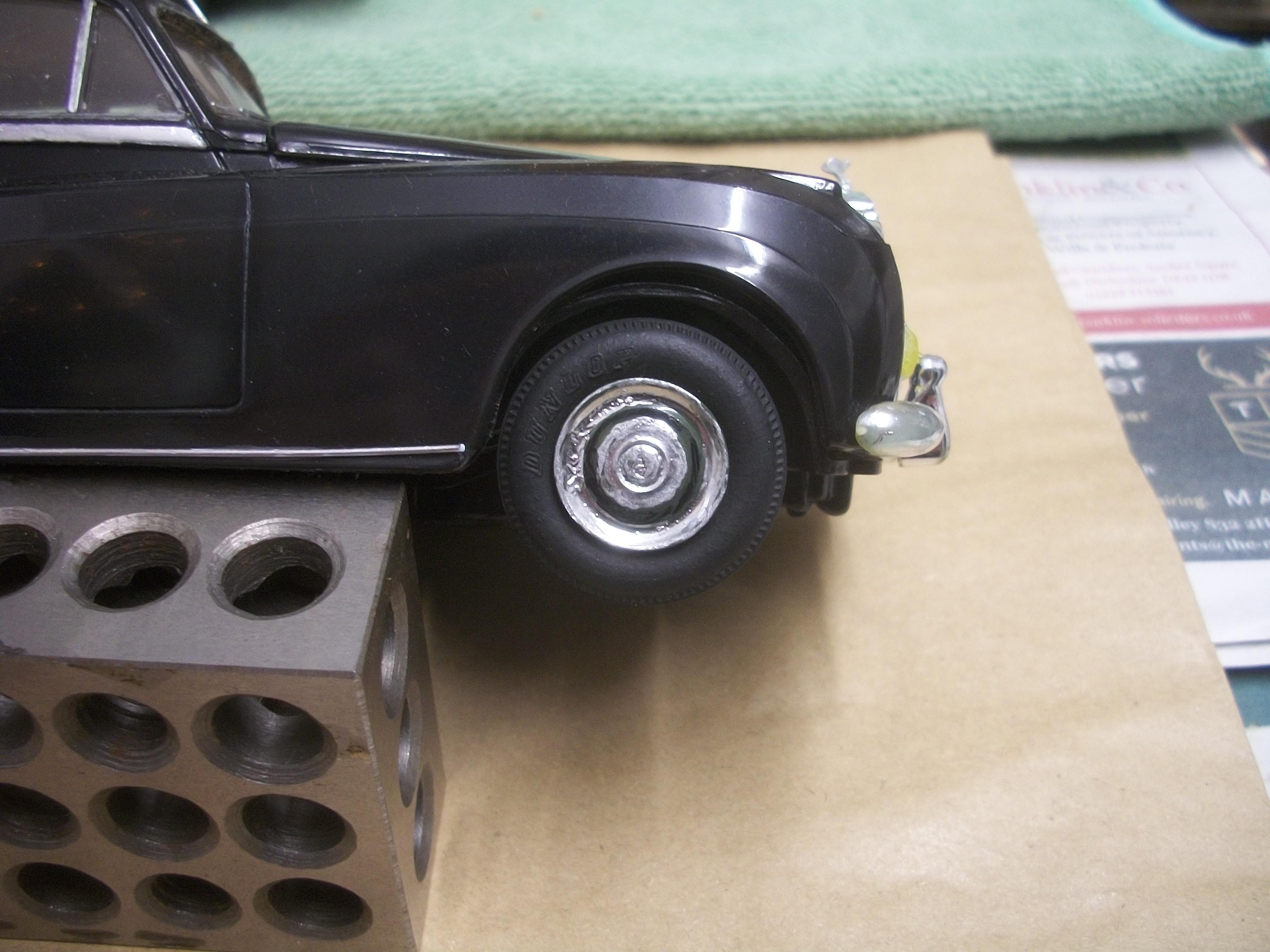

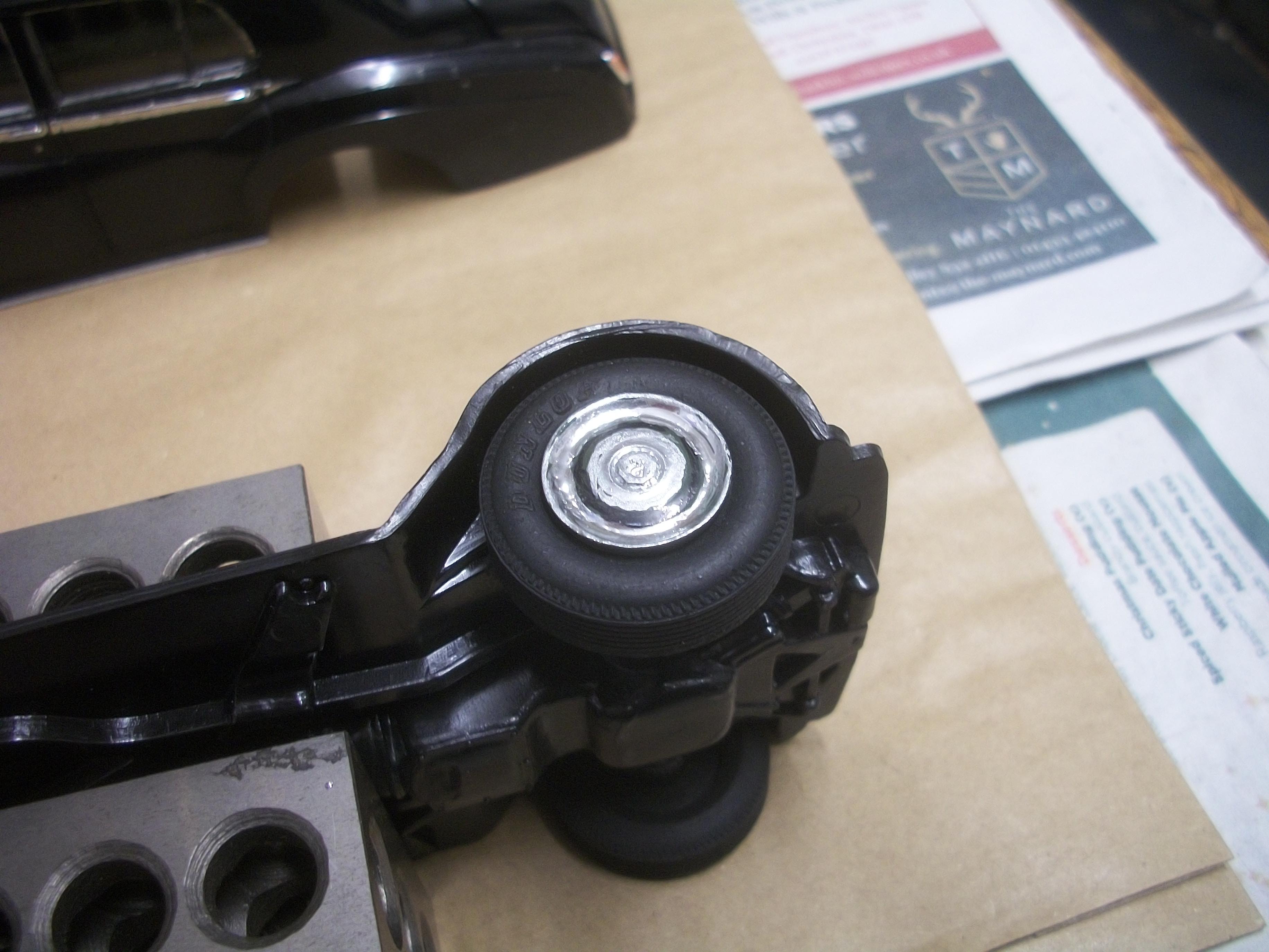

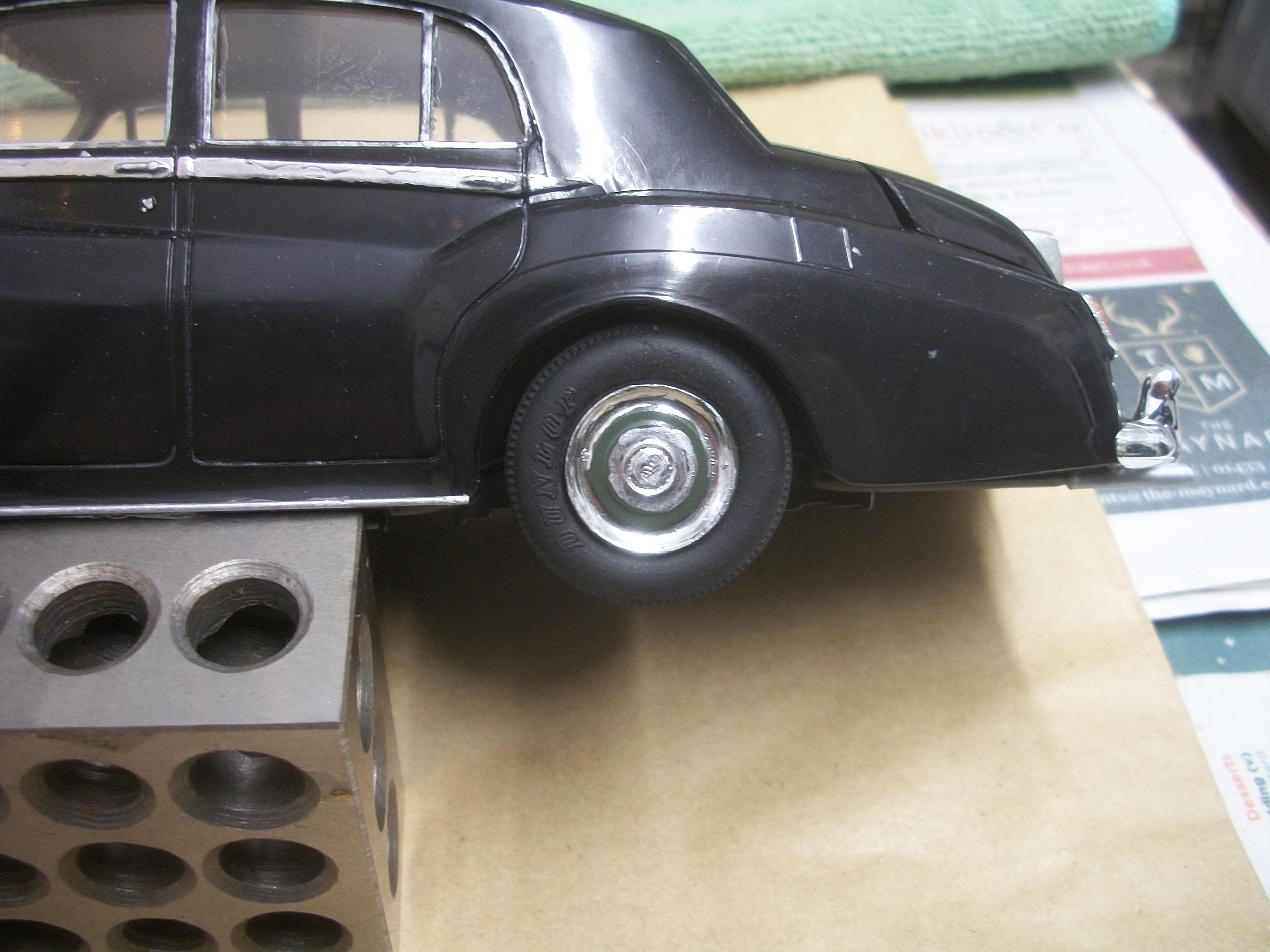

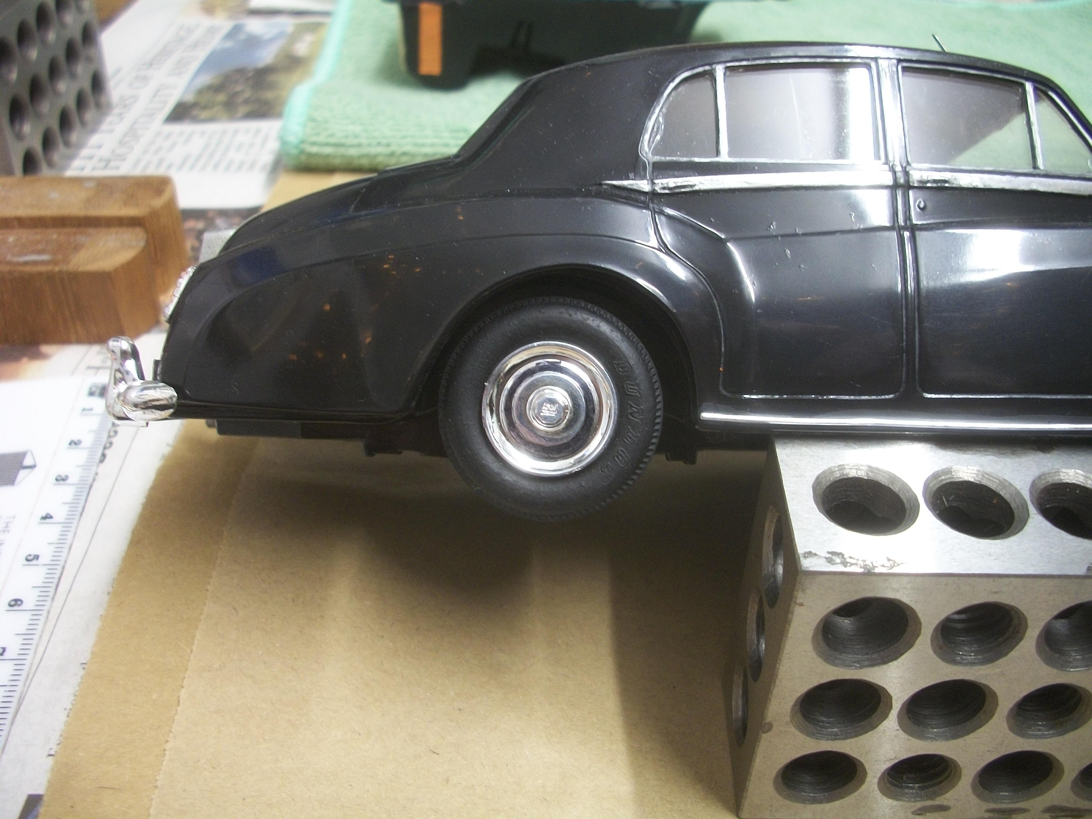

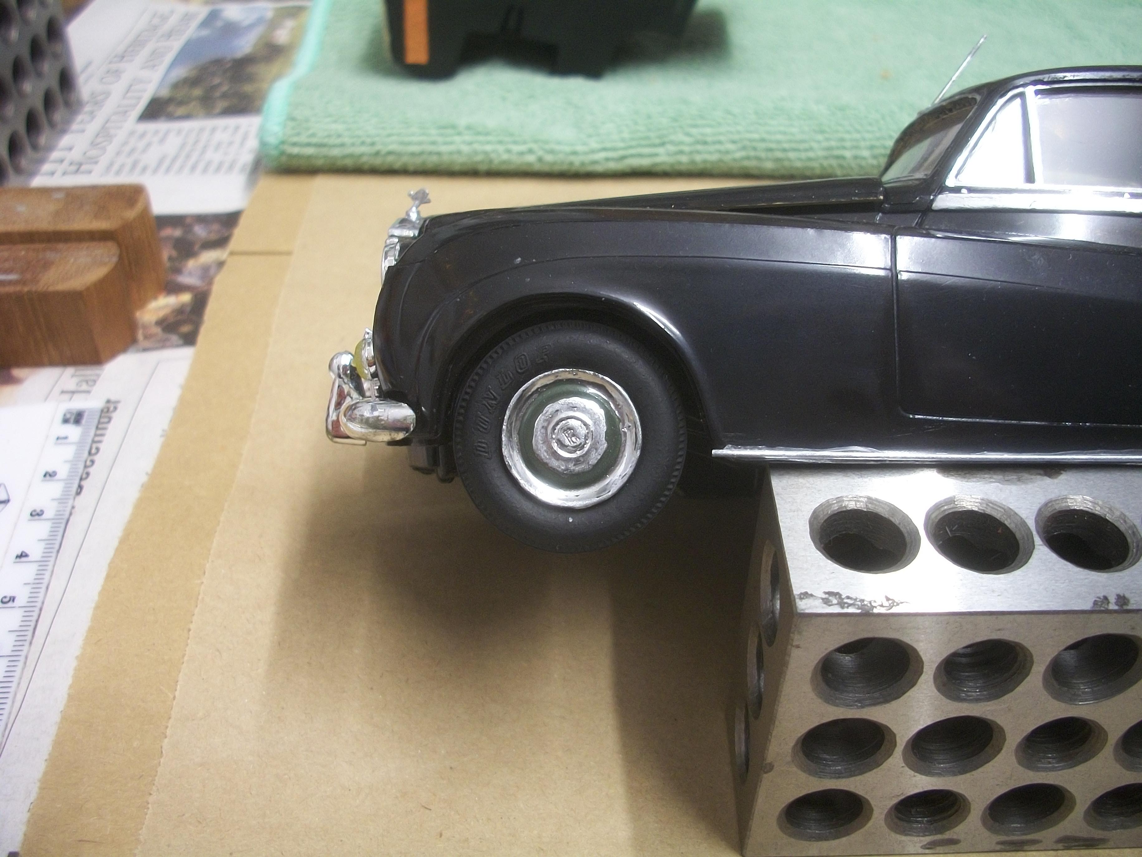

Anglia105E Posted November 19 Author Posted November 19 Brought the body and chassis back to the table this evening, and then examined the four wheel embellishments . . . Started with the driver's side front wheel, which was badly tarnished. After using a needle file to remove the tarnished areas, some liquid chrome was applied to those areas of the wheel. These wheels on the Silver Cloud have a dark ring around the central hub, which always has to match the body colour. This car needs to have black rings to match the black body colour. The rings are tricky to paint, mainly because the chrome dividing lines are difficult to see. By setting up the chassis in a vertical position between two 1-2-3 blocks, this placed the wheels in a horizontal position, which allows the liquid chrome to use it's self levelling consistency to the full extent . . . David 2
MarkJ Posted November 21 Posted November 21 David, the kit people didn't make your job very easy getting that black circle inside the chrome wheel cover. I've been thinking of some way you could make a circular piece of masking tape over a totally black wheel cover and then come back with the chrome around that circular mask but for the life of me nothing is coming to mind on how to actually do that. I have a compass with a blade on one end of it for cutting out circles, but it would not go that small. Mark J.
johnyrotten Posted November 22 Posted November 22 11 hours ago, MarkJ said: I've been thinking of some way you could make a circular piece of masking tape over a totally black wheel cover and then come back with the chrome around that circular mask but for the life of me nothing is coming to mind on how to actually do that. I have a compass with a blade on one end of it for cutting out circles, but it would not go that small Mark, look into hollow punches. Used in leather work and such. Perfect small round masks with little effort. 1
Anglia105E Posted November 22 Author Posted November 22 13 hours ago, MarkJ said: David, the kit people didn't make your job very easy getting that black circle inside the chrome wheel cover. I've been thinking of some way you could make a circular piece of masking tape over a totally black wheel cover and then come back with the chrome around that circular mask but for the life of me nothing is coming to mind on how to actually do that. I have a compass with a blade on one end of it for cutting out circles, but it would not go that small. Mark J. Mark . . . Your thoughts regarding the wheel embellishment rings for this model are much appreciated at this stage. The idea of yours to use masking tape is very interesting, and I need to think outside the box for this one, that's for sure ! Some serious lateral thinking on my part is called for . . . David
Anglia105E Posted November 22 Author Posted November 22 1 hour ago, johnyrotten said: Mark, look into hollow punches. Used in leather work and such. Perfect small round masks with little effort. Thanks a lot John . . . I shall have a look to see if a Hollow Punch Set is available in the UK . . . Never seen this tool is any stores, but maybe online it might exist. David 1
