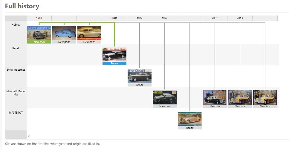

I have previously built 8 Silver Cloud kits, but none of them are Entex . . . They have been Revell, Minicraft and Masterkit, but not Entex. Judging by the photos, the tyres tell me that the Entex kit is similar to the Revell kit, which is a good thing . . .

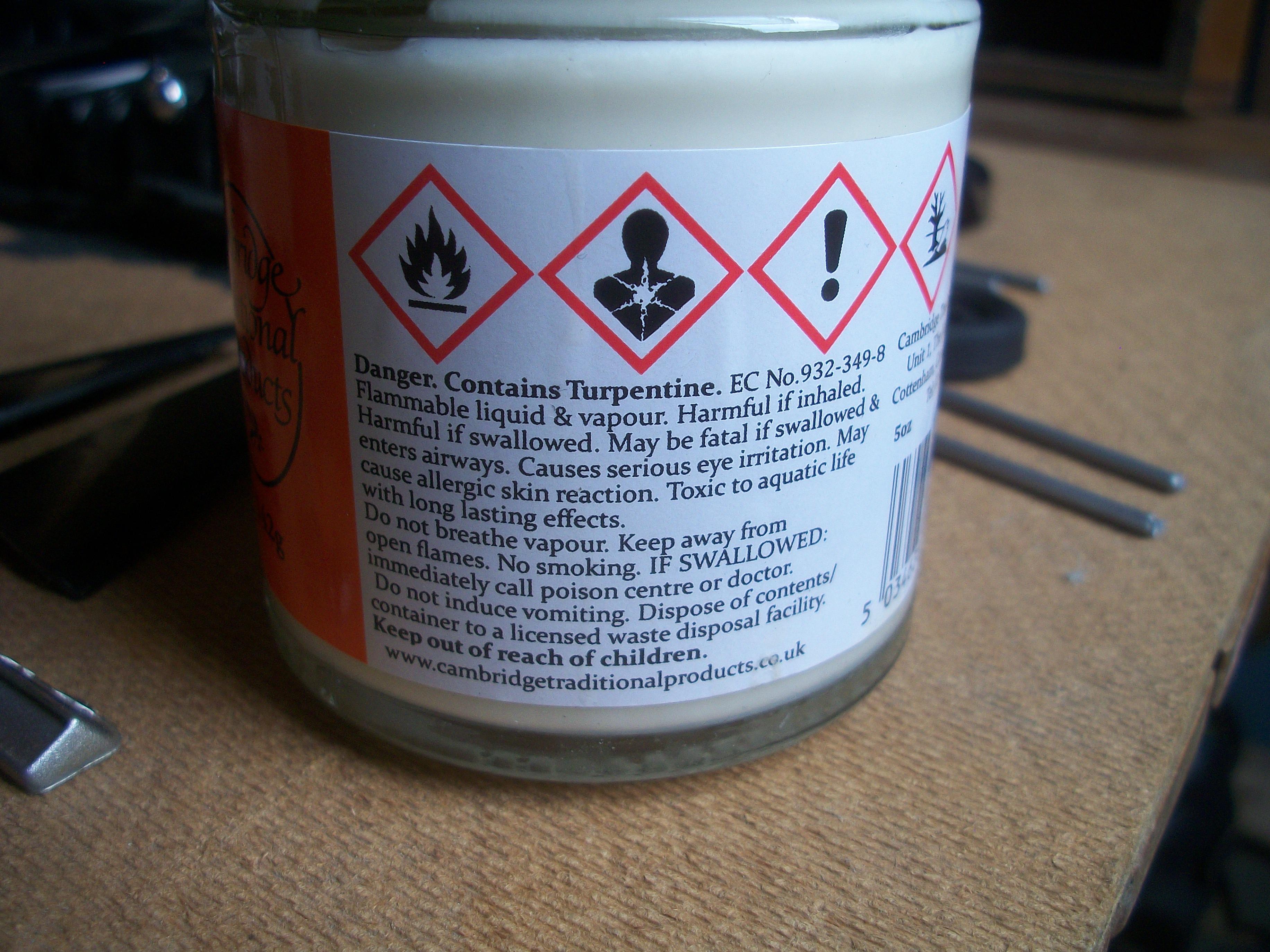

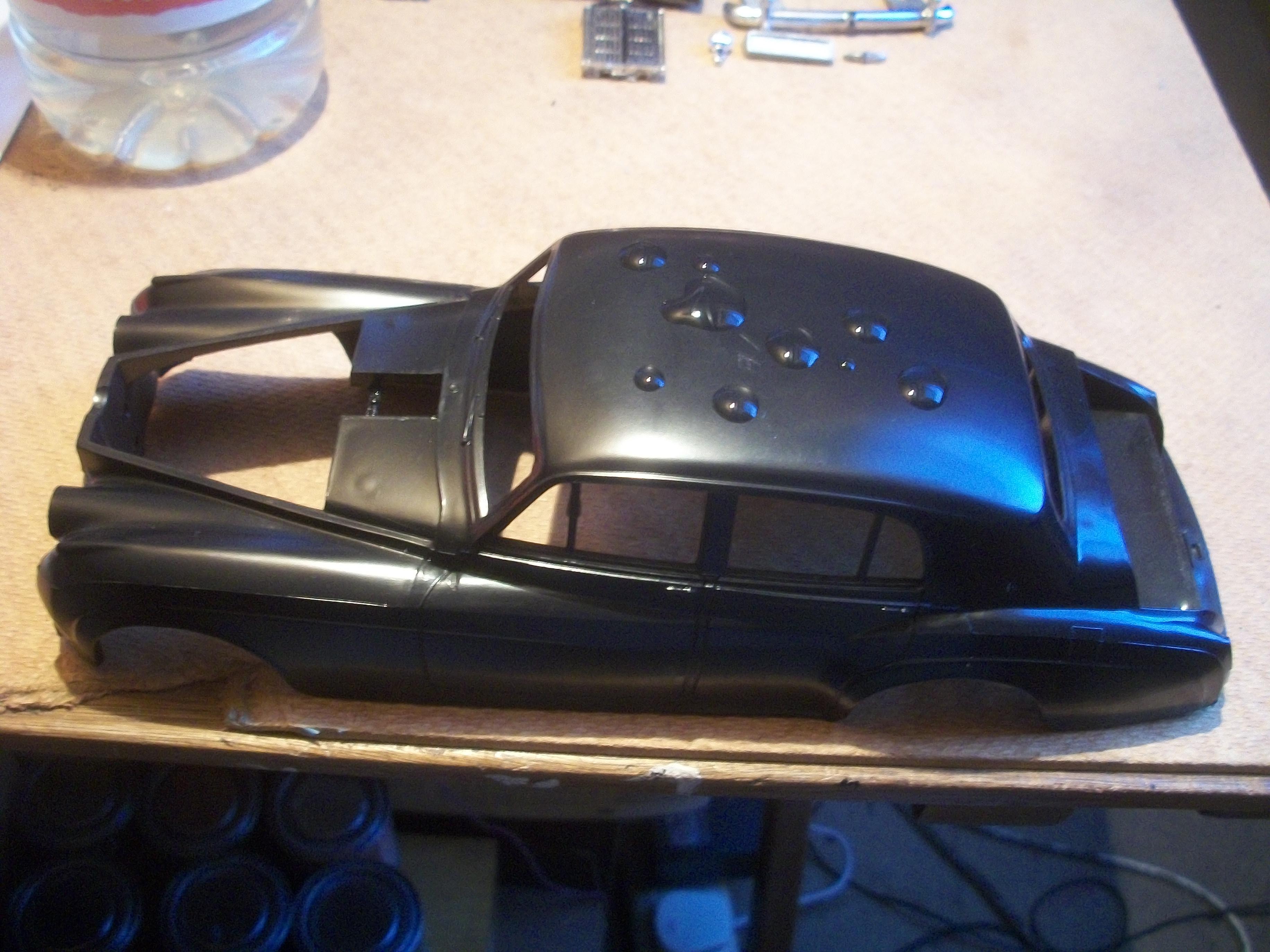

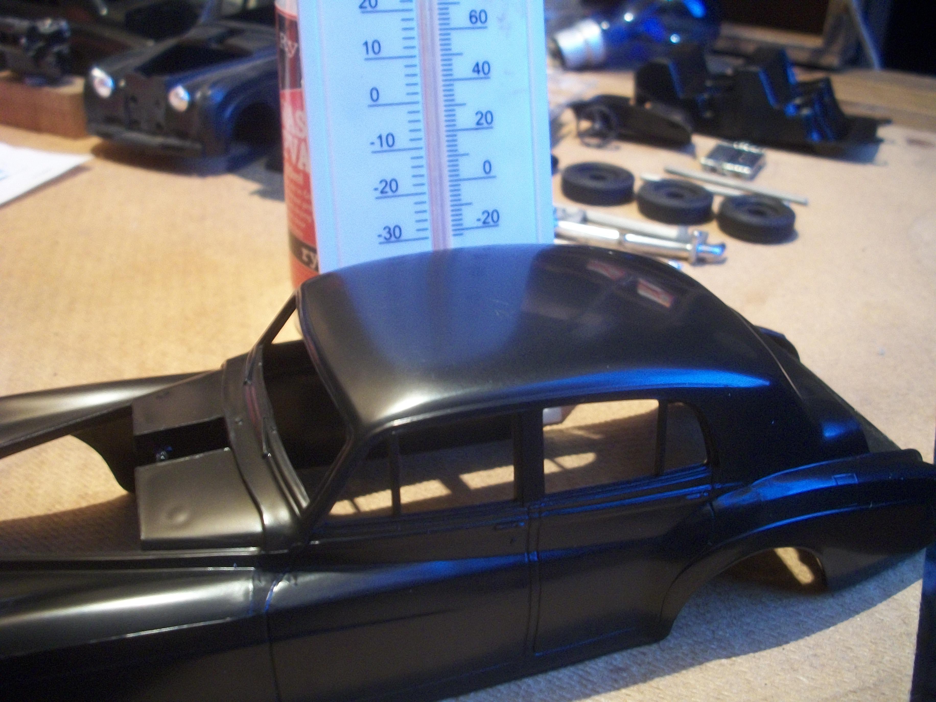

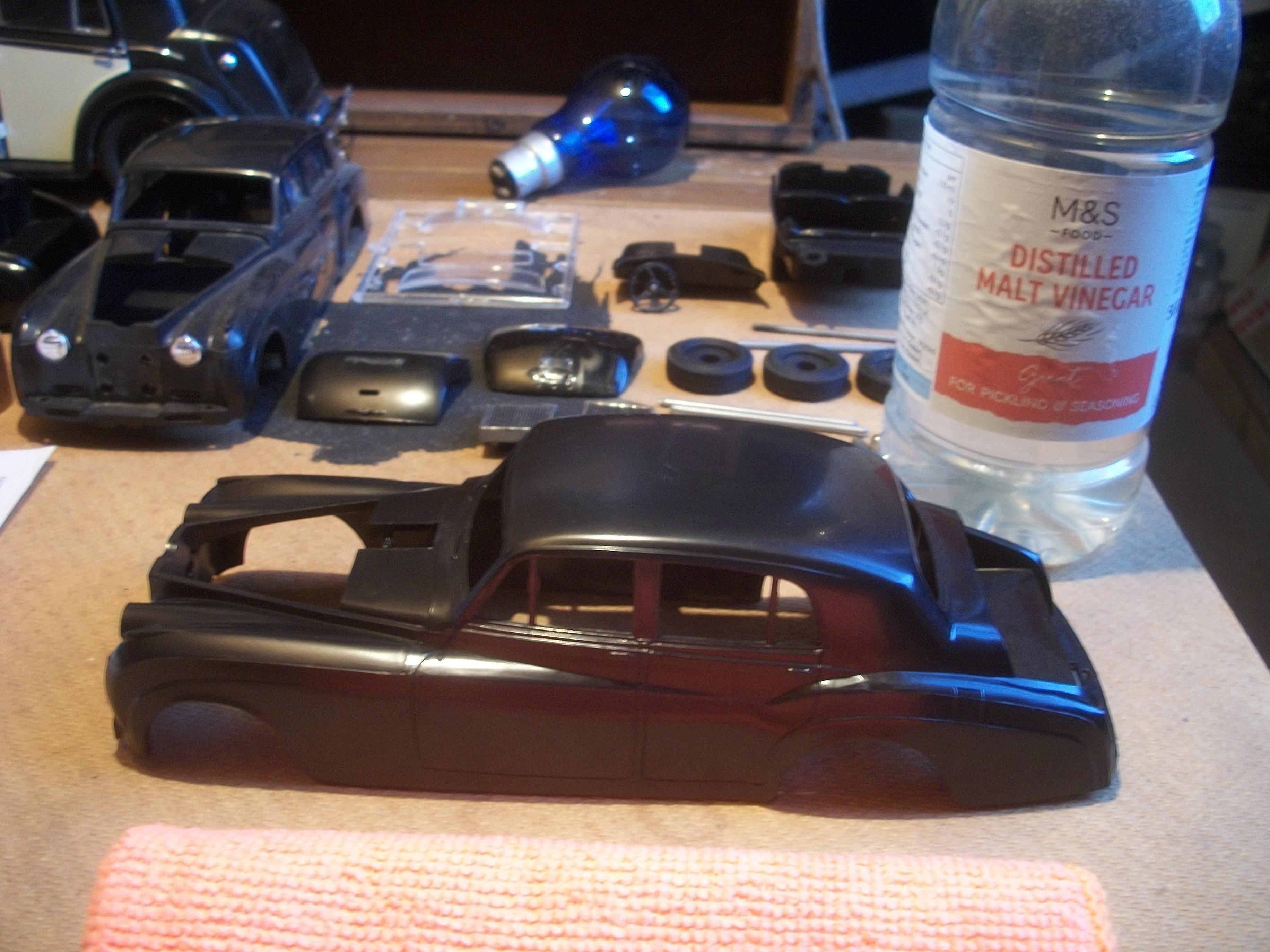

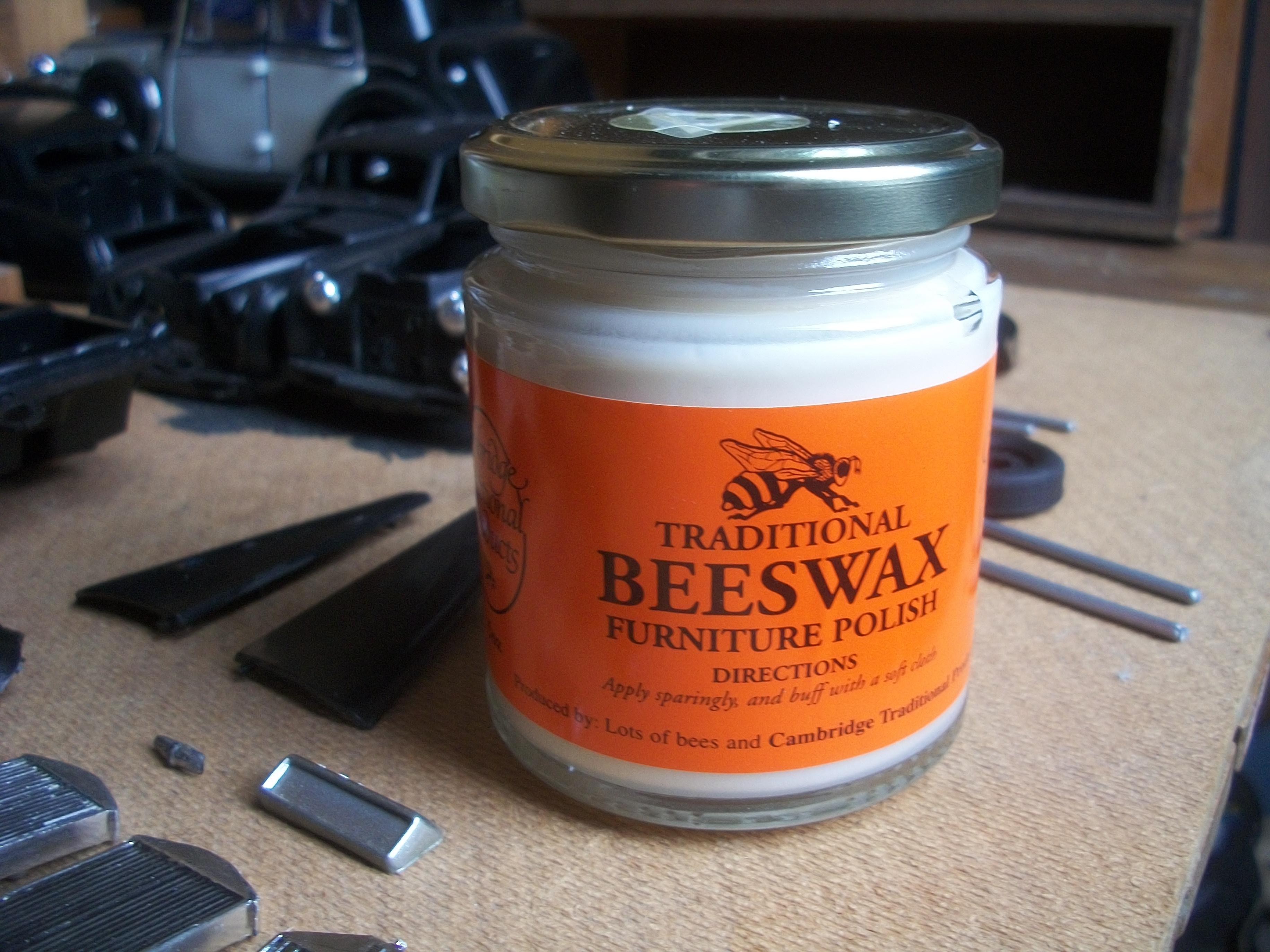

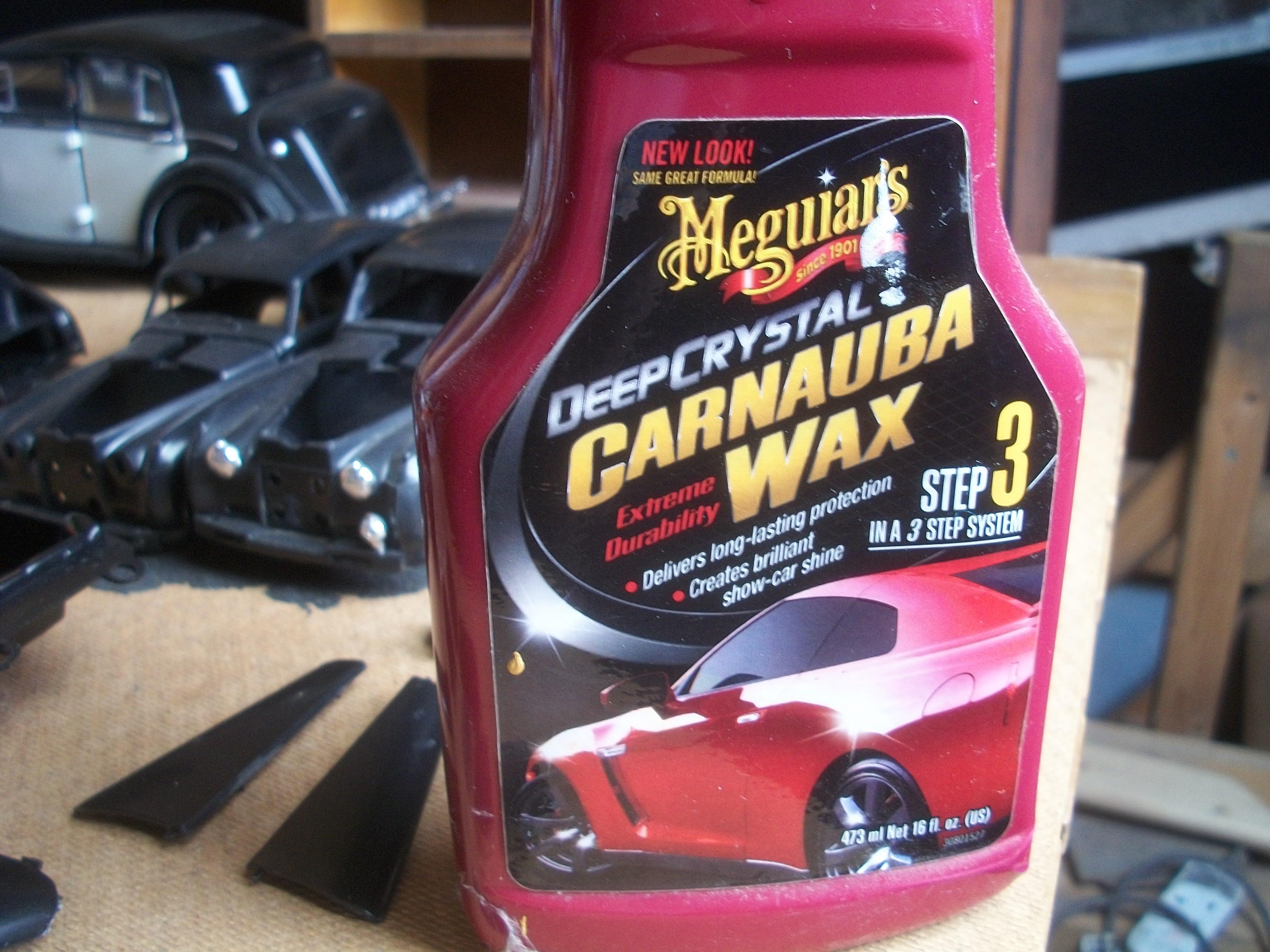

Several of the following photos show the labels on the back of the Meguiars Carnauba Wax bottle, and also the Traditional Beeswax furniture polish . . . Both of these products contain harmful solvents, and there are warnings regarding the dangers of inhaling the vapors, as well as not allowing the product to come into contact with your skin. I do not feel safe using either of these polish products, particularly taking into account my lung condition.

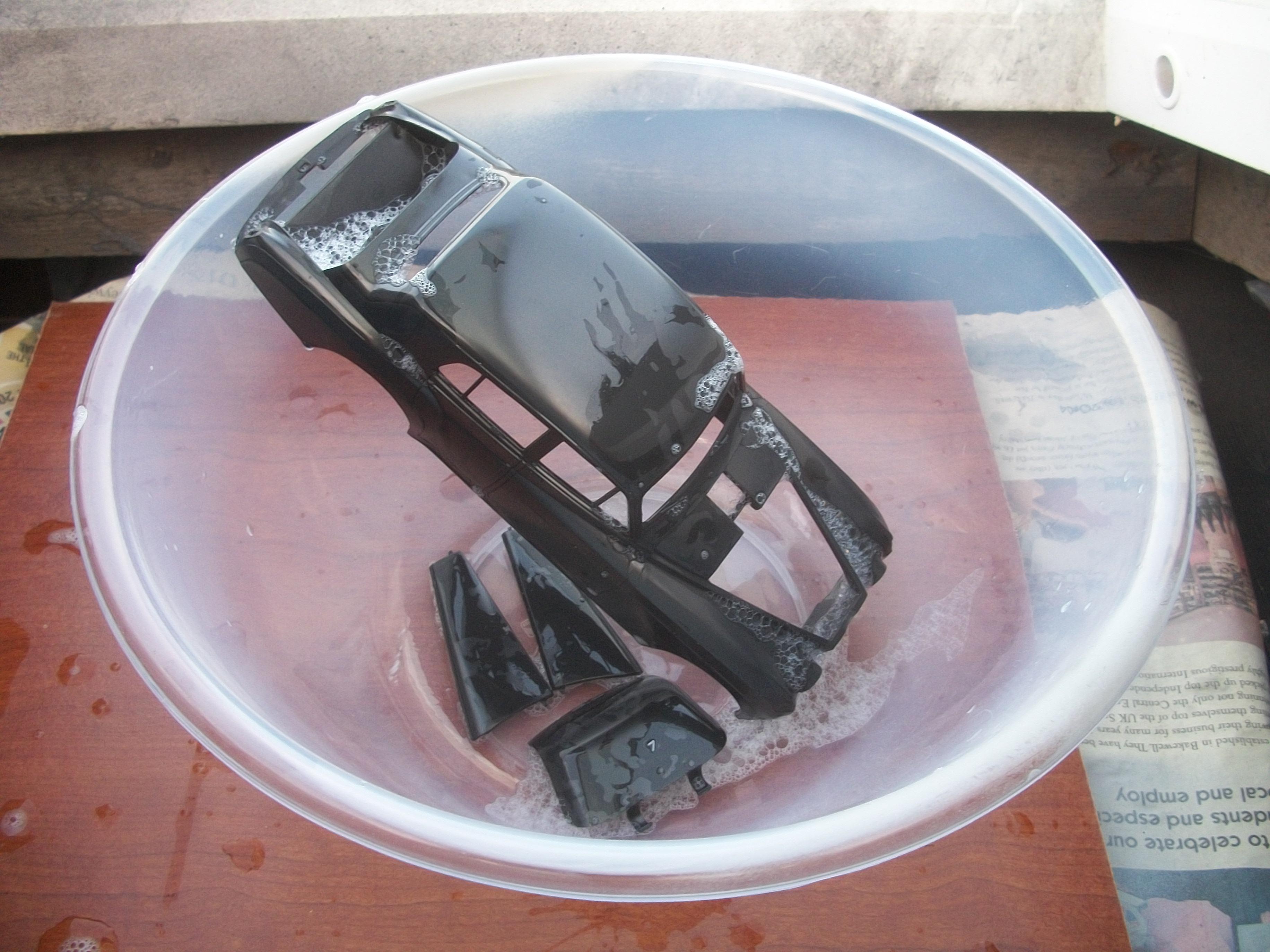

This evening I washed the body parts in hot water with dish wash liquid, then rinsed them in cold water and dried them with kitchen towel. Once dry, I polished the roof panel area with a new micro fibre cloth, applied firmly in a circular motion. This was followed by a second polishing application using distilled malt vinegar and buffed with a clean part of the micro fibre cloth
The resulting finish on the surface of the roof might be good enough, but this is just at the experimental stage for now . . .
Minor scratches in the plastic could be removed using toothpaste at some point.

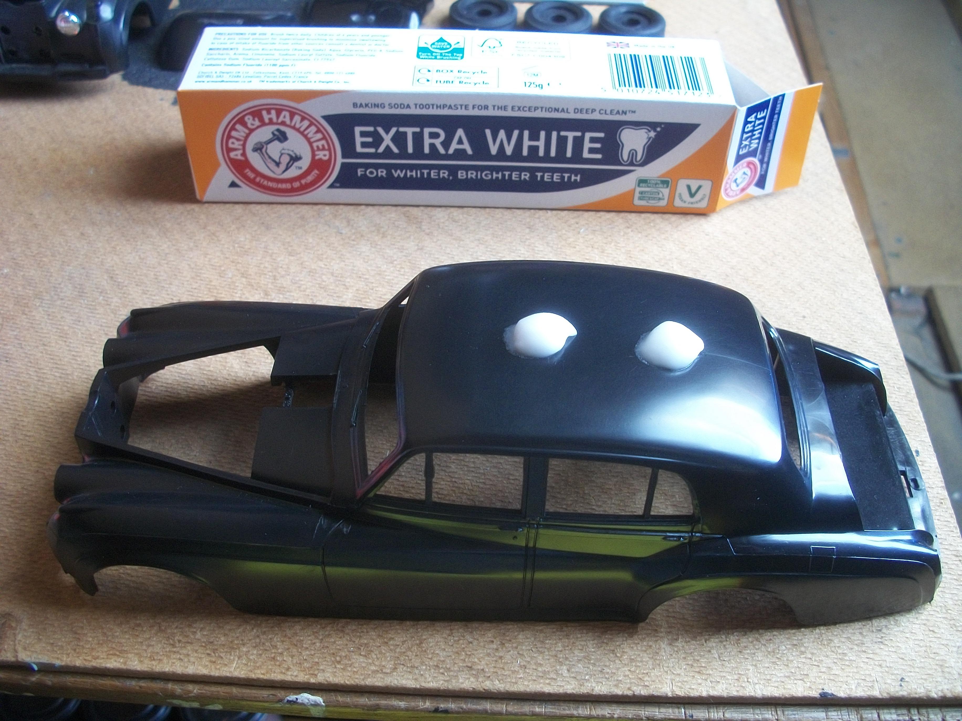

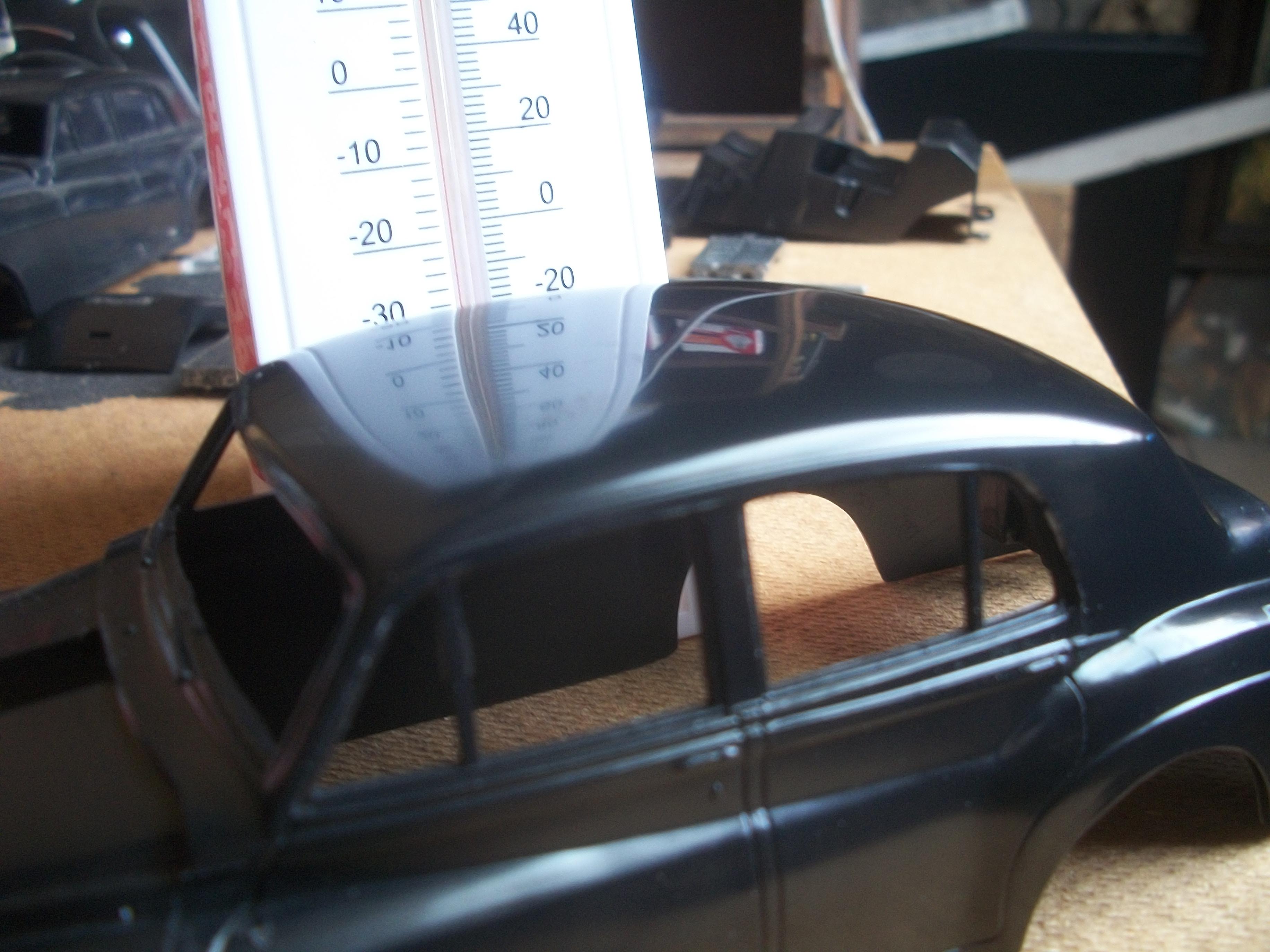

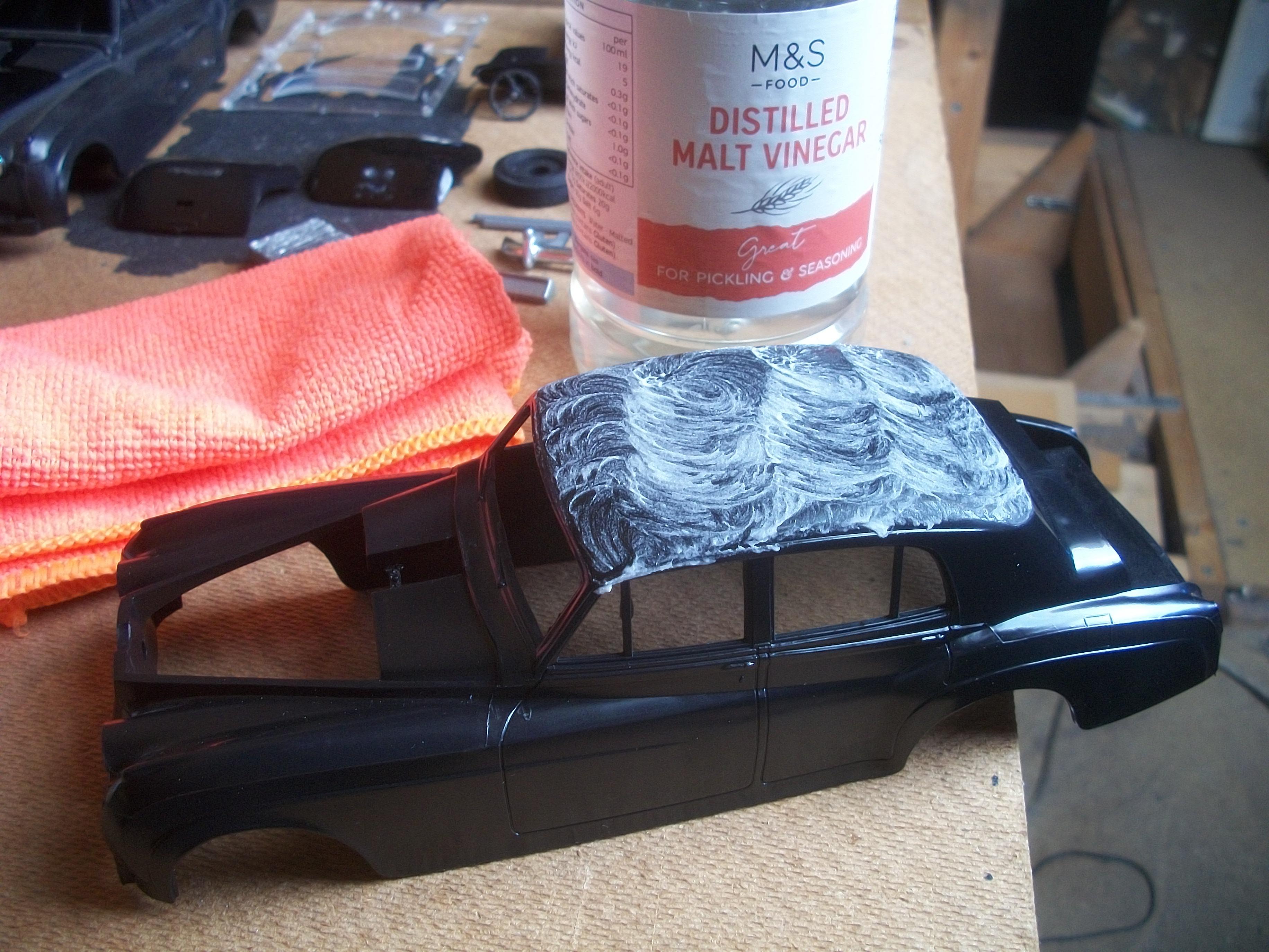

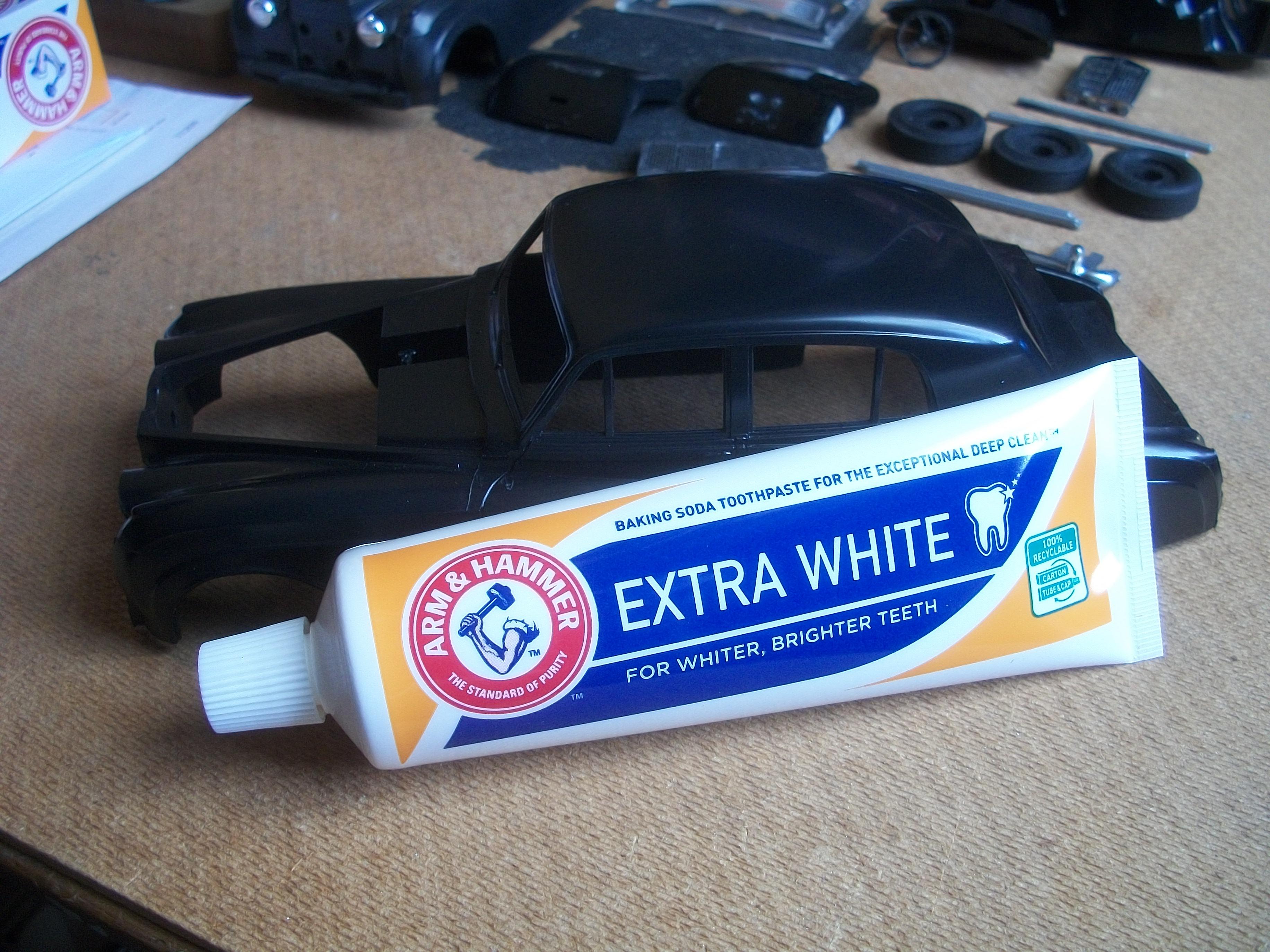

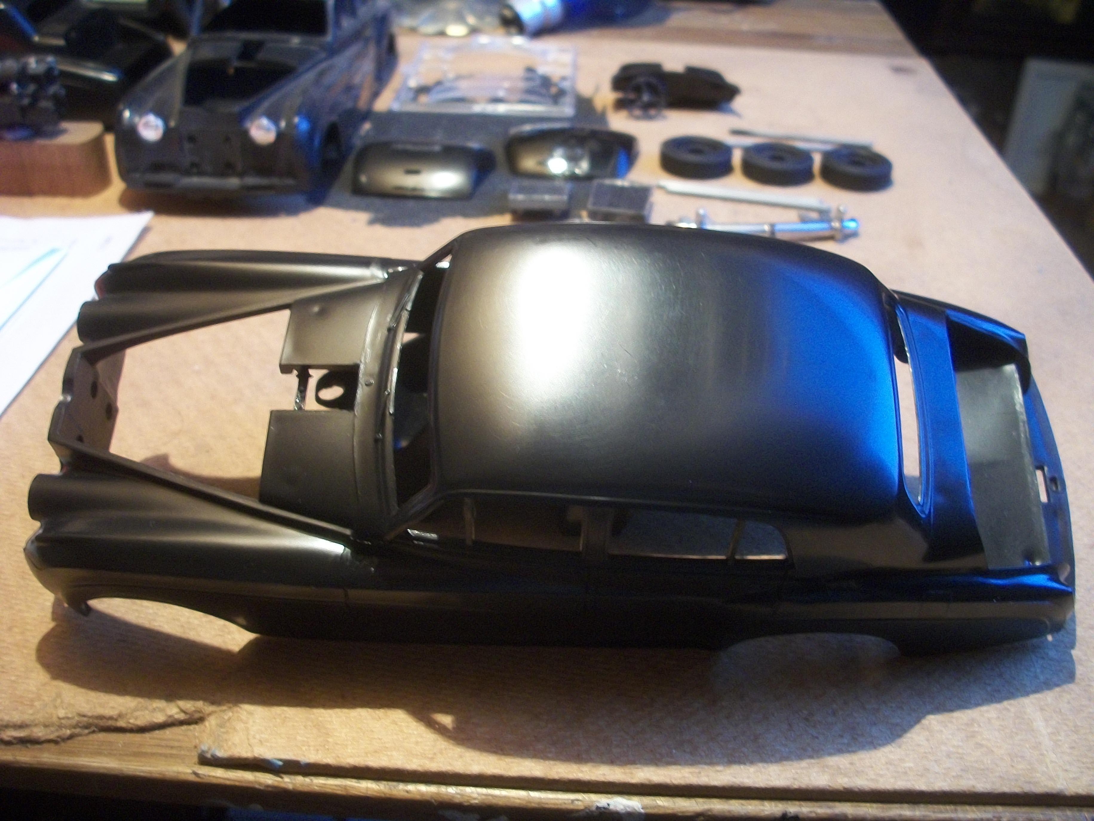

Today I picked up some baking soda toothpaste from a local store, which is the type that is white and has no gel or coloured stripes in it . . .
This toothpaste was applied to the roof area of my test model, by using a firm circular motion with a microfibre cloth, and allowed to dry for a few minutes.
Then I used a clean microfibre cloth soaked in distilled malt vinegar to polish the roof, using the same circular motion . . .
Well guys . . . The shine is wonderful, and this is only having applied the toothpaste once. I shall probably give it a further application, as this is purely a test model . . . I hope that you can see the result from the photos below, which has impressed me greatly. Look at the reflection of the thermometer.
I do like the shine on this roof panel and I have never been able to achieve this standard of finish with any painting methods that I have used over the years.
David

That worked out very well for you, David. Polished up nicely. 👍👍
Thanks John . . . This gives me the confidence that I needed to polish up the entire body shell using this method . . .
David
