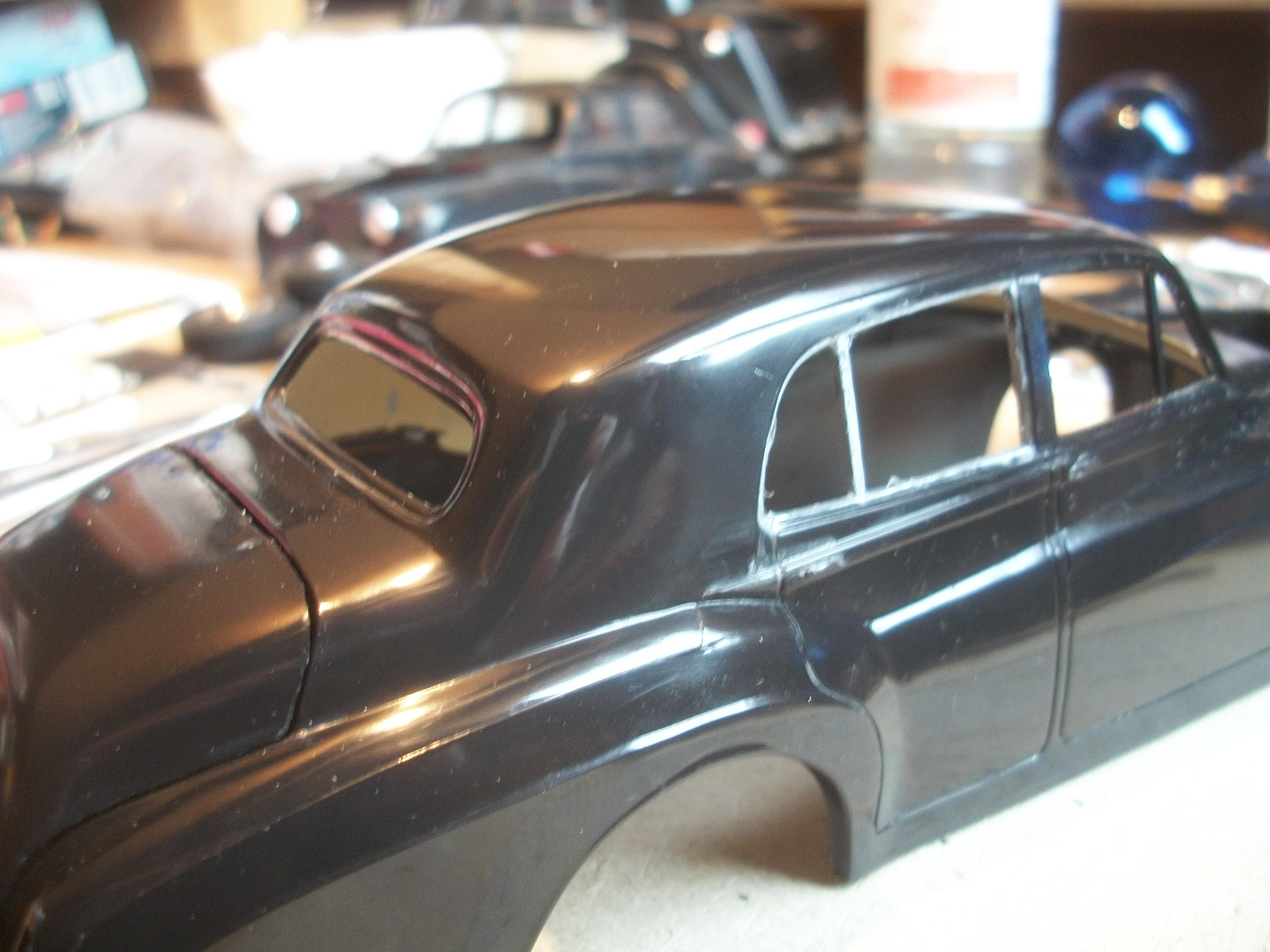

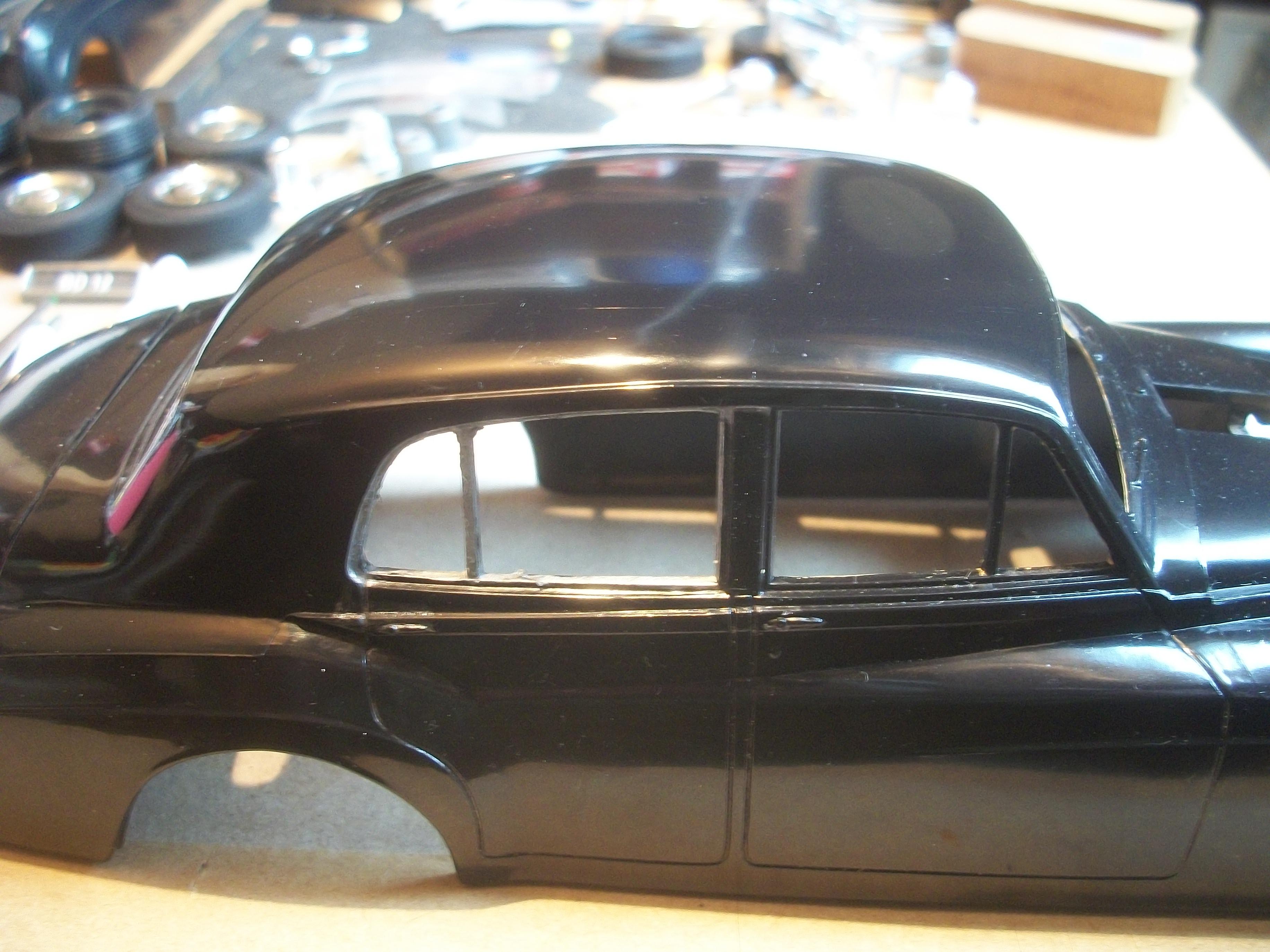

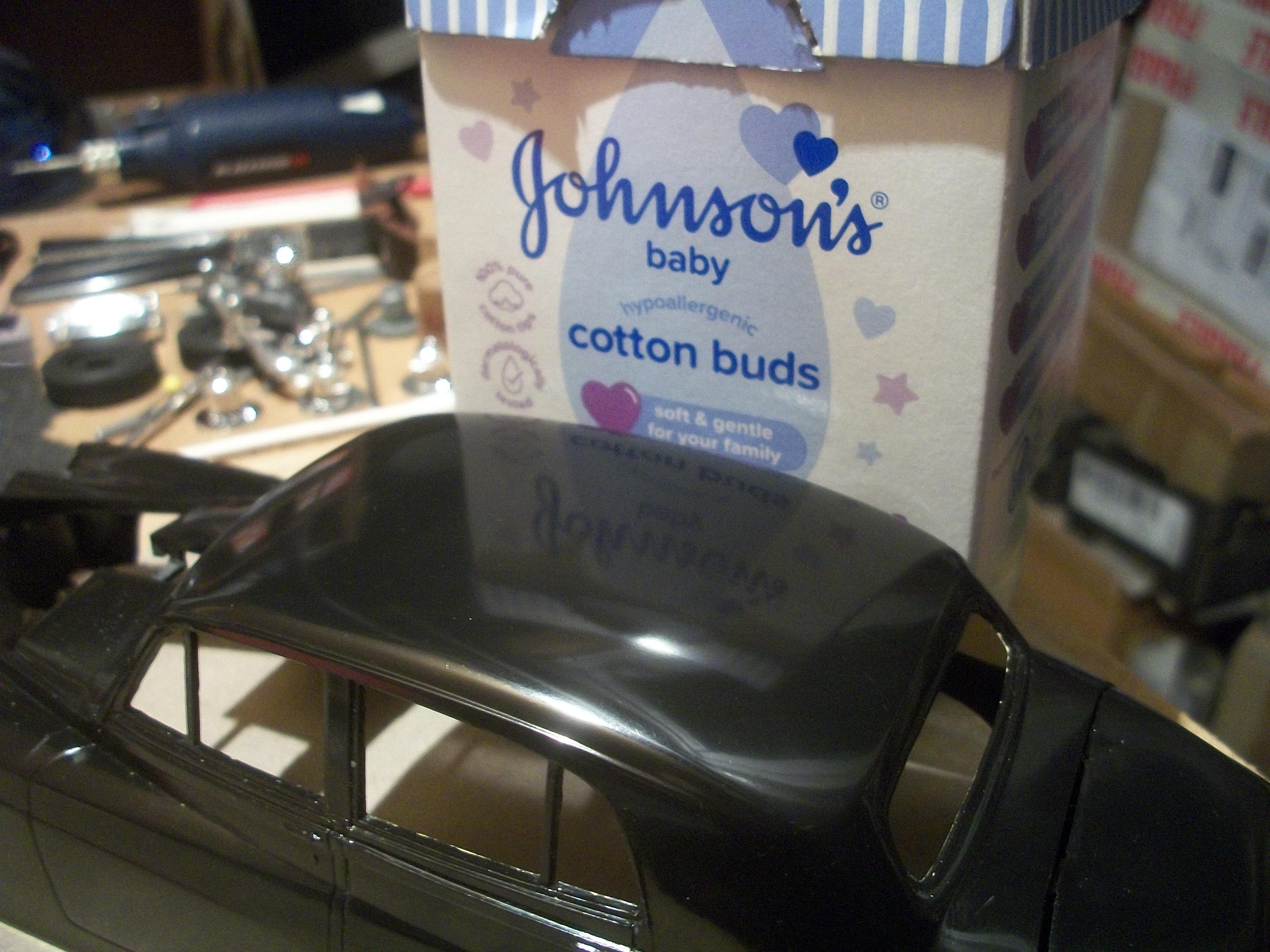

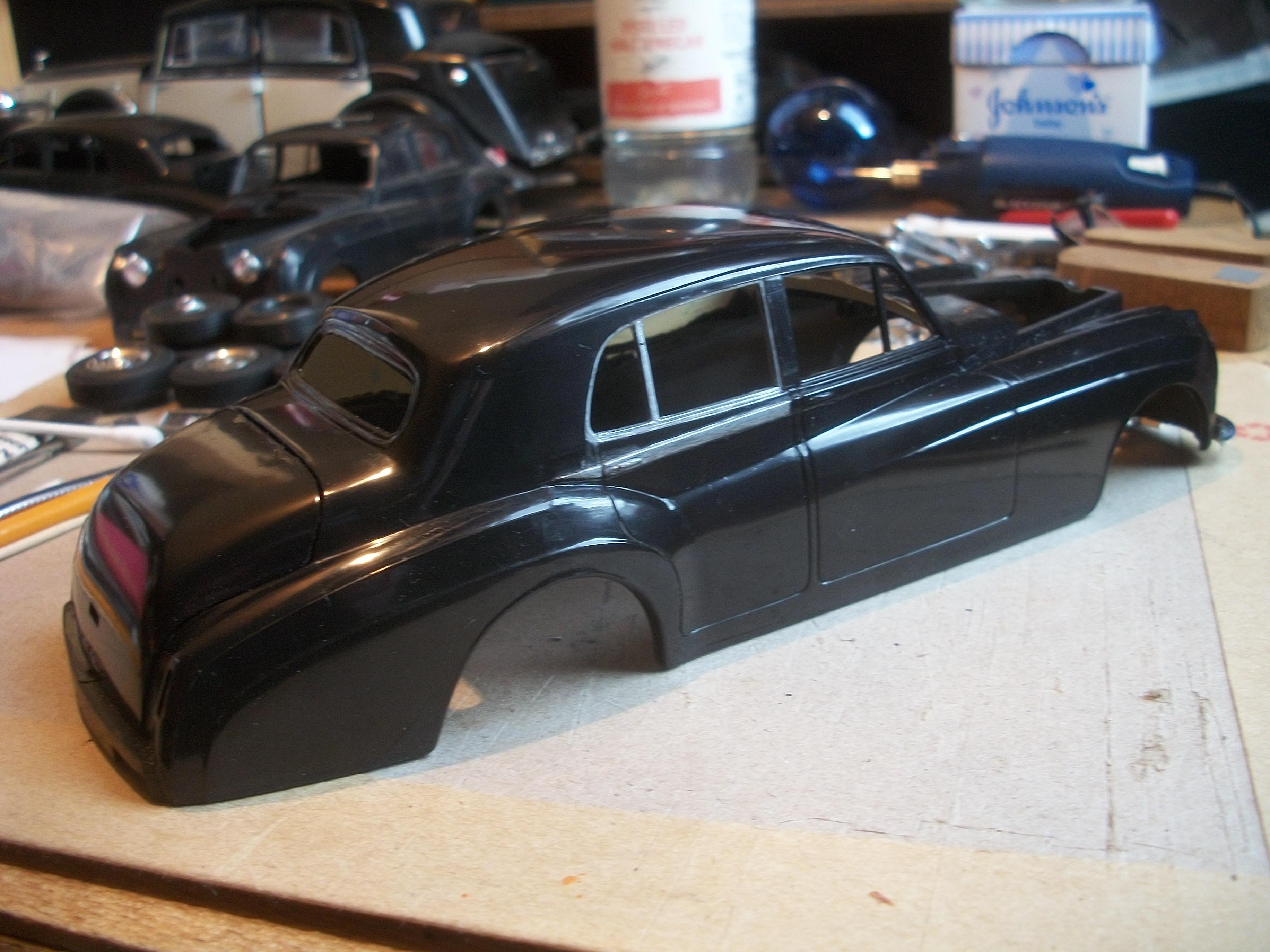

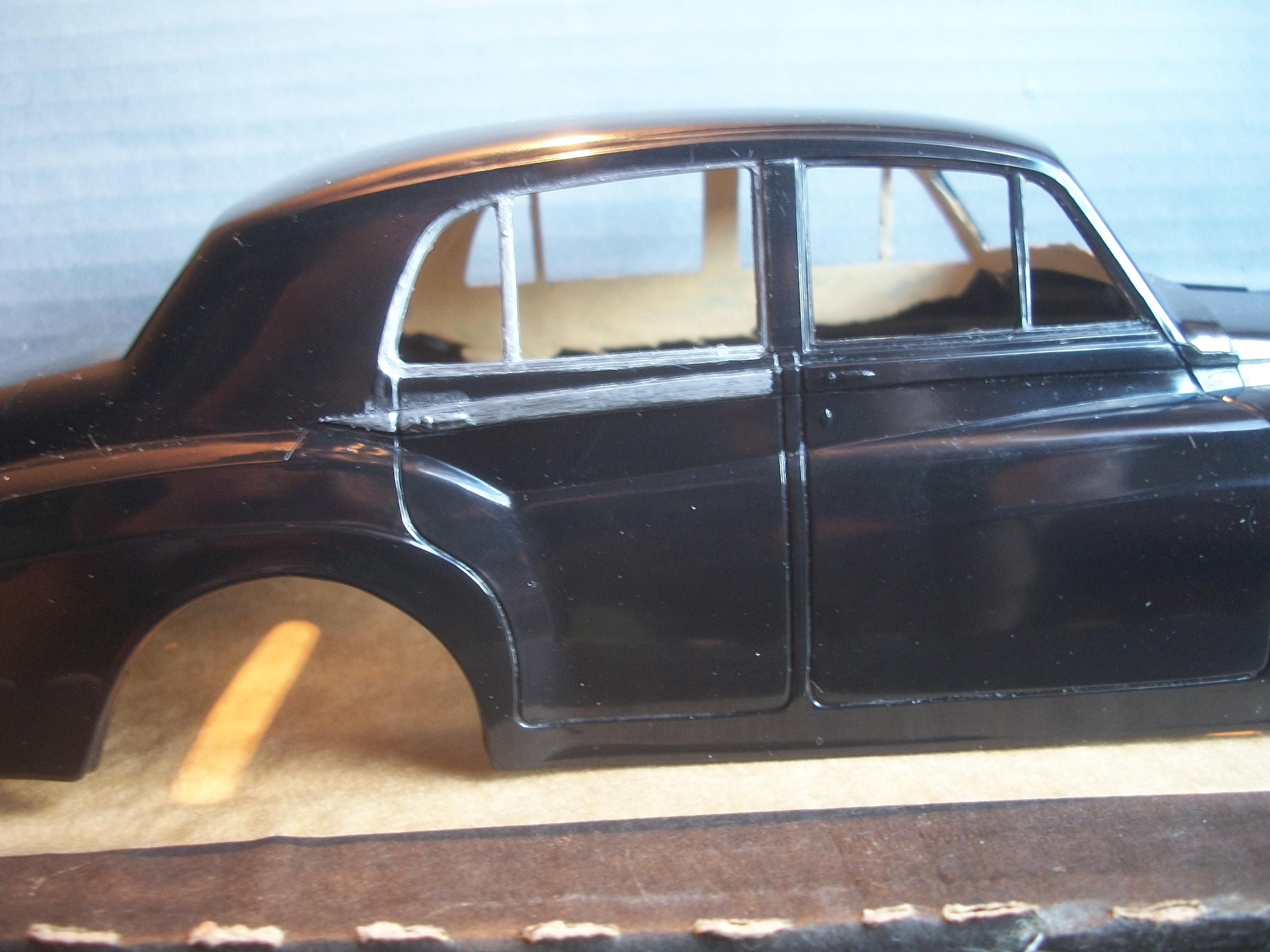

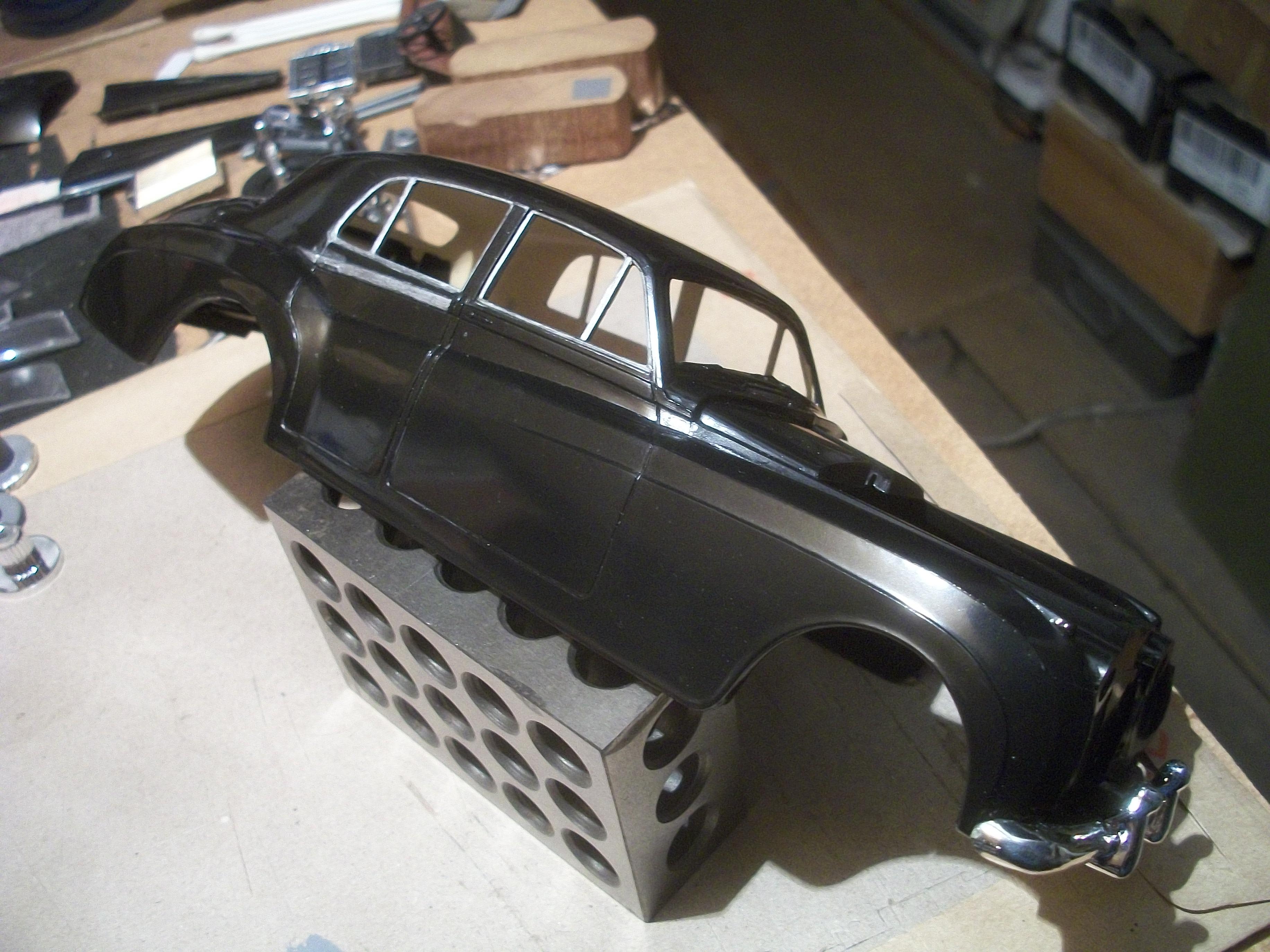

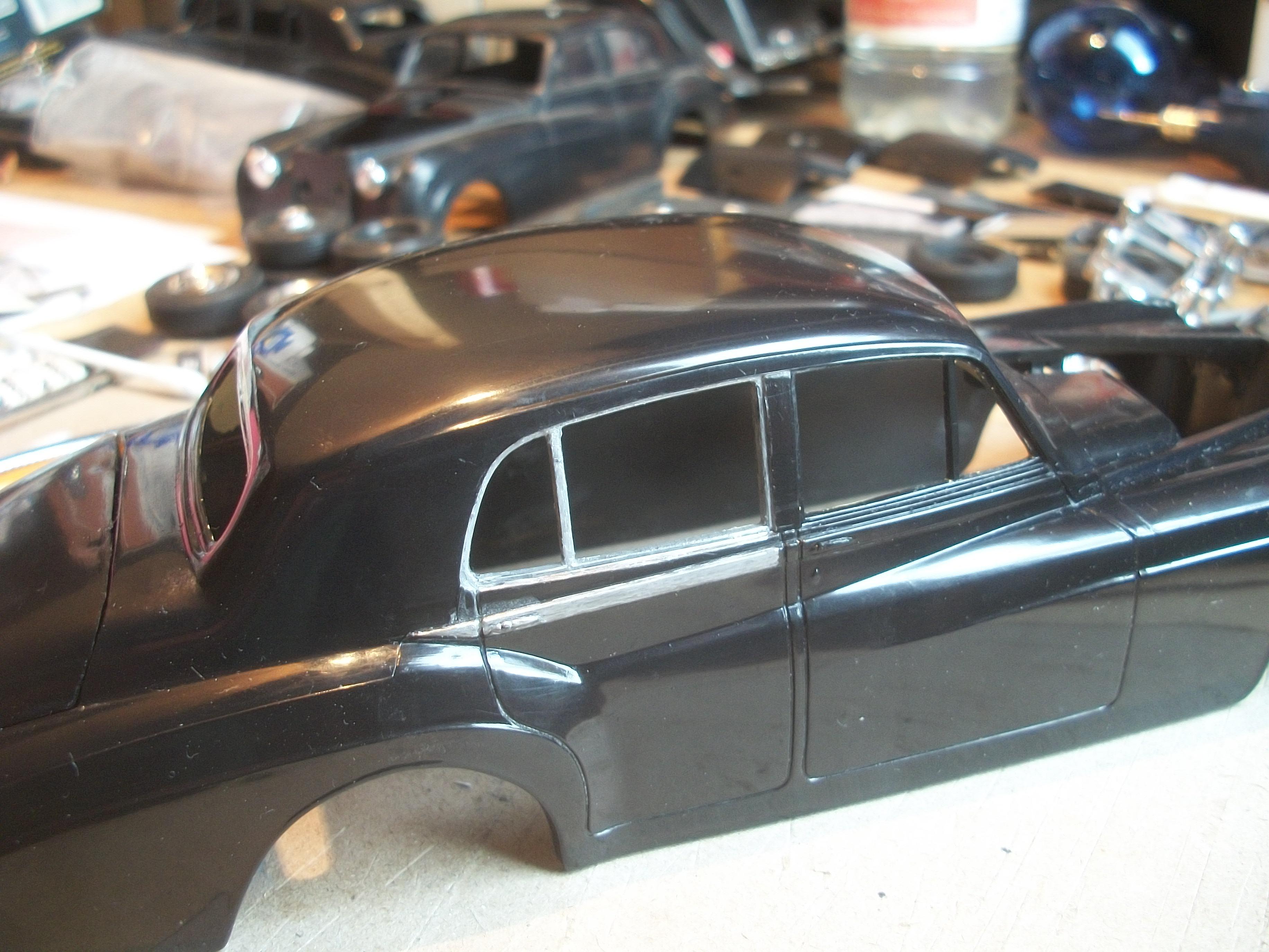

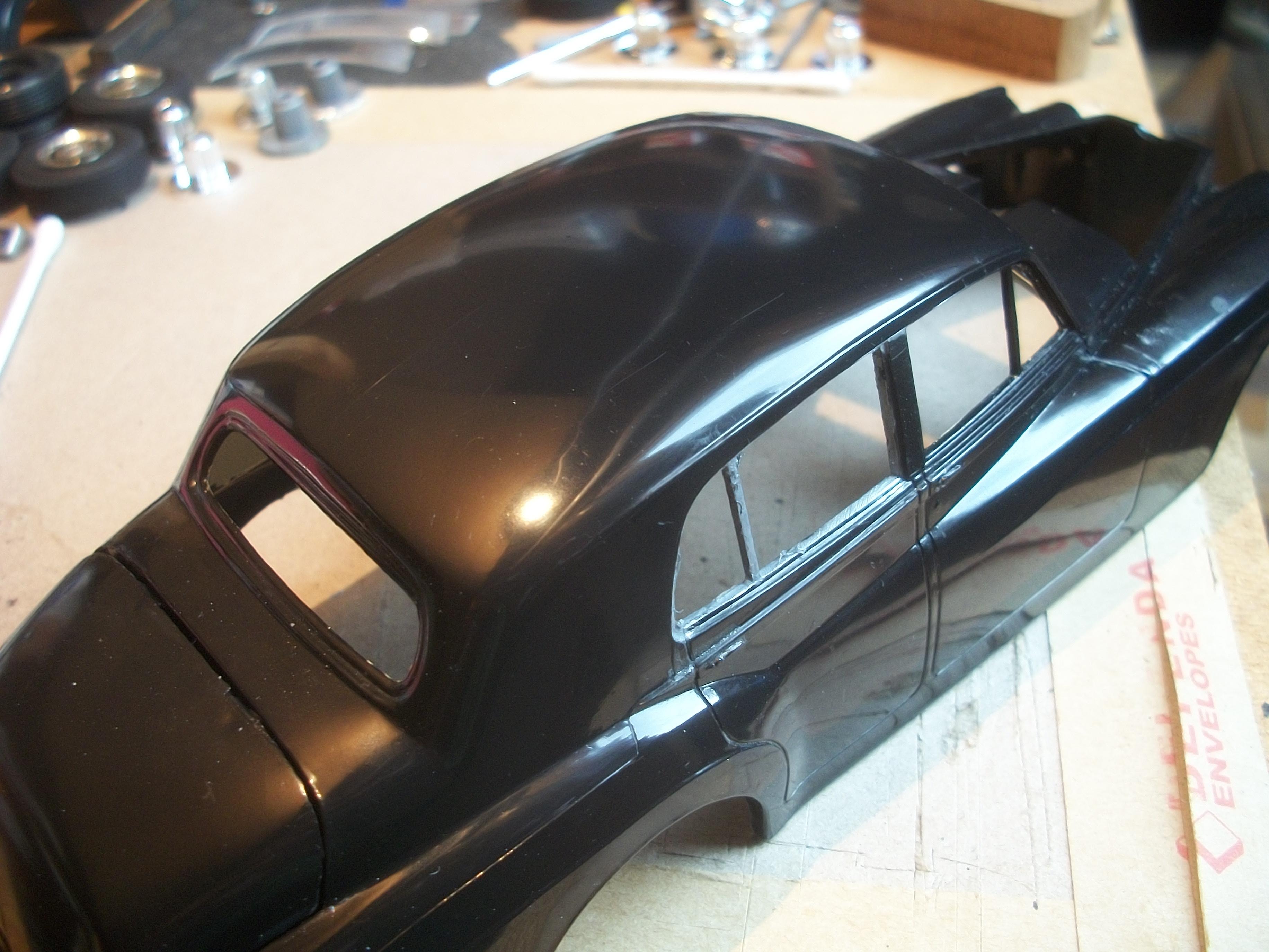

MarkJ Posted 21 hours ago Posted 21 hours ago Congrats, David. That last picture you posted is a definite winner. I can read the printing on the box next to the model. When that happens, you have reached your goal in the paint department. Bravo!
johnyrotten Posted 20 hours ago Posted 20 hours ago You definitely have a great shine going on. That looks fantastic 👍👍
Anglia105E Posted 9 hours ago Author Posted 9 hours ago 11 hours ago, MarkJ said: Congrats, David. That last picture you posted is a definite winner. I can read the printing on the box next to the model. When that happens, you have reached your goal in the paint department. Bravo! Thanks Mark . . . I am trying to upload the text to go with these photos, but MCM website will not allow me to do that ( error message Oops that page can't be found
Anglia105E Posted 9 hours ago Author Posted 9 hours ago 10 hours ago, johnyrotten said: You definitely have a great shine going on. That looks fantastic 👍👍 Thanks John . . . I am trying to upload the text that goes with these photos but MCM website will not allow me to do that ( error message is Oops that page can't be found )

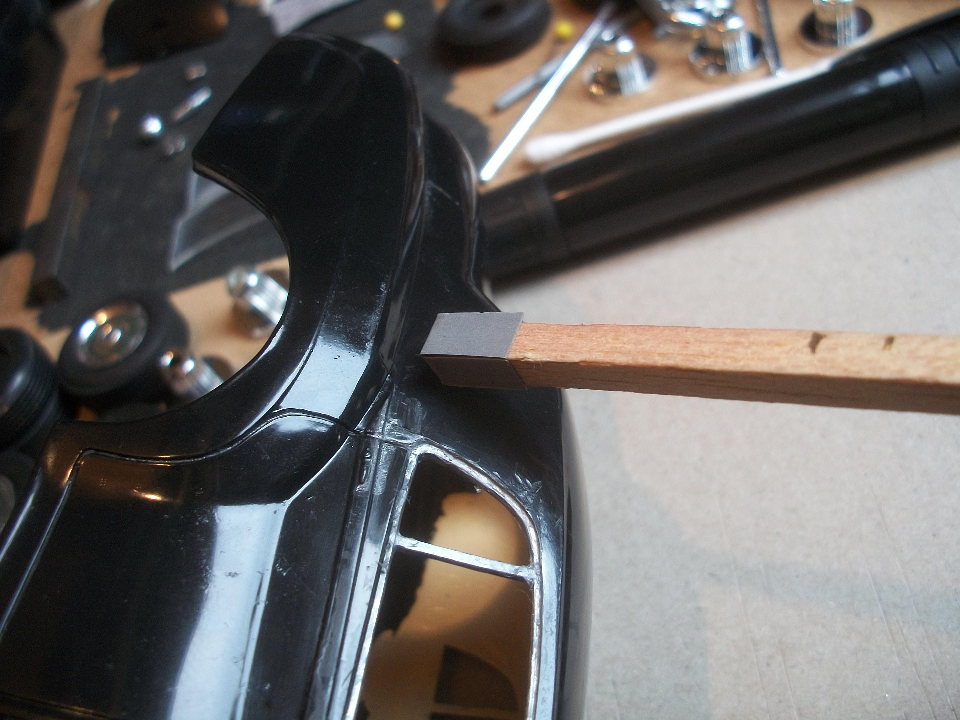

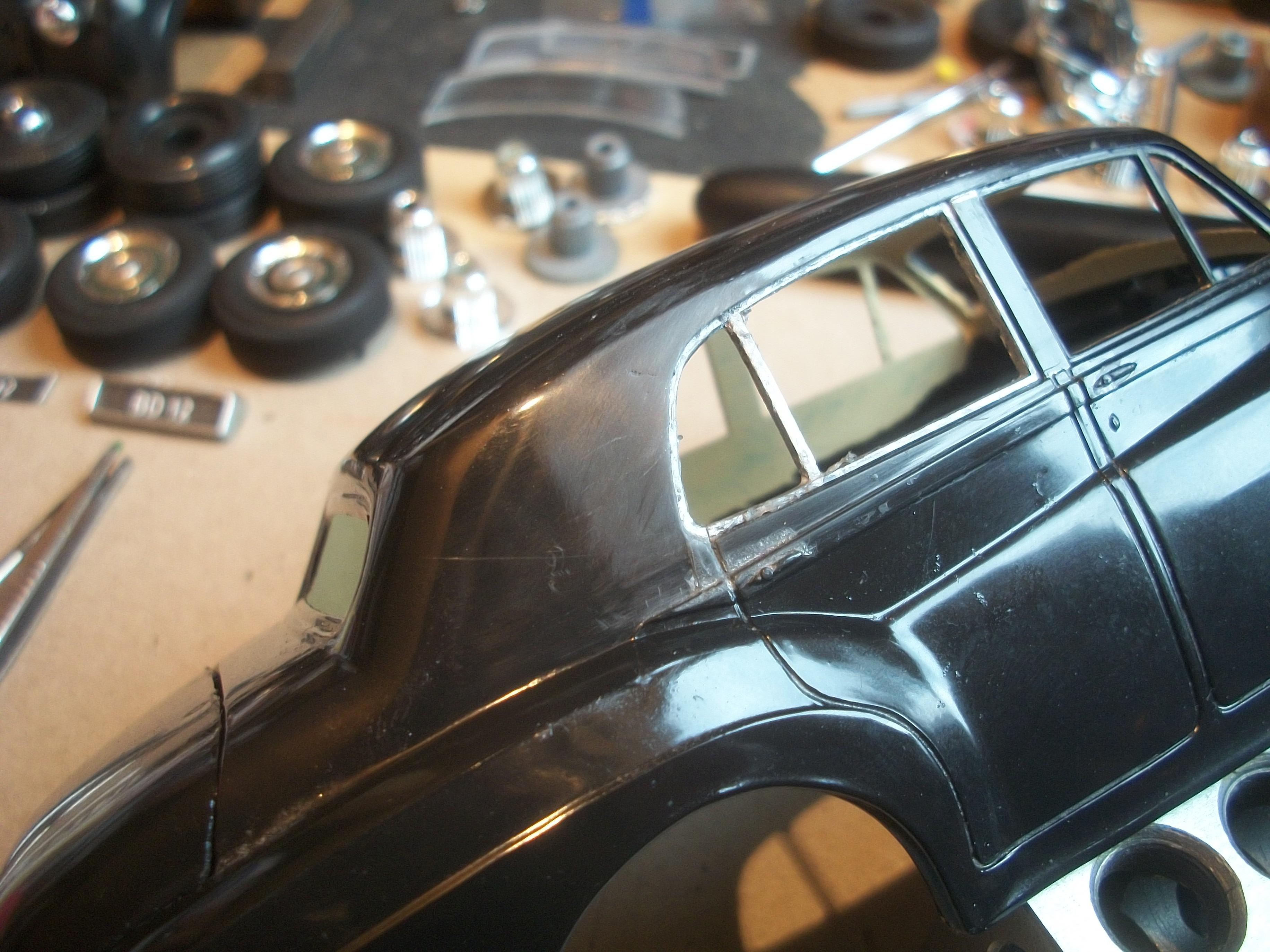

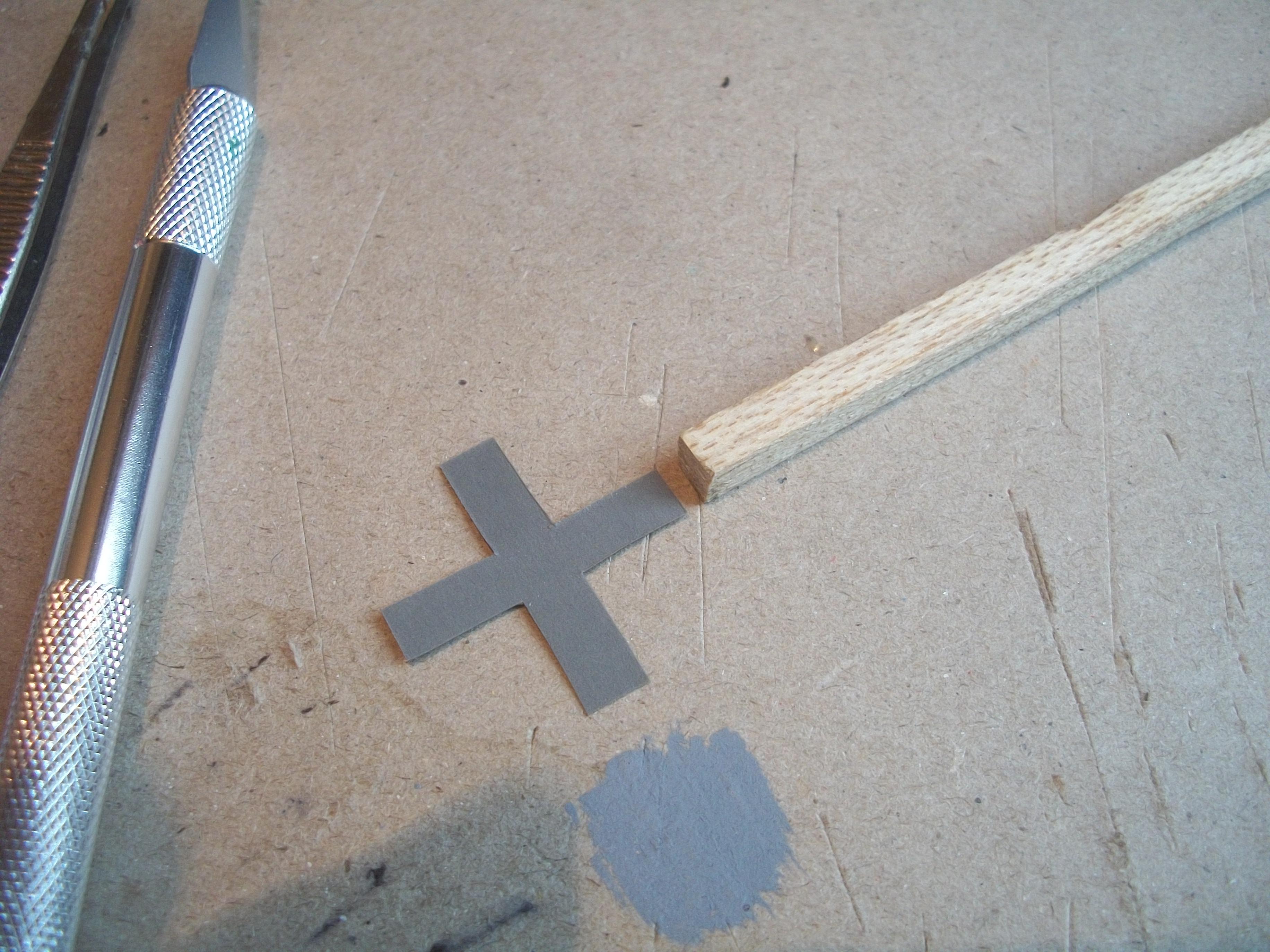

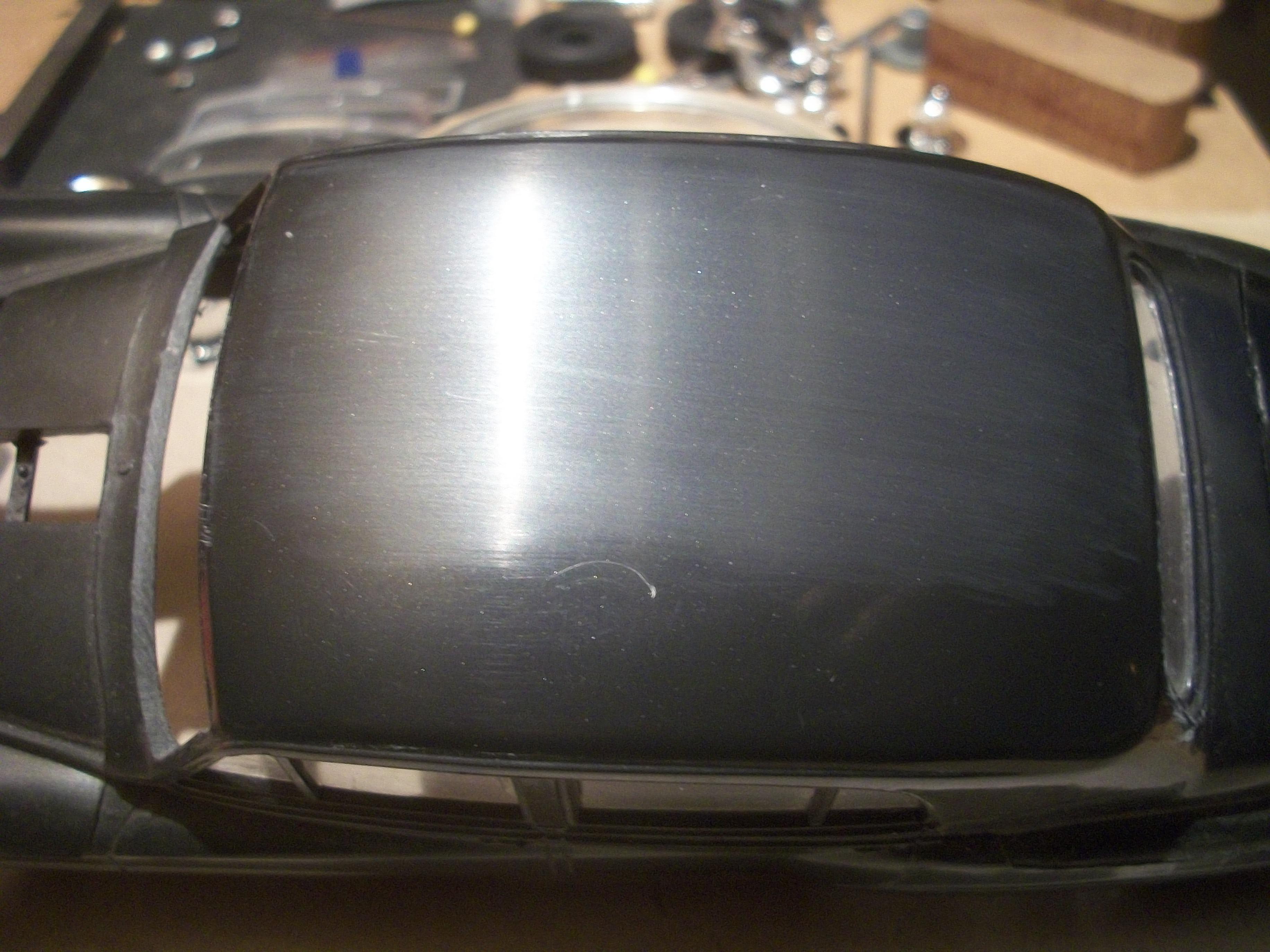

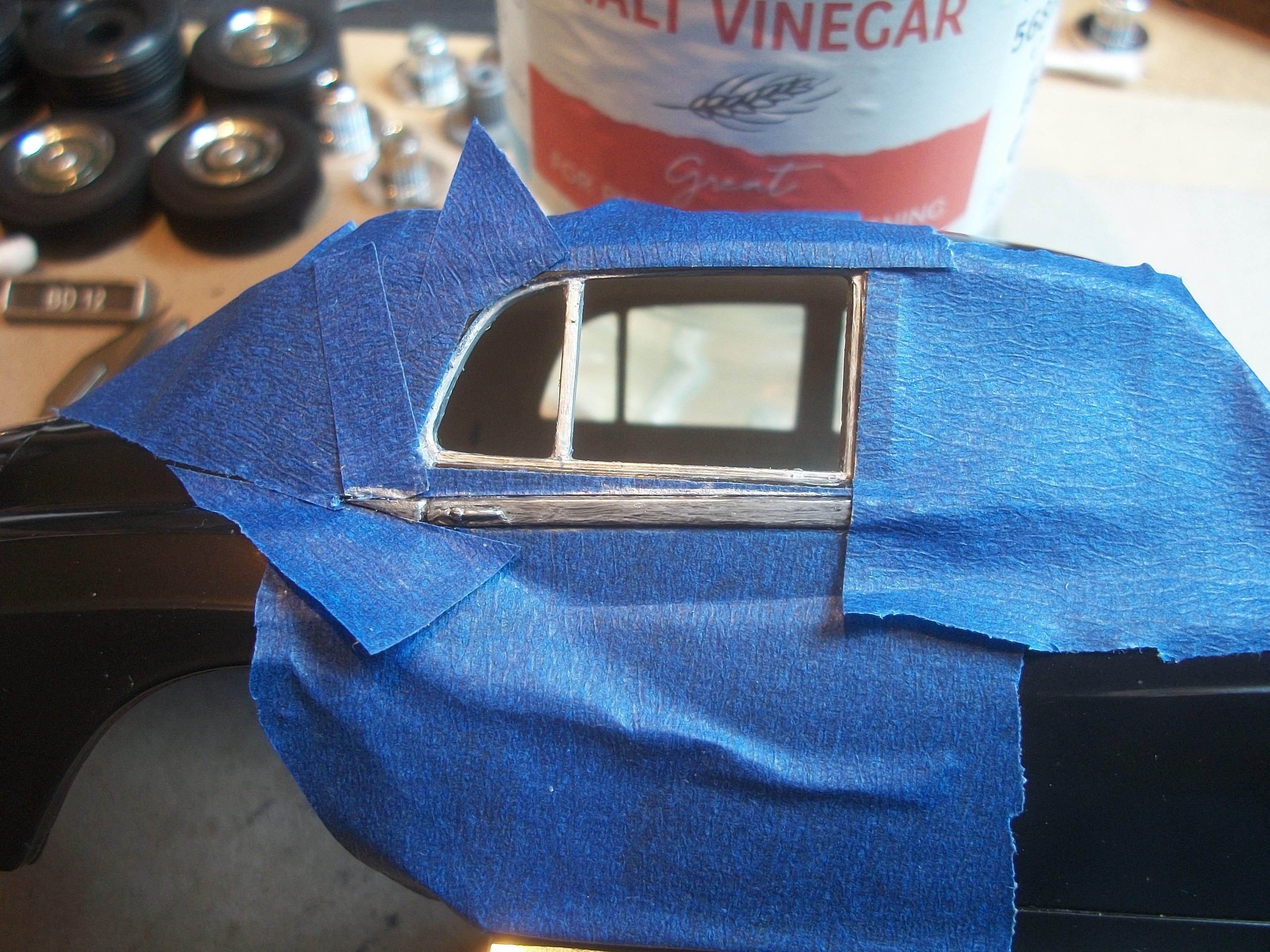

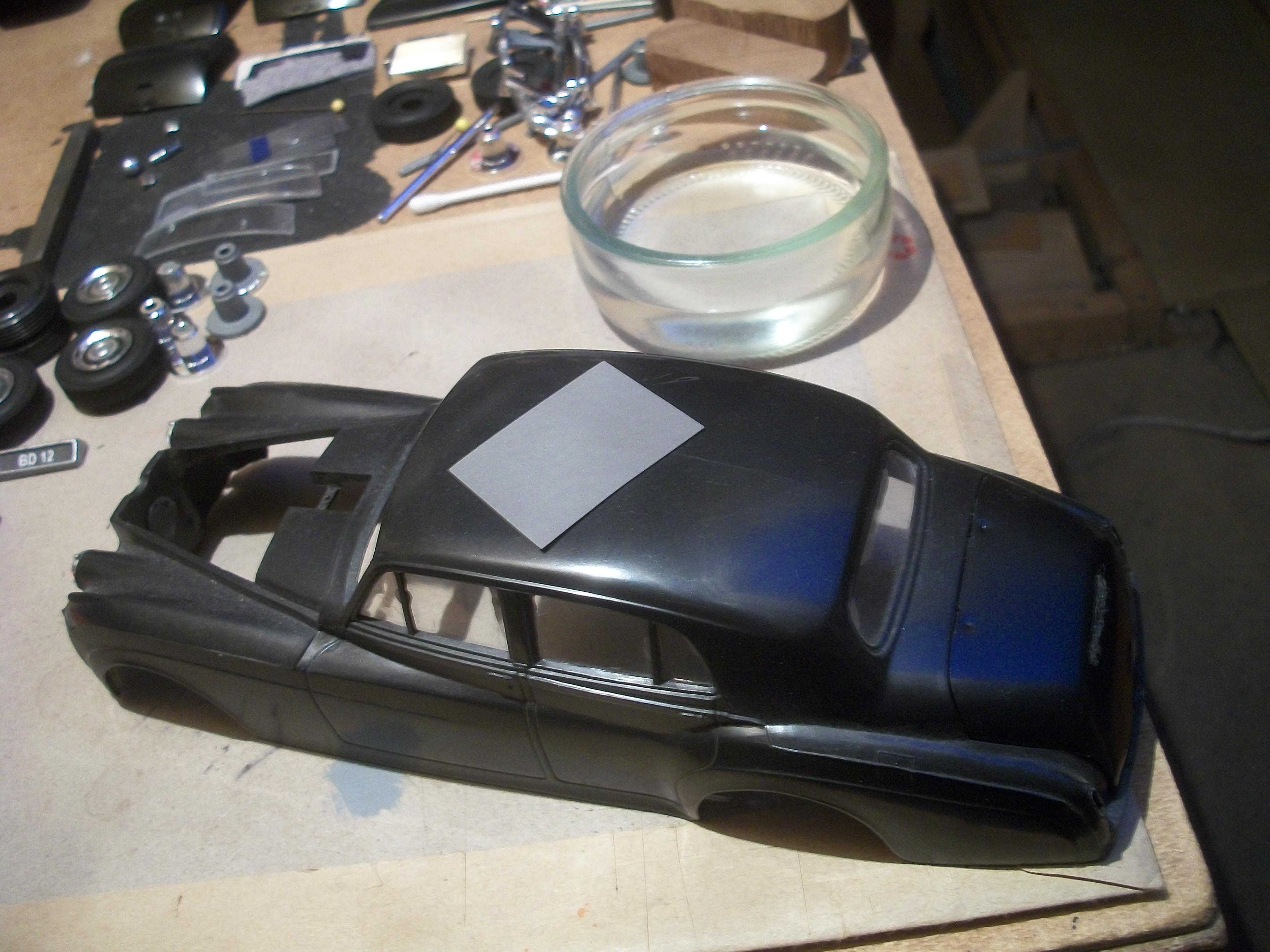

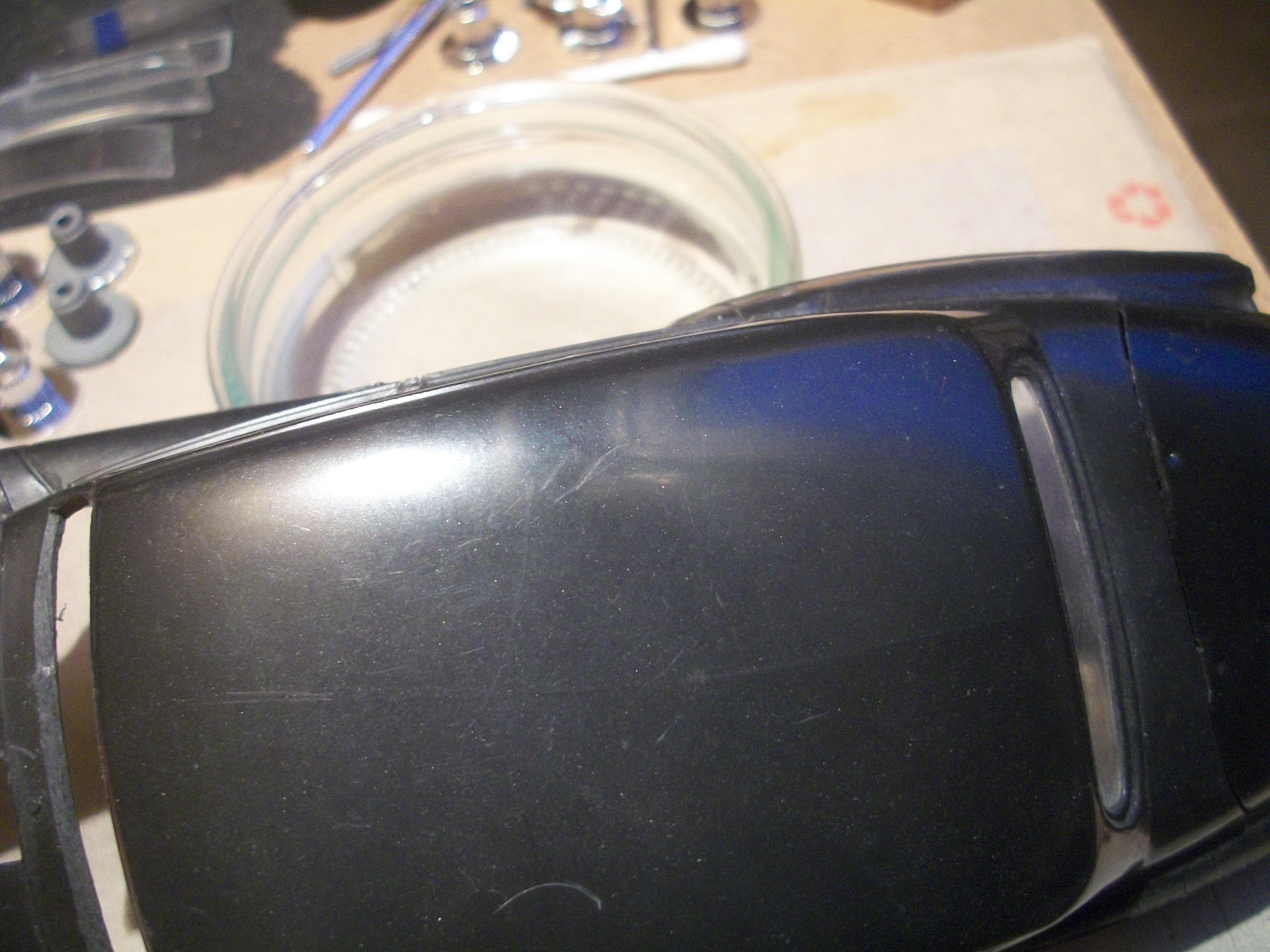

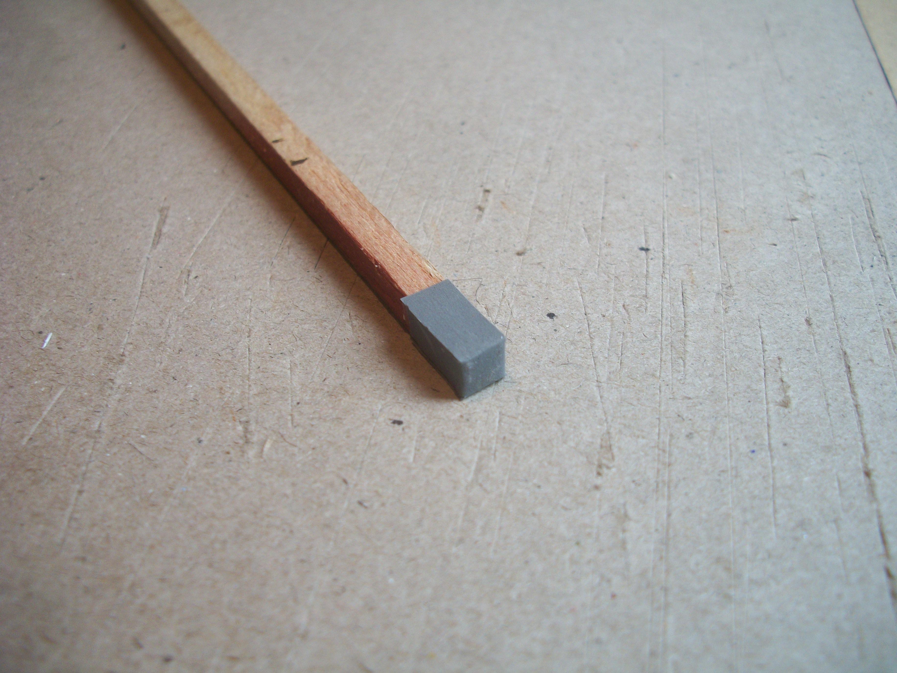

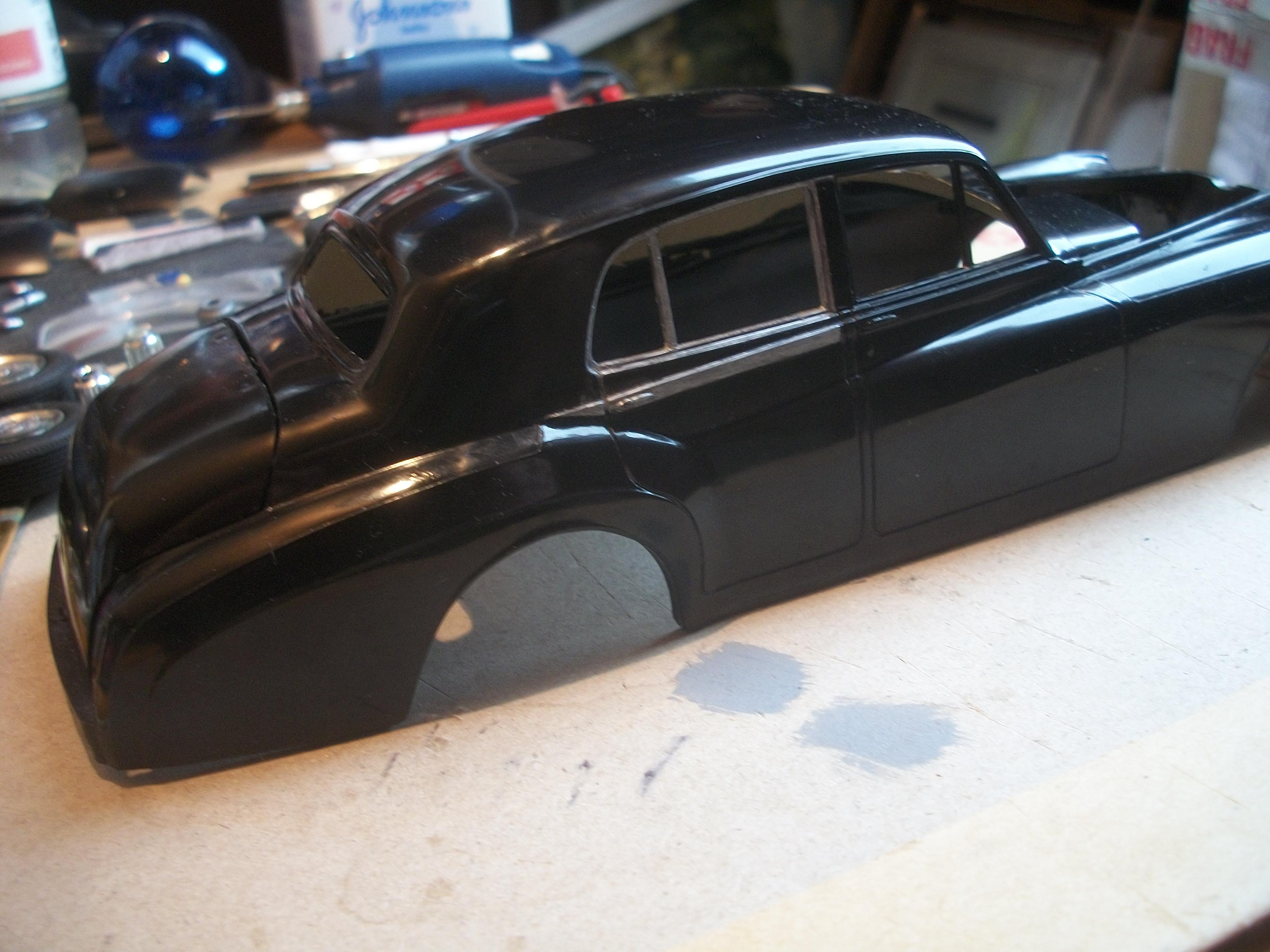

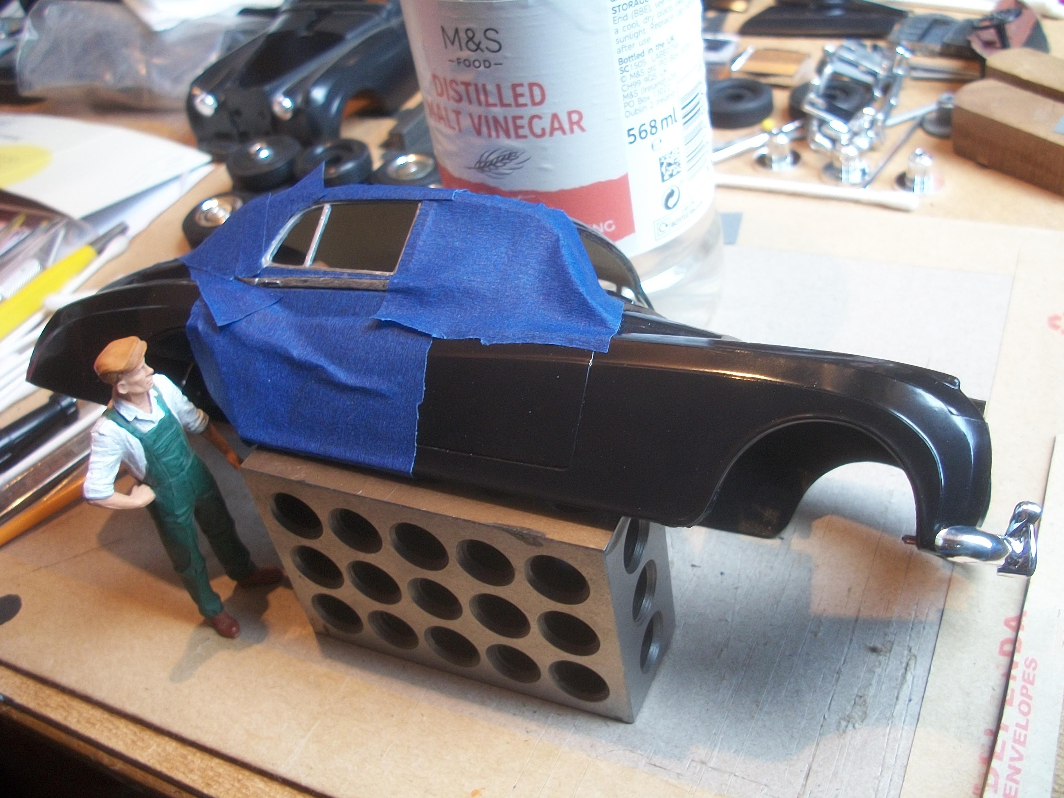

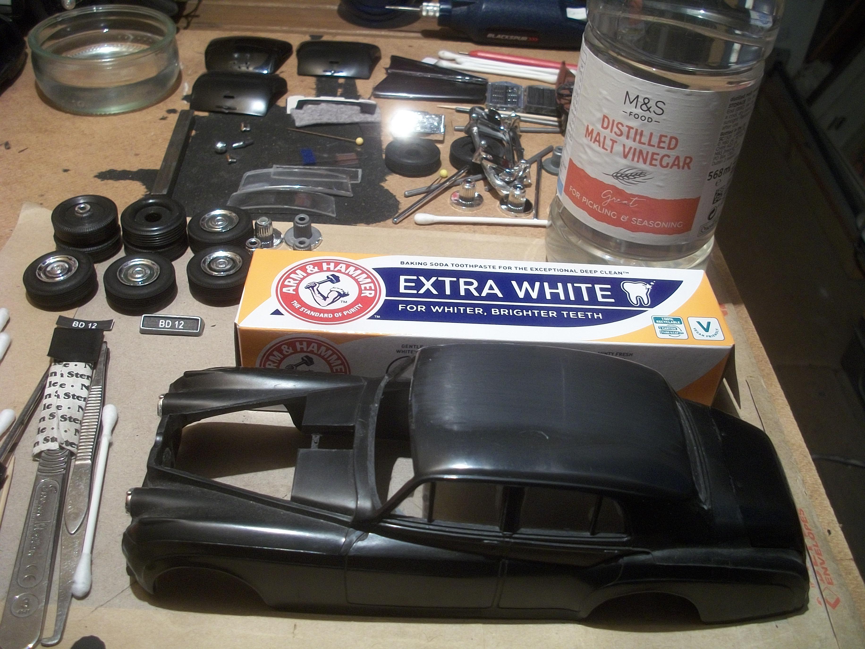

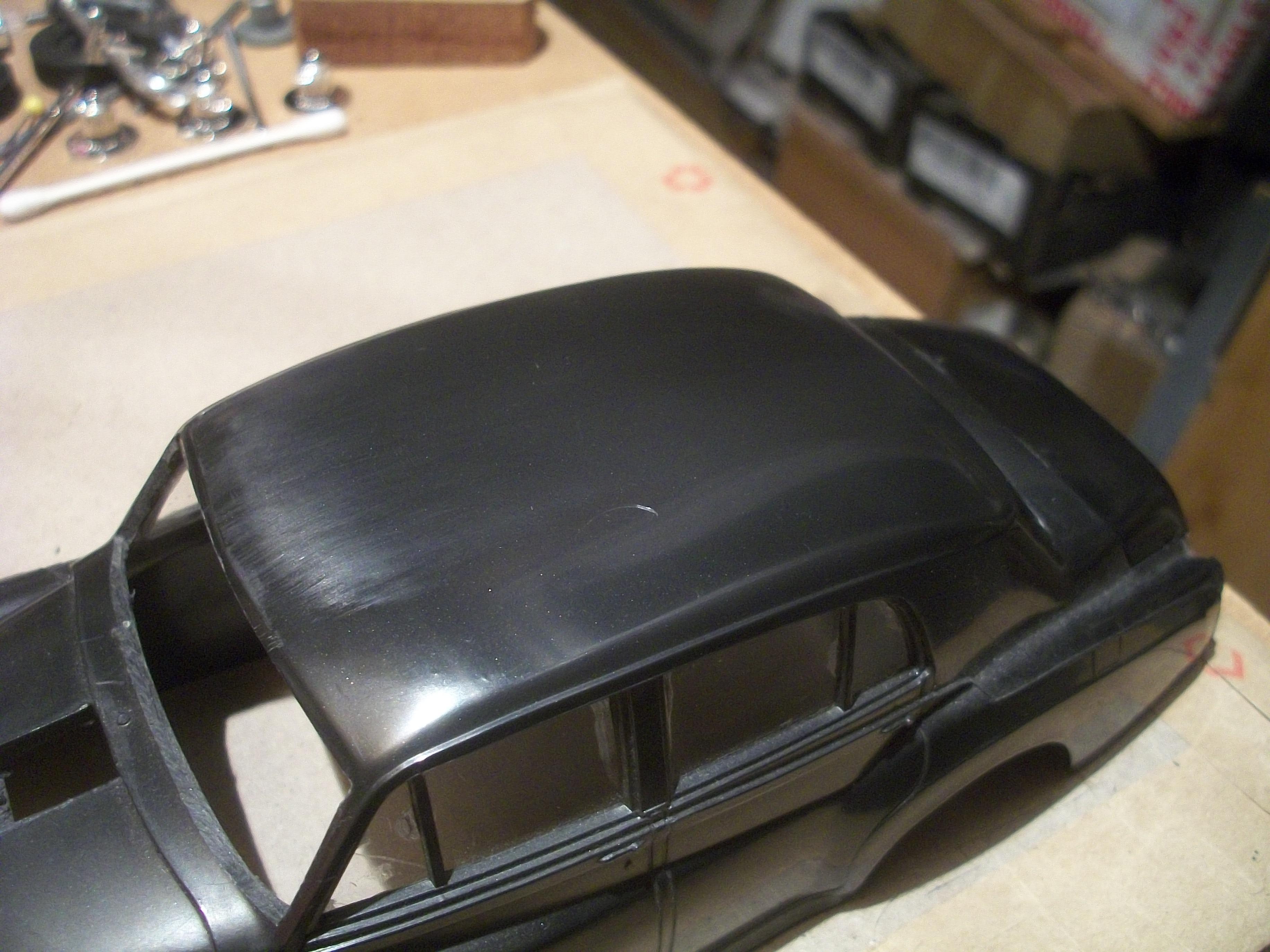

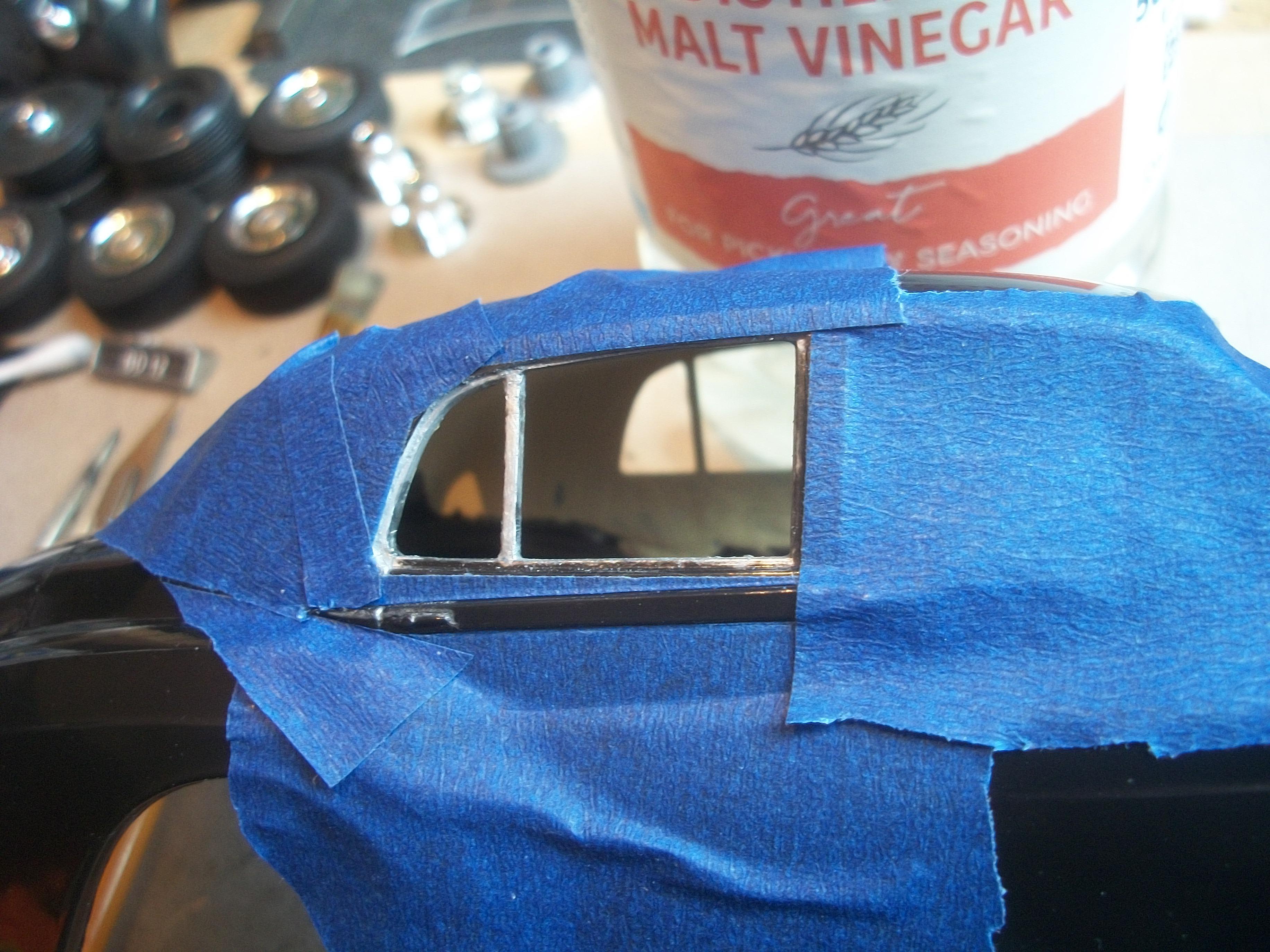

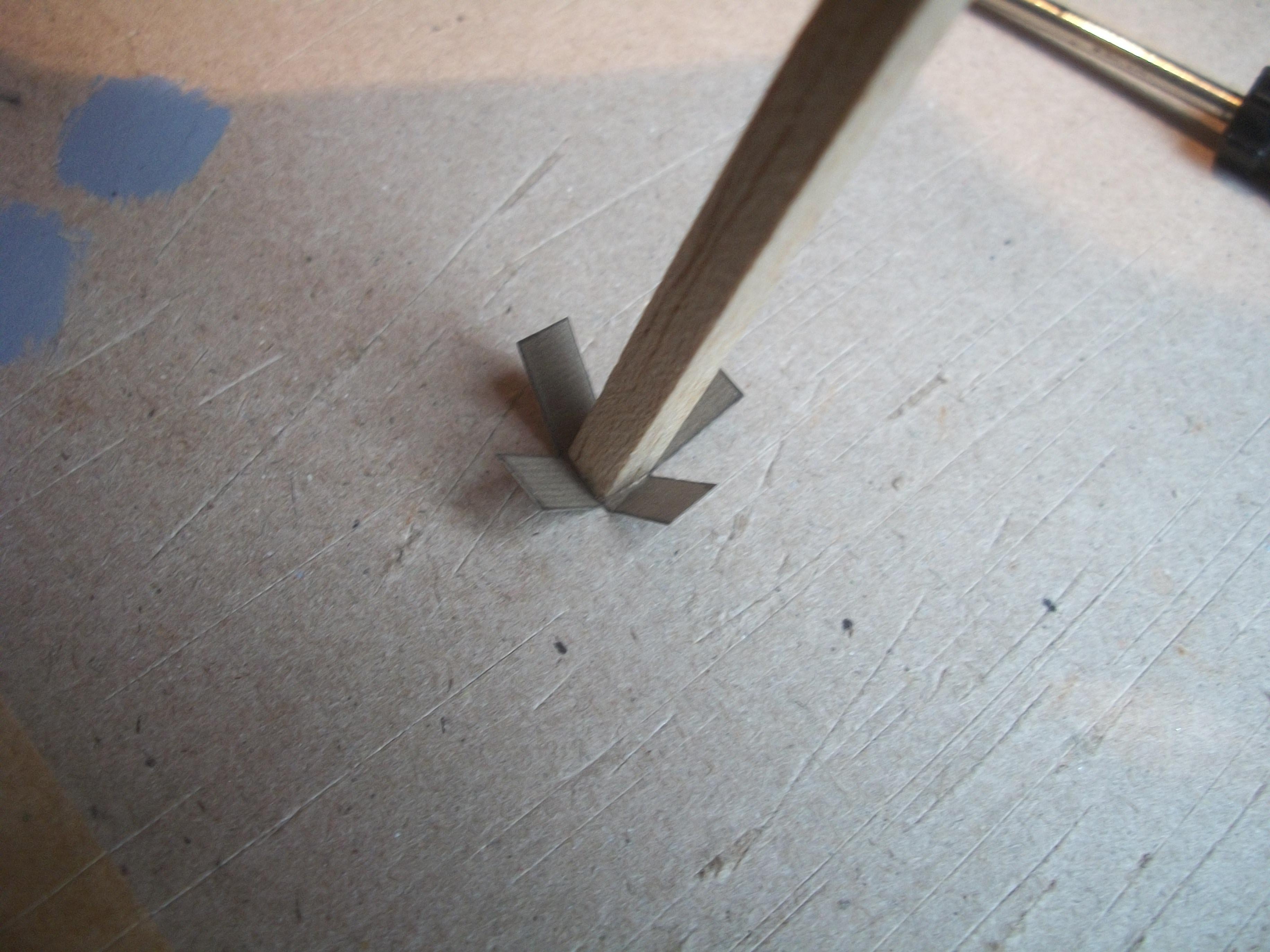

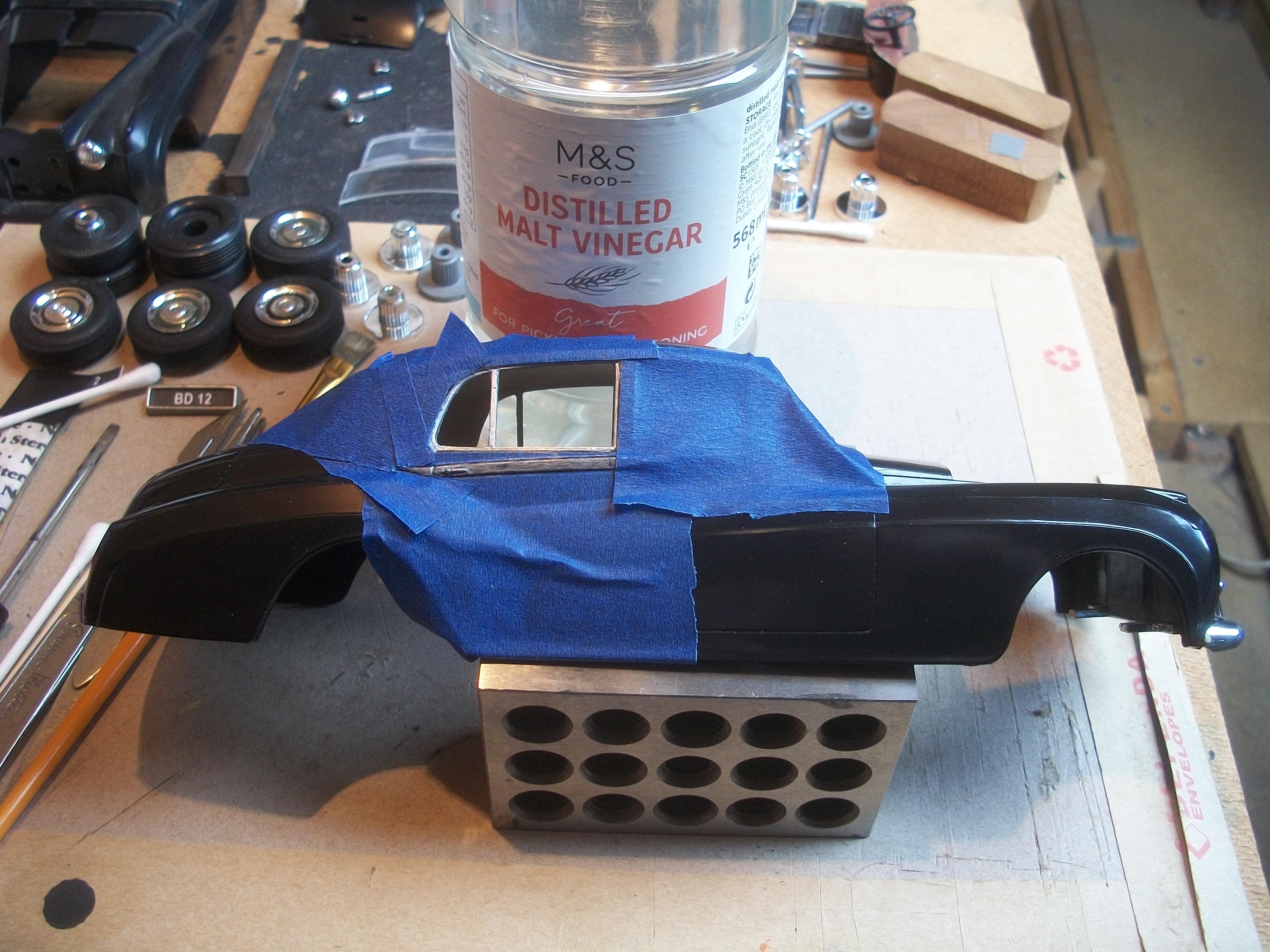

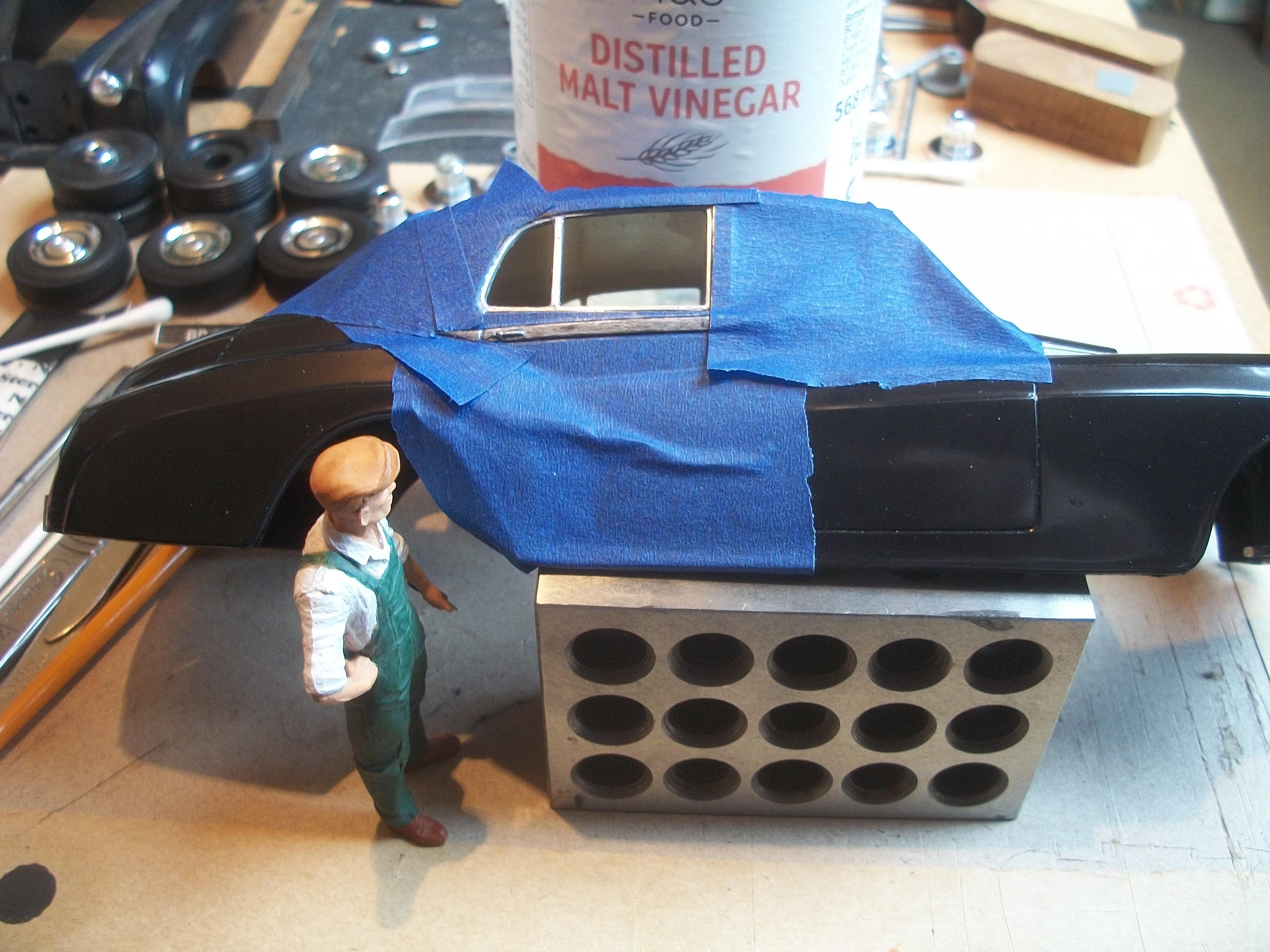

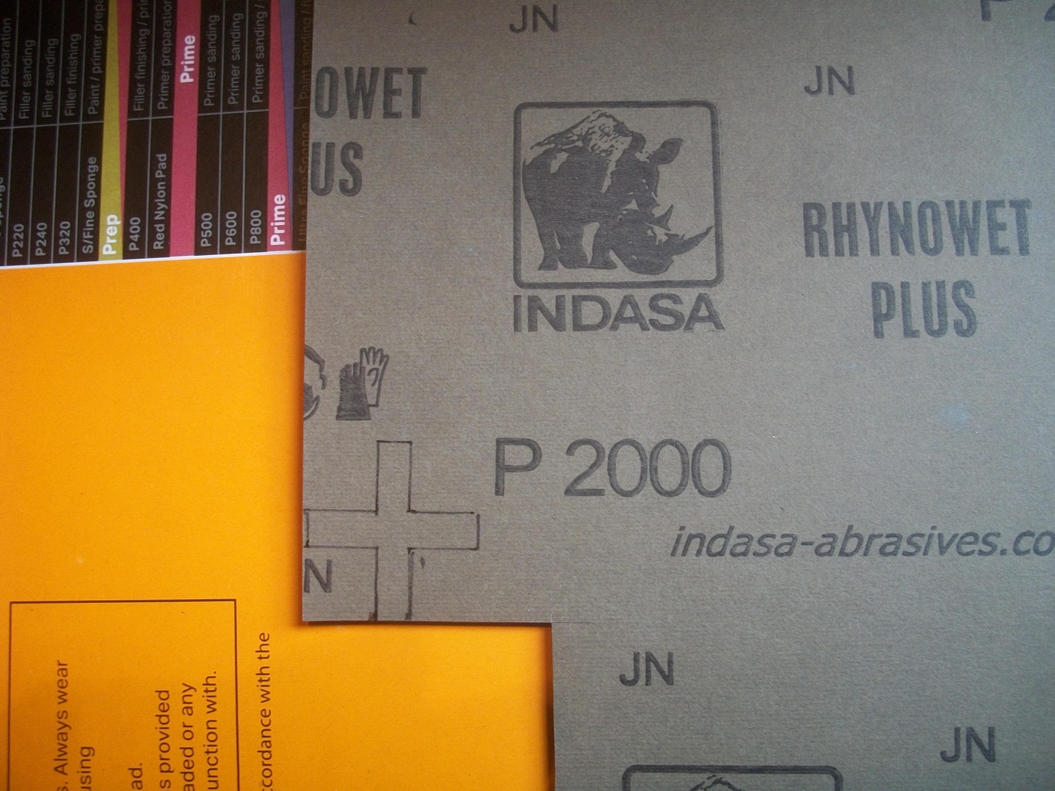

Anglia105E Posted 27 minutes ago Author Posted 27 minutes ago Previously I did try to add text to explain what I was doing in the photos, but the text was rejected, for reasons unknown to me. Basically, those photos showed an experiment to remove a scratch from the test body shell . . . Today I made some good progress with this process, this time using the Entex body that will be the actual build. Here is the explanation, along with some further photos. Hopefully my text will not be rejected this time, as it was quite a lengthy post and valuable model building time was wasted. First of all, a cross was drawn and cut out from a sheet of 2000 grit wet and dry paper. This cross was folded and placed onto the end of a length of square rod balsa, and held in place with double sided tape. Then I used this makeshift tool to sand the area of damage using some water. The scratch was removed and the roughness of the sanding process was polished out with baking soda toothpaste and distilled malt vinegar. I am surprised and very pleased with the result. This step forward has given me renewed optimism, which I needed greatly at this early stage. I intend to use a new silver Sharpie marker pen, and also some narrow art tape to produce a chrome effect on the rear door window frame. The area of damage that has now been fixed, was immediately behind the door window frame, near to the top rear corner. David
