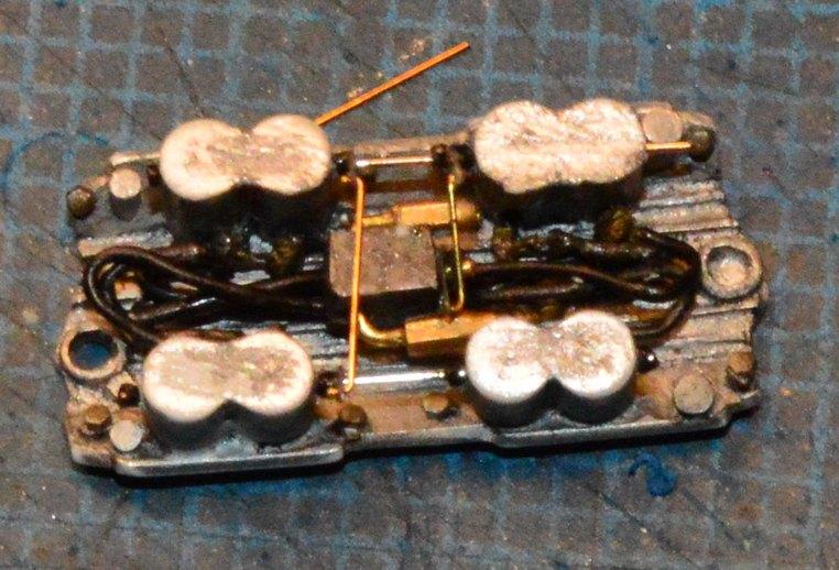

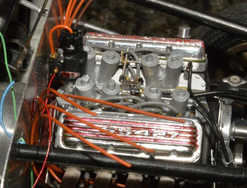

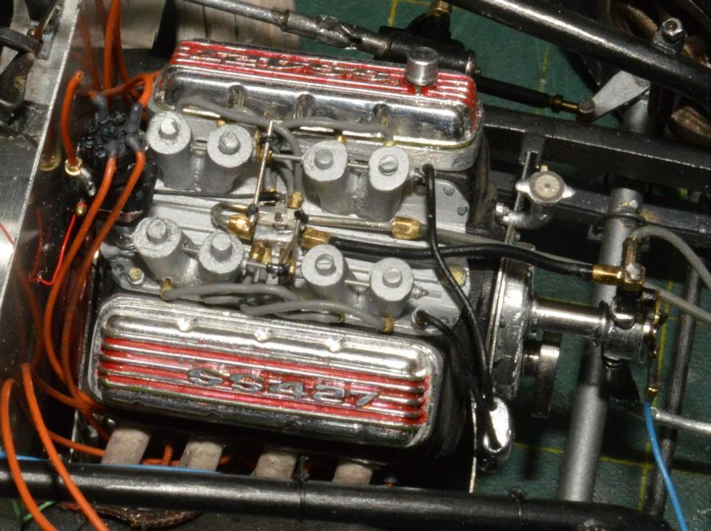

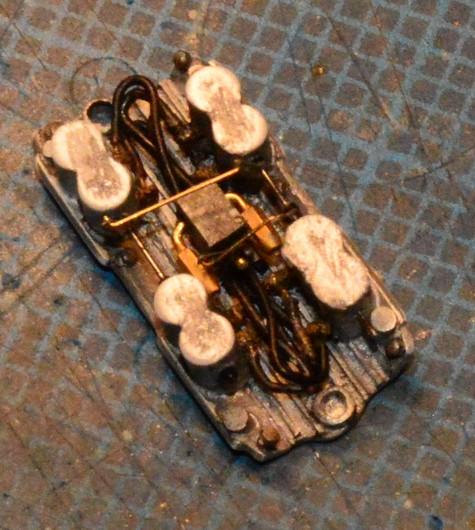

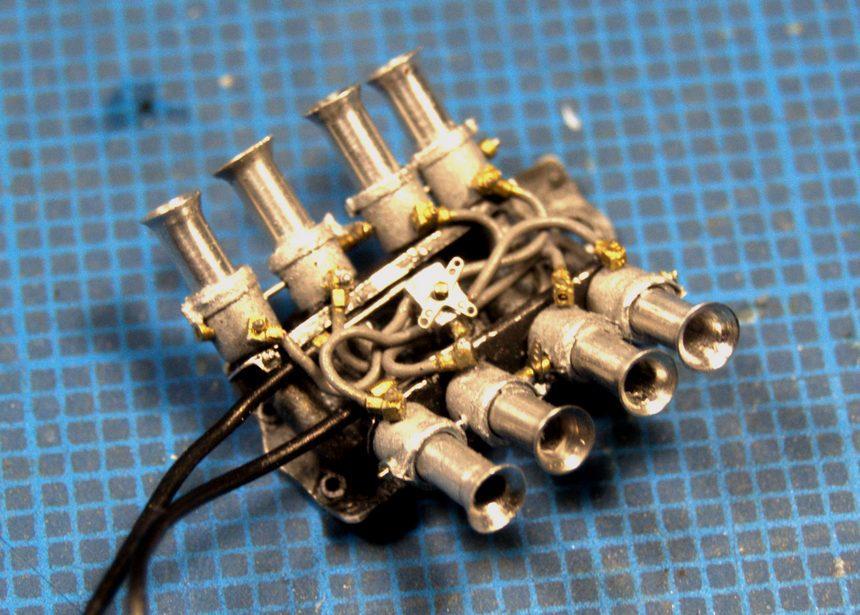

Straightliner59 Posted Thursday at 04:28 AM Posted Thursday at 04:28 AM I used some model railroad wire for this. I think I got it from Train Control Services(?). It's just under .020", which isn't too far off, for rubber lines. 3
Straightliner59 Posted Thursday at 11:40 AM Posted Thursday at 11:40 AM 3 minutes ago, sidcharles said: really nice plumbing Thank you, sir. I've had a bit of practice, over the last few years!😄I can never seem to build anything that is readily available...that I like. 4
Mark W Posted Thursday at 12:03 PM Posted Thursday at 12:03 PM Mighty impressive plumbing Dan! Where do you get your fittings? 1
Straightliner59 Posted Thursday at 12:12 PM Posted Thursday at 12:12 PM Thanks, Mark! I appreciate that. I make them, either from aluminum, or from Plastruct hex stock. I can make pretty small metal fittings using the lathe and the rotary table, on the mill. It's something I've always wanted to be able to do! 1
