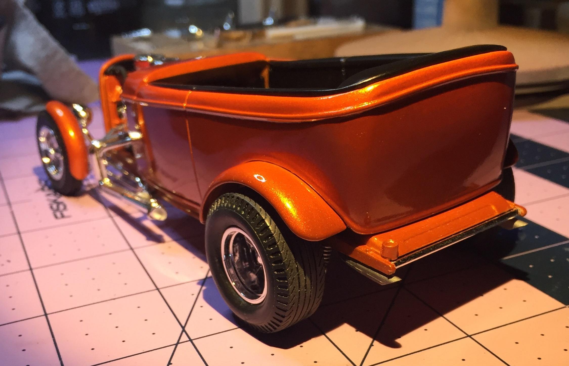

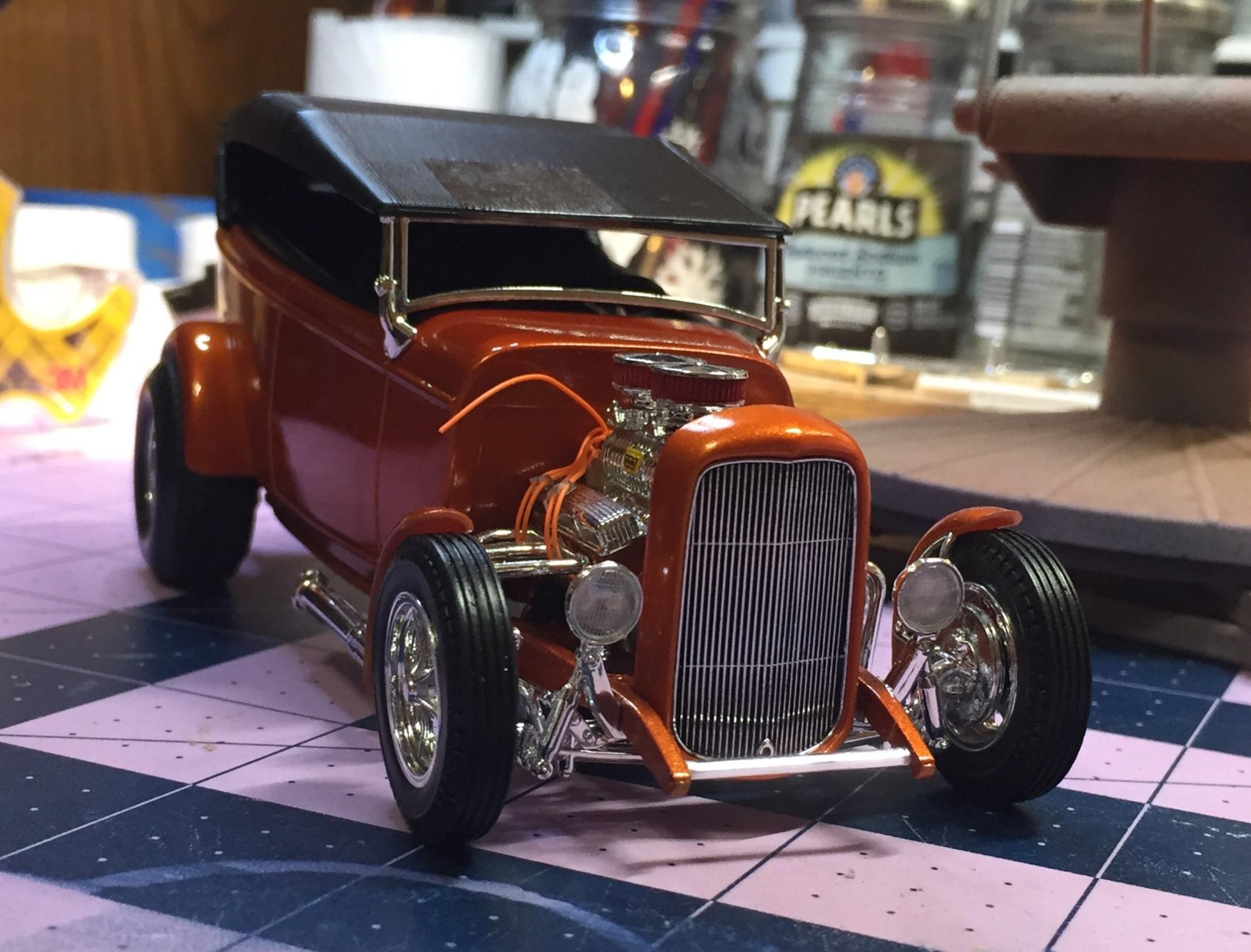

customline Posted October 18 Author Posted October 18 Got 'er painted 😛 Two orange, two clear. Done and done. No rub-out. Nuttin'! Looks like it's final assembly time. 🙃 7

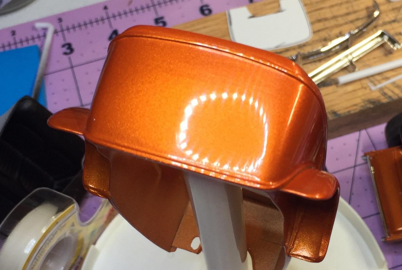

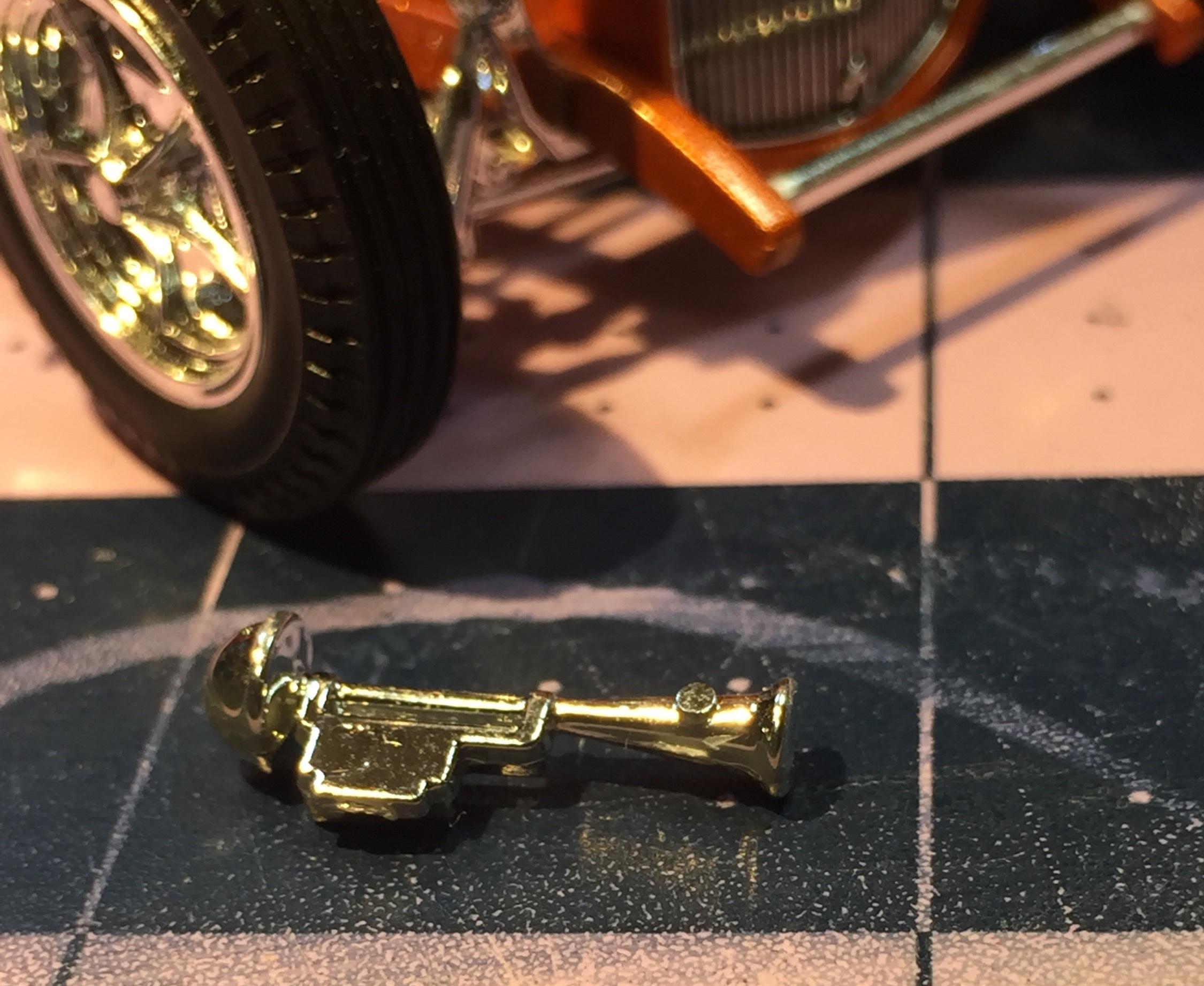

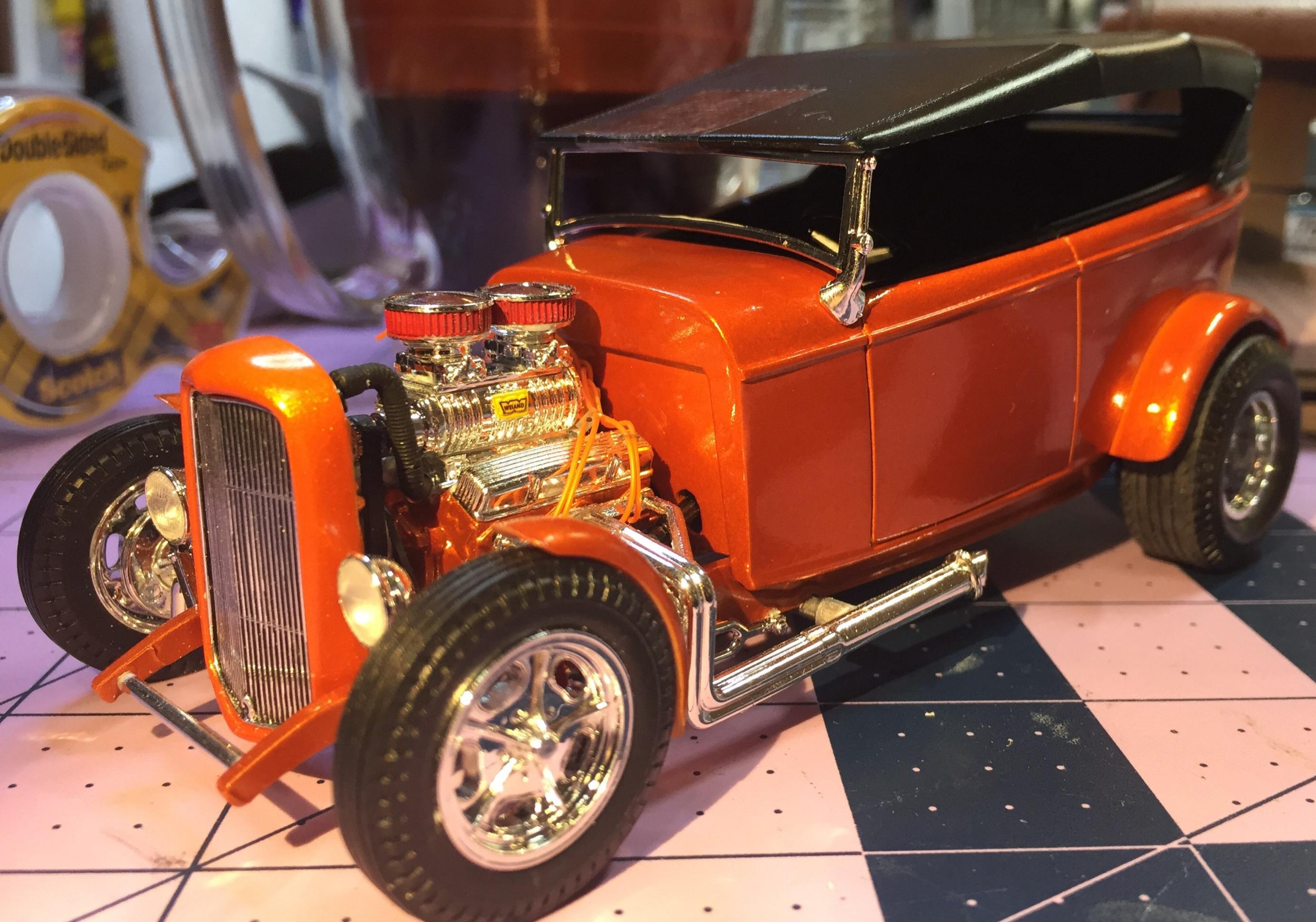

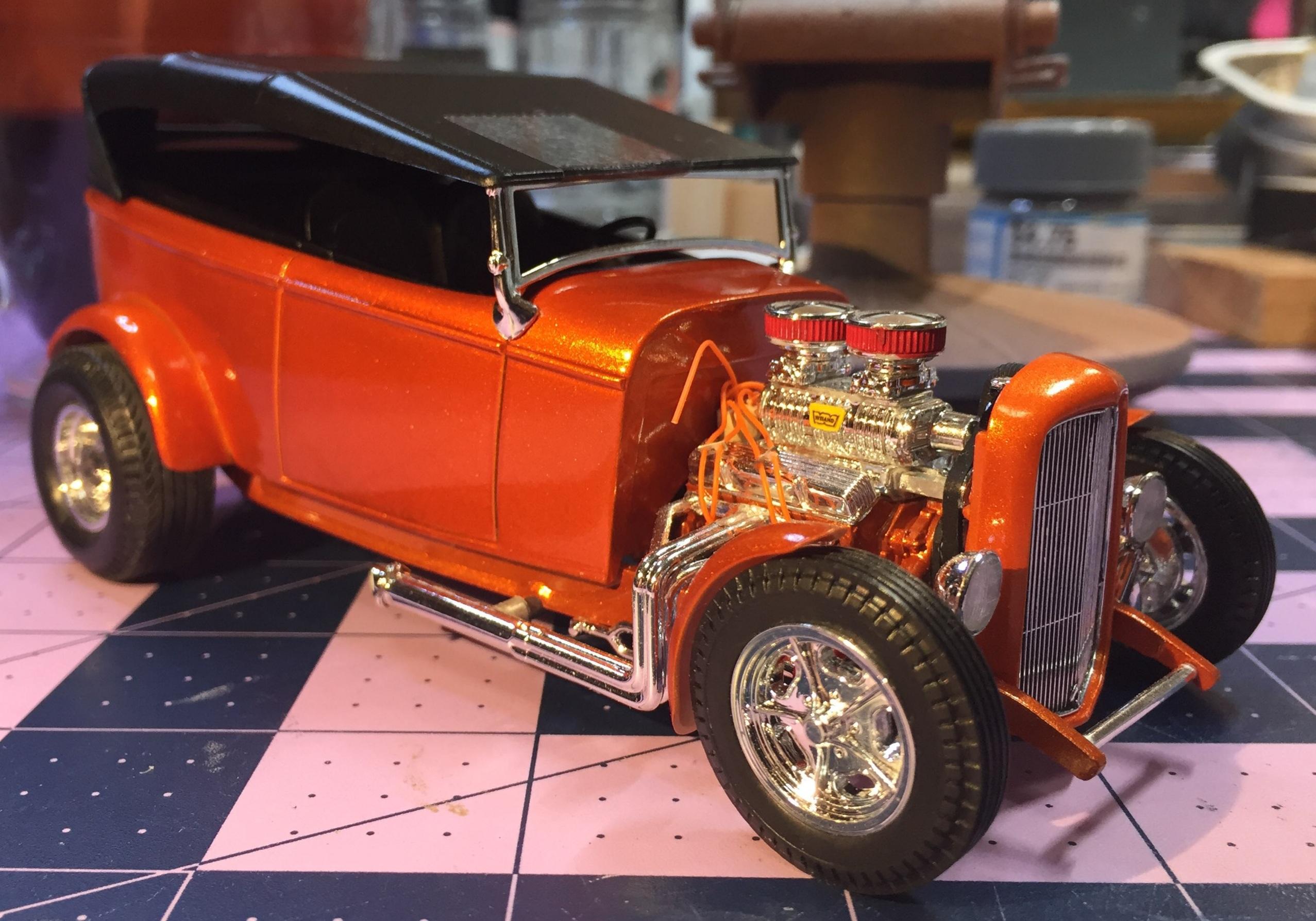

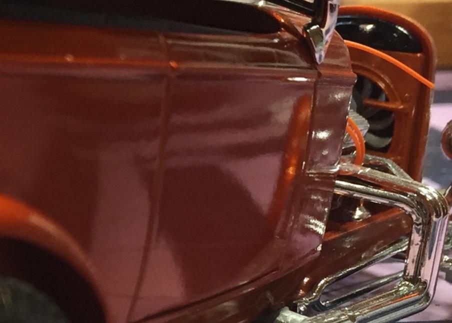

customline Posted October 20 Author Posted October 20 6 hours ago, espo said: Great looking color and like the stance. Thanks, Dave, I was after a little attitude in the rake. I've got mock-up and I need to make a decision about rubbing it out. The paint is dramatic and looks good on the table but it could be much better. I have only two light clear coats. The OP is maybe a coat thick but who knows? I may try my luck but like my sig line says.... To rub or not to rub......that is the question 🤔 Ok...whattayathink about the windshield? It's the "spare" from the Duval kit. It's not quite as low as the tub kit unit and that one looks funny from a repair (not now 😒). I will get some chrome on it and do a comparison. We shall see.... Oh... how about this? 👇🥴 Thanks for cruising by 😎 4
customline Posted October 20 Author Posted October 20 7 minutes ago, TopherMcGinnis said: Now, a Road Runner horn.... Meep meep ? 😄
FoMoCo66 Posted October 20 Posted October 20 28 minutes ago, TopherMcGinnis said: Now, a Road Runner horn.... Where's the ACME dynamite? 💣
customline Posted October 20 Author Posted October 20 3 hours ago, FoMoCo66 said: Where's the ACME dynamite? 💣 If I burn through to the primer we won't need the dynamite. Just my right foot. 😕 1

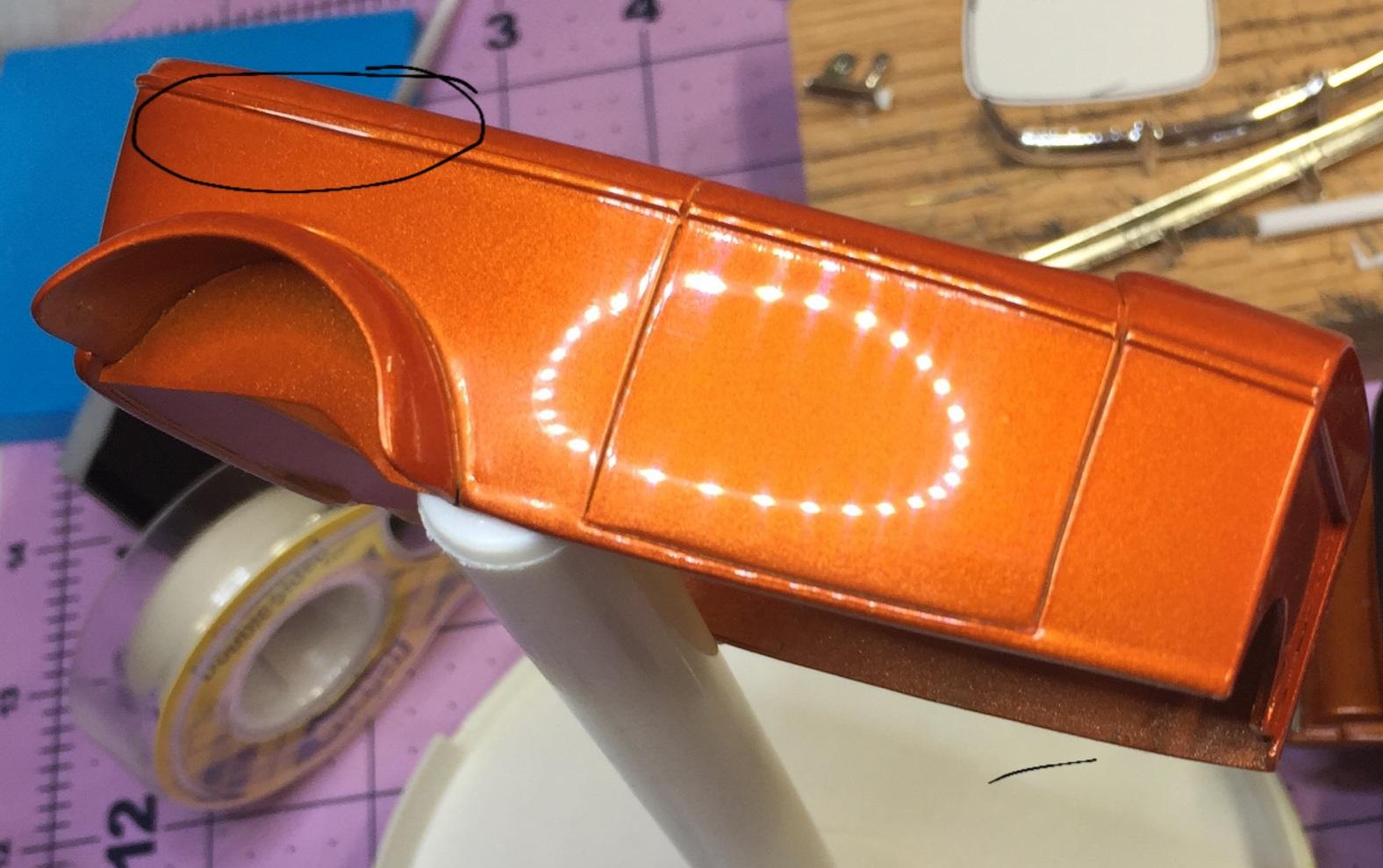

espo Posted October 20 Posted October 20 15 hours ago, customline said: Thanks, Dave, I was after a little attitude in the rake. I've got mock-up and I need to make a decision about rubbing it out. The paint is dramatic and looks good on the table but it could be much better. I have only two light clear coats. The OP is maybe a coat thick but who knows? I may try my luck but like my sig line says.... To rub or not to rub......that is the question 🤔 Ok...whattayathink about the windshield? It's the "spare" from the Duval kit. It's not quite as low as the tub kit unit and that one looks funny from a repair (not now 😒). I will get some chrome on it and do a comparison. We shall see.... Oh... how about this? 👇🥴 Thanks for cruising by 😎 Maybe try a very light color sanding starting with a 3000-grit pad and see just how high and low the finish is. Not enough to get into the color, just the clear and then again maybe another coat of clear. Could be that all you'll need is some light compound depending on how smooth the finish is after the sanding. Kind of like the windshield in the photos. A 1:1 might have a thin rubber type gasket between the bottom of the windshield and the cowl. That might be a consideration.
customline Posted October 20 Author Posted October 20 7 minutes ago, espo said: Maybe try a very light color sanding starting with a 3000-grit pad and see just how high and low the finish is. Not enough to get into the color, just the clear and then again maybe another coat of clear. Could be that all you'll need is some light compound depending on how smooth the finish is after the sanding. Kind of like the windshield in the photos. A 1:1 might have a thin rubber type gasket between the bottom of the windshield and the cowl. That might be a consideration. Yeah, Dave, that's pretty much how I will proceed. You can see in the first picture that the surface is a fairly fine OP. I'm going to try it in a bit and, hopefully, put up more pix tonight. Thanks for weighing in. 1

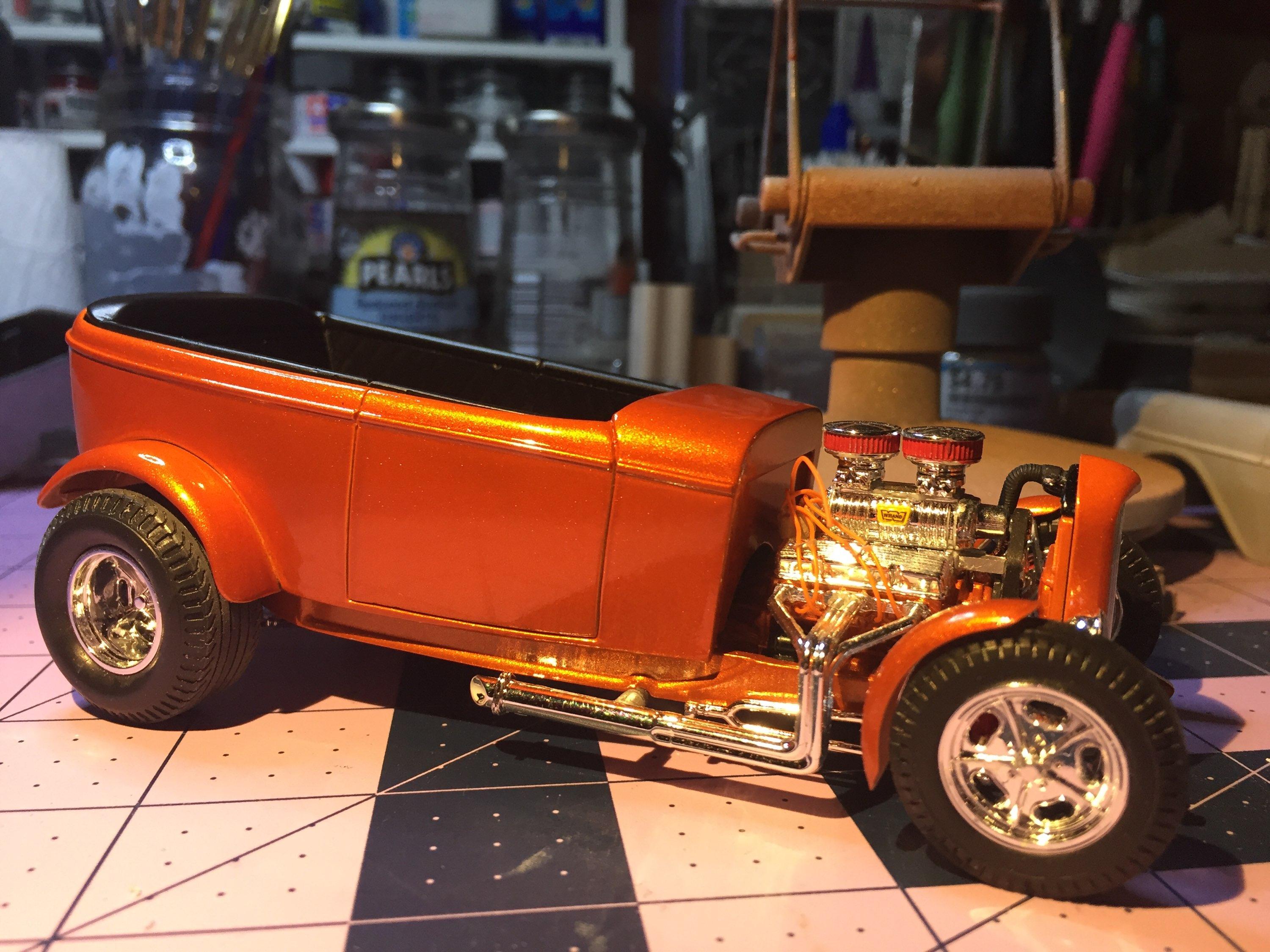

Speedpro Posted October 20 Posted October 20 The paint looks really nice. Till you took that pic from the side. No rubbing compound is going to fix that. If you feel you just have too fix it, best bet is wet sand using a micro mesh sanding cloth system with a little dish soap. Start with 3600 and sand till 12000 being carefull around sharp edges. Then give it another coat of clear. Repeat till you see the result you want. 98.5 percent of views won't see what your seeing on a table. They will look at it and say "nice paint". Great looking build.

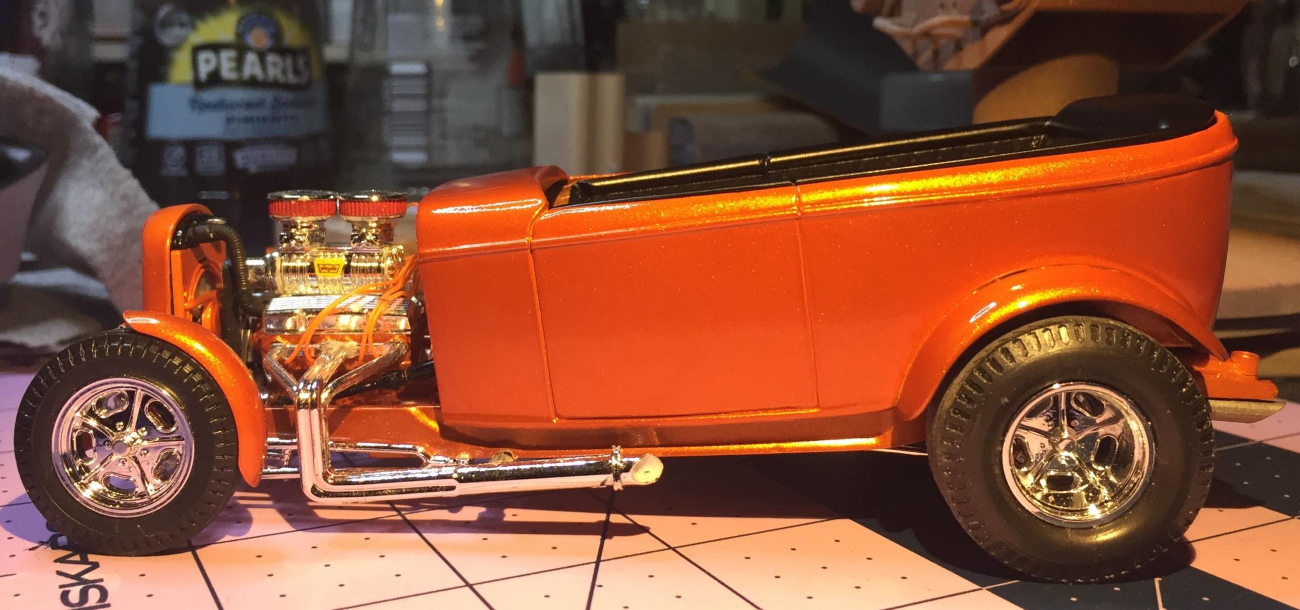

customline Posted October 21 Author Posted October 21 4 hours ago, Speedpro said: The paint looks really nice. Till you took that pic from the side. No rubbing compound is going to fix that. If you feel you just have too fix it, best bet is wet sand using a micro mesh sanding cloth system with a little dish soap. Start with 3600 and sand till 12000 being carefull around sharp edges. Then give it another coat of clear. Repeat till you see the result you want. 98.5 percent of views won't see what your seeing on a table. They will look at it and say "nice paint". Great looking build. Thanks, Paul. I got it done tonight. Took a chance with 2 light coats of clear and started with very beat-up 3200 pad segments and followed it through with Scratch-X at the end. Scuffed it in two spots. It ain't too bad. Oh well.....still some in the can. Or.....or if I just pretend the rub-throughs are reflections 😉. Nah, I circled 'em fer ya. 🤓 All shined up and no place to go. Thanks for checking in. 7

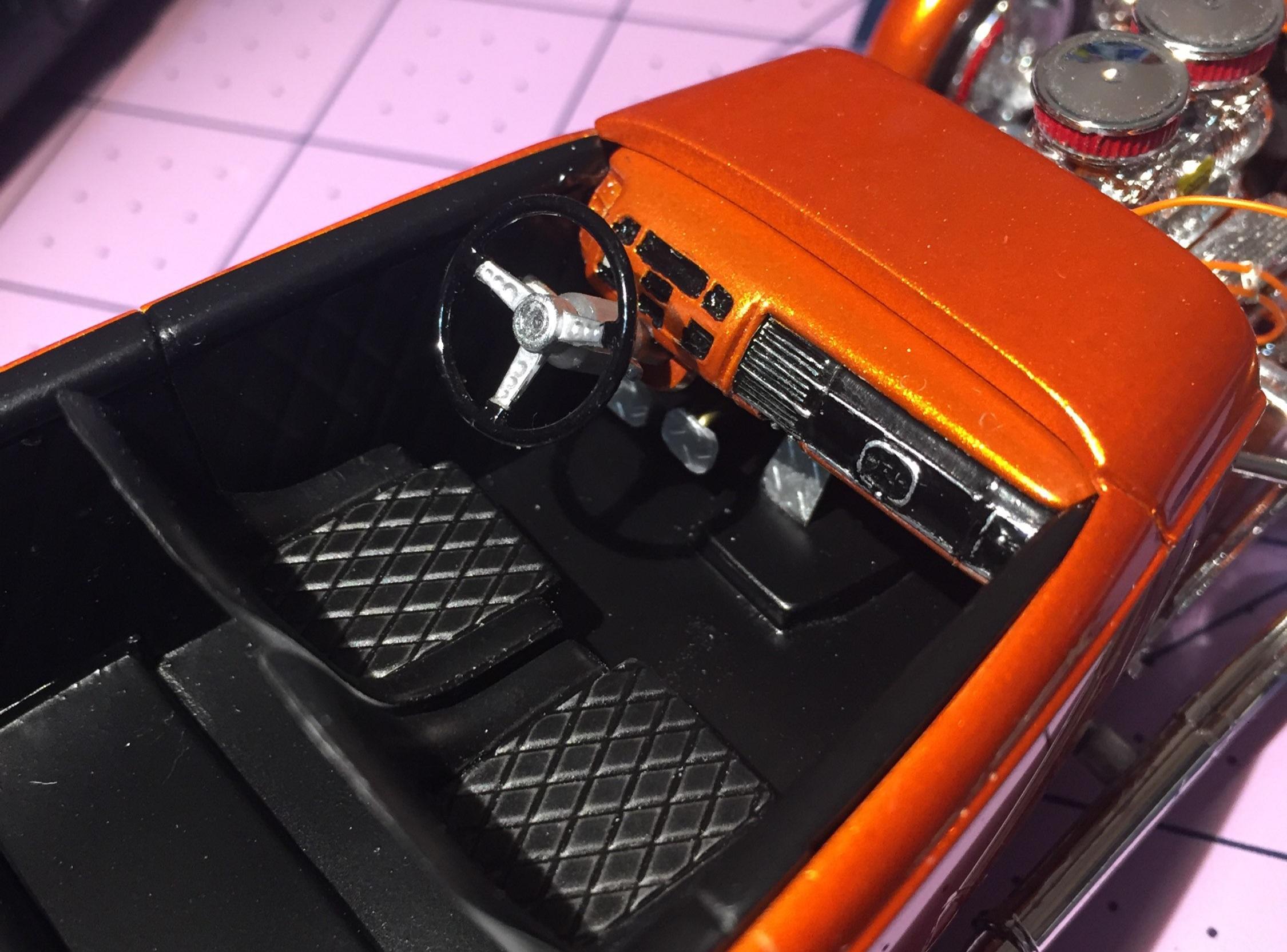

customline Posted October 21 Author Posted October 21 47 minutes ago, meechum68 said: Nice, and Grey primer, gloss white or flat white? then the Metallic Orange? The gray primer is Mr. Surfacer 1500. I was careful about spraying light coats of Tamiya white primer over the gray this time. I gave it two light coats over everything according to previous posts on page 3 ( my memory is not helping much.) Contrary to what I had said, I did not wet sand the white but waited almost a week before the orange, mostly due to weather. I let it rest a couple of days before the rub-out. No issues this time. Just a little touch-up to do now. I put the interior together. After the lid goes on you can't see much of it. It's not fancy but the dash is interesting to some degree, IMHO. Hanging pedals with aluminum diamond-plate treads - very home-built 😉. Gotta find the shifter....it's here somewhere......sure am glad the dash isn't glued.... 4

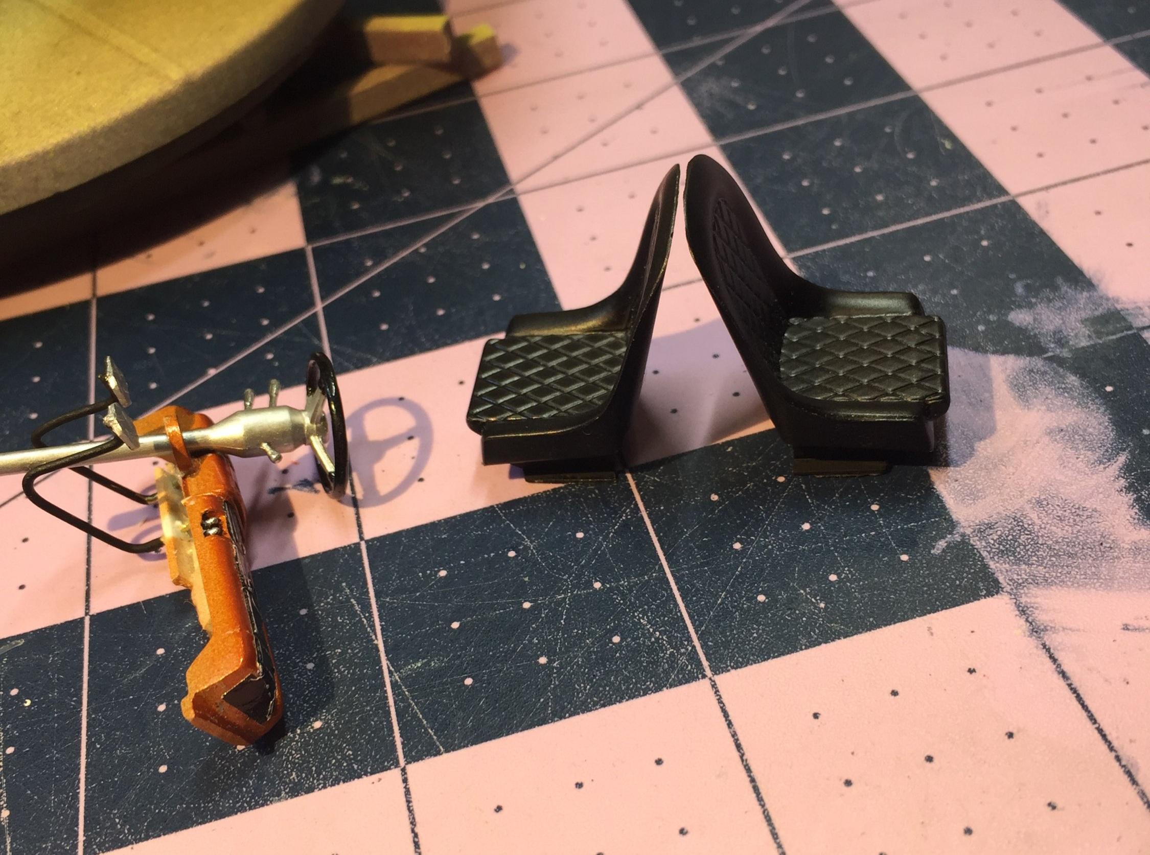

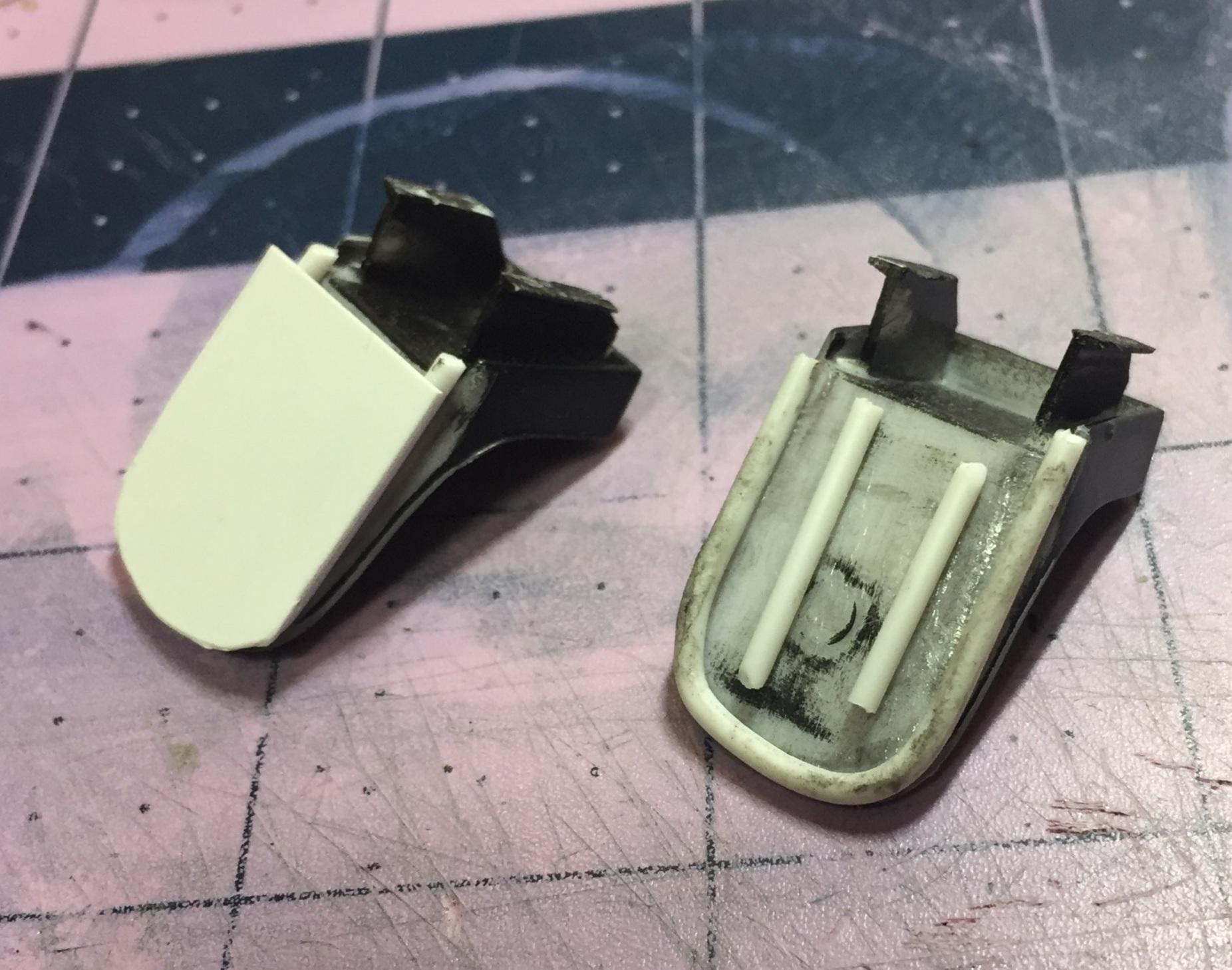

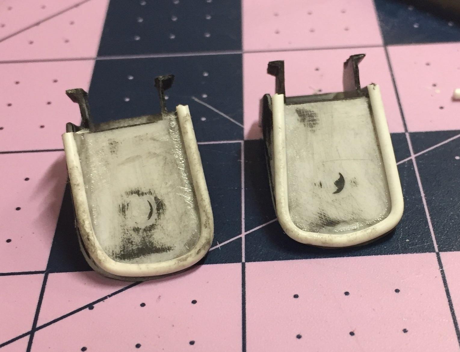

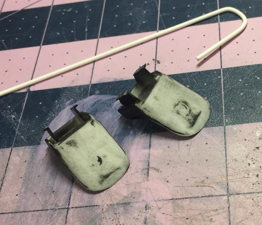

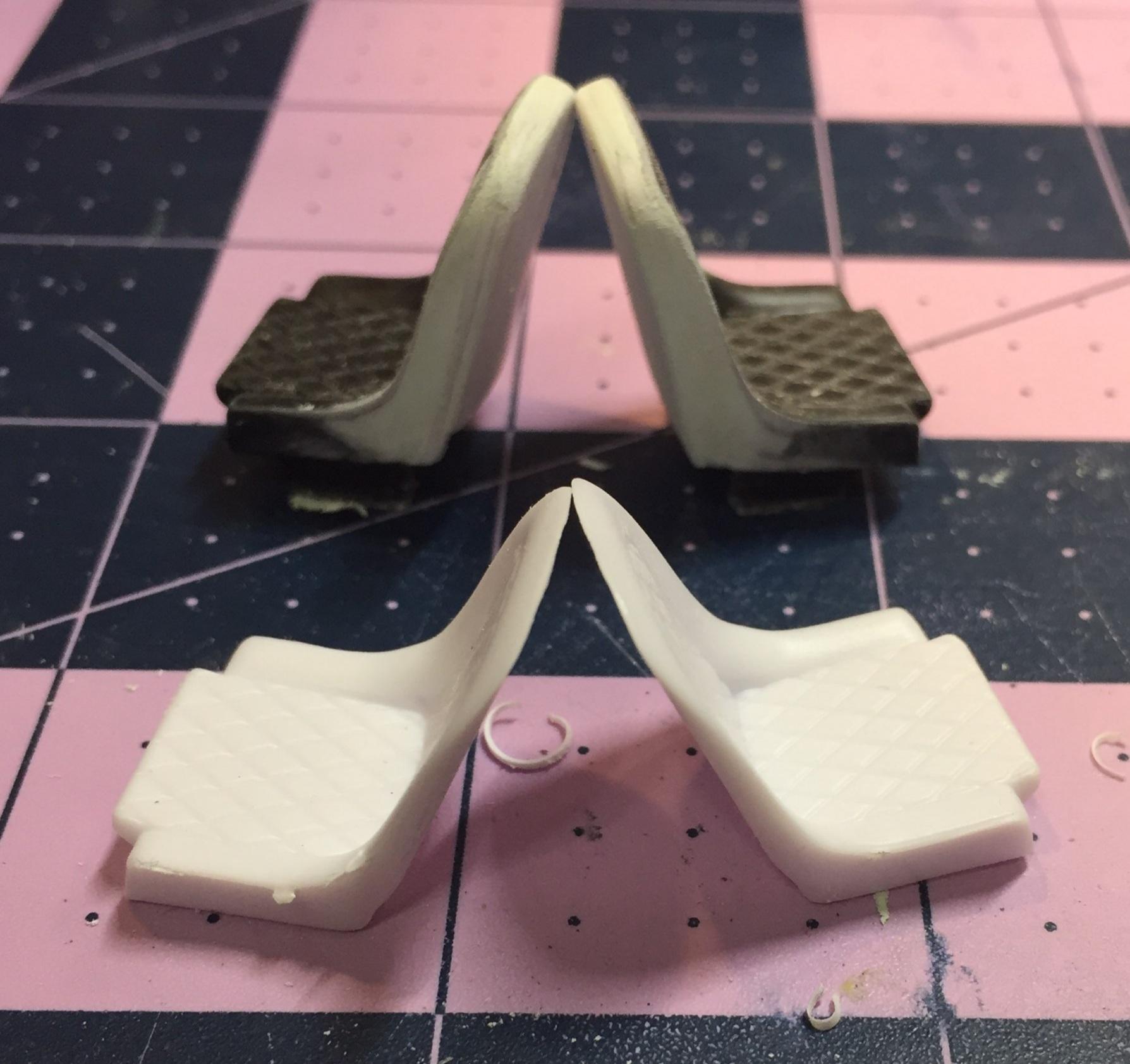

customline Posted October 23 Author Posted October 23 The seats are the ones that come in the Duval kit. You could cut yourself on the top of the backs. I wish I knew why I'm only getting to this now. I did paint them. Well it's time to fix them. I sanded the paint off the backs. I used 1/16" rod, cold bent and attached to the backs with solvent. I added the same inside to hold the curve. I covered all that with .020 sheet scrap and after that I filled the edges with Bondo. There we go...🤓 safety first! 2

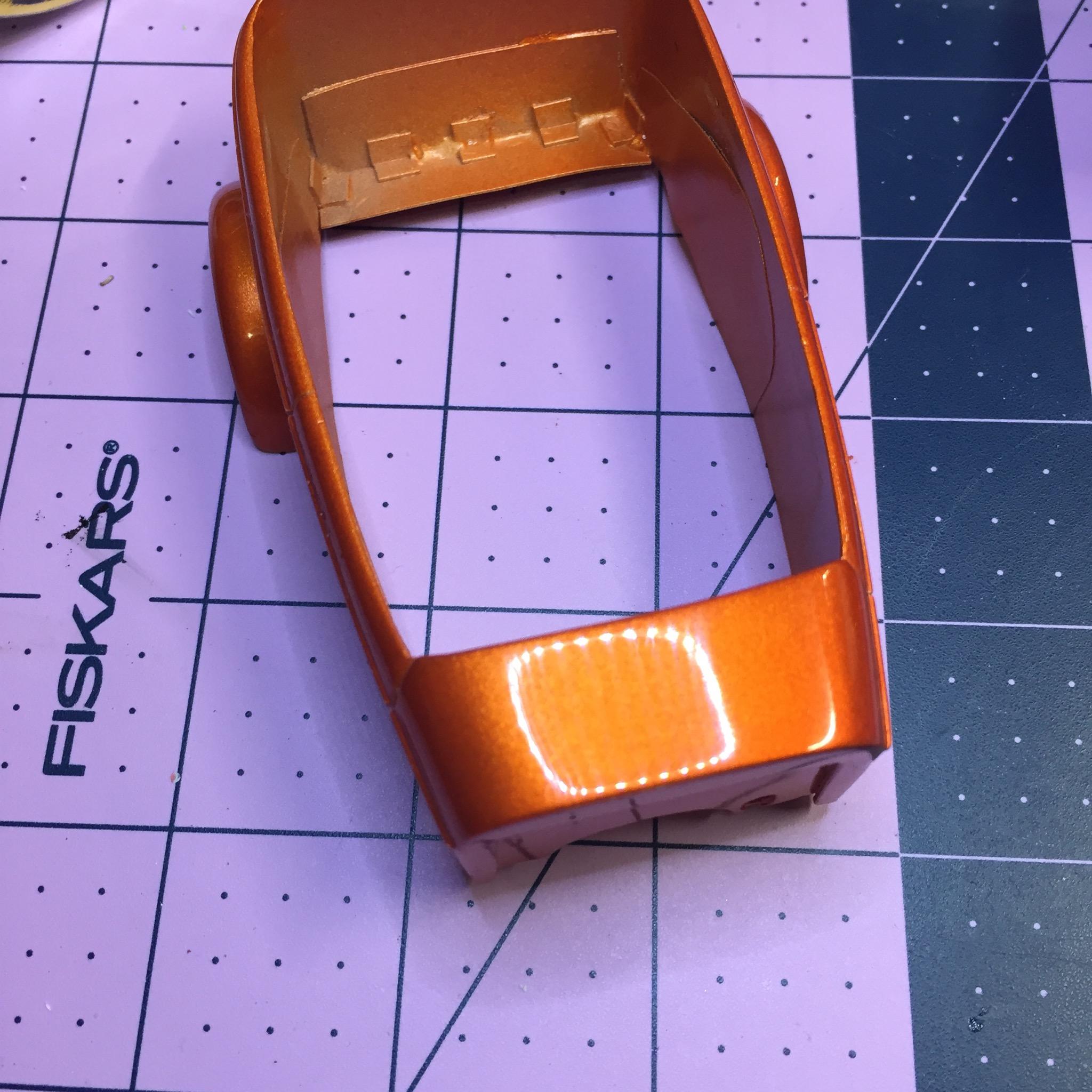

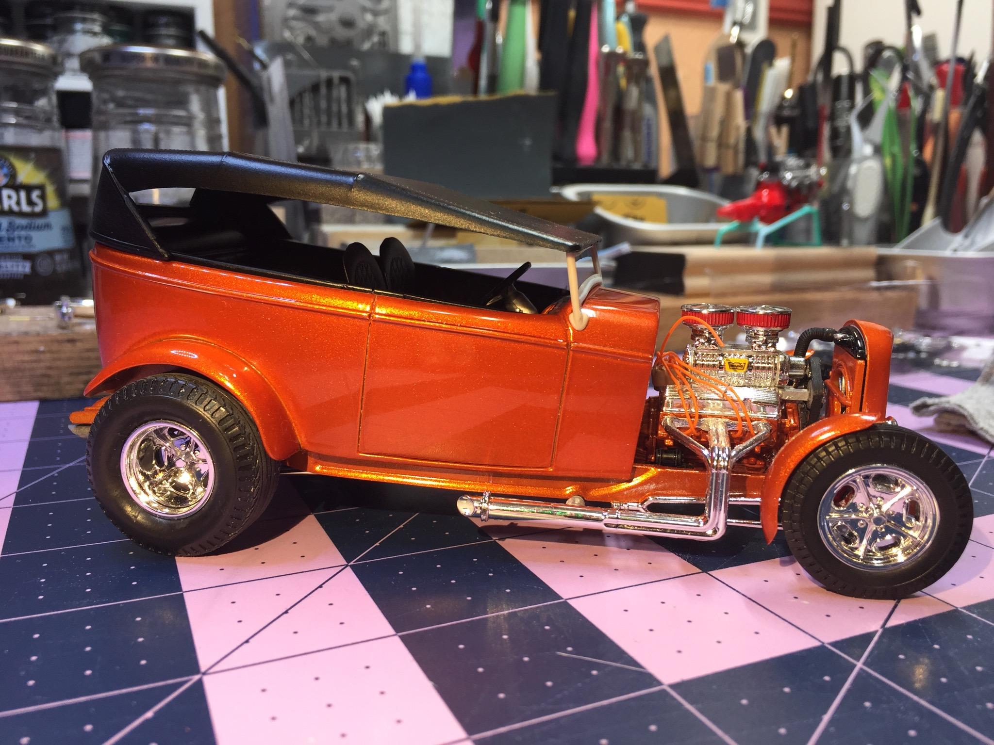

Alan Barton Posted October 23 Posted October 23 Interesting how you have used the awkward tapered proportions of the tub body ( all AMT Deuces have the same issue) by channeling the front to make the lower edge more or less parallel to the frame. I might have to try that myself! Cheers Alan
customline Posted October 23 Author Posted October 23 (edited) 9 hours ago, Alan Barton 2 said: Interesting how you have used the awkward tapered proportions of the tub body ( all AMT Deuces have the same issue) by channeling the front to make the lower edge more or less parallel to the frame. I might have to try that myself! Cheers Alan If I'm recalling correctly, Alan, it was just making a small adjustment at the firewall to frame and just eyeball engineering. I didn't plan it with anything like that in mind. Edit: I checked back and there was clearance issues with the interior tub floor. It was modified to accommodate the transmission and that allowed the the body to sit down on the frame also. The final adjustment was at the firewall. 2nd edit: ....I think. 🤔 Edited October 23 by customline
customline Posted October 23 Author Posted October 23 Seats turned out okay. I used black embossing powder for the indoor/outdoor carpeting, poured over Tamiya flat black. It's not cheap but it behaves much better than flock and it may, in fact, be a bit cheaper. There's not a whole lot of colors that are useful to us but you just treat it like flock and mix colors. Anyway, the interior tub is done so there's nothing stopping me from wrapping it up. Except the game. yeah, I know....you want me to drill out the steering wheel, right? Mmmmmm nah. I have a better idea.....if I could just remember....🙃.....🤣...................🤔 Thank you for your time! 🙃 3

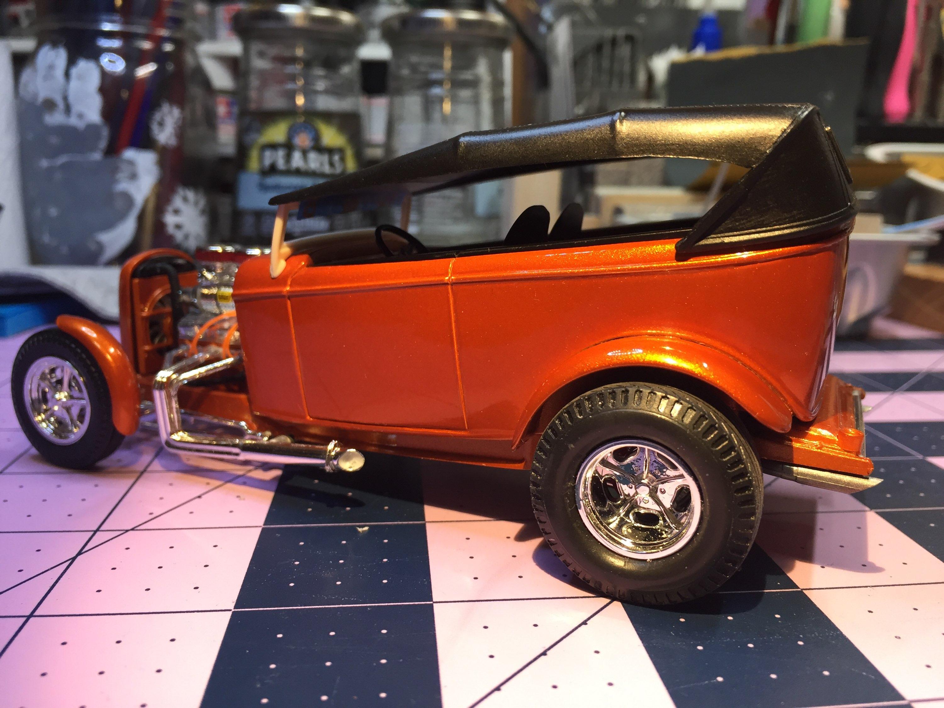

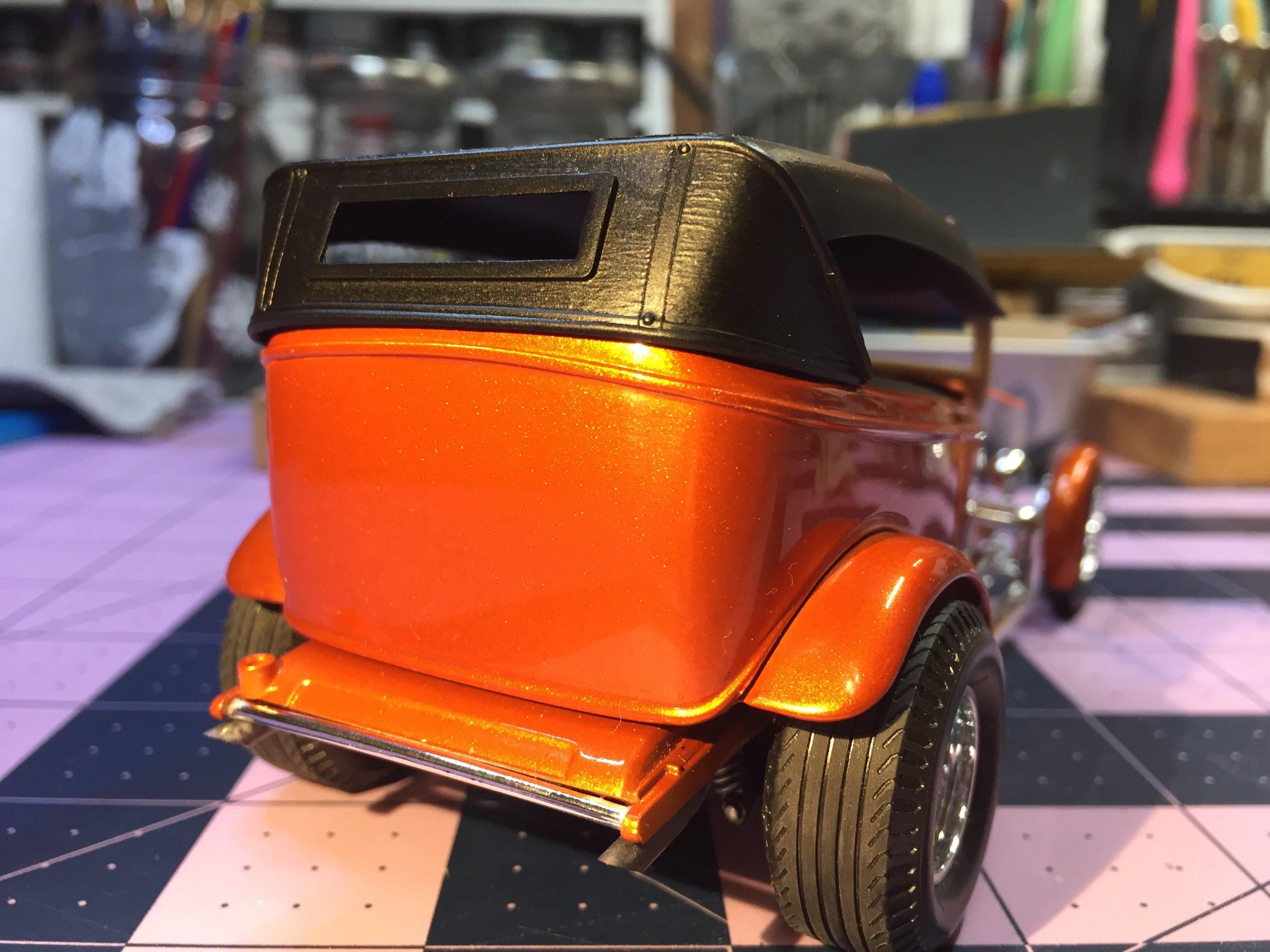

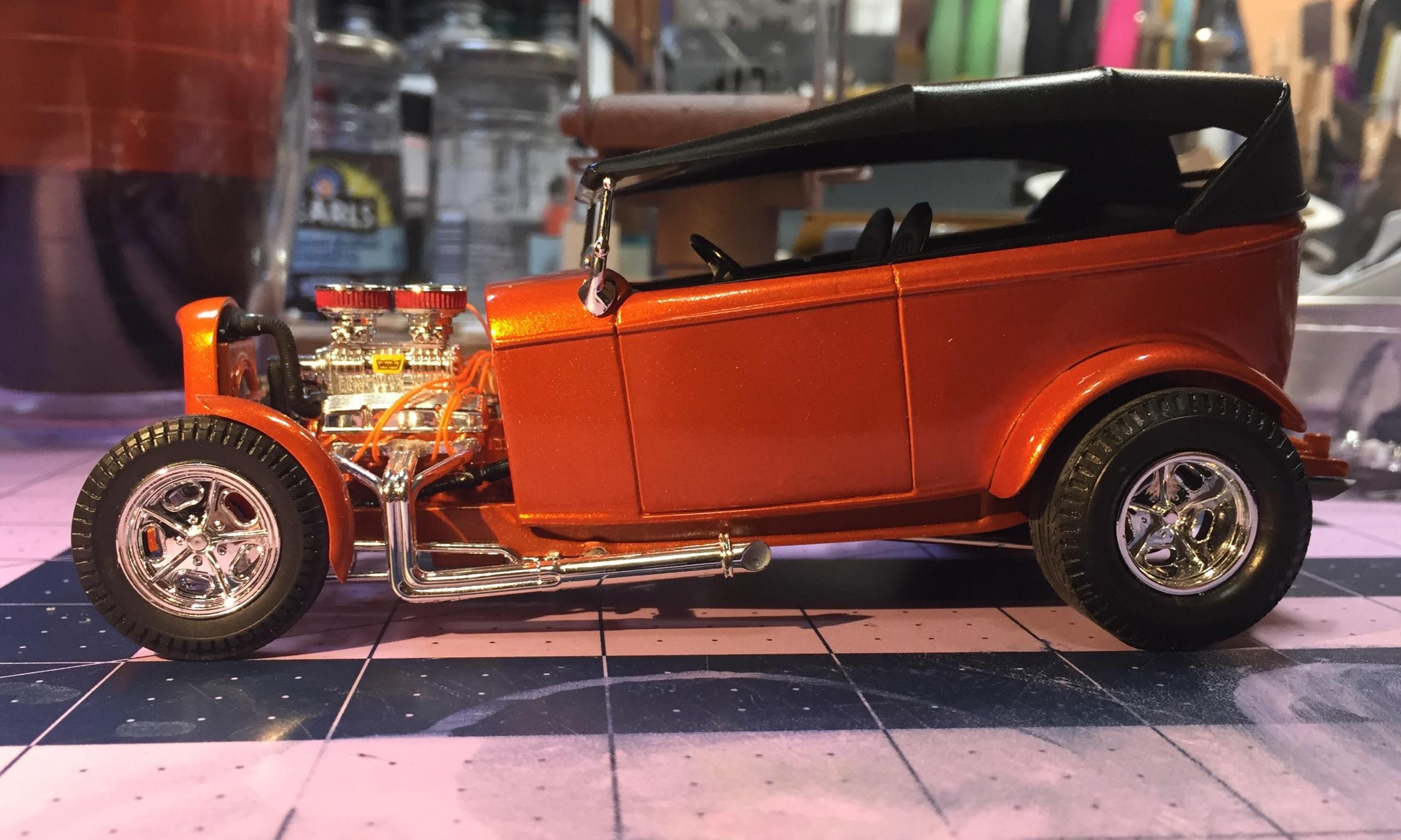

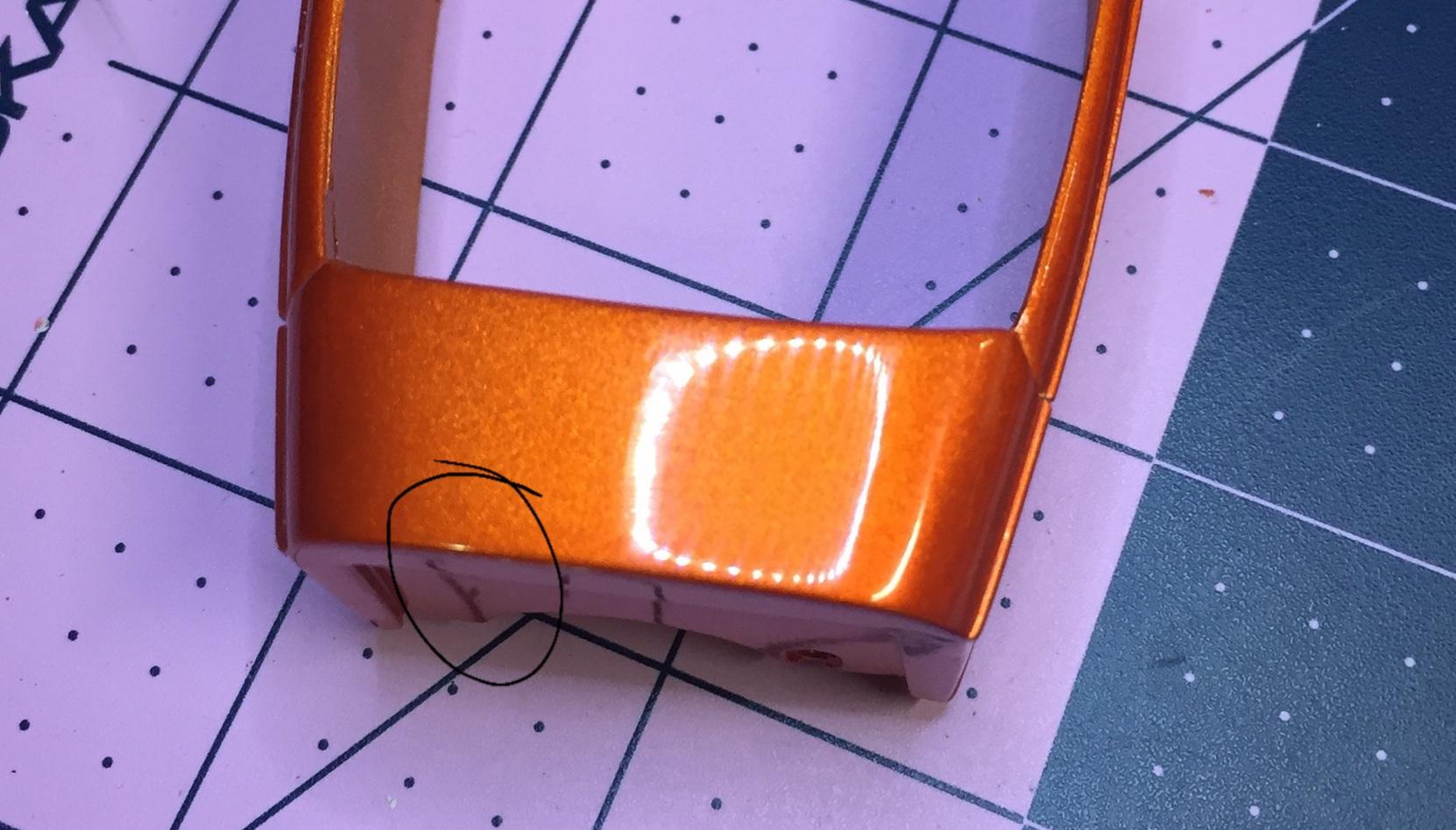

customline Posted October 24 Author Posted October 24 I decided on the leftover windshield from the Duval kit. I don't like the oversize mounts but we can pretend it's a custom part and it's supposed to be that way. The tub kit part was not substantial enough, in my mind, to last in the upright position very long. 😕 tail lights are there now as well as the plate frame from the Monogram deuce kit. My eyes tell me it's fairly well centered. You may get a different result with yours. The front left door line must have had a very slight rise along the line...From now on, I am going to sand panel lines a bit below flush so this doesn't happen. I may try to buff it up but with the clear gone, it likely won't help much. The interior tub is now epoxyed in. We're down to stuff like the coil and radiator support rods. Thanks for checking in. WDYT a out the foiled backlight frame? It seems way out of scale but it's a custom item so.....I need to detail this roof more.... In retrospect, dumping the front like I did was probably not a good idea. The driver and passengers will have a difficult time staying seated. 😟 If I were to do this build again, I would do the same in front but get the back down and just move the fenders up and channel it full frame depth for a nice ankle burner look. The rake is kinda cool but it's not practical for street use. It is what it is 🥴. 3
