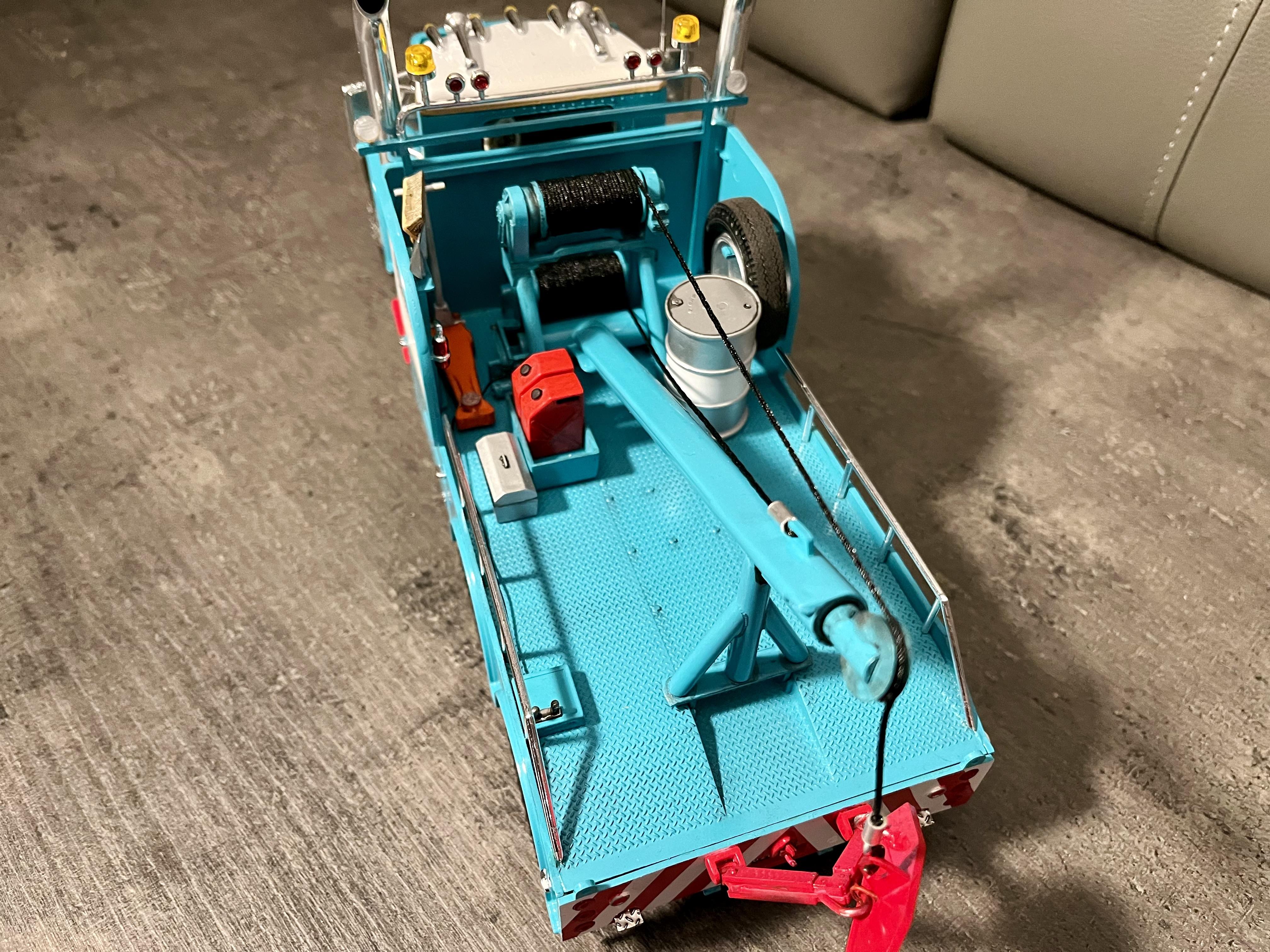

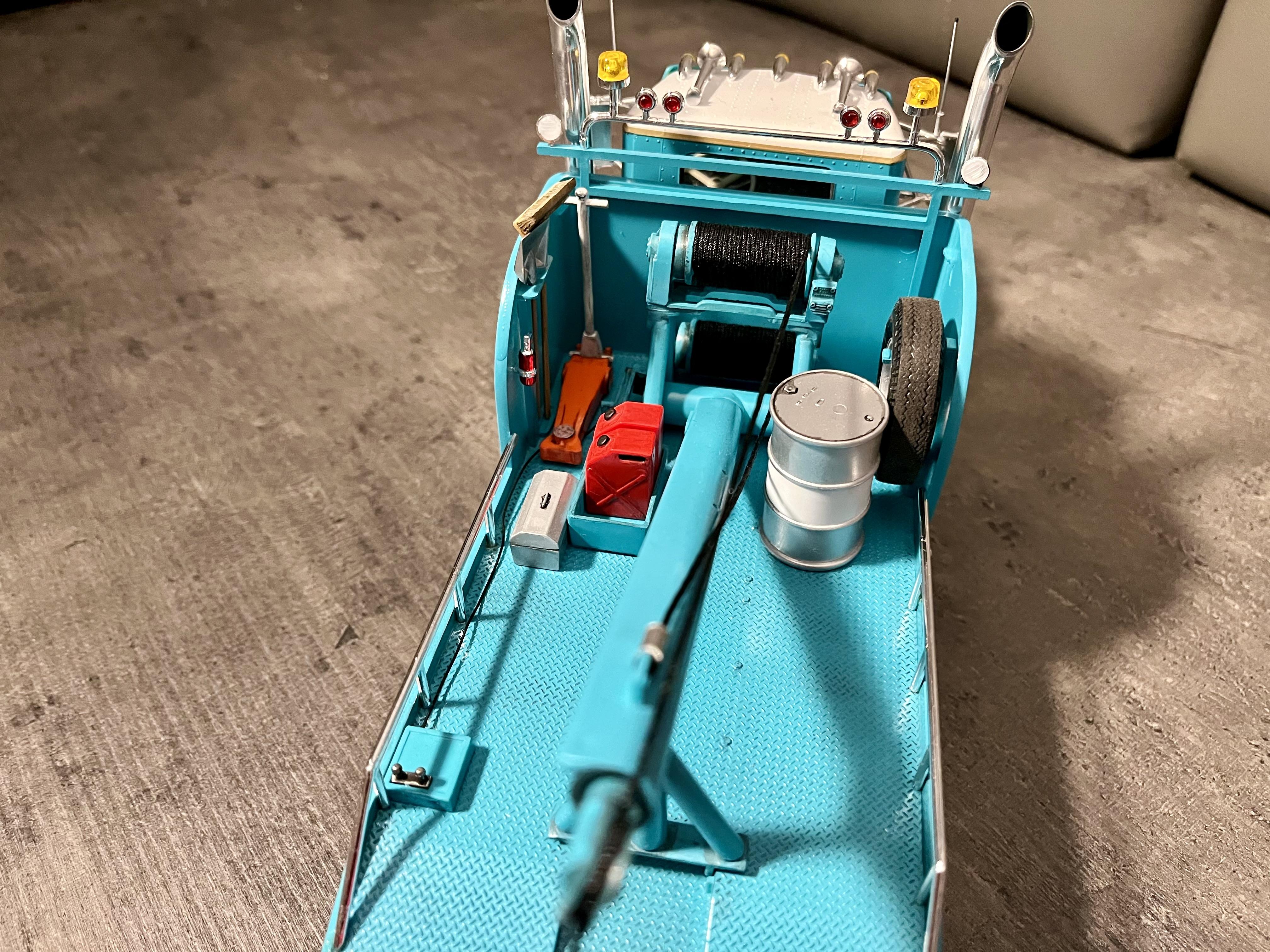

Brutalform Posted September 2 Posted September 2 I purchased some Nylon Cord for Beading at Michael’s. I think it looks ok on my build. 3
