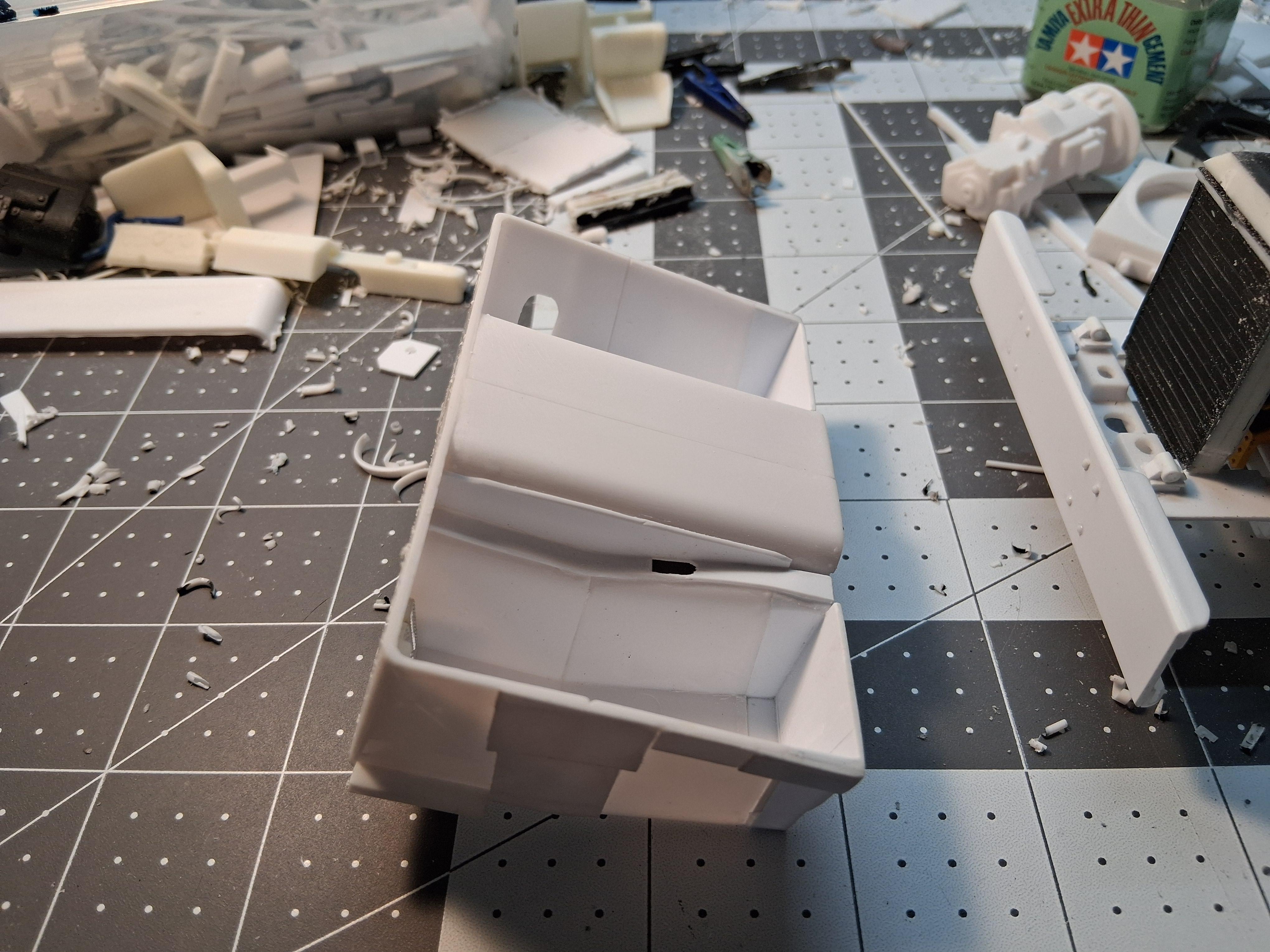

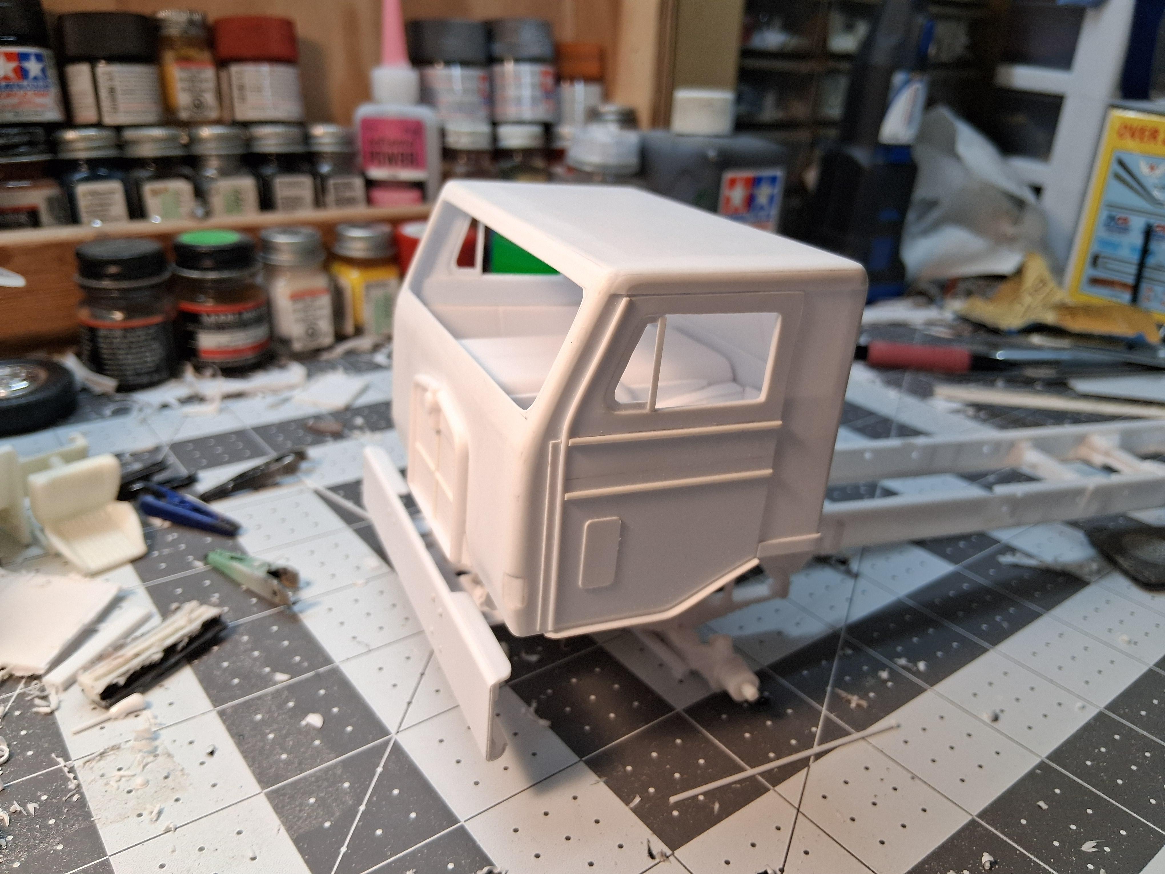

Rbray47 Posted September 6 Posted September 6 (edited) I got a pretty good deal on the new Amt Ford Garwood kit. After looking over the parts, I decided to do something different. I haven't seen a kit or resin body of a Kenworth L700 Hustler, and it looked fairly easy to scratchbuild. It's mostly square. I found some rough cab size estimates from a brochure scan, converted them into 1/25 scale, and drew them the correct size onto copy paper. Then I cut the pieces out and traced them onto styrene sheet. The cab is layered in places because of the rounded corners, and there's some bracing that the 1:1 probably doesn't have, but I think it'll do. After a lot of super glue and filing, along with a modified Amt Kenworth W series grill, it started to look like a truck. The chassis is from the Alaskan Hauler. I used a few parts from a K123 kit. The interior tub is a mixture of 2 White Freightliner tub extensions and sleeper parts. Not everything is accurate, but at least they work well together. Edited September 6 by Rbray47 11

Rbray47 Posted September 7 Author Posted September 7 Thanks everyone. Windshield gasket, cab steps, and fenders attached. It's almost ready for some primer. Frame will have to get chopped quite a bit. Also, I bought a set of 3d print 2 hole Budds, and ordered a 5 hole set. Either of those would be accurate and appropriate, as this truck represents a 74-76 era truck. 10

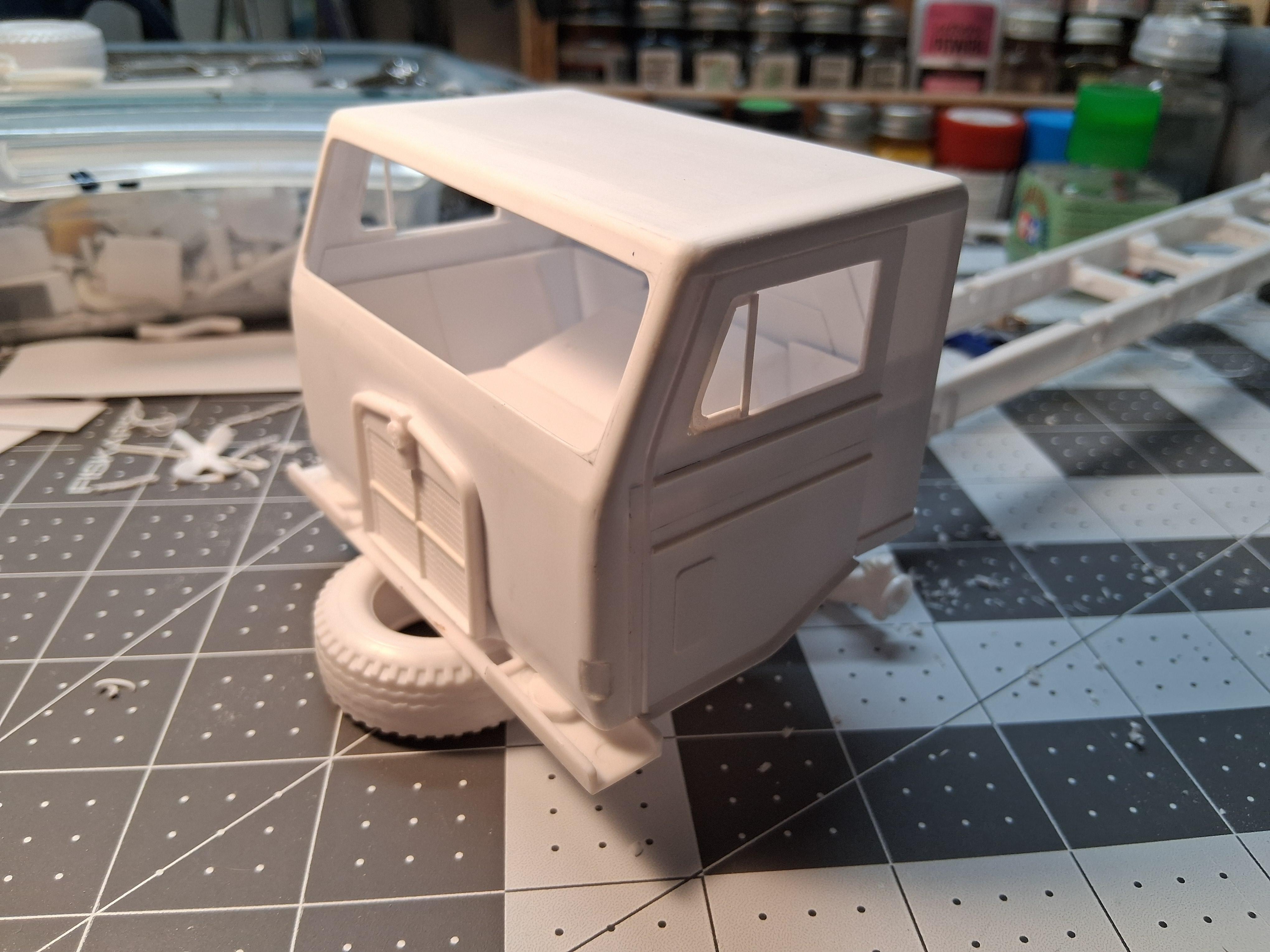

Rbray47 Posted September 7 Author Posted September 7 Busy morning. I was wet sanding the cab, hoping to get a little primer on today. But, I realized that even though I made the outside of the windshield gasket, there was nothing behind it to hold the glass in. I cut some .010 sheet, glued it in from behind, then cut the center out. It's a little deep, but that's ok, because I don't know what I'll be using for glass yet. I can always add another layer later on. Also did some more fitting with the interior. The seats, pedals, and dash are from a K123. The seats and their frames had to be filed on the sides to fit. The dash had to be cut in a few places and pieced back together. 8

Rbray47 Posted September 9 Author Posted September 9 Finally got the cab ready for paint, I think. The frame is shortened and the packer body is started. I left enough room to mount a single exhaust stack and air cleaner. I modified some Freightliner springs and a parts box axle into a single drive rear. 6

BK9300 Posted September 10 Posted September 10 Very precise work, Randy, and the cab looks amazing in primer! 1

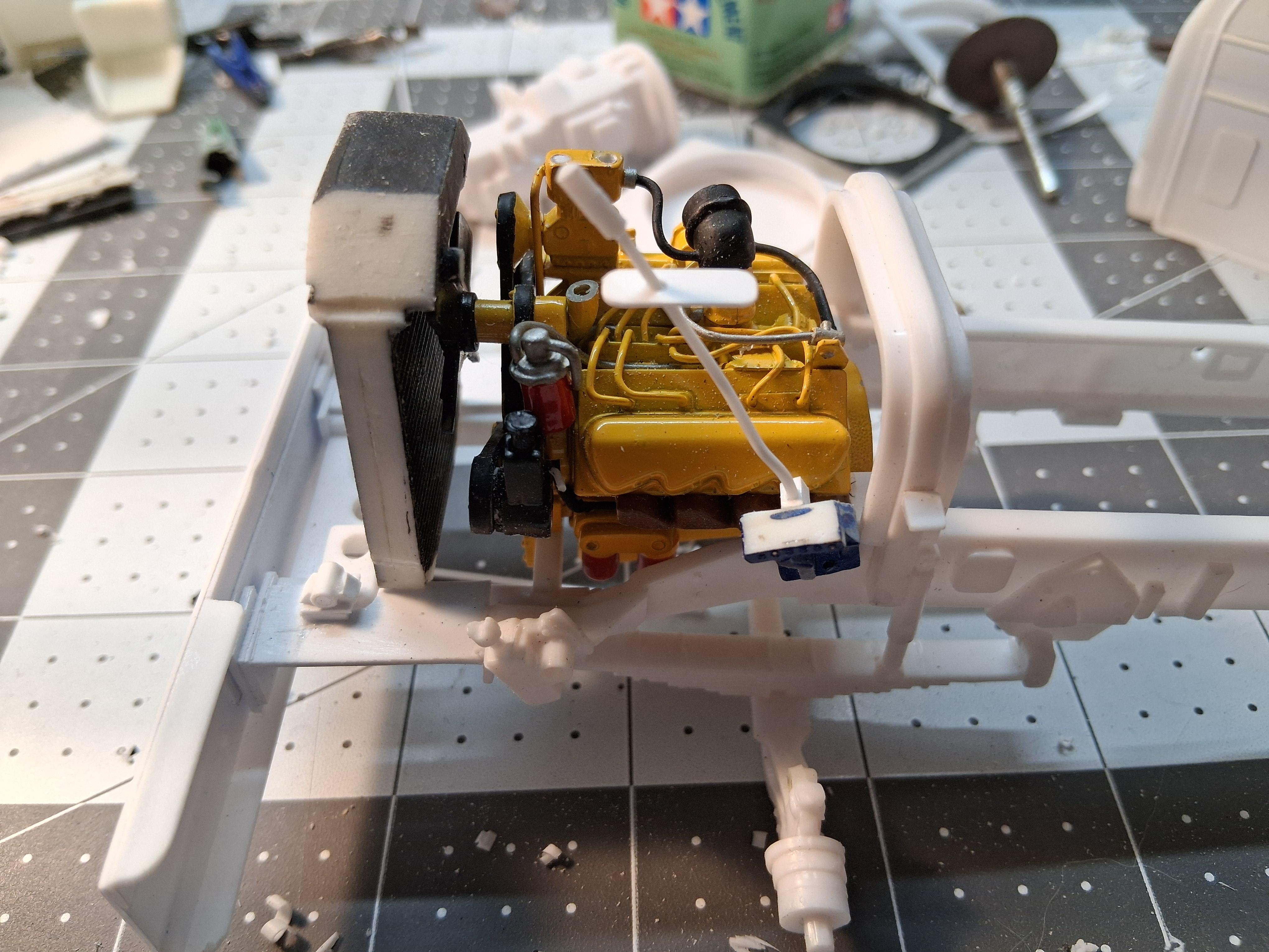

Rbray47 Posted September 12 Author Posted September 12 The wheels are mounted, along with exhaust. I used Vallejo washes and Tamiya weathering powders. I purchased these 3d print wheels on ebay. There were no "inner" rims. All 8 drive wheels had lug nut detail molded in. At first I was a little disappointed but then I realized that's actually a feature. I only used them on the "outer" wheels and used a couple unchromed 10 holes on the inside. The brake drums and the mounted tires hide what they are. Now I have more for other builds. Not sure these trucks were offered with a Cat 1160, but it's all I had that would fit. I did take off the Allison automatic and attach a 5 speed. Speaking of shifting, I may redo the shifter. Its a bent piece of .030 styrene rod. It wont stay in shape well and interferes with the cab closing. Hopefully metal wire will work out better. 7
