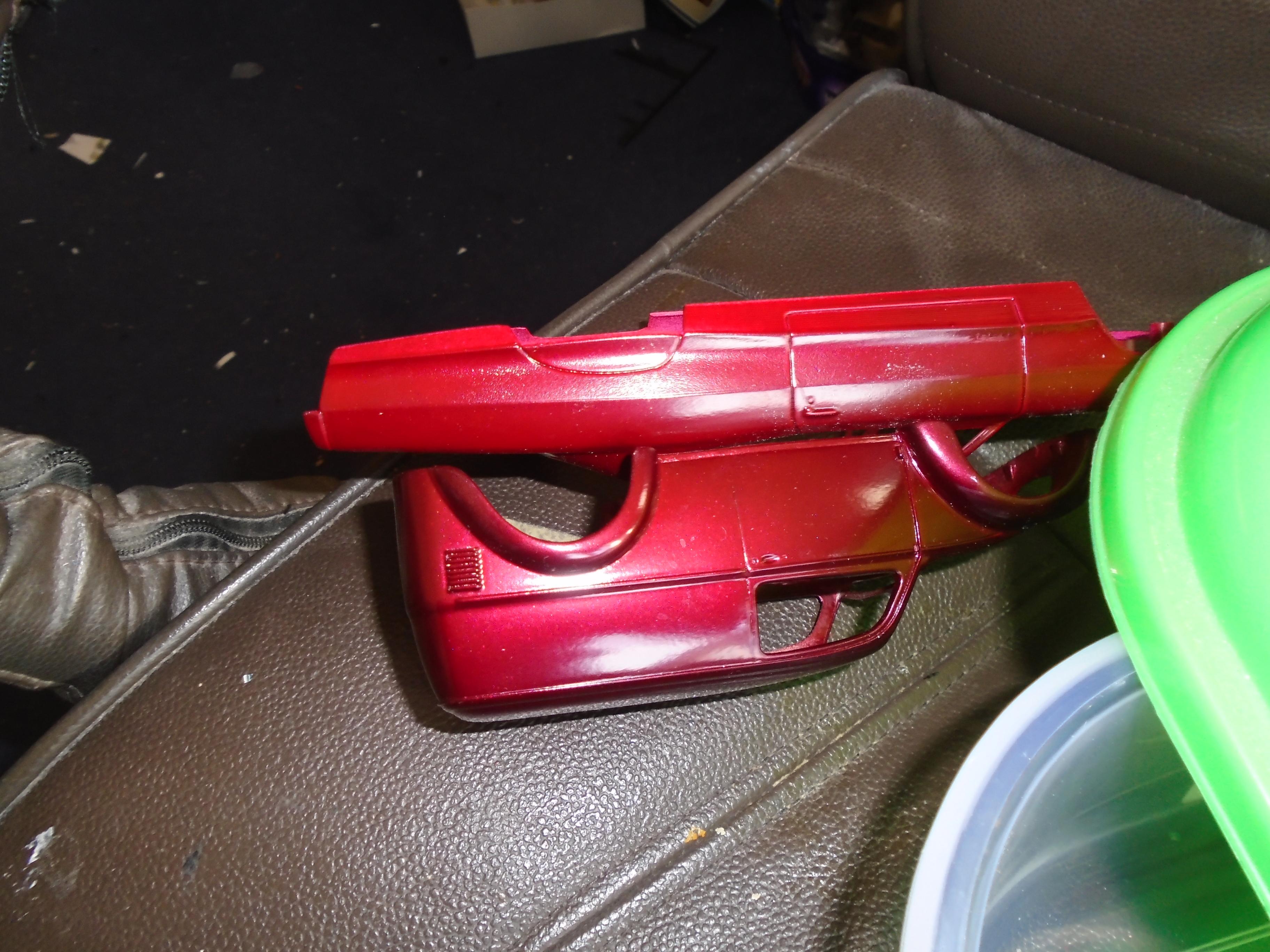

stitchdup Posted yesterday at 09:16 AM Posted yesterday at 09:16 AM (edited) the base coat will change the colour. these are both hok brandywine pearl but the bonneville is over flourescent pink, while the bug is over a bright metallic gold. the bug has a much deeper look to it. these are both 3 coats of the pearl and 2 of duplicolour clear Edited yesterday at 09:17 AM by stitchdup forgot pic
