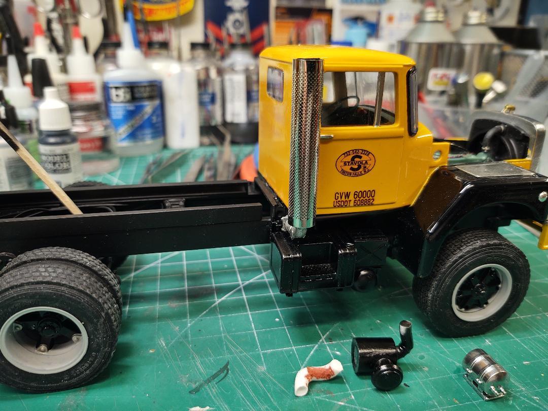

Scott Eriksen Posted November 8 Author Posted November 8 ..........dump body attached to pivots,,might do something different with the mast cylinder,,,I have some Amazon Chinesium telescopic back scratchers I've been thinking about ,cutting the stainless wont be fun though ,,,attached the exhaust ,just have to do the outlet pipe,working on the air cleaner and piping,,,then I'll do the lights and mirrors 4

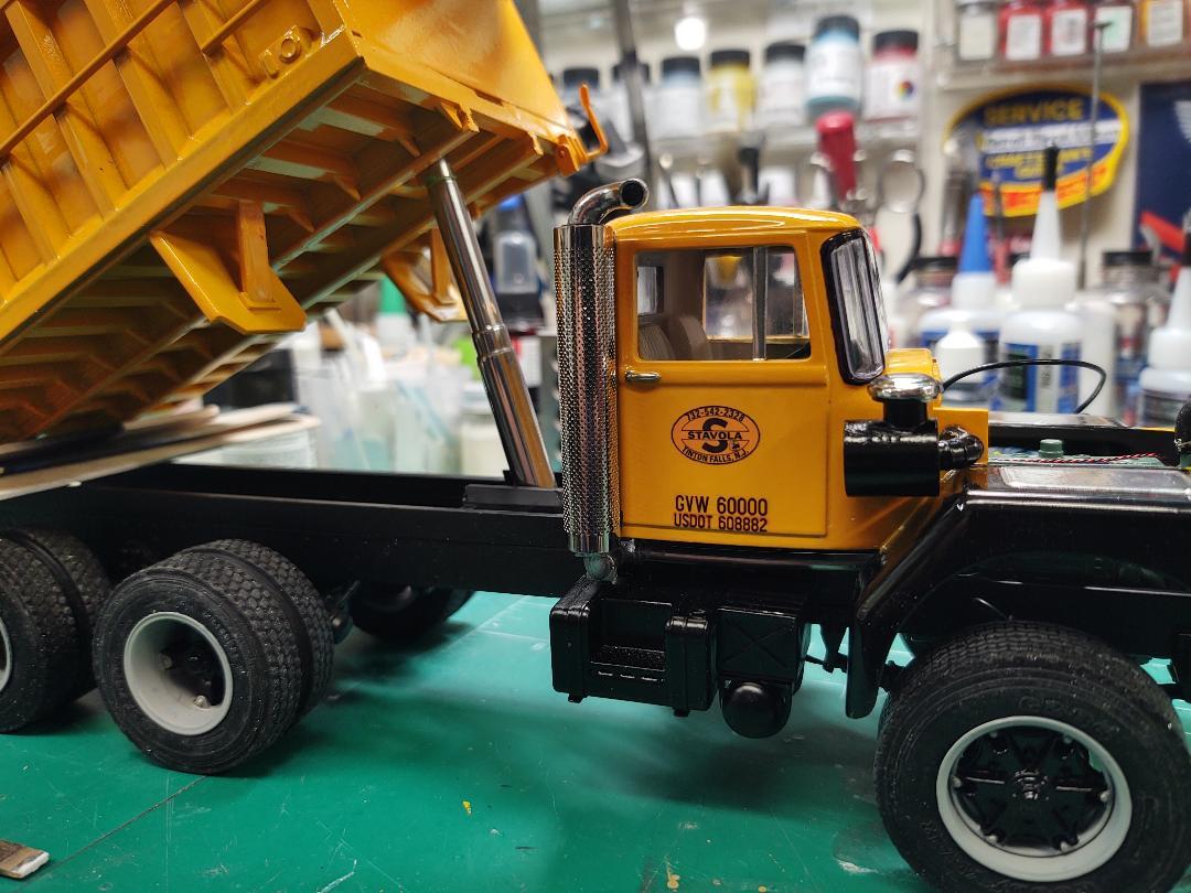

Scott Eriksen Posted November 9 Author Posted November 9 .............I used the back scratcher for the hyd cylinder,,,lol! Got the air cleaner and tubing in,I'll make inner splash aprons on the fenders out of mudflap rubber 5
BK9300 Posted November 9 Posted November 9 Need to see a link to those back scratchers - great 'sequential' lift cylinder! That's got to work on all kinds of dump cylinder situations. 2
Scott Eriksen Posted November 10 Author Posted November 10 1 hour ago, BK9300 said: Need to see a link to those back scratchers - great 'sequential' lift cylinder! That's got to work on all kinds of dump cylinder situations. Amazon.com: XKOS 4 Pack Different Back Scratcher Portable Telescoping with Rubber Handles, Extendable Metal Back Massager Tool with Beautiful Box, Stocking Stuffers for Men Women Adults (Black) : Health & Household Brian,my mini chop saw was able to cut it 1 1
Warren D Posted November 10 Posted November 10 20 hours ago, Scott Eriksen said: .............I used the back scratcher for the hyd cylinder,,,lol! Got the air cleaner and tubing in,I'll make inner splash aprons on the fenders out of mudflap rubber Great idea! When you cut them off, do you loose the flare on the inner ones? Looks like they might come apart if you aren't careful? 3
Scott Eriksen Posted November 10 Author Posted November 10 16 minutes ago, Warren D said: Great idea! When you cut them off, do you loose the flare on the inner ones? Looks like they might come apart if you aren't careful? yeah,,what I did was wrap some thin masking tape on each barrel ,,which gave them a bit of resistance, the truck/dump body would never be displayed at an angle which would allow the sections to pull out anyway,,,I just tried it as an alternative to the kits wobbly plastic cylinder,,looks better IMHO 1
Warren D Posted November 10 Posted November 10 (edited) 1 hour ago, Scott Eriksen said: yeah,,what I did was wrap some thin masking tape on each barrel ,,which gave them a bit of resistance, the truck/dump body would never be displayed at an angle which would allow the sections to pull out anyway,,,I just tried it as an alternative to the kits wobbly plastic cylinder,,looks better IMHO I like the idea. I've had a build that requires a pair of cylinders outboard of the frame. The build stalled as I'm trying to figure out how to make it work as the cylinders sit almost vertically and they don't have any recesses in the body. Thus a very short distance form the bottom of the cylinder support to the bottom of the dump body but they need to extend quite a ways to get the bed to dump. Lots of segments! Edited November 10 by Warren D 2

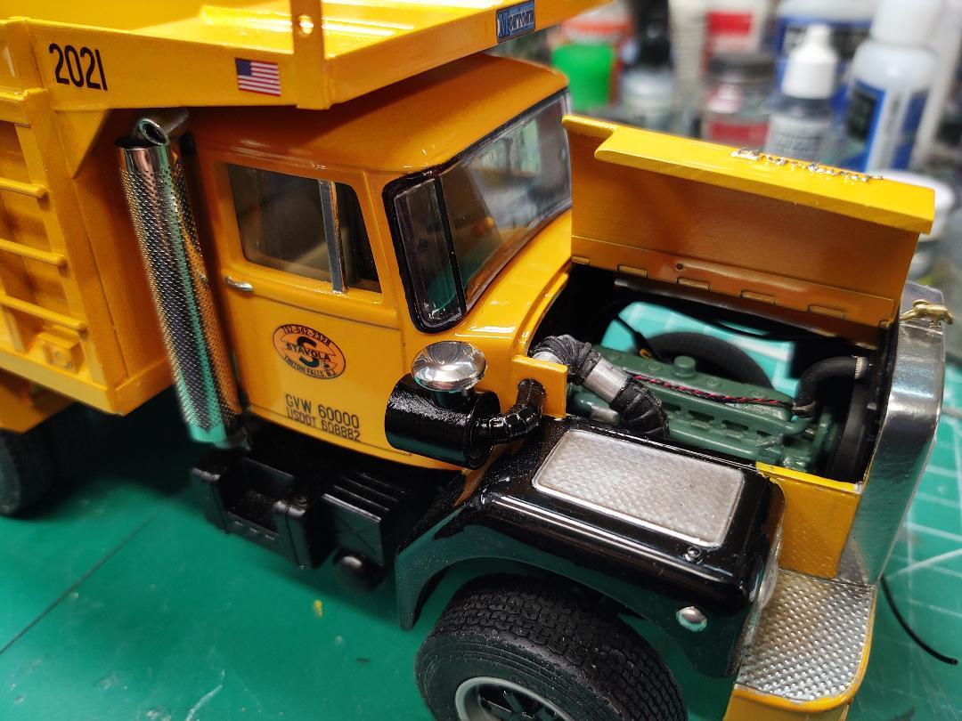

Scott Eriksen Posted November 16 Author Posted November 16 (edited) ................got some bench time finally after a busy week of part timing,lol....and end of season yard work,,replaced a rotted out section of T-1-11 on my shed . She's almost done,,have to make up the tarp setup and a few more little items .I pinned the hood latches on so I can swing them down and be able to open the hood.Made my own mirrors with brass rod and Evergreen Edited November 16 by Scott Eriksen 3
BK9300 Posted November 16 Posted November 16 I agree - this truck's got a real presence to it. Your mirrors turned out really well, too, and got to love the operating hood! Awesome build, Scott. 2

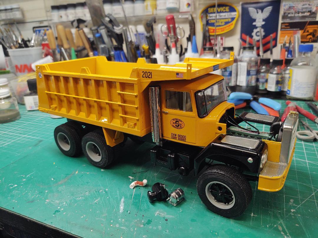

Scott Eriksen Posted November 20 Author Posted November 20 She's done,,under glass ,while I'm gathering stuff for my next build which will be Global Scale's GMC 9500 on the AMT General chassis with a 6V-71 Detroit single rear oil delivery tank truck I'm gonna do the Schwinn bike kit like the one I had,,,it was like B5 Blue with a Pearl white banana seat 5
