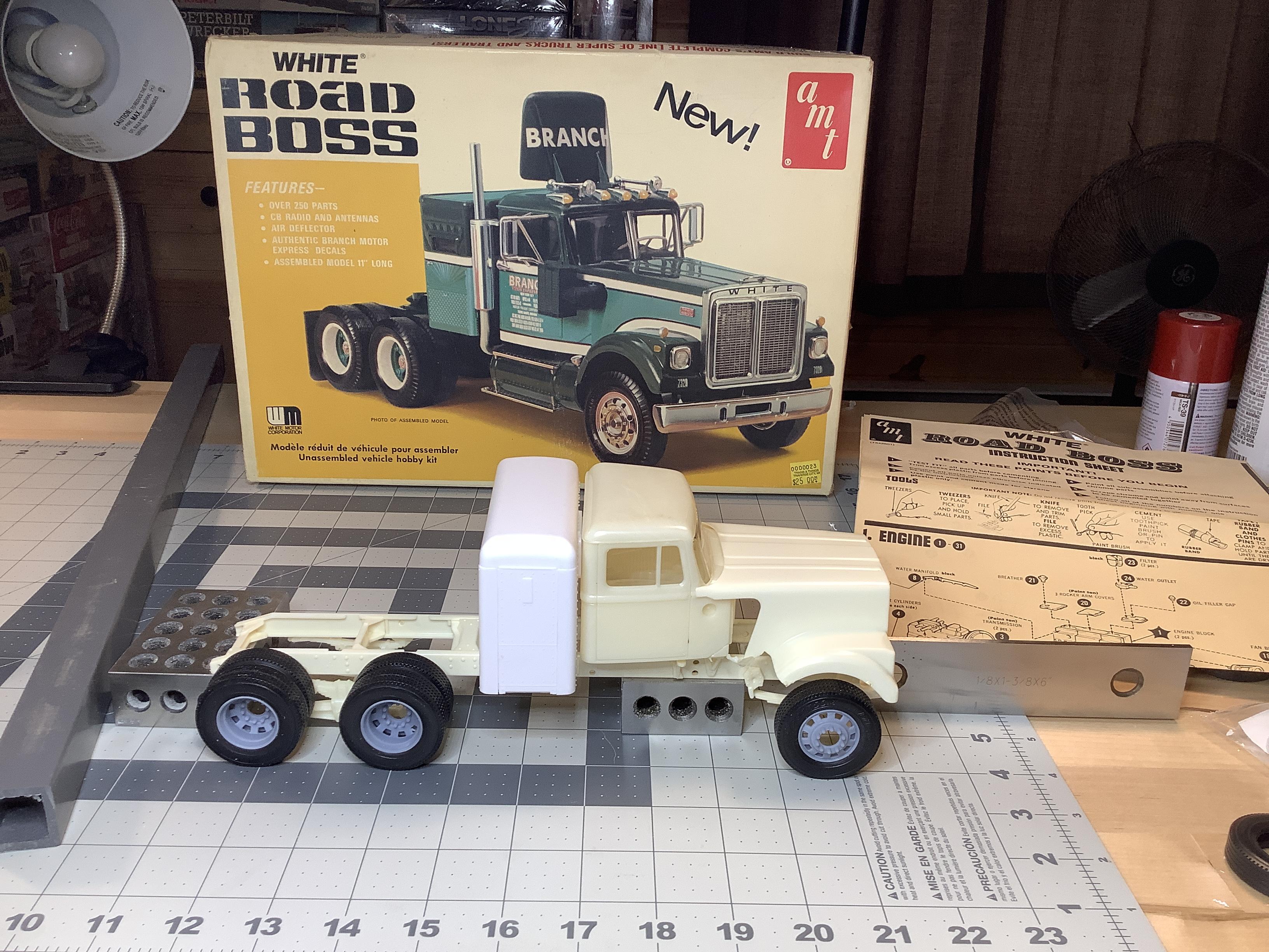

This is a really old kit that I have had for many years. Bottom right hand corner says I gave 25 bucks for the kit. I started this build several years ago and it ended up back in the box, not sure why other than….squirrel. I promised myself that this winter I would finish up three started kits, so this is number one. The instructions have turned very yellow and crunchy. I may take photos of the instructions in case they self destruct. The plastic seems to have yellowed as well or maybe it was molded in this color. Like to build this as a road truck with maybe a couple custom goodies, I have these custom wheels so they are going on, changing the sleeper. See how carried away I get.
  • Like 7
9 minutes ago, Biggu said:
Sweet ,,,, heavy haul? Custom show truck? Custom work truck? 🤔🤔🤔🤔🤔
Just a nice road truck with some simple updates

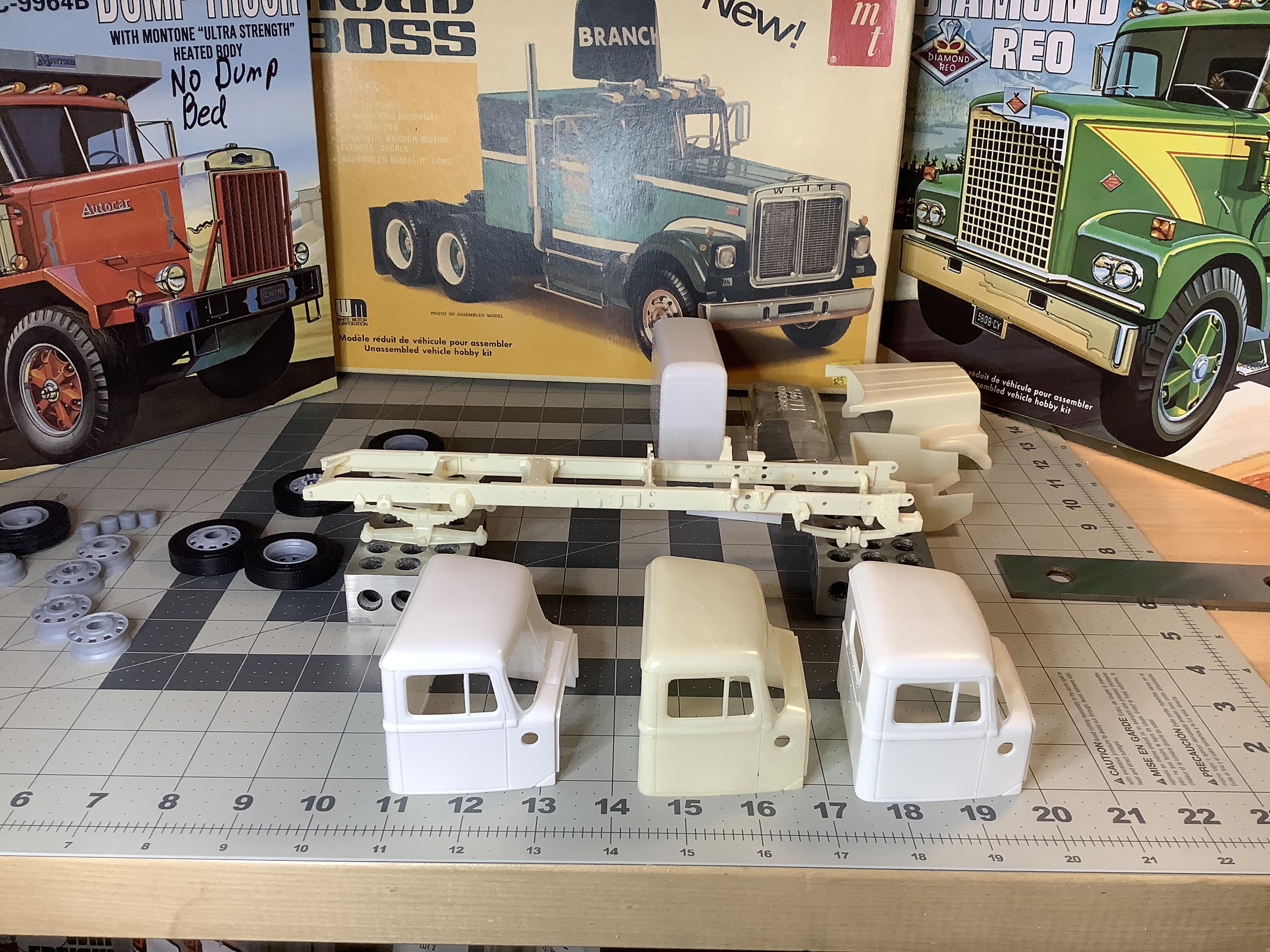

Well that’s interesting, did not know this. Is this an AMT thing or was this real life of manufactures sharing truck bodies? First cab is from the Autocar, second cab from White Road Boss, third cab from Diamond REO, all exactly the same cab.
  • Like 3

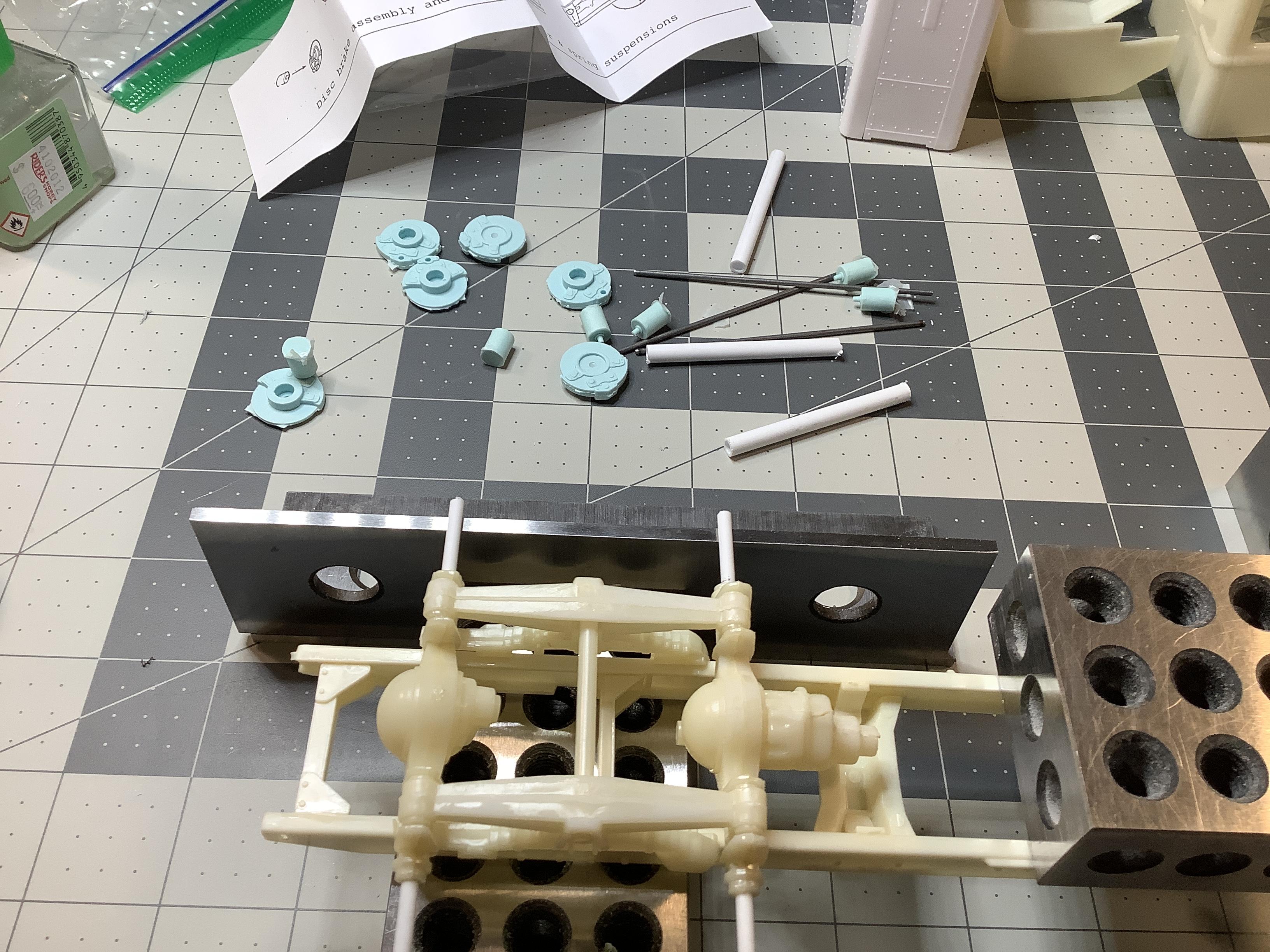

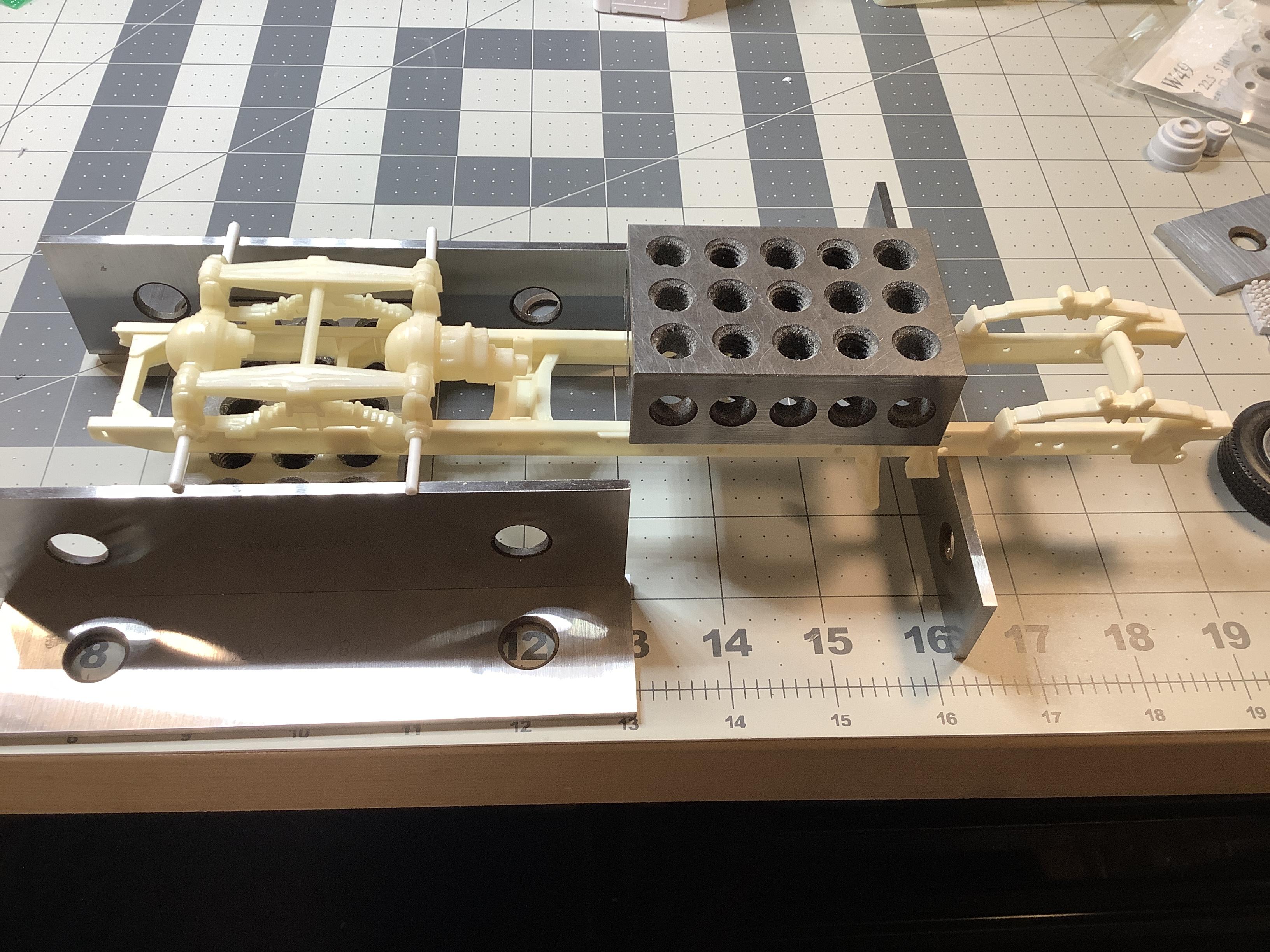

Well I have never gone to this extreme just to align rear axles. This poor old kit needs lotsa love to assemble it, or age has taken its toll on the parts.  Now I now why it got stuck back in the box.
  • Like 4

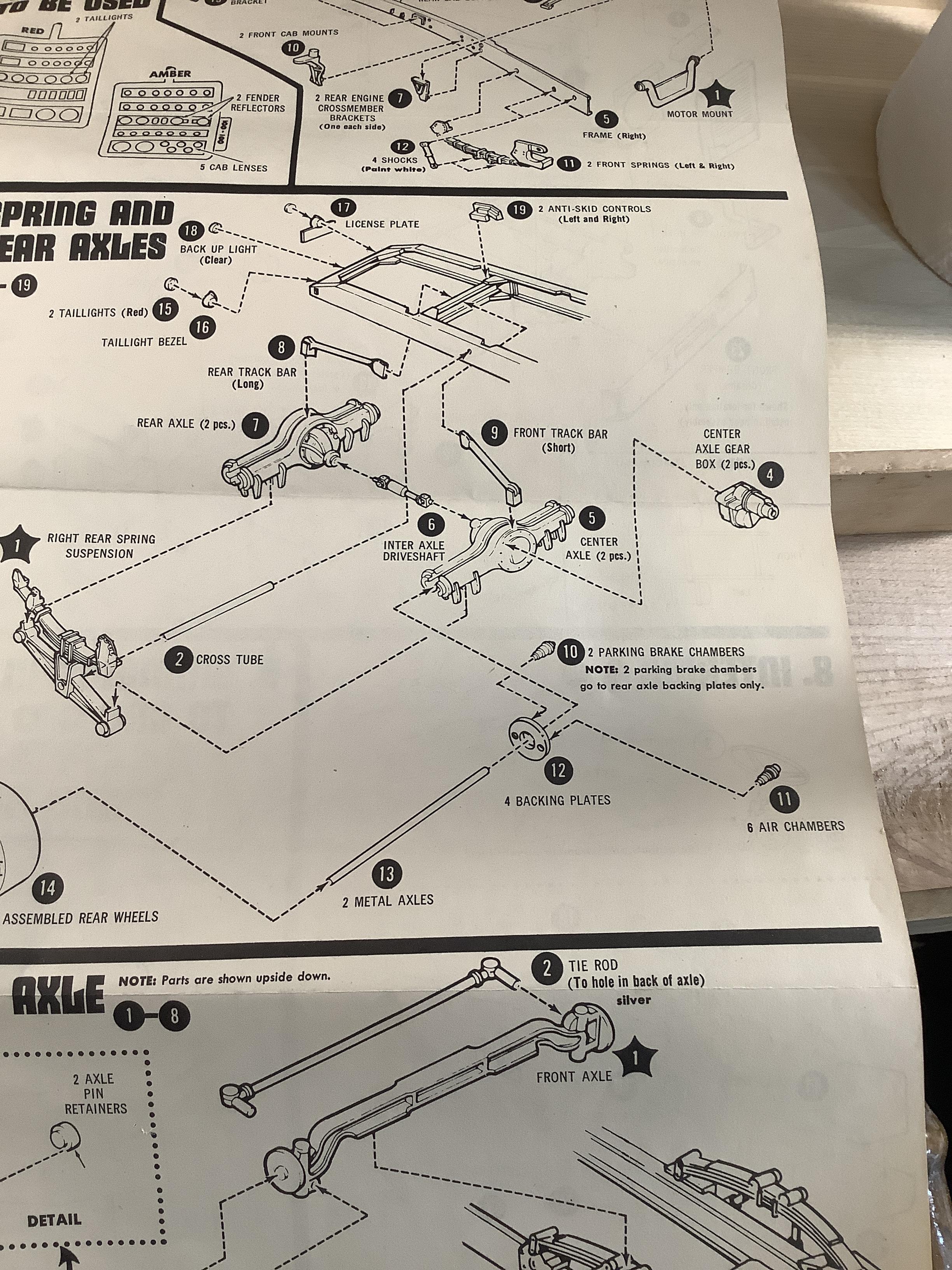

Oh my, this kit has no brakes……anywhere on the rear axles. Non of the air brakes I have will fit. I have a full set of air disk brakes, not sure if anyone has ever upgraded a truck to disk brakes. What the heck…..why not. Kinda changes the scope of the truck but that’s ok, see where this goes or I get to add another bad idea to my growing box of bad ideas.
  • Like 6
I think it had Wedge brakes. Which the Western Star & Reo have.  They are the small brake chambers that are on the backing plates. There is two on each backing plate according to the instructions. The Ford Louisville cement truck I used to drive had only one pot back in the day. Not the greatest set up for a heavy mixer. “S” cam brakes are much more efficient.
  • Like 2
This what you are talking about? I seen parking brake chambers, first thought was then where are the air brakes. We can see where my knowledge stops
  • Like 1
Yes # 10 & 11 is what I was referring to. Not really very well detailed nor sized to scale but yes those are the bits.
  • Like 1
This IS a case of art imitating life. The White Motor Company, at one time, owned Autocar, White Western Star, Diamond Reo, and White Freightliner. They were providing cabs for Diamond Reo, White, Autocar, and Western Star conventionals all at the same time. All the AMT kits reflect this. This carried over to cabovers for a short time. The Road Commander II is the same White based cab as the new for '79 Western Star cabover
  • Like 4

19 hours ago, Gary Chastain said:
Well that answers alot of questions , thanks Brian. And that manufacturing process still lives today, amazing.
Gary to further answer your question. That cab was actually made by “The Corporation Cab Co.”The White company started using this cab around 1963 on their 9000-4000 trucks as their “Custom Cab” option to their smaller White 9000-4000 cab. Autocar used this cab dating back to the early 1950s then in 1966 the Corporation Cab Co. added 3 inches to the height of this cab. The first truck to receive the new cab in 1966 was the White 9000 and the 4000  the other White family trucks followed as well. In 1968 when Diamond T and Reo merged they started using the new 3 inch cab. I discovered this when I was restoring my real 1.1 Autocar A64B and my 1968 Diamond Reo in the year 2000 and 2001.  The cab was made in 3 sections I found this out when I replaced my headliner. I think other truck manufacturers also used this cab as well. Western Star used this same cab from 1967 well into the 1990s with some more modifications. Hope this helps.
