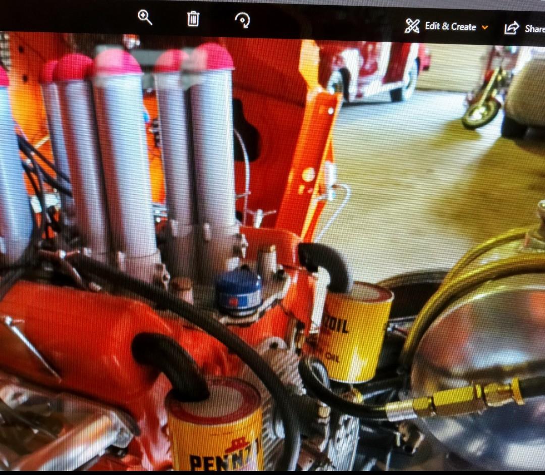

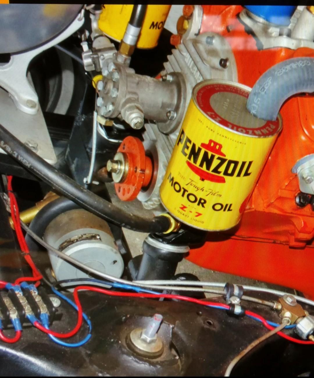

64SS350 Posted Monday at 10:01 AM Posted Monday at 10:01 AM Here's some pics of a friend's car. Small block Chevy...ports for water pump are sealed off, cam pump used for fuel delivery. 2
Chris V Posted Monday at 01:53 PM Posted Monday at 01:53 PM 3 hours ago, 64SS350 said: Here's some pics of a friend's car. Small block Chevy...ports for water pump are sealed off, cam pump used for fuel delivery. Sorry for hijacking the thread, but is that Dave Koffel's "Flintstone Flyer Too" Studebaker Lark?

Ace-Garageguy Posted Monday at 02:11 PM Posted Monday at 02:11 PM 4 hours ago, 64SS350 said: Here's some pics of a friend's car. Small block Chevy...ports for water pump are sealed off, cam pump used for fuel delivery. With the right parts and maybe some machine work, the cam can be used to drive a water pump as well, with it or the injection pump stacked out farther in front of the engine. 1

64SS350 Posted yesterday at 12:16 AM Posted yesterday at 12:16 AM 10 hours ago, Chris V said: Sorry for hijacking the thread, but is that Dave Koffel's "Flintstone Flyer Too" Studebaker Lark? Yes, I built three of these for my friend that owned the car. 1
