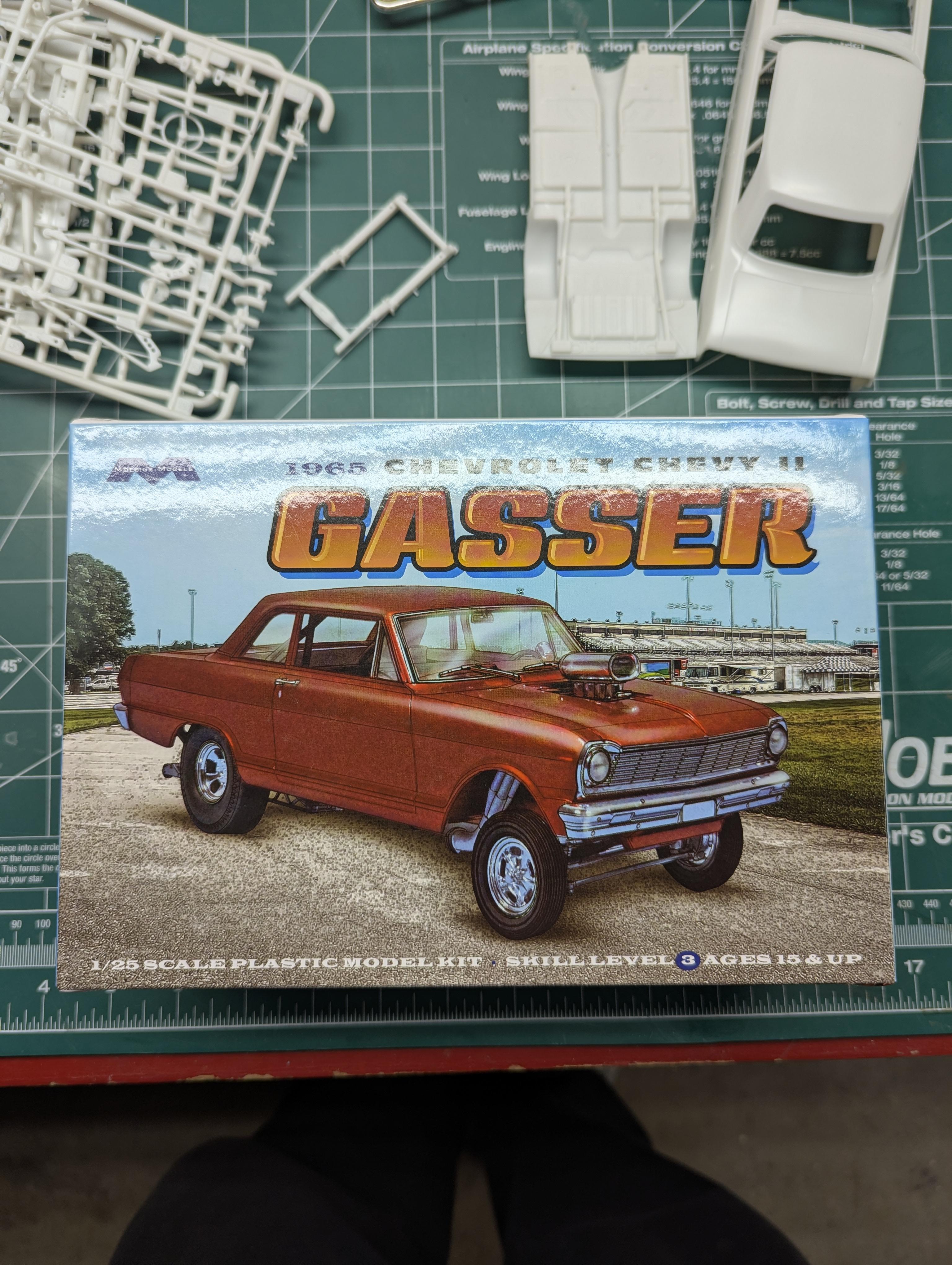

HankinWisconsin Posted Wednesday at 12:06 AM Posted Wednesday at 12:06 AM Starting a build on what is certainly the nicest kit that I own, the Moebius '65 Chevy II Gasser. Any tips on this particular kit are much appreciated. 4

Andrew McD Posted 11 hours ago Posted 11 hours ago Currently working on this same kit. Check the windshield fit. On mine there was interference between the cowl, windshield, and dash. Some sanding of the lower edge of the windshield was required. On the instruction sheet it appears the rear quarter windows should be installed from the outside but they seem to fit better installed from the inside. The blower ends are upside down. If you install as per instructions the radius of the top of the blower doesn't match the radius of the blower ends. You end up with a straight edge trying to match to a radius edge. I may not be clear the way I'm describing it but look carefully at the way the blower parts fit. Apart from these issues I've been quite impressed with the fit and finish of the kit parts. 1
HankinWisconsin Posted 11 hours ago Author Posted 11 hours ago 3 minutes ago, Andrew McD said: Currently working on this same kit. Check the windshield fit. On mine there was interference between the cowl, windshield, and dash. Some sanding of the lower edge of the windshield was required. On the instruction sheet it appears the rear quarter windows should be installed from the outside but they seem to fit better installed from the inside. The blower ends are upside down. If you install as per instructions the radius of the top of the blower doesn't match the radius of the blower ends. You end up with a straight edge trying to match to a radius edge. I may not be clear the way I'm describing it but look carefully at the way the blower parts fit. Apart from these issues I've been quite impressed with the fit and finish of the kit parts. Thank you Andrew, appreciate the heads-up. Hank
