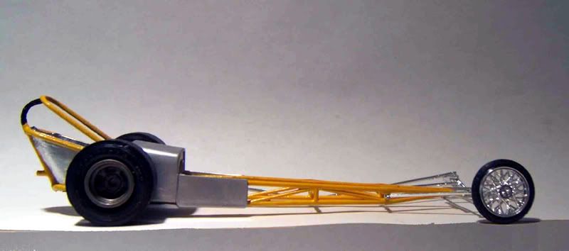

Bernard Kron Posted June 13, 2009 Posted June 13, 2009 For the 120" wheelbase era I would recommend the HemiSphere as almost ideal. It is more or less generally available in your LHS and on line. 7-8 of them currently on e-bay at around $18.00 By-it-now and similar price at Model Roundup. Very nicely detailed throughout and looks good as a stripped down rail. Nice interior details and decent fuel system. Great blown hemi with separate pulleys and rubber drive belt. Here's a bare-bones Nailhead powered rail I did last year from it: Bare frame: (I pinched the nose and made my own fuel tank) Built up: (Except for the rear bodywork surroundng the driver's seat, the parachute pack, and the engine, almost all parts are from the kit) The only gripe I have about it is that it has a Garlits' characteristic roll-hoop and so doesn't look quite right as a West Coast Woody Gilmore style rail circa Lions 1964. For this the Ramchargers kit provides a better frame. But unfortunately it is very hard to find. This Fall AMT/Round2 will issue the Tommy Ivo FED which would also be very fine for your purposes. Most people would probably not notice the difference, maybe...

Bernard Kron Posted June 14, 2009 Posted June 14, 2009 Is this the same kit as the Hippie Hemi I see all over? I don't see the HemiSphere kit anywhere. It's a rough search with all the other junk that name brings up . eheh I just looked at the instructions for the Hippie Hemi and I'd say that yes, this is virtually identical except for the body, which you might not need anyway. The one advantage of the Hemi Sphere kit is that you could cut down the kit body to make a "shorty" body which is what I did (the rear portion behind the wheels is scratchbuilt from pie tin aluminum). Here's a link to the e-bay search for the Hemi Sphere: http://toys.shop.ebay.com/items/Models-Kit...d=p3286.c0.m282 And here's a link to Model Roundup Online's listing for the Hemi Sphere: http://www.modelroundup.com/mrcategory1020.htm
