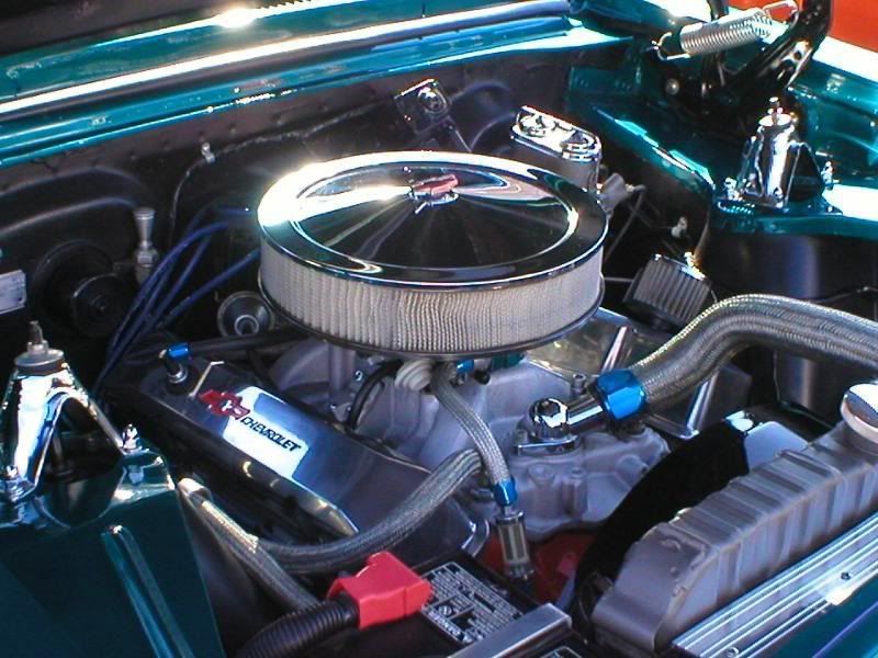

roadhawg Posted June 23, 2009 Posted June 23, 2009 (edited) If you have a metal end tanks you could polish them and make them look good. Unless the radiator shop was doing the radiator for a show car, the solder joints will look sloppy, which is why they paint 'em in the first place. Yes, radiator tanks polish up pretty, but then you got all those ugly solder joints to deal with. Black, or Radiator Black, is the standard color, but that doesn't mean you HAVE to use black. See the Nova model in my avatar? This is a model of a real car I built. I painted the shroud gloss black, and wanted something to contrast it, so I painted the radiator with a spray can of Cast Iron.....just to be different! Lol! By the way.....the reason radiators are black in the first place......the theory is that black absorbs heat, and draws heat out of the radiator. Edited June 23, 2009 by roadhawg
CAL Posted June 23, 2009 Posted June 23, 2009 Unless the radiator shop was doing the radiator for a show car, the solder joints will look sloppy, which is why they paint 'em in the first place. Yes, radiator tanks polish up pretty, but then you got all those ugly solder joints to deal with. Black, or Radiator Black, is the standard color, but that doesn't mean you HAVE to use black. See the Nova model in my avatar? This is a model of a real car I built. I painted the shroud gloss black, and wanted something to contrast it, so I painted the radiator with a spray can of Cast Iron.....just to be different! Lol! By the way.....the reason radiators are black in the first place......the theory is that black absorbs heat, and draws heat out of the radiator. Also the theory behind painting racing engines black, but, "I don't think so, Tim."
