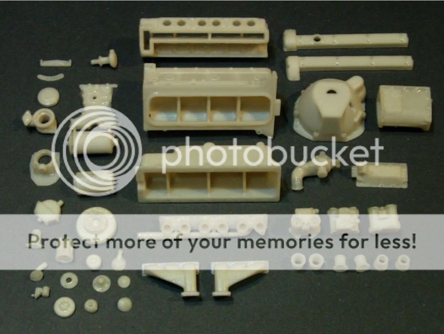

GrandpaMcGurk Posted December 1, 2009 Author Posted December 1, 2009 (edited) Here's a few pics of the parts I'll be dealing with first, I used large photos so that you can see the texture and detail in the parts. Note that bolt holes are printed into the pieces......there are corresponding holes in the part it mates to. For you guys that are going to detail to the max...these holes can be drilled out and metal hardware added. No need to index......the holes line up pecfectly from part to part. Also notice the bracing the desingers have added to strengthen and stabilize the part during printing. TDR's design team is incredible! Edited December 1, 2009 by GrandpaMcGurk

GrandpaMcGurk Posted December 1, 2009 Author Posted December 1, 2009 I'm not one to say do this or that, this is just the way I'm doing it at this particular point in time. You guys may want to take a different approach. I want to use the inherent surface texture to my advantage, after all these are supposed to be cast parts (real world) not machined from billet. I'll go back now that I have a couple coats of hi-build primer on and lightly sand the surfaces...with any kind of luck I'll have a believable cast surface look while maintaining the built in details.

GrandpaMcGurk Posted December 1, 2009 Author Posted December 1, 2009 (edited) That pretty much sums up "how it's done". Thanks Rick, you mentioned CA in your post...I'm glad you did. Gang, put away those squeeze tubes and brush on "Model Car Cements". Those adhesives are of little use on this material. CA or epoxy adhesives are a must. Edited December 1, 2009 by GrandpaMcGurk
