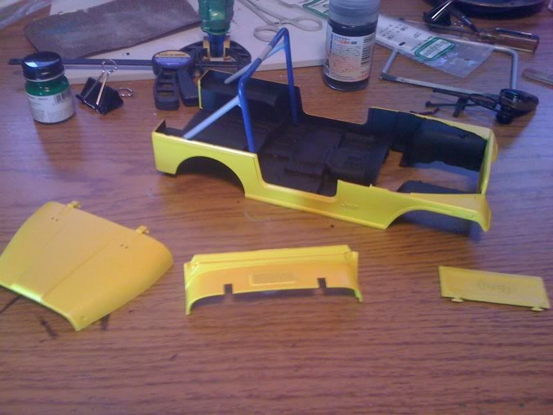

Just a quick update on the CJ-7 - Warmed up enough yesterday to squirt some paint. Hit it with a coat of primer and sanded where it needed sanded. Next up was a coat of Krylon Yellow (same as the 1:1). Some flat black on the interior (best I could do for Rhino Lining) and the engine compartment and we're in business. The cage included in the kit was horrible. I started cutting it up and am planning to do a full cage using sprue (same diameter).

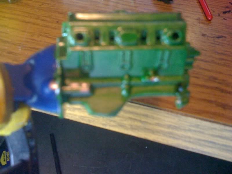

The engine was a Chevy 305 painted Grabber Green. The 360 in the kit will do the job. I looked for a close match to the green I used, but couldn't find anything in a bottle. A little Pearl Green by Boyd seemed like a good idea, but I'm not so sure. We're see after another coat to cover the silver/chrome base.

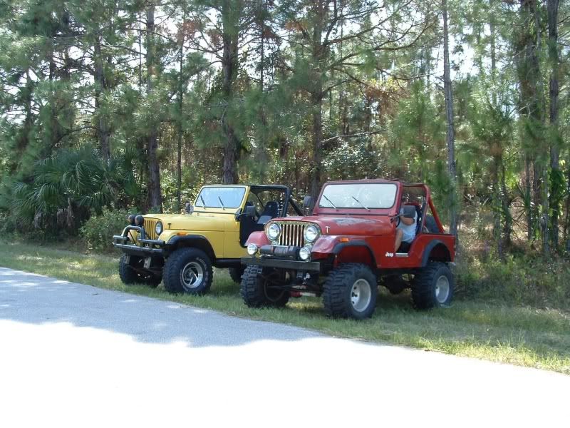

very nice heres pic's of my 1:1 this is a 1974

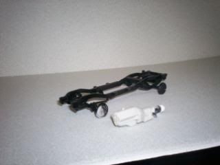

Update on the Dust Devil. 100_1269.jpgHere's the chassis mockup. I've swapped the intake out for a 4bbl, as the kit intake is an incorrect 2bbl. Full time 4x4 trucks used 4bbl carbs. I am using an incorrect manifolt, as it is the one from the AMT '66 Nova (I think, came out of the parts box) and it is going to have a Holley carb, but since it is a custom truck, I don't think it's out of place.

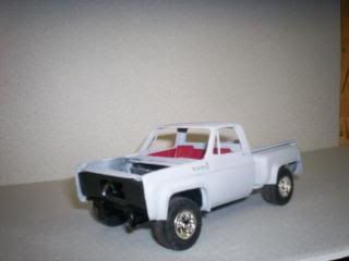

100_1270.jpg This is a mockup with the cab and interior in place. There's still some primer work that needs done, and I need to work out some issues with the fender badges. Seems the primer I used wantes to bury them.

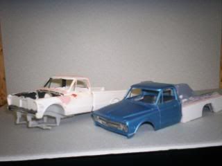

100_1273.jpg'68 and '69 MPC Chevies. Both were aquired through Joe Chernauskas as builtups. The blue '68 was a very nasty gluebomb, with an incorrect engine (the 427 form the IMC '48 Ford) 3 mags of unknown origin, and 1 Hurst mag. It had ben built as a tow truck, and didn't come with any of the stock parts. I'm converting it into a C30 with a corrected wheelbase and chassis. The grille was redone with Alclad.
The '69 was built as the firetruck, but did come with the original box and all the unused parts, including an untouched pair of bedsides and tailgate. It's getting converted into a K20, using the chassis from the '84 GMC. The rear axle will be getting replaced with a more accurate one, which is in the next pic.

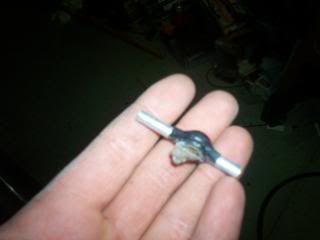

100_1272.jpgThis is the axle I'm working on. When it's done, and cast, it will be an Eaton HO 52/72, which was used in most Chevrolet and some GMC 3/4 and 1 ton trucks from '47-'72. It's based on an axle from a Quadzilla kit, with the 3rd memeber replaced with one that is partly a casting from a Jada diecast '53 Chevy tow truck, and partly hand fabricated. Once done, I will be popping a mold and casting it. Got 4 projects requiring 5 of these axles; the 2 trucks pictured above, a '72 Camper Special (which could also use a Spicer 60), and a '57 Chevy 3800 Napco 4x4, which needs 2 of them.
