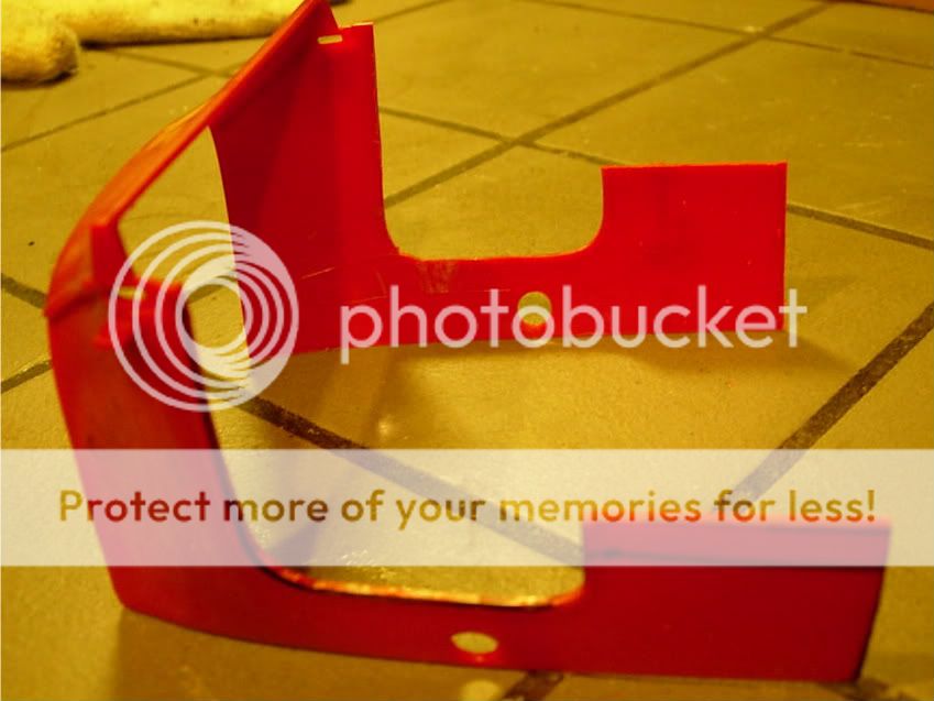

GrandpaMcGurk Posted February 2, 2010 Author Posted February 2, 2010 These pics should pretty much explain where I'm cutting the bucket body..... I be using a coping saw but use whatever works for you. Don't throw away the piece you cut off, never know when you might need a chunk of curved plastic.
GrandpaMcGurk Posted February 2, 2010 Author Posted February 2, 2010 Looks a bit like a chunk of a Jeep....LOL.

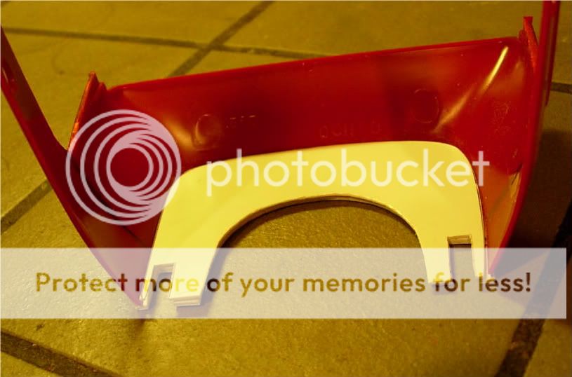

GrandpaMcGurk Posted February 2, 2010 Author Posted February 2, 2010 I traced a wheel rim on the firewall and cut out the bell-housing opening, cut the notches for the frame rails with my favorite tool....the nibbler. It's cheap and is a real time saver, do yourself and favor and get one if you don't have it already.

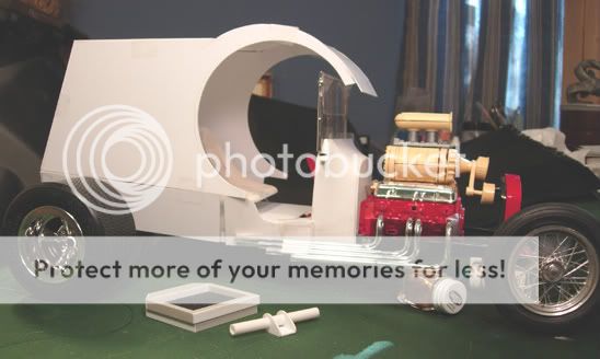

GrandpaMcGurk Posted February 3, 2010 Author Posted February 3, 2010 To give you an idea of where this is headed....here's a photo of the cardstock mock-up I did for a previous build.

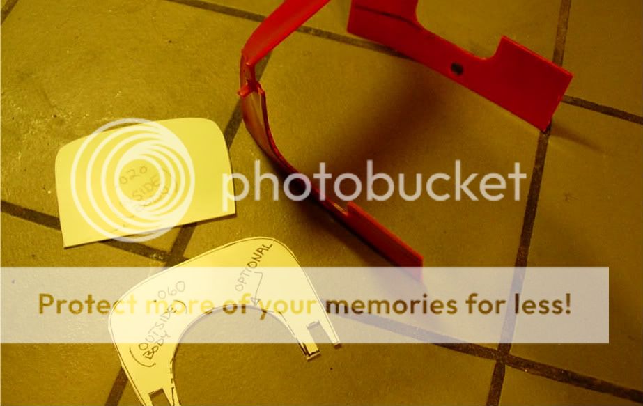

GrandpaMcGurk Posted February 3, 2010 Author Posted February 3, 2010 Trace the inside of of the firewall onto a scrap of 020. styrene and cut out...sissors will work on this thin stuff. The first photo shows the inner and outer firewall pieces. 2nd photo.......glue the outer firewall to the cowl. Trace the firewall and frame notches onto the inner firewall, cut out and cement to the inside of the body. This should give us a good strong joint that won't crack later and add some stiffness to the body. Time for a mock-up to make sure everything fits and check the all important stance. Mock-ups are an important part of scratch building, they allow you to make adjustments and tweaking before it turns into a real problem. I'm using a 327 (built from the kit engine).It has a 4-speed Vette trans I kit bashed......well, case in point, I need to modify the center cross member to drop the trans tailshaft down a little so it will line up with the pumpkin. I want a nose down attitude and plenty of ground clearance for the oil pan. This is the point where you really should determine tire size, suspension, engine & trans etc. I'm keeping the bottom edge of the body flush with the bottom edge of the frame. Here's a few pics of the mock-up.....If you haven't scratch built a body before please don't skip this step! A little head-scratching now will save you lots of grief later.

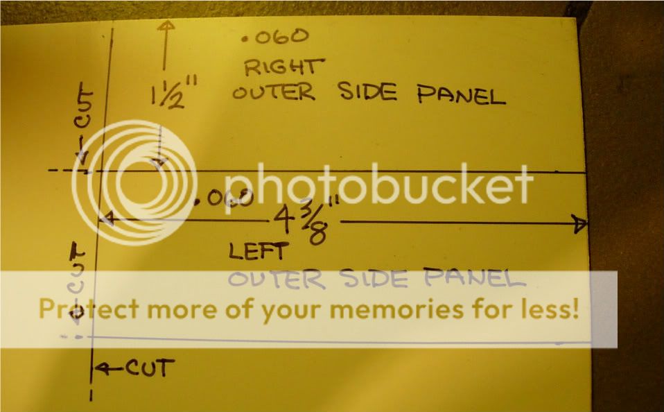

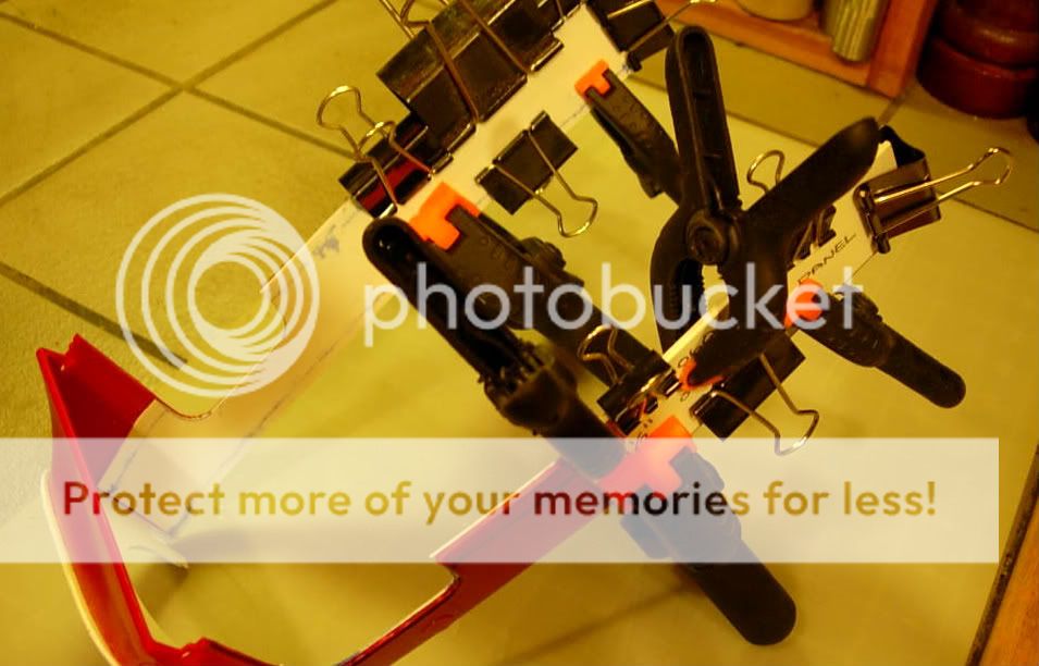

GrandpaMcGurk Posted February 5, 2010 Author Posted February 5, 2010 While we are waiting for the glue to set let's cut the outer side panels. You'll need .060 styrene or laminate some thinner material to get to the thickness of the original kit body. Don't attach these yet as we have to do a couple of things first. You guys still with me? Pretty easy so far, huh? Not much to say here...glue and clamp the outer side panels on. Don't trim the back of the outer panels to match the angle if the inner panel yet.....got a tip for ya to make a stronger corner joint when we get that far. Next up will be the floor boards and rear lower panel. Once all that is done the hard part is over....the rest is even easier and you will be able to add your own special touches to the C-cab.
