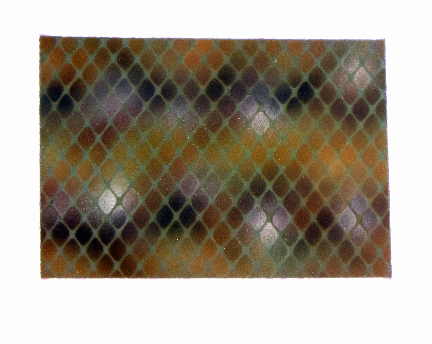

It started with the idea of doing a vehicle that is "reptile" inspired, so I thought of snake skin. I studied a few pictures and patterns and get the House of Kolor paint out and set up . . . just some basic colors like Planet Green, Purple, Tangelo, Chrome Yellow, and some red-orange candies . . .
It began with this practice:
If you study the patterns on say a python or a rattler, you get these multi-colored diamonds . . .
The beauty of it is that there's no right patter. Like realistic flames, the idea is to create your own style and look . . . or at least, that's the story and I am sticking to it. ;);):lol:
I used a bit of white too and the pattern comes from a plastic mesh from an onion bag from the market . . .

Back to the snake skin technique . . .
So I wanted this thing to be as bright as possible, so I used Plastikote white primer, about four coats of it . . . .
Then on the body I put down a couple of coats of Passion Purple (all colors are House of Kolor) and then blended Planet Green along the edges and on the top I added these lines . . .
After the paint sat for about 15-20 minutes, I taped off the top and held the mesh down with tape . . . you gotta make sure the mesh is straight and that it lays flat against the body so that the dark diamond shapes will come through after all the other colors go on . . .
I sprayed splotches of Molly Orange and Chrome Yellow. I used a drop of black and Rootbeer candy and added some dark markings in different parts. You can lay in really well defined markings if you want, but the 32 is a small canvas . . .
After those few coats dried, I brought out the white and mixed in a little bit of white with Chrome Yellow and again sprayed in some spots.
Allow to dry again, 10 minutes or so . . . and then I fogged in Pagan Gold, and that's it.
Remove the mesh after the paint dries . . . and then move on to the next panel.
