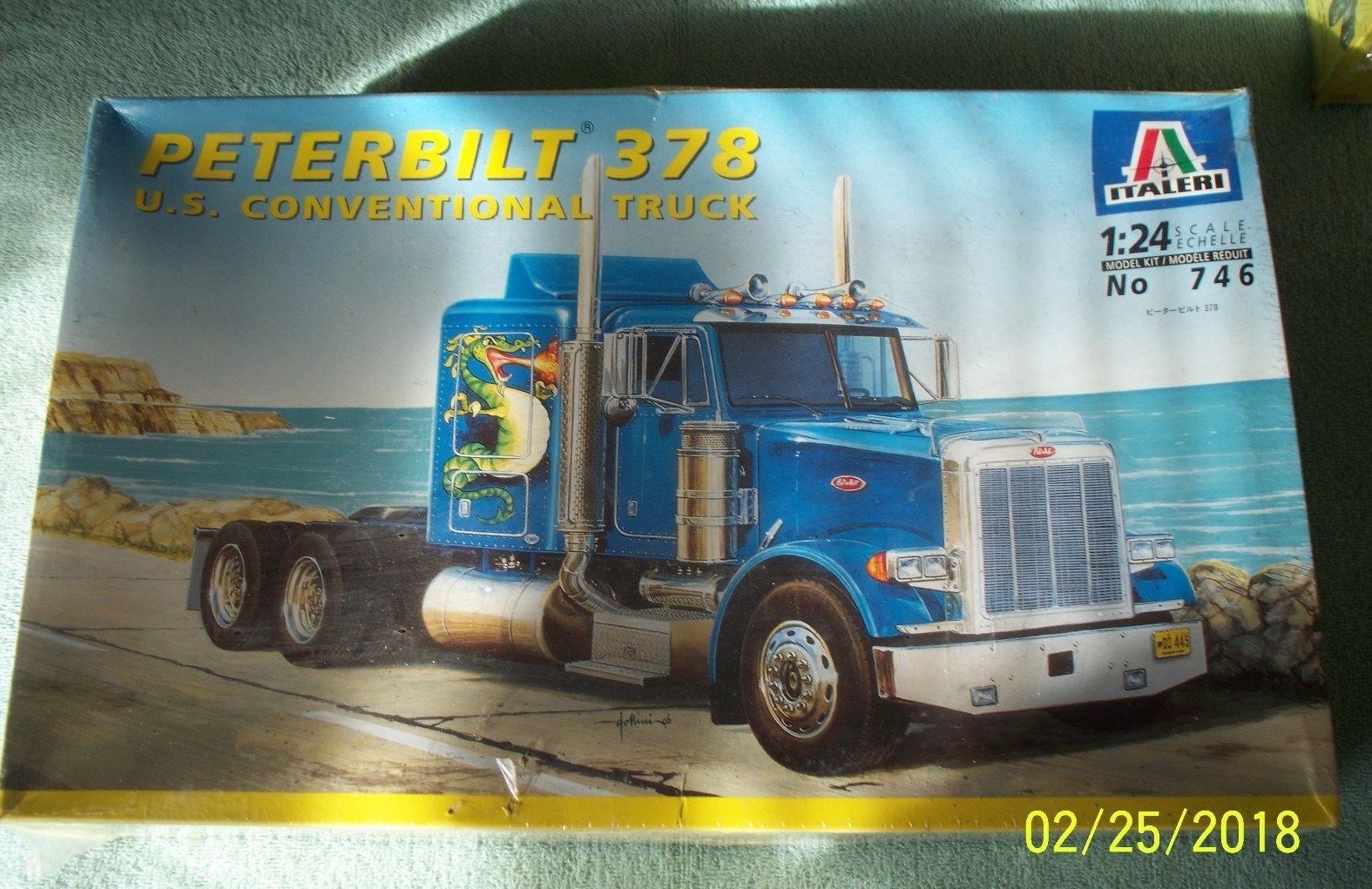

I took Italeri's Peterbilt 378 as a base.
