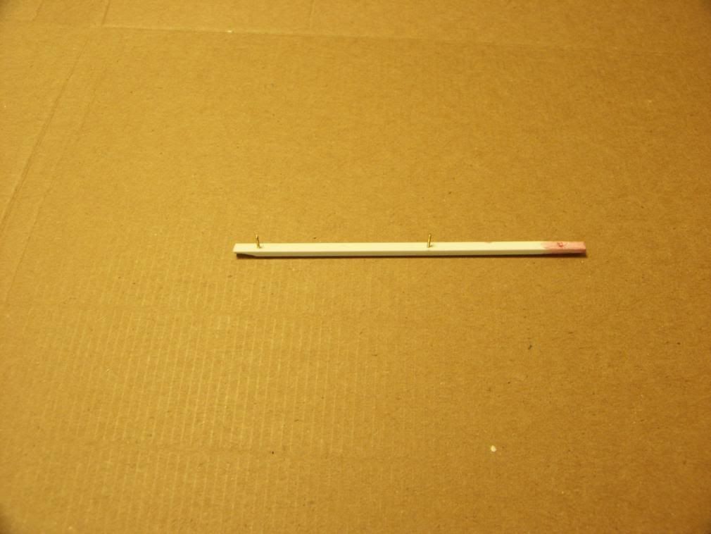

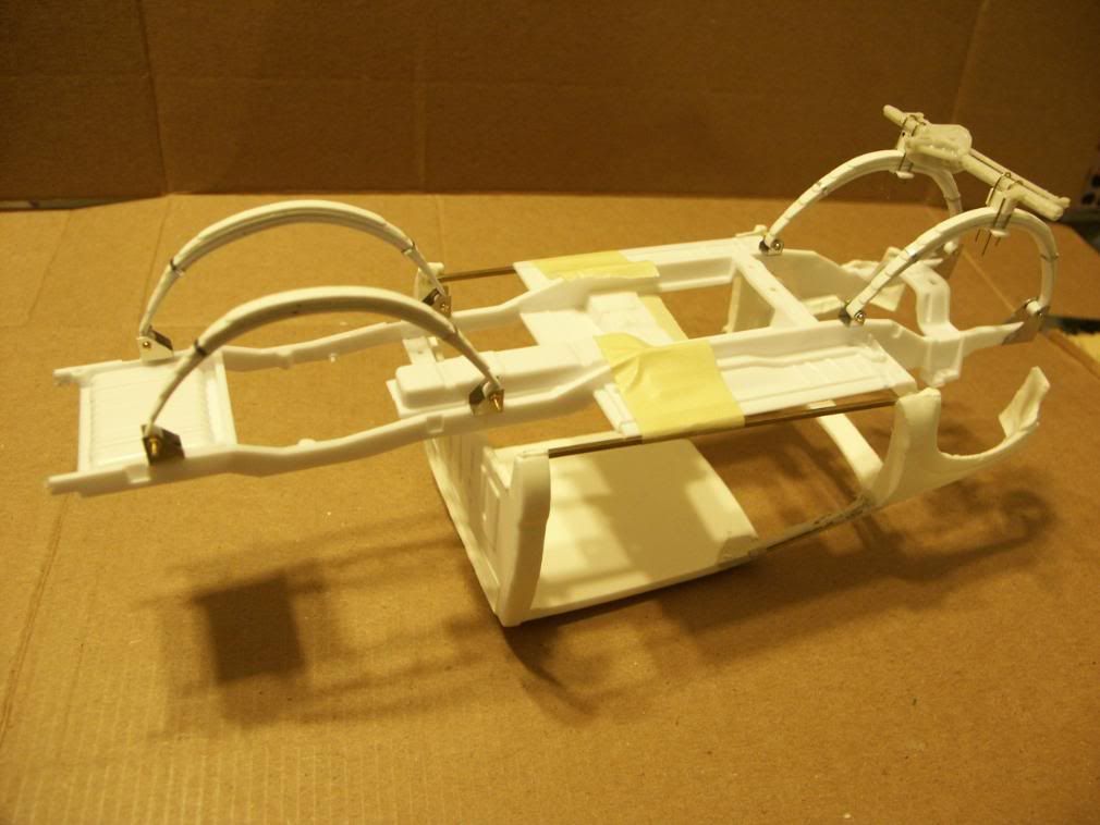

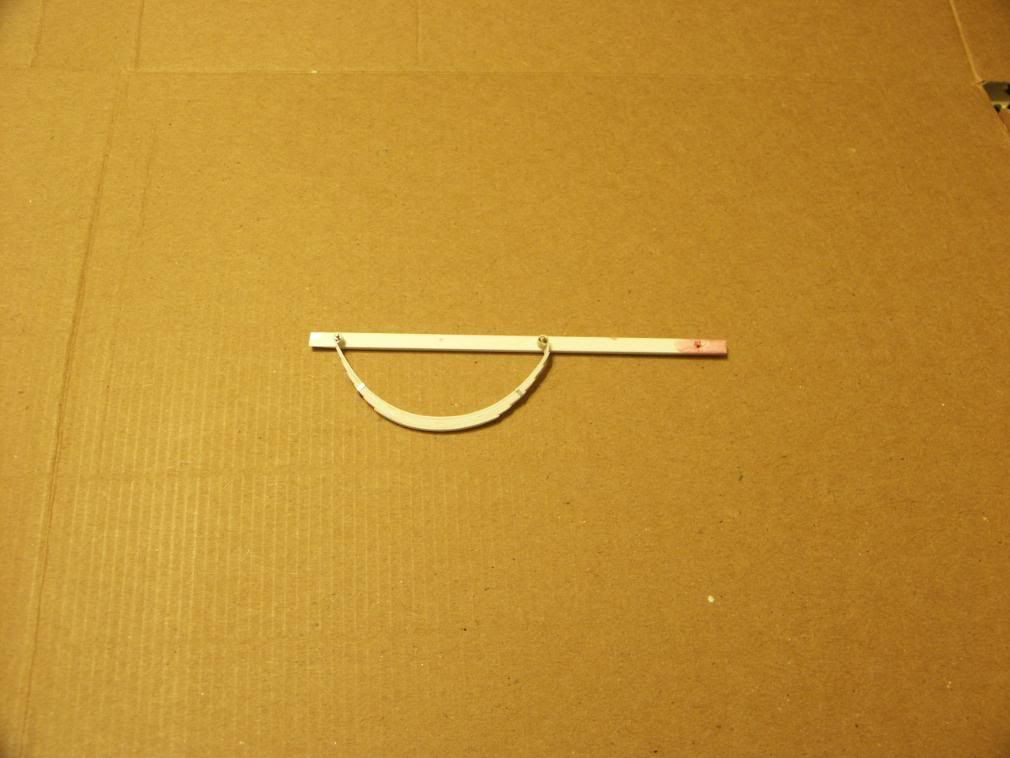

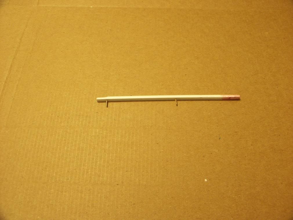

Romell R Posted May 10, 2010 Author Posted May 10, 2010 I found the pics of the tool i used to make the suspension. the tool was made from a bar of Plastic rod and two small screws. The feaf springs are made with .010 plastic strips 5-6 strips each. you apply the first strip between the two screws and as you layer the strips on they start to form the feaf spring. here you see the completed spring next to a kit spring....

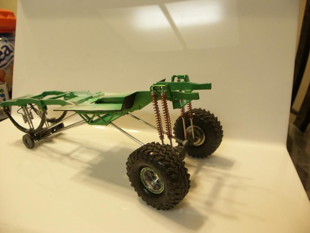

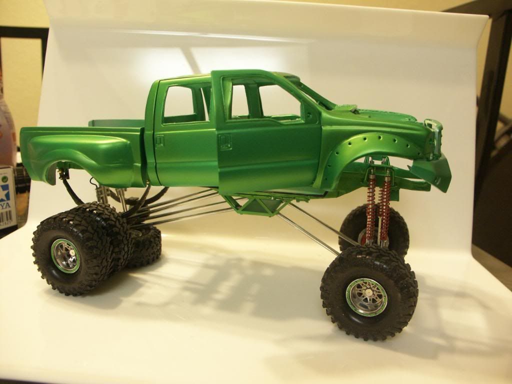

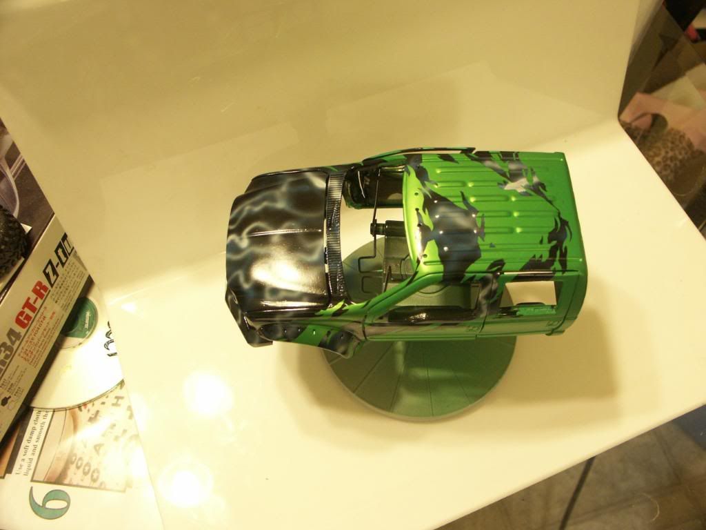

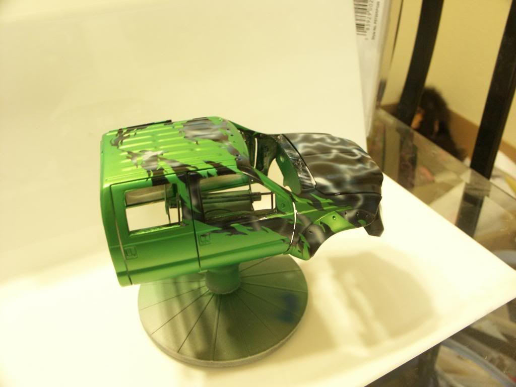

Romell R Posted May 10, 2010 Author Posted May 10, 2010 Here cab has been painted with the first step of color its HOK Lime Green Here some color has been added to the chassis..... Heres a mock up for your viewing pleasure LOL!

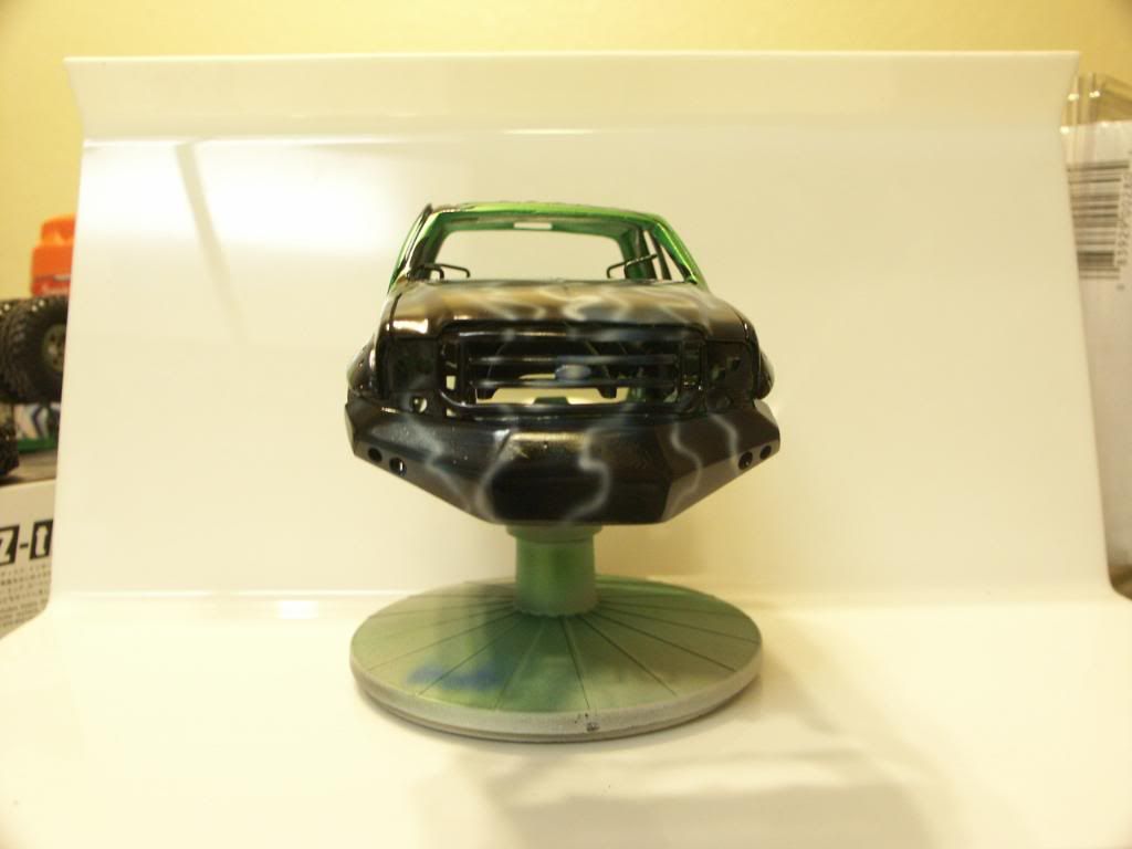

Romell R Posted May 10, 2010 Author Posted May 10, 2010 Got the HOK Black on and the electricity grafix painted on and moving forward... Stay tuned for more.....

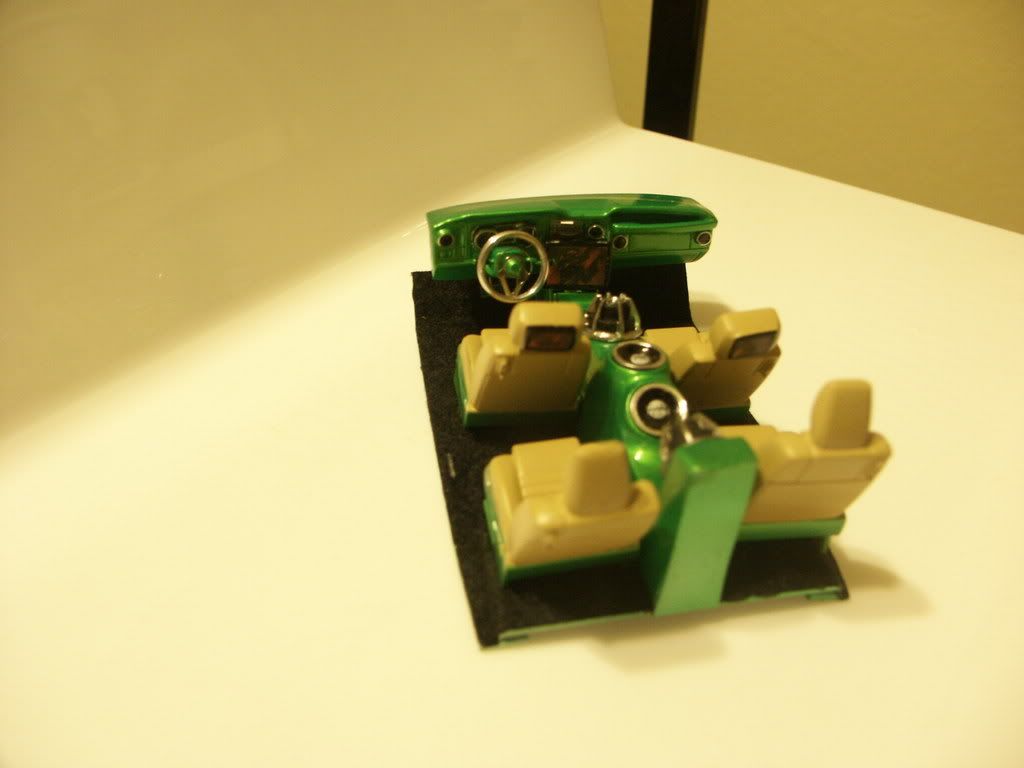

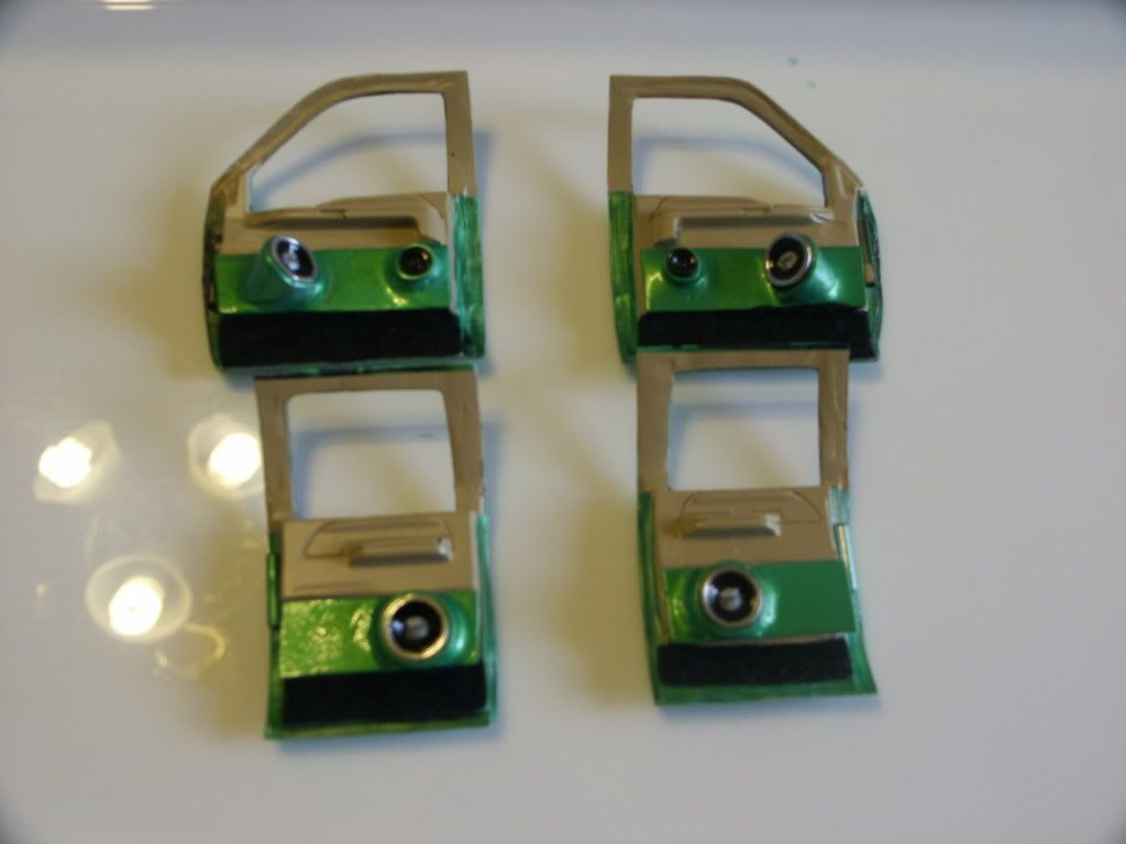

Romell R Posted May 10, 2010 Author Posted May 10, 2010 Heres the almost completed Interior..... these amps go behind the rear seats Visors with video screens

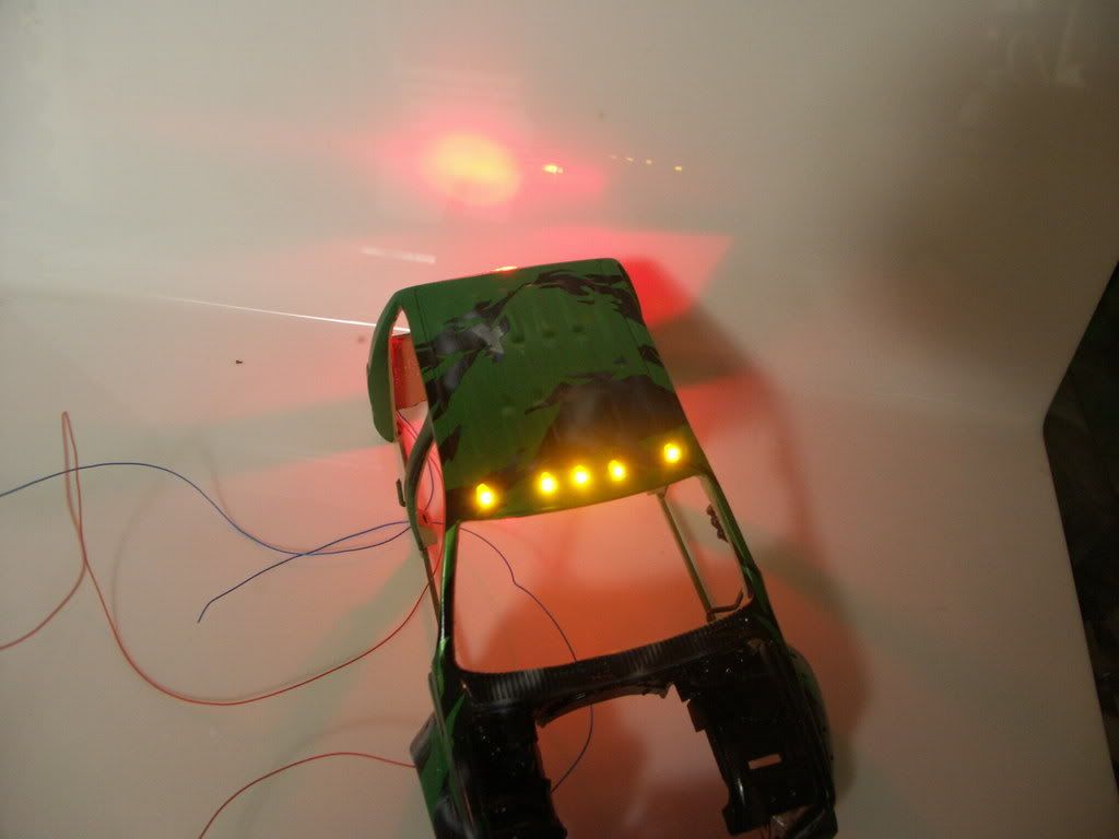

Romell R Posted May 13, 2010 Author Posted May 13, 2010 (edited) Heres the cab with working lights, I used LED's i picked up at Radio Shak and ground them to the right shape. I installed a headliner to hide the wiring. Stay tuned for more to come Edited May 13, 2010 by Aftashox
