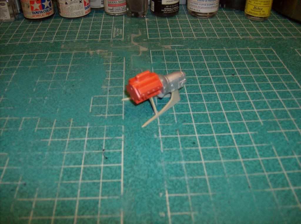

highway Posted May 14, 2010 Posted May 14, 2010 I have a dumb question... what would happen if I don't use a clear layer? John That's not a dumb question, John. The Testors Lacquers are just like a 1:1 basecoat/clearcoat paint job, they need the clear to have a shine. I painted this 09 Challenger with Testors MM Custom Lacquer System Hemi Orange, also using their white primer and clear coat. I used the same paint for the engine and under the hood, but did not use the clear on these parts. It may be hard to see in these pictures, but there is a noticeable difference in the shine. The uncleared parts have more of a satin or flat shine to them, just as if you look under the hood of your 1:1 car, where the paint is typically not clearcoated.
