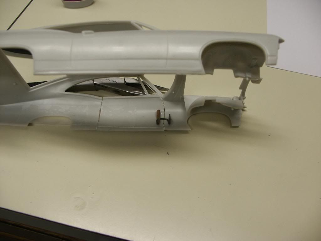

Im enjoying your build you are doing an excellent job. But i feel compelled to tell you that the type of hinge you are using is the wrong type. This type of hing makes the door swing out from the car as opposed to the door swinging inside the front fender as it should. Just take a look at the way a door opens and you'll see what I mean. I have made a hinge that corrects this problem and I would love to show you how to make it using the same materials you use for the hinge on your truck. I hope i didnt offend you in any manner. Romell

I thought just reversing the same type hinge would change the door swing. I'd like seeing your solution. :)

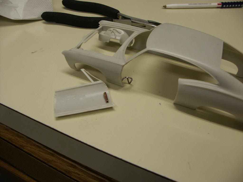

ok heres the tute I promised you. Keep in mind that im not giving dimentions as these will be totally up to you, I just want to show you the shape and materials needed and you can fine tune from there.
Here Are what you will need

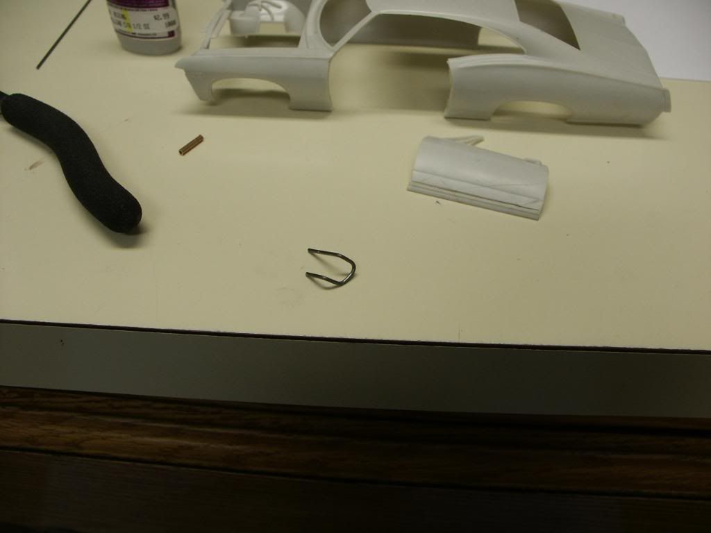

Ive cut the door completely off (in a hurry to do this tute) you will have to bend the wire in a sort of "U" shape like the one pictured hereHINGETUTT003.jpg
Again the size is up to you as long as you have the shape correct this hinge will work
Position the wire on the body of the car as shown and put the tube on the wire on the door side. DO NOT glue the tube on the wire but DO glue it to the door as this will serve as your swivel point.
When the glue is dry it will make your door swing inside the fender the proper way
Heres another cool feature of this hinge...If you ever need to take the door off you can with out having to destroy the hinge and possibly the body

Romell, thank you, you're a lifesaver(modelsaver?LOL).Don't know how that happened, I used to own one of these. That could have been nasty to find after it was done, being a bit of a perfectionist I would have been compelled to fix it. I like your idea for the hinge, makes painting a breeze when the door lifts off. Thanks.
