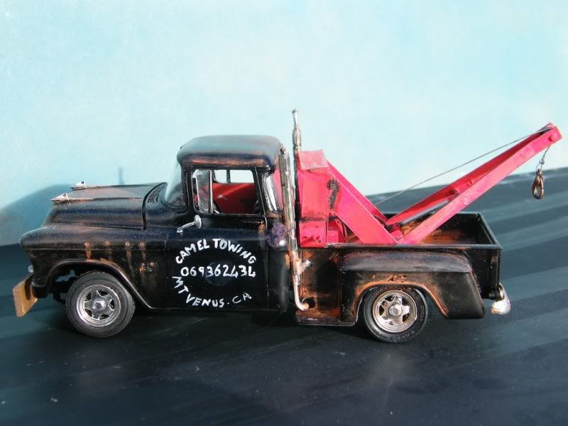

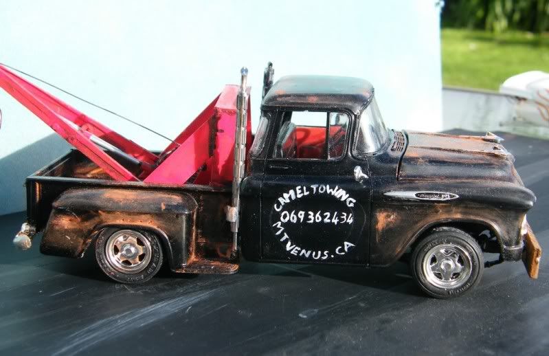

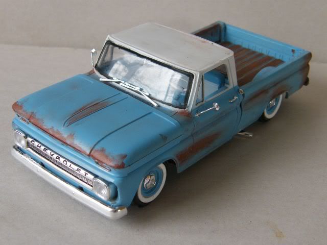

brett Posted August 17, 2010 Posted August 17, 2010 Wow James they look great especially the bumpers, something thats very hard to get right. Heres a couple of my attempts, the 53 and 55 tow truck using railroading chalks and the 64 pickup using some of the wifes eyeshadow makeup.

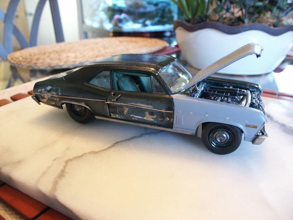

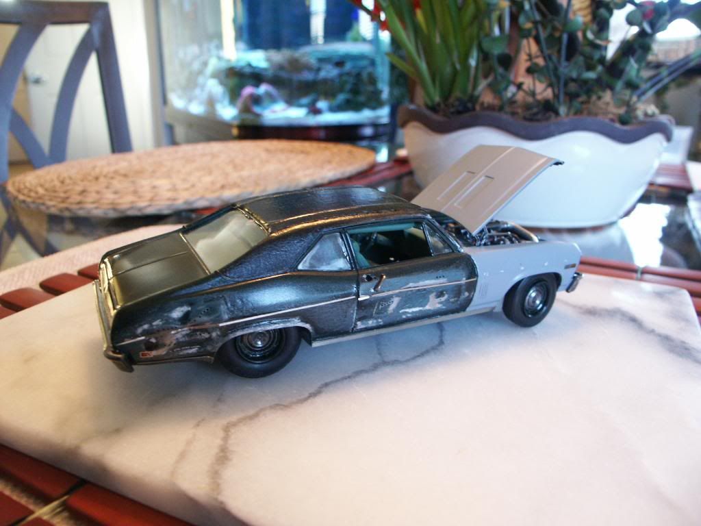

Romell R Posted September 25, 2010 Posted September 25, 2010 (edited) No rust but there is a nice side swipe on this car with dents and damage Edited September 25, 2010 by Aftashox
