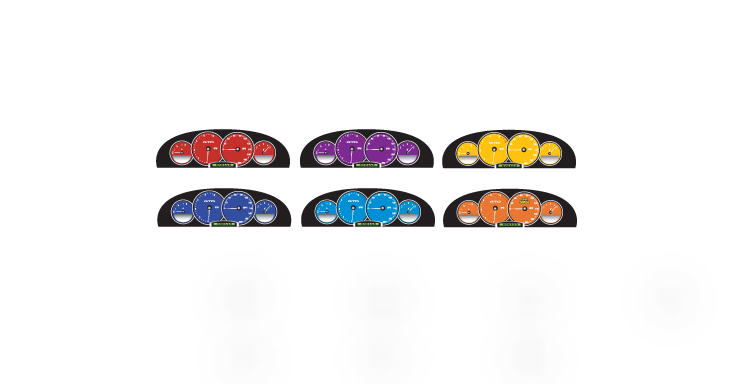

Jon Cole Posted September 12, 2010 Posted September 12, 2010 Some are from the aftermarket, others are images found on the internet... ’40 Ford... ’64 Impala dash, so I am told… Late model GTO… Just some examples. Others may explain the "paint with toothpicks" trick
Chas SCR Posted September 12, 2010 Posted September 12, 2010 I use Dolphin gagues web site. The thing for like new style stuff its hard to get the face you want from the pic, as they have learn that people steel them off the web site so when they take there pics they turn in them a little so you do not have a full face shot. For the older stuff thats a lot easy'er to get done. Then you make a decal and put it in place and clear coat over it.
