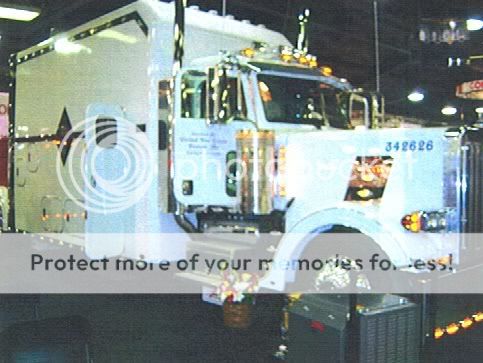

highway Posted October 29, 2010 Posted October 29, 2010 Let's a little continue this theme. What can you tell me about Big custom sleepers ("Double Eagle" for example), riding on Stretched frame Tractors? How much does they usually cost? How comfortable they are? Sergey, as you know, I've been working on my own stretched frame and custom sleeper truck, my Ford LTL 9000. I've scaled the sleeper at a 180 inch unit, and the frame is stretched to a wheelbase from the center of the front steer tires to the center of the first drive axle of about 345 inches. While mine is not a replica of a certain custom sleeper, I did do some research on them. You will find these two sites very interesting and helpful. The first link is to Indiana Custom Trucks, ICT Sleepers, and the second is for ARI Legacy Sleepers. http://www.trucksleeper.com/default.htm http://legacysleepers.com/index.php Here are a few of the pictures from those sites, and like Dennis said, you can get almost anything in these sleepers you can think of, even a shower and bathroom! I even found an optional fireplace on the ARI Legacy Sleeper site! These pictures are from the ICT site.
clayton Posted October 30, 2010 Posted October 30, 2010 Sergey, as you know, I've been working on my own stretched frame and custom sleeper truck, my Ford LTL 9000. I've scaled the sleeper at a 180 inch unit, and the frame is stretched to a wheelbase from the center of the front steer tires to the center of the first drive axle of about 345 inches. While mine is not a replica of a certain custom sleeper, I did do some research on them. You will find these two sites very interesting and helpful. The first link is to Indiana Custom Trucks, ICT Sleepers, and the second is for ARI Legacy Sleepers. http://www.trucksleeper.com/default.htm http://legacysleepers.com/index.php Here are a few of the pictures from those sites, and like Dennis said, you can get almost anything in these sleepers you can think of, even a shower and bathroom! I even found an optional fireplace on the ARI Legacy Sleeper site! These pictures are from the ICT site. Home on the range, and most of the time those owners may not have a place too call home.Most folks don't know that they see those truck and think Wow he rich. I'm guess the payment run 2k to 3k if not more a month?? , Also try the eBay motors look in the truck page lots if info there as well I use it a lot. Higway I'll get some photos in the next few days of mine.I kinda for get or think I'll get in a min.

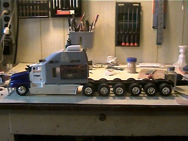

tanarries Posted November 1, 2010 Posted November 1, 2010 Home on the range, and most of the time those owners may not have a place too call home.Most folks don't know that they see those truck and think Wow he rich. I'm guess the payment run 2k to 3k if not more a month?? , Also try the eBay motors look in the truck page lots if info there as well I use it a lot. Higway I'll get some photos in the next few days of mine.I kinda for get or think I'll get in a min. hear is one i am working on not a real truck but just somthing i am working on home on the range dose not tell it all some of the over the road truckesr that own there own rigs also live in them so that they can always be running basically the truck is there home. and the one truck i seen " wish i had a pic" the guy paide $1,000,000 for it and had it specially built for hauling heavy loads like earth movers and cranes it was all he owned and it was decked out to the max.
