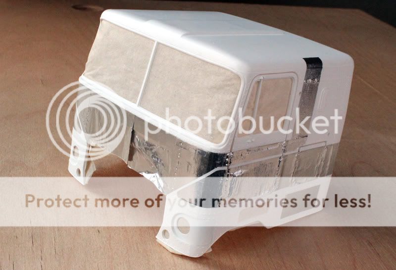

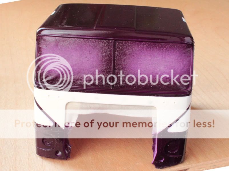

Sergey Posted February 13, 2012 Author Posted February 13, 2012 (edited) Update. Finally have painted the cab. The paint that I used half year ago, have dried. So I bought fresh one. It's - Mobihel "Moulin Rouge": Masking I guess I brushed too much layers. It's too dark. What do you thing? BMF is too old. And some areas haven't stick well. So the cab needs some work. Edited October 29, 2014 by Sergey

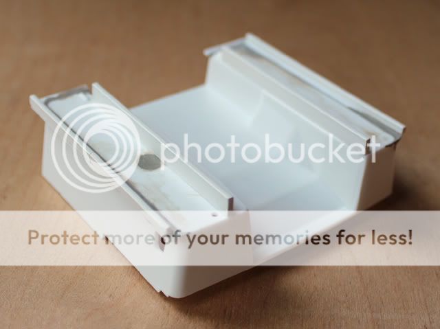

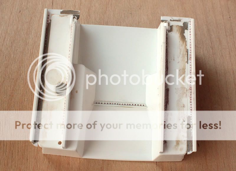

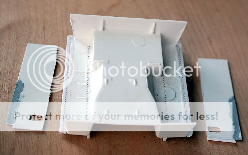

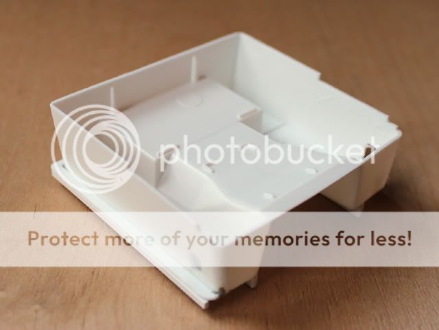

Sergey Posted February 13, 2012 Author Posted February 13, 2012 (edited) Altering the interrior tub. Extended the flor and glued the frame + added rivets down under. Next I cut out side walls of tub to move them closer to cab walls. By the way: what should I do to upload more then 5 photos at once? Edited October 29, 2014 by Sergey
Jim B Posted February 13, 2012 Posted February 13, 2012 Masking with BMF? Never thought of that. Expensive, but effective. Nice job on the cab & tub. I don't think there is much you can do to post more that five pics at a time. It's a new Forum setting.
62rebel Posted February 13, 2012 Posted February 13, 2012 i am overwhelmed by your dedication to scale fidelity and craftsmanship. a hundred and twenty years ago you'd have been working for Faberge making eggs for the Romanovs......
clayton Posted February 13, 2012 Posted February 13, 2012 Use a host server like Photobuket or Fotki.
